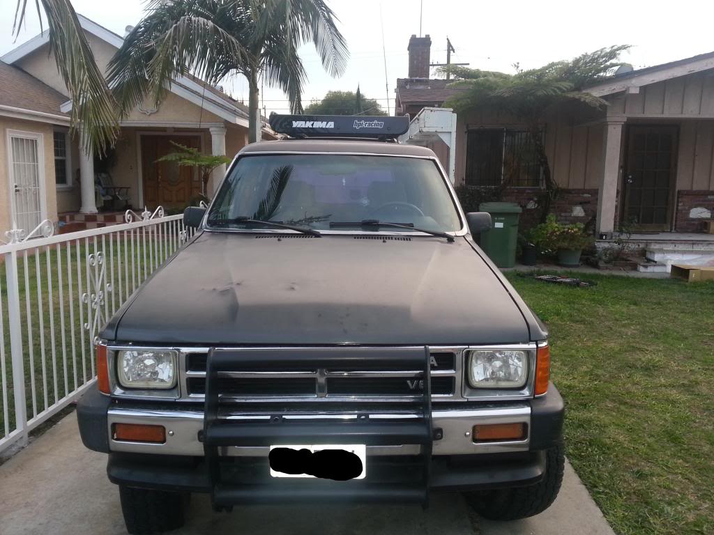

thats a rhino bull bar isnt it? unbolts at the sides i think
Old May 28, 2013 | 05:04 AM
  #1582
Redeth005's Avatar
Joined: Apr 2012
Posts: 2,817
From: Los Angeles CA
Honestly I'm not sure. It does had 2 tabs one the sides that allow it to bolt on to the front bumper. And 2 more on the bottom where it attaches to the front 2 skid plate bolts. You would need to drill through your stock bimper and use a nut and bolt to hold it onto the front side.
Here you can see the tabs where it bolts to your bumper.

ah thought it might unbolt at the side plates the bolts holding the tubes on some were fully welded together

Ah no. This one is all one solid piece. Good thing is that u can use your valance still.

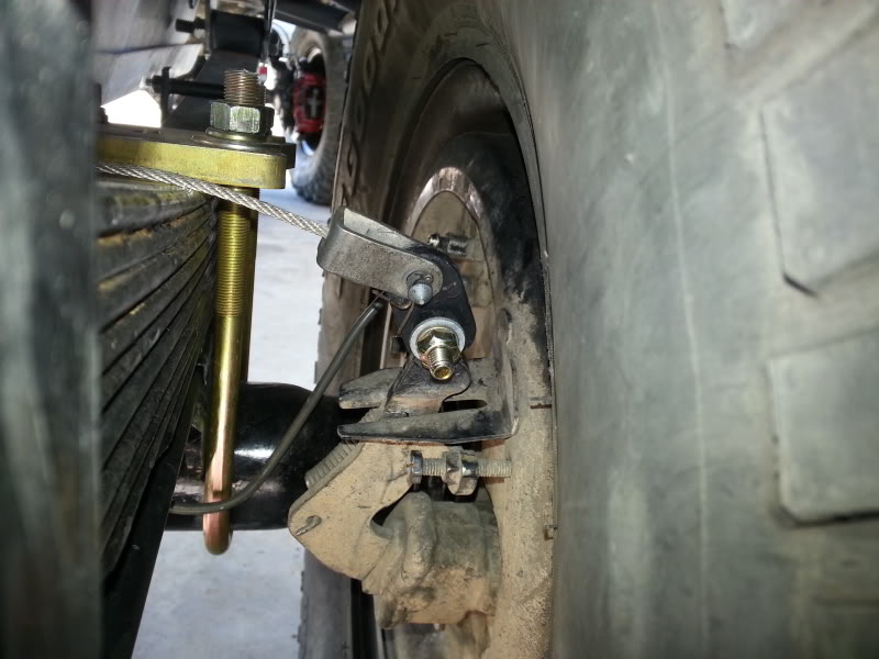

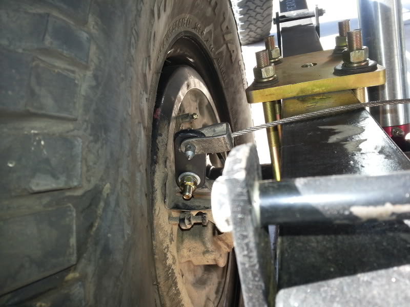

Alright guys i finished the brake line extensions. not too bad. And was a lot easier then i thought it'd be.
Passenger side: (Rear View)
Passenger Side: (Front View)
Driver Side: (Rear View)

NICE work on the extensions! did ya need to make custom cables as well redeth?

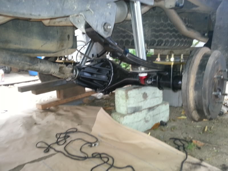

I noticed the U bolt flip kit? Did you reposition shock mounts.
Nice doin' business with ya.
I didn't have to make custom cables. The extensionsvwere long enough for me to be able to still use the stock cables.

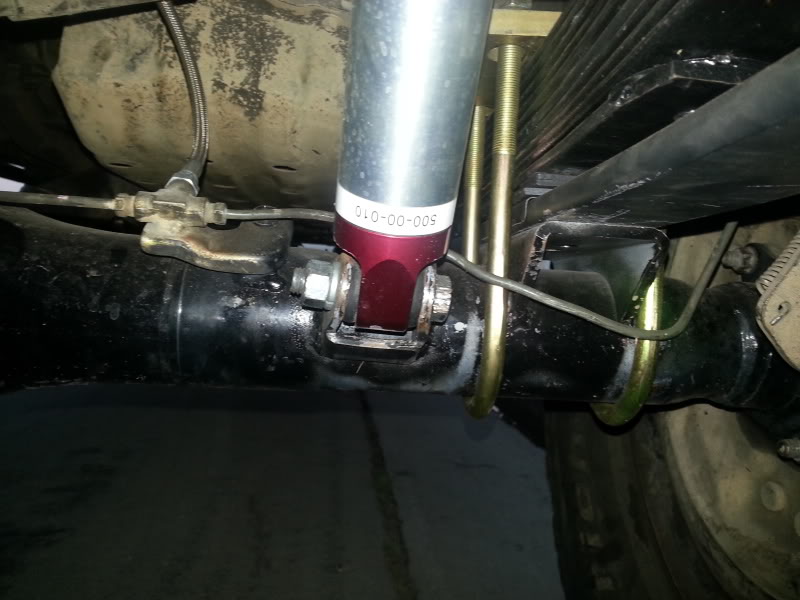

Yea. We mounted the left side on the front and the right one on the rear side. Well not me but my neighbour did.

From: Dixon, Ca
Can you snap a pic of those shock mounts. Thanks.

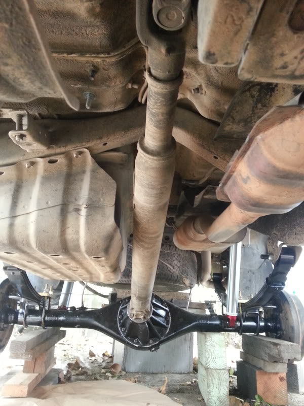

My truck is at home right now but here are a few that I found on my photobucket. Ill take a few more pix for ya when I get home. Then add them to this post in an edit.

Many thanks. now I will think about the fab.

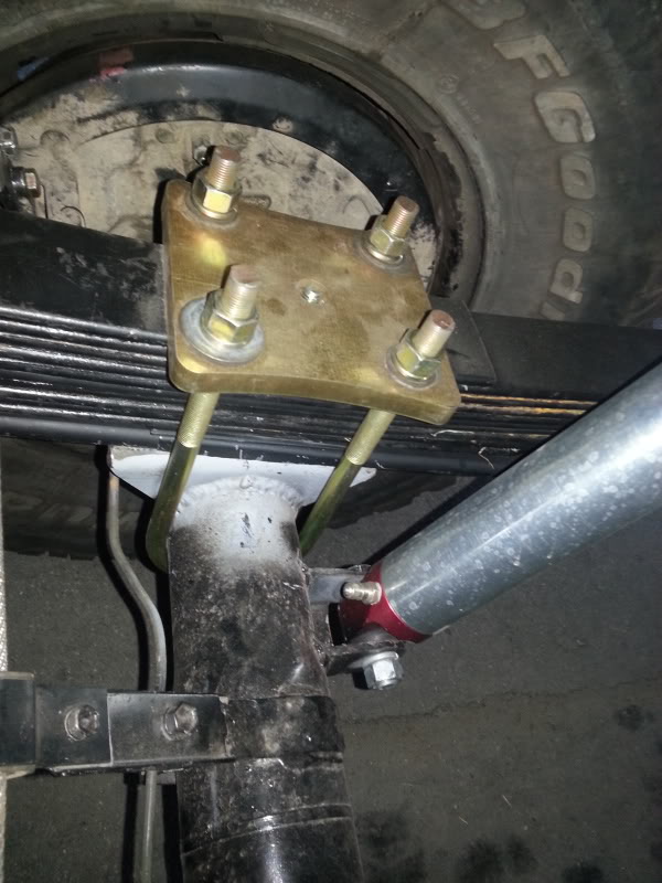

Hey tuef, here's some more pix of how the shocks mount to the axle.
Passenger side:
Driver Side:
After taking these pix i realized i missed a few spots with the black paint lol. I need to go over it near the spring perches because you can still see that primer lol

Lol Toyo, I know it looks huge! those things were heavy and hard to install lol. But dont mind that very bottom fat overload spring. that one doesnt do anything for me other then give me 1/2" more lift lol
The only thing that made a difference is the extra leaf i installed in between the leaf pack. that was to give it more arch for lift. So far it has worked like a charm. It is really level now since ive done that. it has gone down just a tad bit but it still looks level
