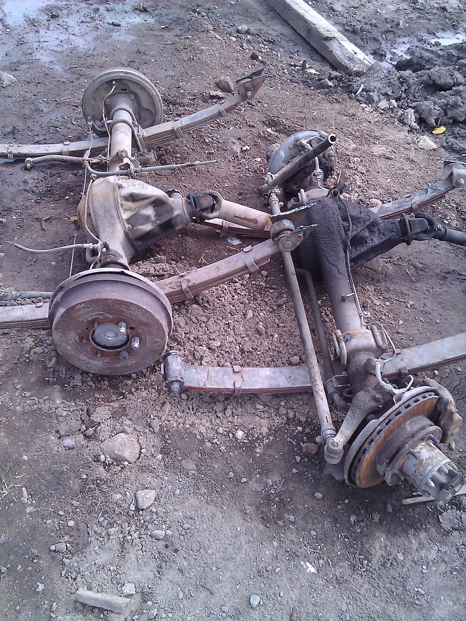

Those are my new junk axles. They come spring under axle and the metal hangar looks like what you have your springs sitting on in your spring over axle configuration.
Was curious if those old trucks came spring under axle and you had to do some mods.
I was so set on a LT kit like Blazeland I've not looked much into SAS jobs.

From an FJ62.
Could have bought the whole truck for $400. Not enough room for more wrecks. It was running though.
Sorry for hijack Redeth.

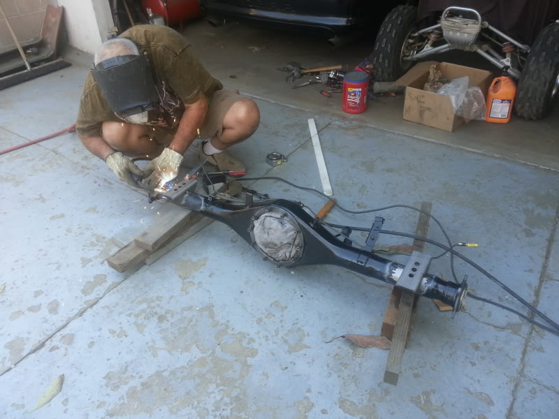

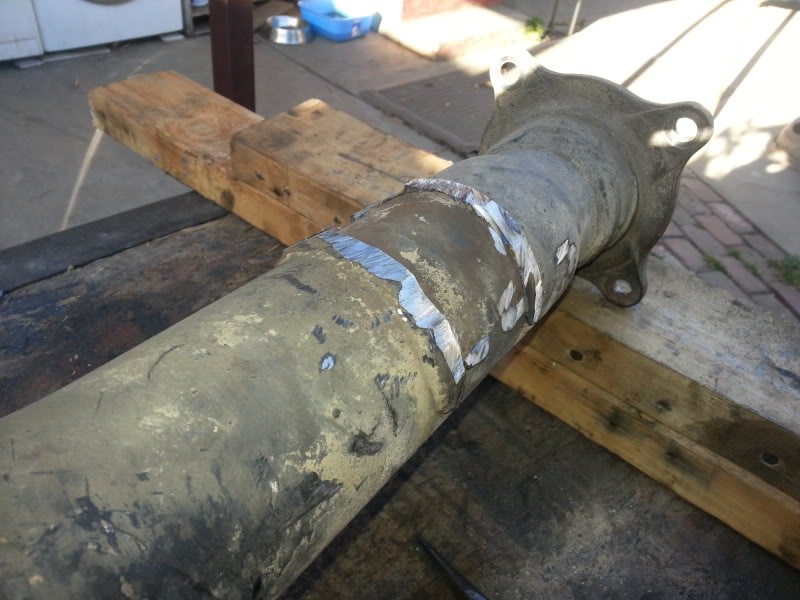

Ahhh ok i see, thats the same way that Suzuki samari's are set up when stock. Ive seen a couple of Toyota Pickups land cruisers and 4runners like that too.
That is the same set up that we have in our rear axles. You will need cut off those (bottom side) perches with a grinder cutter wheel. I didnt mess with my front axle when it came to these because mine already had more or less at an okay pinion angle toward the transfer case. But i did do my rear axle. Here are some pix you can reference to.
Cut off:
Grind down so its smooth:
We referenced my axle to Ruben's truck who's pinion angle was already at a good angle. So you position your axle at the angle you feel comfortable with, then you weld on your new Spring perches. [i got mine off AllPro] ---> https://www.allprooffroad.com/8489su...689springperch

Also you might need to measure where your leaf springs are because you said those axles you bought are a bit wider then our 4runner ones right??? Well if they are you're gonna need to measure from leaf to leaf and make sure they're the right spot same with the front.
Here's how the angle on mine came out:

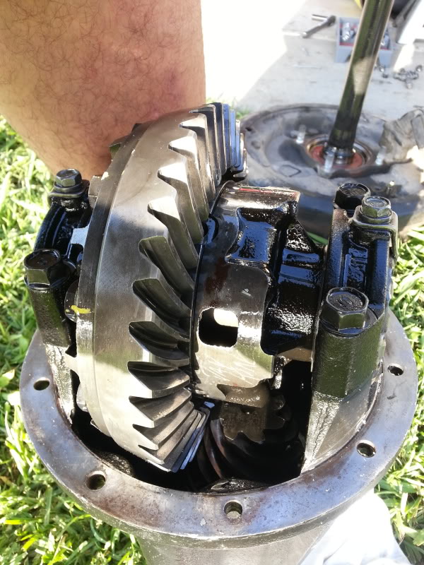

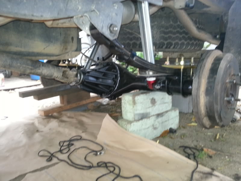

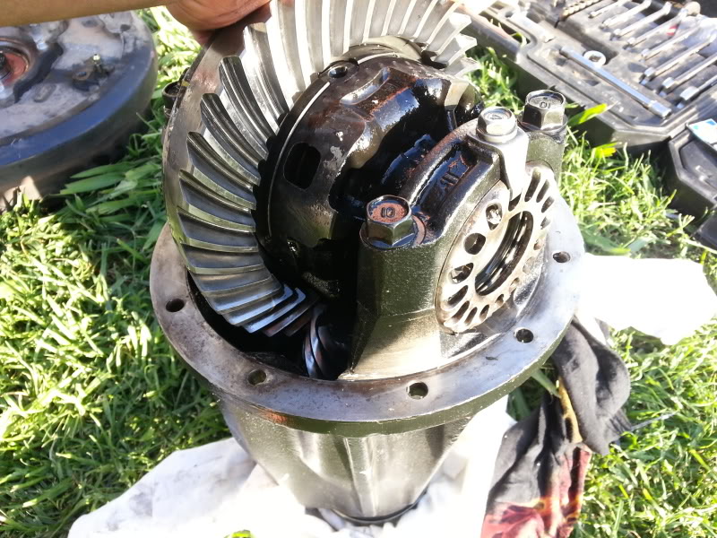

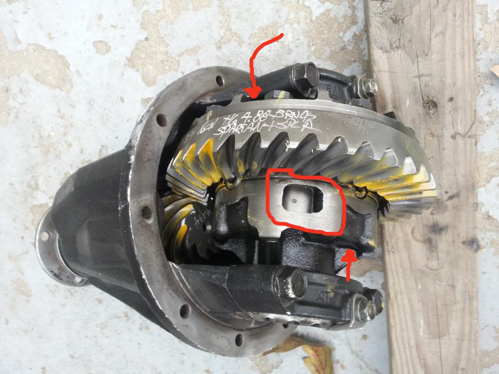

So I removed the rear 3rd member today. And i did not find a single thing wrong with my 3rd. No scratches, chippings, teeth missing off gears, and no more other shards of metal like the one in the previous post.
Anyway. i took some pix and videos prior to my good news.
Short Videos.
http://s10.photobucket.com/user/esam...a3541.mp4.html
http://s10.photobucket.com/user/esam...feedd.mp4.html

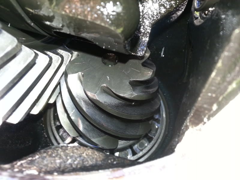

Anyway, after our inspection i still didn't want to install that 3rd. I just didnt feel comfortable. Ruben is a very knowledgeable man. but he doesnt work with 3rd members like Eric at YotaMasters does. Not that im saying i dont trust his opinion. there is nothing more that i would want then for my 3rd to be fine. i welcome good news. but you gotta be realistic and optimistic some times. So What you guys didnt see in the video was us calling Eric at YotaMasters for advice. So i let him know i had the 3rd removed already and it was in front of me. he had us turn the pinion and inspect the gears first, then he had us take a very close look on the spots he would look for damage if it were himself checking and pretty much explain everything we saw to him. Almost like being his set of eyes over the phone. and he had us check in these general areas(remember its a V6 3rd, 4cyl look totally different.)
Anyway both Ruben and I looked and looked and turned the gears over and over and inspected everything Eric told us to look for and everything was perfectly fine. there isnt anything wrong. Not to mention that shard seemed like it might have been too big to fit though those areas. Then he asked how well did i clean up the axle housing when i removed the 3rd. And then i thought about it and really don't only remember giving it a nice little wipe down but for the most part i only remember stuffing it with rags after giving it a quick wipe down. I wasn't as thorough with cleaning the inside of the rear axle as i was with the front.
then he pointed out the Baffles!
I definitely did not remove those things before. So there is a high possibility that the shard i found might have been to something that was broken to the previous 4.10 3rd i had. I looked behind the baffles after he had mentioned it but i didn't find any more shards or metal. so that must had been the only one. Lucky me. So after figuring that out he told us that he doesnt think that shard had anything to do with this 3rd. and thinks i outta go on that Big Bear trip with weekend. and just listen in for anything out of the ordinary.
So we put everything back together and of course with all good news comes bad news! We were nearly done tightening the bolts on the 3rd when my wrench slipped off the nut and WAAAAMMM goes the wrench smashing into my face busting my eyebrow open! Letting you know now these pix dont do it justice. it is much deeper then what it looks. It has almost 3 hours after it happened and my eyebrow is still bleeding a little. I'm sure it needs stiches but i dont think it is really that bad. Nothing that cant heal on its own. Just gonna slap some Alcohol, Neosporin, and fabric bandaid on it before i go to sleep.

Anyway we got everything installed already. but dang. wrench to the face really sucked

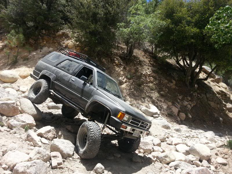

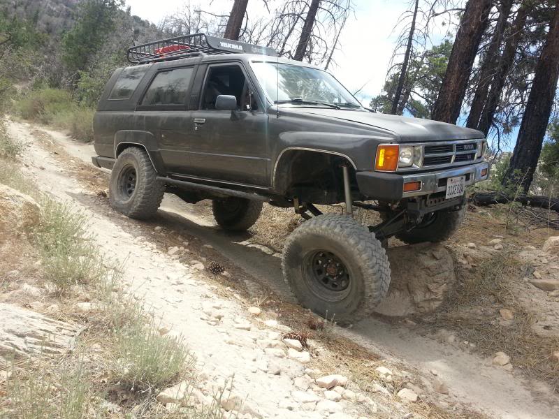

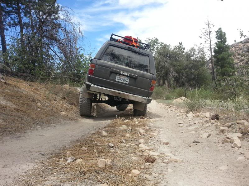

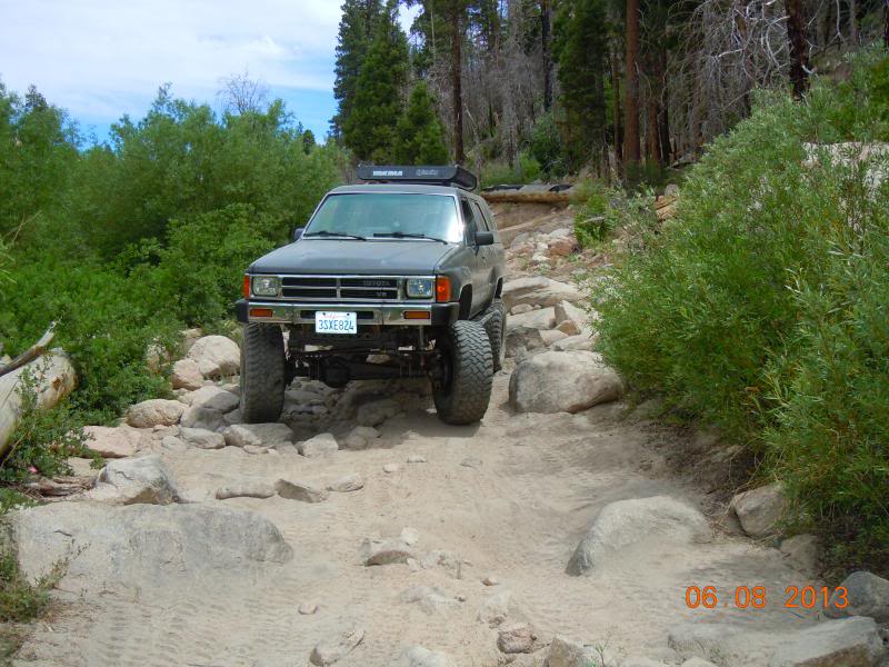

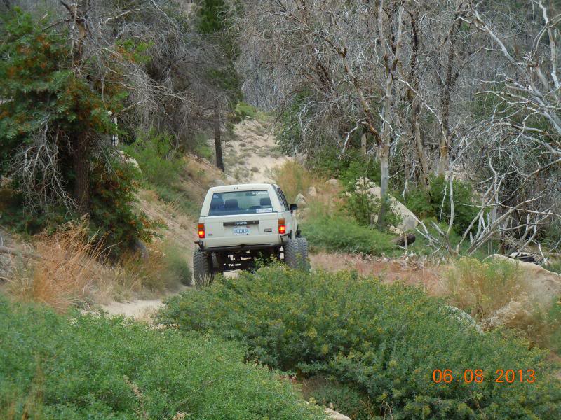

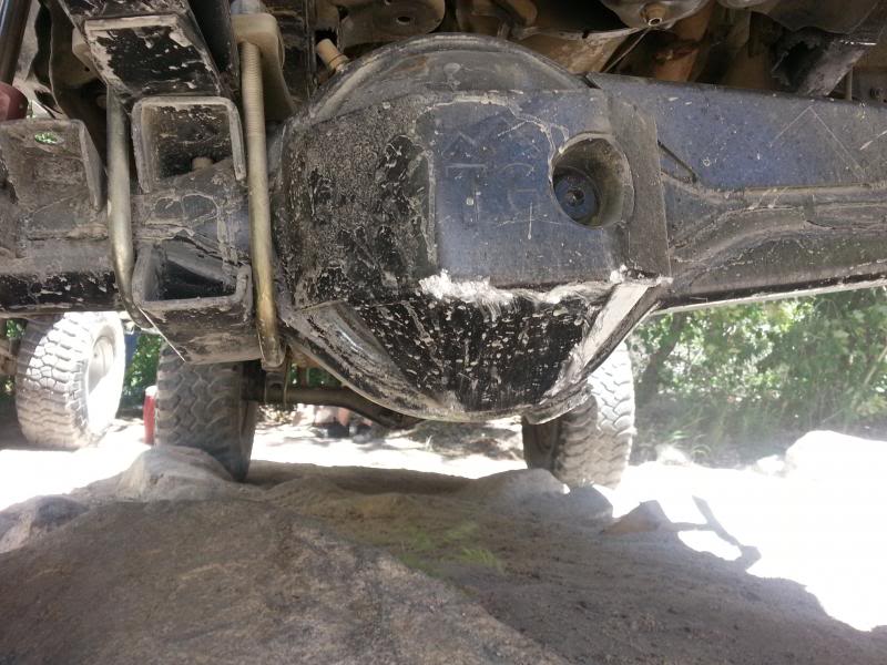

First of all i would like to inform you all of something that always has mixed messages here on yotatech.
Having a Front Locker (Spartan Locker in my case) I always hear that having a front locker is dangerous and i hear that people avoid locking their front axles for that reason. I just want to say that having a front locker does not affect you in any way in the street. So long as your 4x4 is not engaged then you are perfectly fine. I Tested this theory yesterday and yes it does suck when driving in 4x4 in the street. DO NOT TRY IT! i noticed my steering wheel would jerk at times, and when i would try to turn my steering wheel as i would park or pull into the driveway that i couldnt turn my steering wheel very much. it was extremely hard and i didnt wanna force it. Once i would disengage the 4x4 then all would be fine. So if you want a front locker i just dont recomened you guys using the 4x4 on the streets cuz it does suck on the street.
On the other hand, it's performance off-road is completely the opposite, It is great! you get tons of traction. and you are also able to steer! Really you gotta use your engine at times to assist with your turns. but nothing too bad that makes you hate the experience. Watch the videos i upload and you will see what i mean. The performance of having Front and Rear Lockers is like a night and day difference! Not to mention this SAS job and all the other things i added on(lift, 4.88's, lockers, new springs, hy-steer, and 33's. IT WAS MONEY WELL SPENT GUYS. After todays trip i absolutely despise my old IFS set up. I am 100% satisfied with the results and all the all around performance of my rig now! All i need now is my Tire Carrier/bumper, and front bumper/winch/lights and i am completely with off road upgrades.
Also I'd like to say that my rear leaf springs performed flawlessly. You can see in some of the pix that the tire gets stuffed in the wheel well, Only downfall is that the down travel is probably at about 1" less then where it should be at due to the leaf spring i added. BUT i still performed great and my truck stayed level. I think it is well worth the sacrifice because i carry a lot of crap in my rear so i'm happy with it. I'll let the pix speak for themselves and you guys can make your own opinion about them.
With all that said LETS GET TO SOME FREEKIN' PICTURES! ...right??? *YEAAAA!*
I'll just start in order. These pix were taken when we were on the way over there still, already in big bear-ish area.

It took me about half an hour to fully get comfortable with driving the truck with all these upgrades. So i do have a few poser shots. You will see the pix get better as you scroll down showing that i was getting more and more comfortable with driving my truck. So please bear with the first wanna be flex shots lol I promise it gets better lol
POSER SHOT! Seriously thought i was flexing from the inside of the truck hahaha.

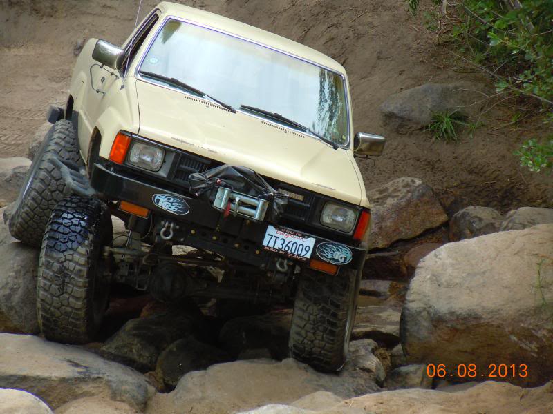

This is Rubens 85 Toyota Cab Extended bed pickup. Allpro 4-5 inch lift, detroit lockers front and rear, 4.88 gears, and marlin crawler transfercase

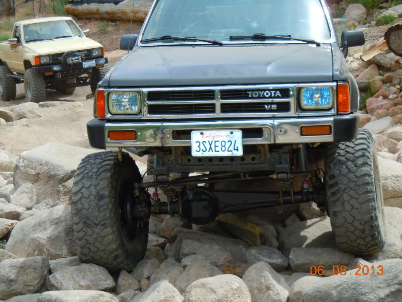

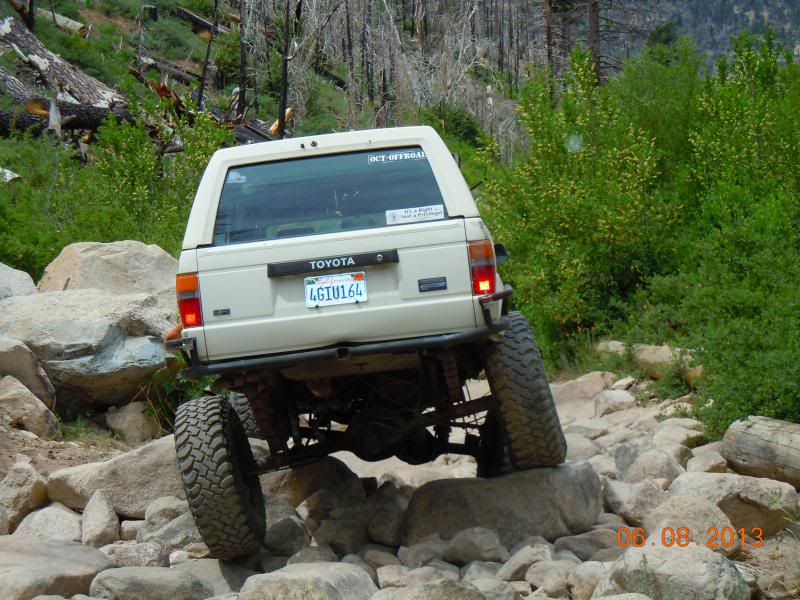

Here is me going through the rock garden directly in front of where the pix above are. Still had some trouble keeping the truck from turning off due to lack of air flow here. but you can see the axle flexing in action in these next few videos
Some more pix:

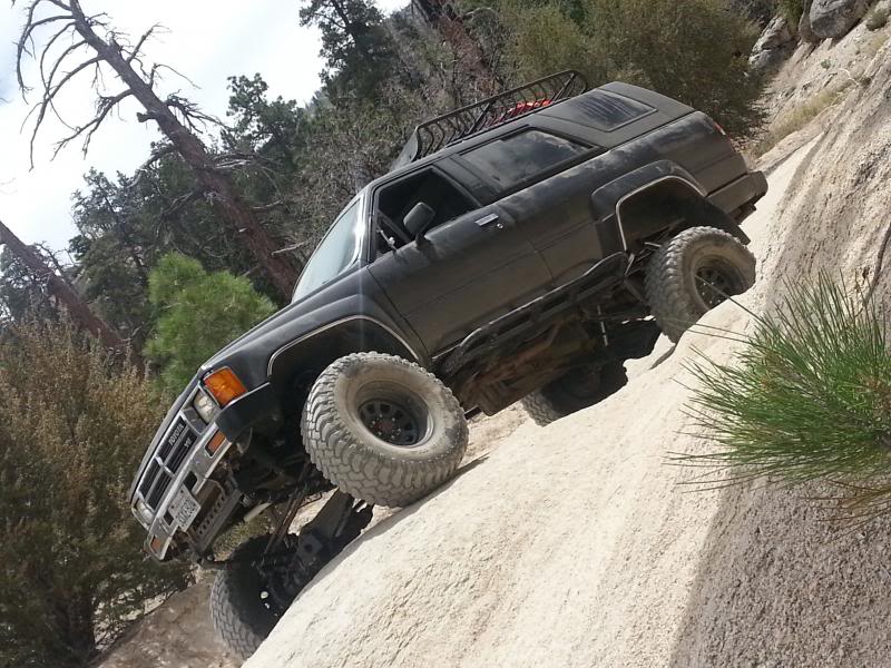

My truck:
