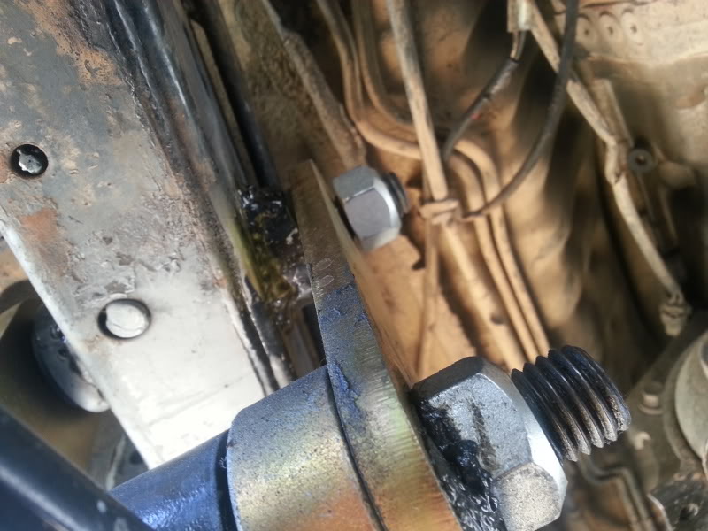

So since the SAS I have been having a bit of "Death Wobble" going on starting about
2-3 days after the first time I took it out for a drive. Mark felt this wobble first hand last weekend. And all I gotta say is that it had gotten worse last sunday. It was doing it frequently. I noticed it would h
Normally happen with bumps and dips anything that was un even and at a speed of 25-35mph. I finally decided to just not drive the truck till I found out what it was so on thursday i went under my truck to check on the bolts and this is what I found.
If you look closely you can see there is a 1mm distance from the nut to the part where it would be "tight". There was also a 1mm distance on the bolt side as well. After finding that I seen that all the nuts and bolts that had to do with the shackles were loose. 2mm on both the front ones and 1mm on both the rear. I knew that you gotta check on your nuts and bolts after an SAS but I honestly did not expect them to looses this quick. I had only driven it for about 100 miles before it started. And maybe 220miles when i finally tightened them. So yea loose bolts..... check them every few days after you SAS. I'm sure it takes some time for the new system to break in and I'm sure the nuts and bolts will get looser like mine did.
Since Thursday I've only driven it around yesterday and all day today and I haven't felt that violent shake at all. So this mystery has been busted. That's definitely what was causing the problem.

Remember what I asked ya? "Dogs ya torque those nits to specs? Think it's 58-65#."......??? You said, "Nope, just tight as heck! " hehe...
Main thing I wanna ask though. .... where are the lock washers? If you go to 58-65# over a lock washered nut? It would not and should never come loose buddy. Get some grade 8 lock washers for those huge bolts and go to"Recommended toque" for those size/thread pitch bolts and nuts. Your new springs and hardware will have full instructions too. See, the stock bolt are M14 X 1.00 T pitch.... those bolts you got, I saw them, they are likely US/STANDARD & at least the of 27mm in metric.... and not as done a thread pitch. ... 27mm equals 1.062".... try a 1" or 1 & 1/16th" socket.... ser if I'm right? Hehe. ...

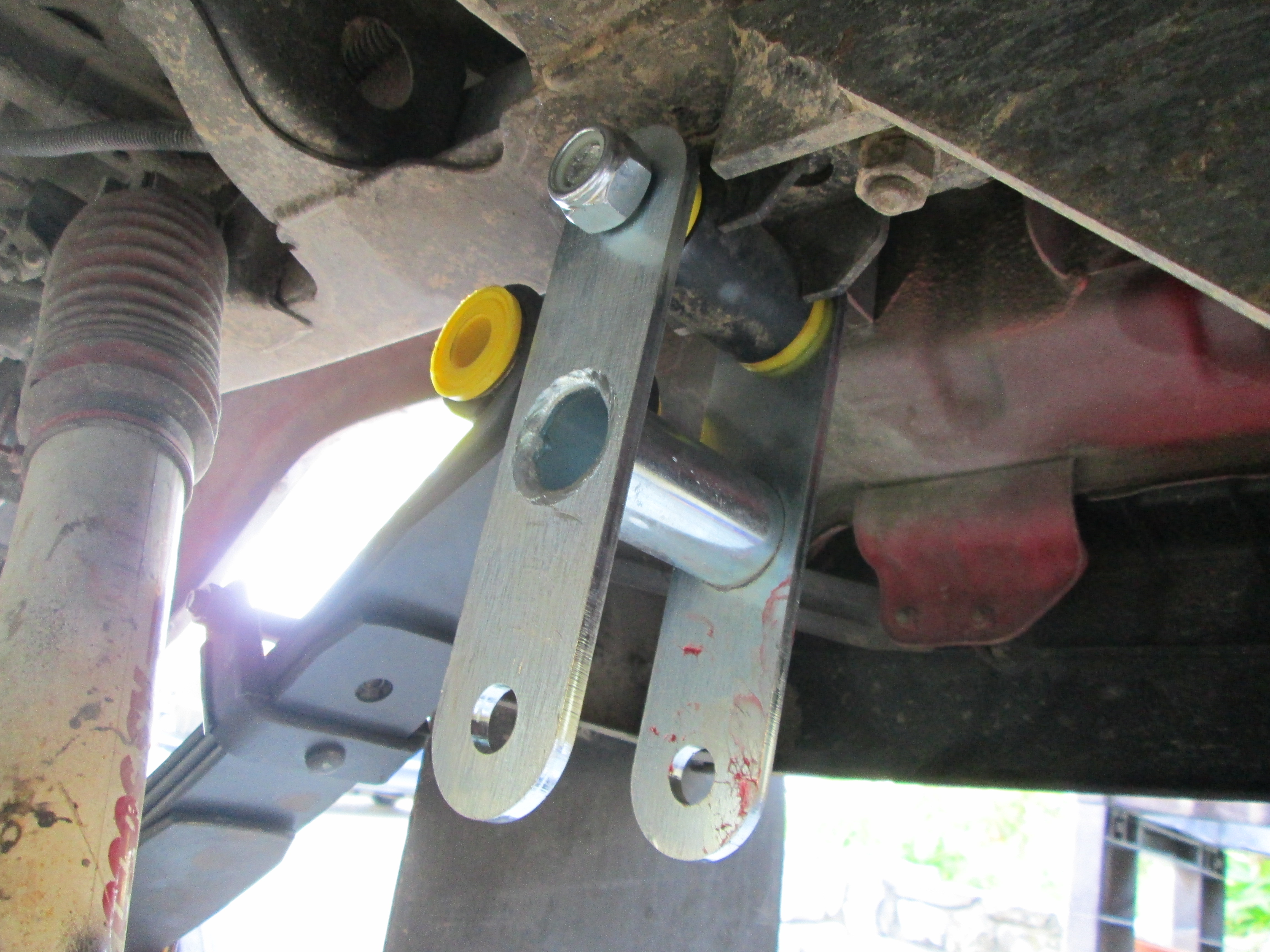

Hey Richard, one other thing,... I'm looking at that picture and it looks like there is no bushing flush against the bushing and bolt insert portion of the hanger, on either side... I just can't see it. It should look like this... The yellow part in that you see where my shackle is pushing against on the inside against the hanger plate and leaf end eye....
And here on the front hanger. ....
Obviously it's there or ur bolts would be flopping around in there, haha. ..... Just curious if maybe the portion that compares slightly between the shackle and the leaf Eye is gone/eroded away?

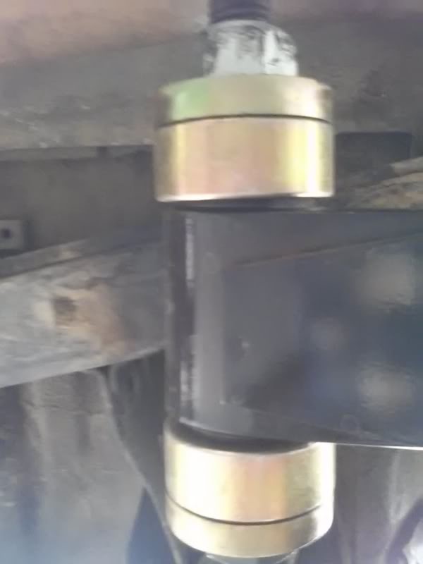

I can see why you'd think it didnt have some huh lol. But yea it does. Just that mine are black. so you cant tell as much.
Here check it out.
Old May 5, 2013 | 09:35 AM
  #1440
ChefYota4x4's Avatar
iTrader: (5)
Posts: 19,281
Likes: 21
From: Lake Havasu, AZ
Ahhhh, fhhew, good! Lol. ... And yeah, they look almost like nylon insert lock nuts, as they're kinda coned (the nuts in the pic)....but I HATE those nuts with a passion! I have had at least 5 lock up on me and basically cause the nut to hamburger the bolt thread. Those daystar shackles I got that were wrong? ......those were lock nuts, and they got on the first turn of the metal on metal and locked up on me. I'm not saying to ditch em, I'm sure ALLPRO did their homework and application testing.....I just have had pretty bad times with those.
