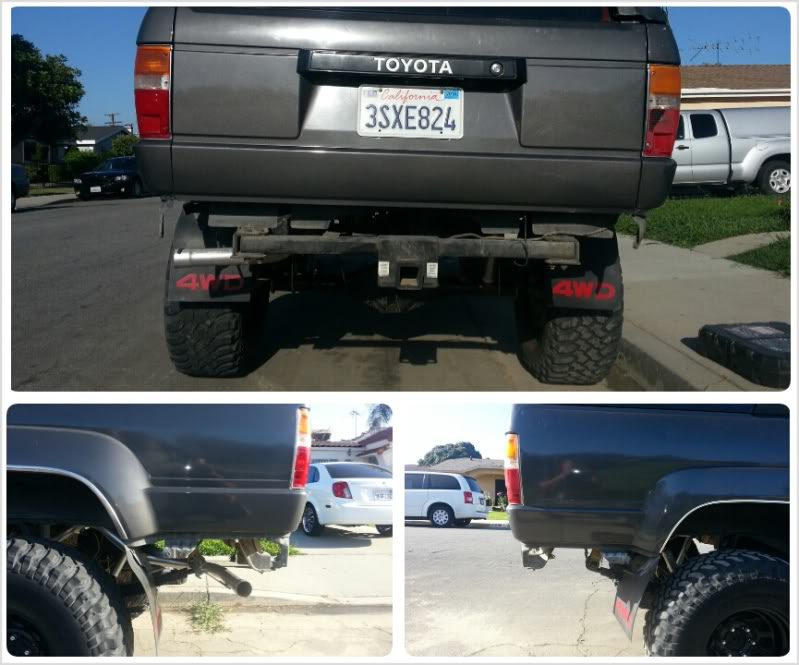

Just removed the rear bumper. I'm thinking of possibly re using that tow hitch. but it does need to be moved up about 2". We'll see what we come out with. Also With the rear bumper and plastic sides off i was finally able to bend that mudflap bracket back some so it stops rubbing against my tire.

if you were to move the hitch box up into the support yu'd gain like 6+ inches weld a plate over the top of the box an below it lots of support for it

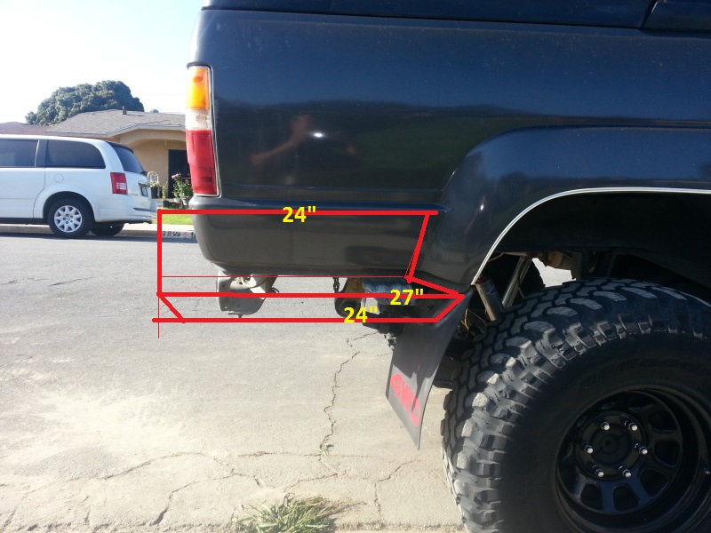

Will, i was planning on building the bumper off the tow hitch but i dont know about gaining 6" more i might gain about 3" of clearance by cutting it and shortening the drop length where it mounts on to my frame.
Every time I see shots of your fenders I'm amazed at seeing no rust.
Thanks Man, I've recently taken a look at that "Show me your Rust Pix" thread and im amazed at how bad some of these trucks get. rusted holes and chuncks right off the frame lol All i gotta complain about is a bit of dirt, dry mud, and a few scratches lol

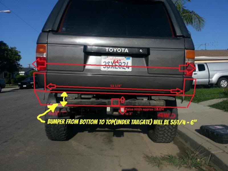

Just a couple of quick measurements i took last minute before i finished up for the day. It isn't the greatest but this is just a rough draft. I'm sure i'm gonna change the design and the measurements might change a tad bit. The one thing that definitely needs to get altered is the height of that tow hitch. Definitely gonna wanna re use that so i can continue to tow stuff. Will probably cut off 2&3/4" - 3" and leave the hitch just 3/4 - 1" gap under the tailgate just to make sure it clears.
Mind you these were done in the last 15 min lol I'll probably have some better drawings tomorrow sketched out by hand. that's if all goes well.

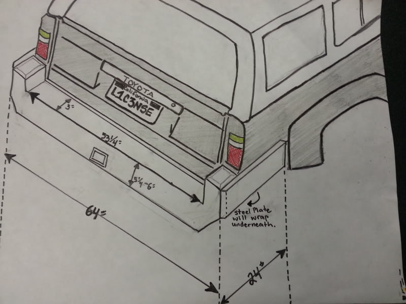

Hi Ray. I can't even use my crank spare tire holder under the truck anymore. 33/12.5 tires are much too big to store underneath lol but yes, to answer your question, i am gonna make this bumper to have the swing away tire carrier too. I already ordered the kit from EMS offroad to be able to build it. But before I get to the tire carrier I hace to first have the bumper to build off of. So that's why I'm making a few drawings of my design.
This is what I drew up today.
Fuel cells are pretty cheap.
I want to put one there in addition to a lower profile belly tank for long range trips.
Old Jun 17, 2013 | 11:18 AM

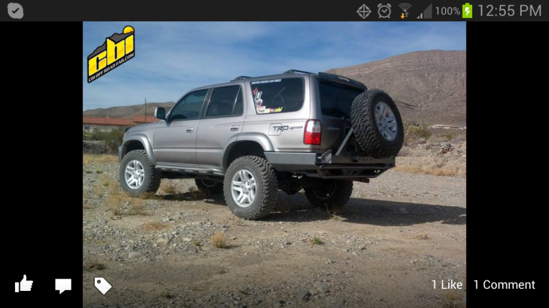

Just saw CBI offroad post this 3rd gen tire carrier bumper on facebook. Its really nice. This just gave me another idea. Only difference is i would be using plate instead of tube on the bottom part where the hitch is.

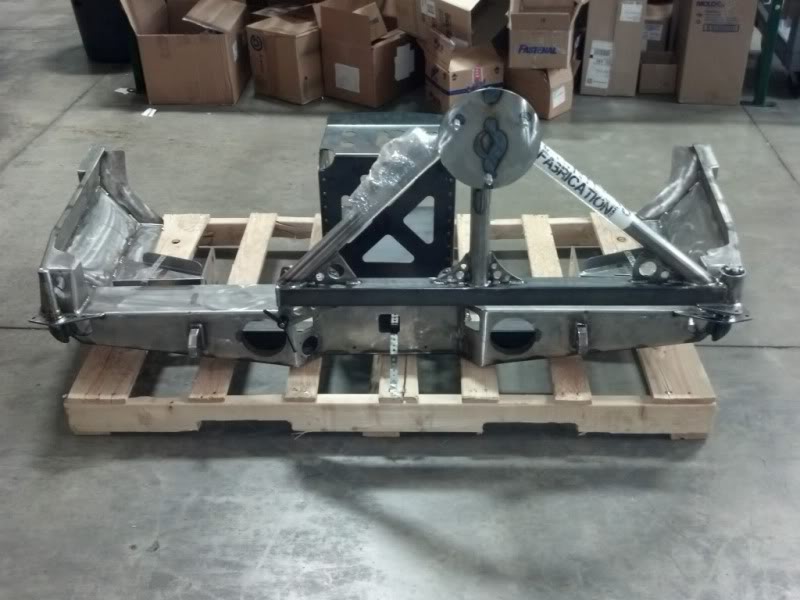

Hey Richard, this is why I like the 4xlabs stuff. .... Well at least that one that I showed you on that Land Cruiser?... It puts the tire almost completely over to the left to where it is not covering the brake light but right near it... Then there is plenty of room for the jerry cans on a separate swing out on the opposite side . I think some of the strongest ones swing down but I'm not sure if that's better or not for our for runners. remember to always include your truck tent in this schematic

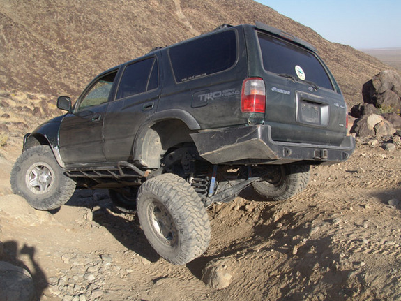

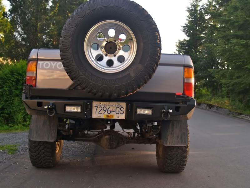

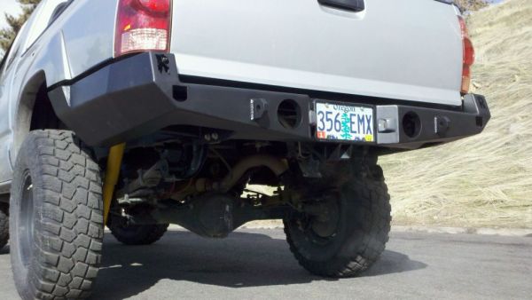

Today I Swimmerboy posted up this picture of a rear bumper he bought by Relentless.

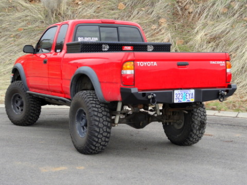

I liked the bumper so much I decided to look up more of their work. This is what I came across.

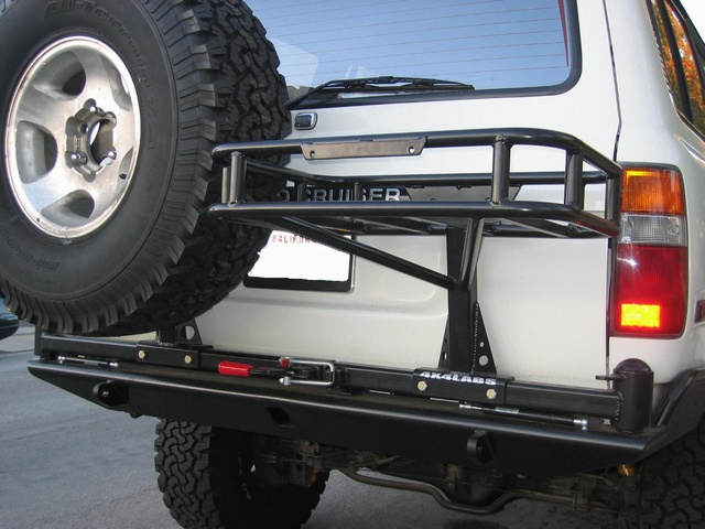

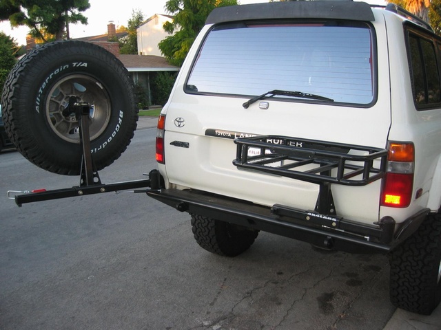

Here is a design more of what I want here. This view gave me a lot more insight on how it's to be made.
I would like something more like the bumper in the picture above but i do like the idea of the 4xLabs bumper that Mark posted in the last post. I do like the idea of having 2 hinges. It makes more sense to build a tire carrier this way to lesson the heavy load on the spindle(s). This way I can have one spindle dedicated to my heavy tire and the other one dedicated to a Hy-Lift and 1 or 2 Jerry cans for gas and water.
Idk yet. I am not certain how to do ot just yet. But this type does look a lot easier to build vs the CBI one that I was looking at. I think I like these ones much better. And also the corners of the bumper look much easier. All it looks like is a bunch of different sized triangles put together to make the corners to ot can continue to the sides.
Definitely happy I looked this brand up.
