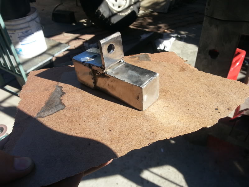

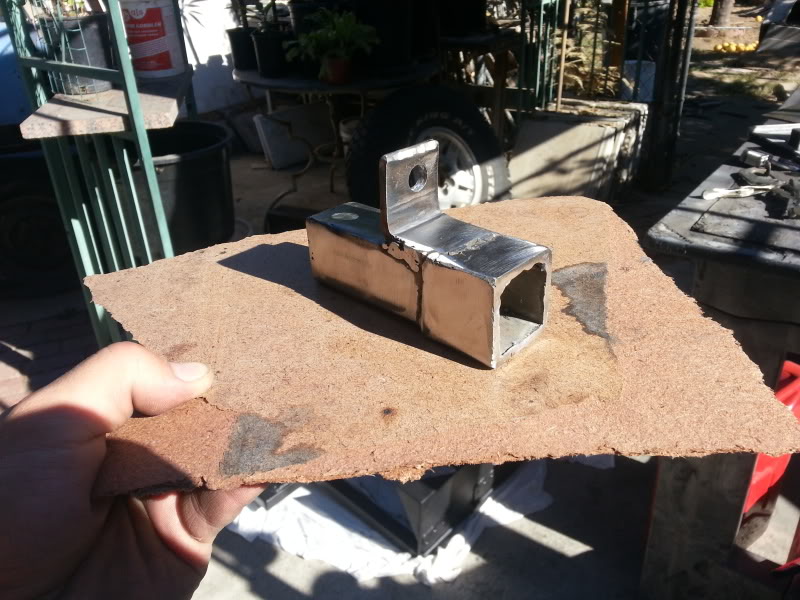

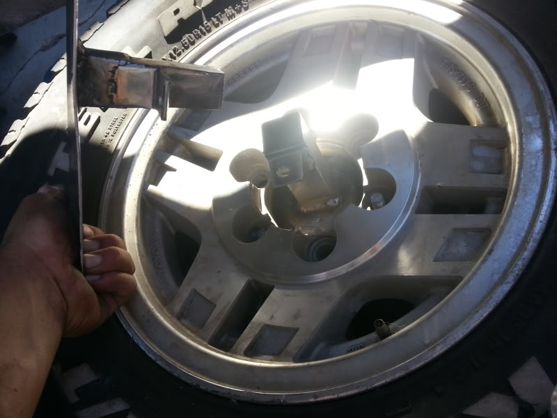

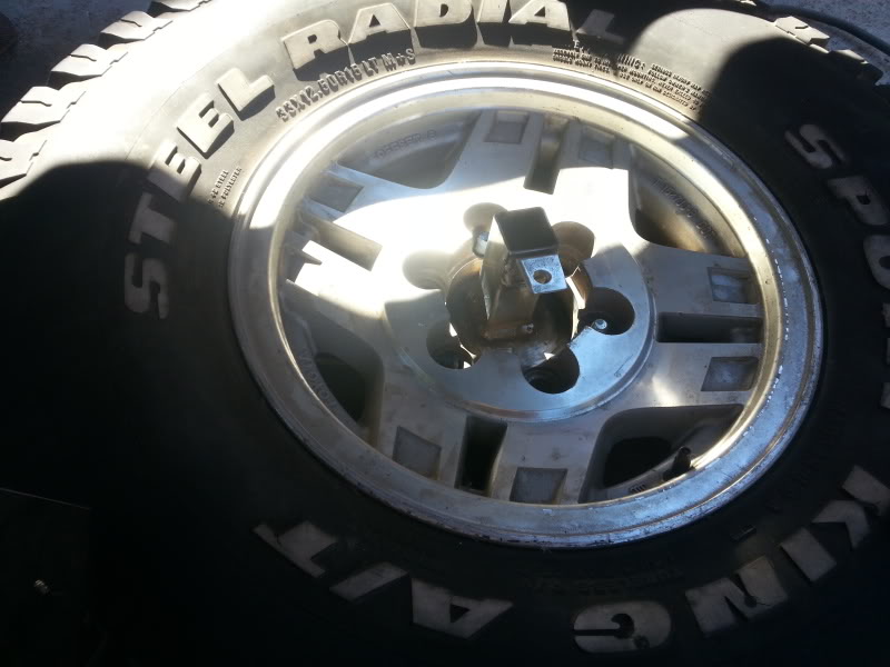

I finally finished the license plate holder/lock.
First i decided to beef up the license plate side with some more metal. It was pretty thin metal so i doubled the size on the end where i plan to mount the license plate. Also decided to add a cap on the end of one of the pipes to avoid getting water into it which will eventually lead to rust.
See? Beeeeefieeeer.

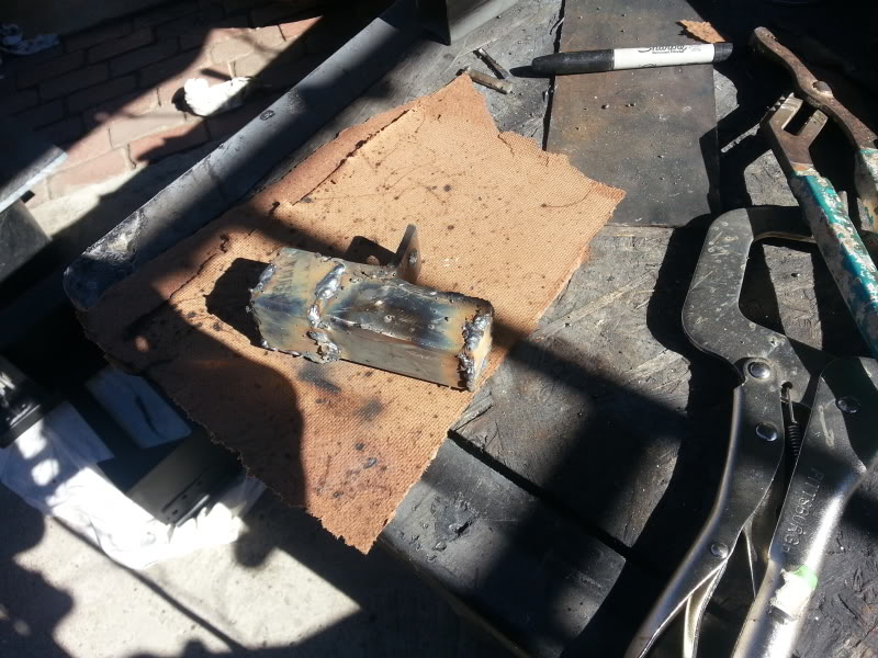

This is the Female side. i welded this to the tire holder back plate.

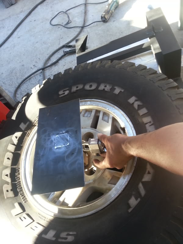

Here's the male license plate holder side. This will act as an anti-theft device as well. With the lock it'll have it wont be so easy for theives to steal my spare tire. Notice my welds are getting much better with practice.
Notice the Master Lock in my hand locking both pieces together. Ohhhhh yea..... I'm gooooood! lol jk It was just a really creative innovative idea thats all. Even if the theives manage to remove the nuts off the tire carrier they still wont be able to take my tire while still having this locking device there.

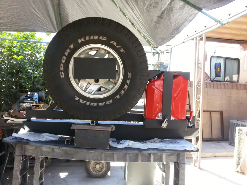

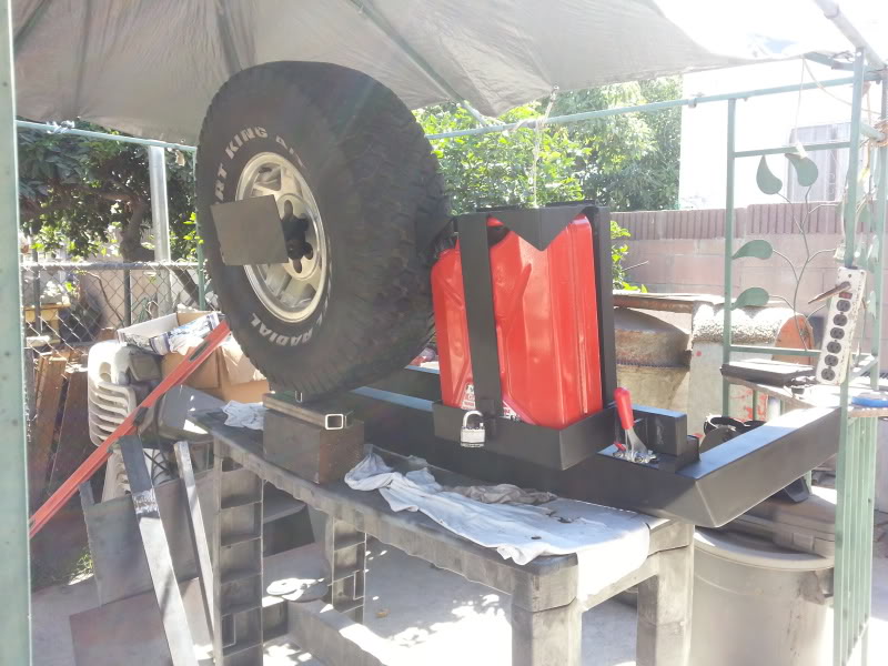

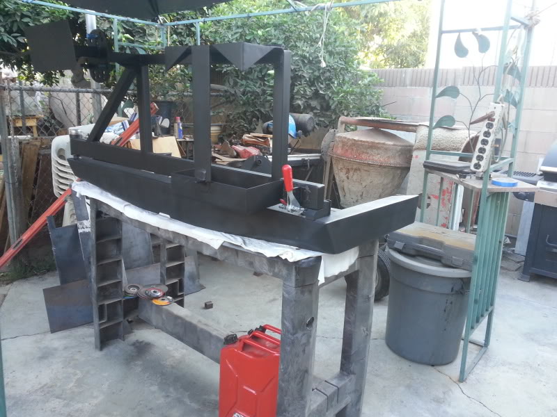

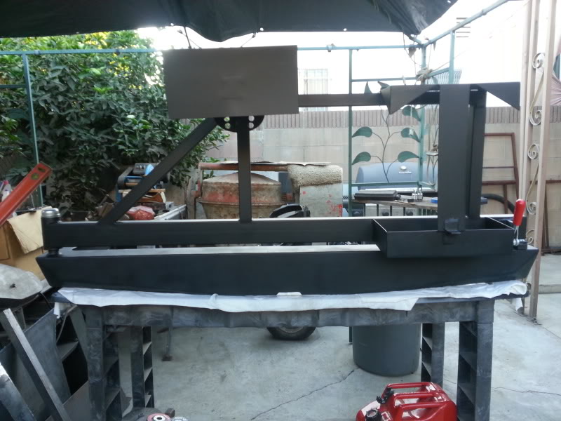

Here she is! It's finally finished. Well, almost finished. only thing it needs is the SuperBrightLEDs LED strip that i bought today. I will probably use some extra square tubing to make a holder for the LED strip to mount onto. Probably cut the square tube so it's missing 1&1/2 of the sides. and i'll just weld it to the back of the plate holder so it kind of hangs over the tops side. and the LEDs will face down. It's kind of hard to explain. I will have to explain through pictures or drawings. Oh well, you guys will have to wait till the LED strip comes in the mail lol.

that just looks incredible rich hows the weight doing?
if i might suggest take some rubber intertube or such an glue it round the padlocks so as they swing to an fro they dont go banging paint an rim too much or even a small bunji cord to wrap around it

I just weighed it. It sits at approximately 110lb. And that is still not including the spare rim/tire with jerrycan(even more when full)
I like your ideal. I am gonna have to use that idea so it doesn't mess up my paint job. Thanks Dragon.
