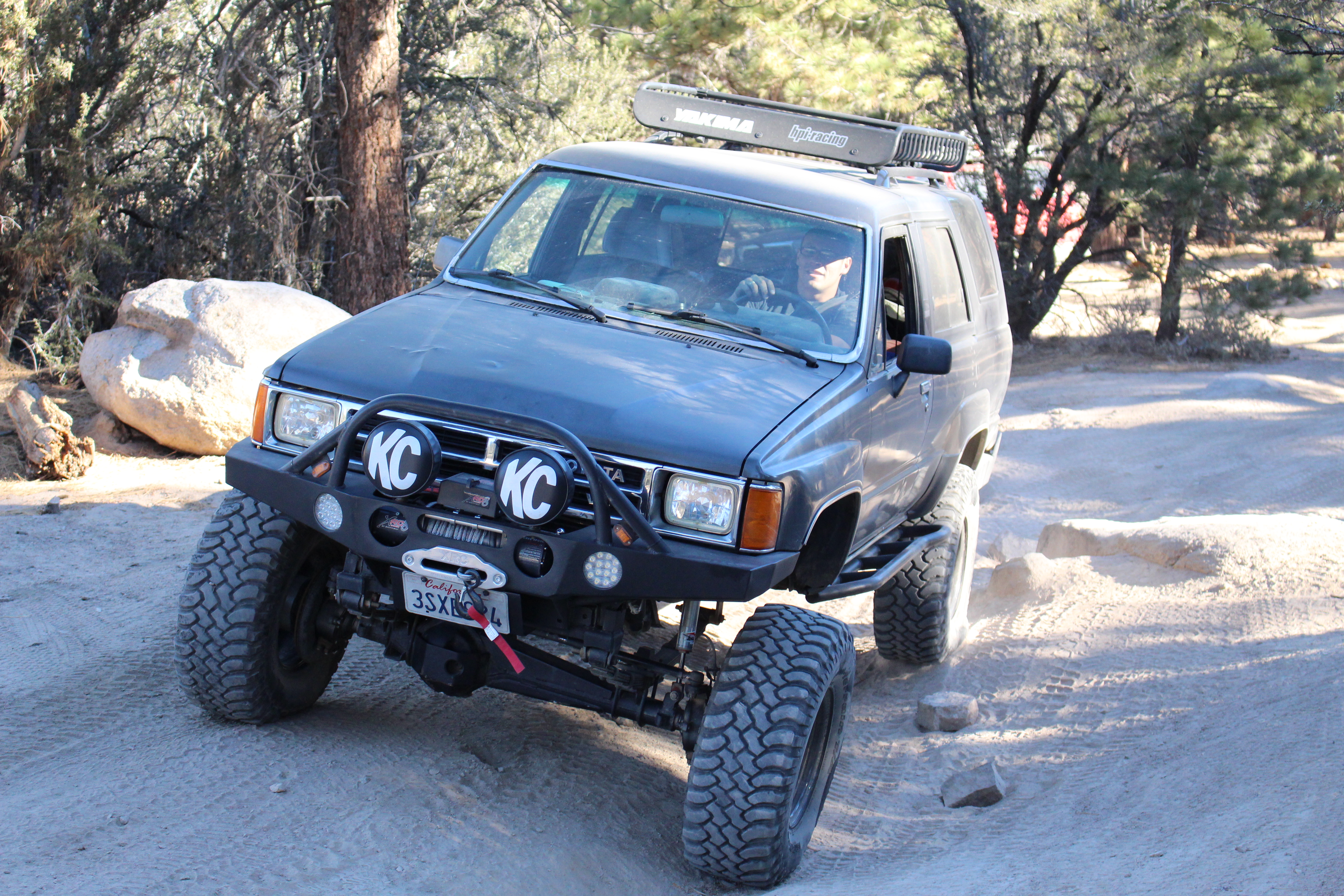

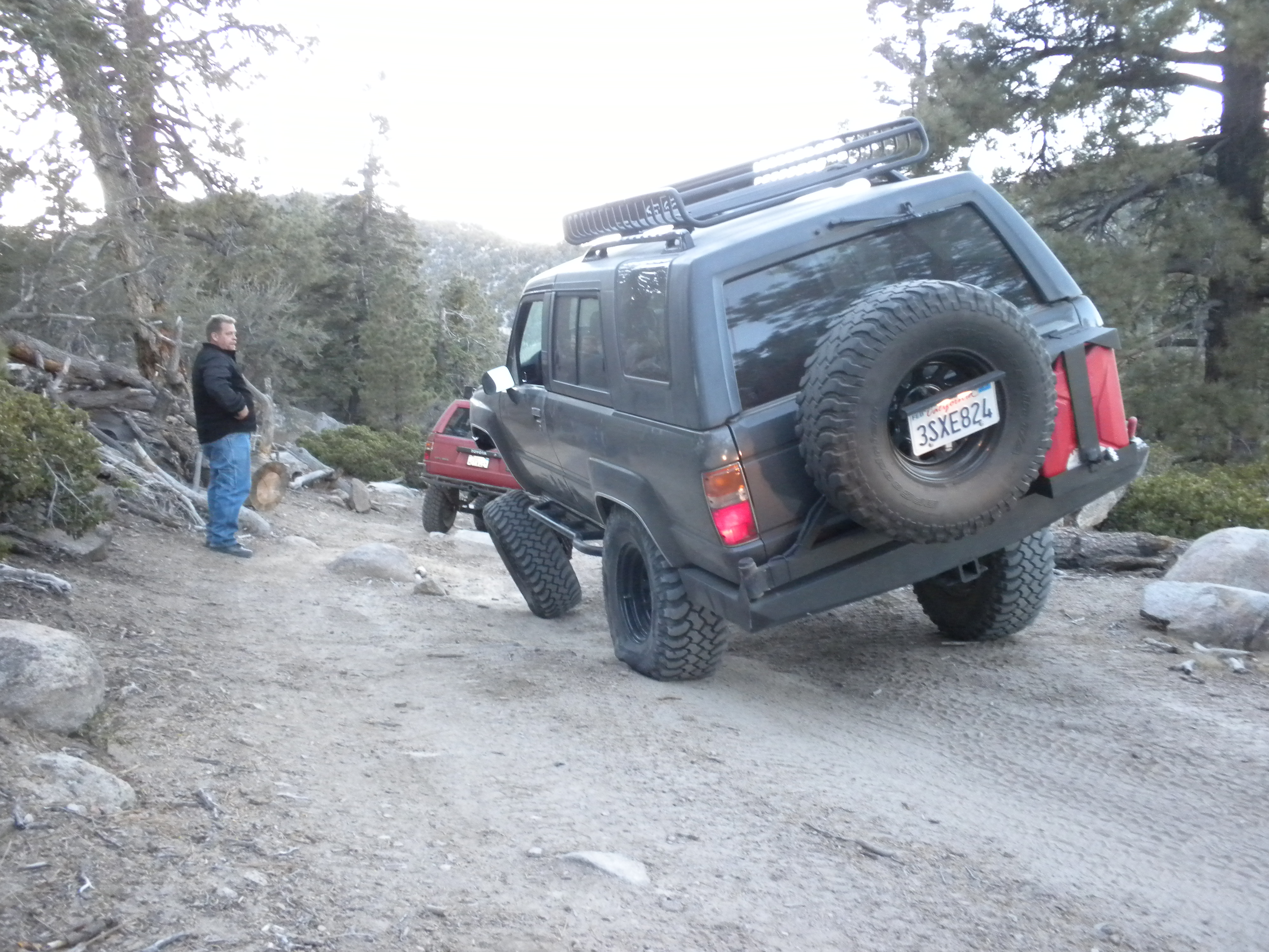

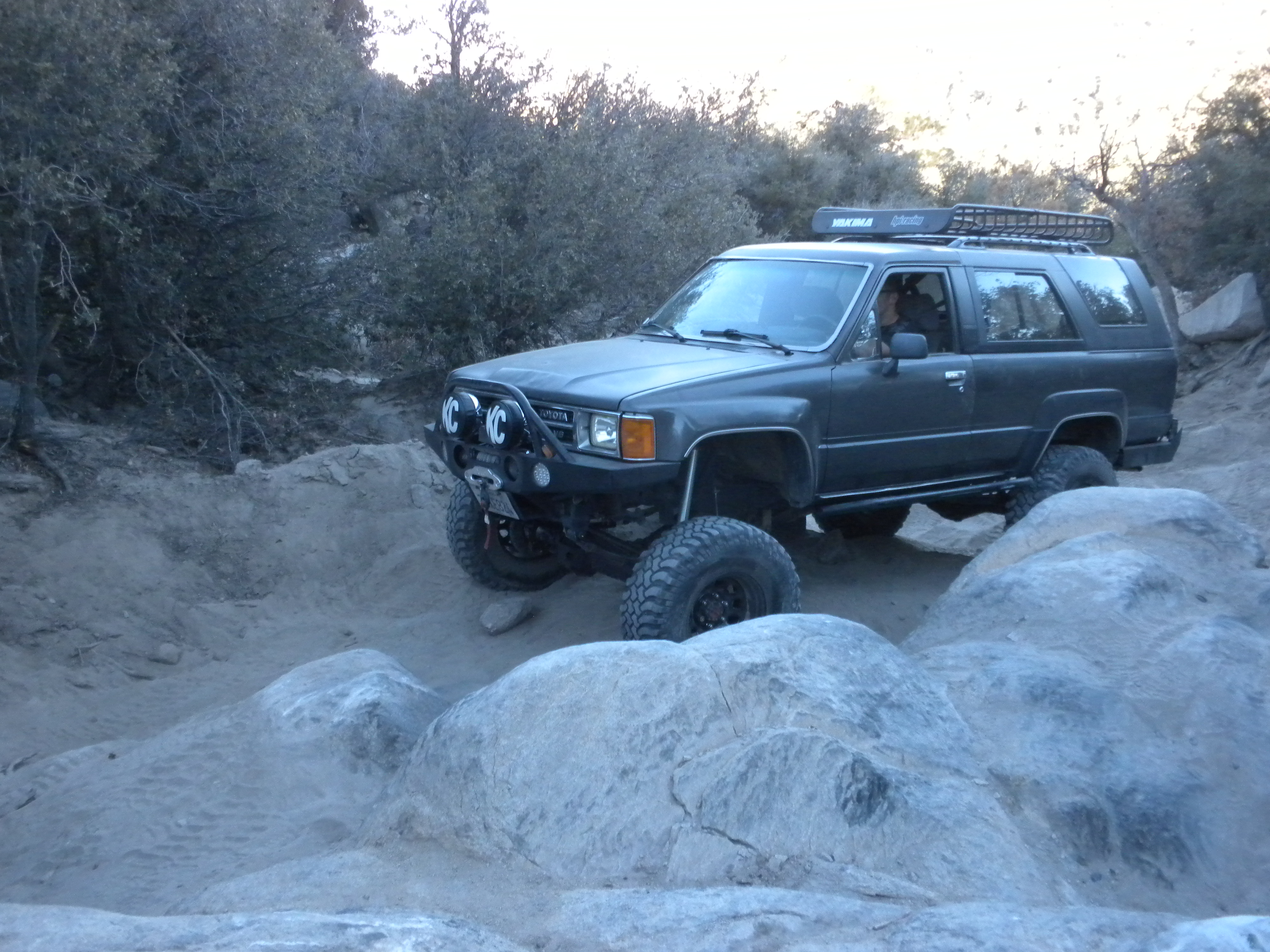

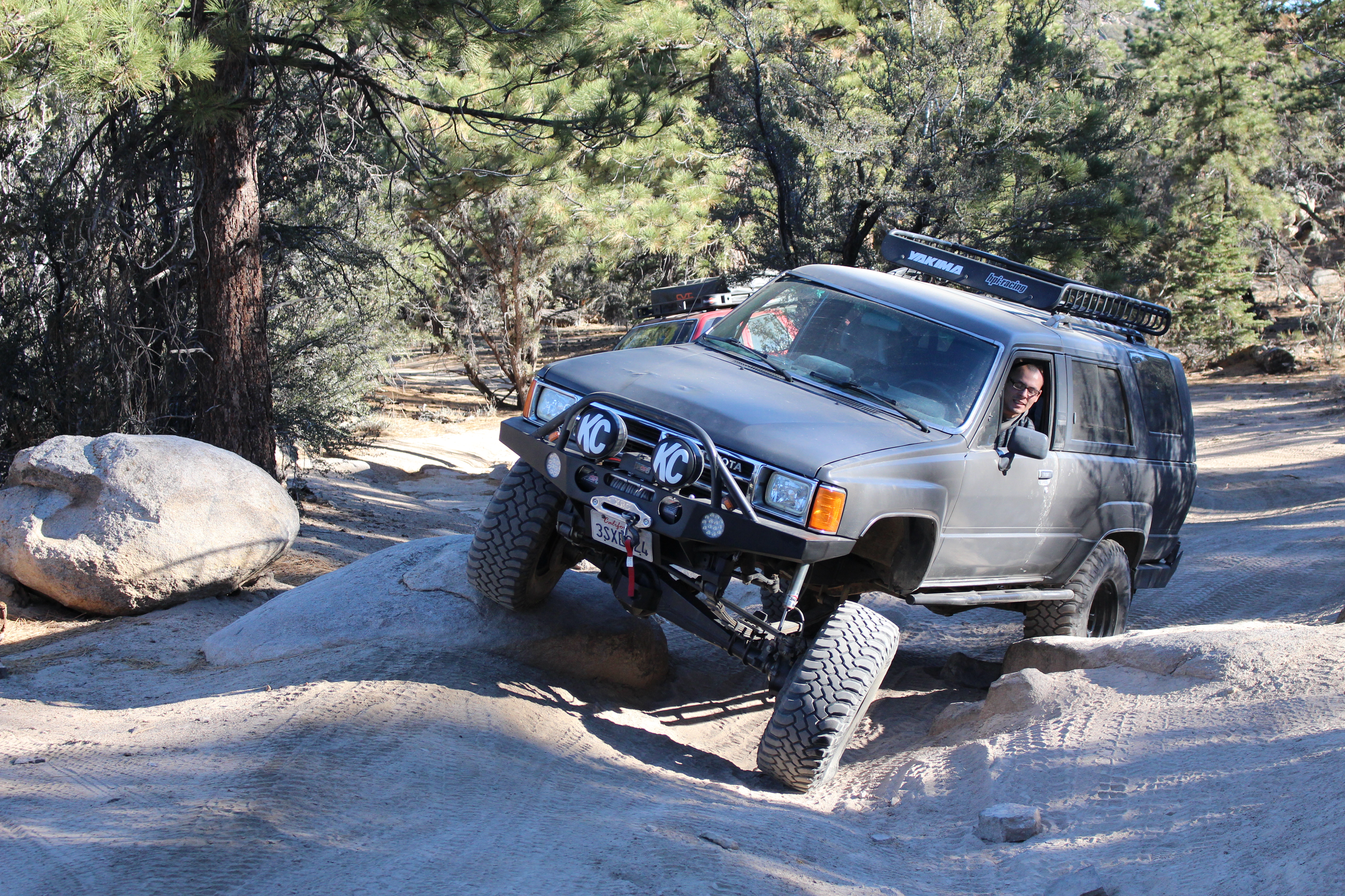

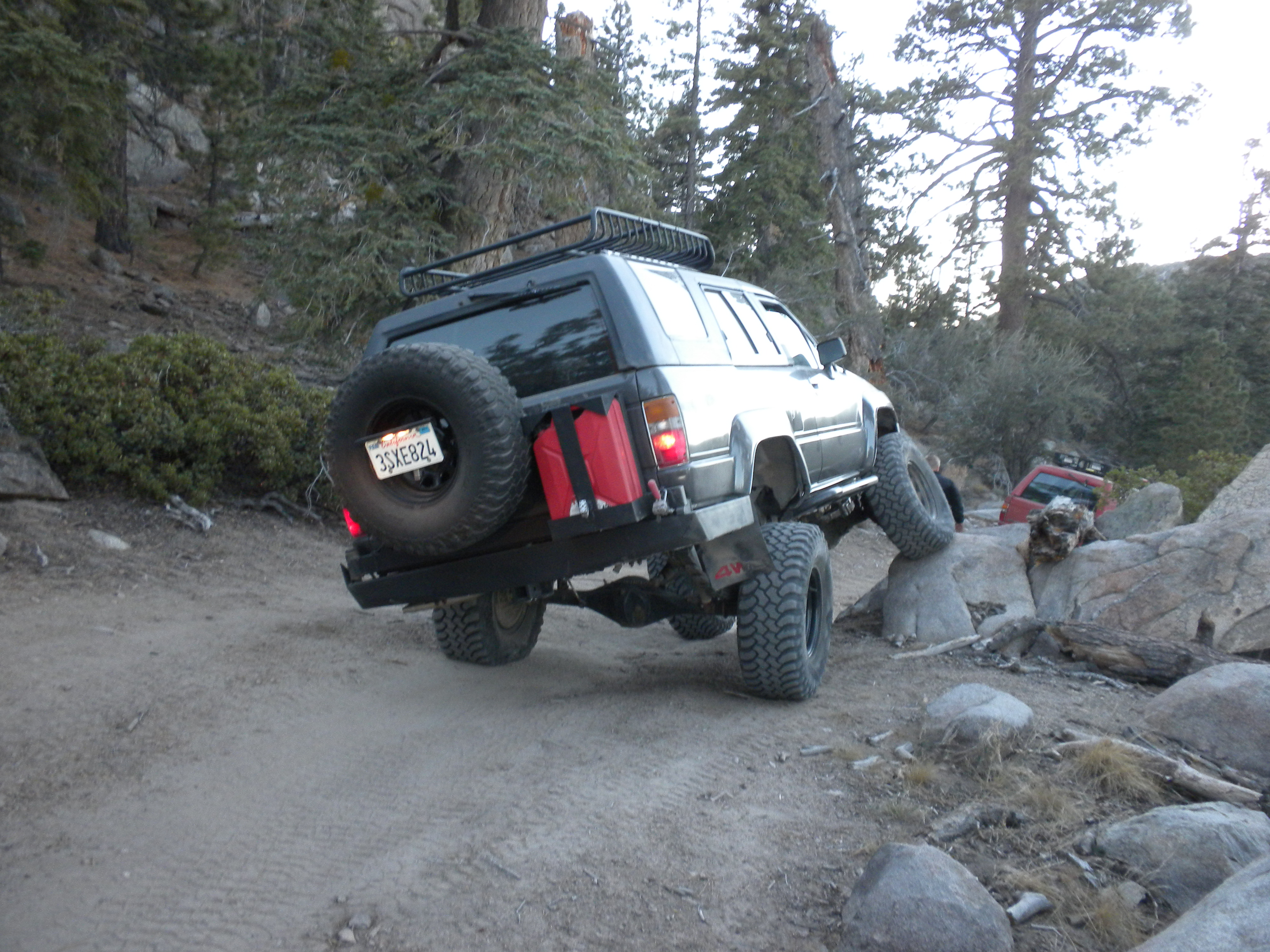

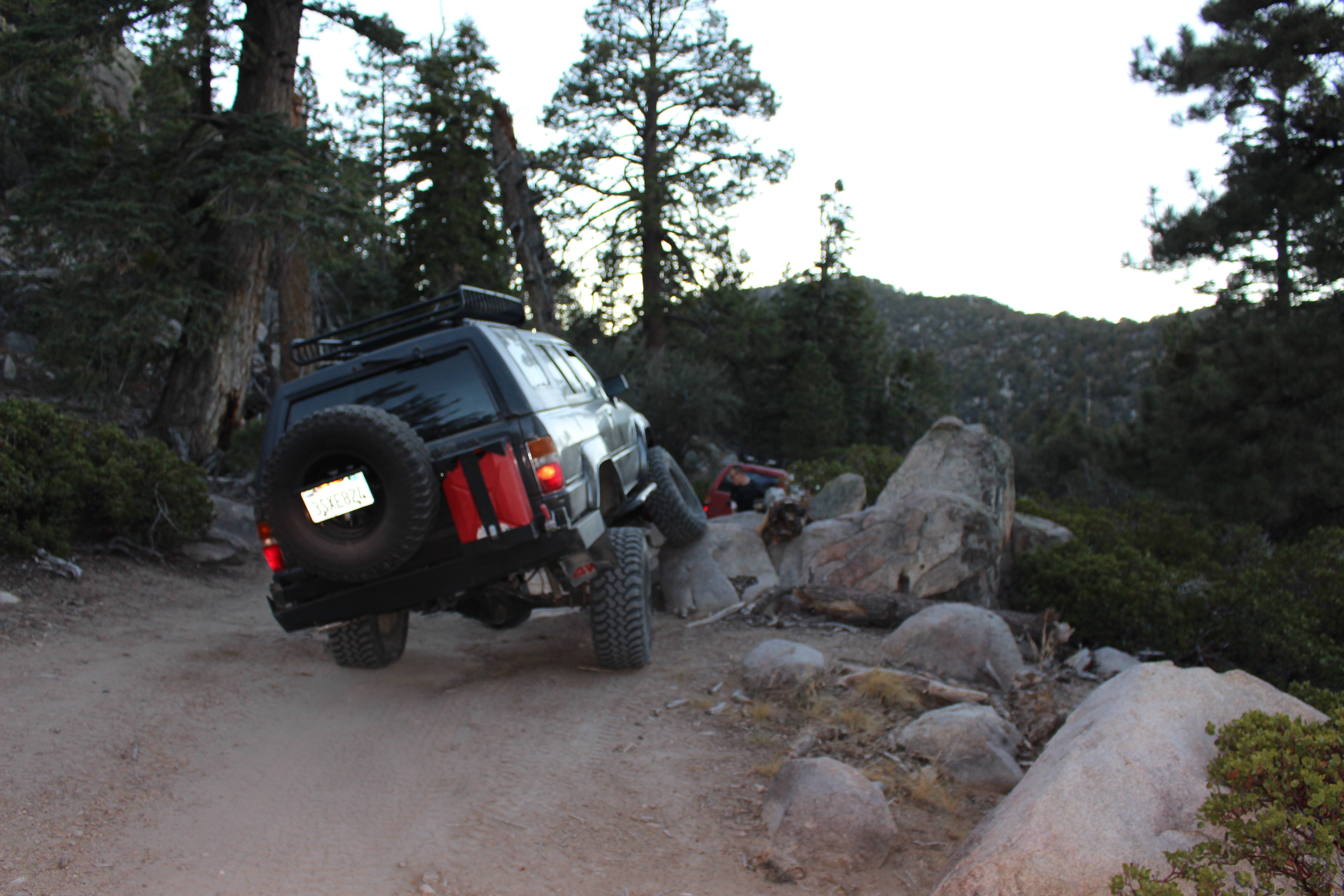

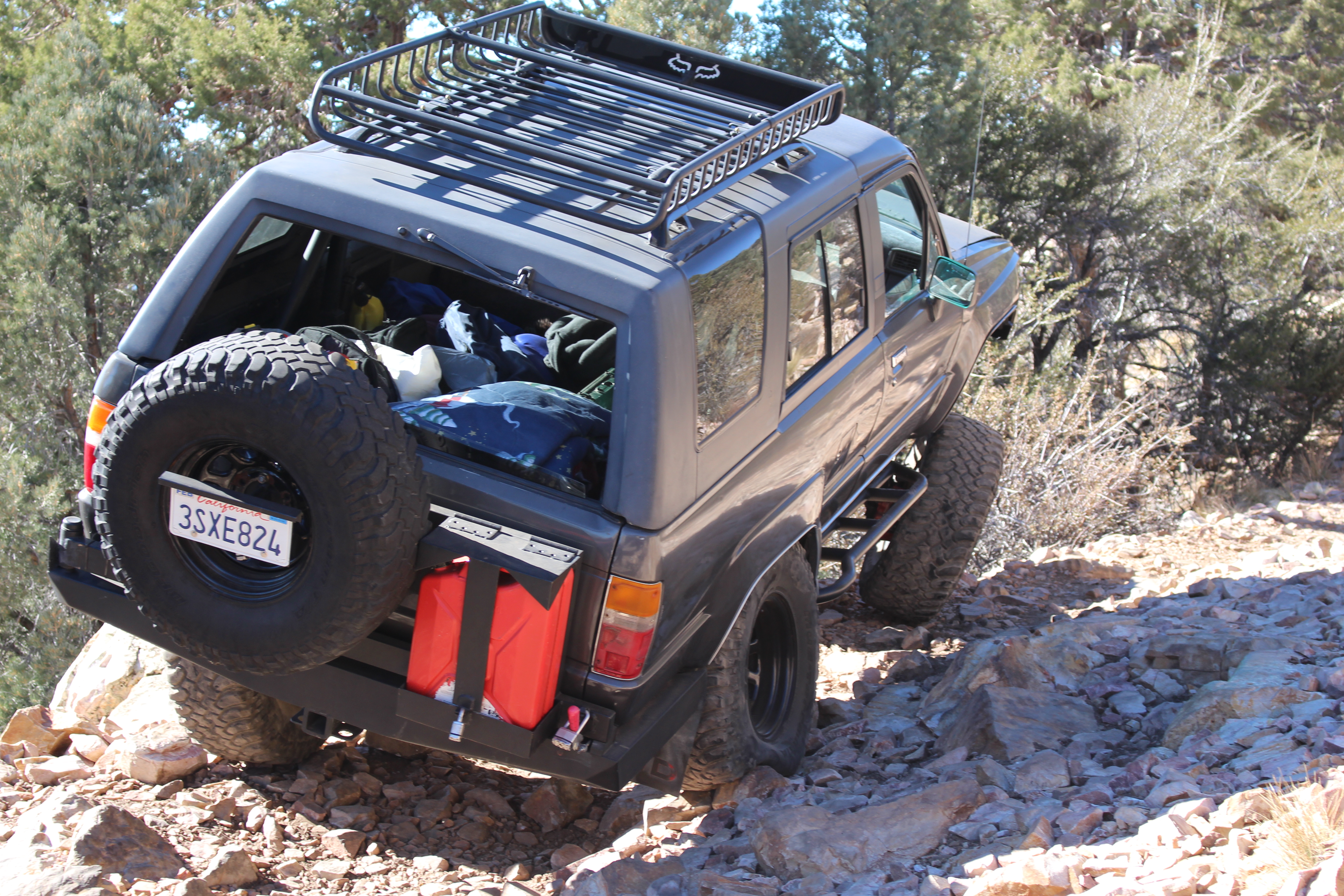

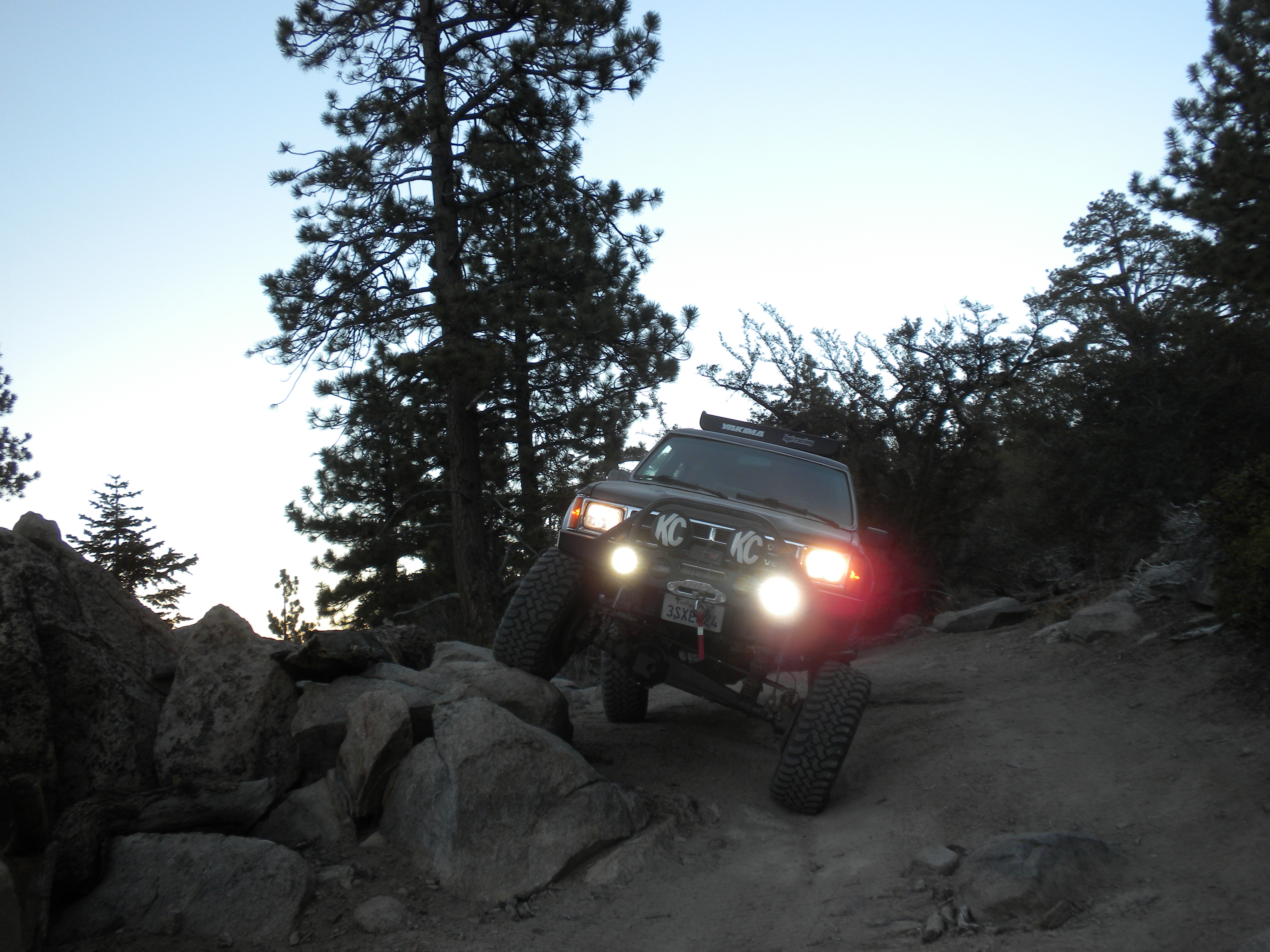

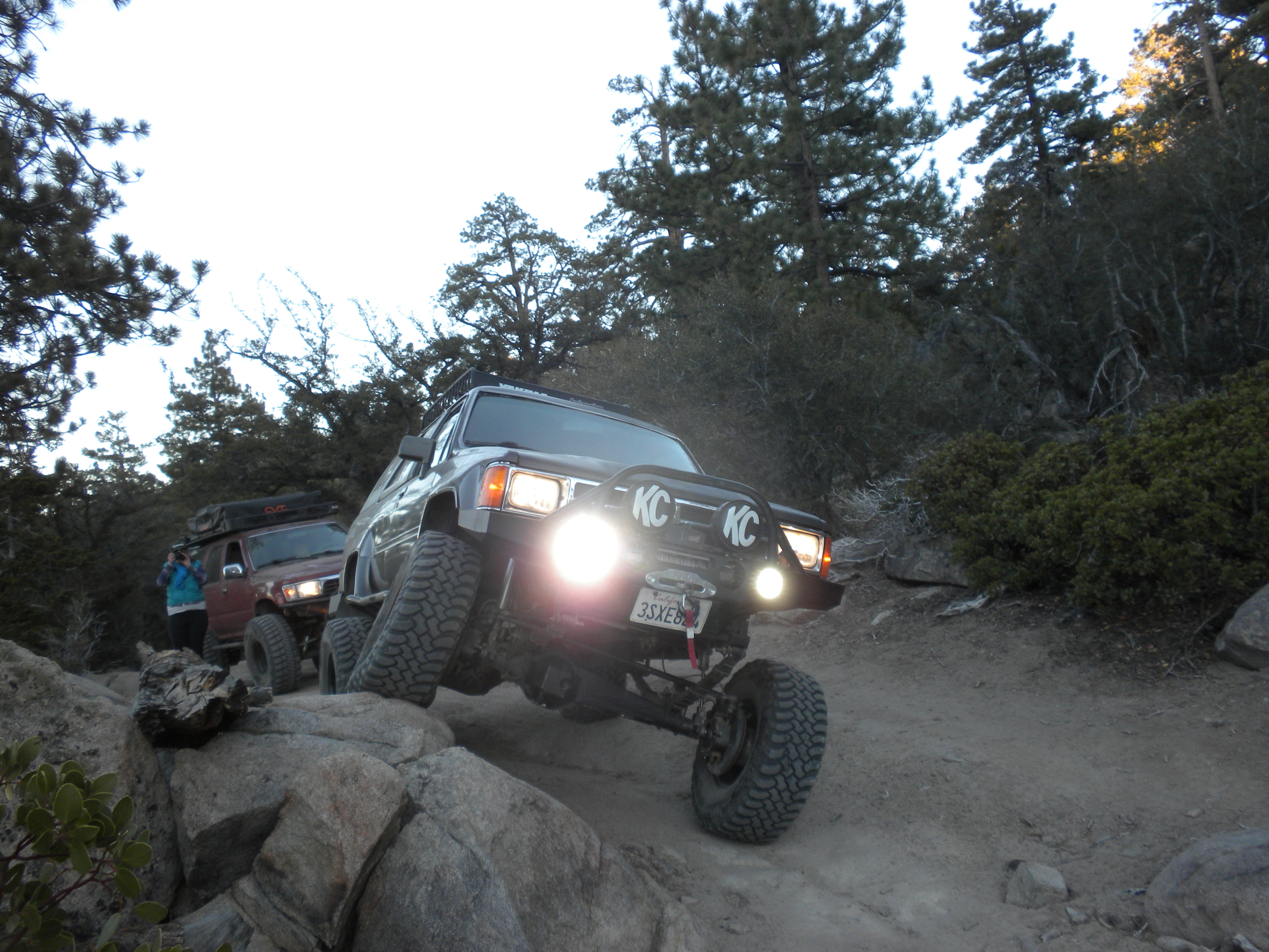

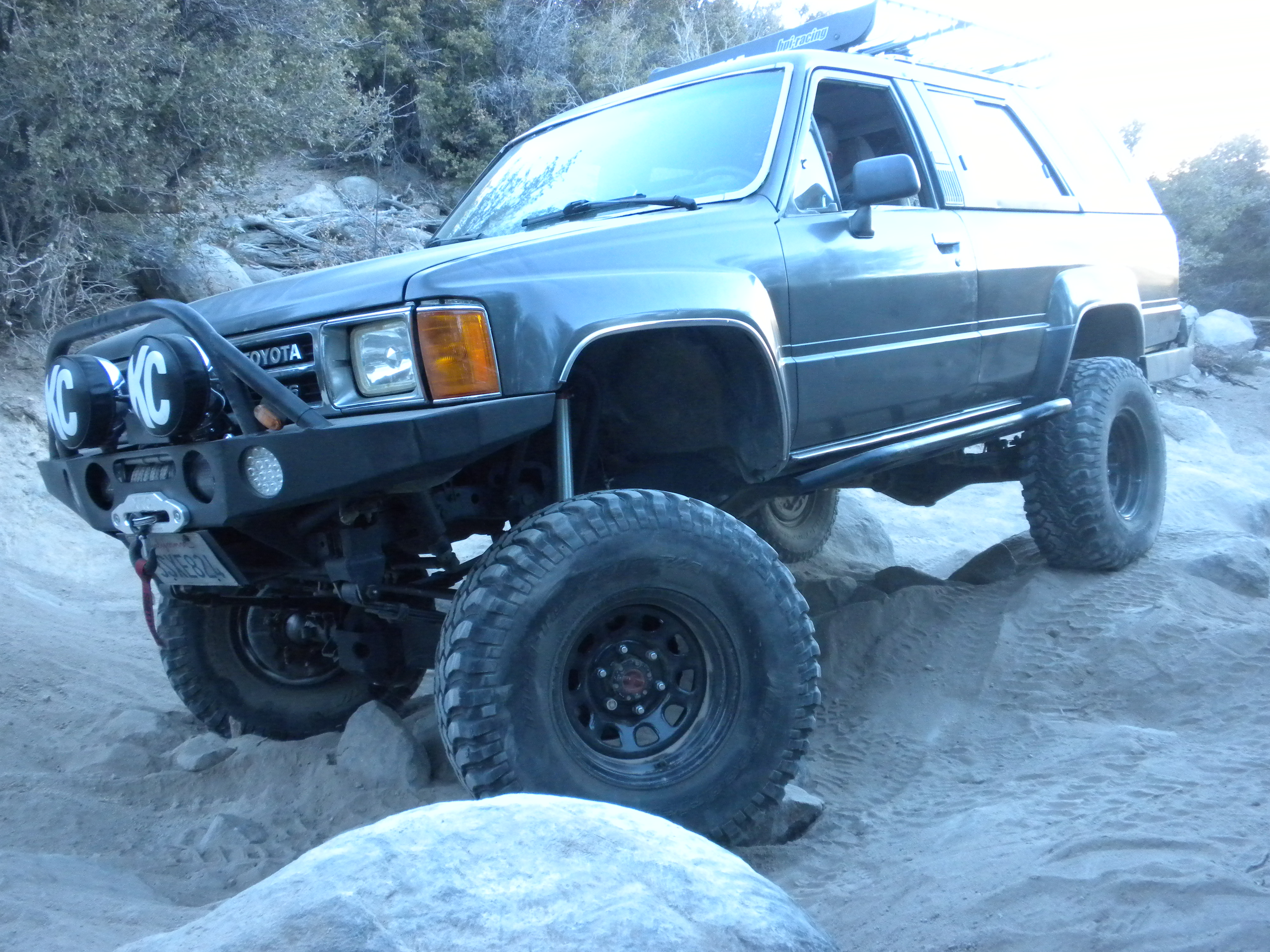

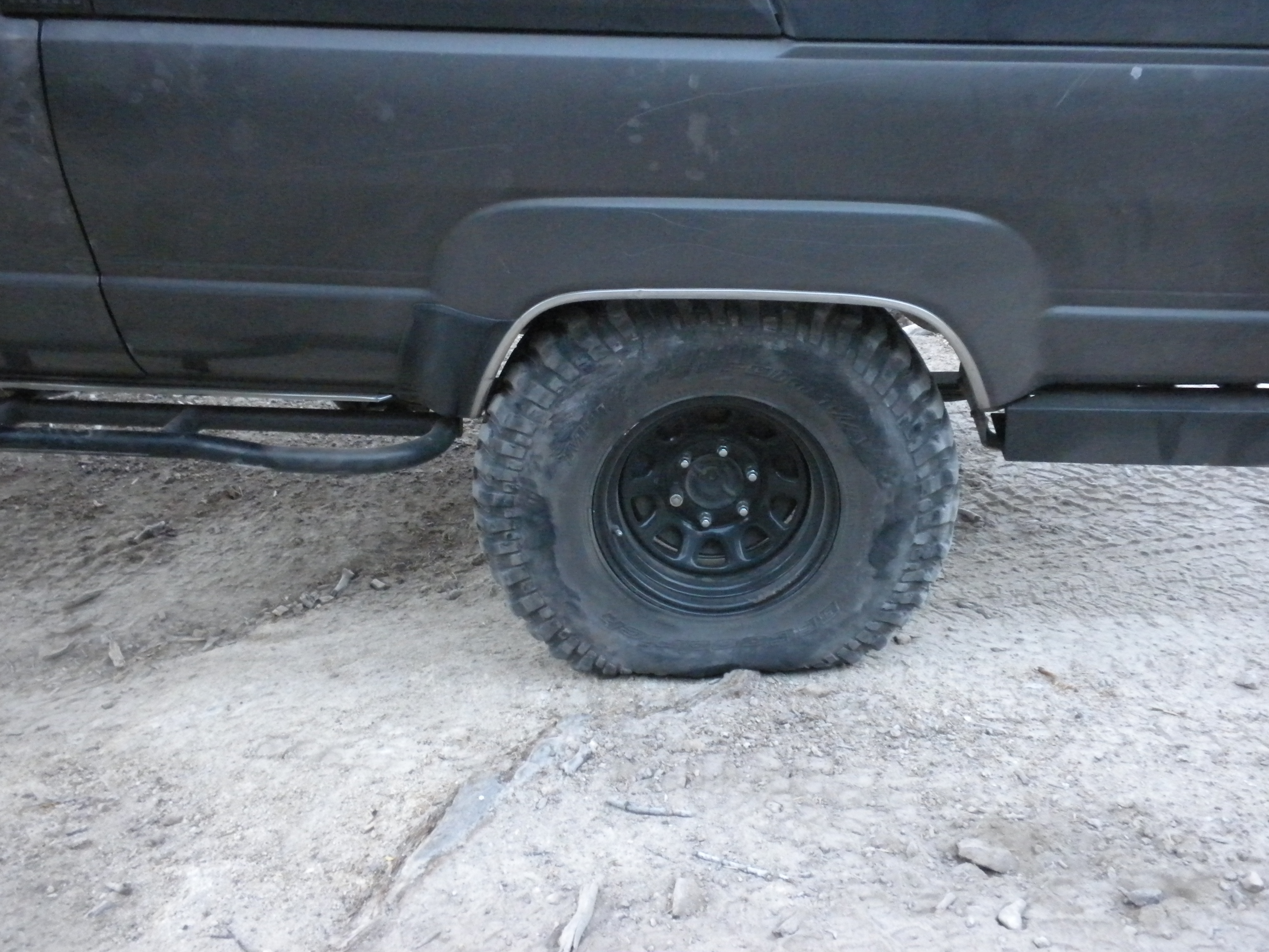

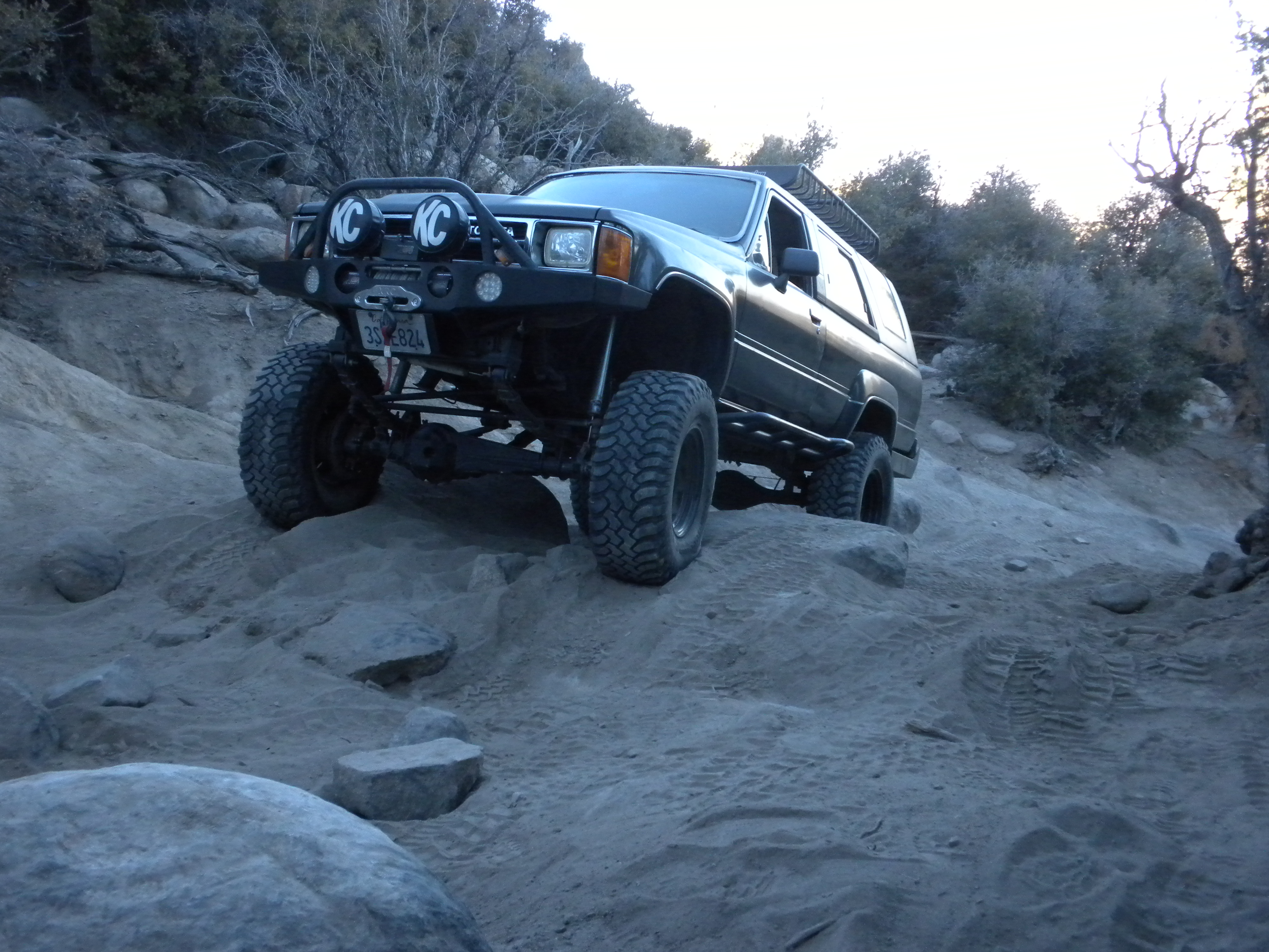

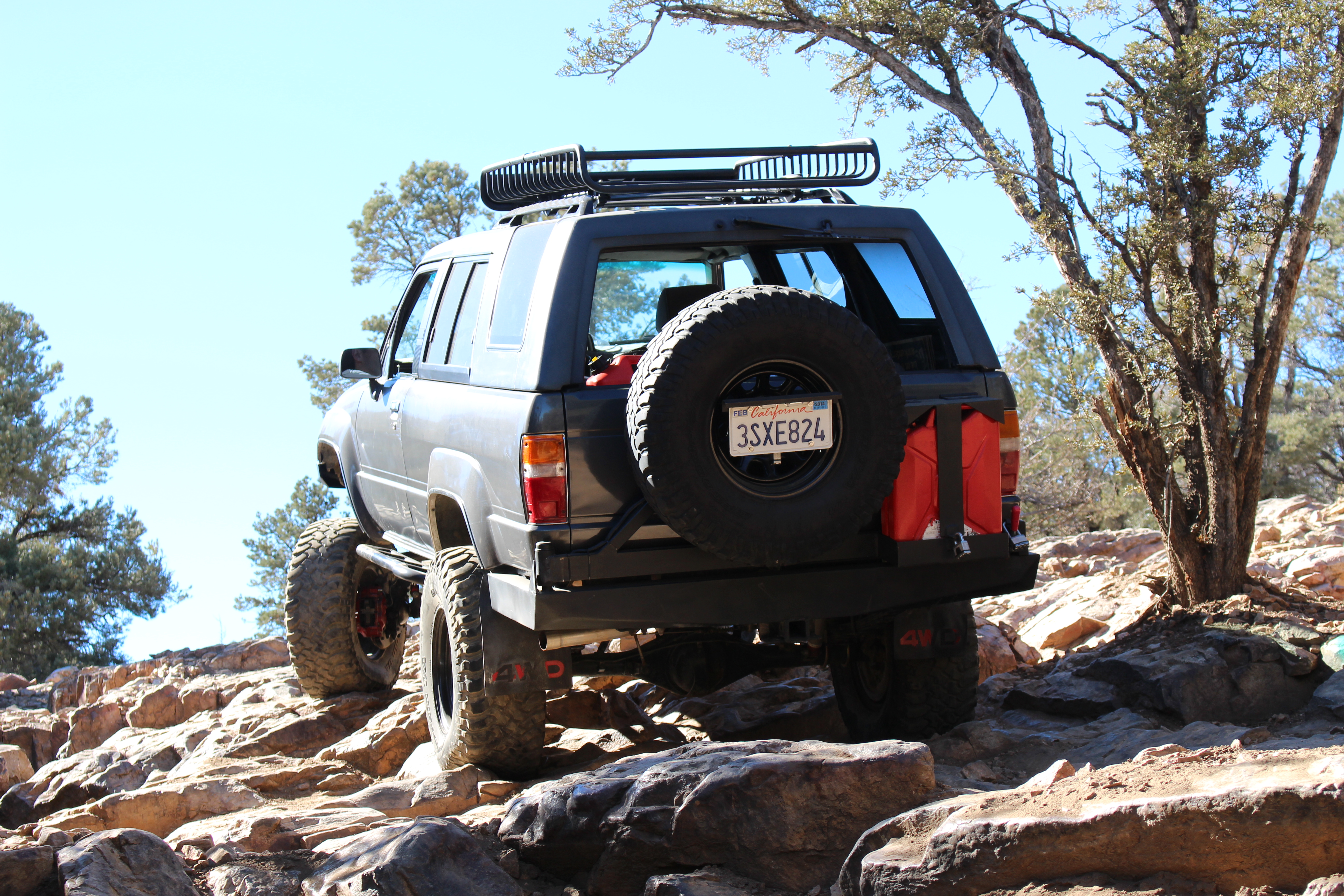

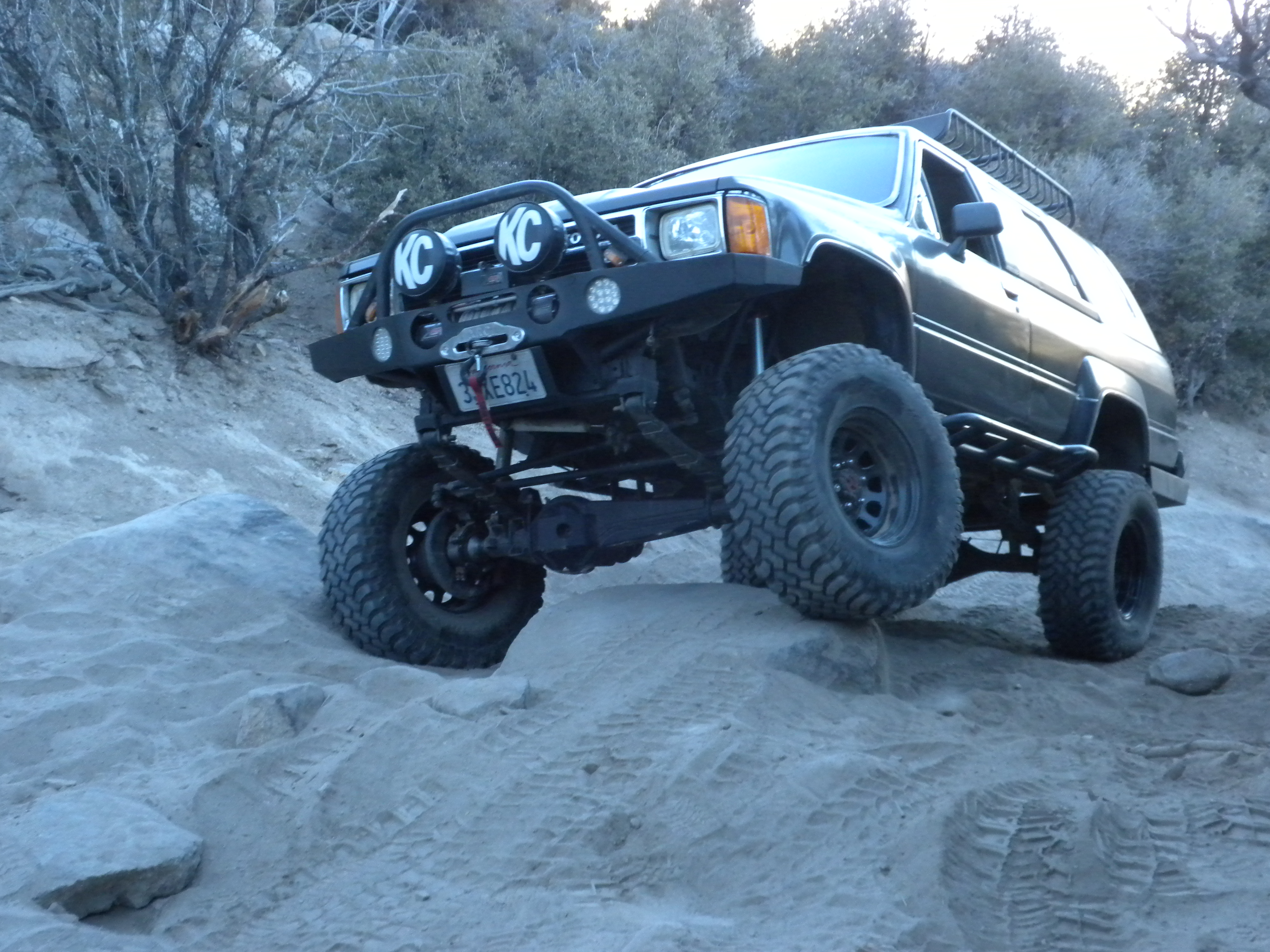

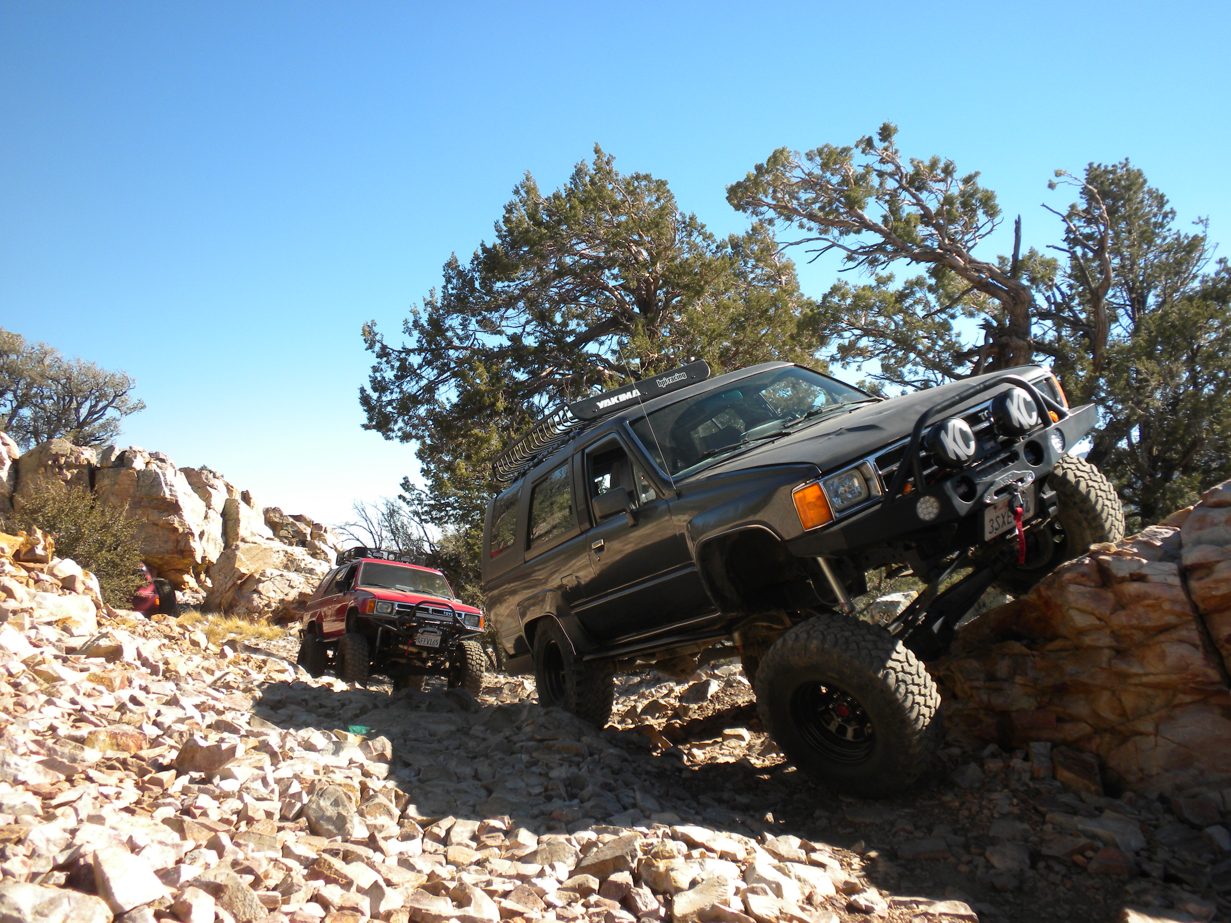

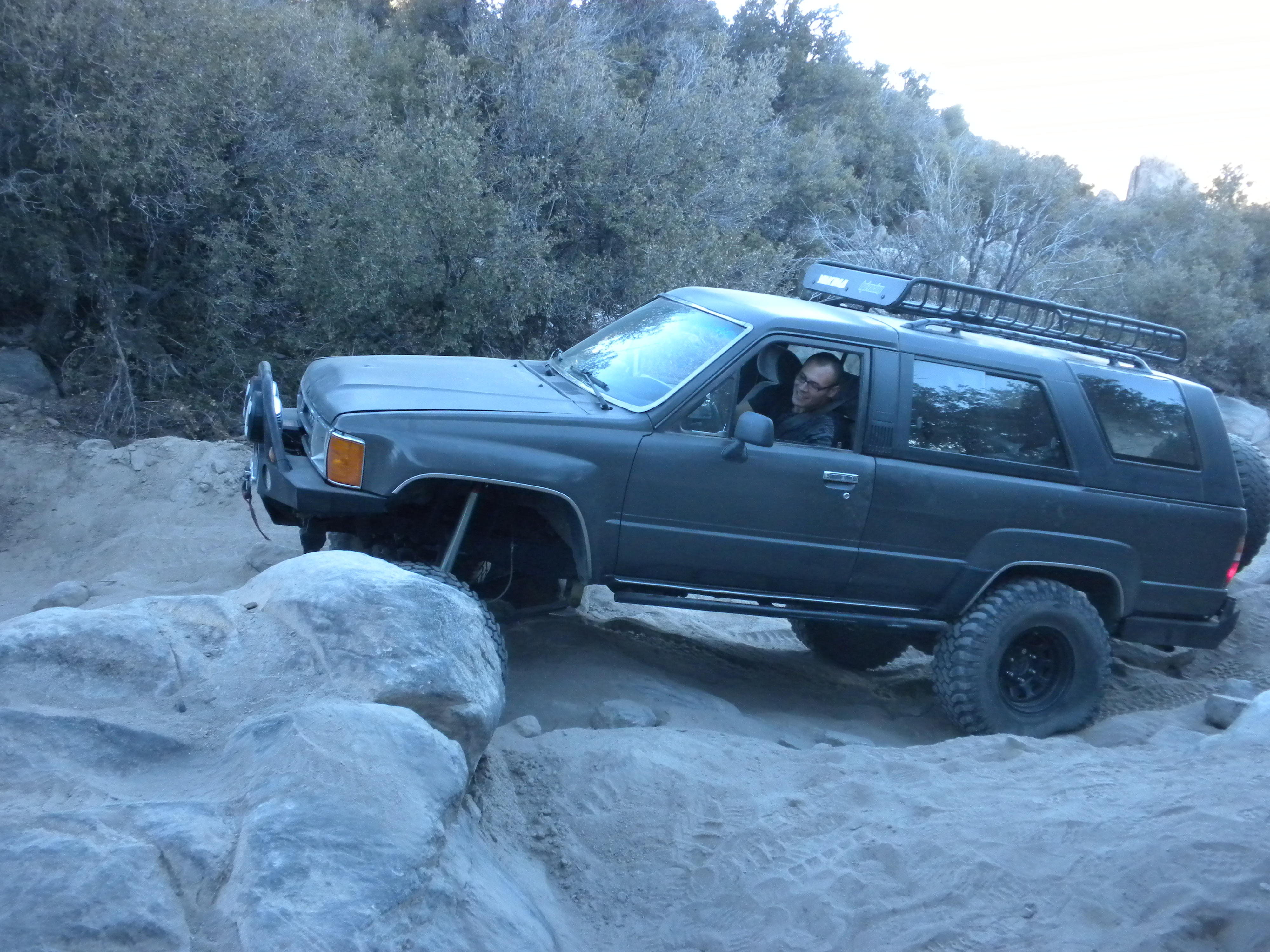

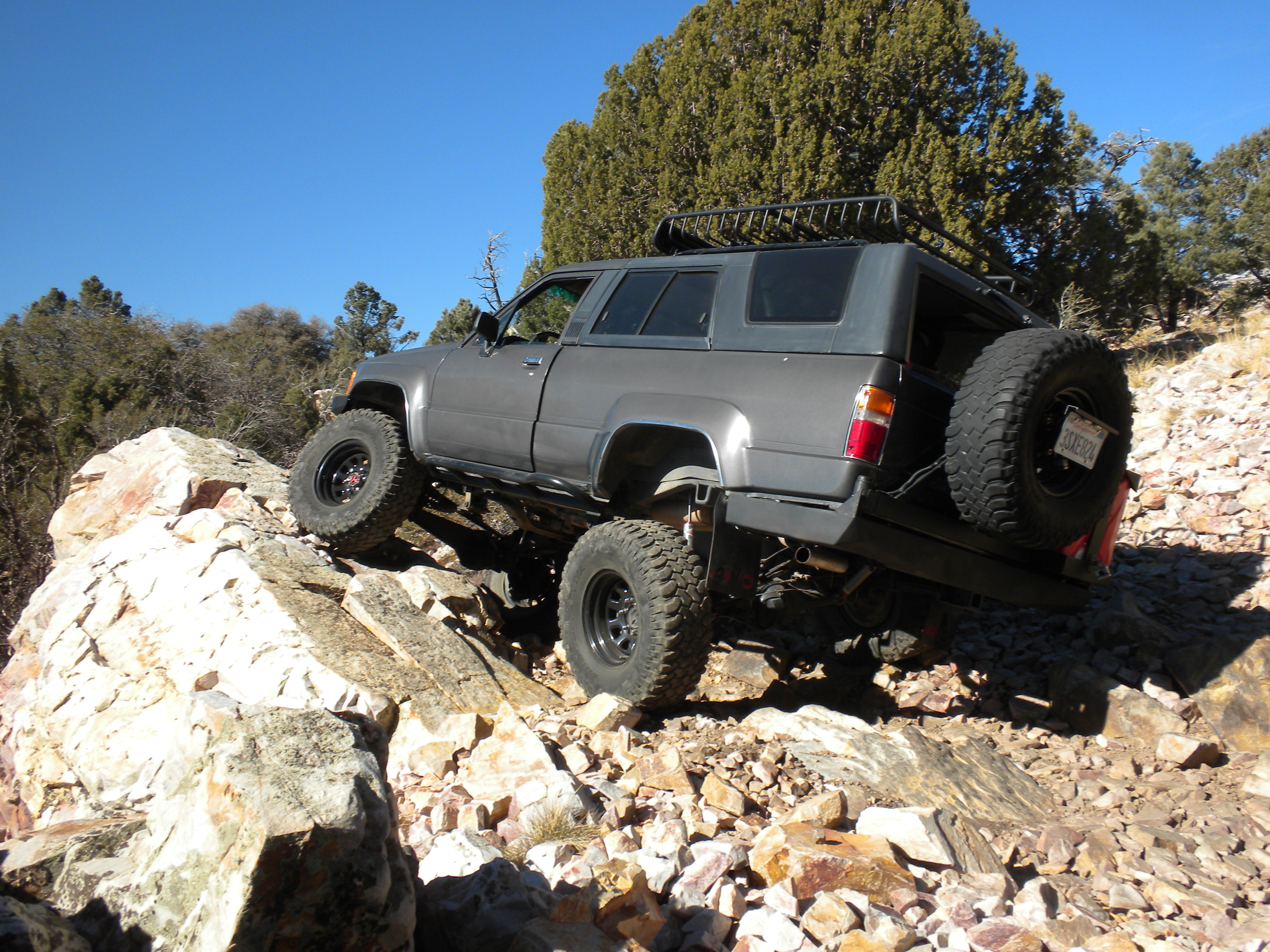

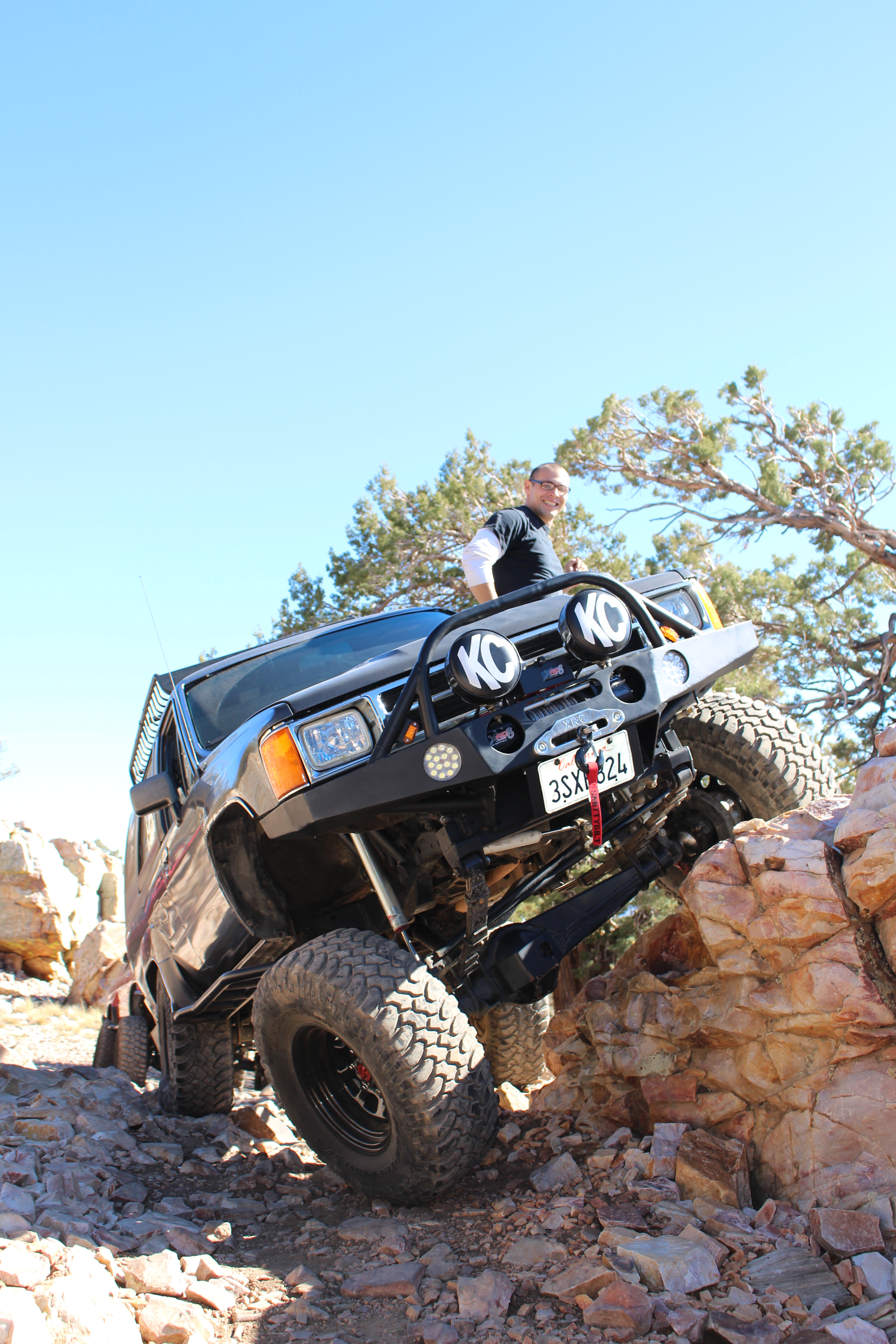

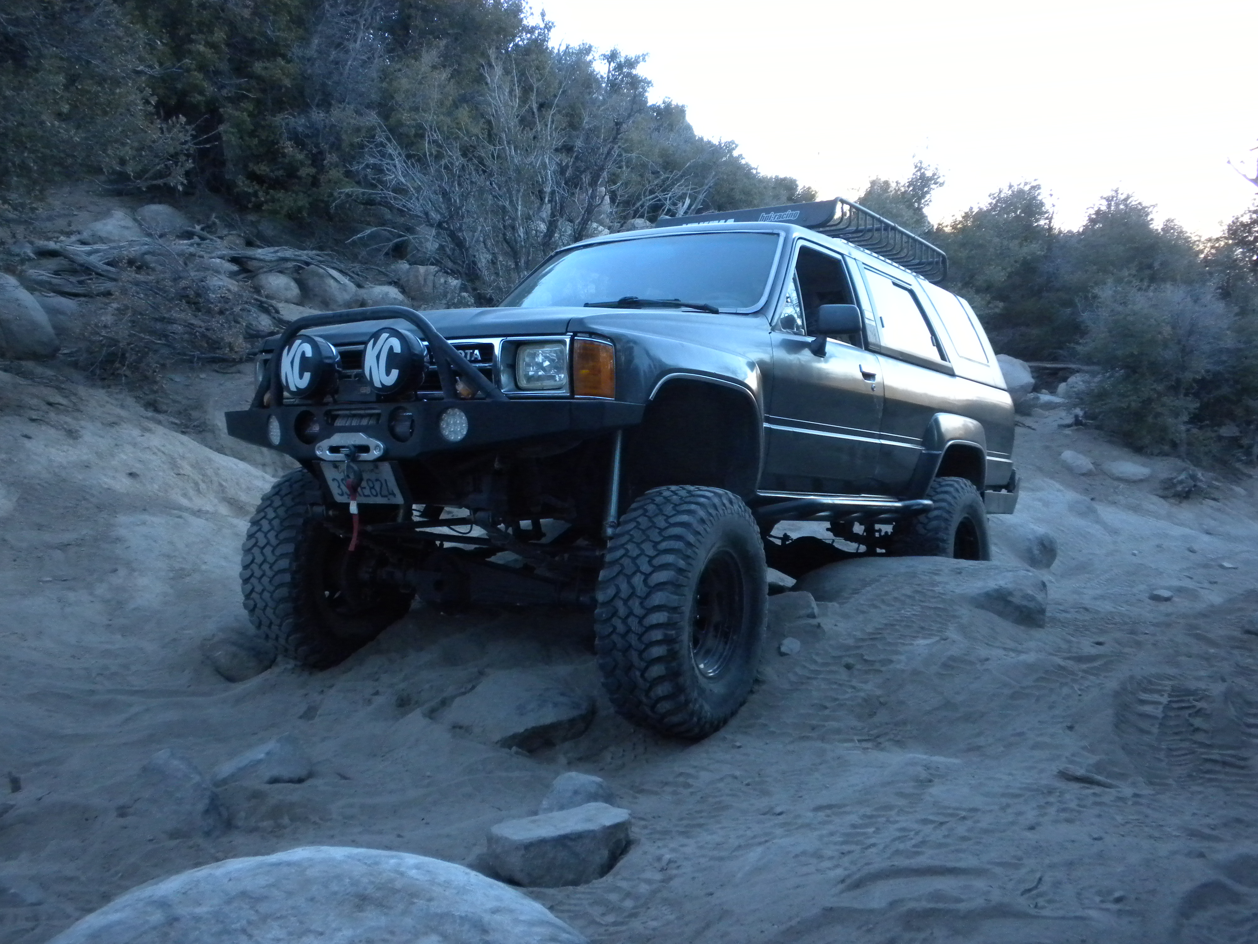

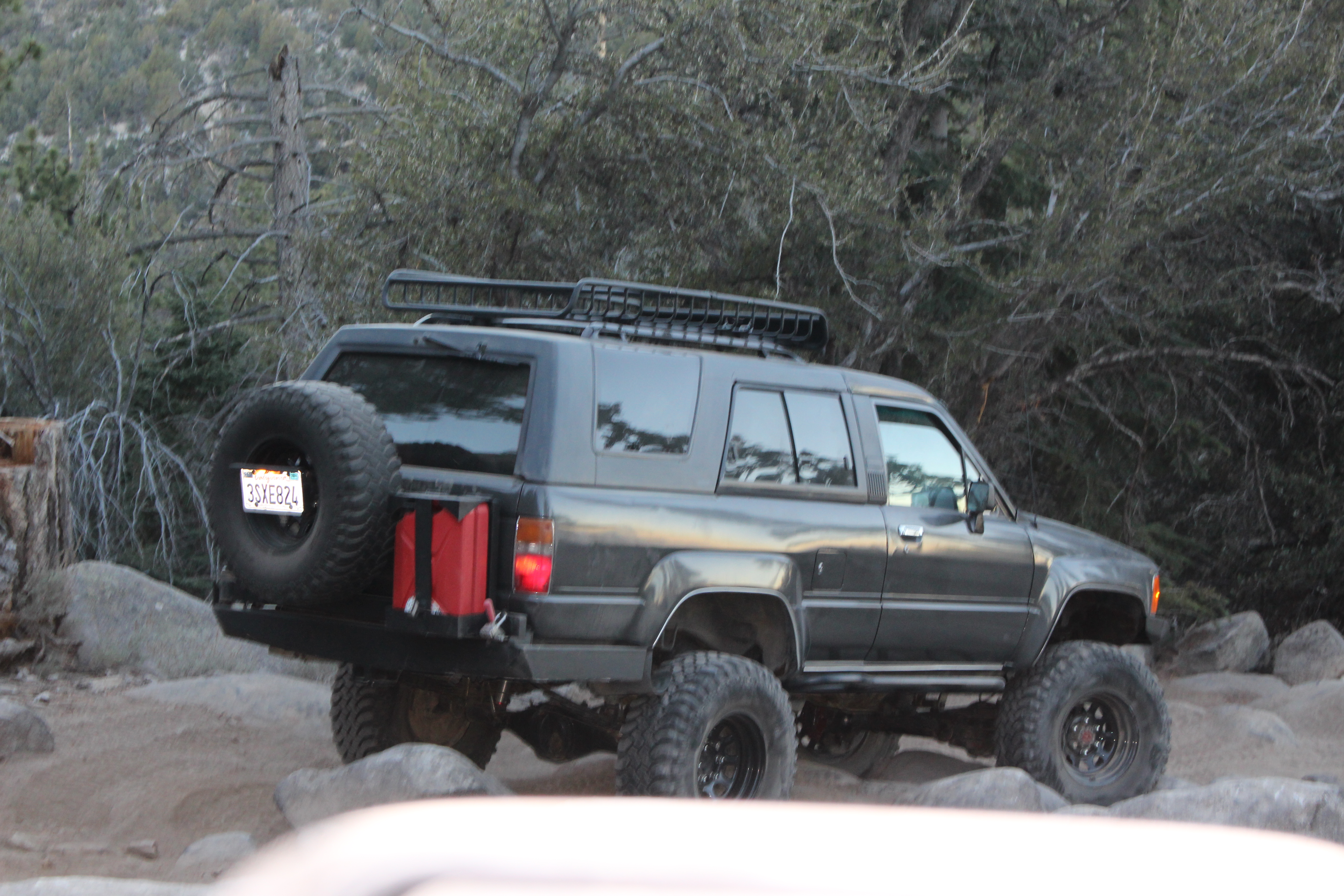

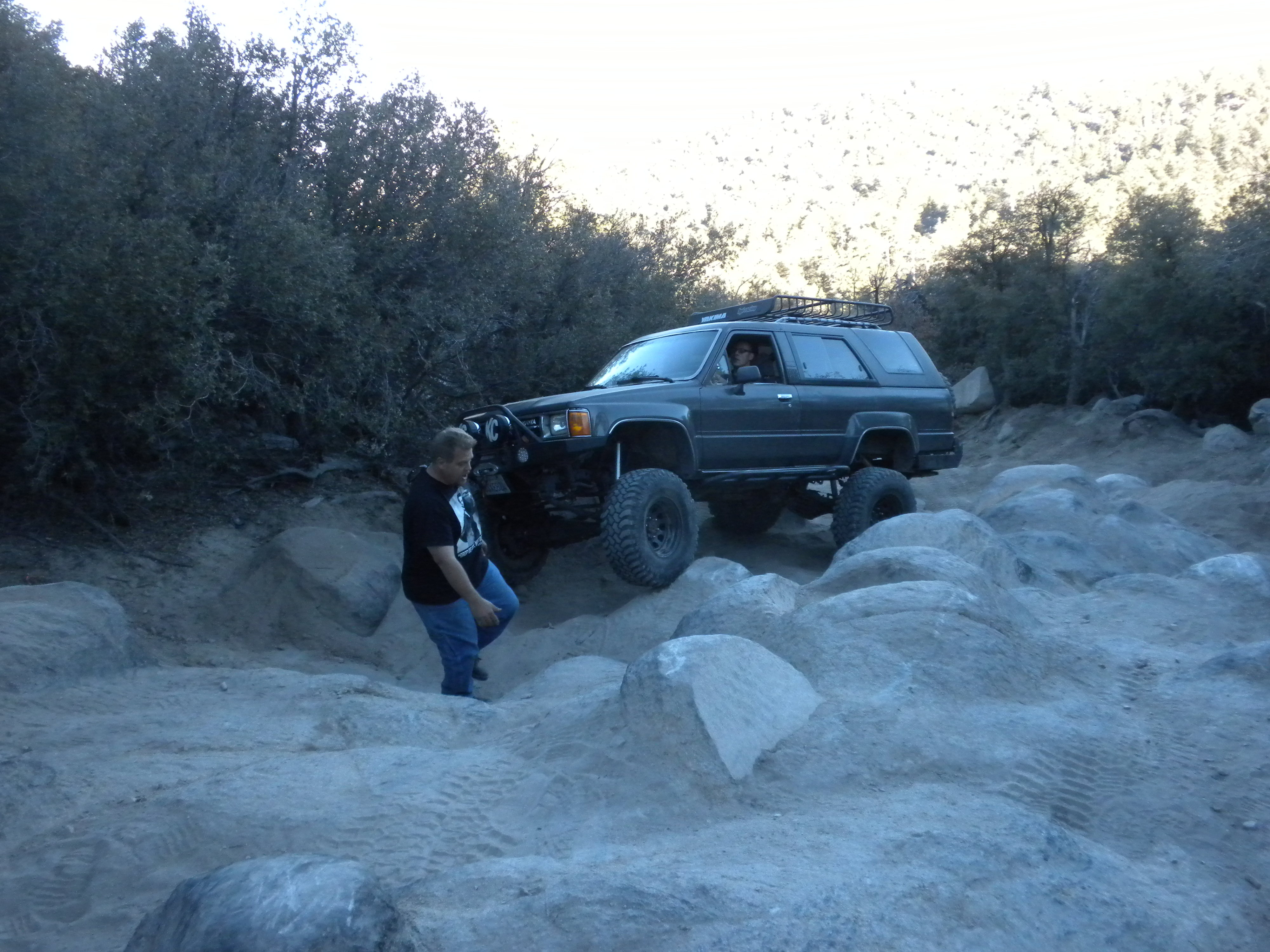

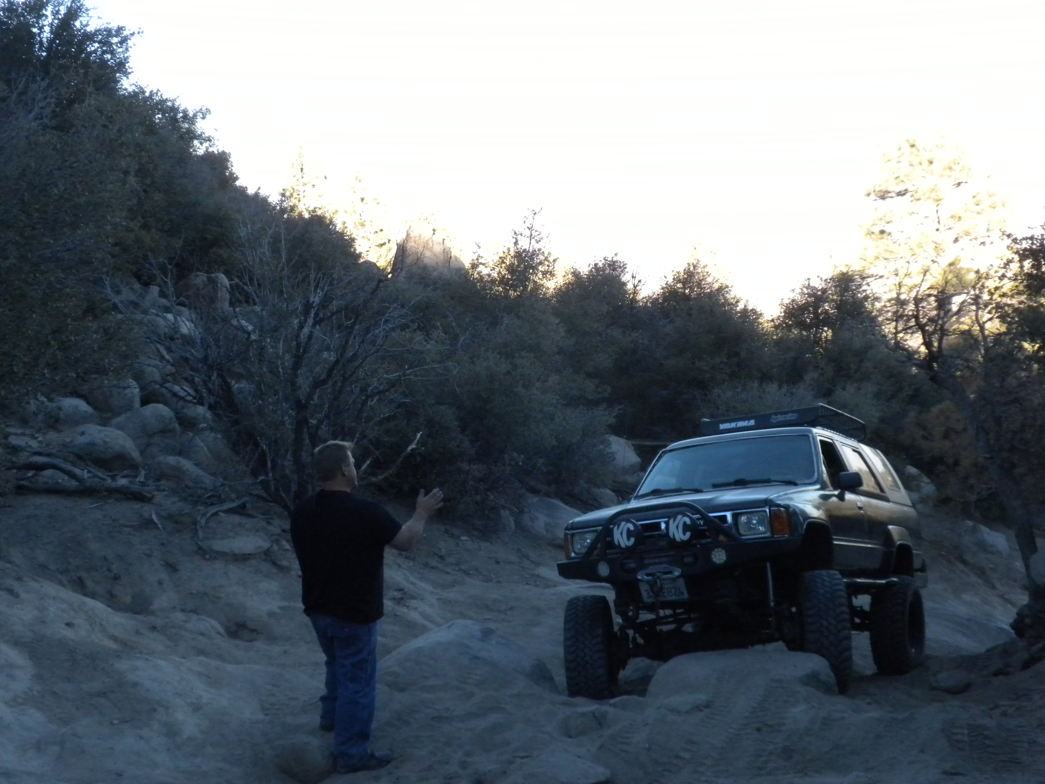

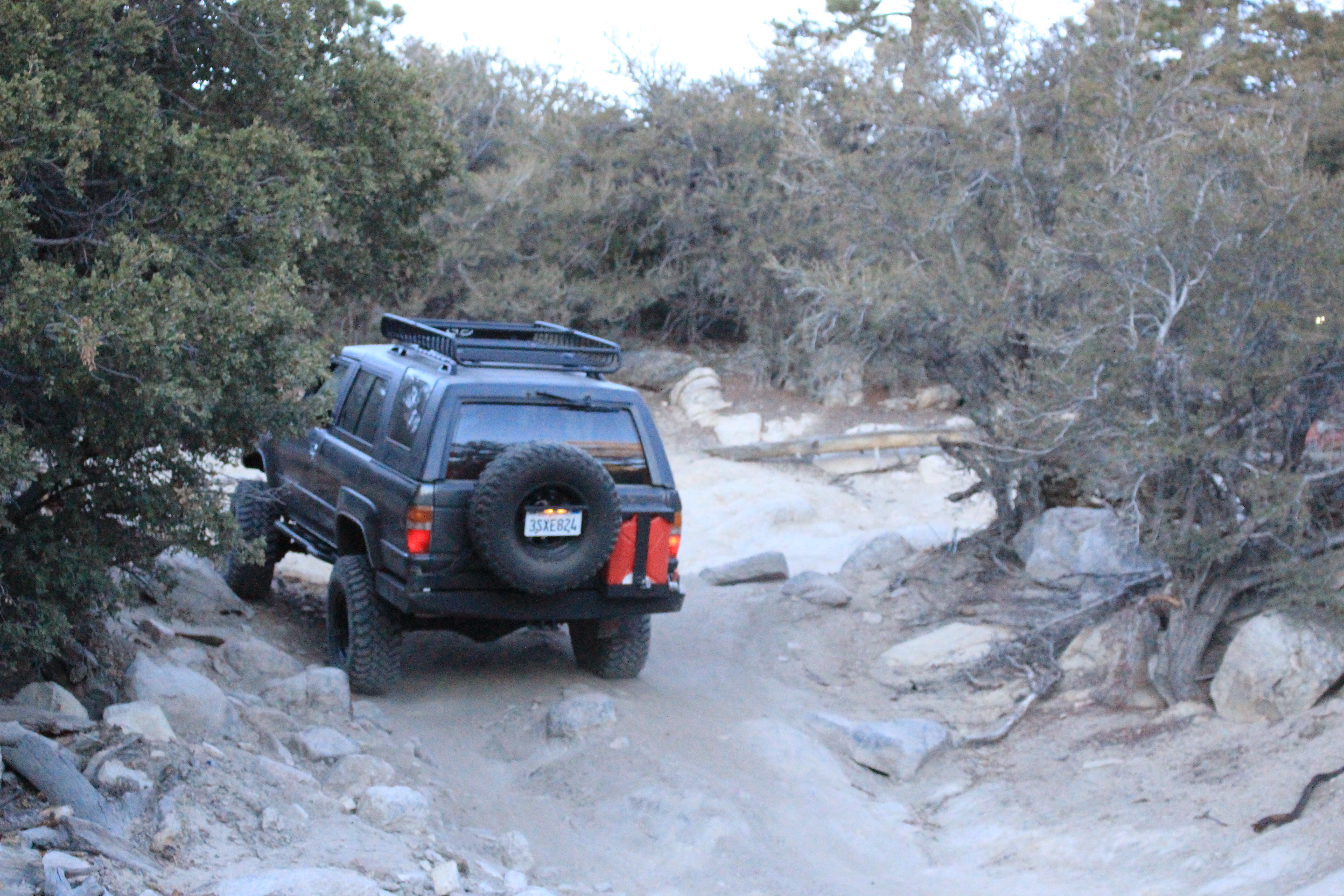

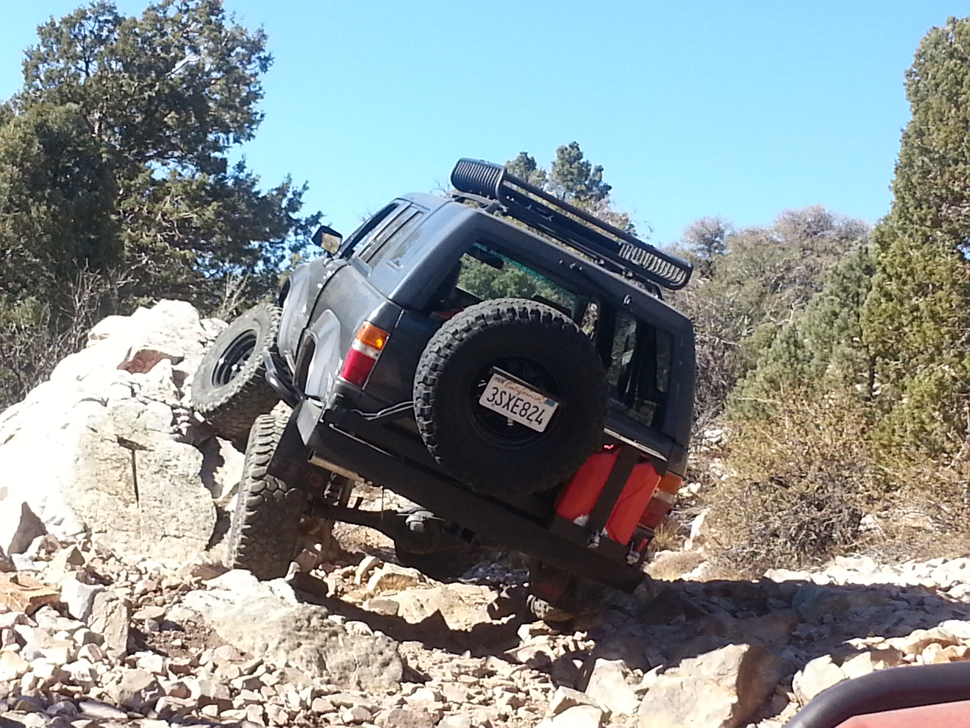

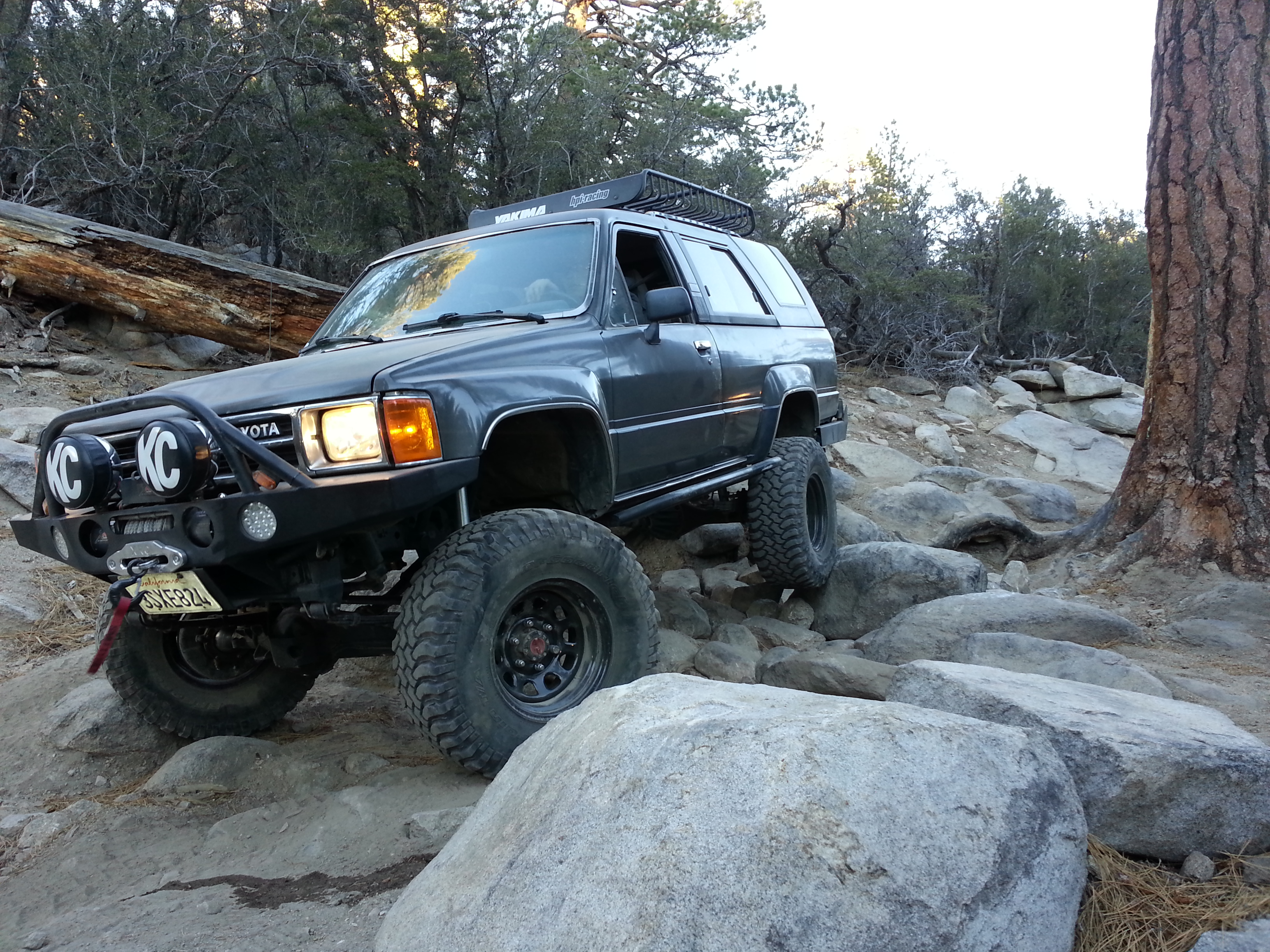

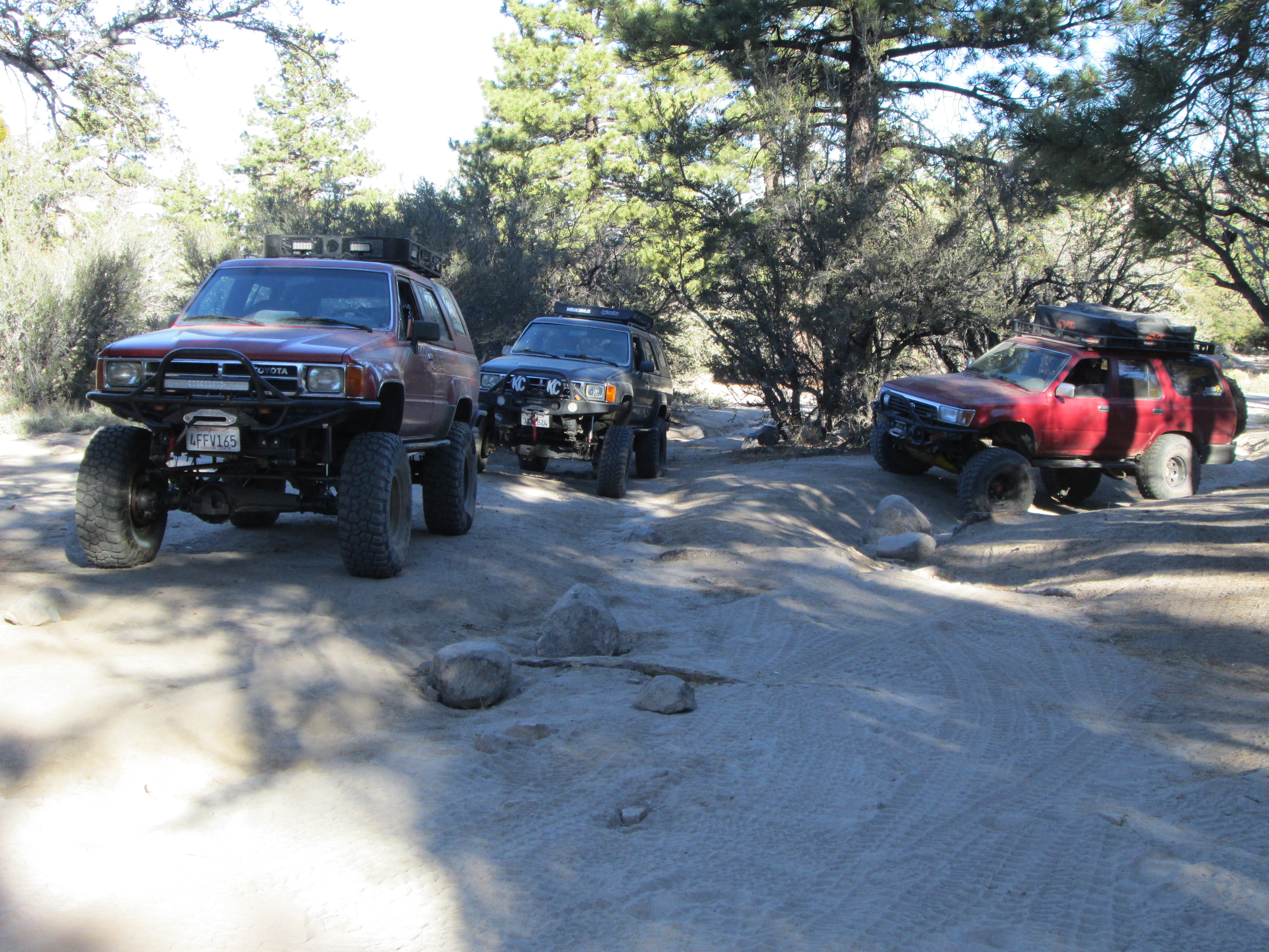

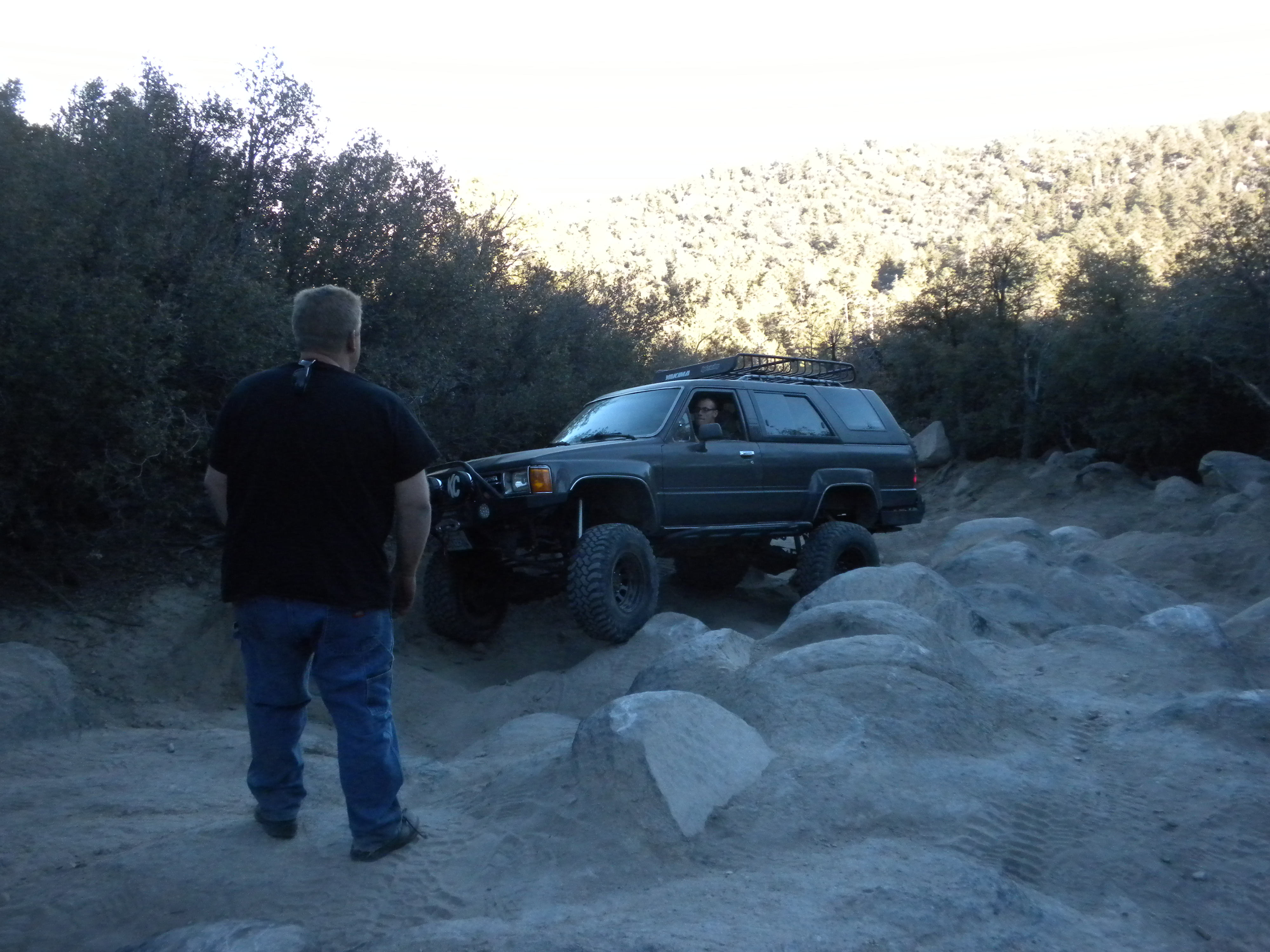

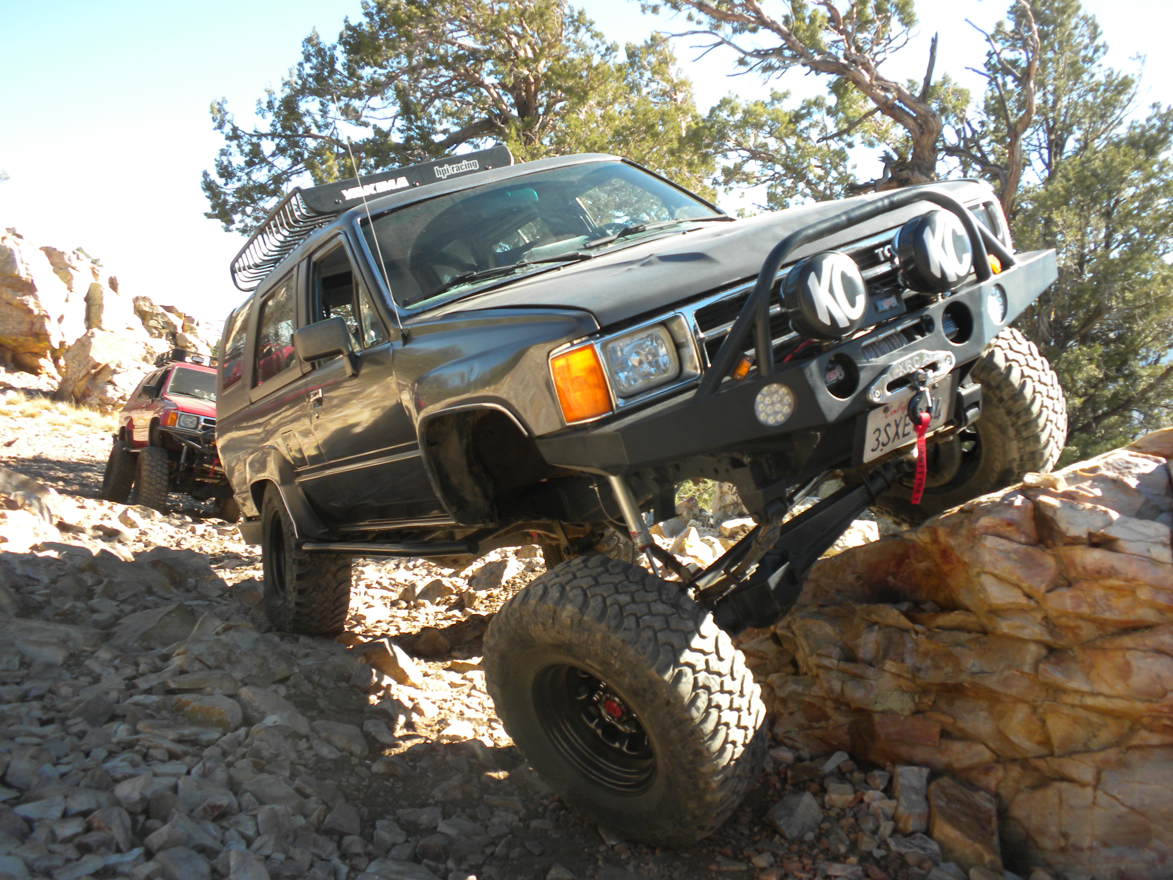

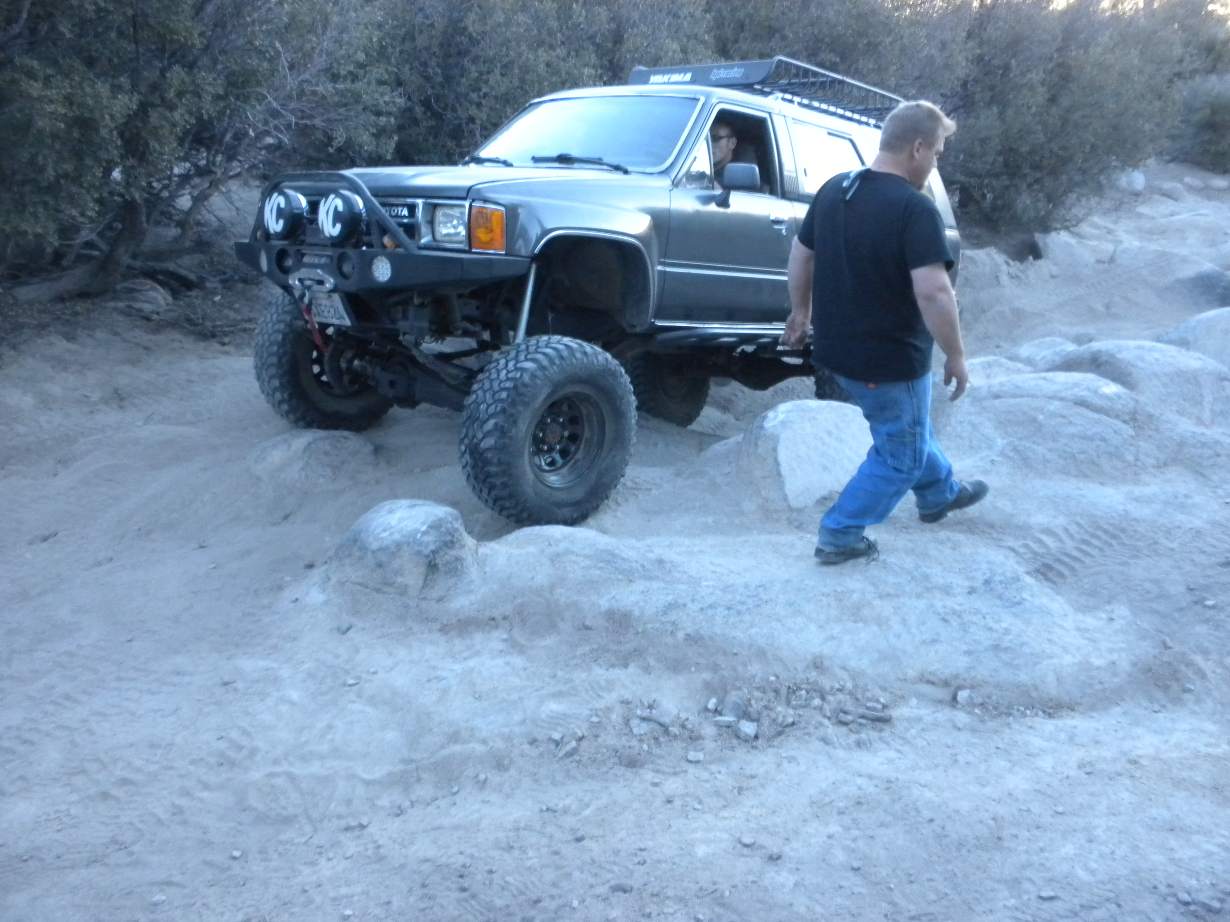

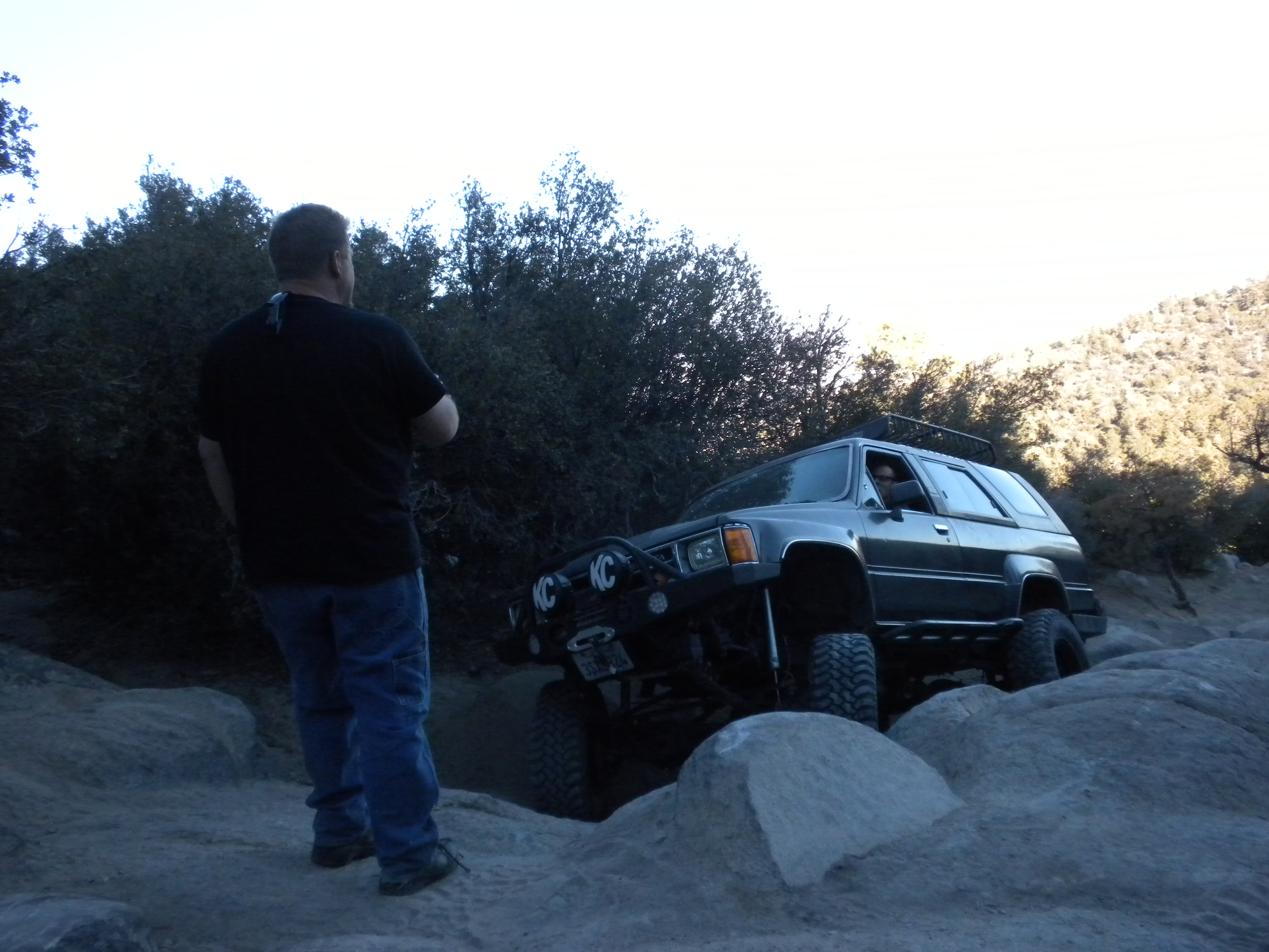

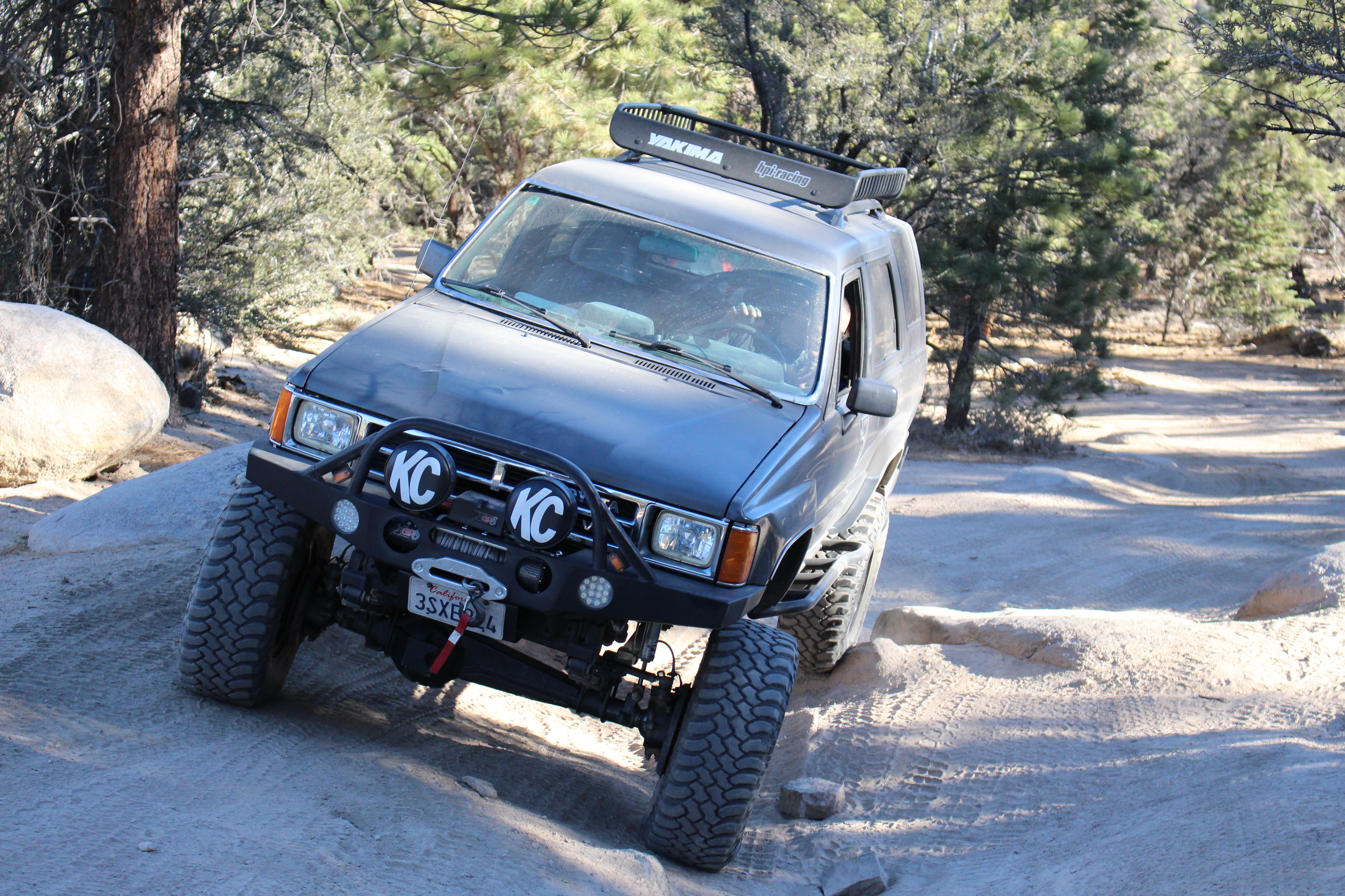

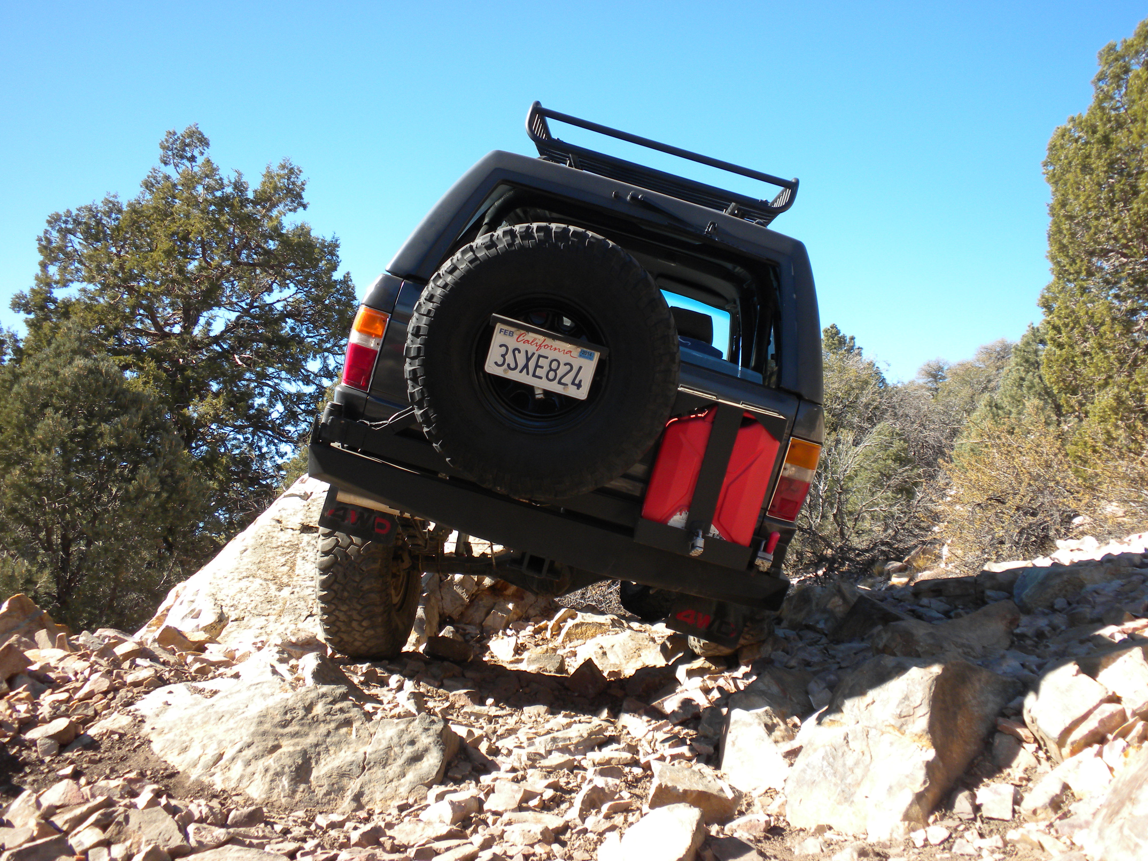

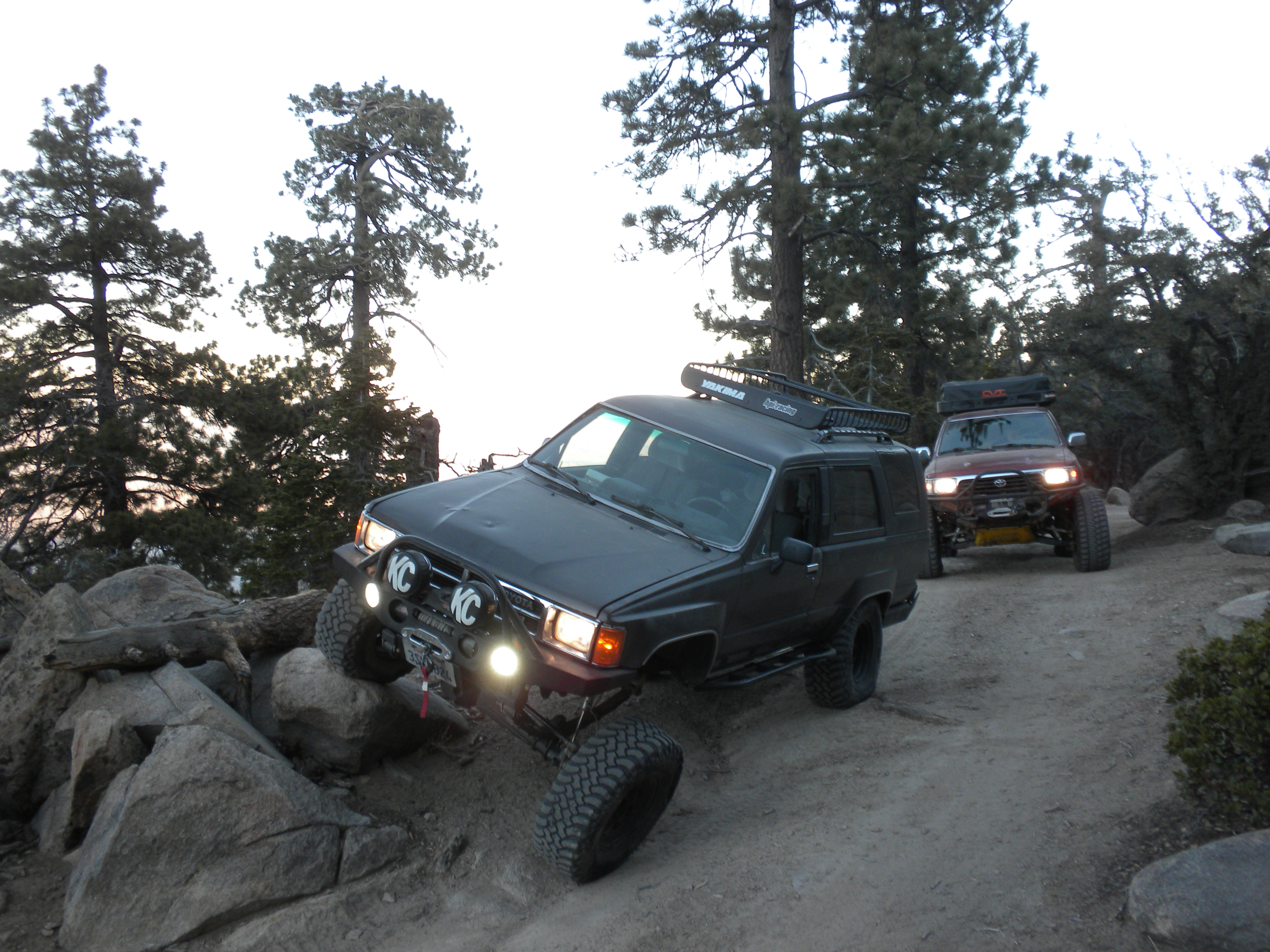

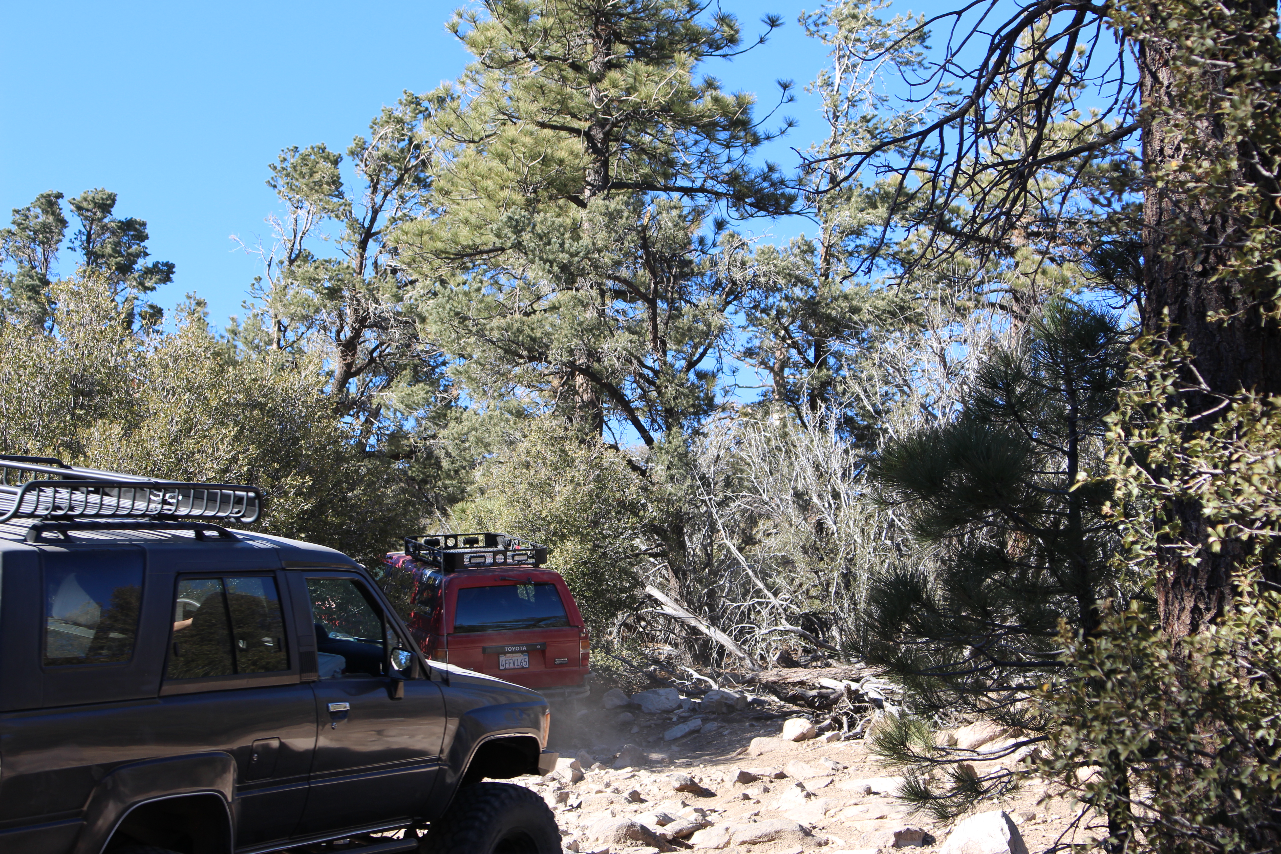

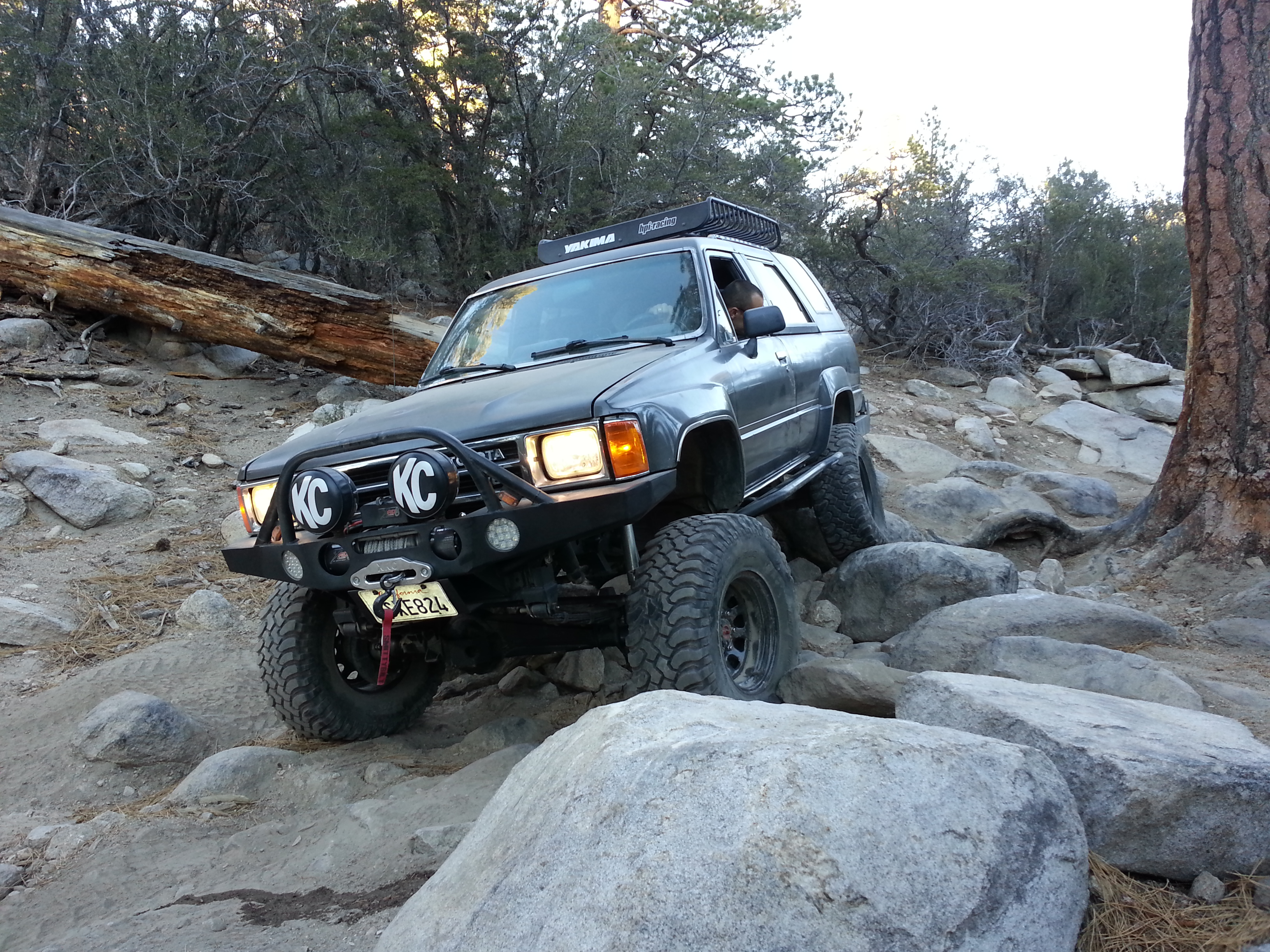

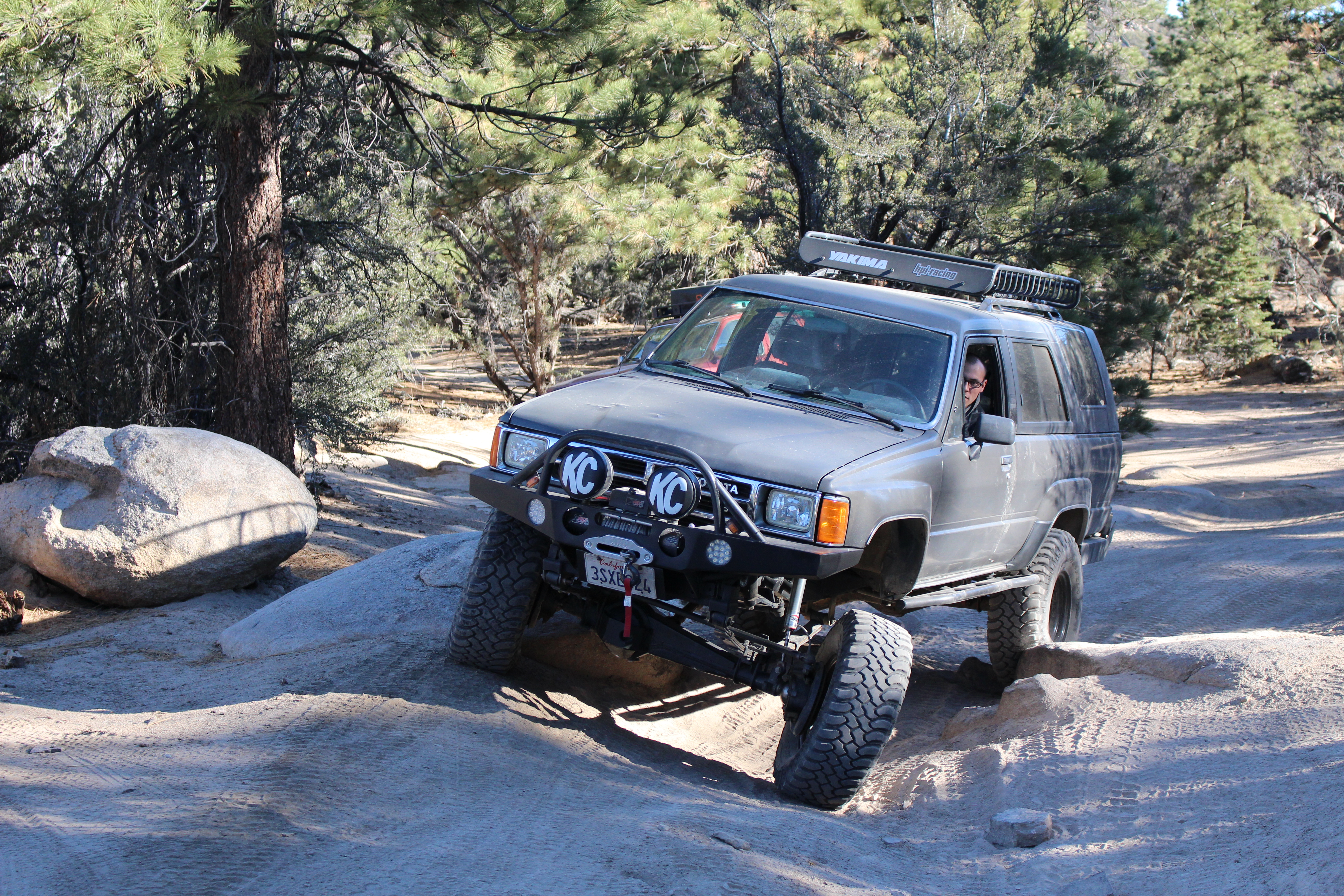

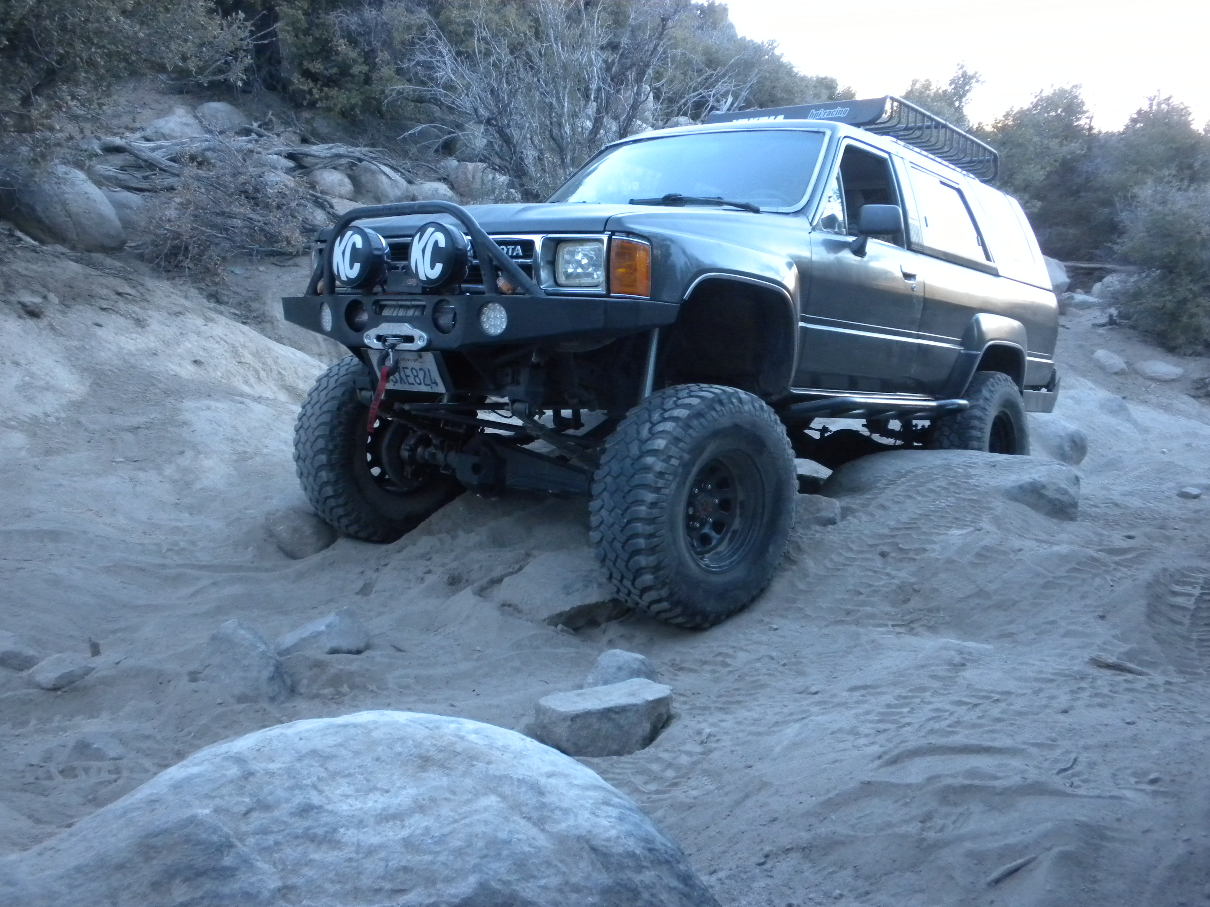

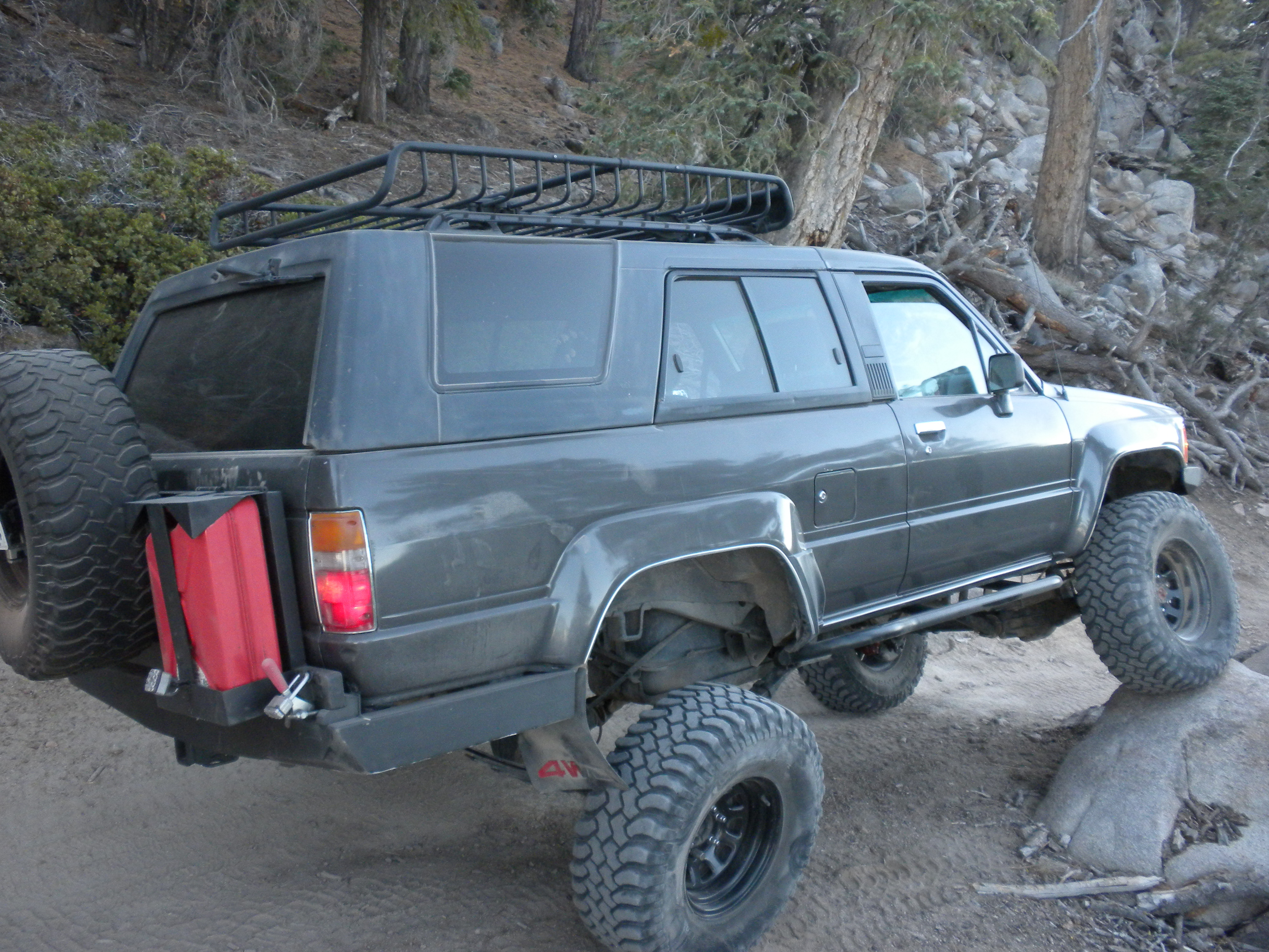

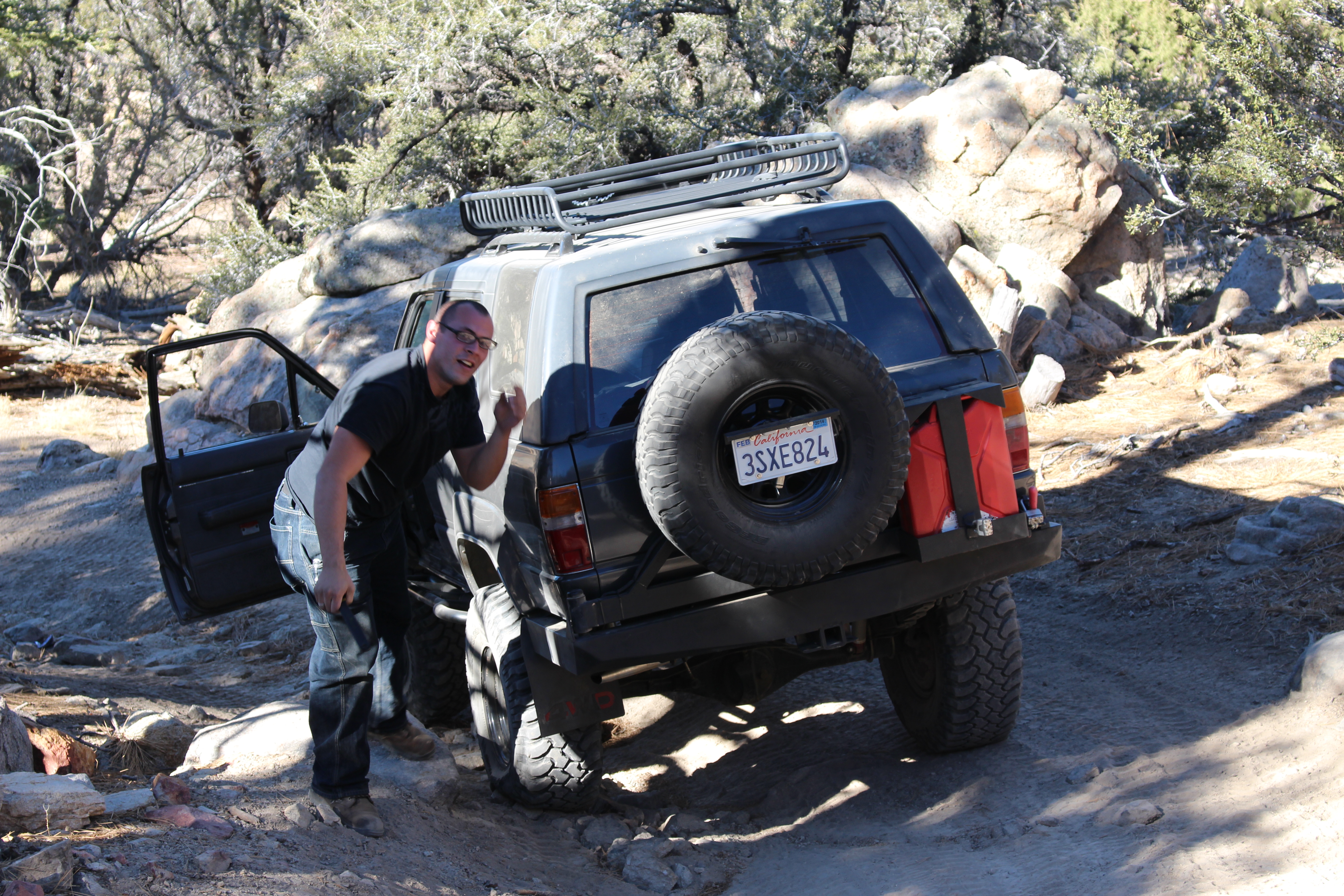

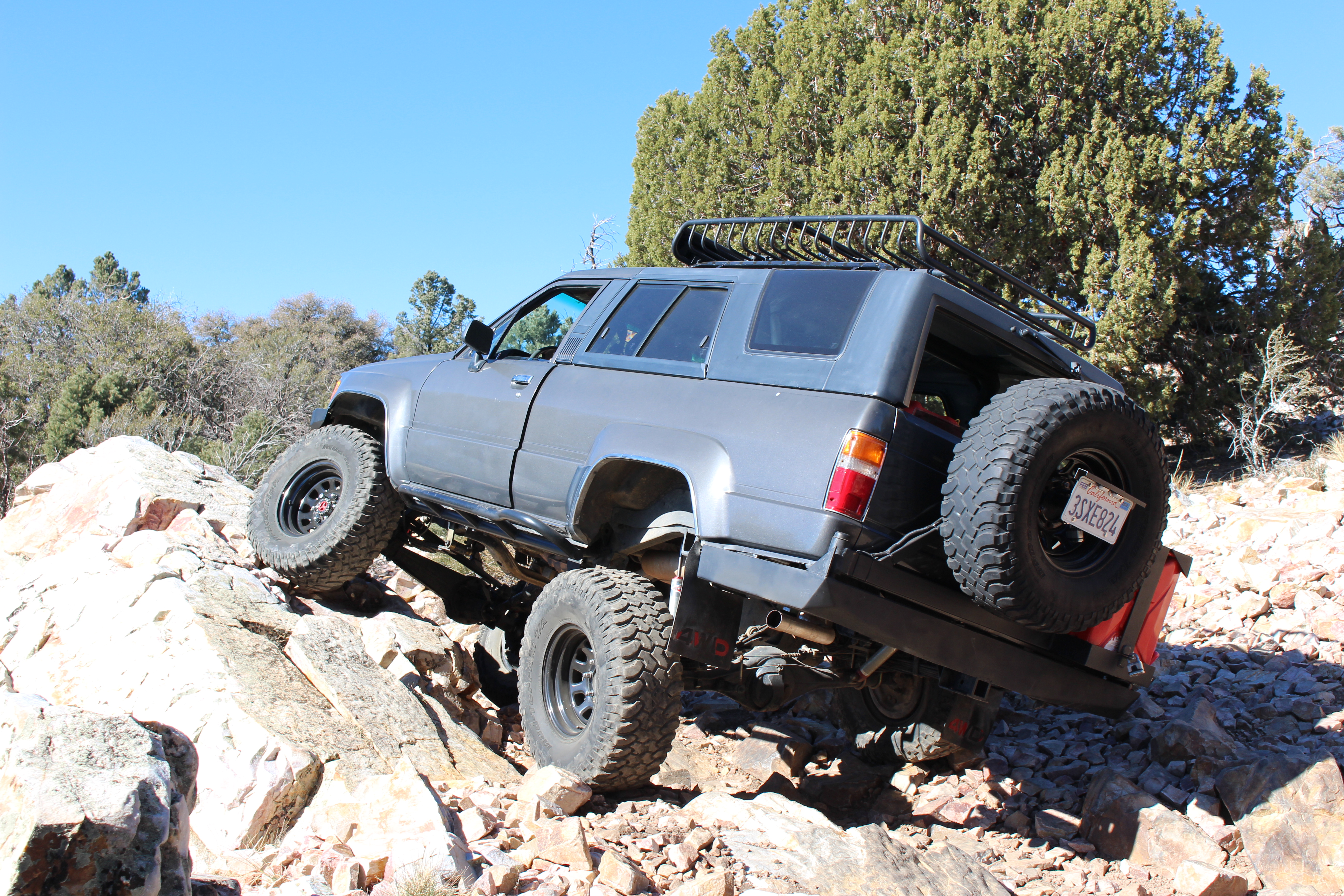

Here are some pix i'm freeloading off of Mark's unlimited bandwidth photobucket lol.
Thank you both for taking so many shots. i really appreciated it all. I had one hell of a time with you all. Has to be one of my more favorite trips. Was nice to meet you n' your wife Red wagon.
Considering it was a heck of a lot of pix(385 to be exact) i'll just post up the ones of my rig and group shots on this thread. I figure we have Mark's shots on his thread and some of Red Wagons pix on his own thread as well.

her rear end flexes very nicely

ASS FLEX!!!

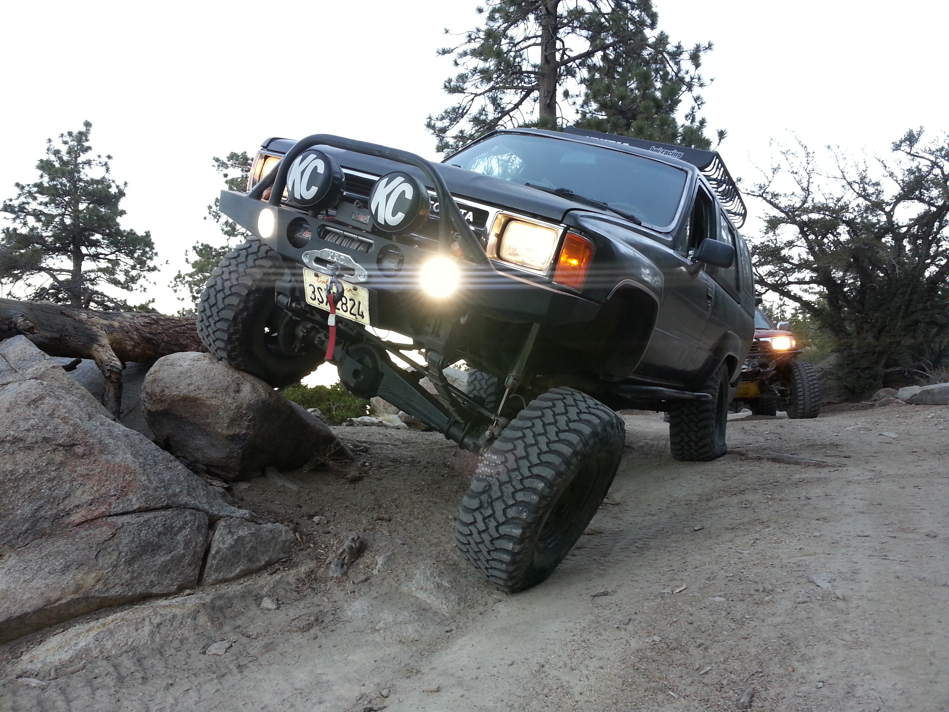

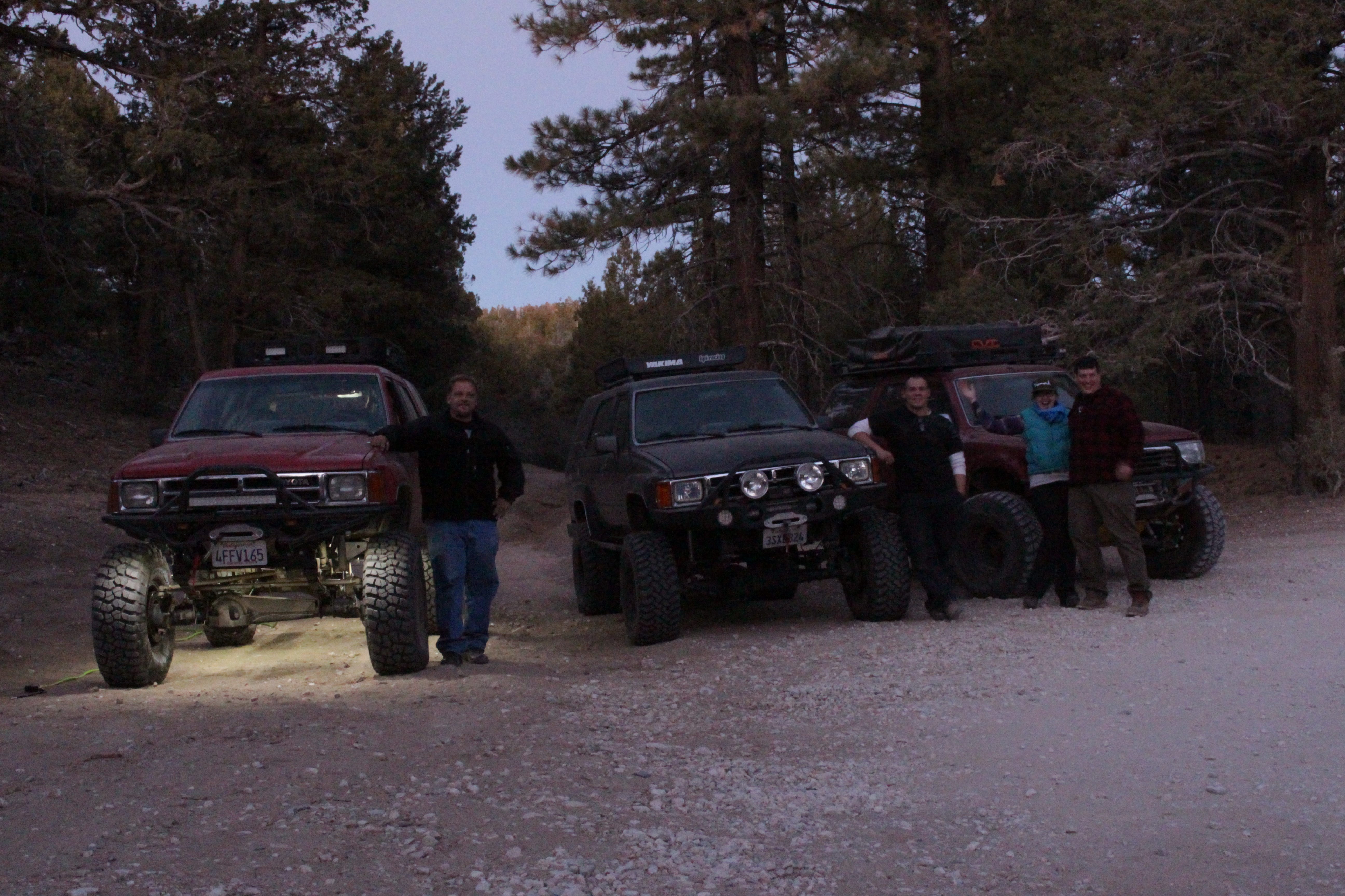

so much awesome pictures you guys
i see marks rck lights working awesomely an your LED bumper lights rich all over ill be ya'll had a great time

Thanks dude. And yea it was pitch black when we were headed out of the trail. We sent Mark out with his 360 degree lighting up in the front. Had Red Wagon in the middle, And my traveling behind them all. Needless to say we were all extremely well lit.

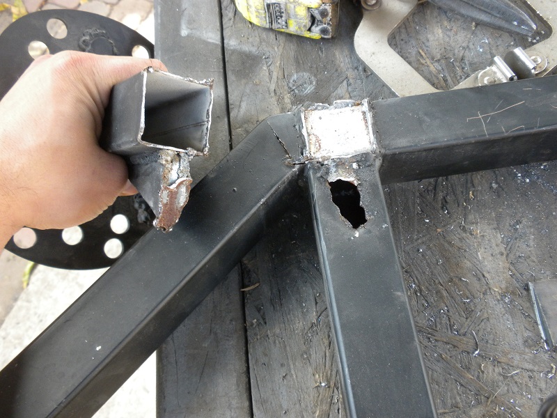

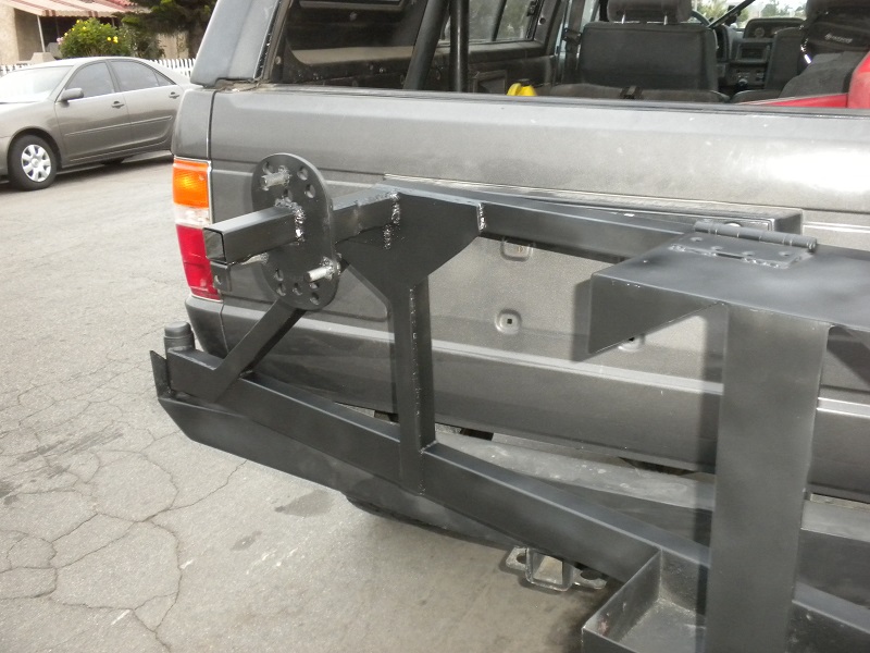

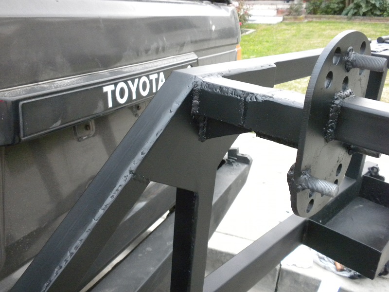

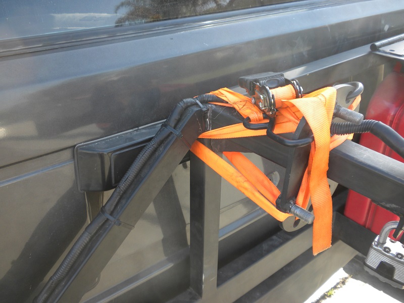

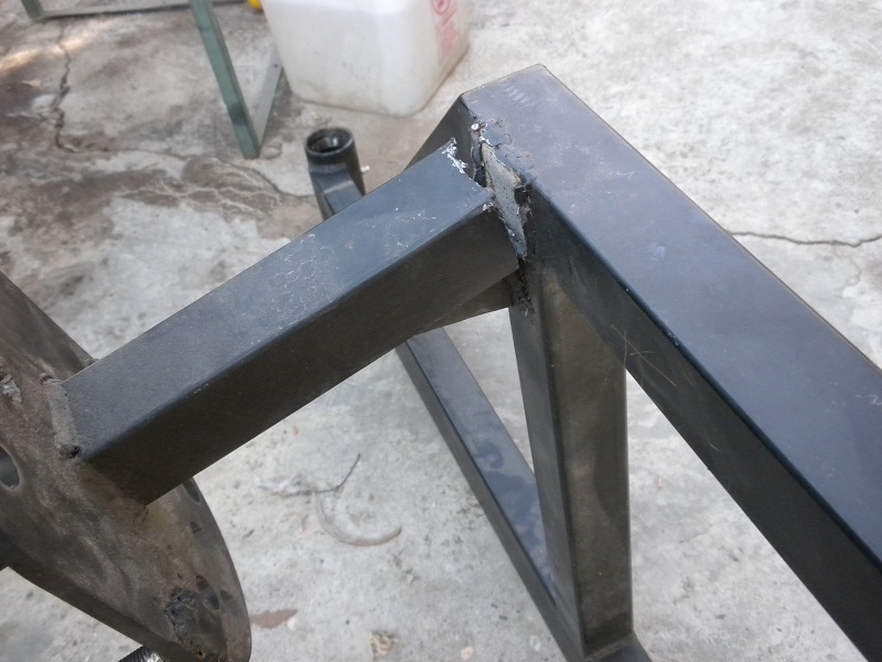

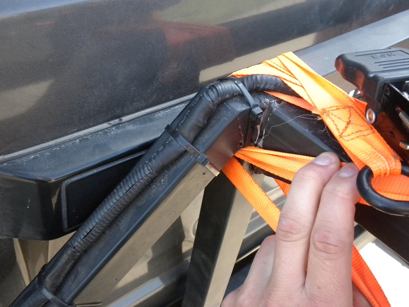

Hi guys. So here's a few things we didnt mention. Due to all the flopping around and rigorous trails we went on this past weekend i ended up breaking my tire carrier.
YES IT BROKE! I honestly dont remember using such thin metal but i can see why i chose it to begin with though. I probably wanted the swing to be light due to the heavy load of the rear bumper's 1/4" steel. So i went with 1/16th tubing. Blahhh!!!!
Needless to say it held up nicely for the short time it was in tact but the almighty weight of the tire and steel rim won with its weight and the brute force of my driving lol I pretty much punctured a hole in the tube.
We didnt notice this until we were done wheeling and had already arrived at the hotel. I was grabbing my things when i noticed my tire wasnt sitting completely vertically like normal. It was more like an " / " and when i went to take a closer look i saw that the entire tire was only hanging by about 1/4" of weld just barely holding on to that 1/16" thick wall of the tube. I was amazed i had even managed to get back to the hotel without it falling off. God was definitely watching over somebody because it held on for dear life. lol After realizing how it was i started to think.... "OMG... all those people traveling behind me on the street. that tire could have easily flown off and bounced right into their car as they drove. oh my. im so happy nobody got hurt." After i seen that dismounted the tire, Andrew threw the tire up on my roof rack (thank goodness for the rack) and i strapped the tire down. then i seen that with the small movements of removing that tire i had broke the metal that it was hanging on by even more. And out here in California we absolutely need to have a rear license plate and have it lit up well. So i had to use some tie straps to tie down the license plate tightly against the tire swing. and well here is the pix to show you how the tire carrier looked when i got back home.

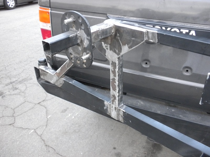

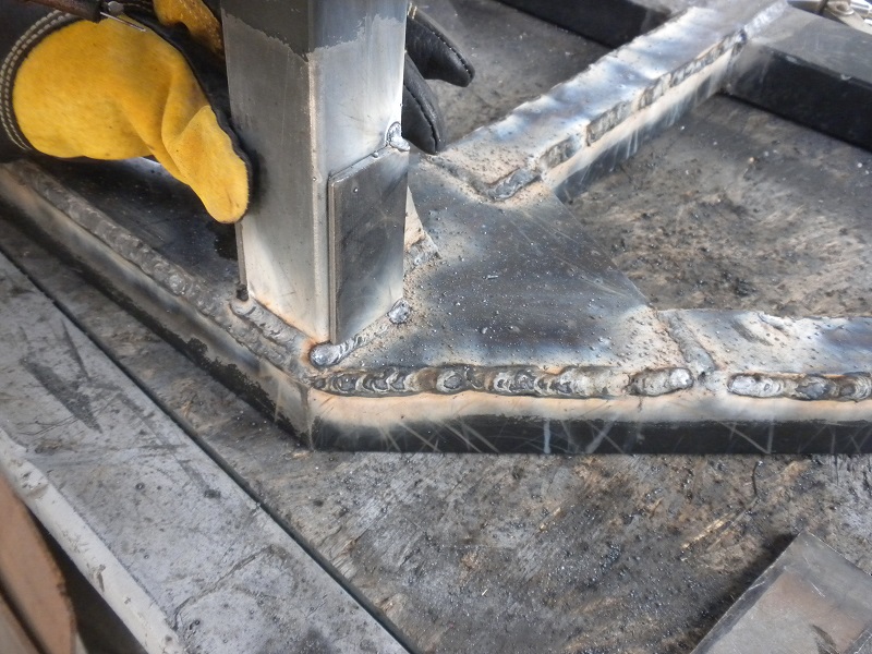

I decided to use some of the leftover 3/16" plate steel from my front bumper to use as reinforcements for the tire swing. Here are the plates
And this time i asked my dad if he could do all the welds. I feel confident in my work, but i would much rather him do it.

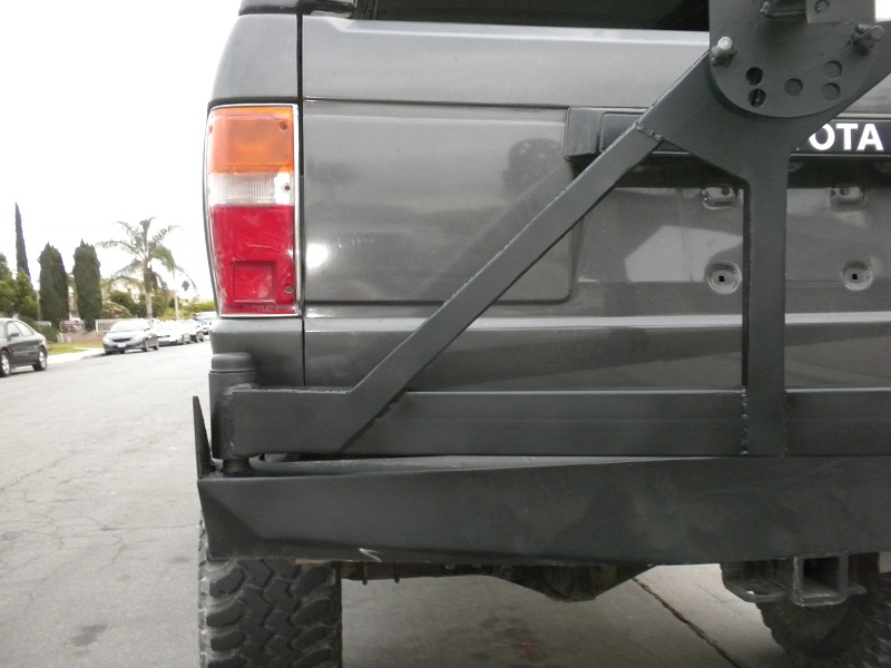

I really doubt this tire will have any problems holding on anymore. Not with these plates. But i seriously dont know where my mind was when i chose 1/16th tubing.... wow that should never be used in any instance. EVER! and if you do use it make sure to reinforce all mounting areas and corners where you connect to other tube. this is something that should never be overlooked. Im just glad i didnt cause a major accident.
Today I mounted the tire swing and got it primered and painted.
I didnt want to grind and sand down those welds too much because i wanted the tire swing to keep its strength so i just touched it up and smoothed it out a little bit. It's okay i dont mind. its made for an offroad truck anyway.
Already painted

... i ended up breaking my tire carrier.
... I probably wanted the swing to be light due to the heavy load of the rear bumper's 1/4" steel. So i went with 1/16th tubing. Blahhh!!!!
I'm glad you didn't have permanent eye damage, Richard. Hoping you'll feel better soon.
Good reinforcement job on that carrier. However, did you consider putting a reinforcing plate on top? That's where tension (metal pulling apart) is highest.
Richard and guys,
Regarding thickness of the bumpers? Do you think 1/4" is absolutely necessary. Has anybody had experience with thinner, say 3/16" or 1/8"? That, plus the structure of the bumper would still be significantly stronger than stock.
Re: Thickness of tire carrier frame,
Would you agree that 1/16" is good, and just need reinforcement like Richard did for the horizontal member itself?

Ray 3/16" is perfect thickness. 1/4 is really heavy duty but I think its much too thick. Most fabricators use 3/16" and they hold up very well. Red wagon hit his rear bumper a bunch of times too and he didn't get any dents in the bumper either. If I could redo my rear I would have definitely gone 3/16. Its lighter. The only reason I used 1/4" for my rear was because that's all I had available to me at that steel shop. Only other option would have been to buy a huge sheet of 3/16 plate steel and that wiukd have been much too much for my project. So I stuck to the scrap metal section and only bought 1/4".
As for the plate on the top side of where the tension is dude I didn't even think about that. Youre right that'd probably be better.

RAD, I wouldn't use anything less than 1/8 inch on any part of a bumper, structural, supports, swing out. You will not save enough weight to matter and the weld has nothing to penetrate. I like to use 3/16 for most everything I do like this, its a good compromise between weight and strength. Jmtc.
Sorry to hear about your eyes Richard, I've done that to myself a few times, I'm a lot more careful in my old age Lol.
The fix on the carrier looks good, spread the force of the joints over as large of area as you can.

i agree i was thinking the same way as RAD of putting a plate cross the top where the pull is but bending the end over the back of the carrier (L shaped) an welding the perimeter

...but bending the end over the back of the carrier (L shaped) an welding the perimeter
YEP!
Richard,
3/16" is just perfect for off-road use. For L.A. traffic your 1/4" is best LOL!

Good to see the carrier fixed with no drama.

^^^^ yes OR you need to increase the gusset under the tire mount.
I did this to mine:
