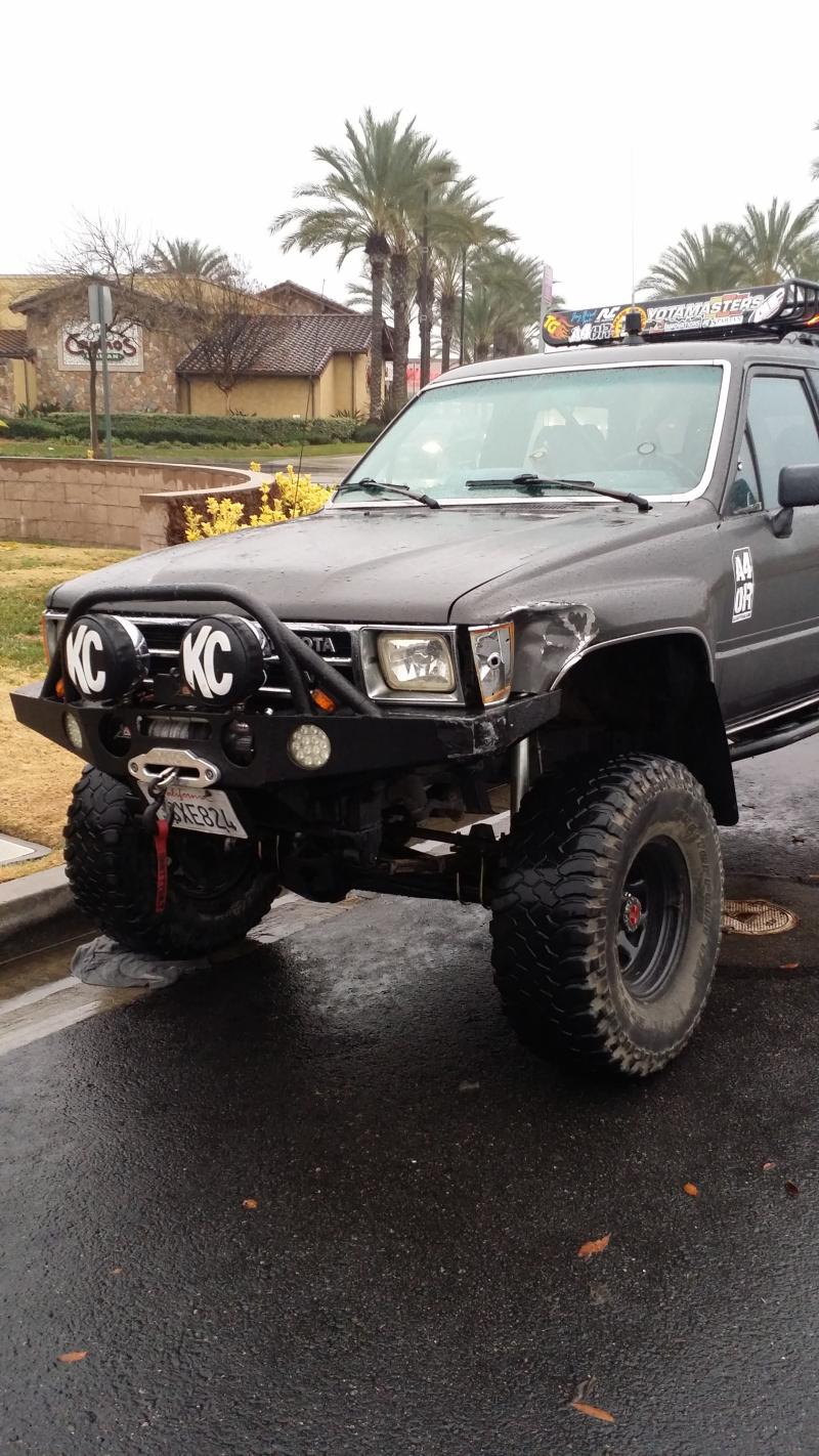

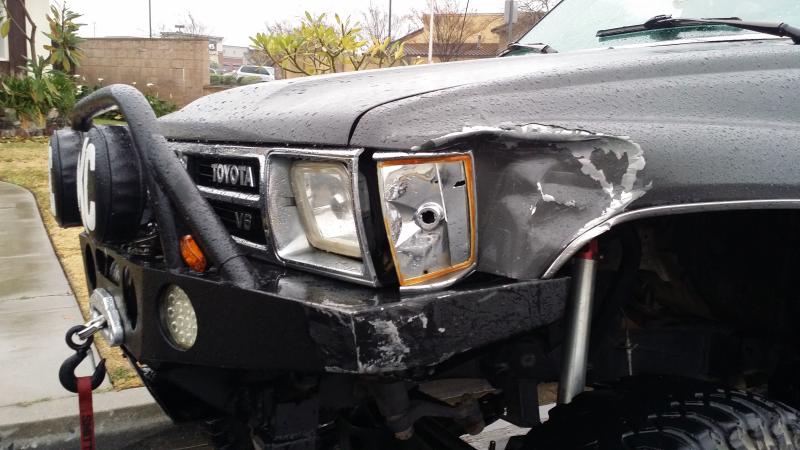

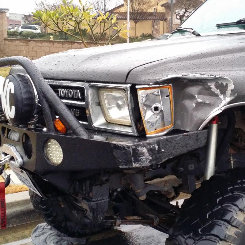

So this happened today about 6 hours ago. Oh how I hate the rain!

Despite the damage that my truck took on I am just happy that this bumper I fabricted did it's job I'm keeping me and my girlfriend safe. I haven't checked out the bumper thoroughly yet but it looks like the bumper only took on paint scruff damage but as the other vehicle sunk into or conformed to my bumper his body managed to touch my driver side fender. Which is where the damage happened.
I'm going to try to smack out the fender to shape again but if that doesn't work then I'll just end up replacing the fender with a used one or order a replacement online and just paint it. All I know is that I gotta get that broken running light fixed asap Because I need it by law. It's a ticket waiting to happen.
So pretty much this is what happened.
It was raining. And we were on our way to pick up a set of 4 used 33"/12.5/r5 tires with great tried to replace my BFG tires that ironically are rolling on the last 2 millimeters of tred. We were driving on a street with a slight downhill; barely noticeable. And I saw all the tail lights of the cars ahead of me on at the red light up ahead. So I started braking from a good distance away. I was only going about 25mph. And as I was braking I must had gone over a puddle or smooth spot of pavement on the street but whatever it was caused my truck to completely loose traction. I skidded a couple of yards. And I saw there wasnt anybody off to the right lane so I attempted to swerve out of the way into the right lane to avoid a complete head on collision. But since my tires had already lost traction I couldn't turn the truck well. I managed to get the truck mostly out of the way but I still plowed into the rear passenger taillight/quarter panel area of his Chevy suburban. ---- in normal conditions my truck would have definitely stopped with plenty of room to spare. And it would have been able to be moved to the next lane. But thanks to this stupid rain I wasn't able to control the vehicle as well. In the close up picture here you can see where the corner of my bumper literally tore into the sheet metal of his side panel.

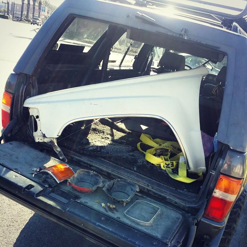

I didn't wanna bother with a slide hammer. And after all I do live in CA where some of the rarest 4runner parts are still available. So I actually gotmy hands on a nearly mint white fender off of one of Chef's friends. I paid ($80) but it was pretty worth it considering there are no dents init at all. and silver trim is in perfect condition. Also, Chef let was kind enough to let me have his driver side running light and headlight bucket and plastic/screws hardware to hold the light in place. I'm kinda in a pinch so he really helped out a lot with that contribution.

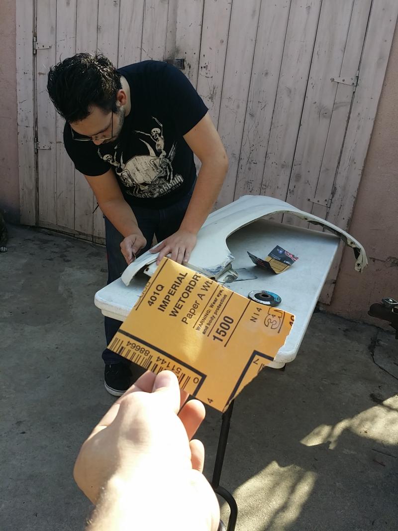

Yesterday worked on prepping the fender for primer, we Sanded down and cleaned up the surface area. Then at the end the day we laid a couple coats of primer on there.
Here's my brother doing some work. We started with 80 grit, then 220, and this 1500.

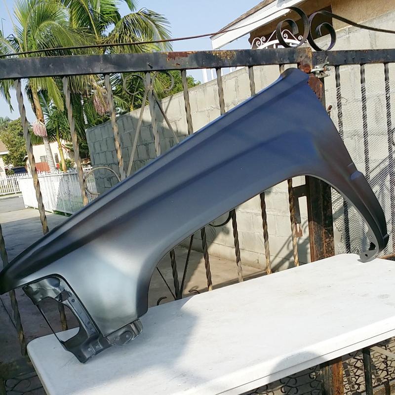

I went through 2 cans of charcoal Grey color.it looks like it's gonna be a perfect match. I sprayed some of the paint onto the crashed driver side fender when I got home and about 2 hours later i went back to check on it. To tell you the truth I really can't tell the difference I cant even see where the new paint went on lol So here is the Replacement fender with 2 cans worth of Duplicolor Perfect Match FORD charcoal grey. Apparently their grey matches my faded charcoal grey Toyota paint color perfectly lol
It's not the best shot. But here I'm holding the replacement fender against the truck's passenger side. Although the angle with shadows aren't the best you can clearly see that the fender is really freekin' close to the original color.

1 can of clear coat check! ✔ she is looking good. Just need it to dry and it is finished!
