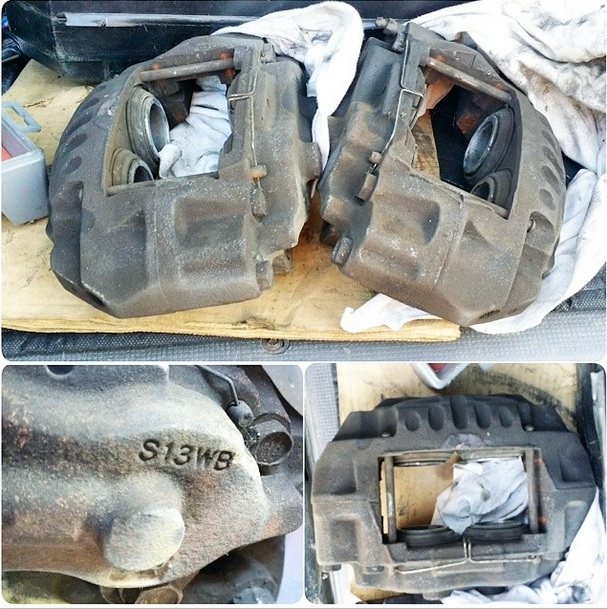

They also saw that one of calipers was seizing up on me while i would drive causing the engine to work harder, burn more fuel, and run much hotter. In the end they found that one caliper was was working better then the right causing my truck to swerve to the left(like what had happened last year) this issue was because i was stuck with the 89 v6 calipers and not the better 93-95 v6 calipers. These calipers off the later years were slightly bigger and the space where the disc fits into the caliper is slightly wider by 1 or 2mm. anyway i did this Brake caliper upgrade on my own time thanks to them and i noticed a much greater braking power behind the truck now. Not a ton. but i can most definitely feel the difference. One other thing that Eric at yotamasters found was that 2 engine mounts and one transmission mount was bad so those had to be replaced. In the end they replaced my MAF with a refurbished one, labor, and motor/tranny mounts. Also finally bought myself a Highlift from them as well. This one is a 50" TJM high lift. for $72 bucks. i like it.

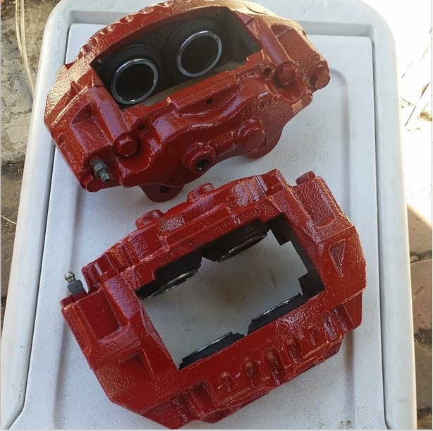

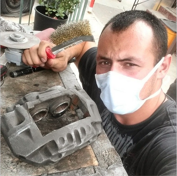

I hit up the junk yard as soon as i could to address that caliper issue. Here are the update pix for that.
Here i am cleaning them up with a wire brush. (also found use for my medical masks lol)
P.S. if you go with this caliper make sure theyre off the 93-95 years stamped S13WB.
Primed and painted them to look good on the rig. made them cherry red like when i first SAS'd the truck.

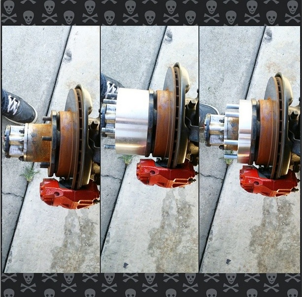

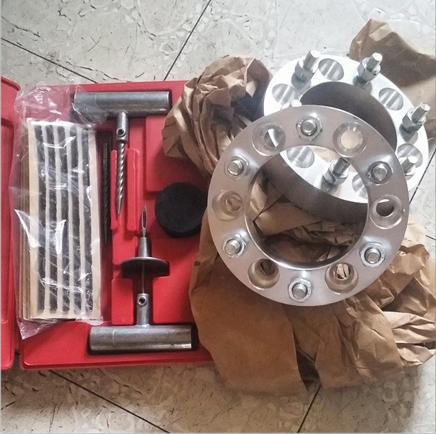

I also finally saved up $$$ to buy the 1.5" wheel spacers that ive been wanting since the SAS! lol Bought my Trail-gear wheel spacers off of yotamasters and for the promotional period they were including a T.G. tire plug kit and free shipping. I got all this for under 80 bucks!
To my amazement the order for wheel spacers arrived in 26 hours! that was awesome! So i installed them the same day they arrived.
This is a copy and paste description of why i swapped spacers off my instagram page.
Once a person does a Solid Axle Swap "SAS" and decides to upgrade to bigger and better master cylinder/V6 calipers they will find themselves with a clearance issue as you can see here in the left picture. Obviously the rim backing plate won't reach the part it is supposed to be flush to due to the caliper sticking out in front of it about 1&1/4". The person I bought my axle off of included these massive 3" spacers(pictured in the center picture) that I've been using since I did the SAS but I honestly do not like the look of them so wide. And don't like the fact it puts stress on the axle. So I finally decided to go to the correct size. 1&1/2" wheel spacers(pictured on the right) these will clear the bigger calipers while still giving me about a 1/4" left after the caliper. Definitely happy I got these.

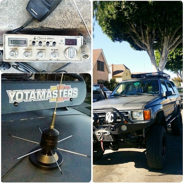

And last but not least! This just happened day before yesterday. I FINALLY GOT ME A CB RADIO SET UP!
I found a COBRA 25GTL in my dads garage and a wilson 1000 antenna. Dad told me if i get it fixed he'd let me have them. So i did just that.
Thanks to my buddy Julio (one of our local SoCal Big rig truck drivers) we went to his friend Camacho to get my set up working and tuned. This guy is somebody who does all of the truckers CB radios. He really knows his stuff. Camacho, cleaned the internals to the CB radio, gave it a few upgrades for longer range and fixed the needle on the face. I didn't end up getting a firewhip or permanent antenna install like I originally planned. He told me the antenna portion of my Wilson 1000 was perfectly fine and in great working condition but the base portion was missing the magnet, and was very corroded inside. So he sold me a new base with a mid piece for cleaner transmissions. Internal speaker on my Cobra 25GTL was busted and rather then replace it he just threw in a better and louder speaker to mount near the passenger feet area. Then he tuned my antenna as well. He didn't do an installation because i wasn't sure where i wanted to mount the CB yet so i just have it in there. In the end he cleaned up and fixed the cobra CB, upgraded it for further distance, sold me a base and middle piece for the Wilson antenna, installed the speaker, and tuned the antenna. He didn't charge me labor because i was a friend of my buddy Julio so that was a huge plus. All this only came out to $90. Not bad considering a new CB would have costed me much more and still not including the other necessary parts. So this price was great. Definitely happy
Here is Camacho woring in the shop
Here she is!
Small video of the stuff ive got.
http://instagram.com/p/rV49pVlImr/?modal=true
And the best part about it is when testing this baby out on the way back home we made contact with people way out in Norwalk CA, the 710fwy and Florence Ave, South Gate California. And we were way out by Soto st and Washington in Los angeles. Dude that was 4, 5.4, and 13 miles away what more can I possibly want. This will definitely be sufficient enough for the trail especially if i go off roaming around and get lost or stranded. Haha

I have been testing out this CB since i put it on. I wanted to make sure i knew how to use it by the time the trip came around. But one thing i noticed around here is truckers dont like outsiders to join in on the channel or conversation lol One minute its about 4-5 people going back and forth. So i wait for a quiet opening out of respect to not cut their conversation up. Then when theres an opening i'll say Good afternoon everybody this is Richard, traveling north on the 710 freeway crossing the Florence avenue exit. How far out am i getting? and i will get absolute silence. ITs like they dont like outsiders interfering on their channel lol. Not to mention most of the people out here where i live are spanish speaking truckers. and although i speak spanish, i speak it very broken. It isnt the best but i can manage. So that works against me as well. I dunno. Maybe i outta find me some english speaking channels. I'll be able to do better communicating with those folk haha.
I got 9 miles out the other day. I was impressed. i dont need any more distance then what this set up is offering. all i wanted was clarity and a couple miles distance for when we travel in our little 4x4 groups. So i have enough with this.

cb basics (i learned back when ya needed a license to play on CB)
usually 19 (which is in the middle of the tuned radios band an thus most receptive an talkative) is where most go to to just yack
when you need to get in "break/breaker # ch here" when it (if it) goes quiet ask your question or such
10 code is still used even by sheriff dept an constables on their car to car radios an its been on CD just as long
10-4 affirmative yes ok an other 10 codes are useful too
the cobra 25/29 great radio good power when peek'ed (radio man removes certain 'limiters' inside doesnt hurt the radio is leftover from when FCC regulated CB bands your antenna great one has the ground plane rods on it to help overcome the fiberglass top issue CB radio likes metal van/suburban/tops flat an signal reflective
i still have my 148gtl sideband radio with a booster i had i actually talked to perth austrailia via skip (reflecting off high clouds an upper ionosphere the signal can go really far lol my booster actually cooked an melted my first fiberglass whips i had on that 88 nissan pickup
