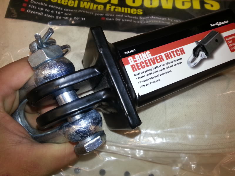

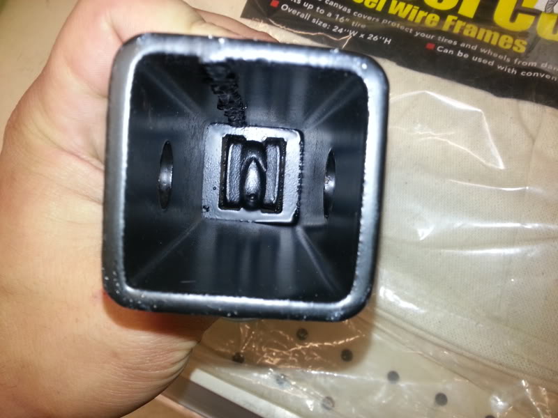

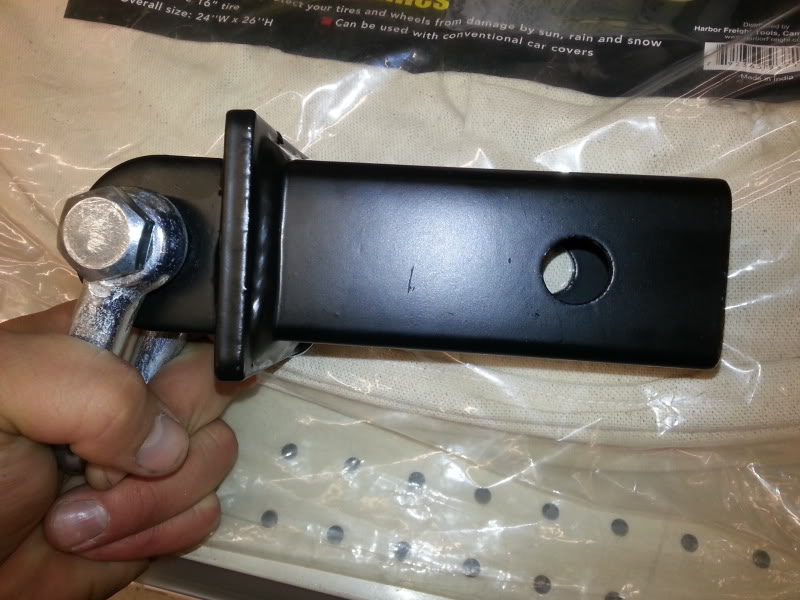

I dropped by the Harbor Freight store today and took some pix of the tow d-ring tow recovery insert.
Seems decent. For $10 at my store
Inside seems to be welded as well
Not bad. It has a 10k pound limit. I think it should be good.
I didn't buy it yet. I wanted to take a look at the spare d-rings i have in my truck. their harbor freight design looks extremely easy to make. I might even be able to make this with the spare metal that i have. Then again maybe i shouldn't chance something like this.
If i don't make it in time for next weeks offroad trip i will definitely buy it. Not like it cost alot anyway.

Do you have any of the 20% coupons Harbor Freight sends out? It would make that hitch only $8. If not sign up on their email list. Coupons every day. I think I would have to paint that D ring with something (blue plastidip?) because the finish looks sloppy.

I have one of those Harbor Freight D rings, got it last trip up to OR. Since then I've probably driven 6,000 mi max, and the pin keeping that nut on already fell off. The receiver part held up to me being pulled out of this, though...
2wd sucks, even with an elocker and 33's

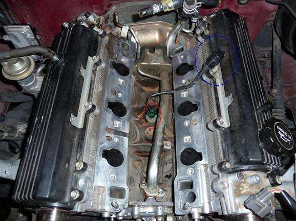

You're right it isnt on the bottom end.
The knock sensor and its wire are both located on the top end.
Here is what the engine looks like once the intake plenum is off the top end.( and that is a job in itself getting it off! As you can see the knock sensor is still not exposed. The whole middle part also has to be removed too. Grrr this is where im gonna run into a royal pita!
After the top end is removed the knocksensor/wire will be exposed an available to replacement. You can see it there in the middle of both heads.
Woo man that is gonna be a fun project. lol2

surprised you didnt replace the knock sensor wire during your engine rebuild. it should be done no matter what due to the location its only makes sense to do it if your gonna have the motor all apart. well its too late now so just take your time and take it apart. replace any hoses you break alone the way. it might be smart to replace the knock sensor itself as well but it not common for them to go bad.
Old Nov 9, 2013 | 09:27 AM
  #2260
Cyberhorn The Dragon's Avatar
Joined: Jul 2012
Posts: 2,365
From: Idaho
ive read that several people just flat disconnect the original knock sensor as its a huge pain to fix an 90% of the time its the wire to it an mount a new one on a lift bracket or another metal spot drilled an tapped
all a knock sensor is, is a transducer an microphone tuned to detect a certain frequency metal is an excellent conductor of sound so the sound of a knock (or pre-detonation) in any cylinder will set it off which tells the engine to calm down
all it needs is a solid metal connection to the engine
