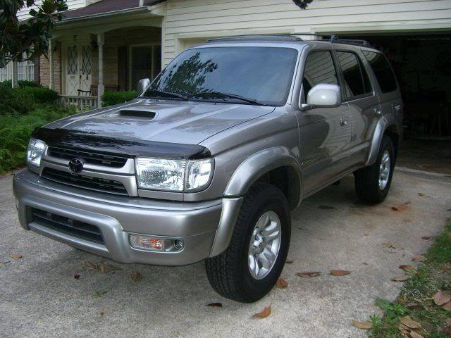

Rock Slide's 2002 Sport
Model: 2002 4Runner SE 4wd
Purchase Date: 4/20/2006
Mileage at Date of Purchase: 22K
Purchased From: Vanderstyne Toyota - Rochester, NY
Vehicle Build Date: January 2002
At Date of Purchase:
And then:
Mileage as of 07/2023: 250K
See below...

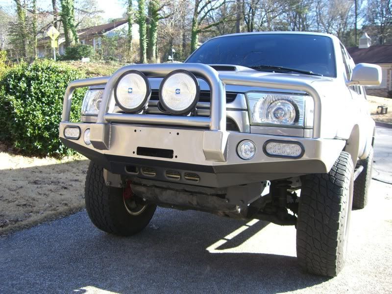

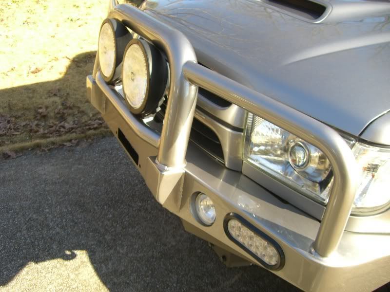

TJM T-15 Front Bumper - Modified & Color Matched

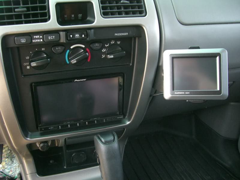

Stereo Mods:
Head Unit: Pioneer AVH-1550NEX w/ Ipod and Camera control

4. Part 1 - 7.1 SS Lift Kit, TJM Bumper, Wilderness Rack & IPF Lights
5. Part 2 - Modified my TJM Bumper

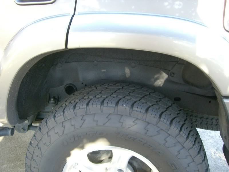

17. 1" Body Lift and Rear Fender Liners

24. Hard Wired Garmin Nuvi 500 GPS

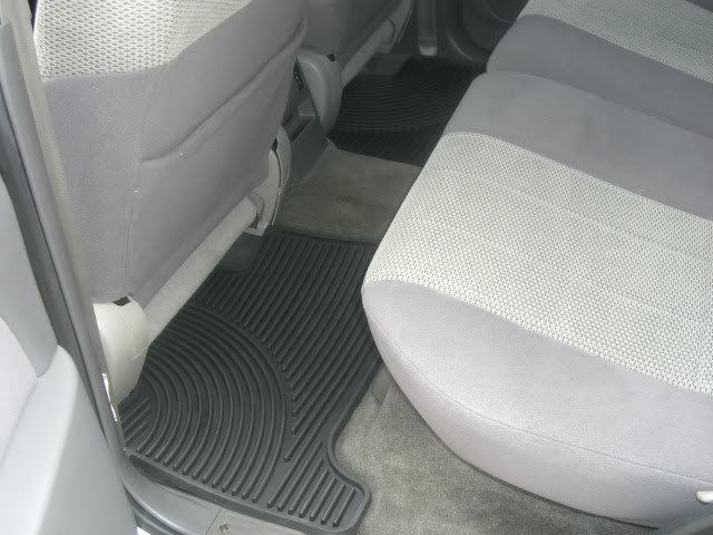

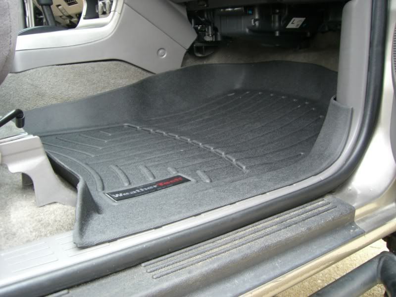

Do NOT waste your money on the below pictured OEM rubber mats. Look what happened to mine here: Click Me.
OEM 4Runner All Season Floor Mats. Part No: PT908-89060-02:
**Edit 12-8-08:
Two months after my OEM mats failed, I purchased a set of WeatherTech Liners front & rear. Much Improved!!
See Post #14 of this build thread below for more info.

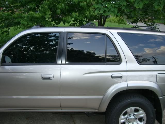

Windows tinted. The entire front windshield has been tinted to 35%. All remaining glass has been tinted to 20%:

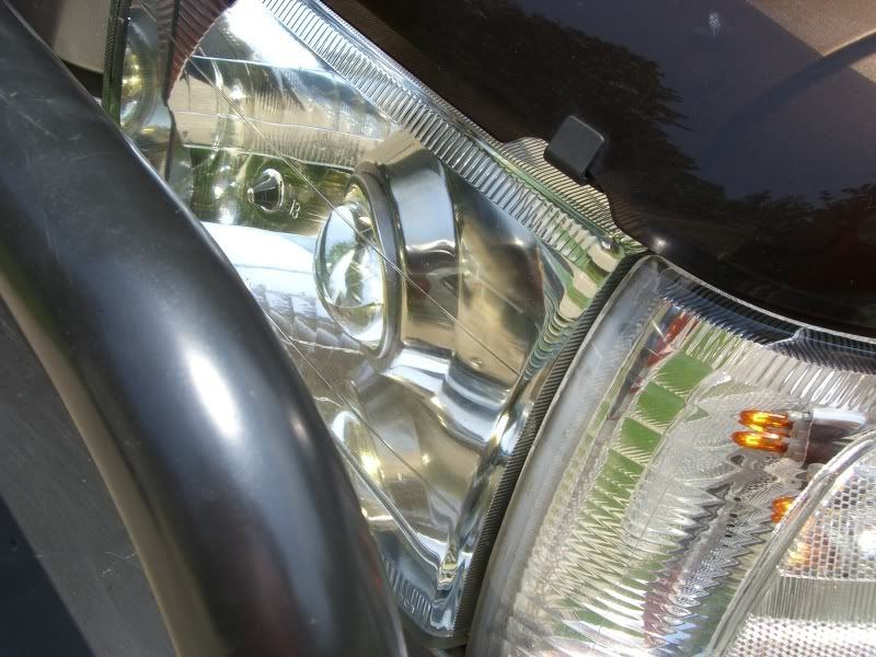

New PIAA H4 Intense White Headlight bulbs installed. This photo was taken while only the driver's side PIAA bulb was installed. These PIAA bulbs give off a much more whiter light than what the OEM bulbs produce. Notice the yellow cast to the passenger's side OEM bulb:

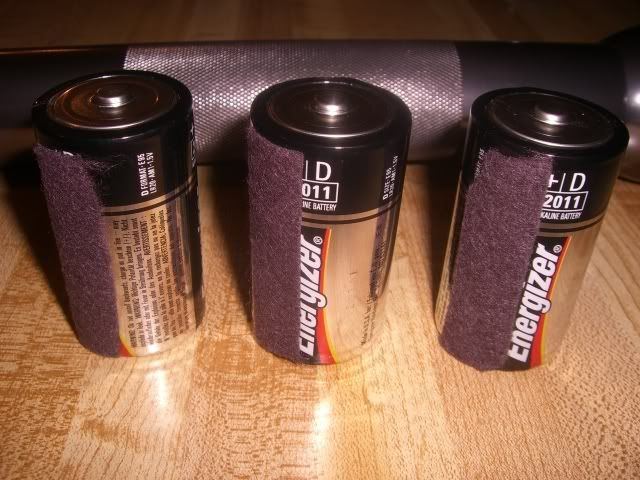

After having mounted the Maglite to the roll bar, the batteries inside began to rattle while driving, thus causing an irritating noise. To aleviate this problem, I came up with a simple soultion:
I purchased a 4" by 8" piece of adhesive felt from Lowe's Home Improvment. I cut 3 small strips and applied one strip to each battery. Now, my maglite is the quietest thing in my 4Runner.

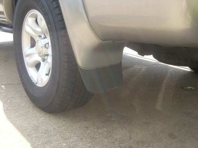

Rear Mud Flap Mod:
I got tired of seeing those extra pieces of black rubber on each of my rear mud flaps hanging down low on the truck. So I used a utility knife and sliced them off.
BEFORE:
AFTER:

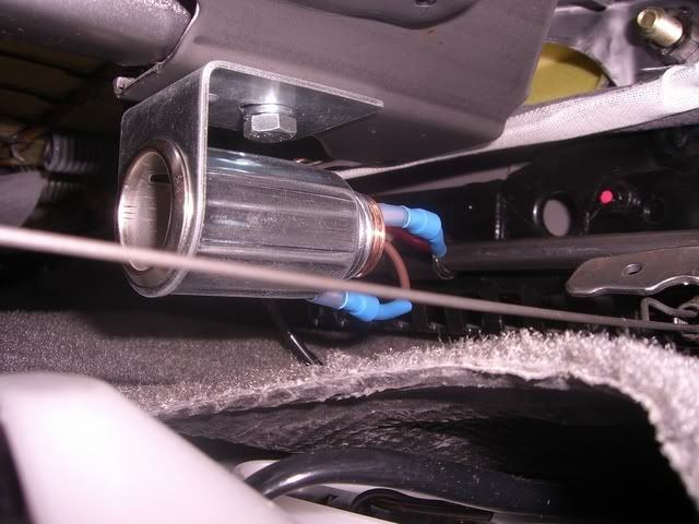

I took an idea out of member J.A.'s book and purchased a 375wt Power Inverter:
I purchased an aux. power outlet for $5.00 and installed it under the passenger's seat. There was already a pre-drilled hole in the seat frame, so I mounted the outlet there using a bolt, lock washer and wing nut. I ran the wires under the carpet and under the middle console up to the dash. Because I never use the cigarette lighter outlet, I then tapped the power and ground wires into it.
Aux oulet under Passenger's seat:
Installed:
This Inverter has been a great investment. I've used it countless times to charge or operate all sorts of equipment.

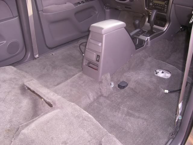

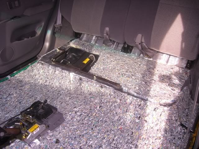

I read how Bob_98SR5 did some sound deadening on his 4Runner and thought I'd give it a try. I did not put forth as much work as he did, but it turned out great. I'd provide you a link to his web page, but it appears 4runners.org has since fallen off the internet...
It all started with a troublesome leak I had in the cabin of my 4Runner that I couldn't locate. Thanks to the advice of some members here, I found the leak and plugged it. Turns out, when I ran some additional wires through the firewall grommet, I accidentally pierced it. Every time it rained, water rolled off the hood, onto these wires and straight into my 4Runner causing the carpet insulation to mildew! I used some black silicone and sealed both sides of the grommet.
I removed the one-piece carpet and the thin factory padding that was glued to the carpet. Since I had half the truck torn apart, why not go ahead and lay down some sound deadening material and new padding.
My process in 3 steps:
Step 1 - Cab
Step 2 - Cargo & Hatch
Step 3 - Doors
For more information on the Sound Deadening material I used, visit: McCaster-Carr. Part Number: 9640T2 in the 6" roll. It has a very strong adhesive on one side and a reflective aluminum surface on the other. For the cab and cargo area, I used 4 and 1/2 rolls.
For the new padding, I picked up some 8lb carpet padding at my local Lowe's Home Improvment Store. They sell a 6ft wide by 9ft long piece for around $30.00. I lucked up and got the 9ft roll for $17.00 due to mispricing the item. I tried to find some for free, but no one was willing to let the 8lb stuff go!
Carpet padding is sold as 4lb, 6lb, 8lb and so on. When you need something above 10lb, the padding becomes heavier, stiffer and more expensive. It's also only offered as a rubber compound above 10lb I believe. 8lb is very firm, but molds very easy to many contours.
To secure the padding, I purchased 2 cans of 3M Adhesive Spray Glue #90 at Lowe's as well. This stuff's expensive, but well worth it.
I do not feel I need to further sound deaden my headliner, so for now I have only done Step 1 & 2 of my Three Step Process.
Step 1 - The Cab:
First was the cab. I removed all 4 seats, trim pieces and console pieces and then removed the one-piece carpet.
The sound deadening material is very easy to cut with a utility knife and molds to the floor contours very well. I applied it anywhere bare metal showed:
Next, I installed the padding everywhere I saw fit:
While the carpet was out, I went ahead and cleaned it. It was drying while I installed the padding:
Reinstalled all trim pieces and console pieces:
Put the seats back in and that's it! Step 1 is complete.

Rear Hatch:
I've since reassembled everything and now Step 2 is done.
To date, I have not done the doors. The cabin is much quieter than it was before. This project was time consuming, but very worth while.

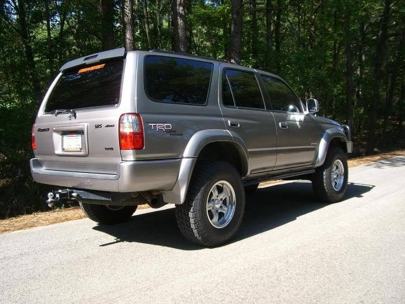

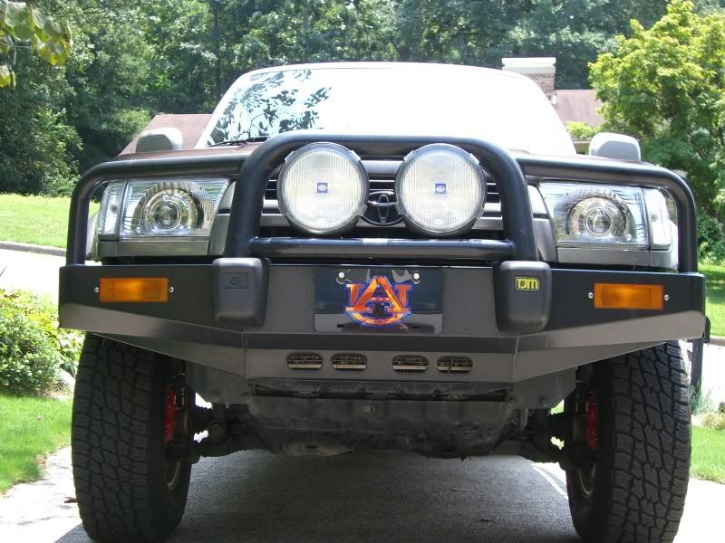

Installed the Sonoran Steel 7.1 Lift Kit, TJM T-15 Bumper, Wilderness Rack & mulitple IPF & PIAA Aux Lights. With the addition of the TJM, my front dropped 0.5 inches.
If your front TJM Bumper Pads ever need replacing, the part number is: 076-P15-BUMP2. You must order them as a pair.
**Update 4-04-08:
I've since sold the Rack, 4 front rack mounted IPFs and 2 bumper mounted IPFs. (I kept the rear mounted PIAAs, just not sure where to install them yet.) The size of the Wilderness rack was a hinderence on narrow trails. Plus, most of the stuff I now haul, I can store in the cargo area instead. No need for a rack if I don't use it frequently. I purchased a pair of Hella 4000s (Cornering Beam) instead and converted them to 35wt HIDs, with 5000K bulbs.
For the Full Write-Up and mulitple pictures, click the link below
Click Me

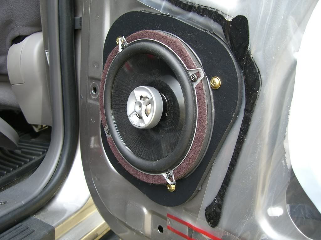

Upgraded my door speakers all the way around.
Installed the following:
Front Door Speakers: JBL GTO607C 6.5" 2-Way Component - 70W RMS
Rear Door Speakers: JBL GTO527 5.25" 2-Way Coaxial - 45W RMS
To mount the rear door speakers, I purchased a set of speaker adapter plates and speaker spacers from - Car Speaker Adapters
Front Door Speaker:
Tweeter:
Rear Door Speaker:
(You can see what it took to get that speaker to sit out far enough so the glass would not hit it when rolled down.)
Install was fairly easy. A big thanks to all the YT members who helped make this install go as straight forward as possible.
For the write-up, click in the link below:
Click Me

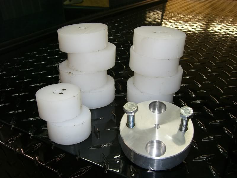

Wab Fab Off Road 1" Body Lift installed
Wab Fab 1" UHMW Polyurethane Spacers & 4Crawler Steering Extension:
Before:
After:
Installed a set of OEM Rear Fender liners from an '89 Toyota pickup to hide the gap created by the BL:
Before:
After:
A big thanks to WabFab for the installation of this Body Lift .
For the full write up, including more pictures and detailed information of the install, click on the link below:

Just finished a complete HID Retrofit to my stock headlights
Here's what I used:
Infiniti FX Bi-xenon Projectors
Acura TSX Lenses
Hella Gen 3 Ballasts
35W 4300K Philip D2S 85122+ Bulbs
H4 Plug-n-Play Wiring Kit - (ebay special)
Malibu Light Covers
Here are a few pictures of the finished product:
For more pictures of the install, check out the Write Up below:
Click Me

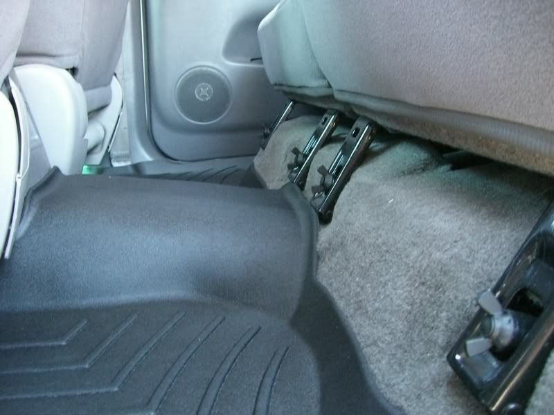

It was time to upgrade my floor mats. My oem rubber "all season" mats failed after just 2yrs worth of use.
In the Beginning:
Two Years Later:
So, after a bit of research, the 2 best options available today, are either the WeatherTech or Husky Liners. To make my decision simple, I just ordered a set of both. .
After a week of using both, the WeatherTech liners won the decision hands down . They have a much better fit and feel compared to that of the Huskys. The Huskys got returned.
For more photos of these mats installed and even a few comparison photos of the Huskys, click the below link. It's full of info on both these mats:
Click Me

New Pioneer 4100DVD HU installed w/ a few cameras:
HU:
Camera Switch:
Baby Cam:
Backup Cam:
Full Write Up here:
Click Me
Having both a Pioneer HU and a Hilux Field Monitor installed created an issue as seen here: CLICK ME.
UPDATE 1/25/12: Solved the problem mentioned above! Refer to the link and you'll see...

Modified and color matched my TJM. A big thanks to WabFab Off Road for all their hard work modifying my bumper . It was later professionally painted at a local body shop.
Run down of the mods:
-Raise the bumper 1" to accomodate the body lift
-Cut oval slots to mount new LED turn signals
-Cut holes for 4" round fog lights
-Bobbed the side wings
-Weld side wings to main bumper support (the side wings originally bolted to the front support.)
-Replace front bumper rubber pads with a set of custom low profile welded metal pads
Once the above mods were completed, I turned the bumper over to a local body shop. They in turn did all the pre/paint work. The entire back side of the bumper was rhino-lined black. As was the bottom front portion of the bumper to keep rocks from chipping it. Then the top half of the front was colored matched Thunder Cloud metallic.
LED Turn Signals:
Full Write Up on the Bumper Mod can be found here: Click Me

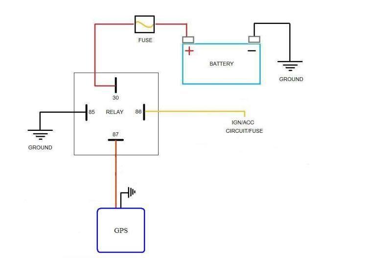

Finally posting photos of my gps that I hard wired + the Scangauge II installed:
GPS: Garmin Nuvi 500
Mount: Pro-Fit VSM
GPS Mounted:
Wiring Diagram. Disassembled the garmin car adapter plug to access the power/ground wires and ran new wiring:
Full Write Up can be found here: Click Me
Scangauge II mounted. Drilled a hole in the console to run the power cable to the OBDII Port. The SGII is held in place using a pair of velcro strips:
