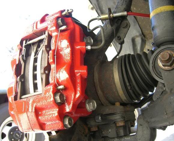

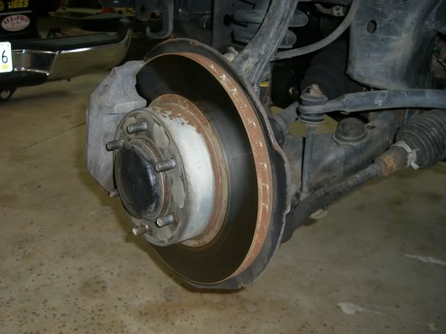

Well, new brakes are finally on. My old ones have been slowly wearing out and I figured it’s best to replace everything now, then later when I encounter a problem. I also knew that when the time came to do the brake job, I’d replace the front calipers, hard lines and soft lines with new components. (Having bought this 4Runner up North, the front brakes looked 3x their age. )
I had planned to just replacing everything with OEM stock parts, but for not much more in overall price, I decided to go with the Tundra brakes instead. I purchased the Calipers from my local Advanced Auto Parts Store. I picked up a set of Brembo Blank Rotors from Auto Parts Warehouse. The Pads & Hard Lines I purchased from my local dealer. Last, but not least, I purchased a set of Goodridge SS front braided brakes lines from Wheeler's Off Road to complete the system.
Again, having purchased my 4Runner up North, I also figured the pins and springs in the rear drums would need replacing. Therefore, I purchased a set of rear OEM shoes, pins and springs to completely do the rear drums too.
For the Front, I purchased the following (All Prices listed are 'Total, Out the Door' Prices):
2001 Tundra Reman 199mm (S13WE, Pins included) Calipers (2) $300 - $100 Core Charge = $200
2001 Tundra Brembo Blank Rotors (2) = $124.00
2001 Tundra OEM Pads (4.7" pads = D812 = 199mm calipers) = $55.00

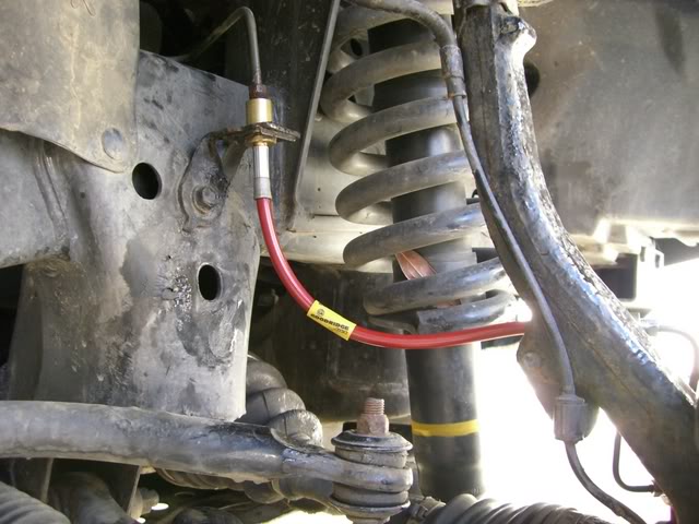

2002 4Runner OEM Hard Lines (set) – (These are the hard lines that come directly off the calipers.) = $10.00
2002 4Runner Goodridge SS Braided Brakes Lines (set) =$66.50
Parts Total = $455.50
EDIT: Just to be clear, in order to complete this upgrade, the Hard Lines and/or Soft Lines (SS Braided Brake Lines) DO NOT have to be replaced. I went a step further and did so because my OEM lines needed replacing.
As others have said, yes this was a simple “bolt on” upgrade. However, I knew I would not be able to complete all the work by myself. Yes, I could have done the fronts by myself, but I had planned to have more work than just fronts done. First off, I know zero about installing pins, springs and shoes in the rear brakes. Second, I also wanted my new calipers powder coated while the truck was down. (Yes, I could have had the calipers powder coated before I tore the truck down, but I needed to know if they fit my TRD IS wheels first to see if they rubbed. If they did rub, I’d have to grind the calipers down a bit, and well, I don’t own a grinder .) With that said, I drove down to WabFab Off Road to pay Brian a visit.
The good news was, when we looked at the rear brakes, everything checked out clean! Not only did the shoes still look good, but it also appears the dealer replaced all the pins and springs in the rears before I bought it a year and a half ago. (Fortunately, I was able to return all the rear parts for a full refund.) I guess that's what I get for assuming the worst.

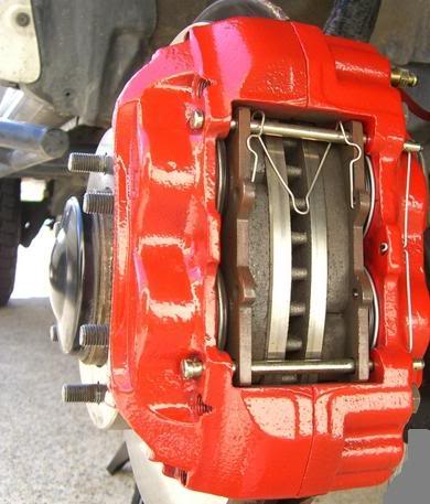

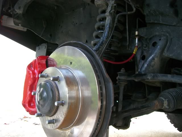

Now for the fronts - The front calipers & rotors were removed and put to the side. Mounted the new, thicker Tundra Rotors & Tundra Calipers for a test fit to see if they would rub my wheels any. Fortunately, we found no rubbing what so ever . Plus, the dust shields themselves needed no trimming either.
Next, the new Tundra Calipers were dismantled to be powder coated. Just for grins, I had them powder coated High Gloss Red. Within a few hours of being pc'd, Brian already had them put back together and mounted on the truck. Next came the installation of the hard lines, followed by the ss braided lines. Finally, bled the brakes and I was good to go!
Drove down to the local Advanced Auto and returned my stock cores for a full refund .
I can’t say enough about WabFab Off Road. Brian’s a great guy to do business with and does exceptional work. I definitely plan to continue doing business with him.
Some pictures from beginning to end:

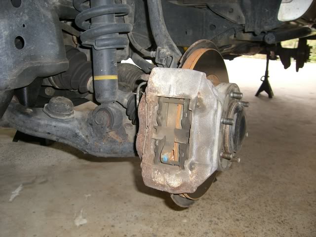

The Old:

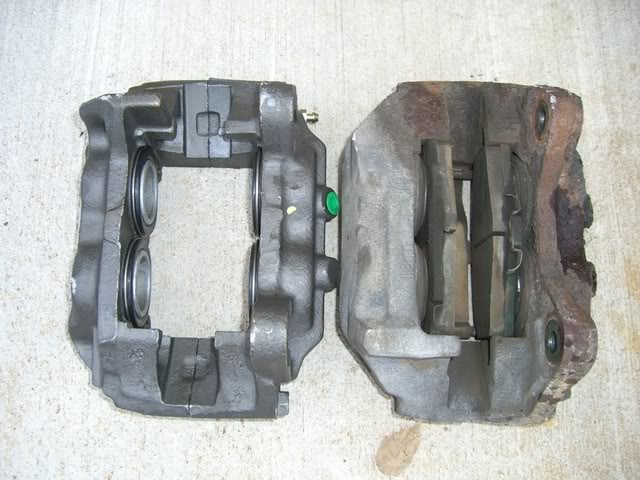

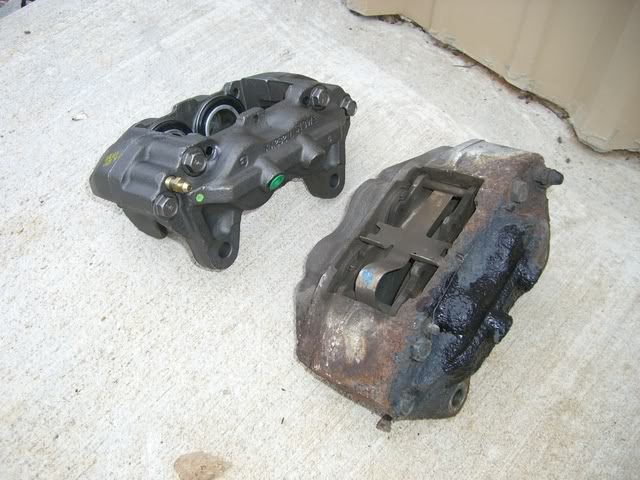

New vs. Old:

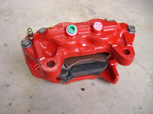

New Caliper pc'd and ready to go:

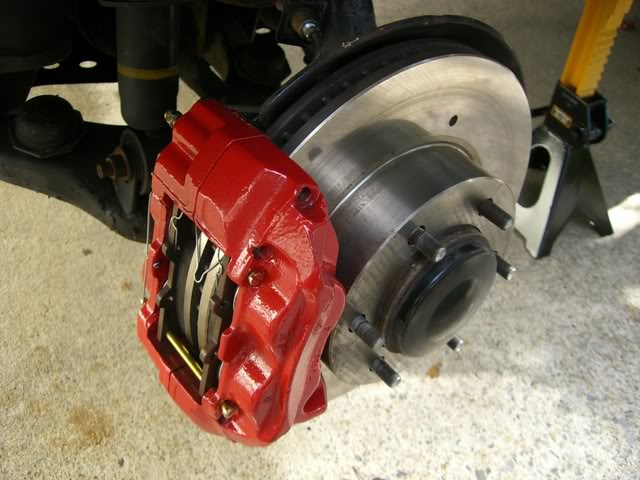

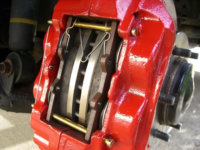

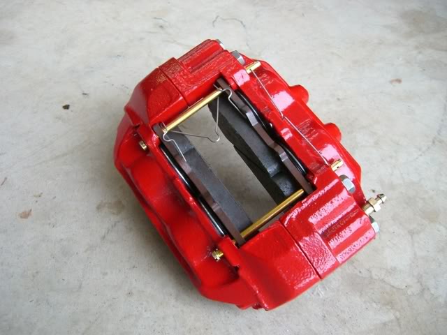

New Calipers, Pads & Rotors installed:
SS Braided Line (As luck would have it, they are red too ):

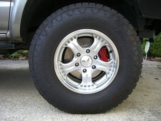

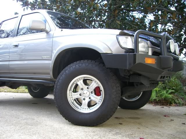

Finished Product:
