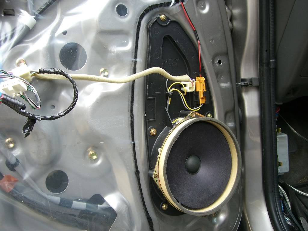

Front Speakers:
Here is a shot of the oem driver side front speaker:

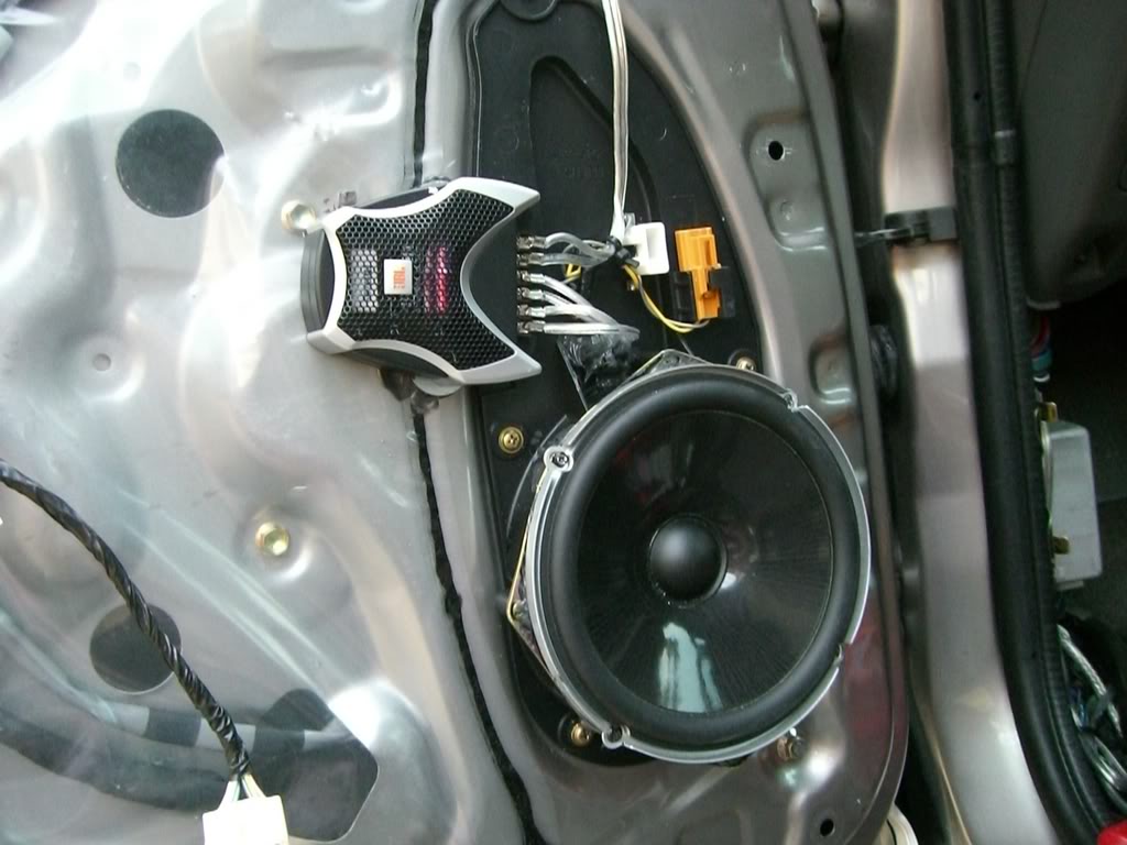

I removed the stock speaker, cut off the gold ring housing and used the ring as the mounting plate to mount the new JBLs to the speaker housing. I also placed a bead of silicone between the gold plate and speaker itself. No spacers were needed for the fronts:
Crossover installed in the door:
New JBL tweeter installed. This took only a small amount of trimming to fit:

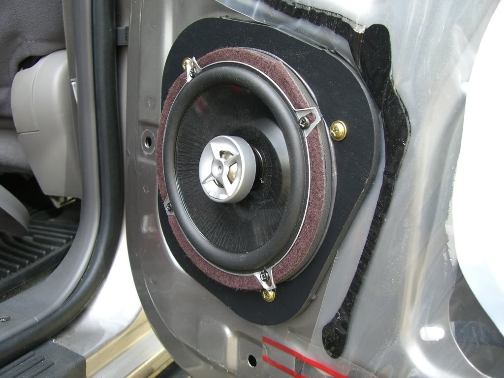

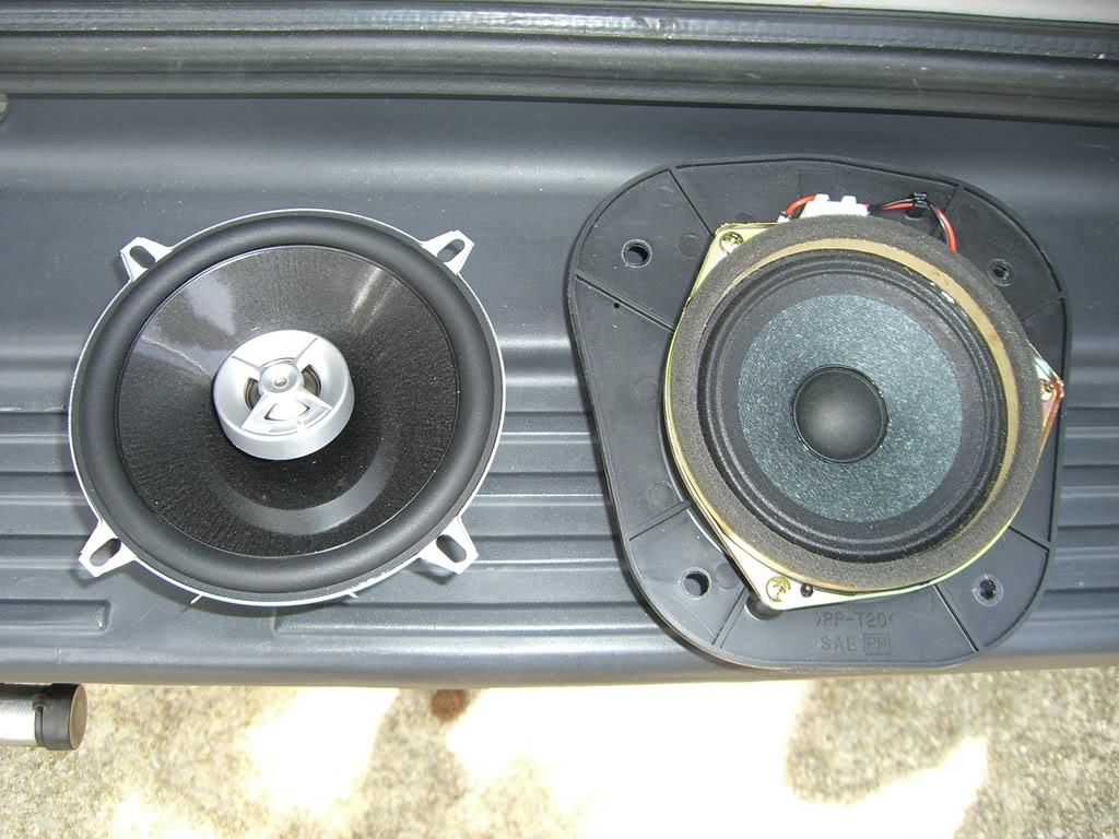

Rear Speakers:
Here is a shot of the new JBL 5.25" on the left and the oem 4.25" on the right:

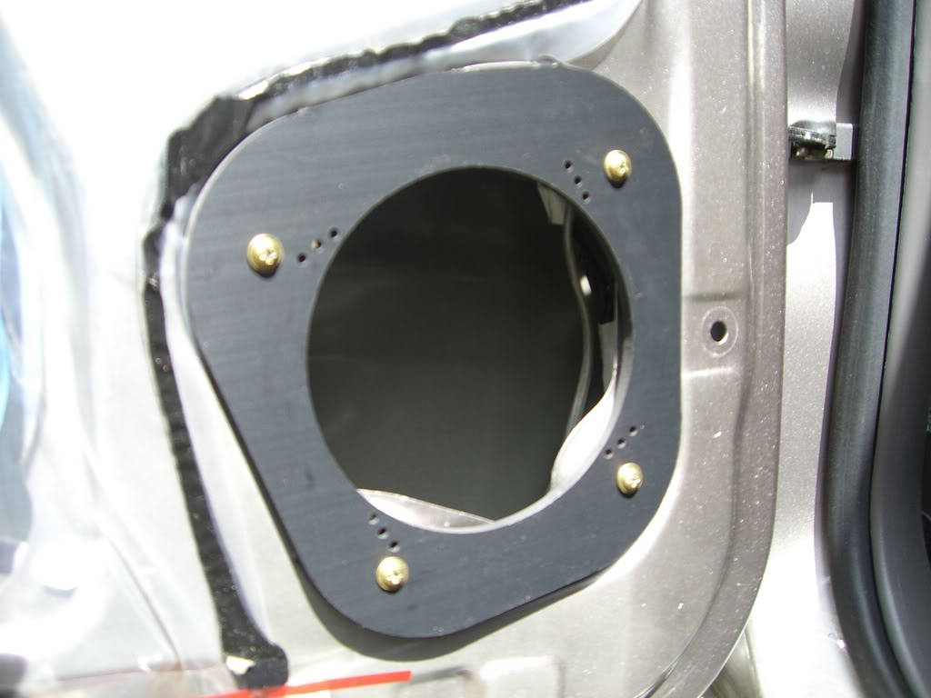

Speaker Adapter plate installed:
However, to get the new JBLs to sit out far enough so the glass would not hit the magnets when rolled down, I had to do the following:
1. First, install the adapter.
2. Next, apply a bead of silicone around the hole and place the .25" spacer on.
3. Still the speaker did not sit out far enough, so I purchased a roll of 1/8" thick, 1/4" wide felt with an adhesive backing from Lowe's and then placed that on the spacer.
4. Finally was able to mount the speaker.
Had I just purchased a set of 1/8" speaker spacers with my original order, I would not have had to buy the roll of felt.

No problem! Look at these 2 pictures again:
This of course is the stock photo. Everything is factory in this picture:
This is what I did:
1. I removed that big black oem speaker housing.
2. I removed the oem speaker from the black housing.
3. I lliterally cut off the gold ring of the oem speaker using a pair of snips. (This gold ring is actually part of the entire speaker.) This ring will now be the mounting point for the new JBLs.
4. I drilled 4 small holes in the gold ring that would line up with the 4 holes already in the new speakers.
5. Now that the gold ring was finished, I placed a bead of silicone between the gold ring and black speaker housing and then screwed the gold ring into the same holes on the housing where it originally sat.
6. I let that dry, then placed a bead of silicone on the top of the gold ring, mounted the speaker on the ring and then screwed it down in the new mounting holes I previously drilled in the gold ring.
Now look at this picture...you can actually see 2 black screws going into 2 of the new holes I drilled into the gold ring. (Top of picture & bottom of picture) The gold screw is the oem screw. This hole was already there. As you can see at the very bottom of the picture, the black screw does not actually screw into the black housing. It is just to hold the speaker to the gold ring. That is how the other 3 black screws are set. That's also another reason for all the silicone. I did not want this speaker falling out:
Fortunately, the new JBLs were very similar in size to the old speakers, so I did not need any spacers to keep the window from hitting it. I did do a little trimming to the inside of the door panel, but it was more for precaution. Wanted to make sure that panel did not touch the speaker.
Again, here is a picture from the first post w/ everything installed:
If you need me to, I can take a picture tonight of how my old speakers now look to give you a better idea what I snipped off if that helps. I still have them laying around somewhere.

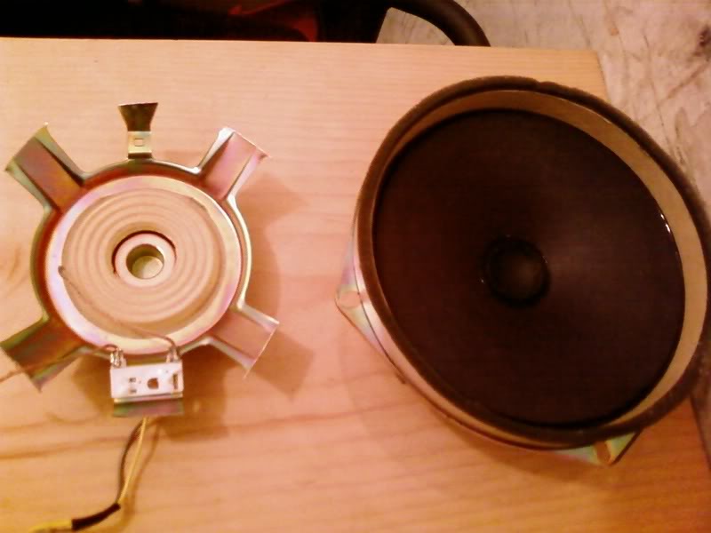

So i followed your advice and cut off the gold ring on the stock speaker..How did you manage to get the wooden piece and the rest of the speaker coke off of the speaker? with a heatgun or what?
Old May 25, 2007 | 06:11 AM
Rock Slide's Avatar
Joined: May 2006
Posts: 2,262
From: B'ham, AL
I think I just took a razor blade, cut a slice down into the wood ring and then just took one of the cut ends and ripped it off. You will have some black silicone still left on the gold ring, but you can just take a flat tip screwdriver and scape it off.
Don't worry about having to save this wood piece for later...you will not need it. You have already cut up your speaker in such a way, that your speaker cannot be be reused anway.
Good question though.
For anyone who is unsure what the gold ring is we are discussing, here are 2 comparison photos. These were taken when I had cut only one gold ring off:

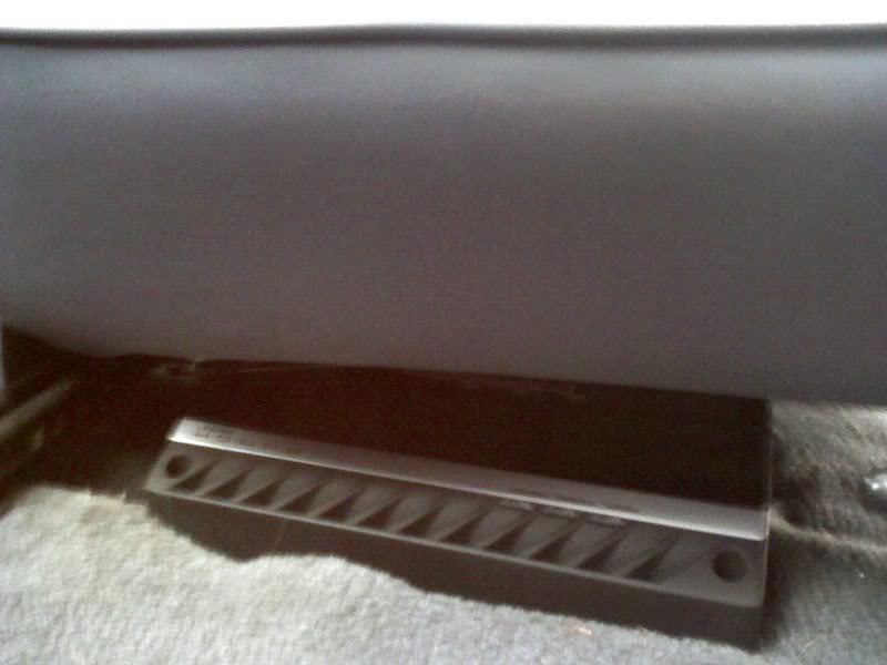

not to hijack your thread but heres my finished install in my taco:
Specs:
Alpine Type-R 6.5" Components
Rockford Fostage P400-2 Amp (100 watts RMS x2)
The amp fit PERFECTLY under the seat great choice for mounting there.
The tweeters are in the door panel becauase I have a taco and have no stock tweeter location. They fit perfectly there and dont look too bad IMO
