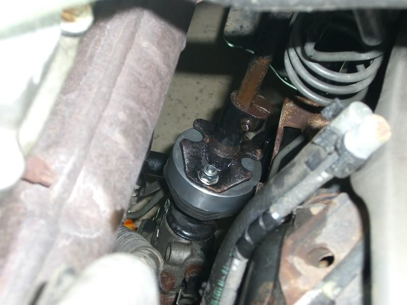

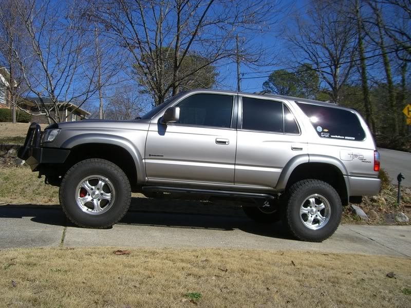

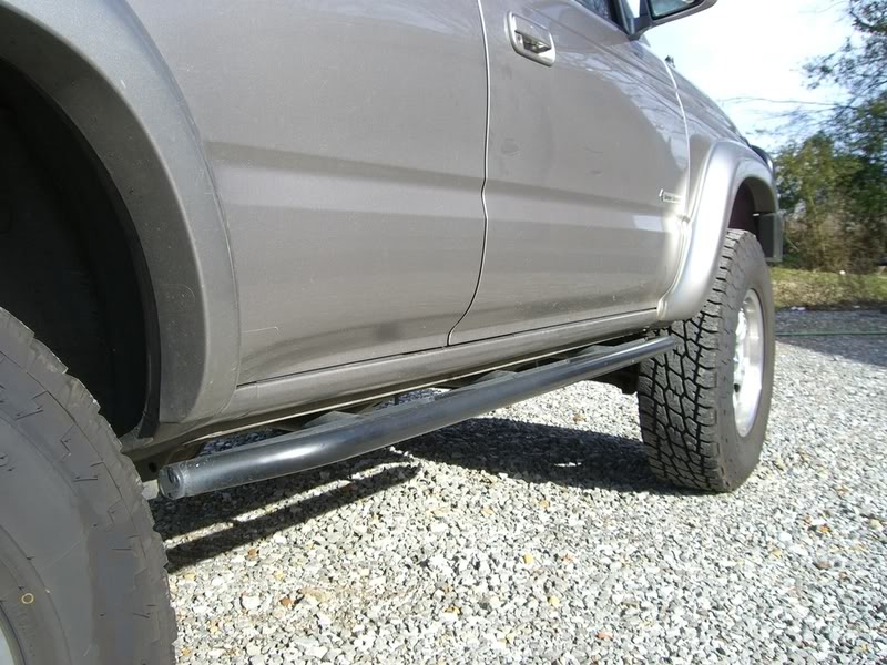

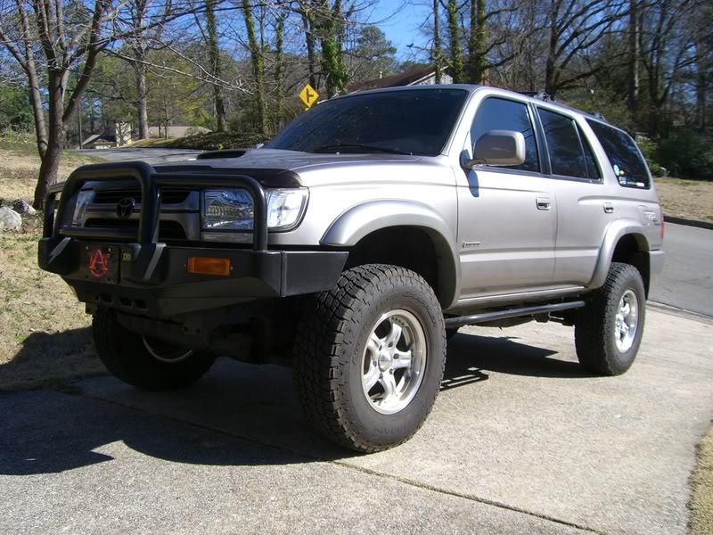

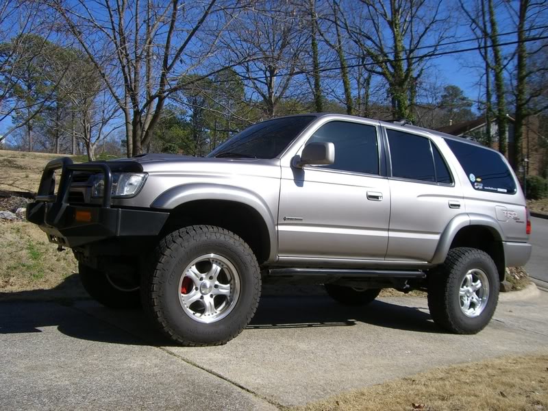

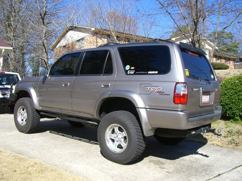

Got my 1” Body Lift installed a couple weeks ago. Purchased the steering extension from 4Crawler Off Road.
I also took a page out of Steve’s book at Sonoran Steel and installed a set of rear fender liners to cover the gap created by the BL . I then sprayed undercoating over the liners and the wheel wells to make every thing blend together. More info on what Steve did can be found here: Click Me.
I’m very pleased with the overall results of the BL and Fender Liners . Pictures below:
Body Lift and Steering Extension:
Before:
Body Lift Installed:
Steering Extension Installed:

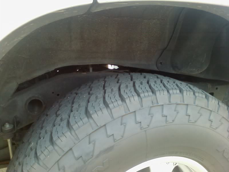

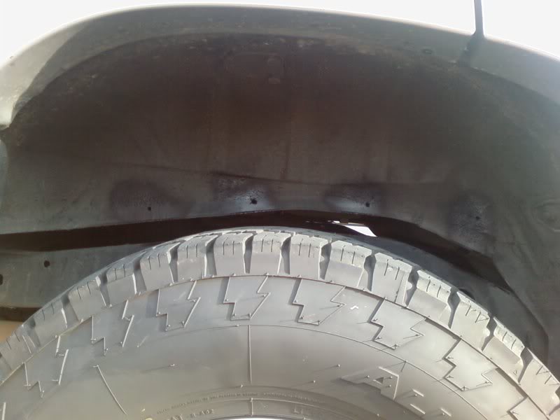

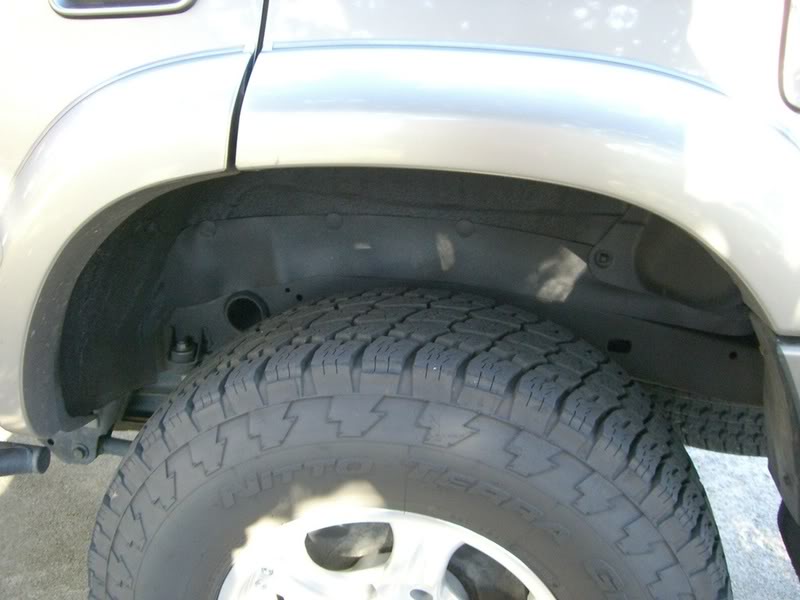

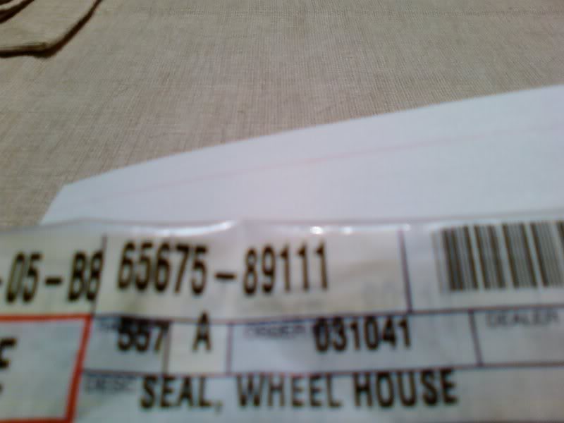

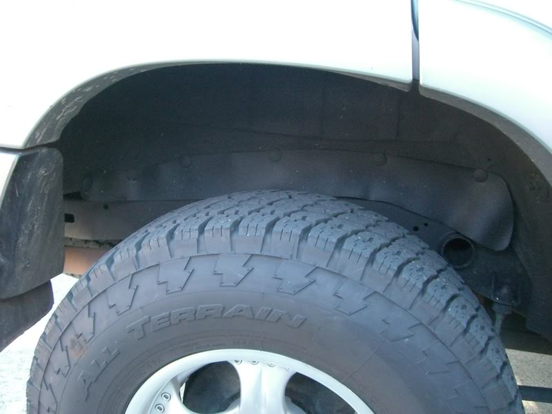

Here’s some info on the rear fender liners that I used to cover the gap created by the BL:
- Wheel House Seals (2), Part No. 65675-89111
- Clips (9), Part No. 90467-A0003
These Liners have 5 holes in each. I had to create an extra hole on the passenger side fender…so I used a total of 6 clips on that one. However, for the driver side fender, I only used 3 clips. I used 2 existing clips that hold the gas tank filler cover to the body.
Fender Liners

Rear Driver Side Body Gap:
Rear Driver Side After Liners Installed:
Passenger Side Body Gap with New Holes Drilled:
Passenger Side After Liners Installed:

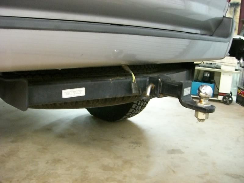

One Last Picture for Good Measure:

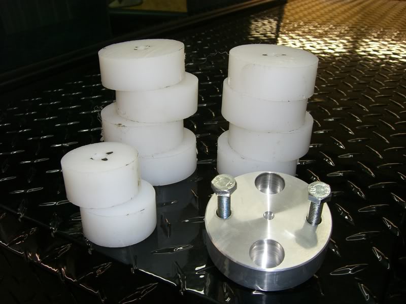

if you have any tools it's pretty cheap to make the lift yourself. i think i spent about $20 on UHMW, and maybe an hour on the jigs to slice and drill it.
dangit, i had a pic of all my pucks but i have no idea where it is. oh well, they look identical to all the other ones :d
