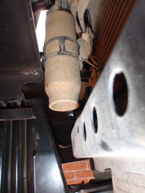

5) ARB front bumper required new mounting holes be drilled. 1" lower (for reduce bumper/body gap):
and 3/4" further in (to help push bumper out/away from a/c receiver drier. Still very close though):
In my case, ARB bumper was brand new and first installed immediately after body lift.

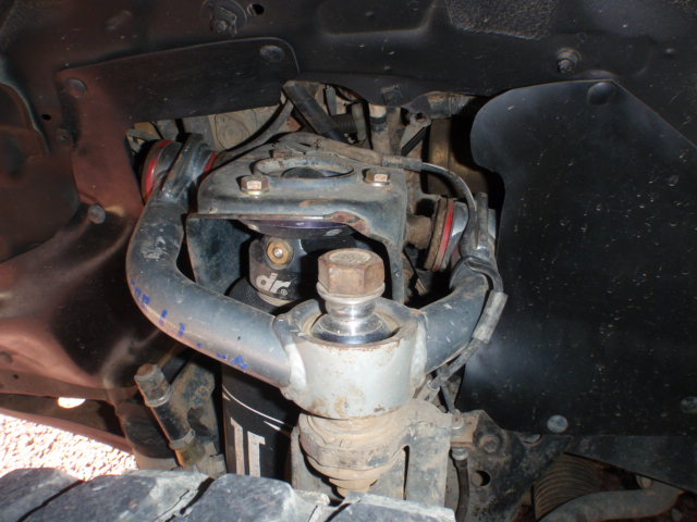

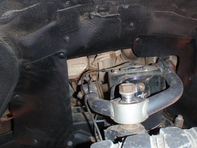

9) Removed all four factory splash guards from front wheel wells. Used these as templates and made new ones from sheet rubber to accommodate the new 1" difference. Here are some pics of my new custom splashguards.
Right side:
Left Side:
