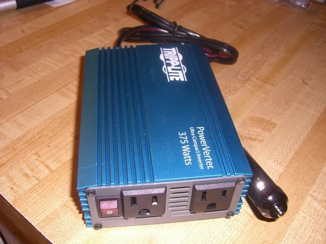

I took an idea out of member J.A.'s book and purchased a 375wt Power Inverter. It's nice b/c of its compact size and the fact that it can plug into any aux. outlet in your vehicle.
The cord attached to the unit is only 3ft long. For it to reach where I wanted to install it, meant either lengthening the cord or bring the power source closer. I did not want to see any wires, so I decided to bring the power source closer.

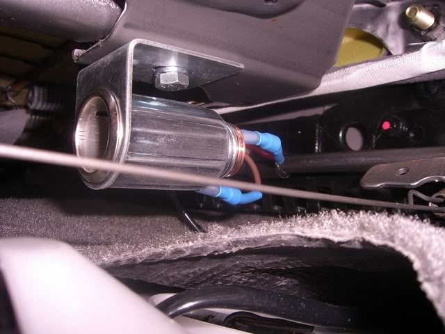

I bought a seperate aux. outlet for $5.00 at Walmart and installed it under the passenger's seat. (There was already a hole there, so I just purchased a bolt, lock washer and wing nut to secure it to the seat.) I simply tapped into the existing cigarette lighter (that I never use) and ran the wires under the trim and under the carpet:
375wt Power Inverter:
Aux Outlet Installed under Passenger's Seat:

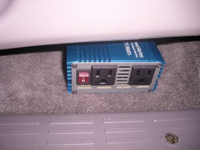

Unit Installed:
Unit Installed:
