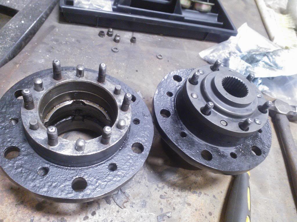

Close! They are creeper flanges from TG. 30 splines on the end, chromo with 4 extra dowel pins (stock has 2) . the ADD flanges are 27 spline because they are for CVs. However, flanges for a FJ80 will work, but are about 50 a pop, and not chromo and still uses 2 dowel pins.
If you poped off the cover, you would see the end of the shaft coming out with a snap ring on it.
It was either $120 for the hub gears to make my IFS lockouts work on the SA, or 140 for flanges... and I sold my IFS hubs for $100, so it worked quite well. IF this truck was still driven on the road, it would just changed hub gears in the lockouts.

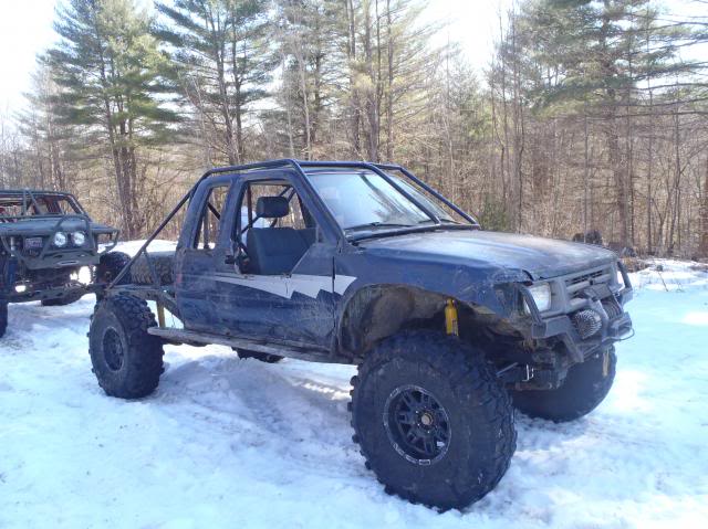

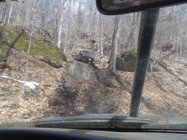

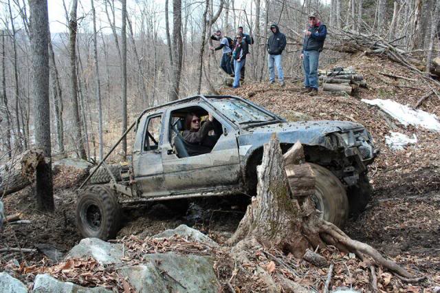

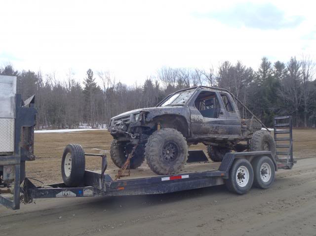

Went really well!
His battery died half way up, So I came up to jump him.

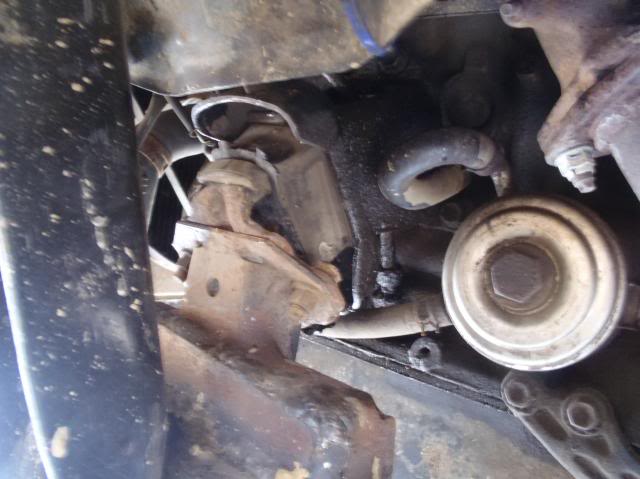

Then, poped the hood to check the oil and noticed the engine was sitting a little crooked, quick check I found this:
So that ended my day a tad early, but ill pull them out and through bolt them and be done with it. A lot of people were taking pics today, so hopefully some more pop up.
Was a wicked awesome day. Sunny and 60.
Oil leak/antifreeze leak didnt slow me down too much, but needs to be fixed. I need to adjust the passenger side bumpstop, and I lost a bunch of power steering fluid (atf) out of the cap. Then after I fix all that, ill finish up those doors.
Rest of the pics I took here: http://s179.photobucket.com/user/edi...20april%202014

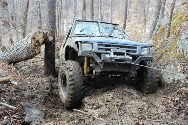

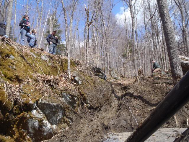

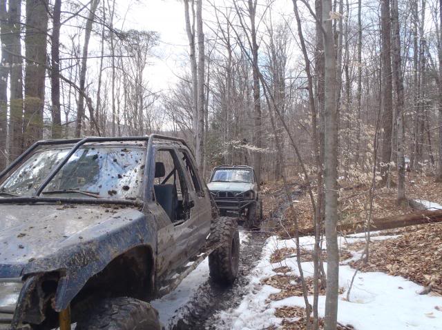

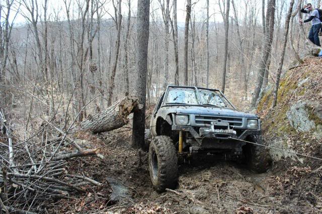

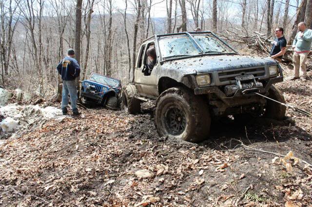

Got some moar, other peoples pics.
Trailer line up
First hill into the property
Second Hill, thats the jeep with the dead battery.
Faster than the camera..
After winching up that hill and a short one right before it, I needed to let my battery charge back up. While doing that we hooked the next guy onto my rear mount and started bringing him up the hill.
Man what a great day.

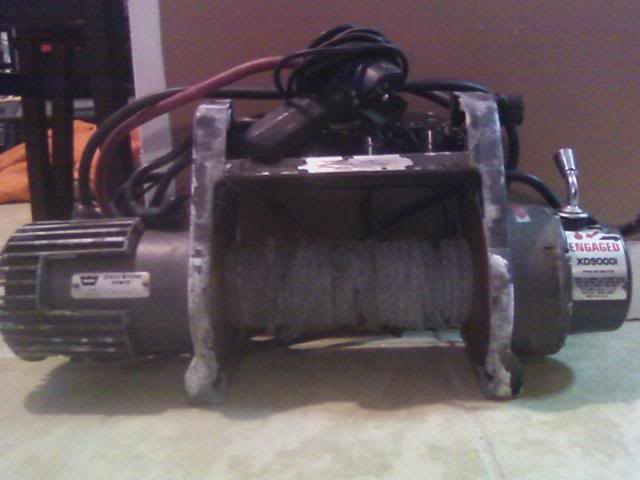

It was a blast! Winch is a Warn Xd9000i that I picked up a few years ago for cheap and rebuilt. https://www.yotatech.com/forums/f31/...evival-250910/

Im sure there are 4x4 clubs in your area...
