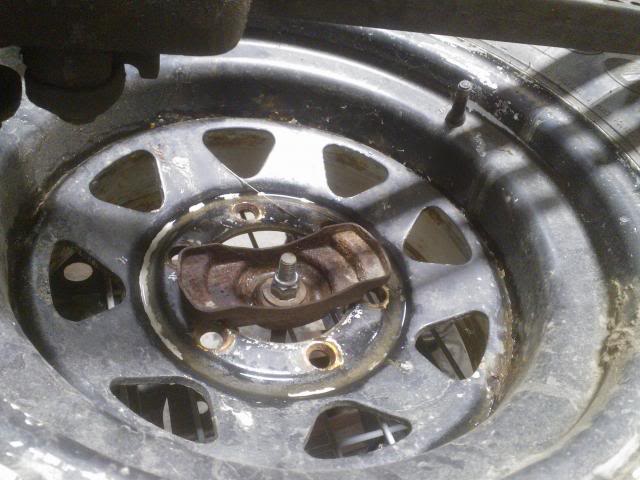

The drive flanges make it easy too, I dont have to unbolt the lockout , just pop off a dust cover to get to the snap ring.

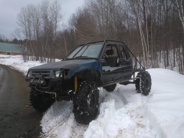

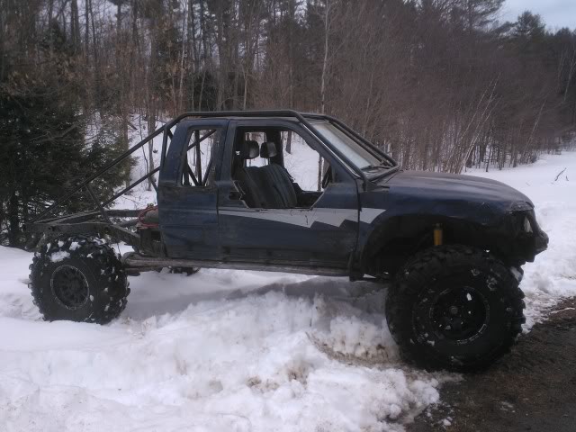

Front "spool" works mint! Snows starting to melt so I didnt get stuck in the field this time. Half doors back on. Still need to be cut down a bit and capped.

They dont open anymore. Need to get in dukes of hazard style, which really isnt that hard. They are being held in bu the latch and the top hinge. Should have them finished up by next weekend and start on the bed area.

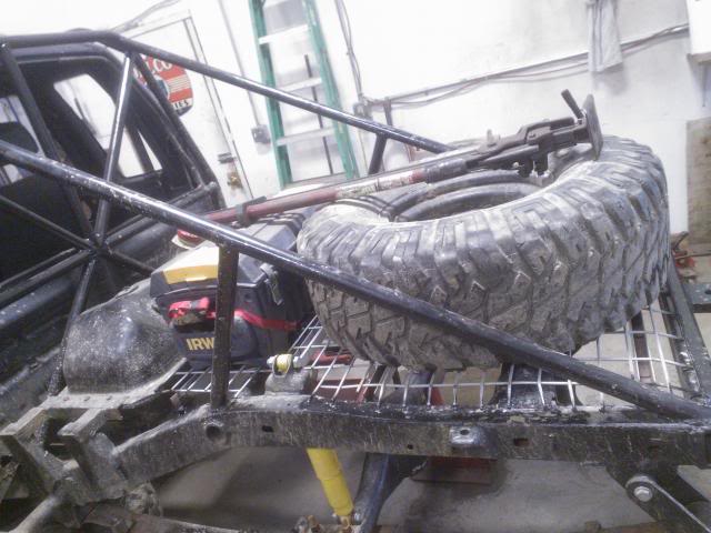

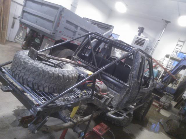

Made a bed space out of a piece of pallet rack. Small U channel supports welded to the frame keep it pretty rigid. The grate allows me to attach pretty much anything to it. Tire is on by a piece of threaded rod with an old piece off a chevy tire carrier. Hi lift will probably end up on the back of the X brace.

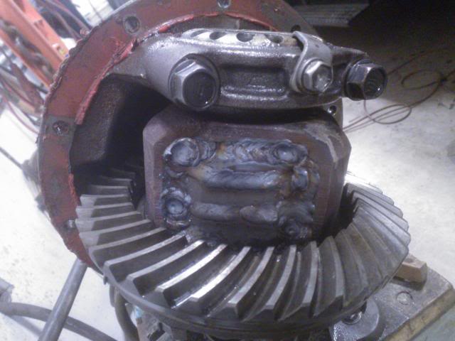

Oil leak ended up being the back cam cover. Was able to turn each of the bolts a bit without taking off the plenum, and it seems to be working. So in testing, the rear end started making that same slipping sound the front did.
[youtube]-MfqEAjOQ2A[/youtube]
So I fixed that one too.

Snap, Crackle, Pop! Good job on the new "lincoln locker"

Homemade locker looks good!!

i actually read through your entire build. Wow what a change your truck has become. So im wondering cause i cant tell since your front diff is welded now do you still have lockouts or just the dustcap??Might be a stupid question but im trying to get this ifs hub swap figured out when i get my knuckle rebuild kit in i have a half a$$ idea what im doing. Youve really tested your ifs by the previous pics on your build. I can only imagine what youll be able to conquer now. I really like how your running that pitman arm with the notched frame and how you built your leaf packs for the lower stance,you definetly accomplished it.
Old Apr 10, 2014 | 09:10 AM
  #420
FourwheelinVT's Avatar
Joined: Aug 2010
Posts: 165
From: South Royalton, VT
He is using the drive flanges that come with add instead of locking hubs. They have a center hole that allows the dust cap to be exposed.
