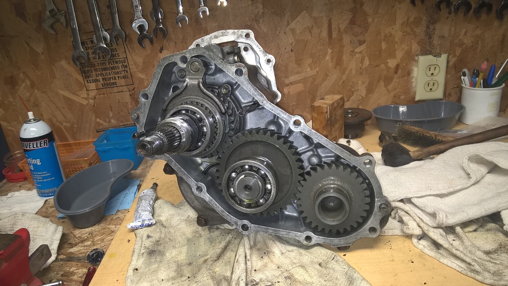

Some re assembly, but had to stop when I found the splines on the front output were twisted! Oops.
Twisted splines
Ill be picking up another case tuesday for parts and get it back together.
If you don't have any luck,finding a case I am pretty sure I have a good.front spline/output I could send you, just pay for.the medium flat rate box.

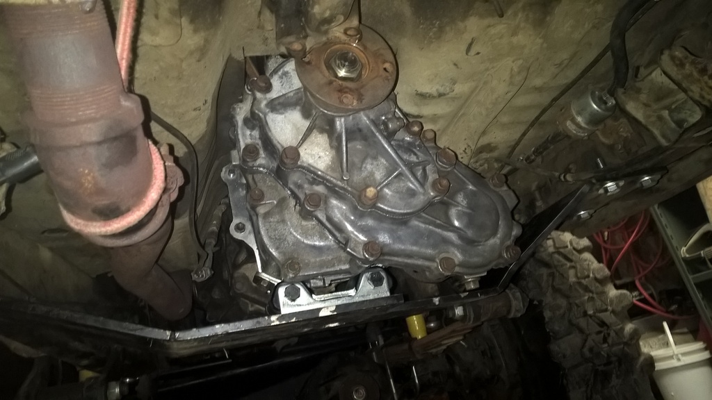

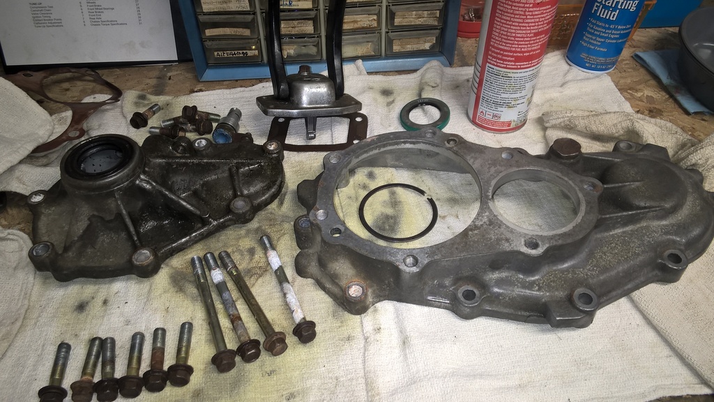

Hey thanks! Thats good to know! I ended up getting a top shift case for $60, but it had been sitting in a field uncovered for a bit. Took me 3 hours to get the front output out. 4 bolts needed a 13mm punched on , and 4 broke heads off, and 1 needed to be cut off. But I won. Haha
Should get it finished up tomorrow.
Little more wire brushing and well have it back together. 1/2 way done with the one on the right, still need to do the left case.

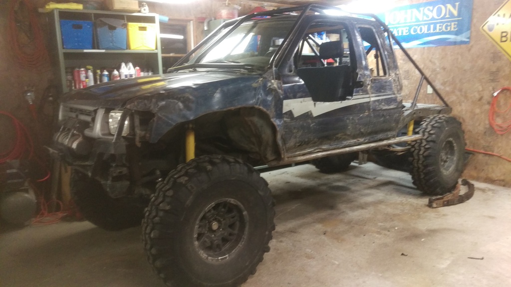

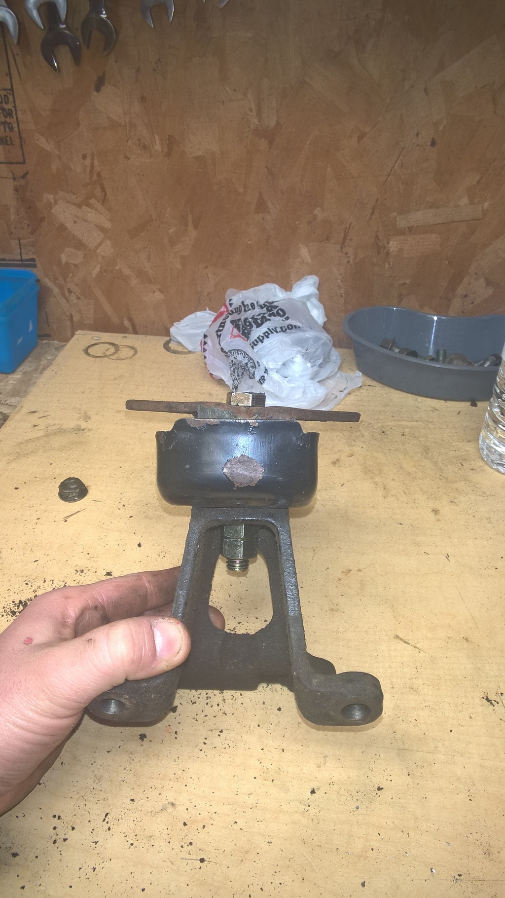

Took the time to through bolt the pass side engine mount to match the drivers side. 1/2x3" grade 8
Retorqued the high steer arms and ubolt, greased the drive train changed the tranny fluid, went through and organized recovery gear. Shell be already for a little wet spring wheelin next weekend! Even washed and vacuumed the inside!

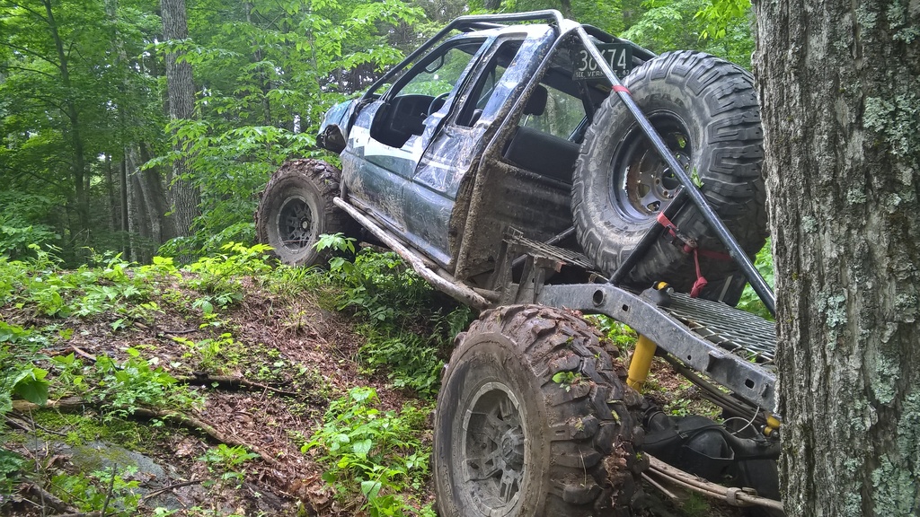

Whent wheeling I did. One of those rare time that nothing broke and the truck did awesome all day.
Same trail later in the day
And some random dash vids.
And a few photos.

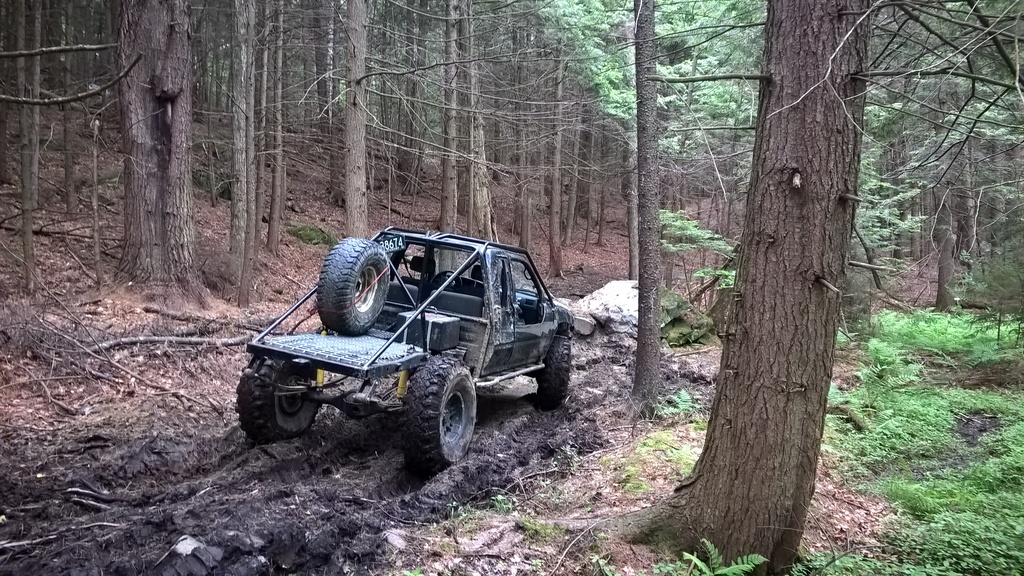

Wheeled a few weekends back, same place as before. The Jungle in Bethel Vt, it was much wetter but nothing broke.

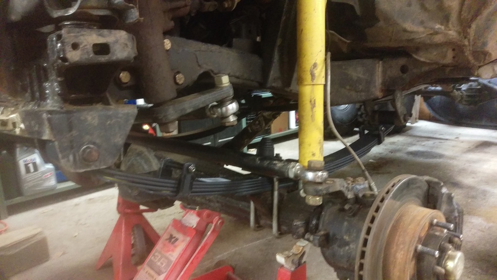

Springs are on. I pulled the long overload but left the short one. Got about 3" of lift from them over my old springs. The spring clamp may hit the pitman arm, so ill have to watch that when flexing it out tomorrow.

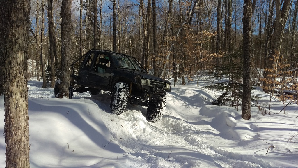

And a couple wheelin pics from the summer.

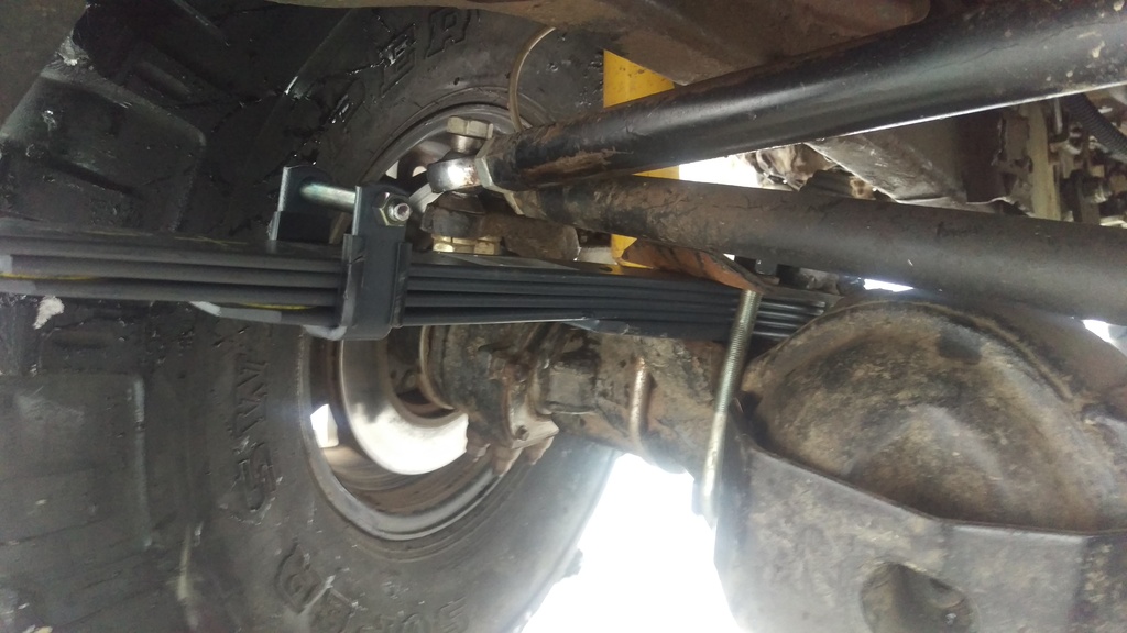

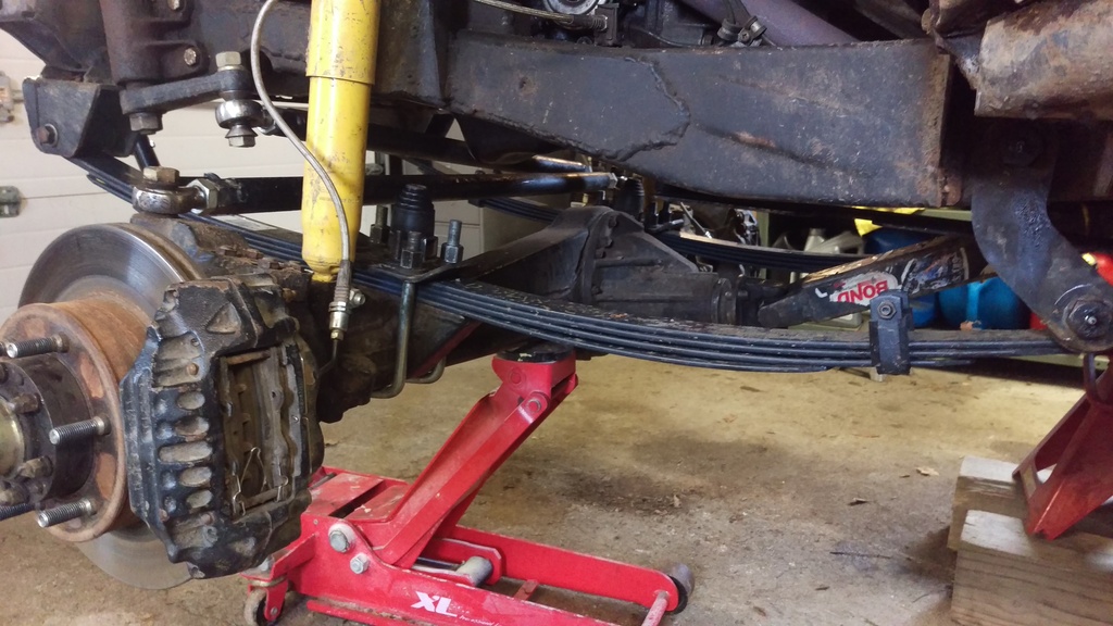

Been playing around with the front springs, and I found when flexing that the springs were bending around the over load.

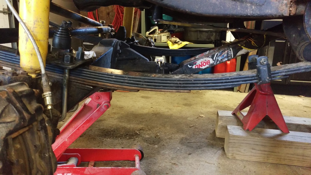

So I pulled it out and drove around a bit, but now there wasnt enough support on the lowest leaf. It is pretty long, and the looked like it was starting to "w".
So I pulled 2 short leaves out of the stock pile that came from a Downey pack to hep support the bottom leaf. Seems to be working so far.

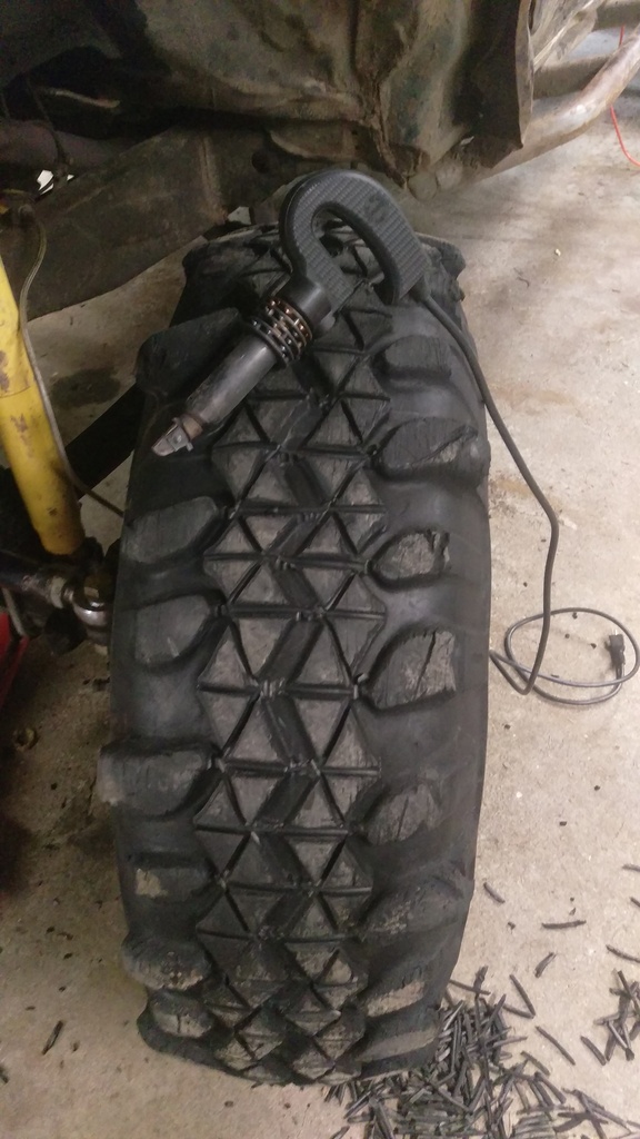

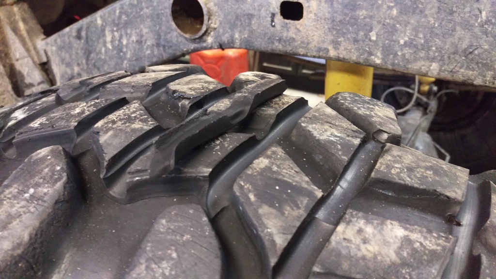

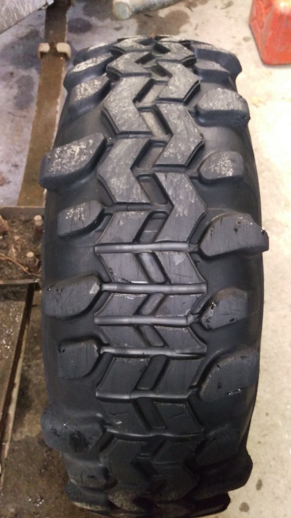

Did a little re grove on the front tires.
I have a wider square blade for a different pattern on order for the rears.

Thanks dropzone! I figures why not, couldnt hurt!
Used a 1/2 blade for the rears with a simpler pattern, just to open the lugs up and take down the wear bars and help with tire flexibility.
How much rubber comes out with this blade.
