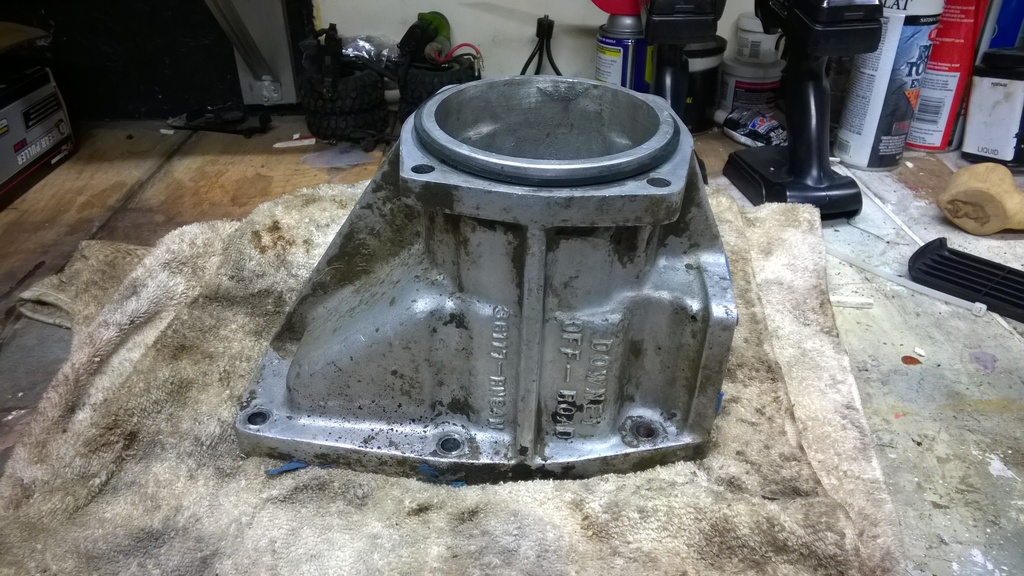

Found a deal on a old school Downey 2wd th350 to toy adapter. Ill need to get a new coupler as the one that came with it is 21 spline, and my case is 23.

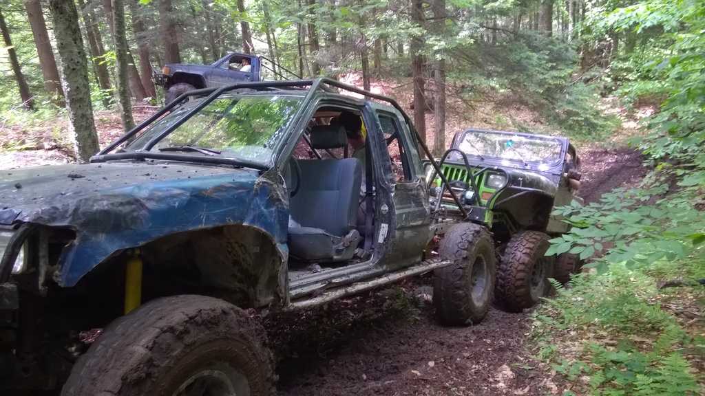

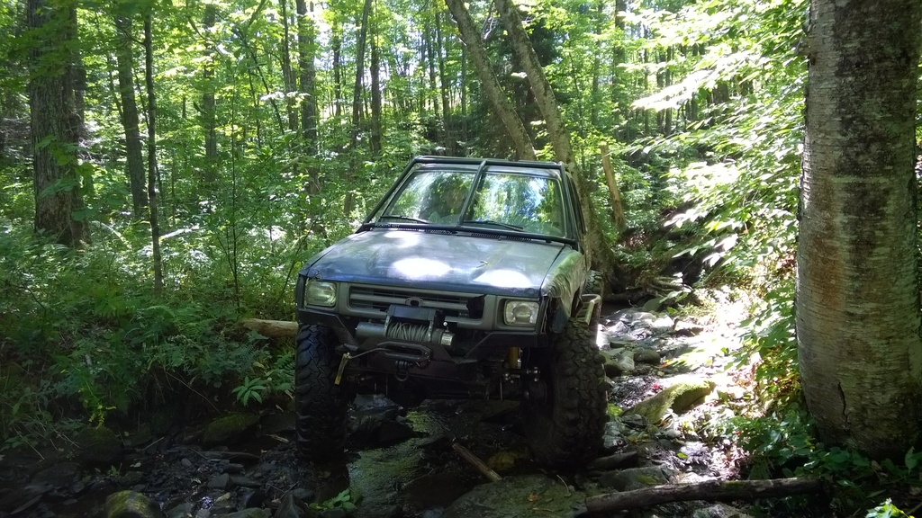

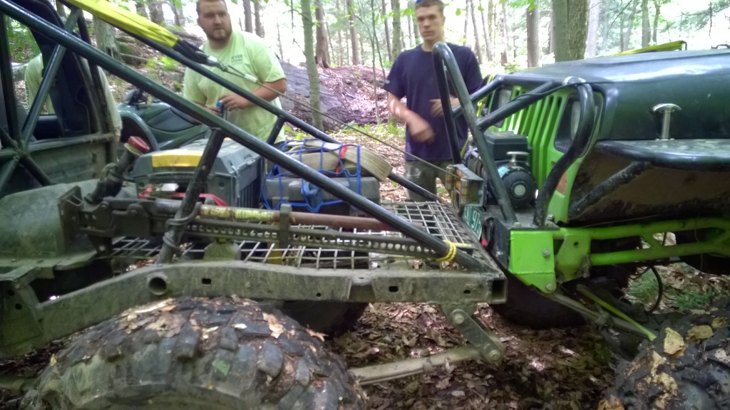

Did a little wheelin today, till a yj ripped it steering box off the frame. So we piggybacked it on my truck and hauled him out.

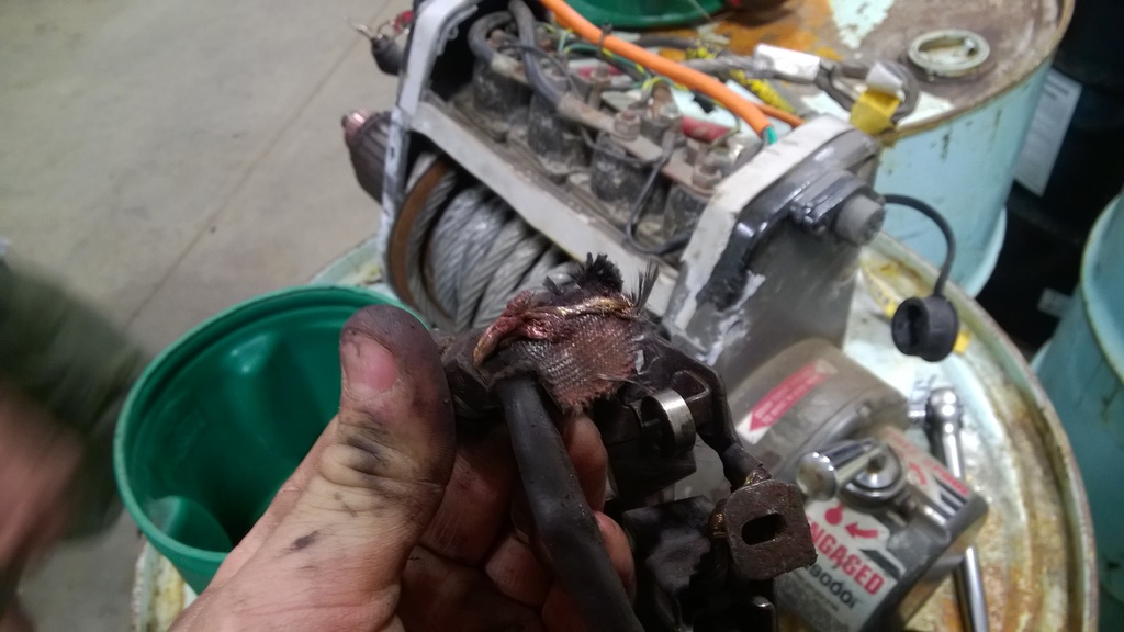

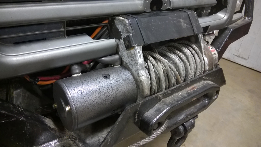

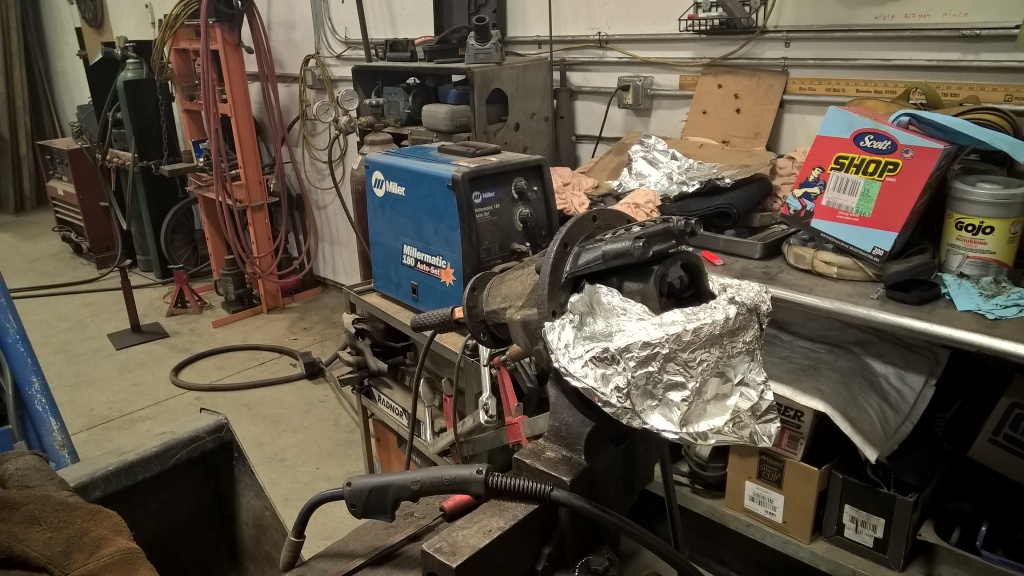

Was having some problems with my winch, when I would use it it would kill all power to the truck. took it apart to find a wire rubber raw, also broke a terminal getting it off. Warn doesnt sell motor parts, but they will sell me a new motor for $350. They also recommended taking it to a starter/alternator shop, which I will try next. If that doesnt pan out, I found generic replacements on line for about $85.

As for updates, I havent fixed the winch yet, the old motor is rusted on there and isnt budging, but I have a few more ides before I give up and bring it some where. But I bought a DB electrical replacement motor. Its a china motor, but for $82 shipped to my door ill take that chance.

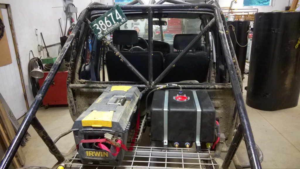

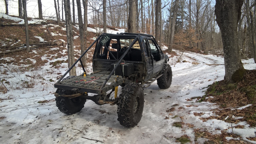

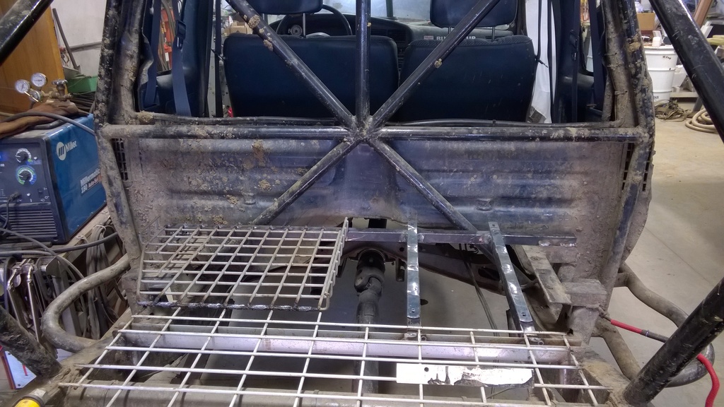

Made a frame to hold the tank and add some more pallet racking out of some 1" square, which allowed me to move my tool box for better access Fuel pump is mounted in the angle iron that was the old tank mount. Still needs some finishing touches, but Works great so far!

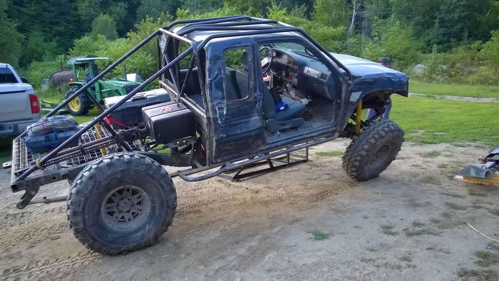

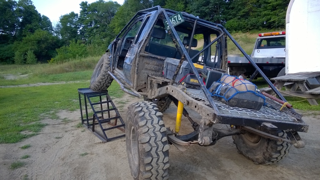

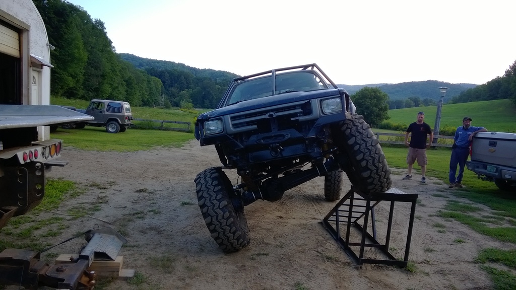

Drove down the road to a friends shop to pick up some parts and catch up, also did a little flexin.

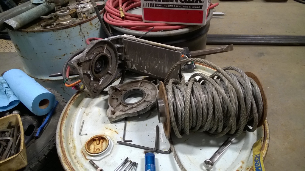

Had to take the winch completely apart to get the rusted motor out. It was seized into the bearing, which was crunchy sounding too. The DB electric motor came with a new bearing, so it went back together.

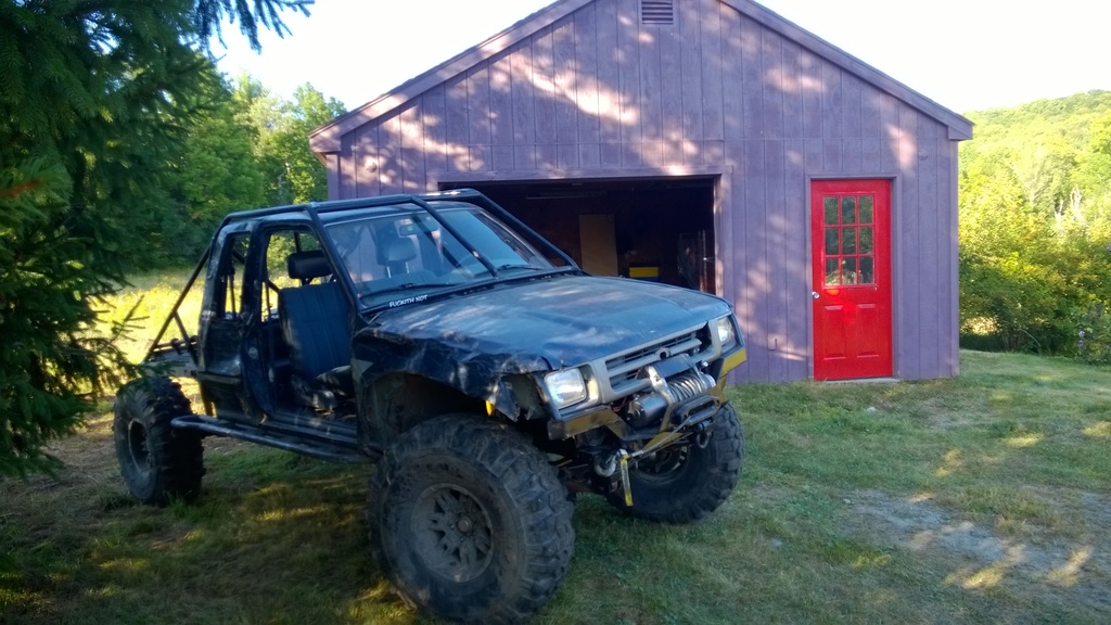

]My fiance and I just bought out first house. Nice little 10 acre chunk in Northfield VT. Mostly field but some stuff to play on, and eventually there will be a rock course some where on the property. But what Im most excited for is that for the first time in 5 years, my truck is at where Im living. And I have my own garage. And as soon as I get it set up I can get the truck in and get working on some maintenance issues!
Leaving my folks shop in Royalton, just a short 30 min tow. It will be back in November for a trail ride here.
In front of my own garage!

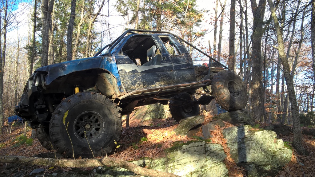

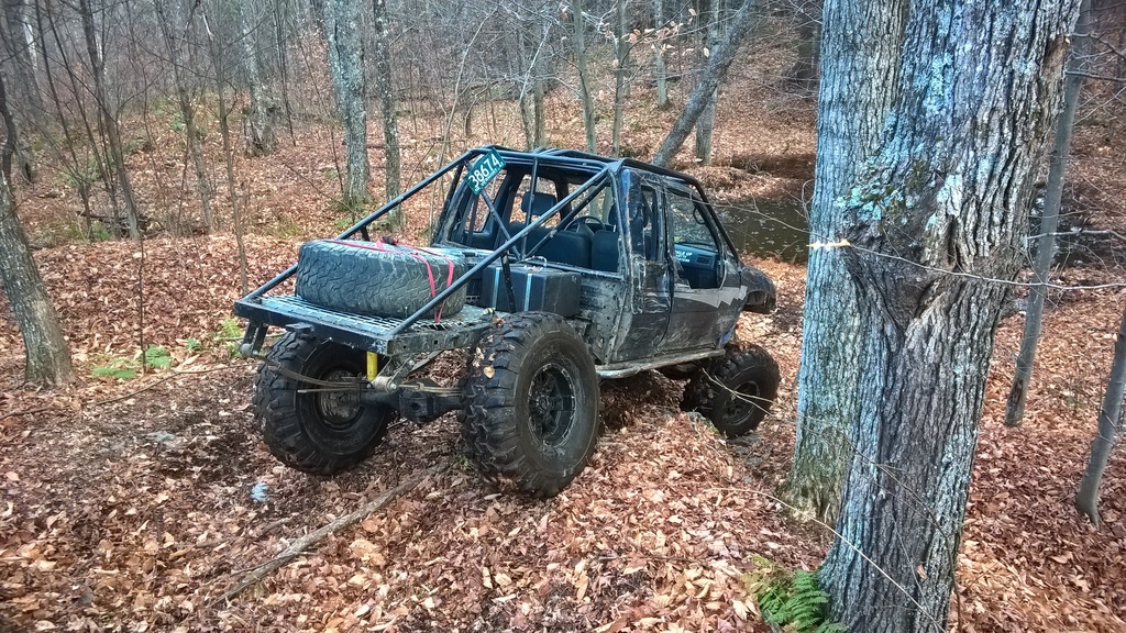

Been a bit since an update. My Nov trail run went great, wheeled a bunch, not many pictures.

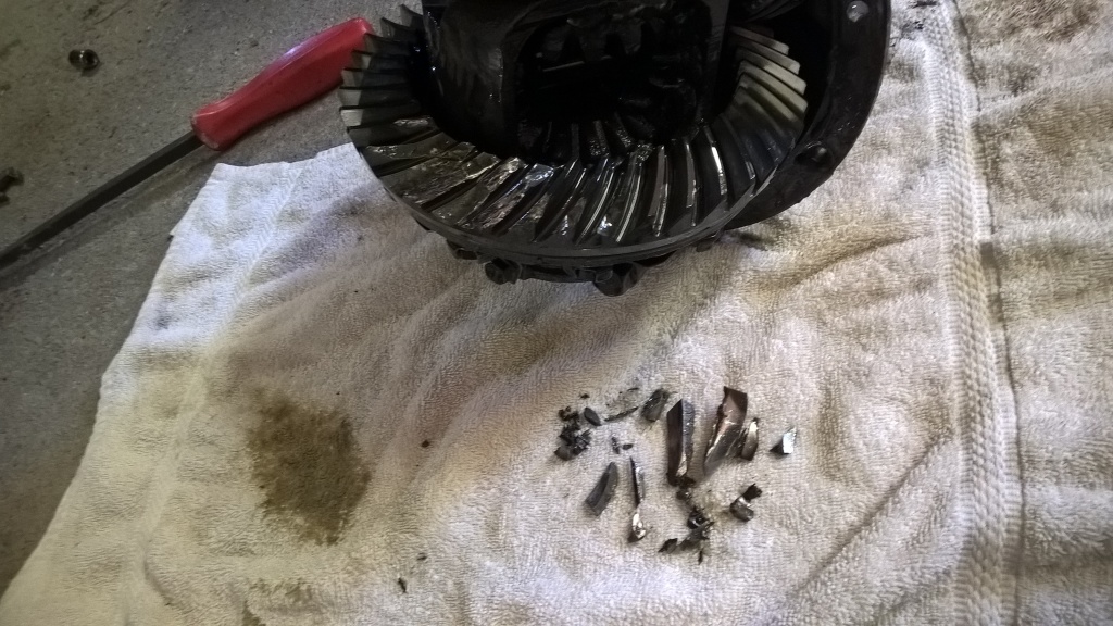

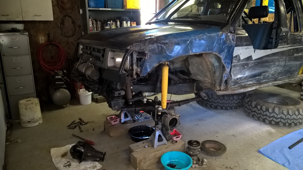

Made it 10 min into our Dec run and the front r&p let go. The front end bounced and when the spinning wheels hit the ground it was all done. ting ting ting ting.
Walked the rest of the day and then dragged it home to get fixed.
Used 4.10 3rd, welded up and ready to go.

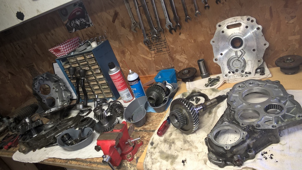

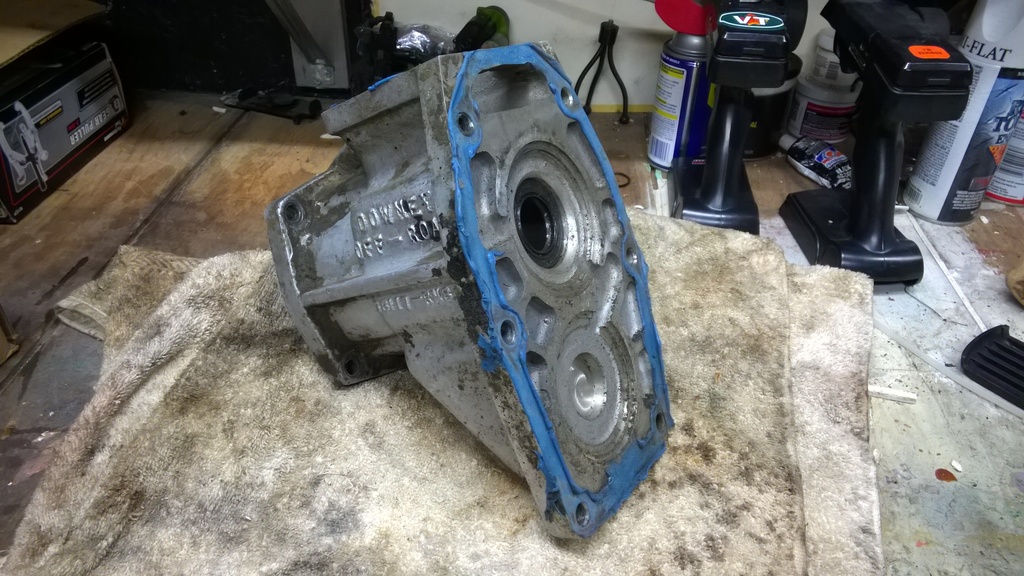

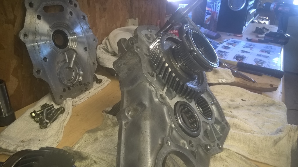

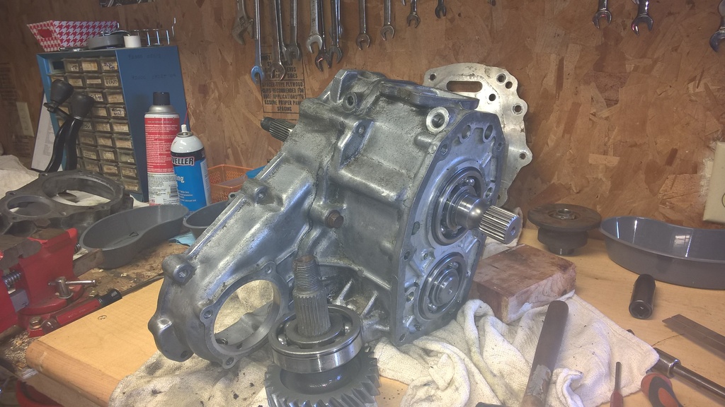

With the first gathering of the season right around the corner, time to get some maintenance done. First is to address the leaky t case.

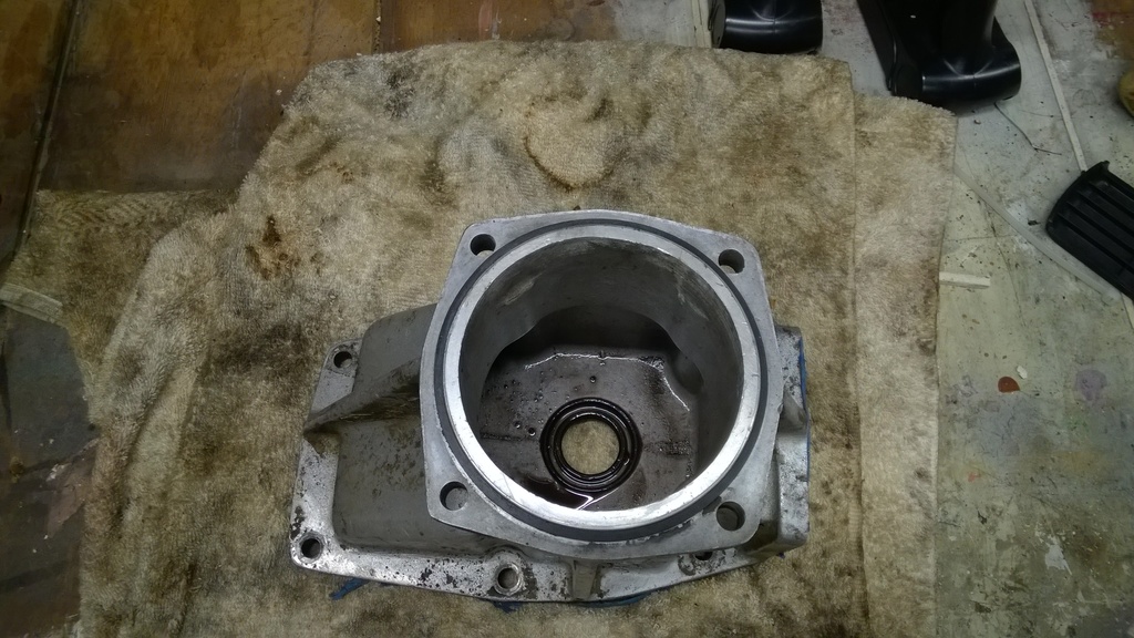

And a little tear down.
Time to start cleaning and re assembling.

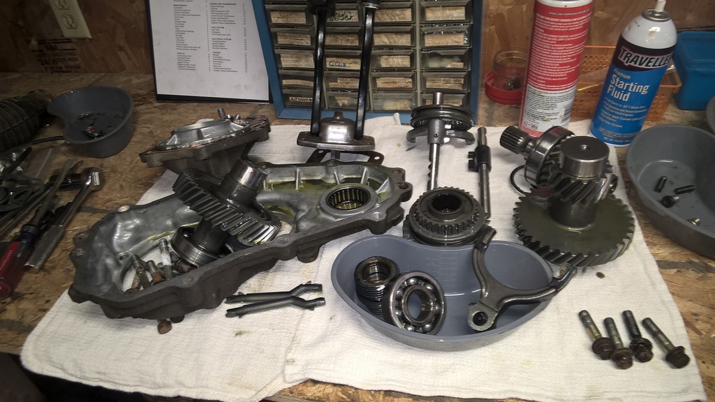

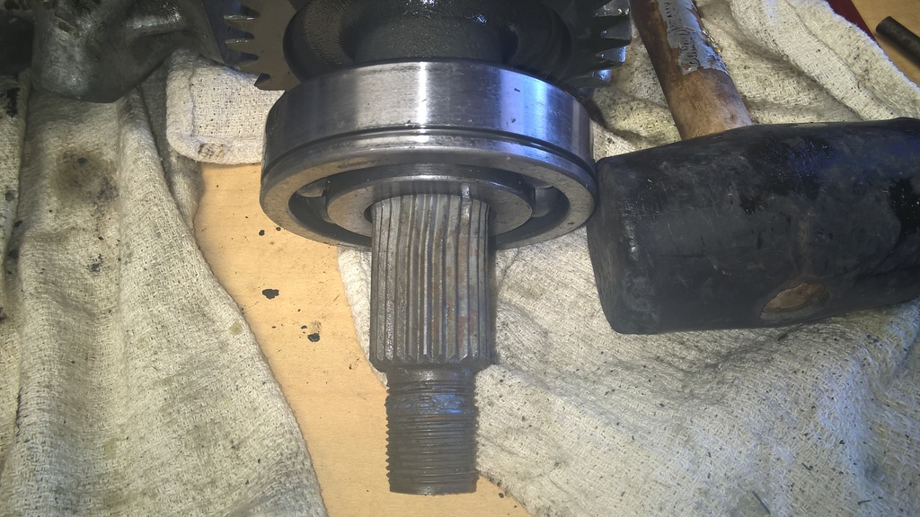

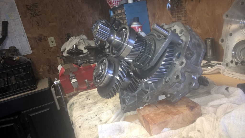

Some re assembly, but had to stop when I found the splines on the front output were twisted! Oops. Probably happened when the front ring and pinion went last December.
Reduction gears
Twisted splines
Ill be picking up another case tuesday for parts and get it back together.
