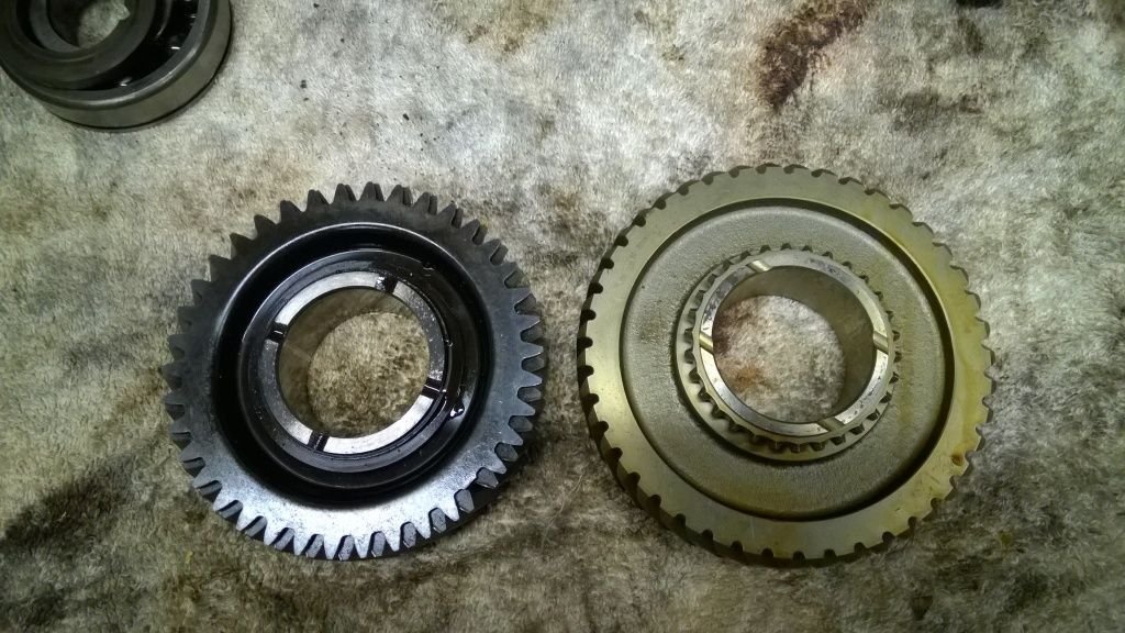

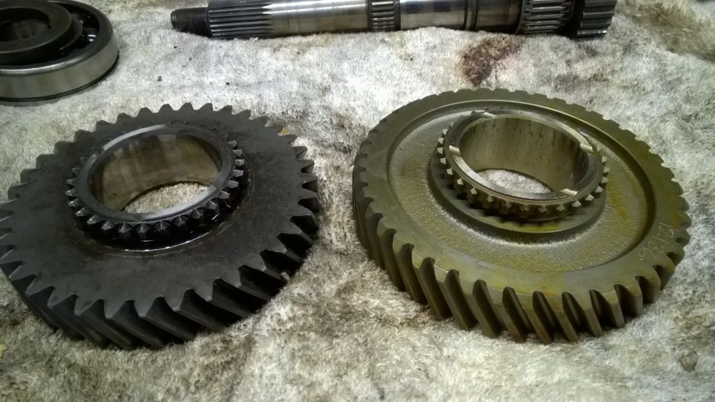

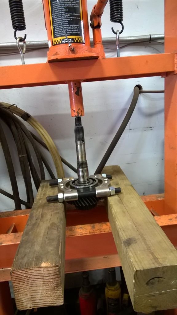

No one local had pliers. Found some on amazon and got them here quick (prime)! On to the next steps!
Pressto!
The 2.28 gear vs the 4.7 gear
Going to clearance the inside of the case tonight for the new gears.
Last of my parts have been ordered, twin stick top shift conversion and the 23 spline coupler from AA that Im missing. Should all be here some time next week.
