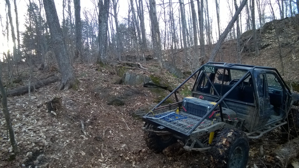

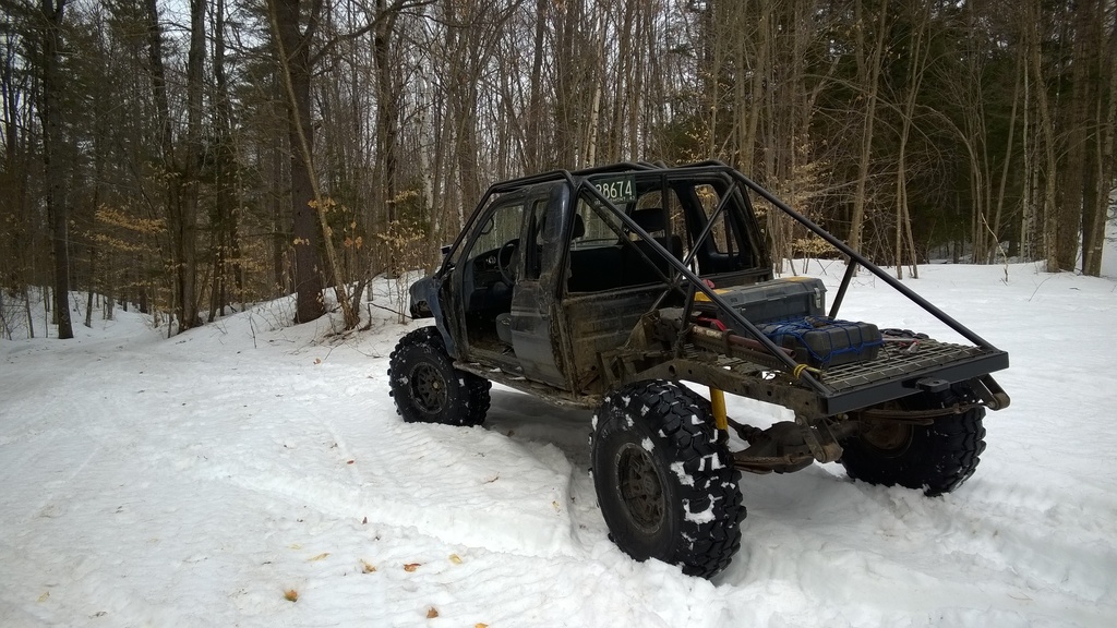

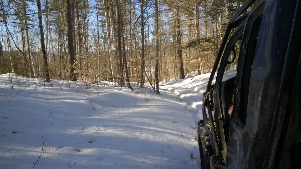

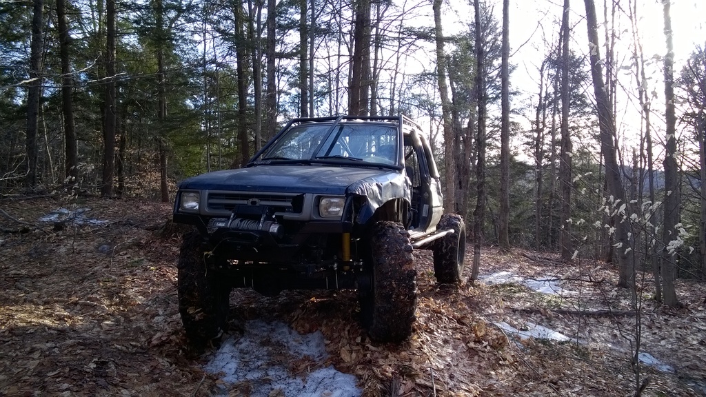

Got up into the woods a bit today, but it was slow going. Still about a foot and half of snow that starting to melt out, making it very soft. Headed back to deal with some engine oil leaks. Rear cam seal on the pass side and dist o ring should seal it up.

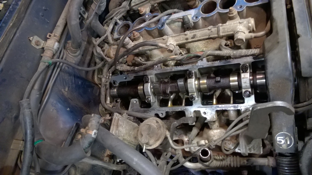

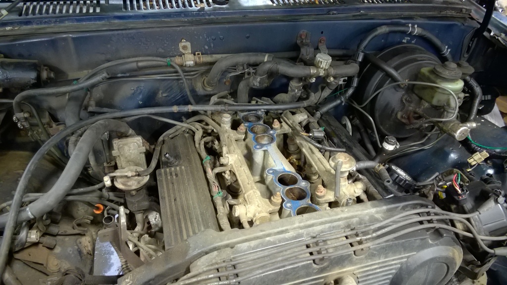

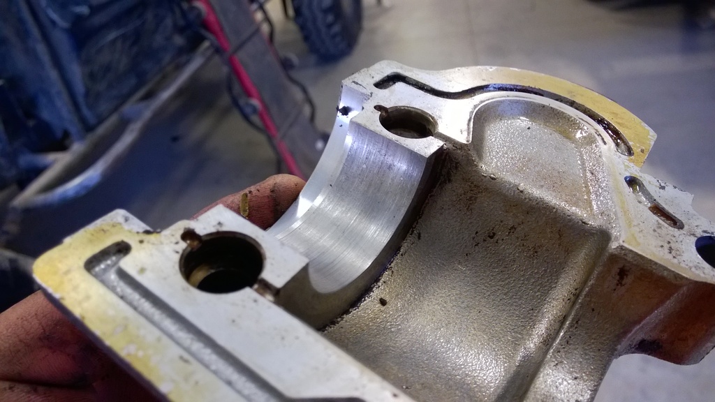

My rear cam cover was the cause of the oil leak.. but the cam bearings didnt look too hot. Guess I better get movin on prepin the 4.3 to go in.

yikes. Big old glob of assembly lube and a prayer and awaay we go..

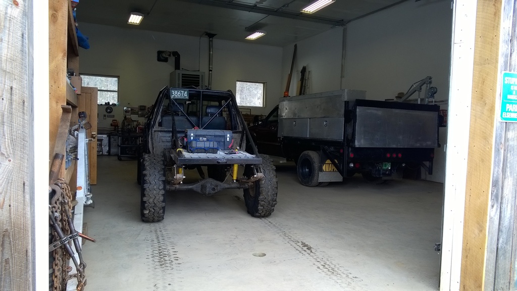

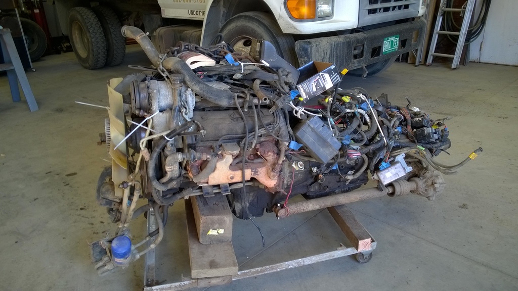

Made a little cart to move the 4.3 around on and pulled it out of the corner. Time to start causally working on this guy.

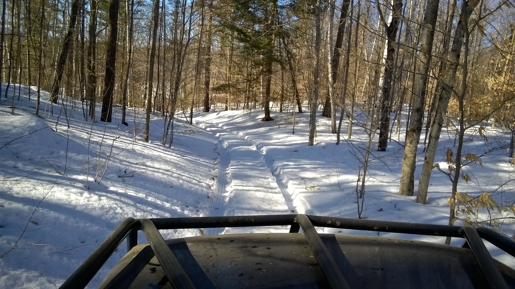

Made a few new climbs over the weekend, shooting to have a trail ride here mid may.
