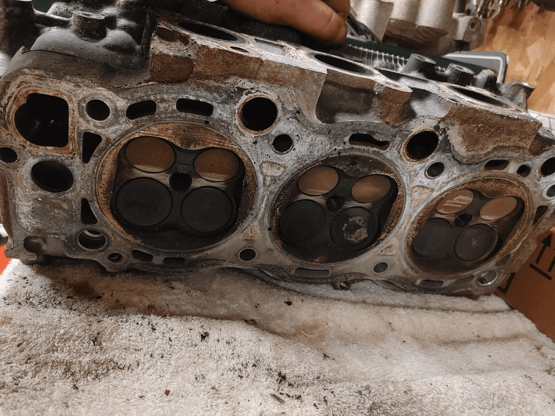

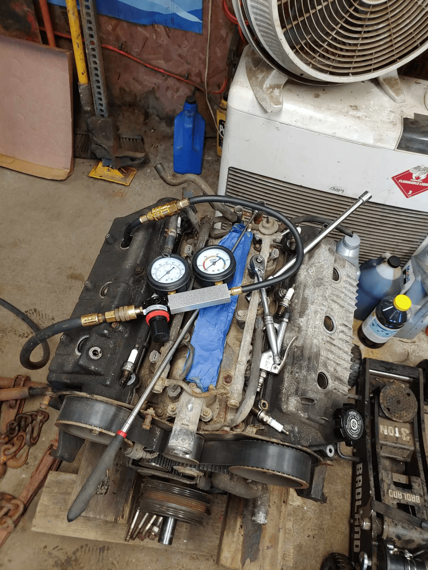

Did a leak down on the old motor. Cylinder #5 is the culprit. When we applied air to the cylinder, it leaked out the pilot bearing/rear crank bolts holes..somehow. Ill pull that head off and see what I can find.
I got the "problem" side of the old 3.4 off, I dont really see any reason for failure. HG looked fine, didnt see a crack in the head. Ill evaluate more and pull the other side off, but a little stumped right now on how the coolant was getting in. The white between the valves was me with a brush looking for cracks.
