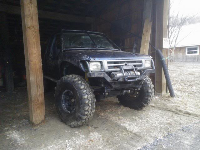

No leaks! Seem to be holding up well. Quick bath, to get it ready to go back in the shop to address a few things. Motor mounts and engine leaks are first, then I need to change around my front leafsprings, then I can finally finish up the half doors.

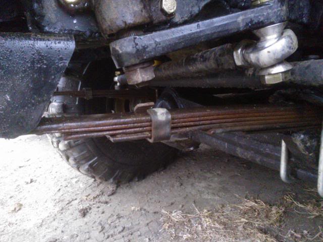

Here you can see where the thicker newer Downey (2nd from the bottom) springs arent bending as much as the softer worn 48" spring. Im going to take them out and change them up a bit.

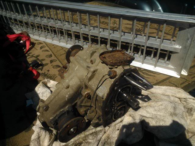

Got a killer deal on a forward shift, that ill convert to a top shift.

Trail gear makes a kit to do so, or there is a DIY option which I will probably give a shot. I think ill be picking up a top shift with bad gears in it, so I can steal the shift rails off that one.
http://www.pirate4x4.com/forum/toyot...onversion.html

Dont mind at all! haha. It depends on your transmission. You can use a forward shift if the transmission came with one behind it, if not then you use 2 top shifts. But the rear case must be a top shift, because the shifter must sit on top (not on the crawl box in front of it) And the shift rails cant come through the adapter plate.
Marlin t case bible: http://www.marlincrawler.com/tech/tr...fer-case-bible
Good t case read> https://www.yotatech.com/forums/f116...r-case-231669/
Toyota engine/tranny stuff faq: http://www.4x4wire.com/toyota/faq/parts/
Since I need an adapter to get a gear drive case behind my tranny, Ill need 2 top shifts if I go duals.

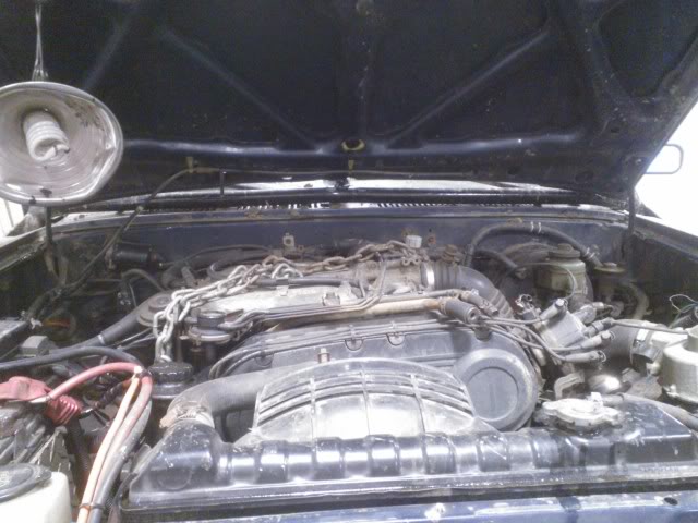

Heres the crooked engine, that led me to find the broken motor mount. That and when I hit the gas the shifters went about 2 inches to the passenger side.

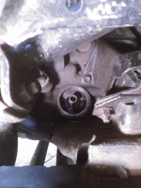

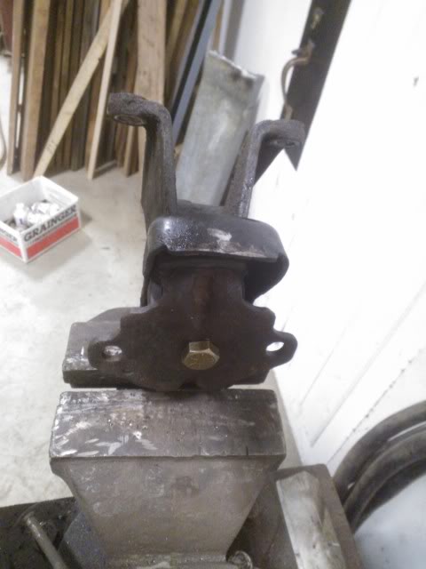

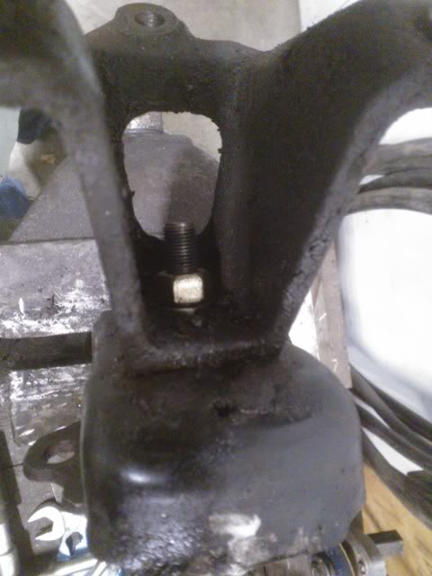

Drilled and put a 1/2 inch grade 8 bolt through it, Marlin style. Tightened the nut just enough to close the lock washer.
Thats a 3.5" bolt. You dont have to pull the mount off the engine as long as you can unbolt the rubber part, I did because I didnt know, and it makes it easier to get to the nut. The hole in that engine side mount is already 1/2". But if you do decide to take the mount off, you have to pull the oil filter and dip stuck tube to get it off.
