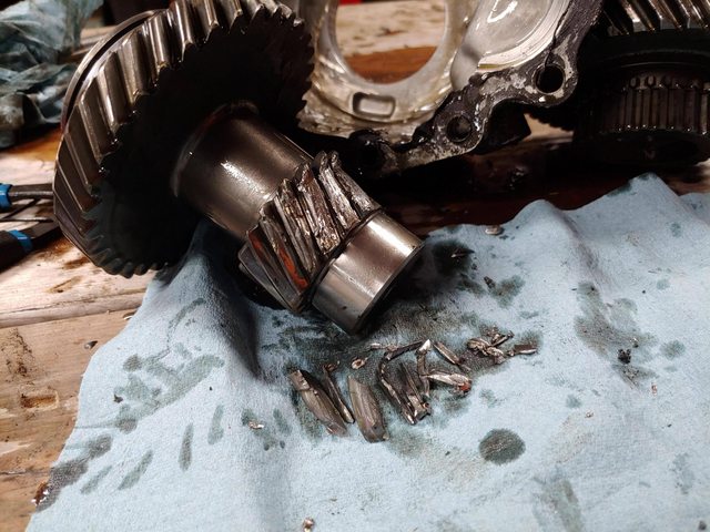

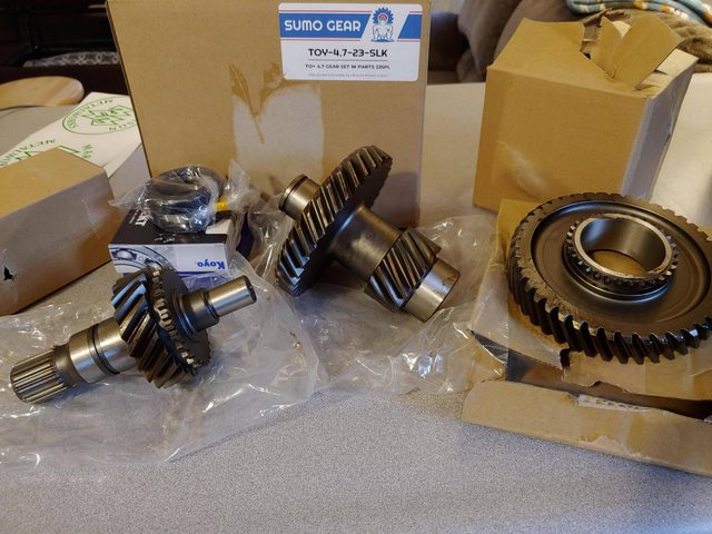

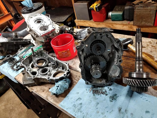

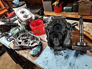

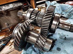

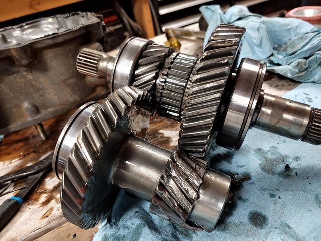

Well after 6 years, my TG 4.7 gears gave up. Bearings and case all look ok (but I got new bearing anyway). Im assuming my 4.10 diff gears have something to do with it but too late now. I have a set of SUMO 4.7 gears on order. As soon as they show up Ill be back to crawlin.

SUMOs came in last week and got everything back together and so far working great. Also took the opportunity to put fresher bearings in the case.

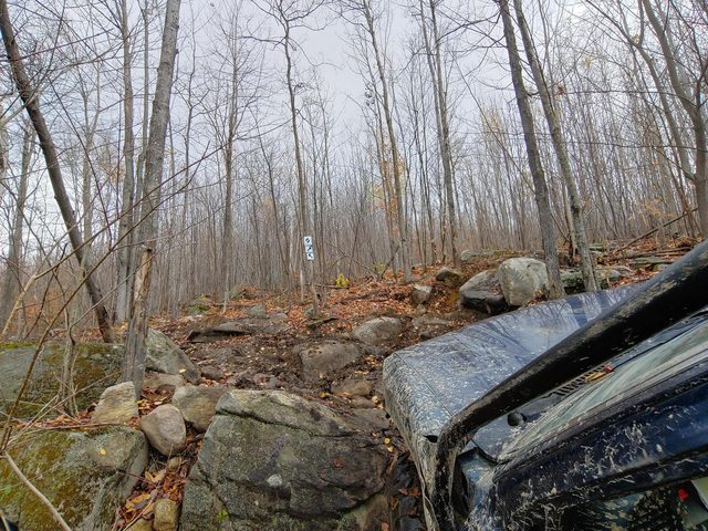

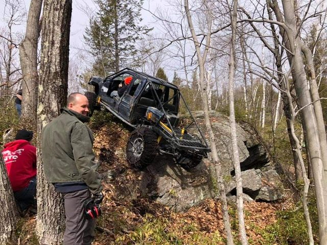

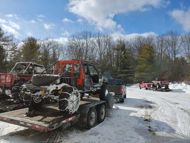

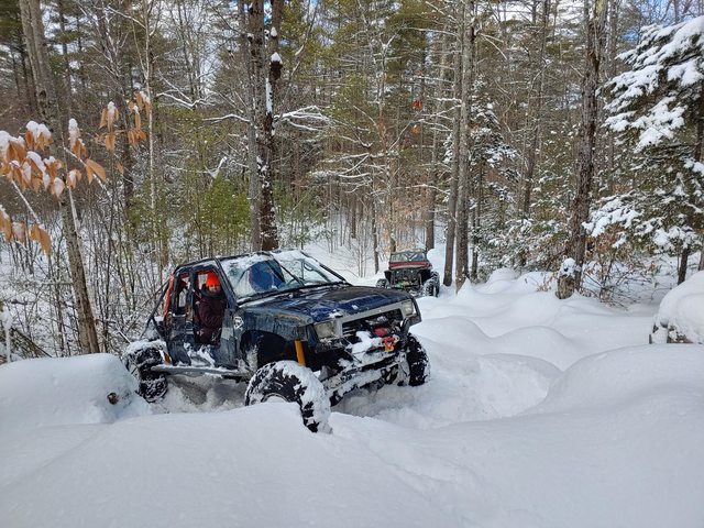

Couple trips out since my last update, everything going well! Sliced a sidewall on a rear tires, so all 4 have tubes in them now. I have another set of tires to swap over, just trying to get all my moneys worth out of these first. They have good tread, the sidewalls are just getting very dry rotted.

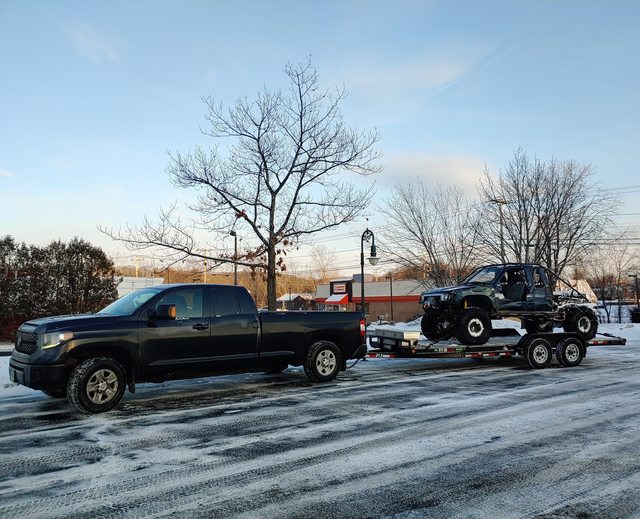

19 Tundra SR. yes, 4x4 (its a must where there is snow on the ground 5+ months of the year) , 5.7, 8' bed. "work truck" package, which is basically base model with tow mirrors, trailer brakes, 4.30 gears, limited slip rear, "vinyl" bench seat and rubber floor mats.. I got it in June of '19 with 64 miles on the odometer. It could use some airbags or timbrens in the rear, but Im just leasing it for now. If I end up owning it ill put something in to help the rear end hold weight, but that depends on what the 2022 tundra has to offer!
Its no superduty, but I was working on my last ford ALL THE TIME. This has been nothing but trouble free miles. Its actually going in for its 20k service this afternoon.

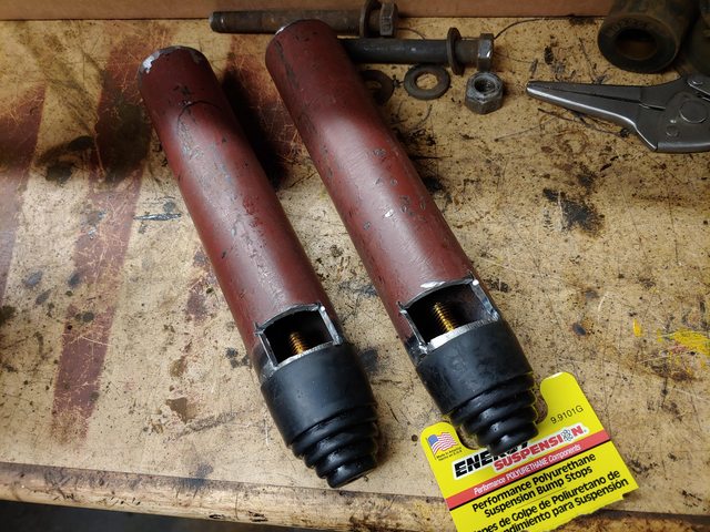

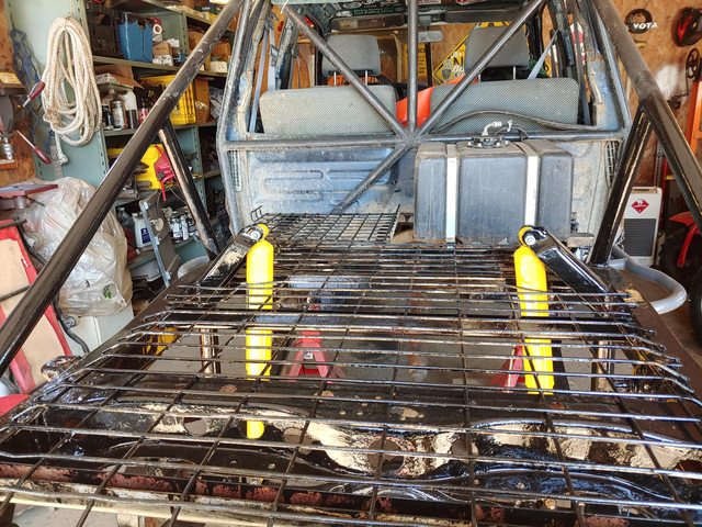

Got the rear shocks and bumps re done and tested. monroe 13" "f250" shock and f250 towers again, but this time so the shock doesnt bottom out. Made some bumps from some scrap and some energy suspension bump stops. Same ones Im running in the front. For $13 for the pair, you cant beat em.
I ended up making them a bit to long, but just trimmed the bump stop to compensate. they hit the u bolt plate right between the nuts when the leaf is just past flat.
