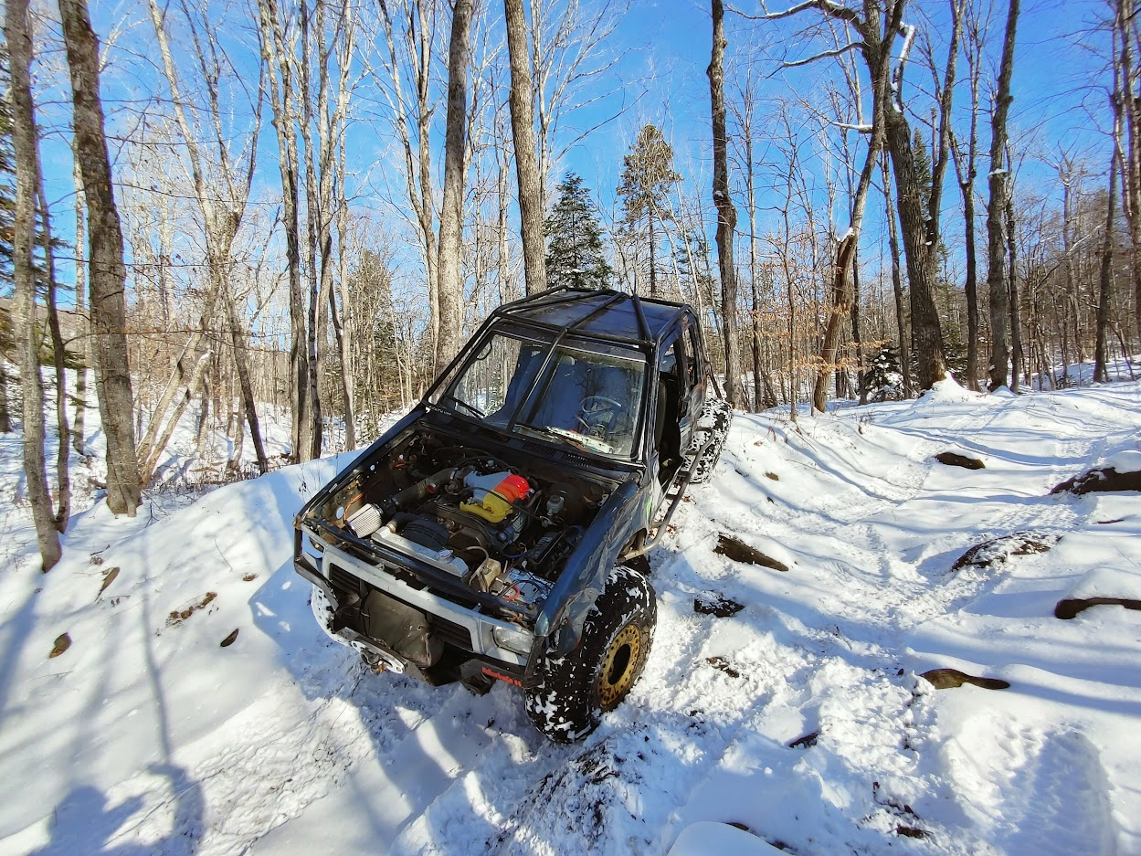

Been wheeling a bunch.. and the 3.0 is getting a little tired. Shes been nose up too long too much and getting a little knocky. Going to keep limping it along and start prepping a 3.4 to go in. Ive gotten 10 years of solid wheeling out of this ole 3.0.
Same climb from the other side. Local hard climb (at the jungle in Bethel Vermont) , this was my first time making it. I havent even tried in years because of how quickly it can go bad. But it was hot and the rocks were sticky and the wife and I strapped in and gave it ago.
3.4 time I suppose

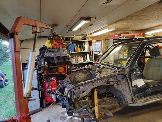

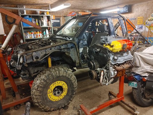

Motor swap updates:
New valve cover gaskets, plugs, belts and threw some paint at the 3.4.
Old Oct 11, 2022 | 11:02 AM
  #684
rattlewagon's Avatar
Joined: Oct 2009
Posts: 4,832
Likes: 332
From: Northfield, Vermont

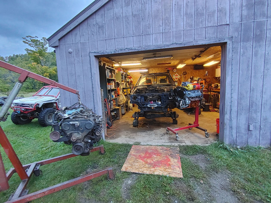

3.0 out, 3.4 ready.

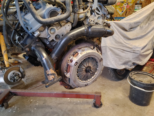

Used yotashop crossover from a buddy, 3.4 clutch and flywheel, 3.0 throw out bearing and slave cylinder, 3.0 through bolted motor mounts.

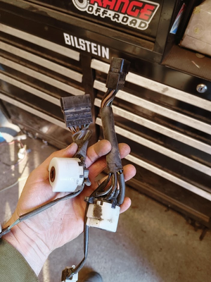

Im using the whole t100 harness. Needed to swap the ignition pigtail over to the t100 column for a little extra length to reach the t100 harness.
3.0 PS bolt and lines bolted right up to the 3.4 pump. 3.0 bolt on the top, 3.4 below.
Ill keep picking away at it, hope to have it running by end of October for Hallowheelin

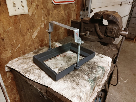

Battery tray to move the batter to the drivers side. Bolts welded to the bottom to hold it to the inner fender.

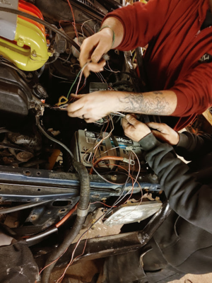

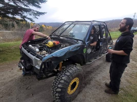

Dash going back wiring just about finished
Cleaned up the wiring for the 02 and fuel pump

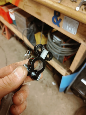

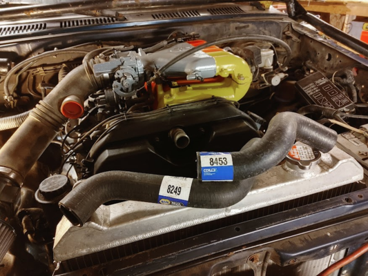

if your using these as bolt throughs, remember to take the paint off for a better connection
Had to trim the ends of both, but found these part numbers on a 3.4 fb group, they worked great
Napa 8453 for the lower and 8249 for the upper hose.
Got to drive it!
I get by with a little help from my friends..
Rips pretty well! Racing my buddys runner with a 22rp..
Back in the garage on its own feet again. The power steering pump was dead, so we had to swap it out for another used one. Took me about a month to get this motor swap done, I need to clean the throttlebody and idle air control valve because it idling high. And one fix a power steering leak. Should be ready for Hallowheelin next weekend!

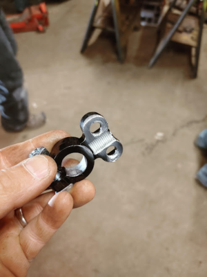

Made a "new" set of wheelin chains out of my 2 older sets. My old set is in the middle, about 91 inches long and fits well on my 38s. The new set is about 110' long, so well cut them down a bit.
Removing the cam locks for two reasons. 1, I feel they pop open when dragged across trees/rocks and B, I want to put another cross piece right where they are..You could also add two quick links instead of undoing the whole side, but I only had a few quick links on hand.
I did this for all 6 cams on both chains, Started adding the extra pieces
stock vs doubled
cross pieces and the chain tool.
Use this side of the tool to open the clamps up. I would put one handle on the floor and use my body weight to help compress it.
This side closes them back up. Having this tool makes this go so much faster.
Few disposable bungies and were ready to go.
