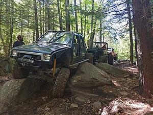

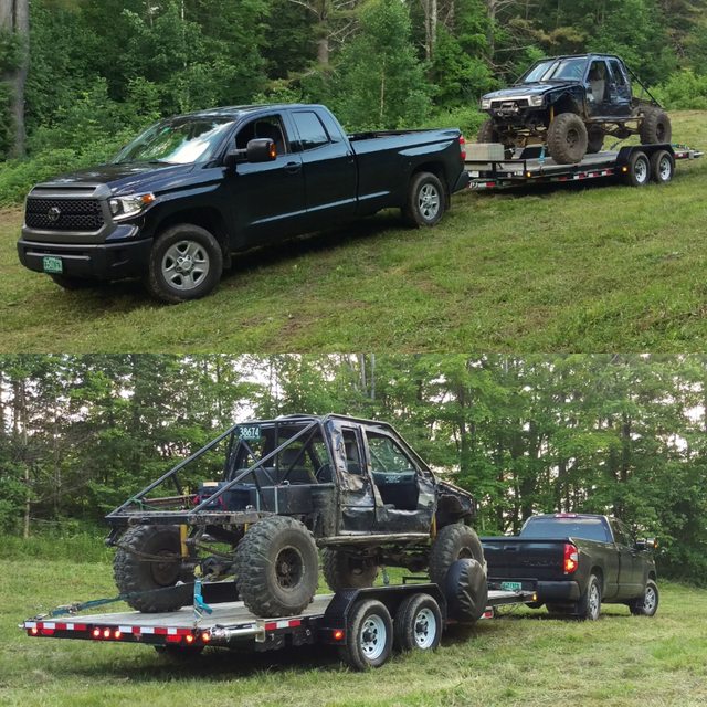

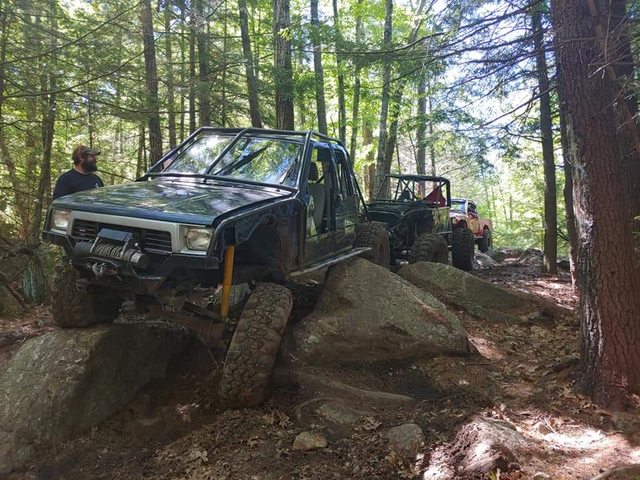

Cliff notes:
Originally a 3.0 truck, swapped in a 3.4 in October of 22.
38TSLs DIY beadlocks
Front is 85 Front axle with all the TG Armor, OldManEmu/RUF springs. Sky hanger/shackles, 30 Spline Longs, Creeper Flanges, 5th Stud high steer arms, extend spring perches, RuffStuff 7/8th Heim joint steering. IFS hubs ground down used with Tacoma slip on rotors for a 3"wider stance. 4.10 high pinion and a welded diff. Ford 12" shocks and towers, TG extended brake lines. Daystar mini bumps
Rear is welded locker with 4.10s with some armor. Ford 12" shocks and mounts, Chevy 63s with Sky hangers/shackles
Dual gear drive 23 spline t-case with 2.28/4.7 gears, tg twin stick. Advanced adapters plates held up with a Bud Built 1.5" lift v6 skid plate and some 4xI sliders.
TG winch plate based front bumper with a Warn XD9000I and amazon synthetic line.
126" Wheel base. 25" to the frame right in front of the cross member. Total lift from the solid axle swap and chevys is about 3"
