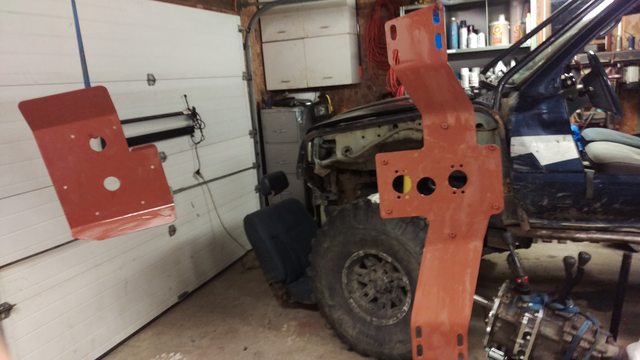

Wheeled a bunch this spring, now in the process of finally putting duals in. 2.28 and a 4.7 box make for a final of 10.7:1 reduction, for a final crawl ratio of 168. Everything is 23 spline because trucks a 3.0. Waiting for the paint on the budbuilts to dry and then I can start getting it in there and measuring for driveshafts.
The red is primer, they are black now. Skid is has a 1" drive train lift just to help tuck things up a little more.

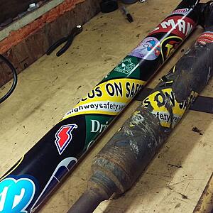

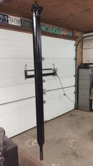

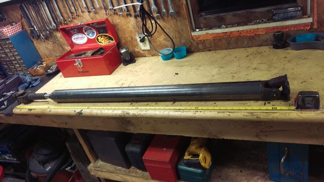

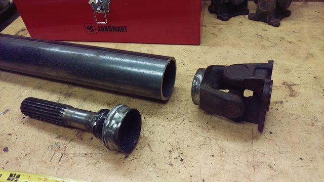

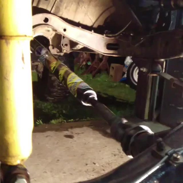

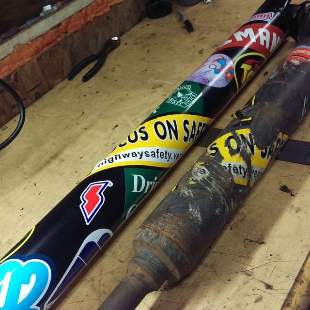

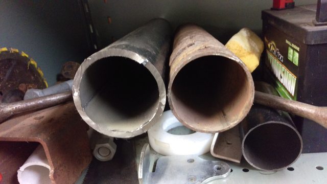

Tossed the 2 piece rear shaft for a 1 piece. It hangs a little lower than the 2 piece, but after the drive-train lift, the 2 piece was almost straight anyway. New guy is 62" flange to flange made from 2.5" schedule 40 pipe. That size has a id of 2.48 and per the pirate bible the toyota yokes are 2.46, a little loose, but it came out pretty straight.
Old shaft vs new. Same sticker.
.20 wall schedule 40 vs the stocker
^ thats a video on imgur, not sure if its playing here?

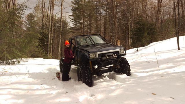

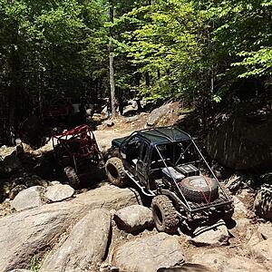

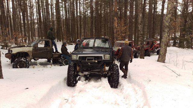

Summer wheeling calendar is filling up pretty quick. Ready to get the chains off and find some dry rocks.
Quick vid from wheeling a few weekends ago. Snow was still a little to deep to get very far, but still a good time. Gave my winch a good work out.

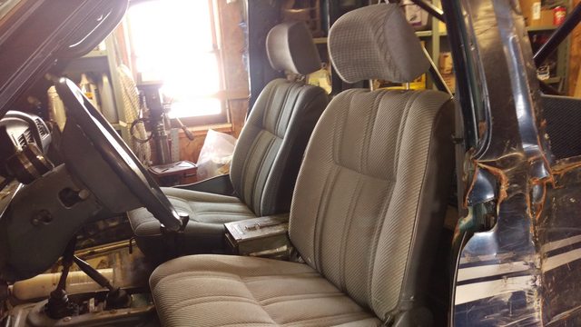

Quick picture of my seat set up. Its a passenger seat out of the same era truck. So the back rest adjustment is on the inside by the shifters. Its pretty much bolted in. the two out side bolts threaded right in, the front inside had a hole but no nut, easy. The rear want to be where the seat belt mounts. But needs to be spaced out a bit to sit squareish. Used a longer bolt and stacked a 3/4 spacer on top of the seatbelt tab and she s in! And it was free because it came out of the parts truck. Cant beat that.

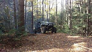

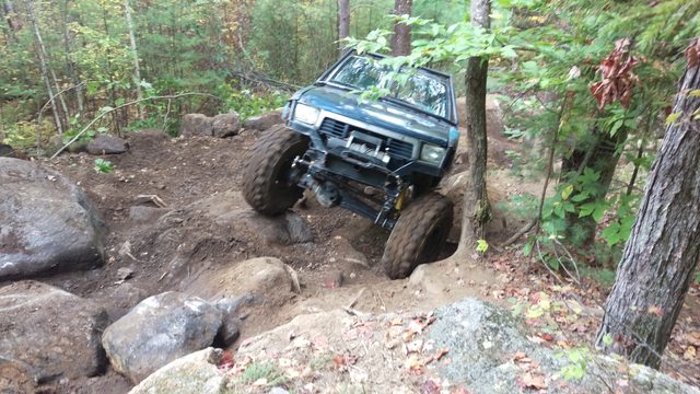

Been getting out about once a month still wheeling. Truck just keeps crawling along.

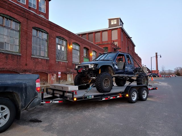

Also upgraded the tow rig and trailer. Trailer was rusty, sold it for what I had into it and put that down on a new PJ 20'. I realy liked my f250,It towed awesome most of the time, but it would just never run right and left me stranded too often. Traded that in for a 19 tundra 5.7 with a tow package. No more towrig or trailer worries for me!

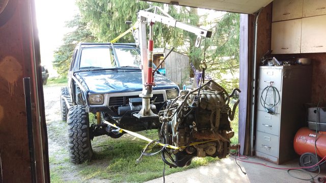

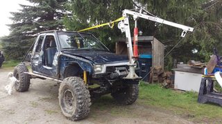

Now its a crane
Tested by moving a motor and 2 trans. Works great. And could be put almost any 2" hitch.

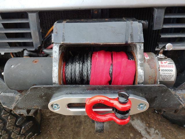

Santa brought the ole warn a little upgrade. This old winch is still going strong.

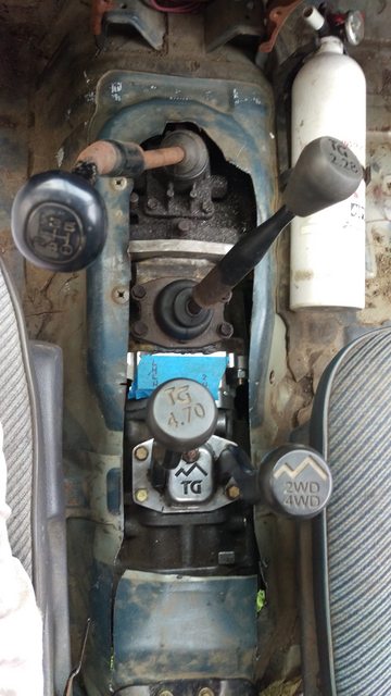

A friend asked my what gear I was in and I said: 2nd low, 4th gear. He asked what gear over all, and I had no idea. So I mathed it out. The red is the "gear #"
This is for my r150 with 2.28/4.7 duals, but the pattern should be similar for most
So , 2nd low (4.7 case) 4th gear is 10th gear.

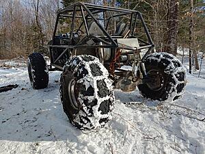

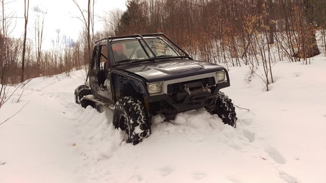

Winter wheeling is the best wheeling.
Broke a chevy leaf after 6 years of wheeling on them. re worked the rear springs with parts lying around. Rear pack is now 1 main chevy leaf, 1 ford ranger helper spring, 2 toyota leafs from a ruf pack, and the chevy overoad. Seems to work pretty well and sits about the same height.

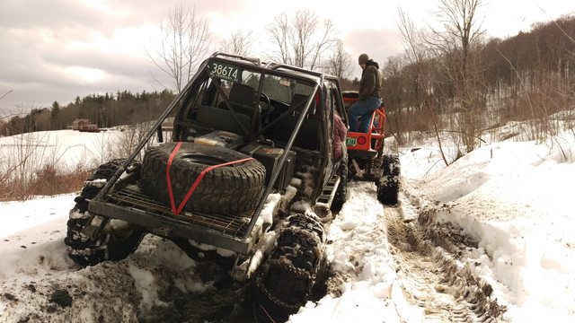

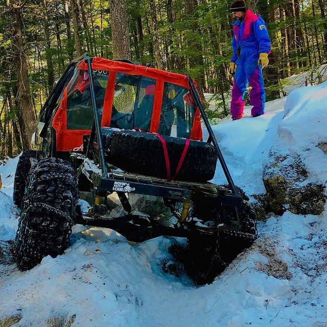

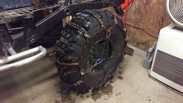

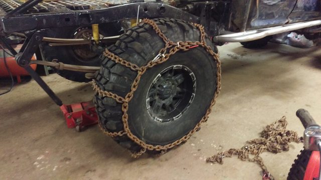

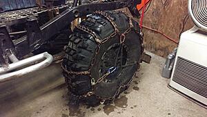

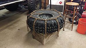

Tires are 38x12.5. I made the set of chains a few years ago out of old chain parts from our f550 plow truck. Only one of the chains around the tire is from tire chains, so I had to make the other 3. I used regular chain and cut/welded the hook to fit into the normal size chain. Some of the cross pieces are studded, the other are v bar.
These CHANGED how I wheel in the winter so much that I get sad when they come off in the spring. We dont get the snow fall the west does, but we do get ice.
This is a buddys sammy buggy. Hes running ice pick chains from a tractor on his 39. iroks. Even in 2wd he goes all over the place.
I would love a set like that or some skidder chains to make fit.. but people want crazy money for them even used.
I have a friend running some on is 36x13 iroks and they are stock front chains for a semi. I think he said he paid around 160 for them..

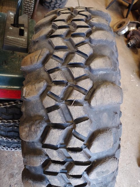

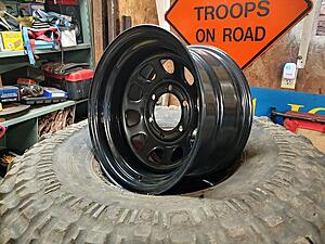

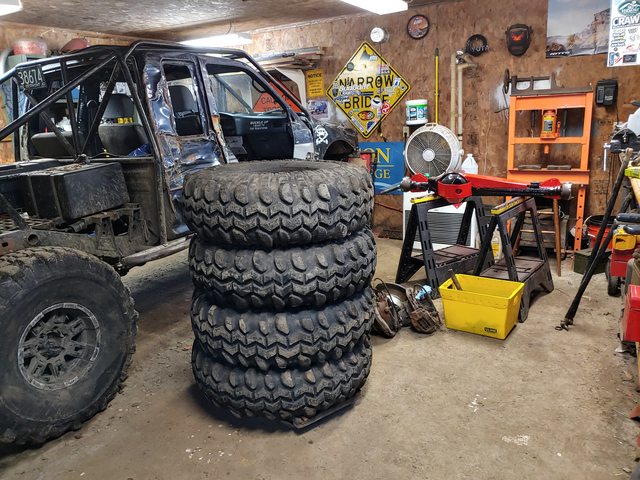

I picked up a newer set of 38x12.5 Tsls SXs to replace my dry rotting ones. I want to keep my old tires on the rims they are on for spares, so I got some procomp steelies to turn into DIY beadlocks.
Groved the middle out like this, then ill sipe the remaining middle and outter lugs. Should help them grab a little better.
