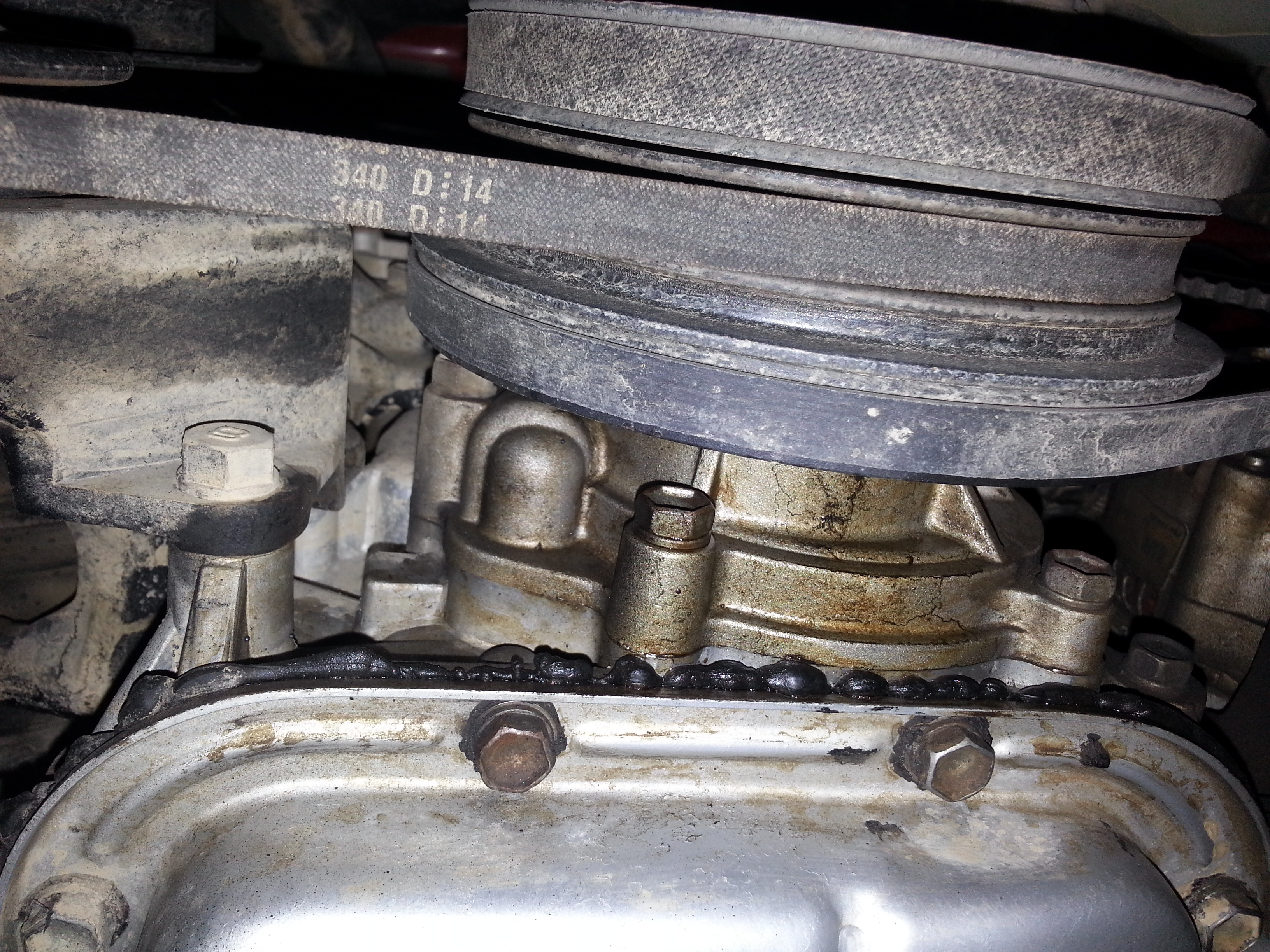

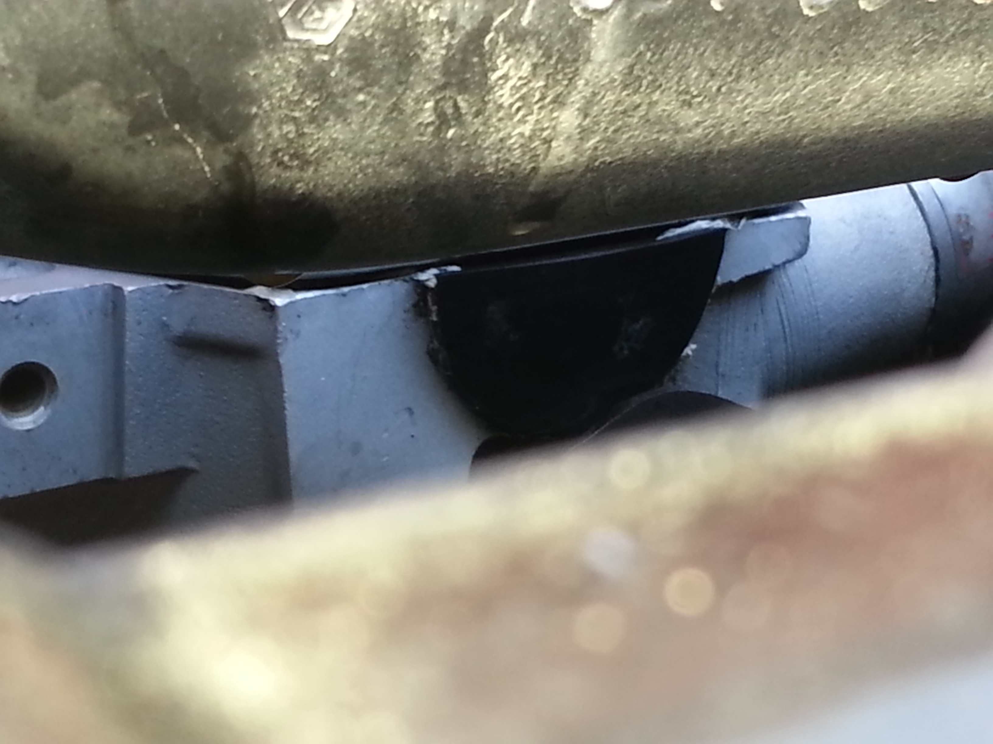

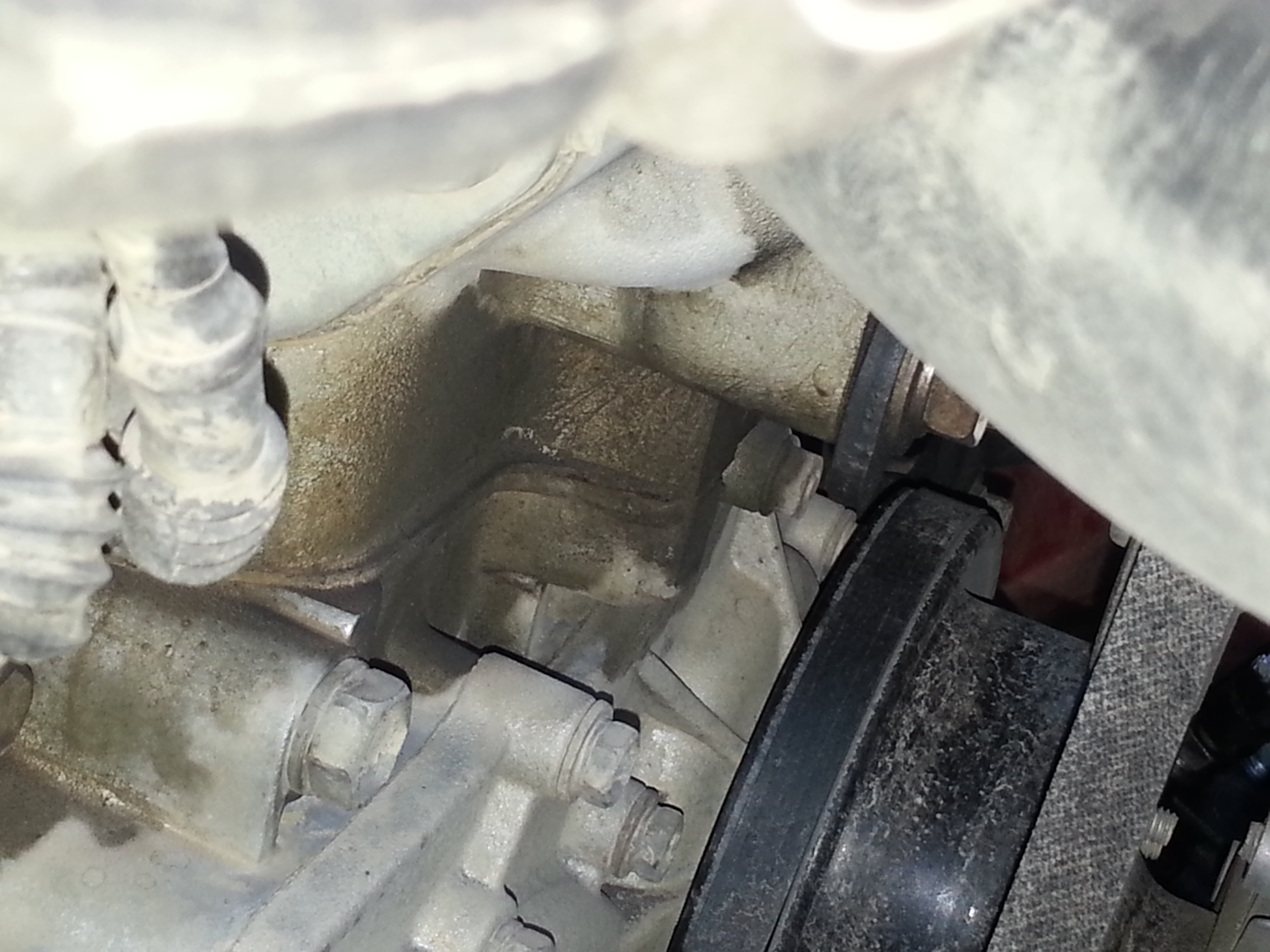

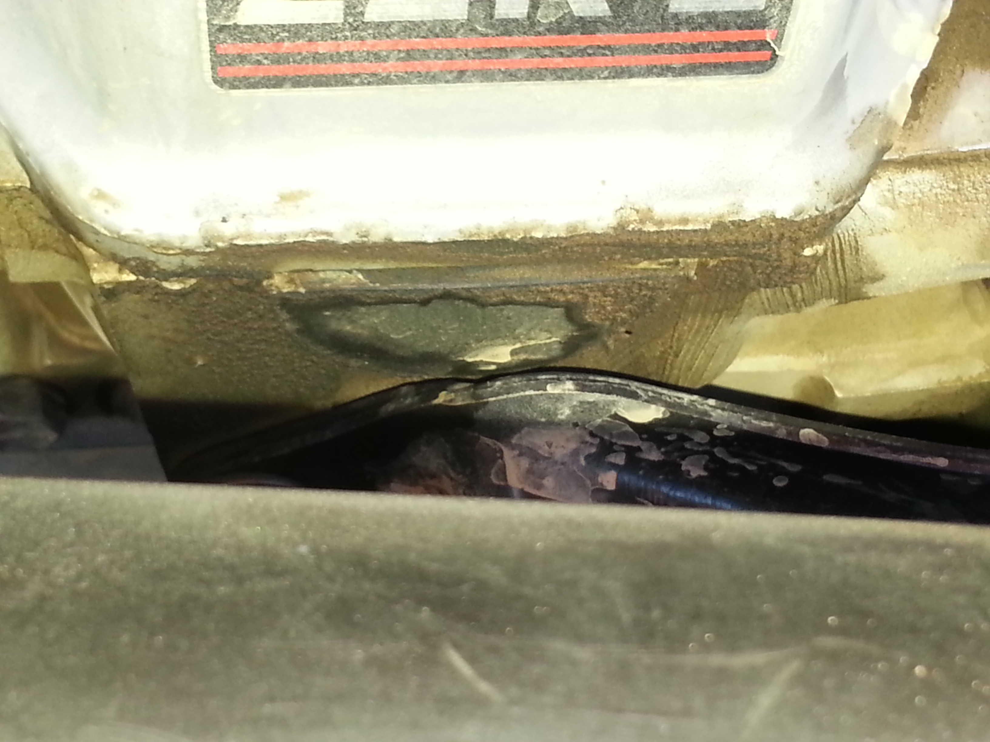

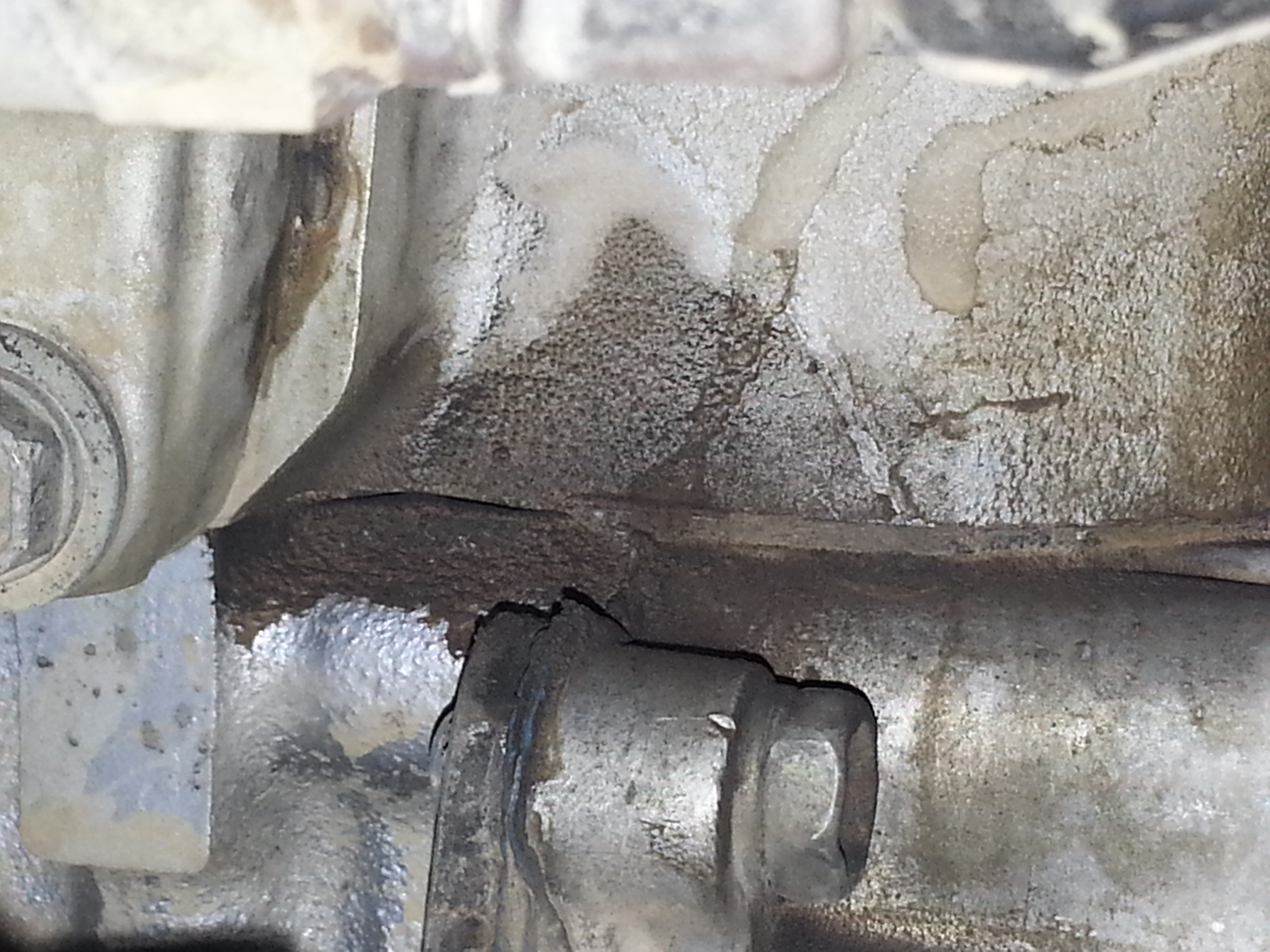

* I listened to both videos with my headphones on and it is definitely a hundred times more clear with my headphones then when I listen through the phones speaker. It's actually a decent speaker but it doesn't work properly for the practical application of these videos. Anyway....

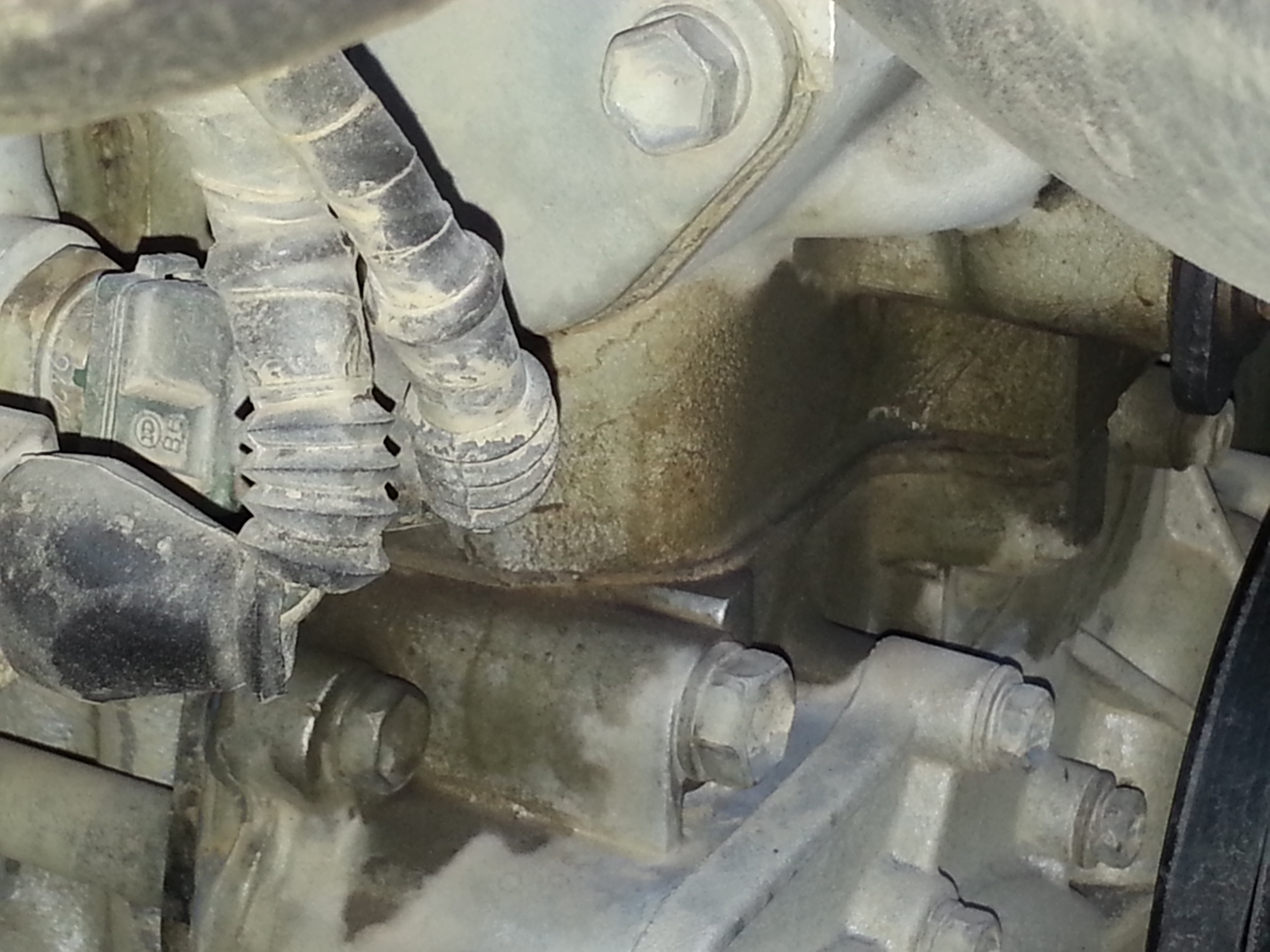

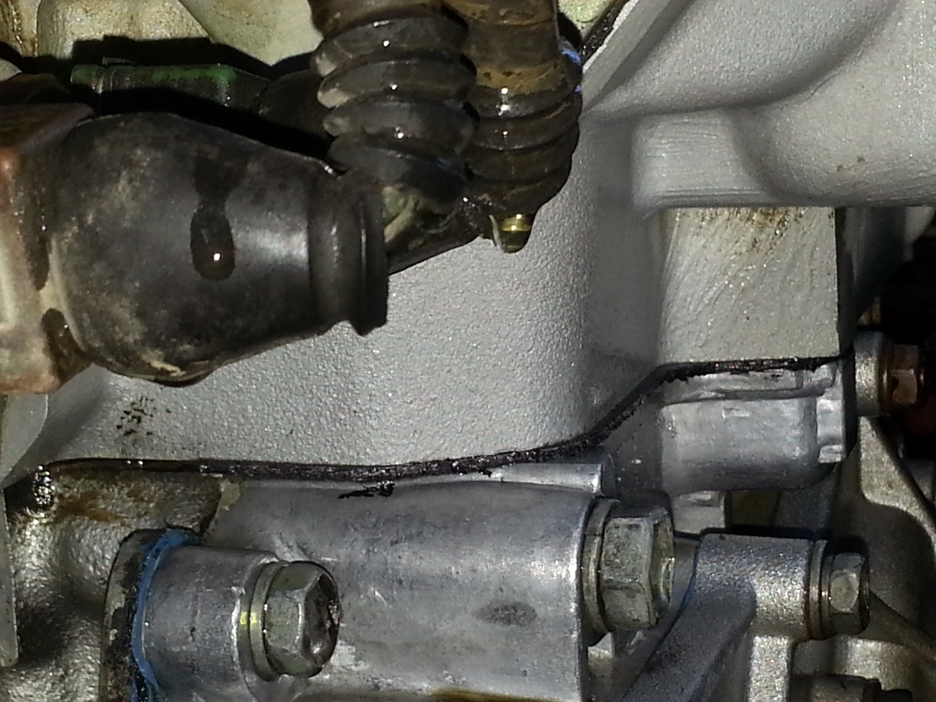

1st: I have a Rough Idle after hot restart/After sitting 15-20 minutes (Hot Soak, maybe?).....
These videos and pics should show all of what I'm looking at. ...

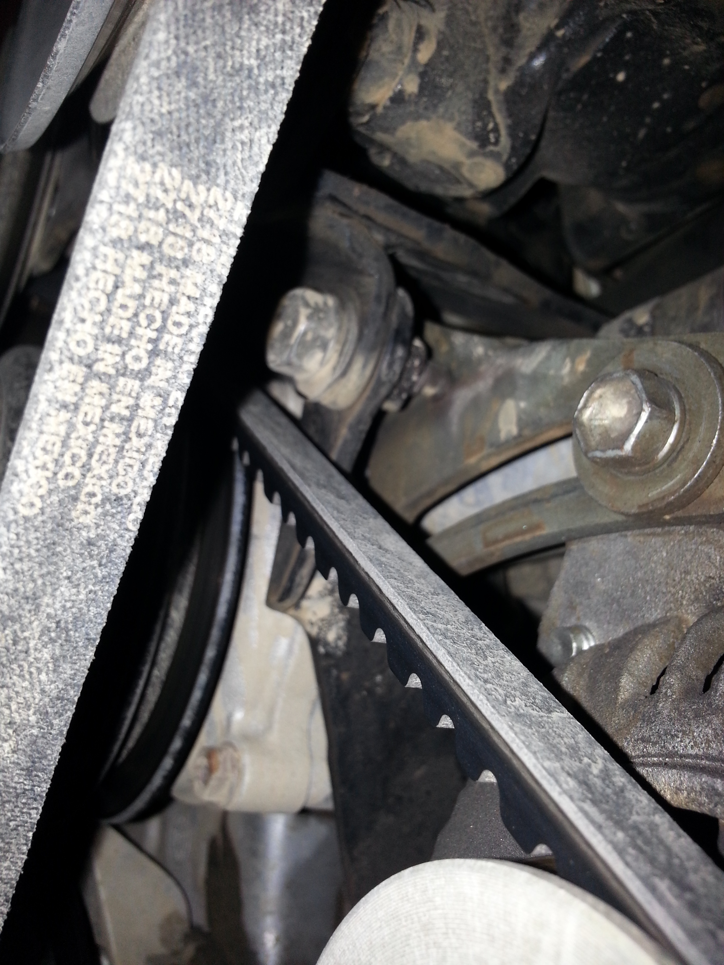

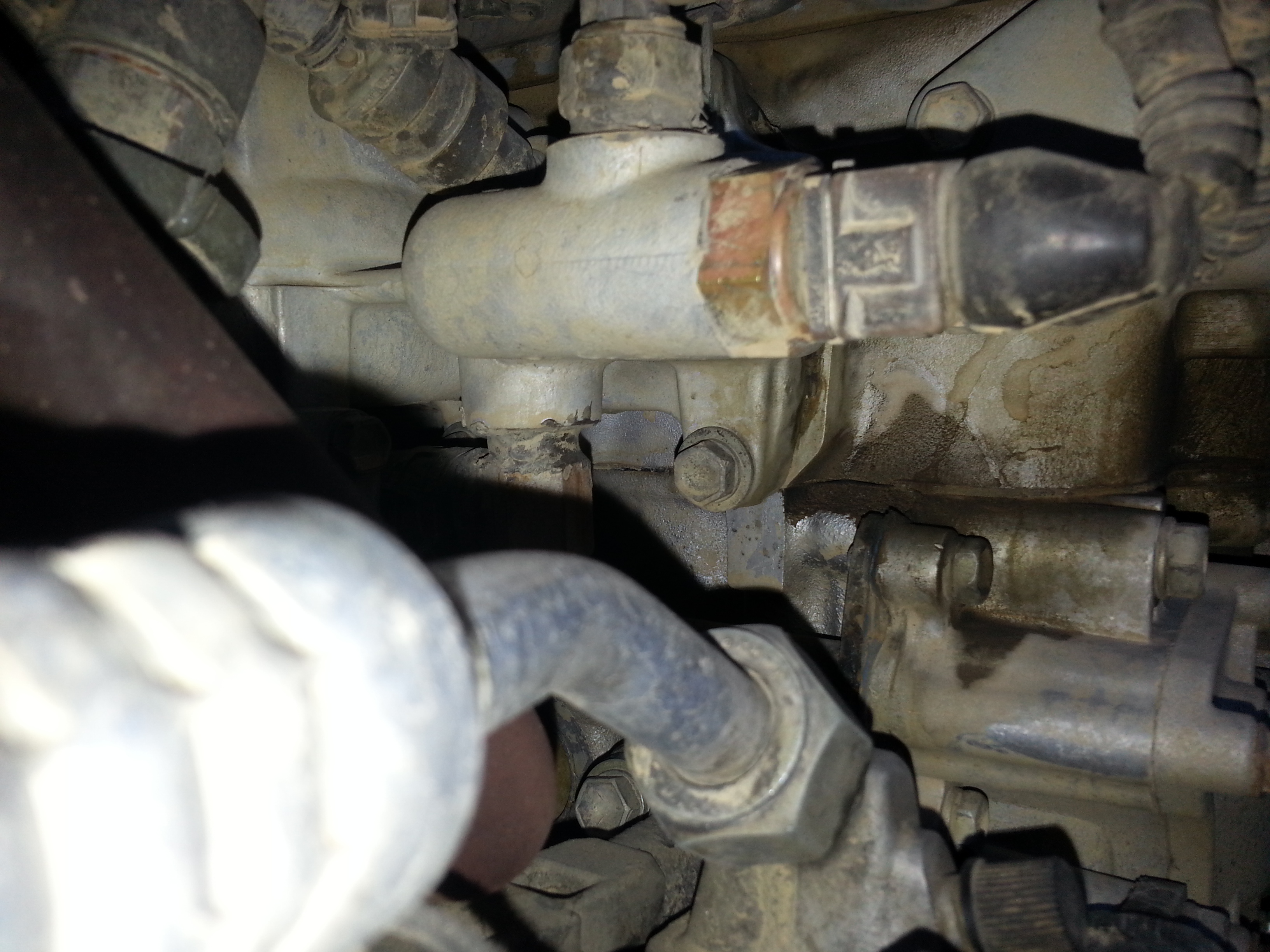

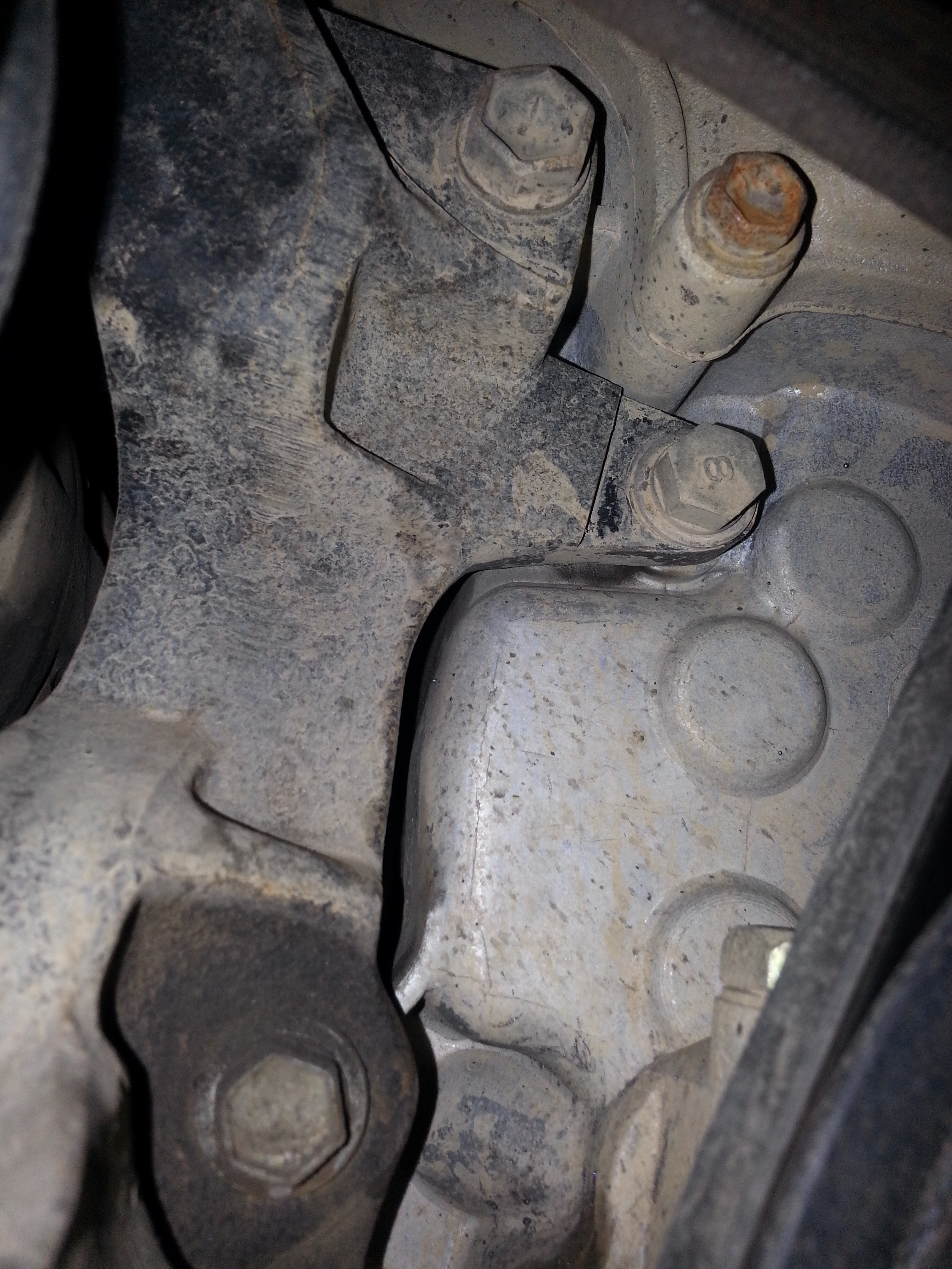

1. Pics of oily spots before cleanup. ...
A. Front main seal/Oil Pump leak.....
B. Around Oil Pump....
Bottom left of next Pic, a build up in very localized area....
C. The rest of the pics are localized to Head/timing Cover/block union on passenger side (possibly passenger side, just can't see in there).....And Valve cover half moon......
D. All cleaned up.......Attempting to reference these and figure out source.....
Two videos I posted above are pertaining to both these oil leaks and gremlins......
I understand that for some, I always have a bit to much to read through, I apologize again to those who just don't have the time ... So that's why I did this last post here regarding this oil leak and gremlin combo.
I will test whatever I can, but I have no shame in saying I can't wait to see the day when all of this crap is figured out, whether 100 percent at someone elses credit or not!.... My only worry is that it is, yet again, mechanical. In other words, valvetrain or otherwise top end related, etc.
PS: If you notice in the video, if you are able to watch, I had it running for quite a bit and even pulled up the idol to around 2000rpm for about a minute or so... And the EGR pipe is still ice cold. I'm a bit confused on that one. I will drive it around a bit longer in the near future and give that a check. I know I got it very clean and it seems to pass all the tests related to a EGR operation and modulator as well.

i would just follow the TSB i linked you. i know its $200 but that is where i would tell you to replace if it came into my shop and see what happens. i know it sucks but with older vehicles, we just have to base it off what we find in TSB/repair manuals and go from there.
if i owned your runner mark, i would keep driving it till it gets worst otherwise replacing parts till its fixed is next. maybe you need to adjust your TPS?
your "oil leak" doesnt really look like a leak. a leak is when you see wet oil. looks like you may have some seepage that may get worst or its just old stuff, maybe some wd40 was sprayed around that area and collect dirt when you had the SAS done
^the video shows it is wet and leaking. my bad lol. i was just looking at the pictures. i trying to watch the video but its a little slow on my old computer lol.
ps: any word on the stock pitman arms? did you wanna sell any of them? i havent heard back from you on this?
Same here. Mine also leaks because I think it still has the original, un-rebuilt engine. Too expensive to have just the leak fixed.

Update.....kinda.....maybe? Plus just for the video documentation of the gremlin and oil leaks.....
Oil leak on head/halh moon area....
After reading the PDF that Toyo posted again, I realize that it is suggesting that the rough idle at hot soaks after 15 to 30 minutes of the car being off is referring to the thermal temp time switch that is on top of the thermostat housing. that is the part that it recommends be replaced which is already has... But I also noticed that it is also the one that goes with the instructions of pulling that pin out of that particular ECU connector pin housing. I did not pull that pin when replacing that unit, and yet it seems to only be referring to people that have AC "experiencing a high idle even when the AC is off." That does not happen to me. However, while simply unplugging that temperature time switch on the thermostat housing might not be totally telling as to whether or not it is the problem... I figure what the heck. I will have to do it tomorrow as I have a big party tonight. However, it will feel good to at least rule out one thing. I may also take notes on my TPS specs while I am at it.

Thanks a bunch, Brandon. I really appreciate you taking the time to lend some input.
Yeah, I've figured for a while that the gauge has to be the culprit. I didn't know about that test and I will check it out.
They sure are weird "miss" type gremlins, aren't they? I'll run it today and pull the Thermal Temp Time Switch connector from the switch. Hopefully that wont just throw it into open loop again, which would make it a useless test as it would do the same thing as pulling the TPS would.
Far as that last video relating to the leak on the top side, I need to get the valve cover off in a timely manner and will probably end up using my spare half moon seals. I'm thinking about replacing the valve cover gasket is well but it only has about 10,000 miles on it...

i would change the gasket for the valve cover. they're pretty cheap and are recommended to change when you pull the cover. would hate to fix the half moon plugs then have the vc leak right after haha

I hear you're Brandon. It's just kind of weird to me because I rarely have any leaks up there... So many times a week for the pan or the AC bolt to the timing cover hole or some other totally weird crap cause by the way first builder. Anyway, I'm pretty sure that 90 percent of the cause of the week there is just not having a proper amount of sealant on the bottom side and a half moon. You shouldn't put too much but it's clearly not enough. Of course it could be leaking at the top corners... Are the way its gotta go... And yes I will replace this 10000 mile old valve cover gasket.... Grrrr. Lol.
Weird little miss,... And hot soak drama... it has stumped many fairly apt Toyota mechanics... I hope that I can stumble on it through the stuff that you guys have given me and others but I've already tried in the past... Basically testing every single sensor and item on the truck. Haha.
Hearing that little squeal in the belt on the first of the last 3 videos... That struck me as odd as well. Really can only be three things, power steering, fan, or water pump. Well, I guess if my clutch was feeling on my ac it could be that as well... But it seems to be working flawlessly. Tiny little squeal, and considering I'm having some weird steering stuff going on, my guess is its either that I got a bad your box what is way over working my steering pump, or two. It is just a coincidence and is a failing steering pump... Or 3..... Its both or none of the above? Hahahahaha. I guess I just have to laugh about this crap before I break something. But then nothing runs problem free forever... Its just that I would hope none of these brand new things would be failing.

Valve cover kit ordered... Heading out to ship tuyo some pitman arms and pick up the valve cover gasket kit.
For the hell of it I will probably check my head bolt torque rating... Depending on whether I have time or not I'm I checked the valve lash is well. If its way out again that might indicate that I definitely have a problem with the cam. I doubt it though. It seems to run so smoothly when it is warm and on the highway, getting fairly decent mileage at freeway speeds. No misfire or backfire... No smoking or fuming out too bad do too unbirth feel... But something's wrong for sure. That's the time to check that crap is when you have the valve cover off, so I might as well..... .007 & .009.... SEXAYYYYY! Lol

I picked up the Valve cover kit, got Toyo his stuff shipped... ran a few errands and then I had to get back to work. Of course the freaking bank took me longer than anything.
Here's a video of basically I just wanted to share that I unplugged the TTTS, the sensor on top the thermostat housing... The gremlins kept right on rambling on shaking and idling at 400 to 500 rpm... Didn't seem to change a thing . I don't know, maybe its doing its job? Hahaha....
I'm going to change out the Valve cover kit, check the TPS, unplug the TPS during the gremlins, unplug the cold start injector time switch again during the gremlin , and possibly check my valve lash and head bolt torque. How to p*** off at my AC VSV is only working when the truck is cold. I guess I can usually it seems to work when its fully warm but very rarely.
