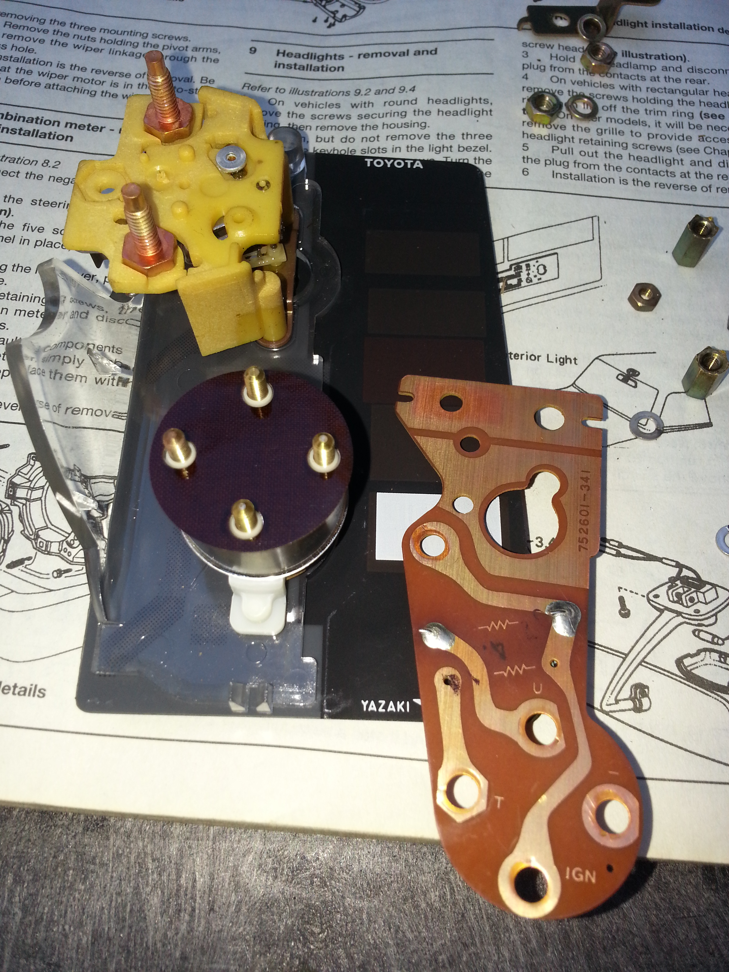

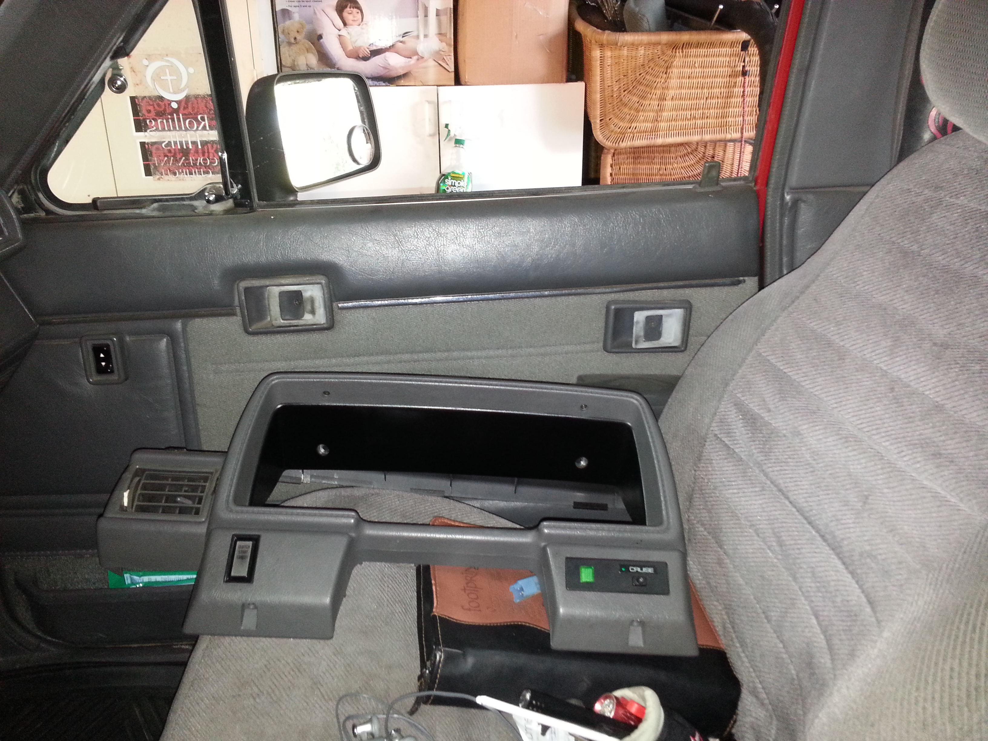

Well, I got a lil time today, so I did my front breather extension again (the SAS left it short).......

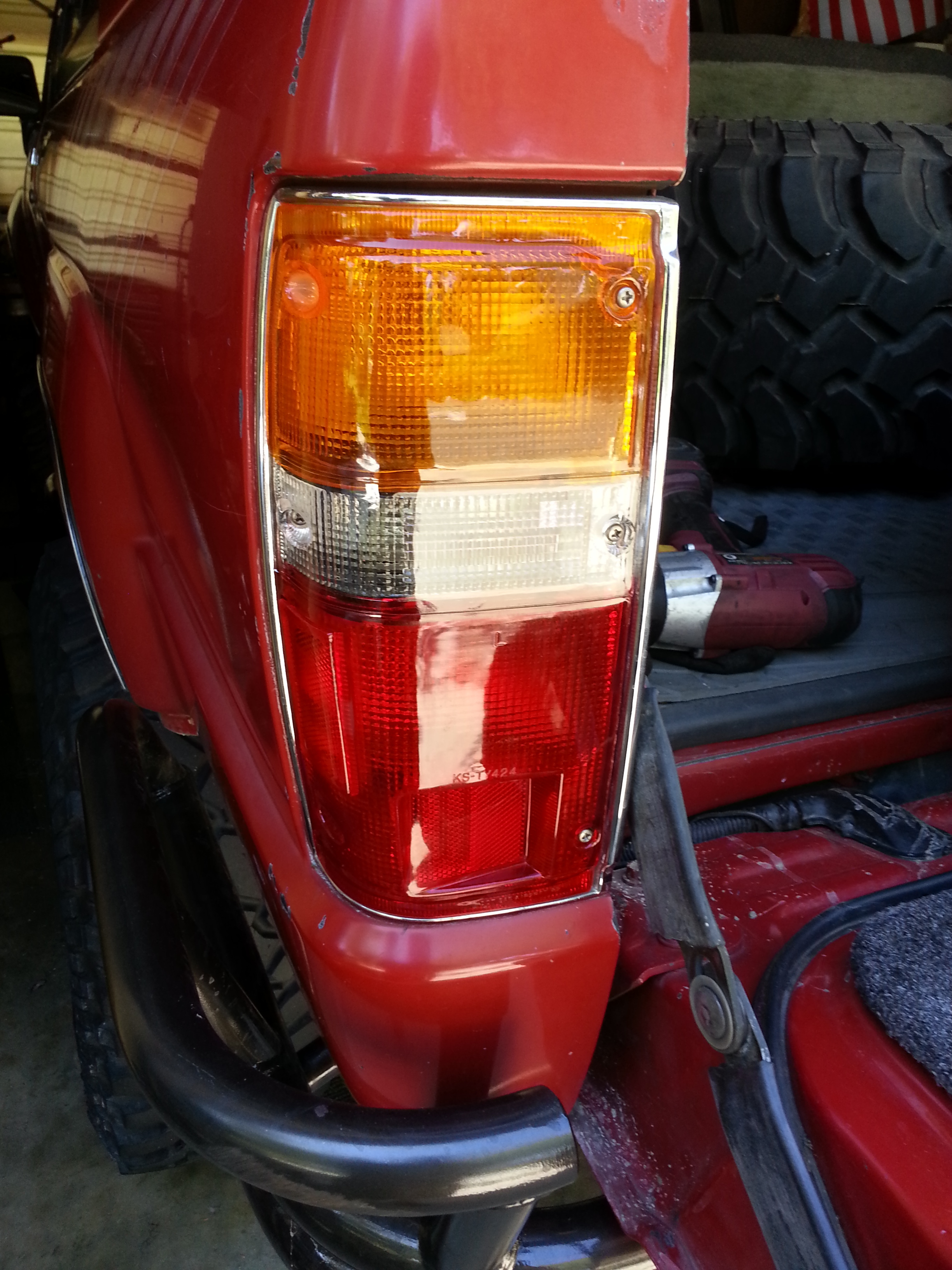

Then I slapped on my replacement taillight.......

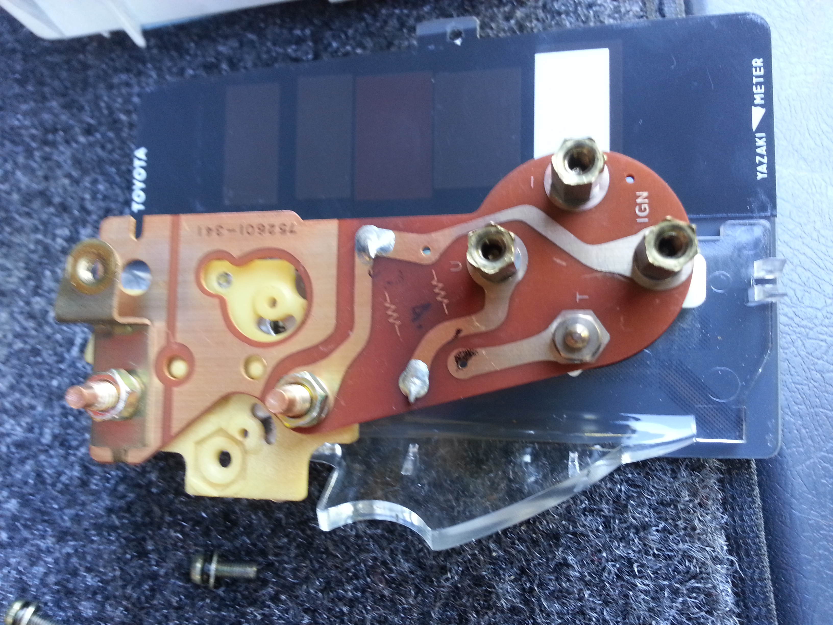

Then, decided I should give Terry's/Inferno's temp guage fix a shot.....
I found it to be nearly perfect.... And, I seem to have the insulation/damper piece on the back of the metal housing for the temp sender that Terry says he never sees.....(Except for in Infernos thread)

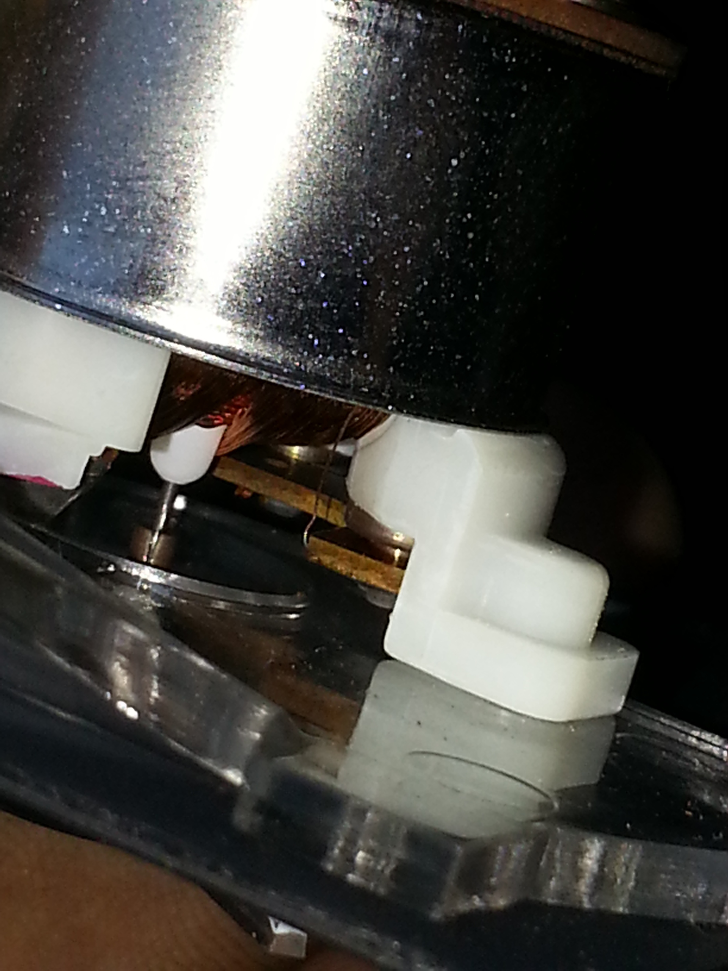

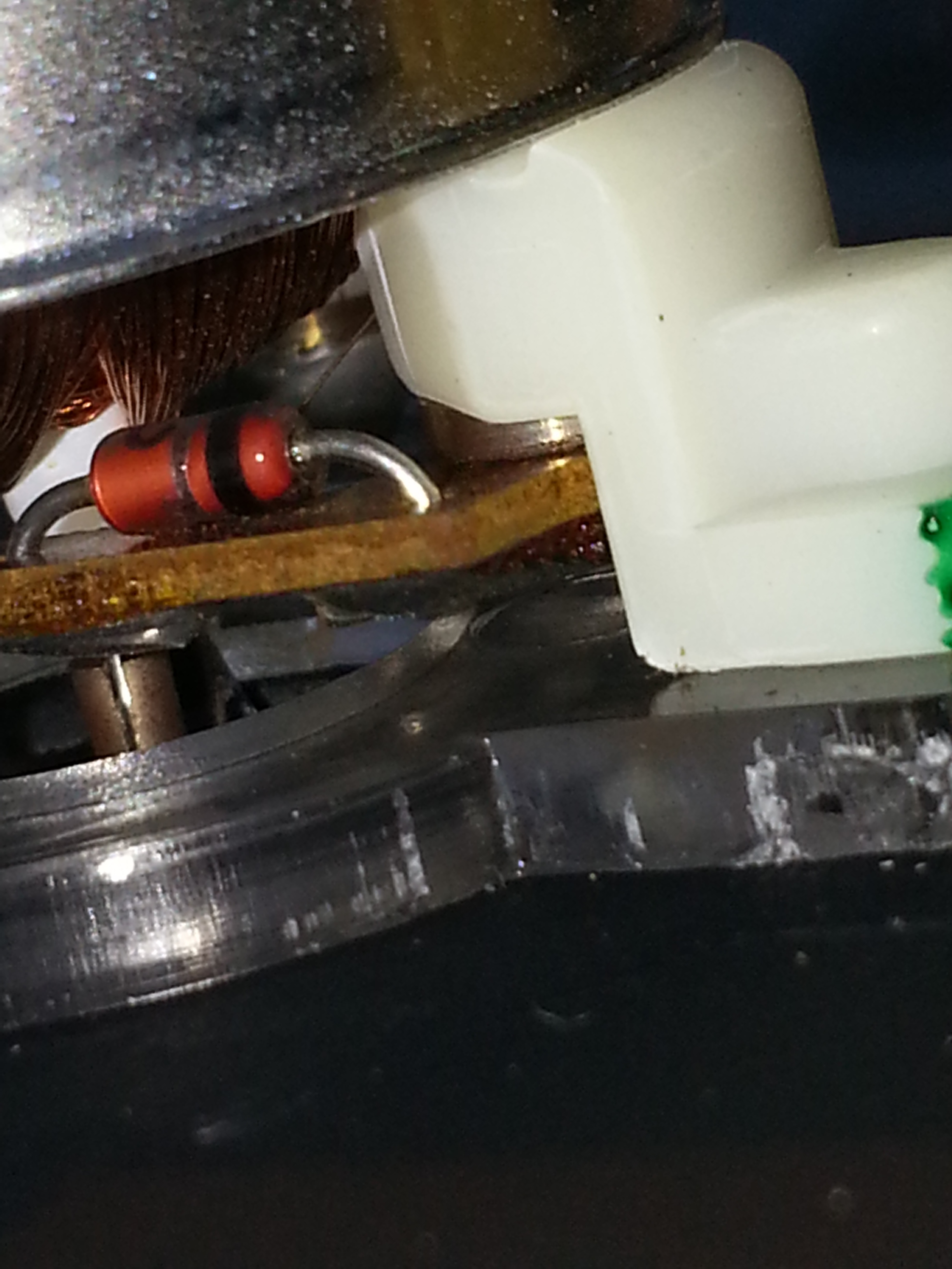

Here's a shot of both of the teeeeeeny wires that come off the spool to the arm that gauges the coolant temp as relayed by the Temp Sending Unit......
( Curious if anyone thinks that the sleeve where the needle rod goes into looks cracked, or is it supposed to be that way?)

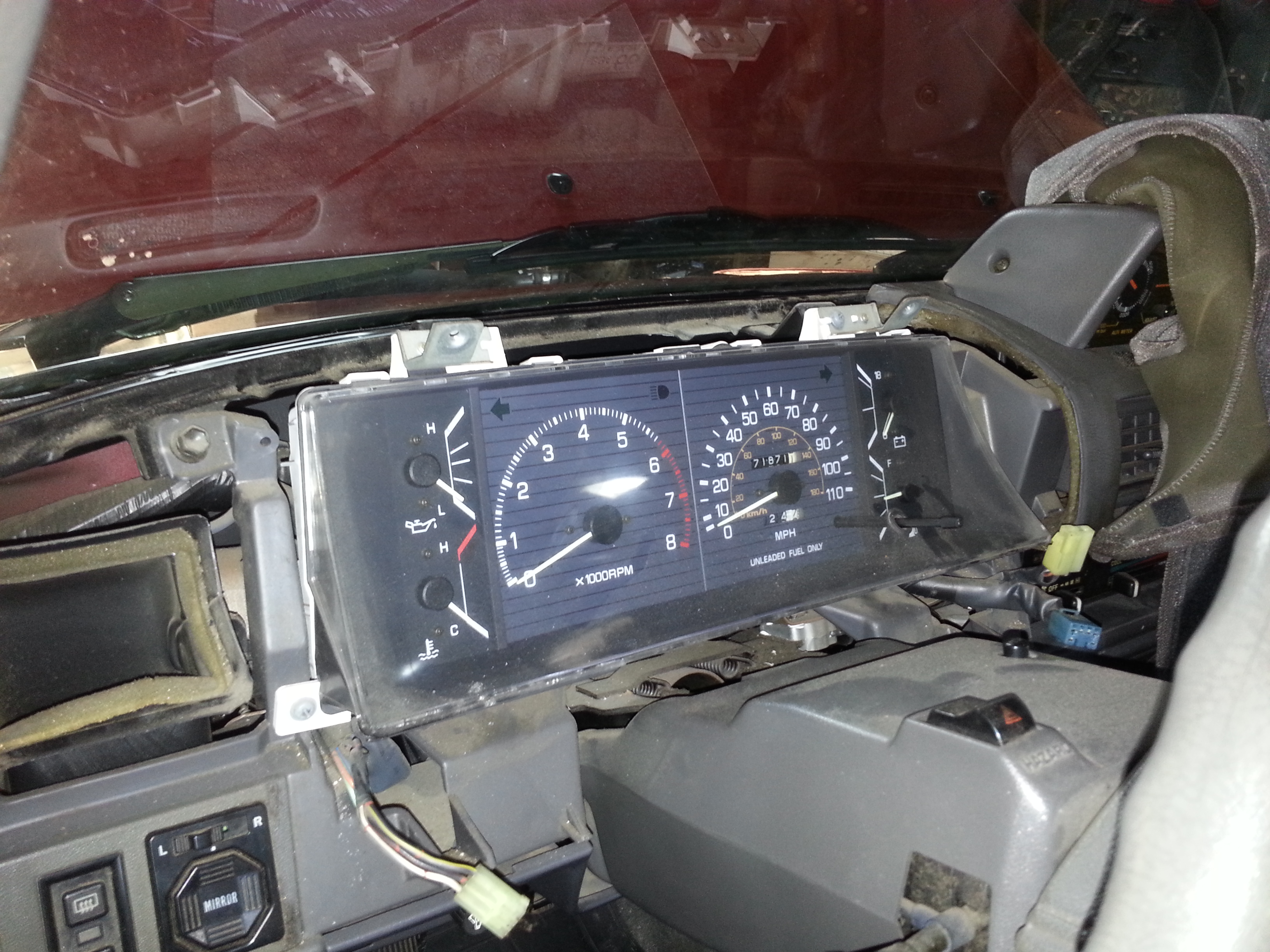

I assembled everything and reinstalled the guage cluster.... It started out cold, and I can't know if it gradually went up or not..... I ran off to a scream for help from the neighbor...... Came back and it was in a lower spot than it's been in years..... Gradually, I THINK, it came up to the "1/3" spot it always sits when fully warm.
Tomorrow I'll do a video from cold to fully warm..... It either worked cleaning it up or not..... PLEEEEEEASE?!?! Hahaha.

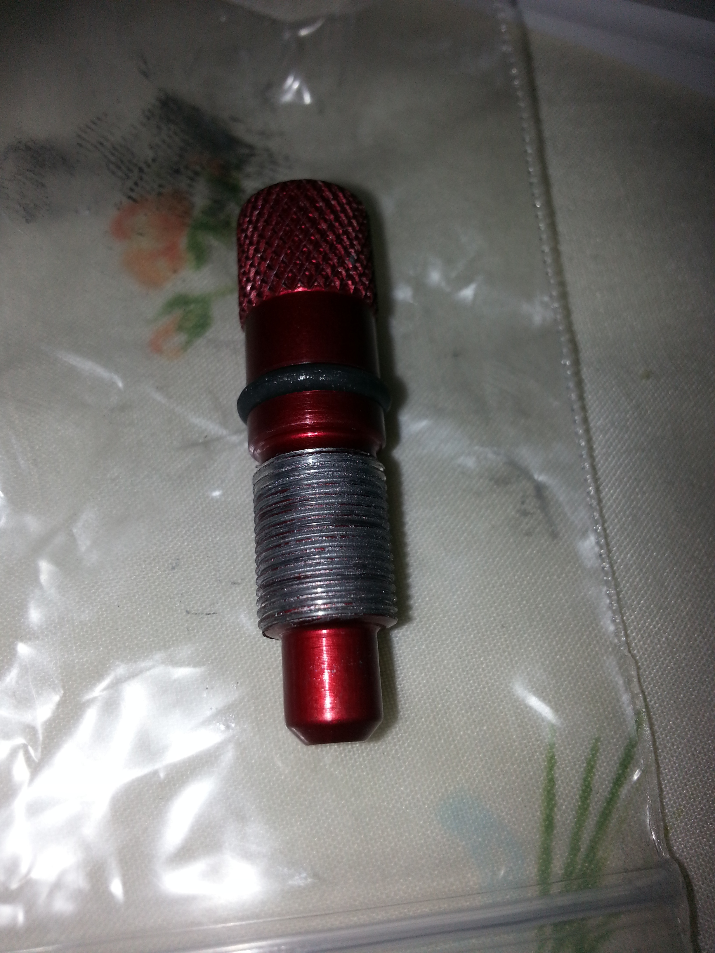

Hahahhahah...... Okay, its not a performance mod, I apologize... Lol. However, I'm hoping it will stop the idle screw from backing out on the inclines and while I don't really need it I had a gift card basically for LCE... So I grabbed the only thing I really needed from them. This way I can take out my old one and get set up with the new wiring and slap it in my little ziplock baggie in the glove box of extra goodies...

I'm not sure buddy, but one thing is for damn sure, no matter how hard I turn and squeeze on that thing I cannot get it to go lower than 800 rpm. I took the o-ring of it and slapped it on my factory idle adjustment screw... I got it down to about 750 again. The odd thing is that now my AC idle up is working constantly and that's before I change back and forth on the idle screws. Even more odd is the fact that when I first started the truck, which is when the air conditioning VSV always works, it didn't.... But since then for the last 45 minutes, like a little kid messing with electric windows for the first time, I flipped the thing on of a hundred times and I cannot get it not to work! Lol. I have no freaking clue.... I also have absolutely zero ideas as to why the LC engineering fancy screw will not go down any further, it is exactly the same size... I guess it's much tighter because the threads are all new? All I know is I had a towel on there and was turning this time as I can and I have pretty durn strong hands... I was afraid to break the darn thing off in there! I could not get the thing to go down below 800 rpm using that new adjustment screw. I thought maybe the AC I'll up was only working because the RPM was reading over 800 rpm? Nope, I adjusted it back down to 750 as far as a gauge is concerned and..., well, let's just say it keeps working. The problem is whatever's going on I know it's not going to last Considering the extremely odd gremlins that I have going on.
Also, my cleaning up of the temperature gauge did absolutely nothing. It seems to work yesterday but now it is stuck right in the third even when I started cold. But I did read the thread somewhere that said the RPM module somehow, the portion that is in the gauge itself, relays whether or not the AC I'll up can work... What I don't understand about that is that I would think it would stop the clutch from engaging at all... It doesn't, and no matter how long I've been driving around the AC always comes on and blows cold. I'm totally sick of this crap, to take a little tangent turn. Lol.

ya might have something in that there might be something in the threads or theyre worn the new threads wont fit right

I really thought that would fixed your guage. I have never seen one with a red resistor either. They have all been white. I had just met mightymouse when you called. I will plan on calling you Monday nite.

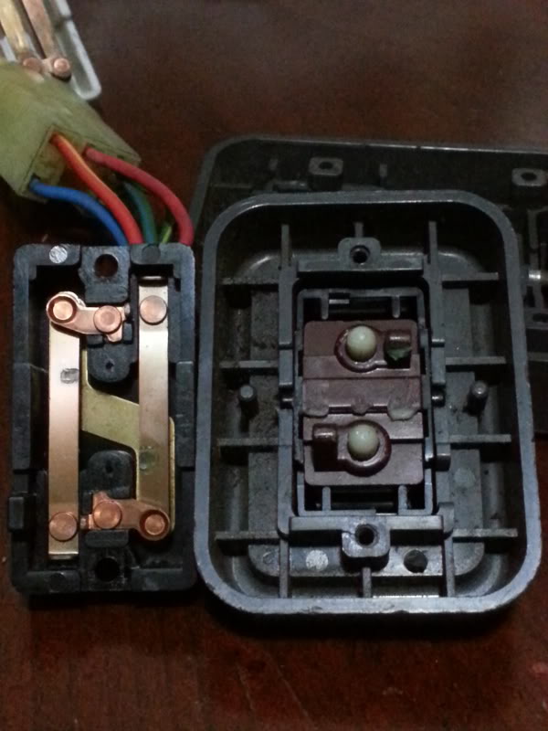

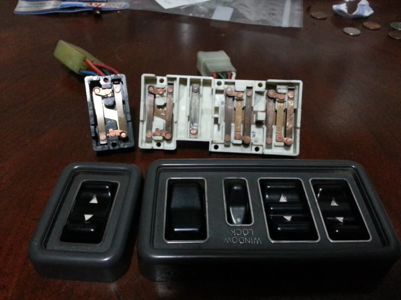

MARK Found you a replacement passenger side window controll button for $15 lol http://compare.ebay.com/like/350859809235?var=lv&ltyp=AllFixedPriceItemTypes&var=sbar
This one is $10.95
http://www.rakuten.com/prod/hqrp-pow...ngId=282573736
this one is $25
http://www.switchdoctor.net/toyota-4...FUSCQgod_WIAig
MASTER WINDOW SWITCH!
$70 http://www.switchdoctor.net/toyota-4...FYaDQgodfjgAJg
$80 http://compare.ebay.com/like/390361688458?var=lv&ltyp=AllFixedPriceItemTypes&var=sbar
Granted none of these are factory. They are all aftermarket. but heck they all look like the original. i could care less. So long as they work properly.
You see, you dont need to pay $340 at a toyota parts store for this. I'd much rather buy one of these whenever mine ever goes out.

Thanks a lot for posting that buddy! That's good to know they're available as Toyota faces out every single thing that we could possibly need! Lol.
Ima go order that thing, the passenger side one at least. My driver side one works for yours up or down but not the passenger. Sweet!

Here's those pix you requested.

Yeah, that's what I remember! Thanx! The whole cover and toggle are one piece. .... Thanx again.

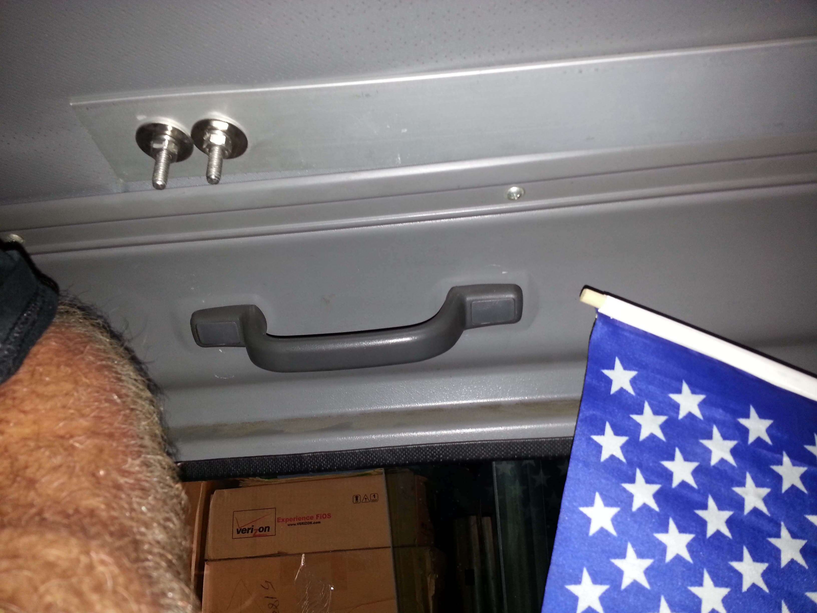

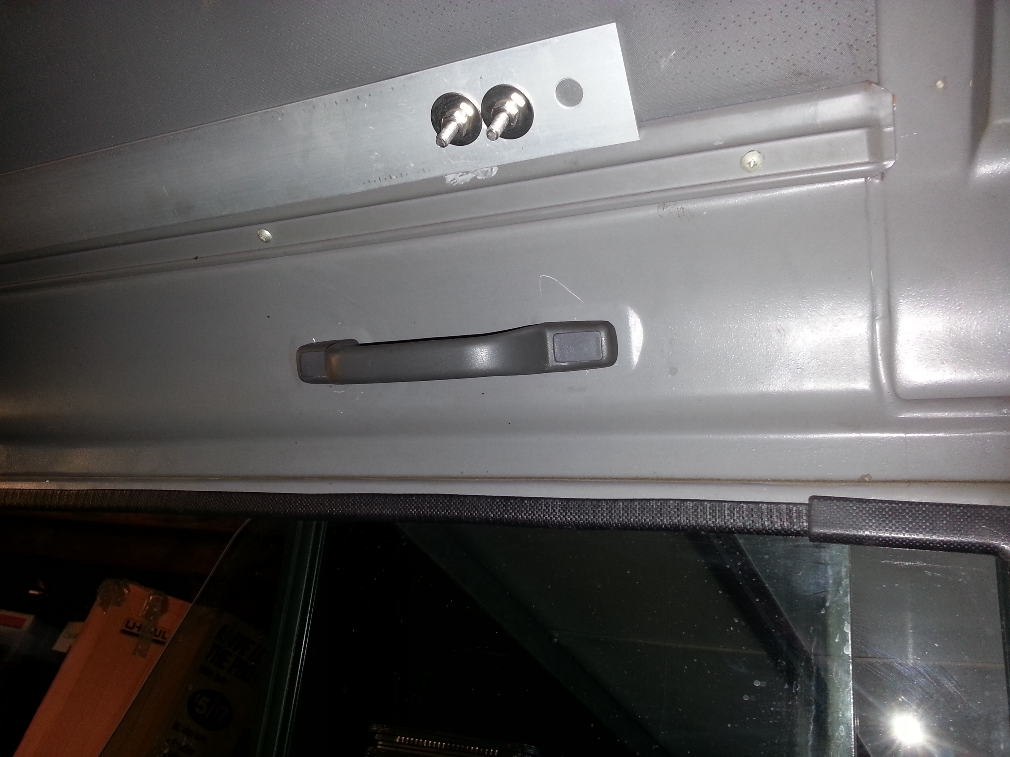

First, I went out today and installed the LC engineering idle air adjustment screw... No matter how tight I screwed that thing and I could not get it down below 800 rpm. Then I installed my factory one again with the new o-ring ring from the LC engineering adjustment screw... And, well, it worked and went all the way in had I wanted it to. They are exactly the same length and amount of threads... I just don't understand why it's getting so tight near the bottom. The factory one screws in or out without a lot of resistance but with some after the new o'ring...... But, there are no hamburger threads inside the throttle body or on the factory screw. Either LC Engineering didn't get this right or I just have to screw it in and out a few times? That makes me a little nervous as I got one throttle body screw hole to mess with... Okay this is just sounding terrible by now! Haha. But you'll know what I mean.
Then, it seems to be idling around 800 rpm with the screw nearly all the way in... Then the AC idle up VSV worked every single time after a few minutes of warm up even... It worked all day And stayed at 800 rpm on the idle and I'll be up on the AC... Until this evening, when I came back from dinner... I pulled in the garage clicked on the AC and it would not idle up. Secondly, the idle after around 6 p.m., from that point on, never wanted to stay above 700 or 750. Something is freaking going on in regards to ambient temps outside. I'll get back to all that later...
Got the oh crap handles in todayn in back......

Hust change out your grey button housing onto the new on and you're set

Hey Mark what are you plans for these skull pokers?
Cut flush and cap?

I was gonna say if you get the idle screw set and where you want it. I would dab a little silicone on it. It will keep it in place and its something you don't adjust all the time.
Cut flush and cap?
Yeah, I know, I rarely leave things I'm done like that... And, yes, I plan to cut them to nearly flush and use quarter 20 caps. I just hadn't bothered because I really have backseat passengers anymore. I already have the caps and everything just like I do on the rear... But I'm happy that handles came out nice and tight and they look pretty good I think? Never hurts to have something to hang things off either, especially when sleeping back there! Lol maybe now I can hang a curtain 2 only further my super blackout methods! Lol.
Yeah, I could.... But with the new o'rings it doesn't seem to move without some pretty decent effort. Its not backing OR seizing up, the original screw, but it's definitely much tighter with the o-ring. The LC Engineering screw... It's definitely the threads that are just tighter. It's almost as if its 26 years too late? Lol. I asked one time about getting a new idle - air screw o-ring at Toyota( I know, I know, I know,... But Toyota of rings for those applications are flat on the inside where it rests in the journal... Just like the o-ring for the wrap around pipe that goes into the center of the intake on the 22 re) . My buddy at the time that was there, right before he retired, looked and looked and basically told me that I had to buy the whole throttle body. Just like Toyota isn't it? Haha. When I asked about buying a new fusible link box, or even just the cover, he said that you cannot get any of that stuff without the purchase of an entire harness at around 1100 dollars on discount? I can't remember but it was astronomical.
My problem in doing that( silicon ) is that I seem to have some very obvious Auto adjusting going on which seems to be related to ambient temperatures. Yesterday, having nothing to do with altitude or anything else, I started it cold and warmed up the rig, and it did its thing and wound up around 800 or 850 rpm... It was really difficult to get it to go down below that, even after it was fully warm and have been running for about 20 to 30 minutes. I also might worry about minuscule particles of silicon winding up in those tiny vacuum ports or just the main one that bypasses the throttle plate?
