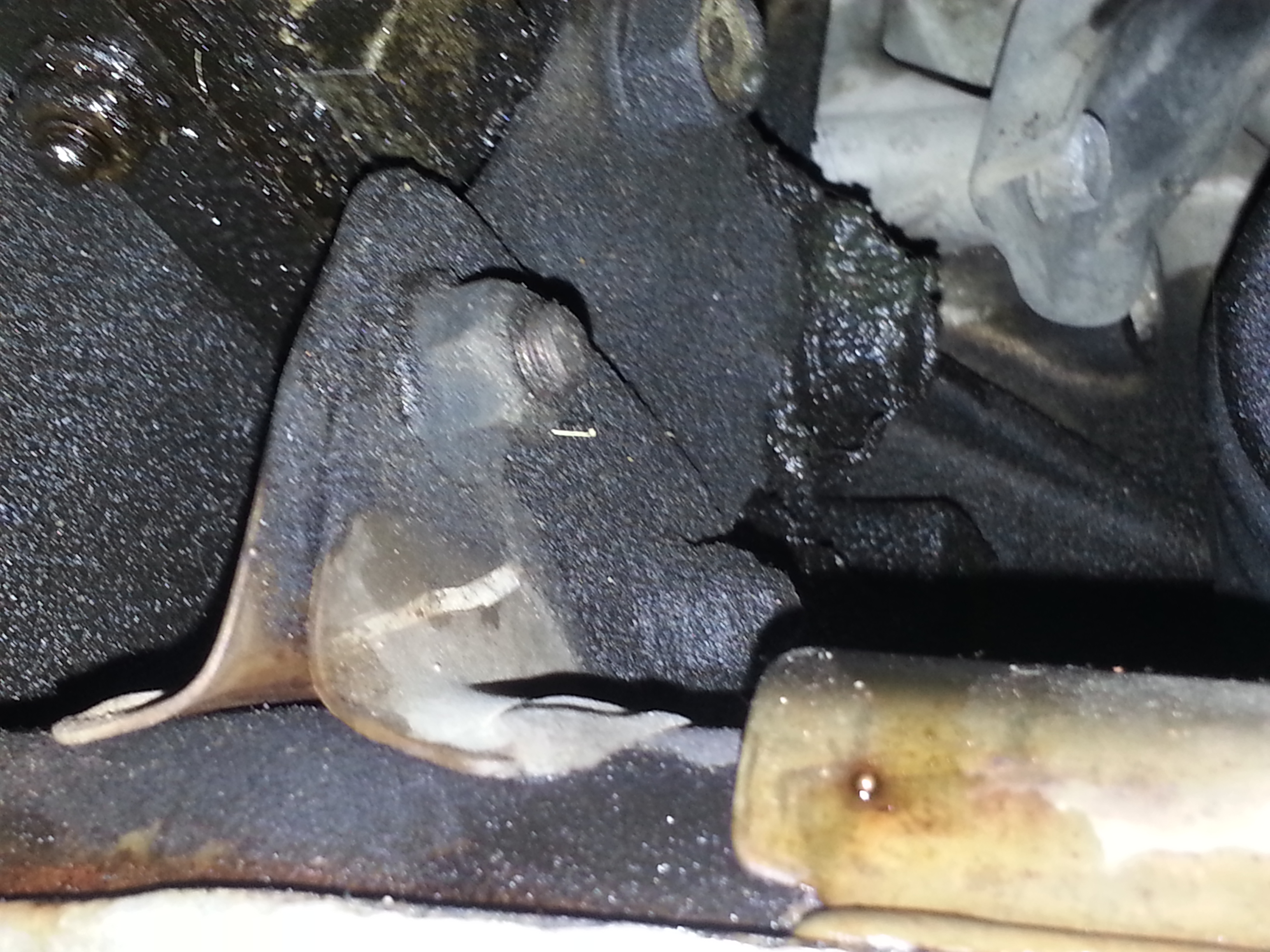

One thing that puzzles me... I can't be sure the front main is leaking at all. There is absolutely zero oil or oil residue on the back or sides of the crank pulley. I'm sure there is some type of slinger on there... But I could see the oil pan causing that type of residue. Anyway, I will look into how much more work it is and then I'm going to do anyway so I don't even know why I would bother looking it up other than for prerequisite homeschooling before assault! ... Hahaha.

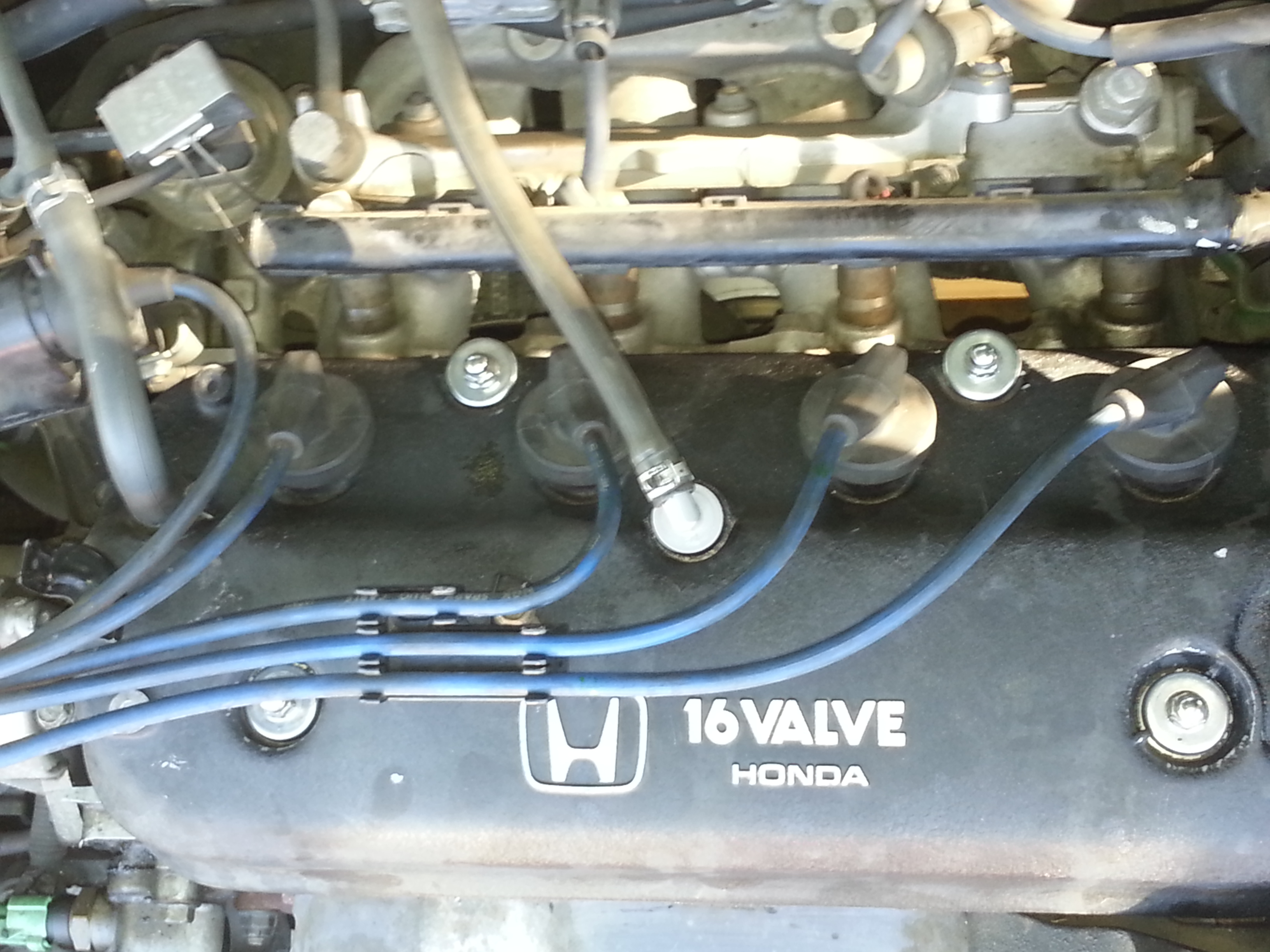

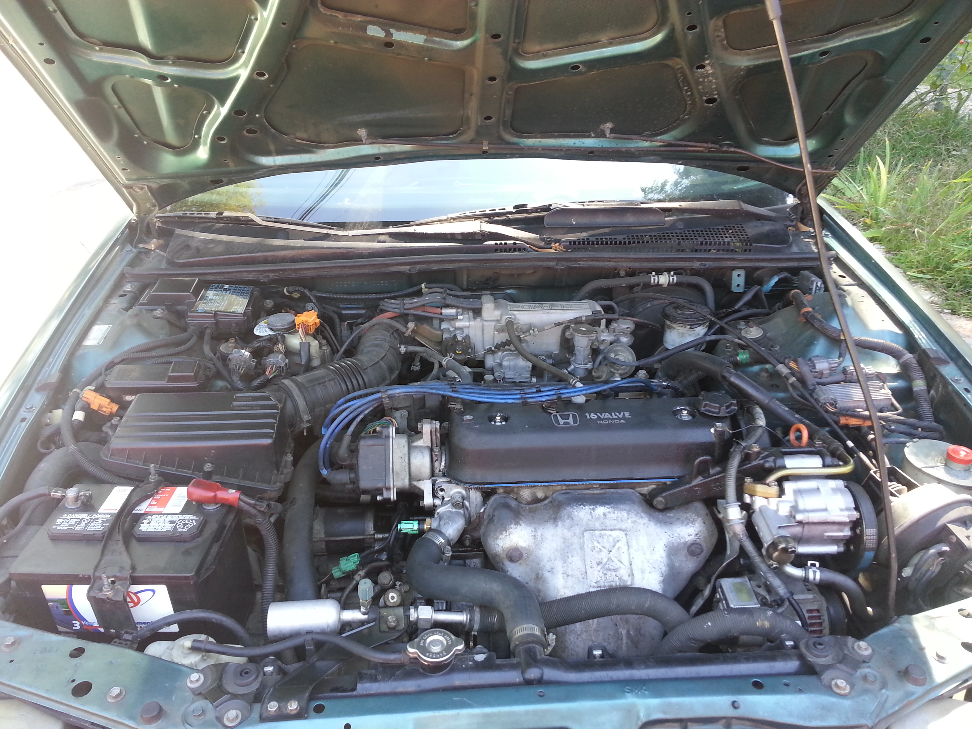

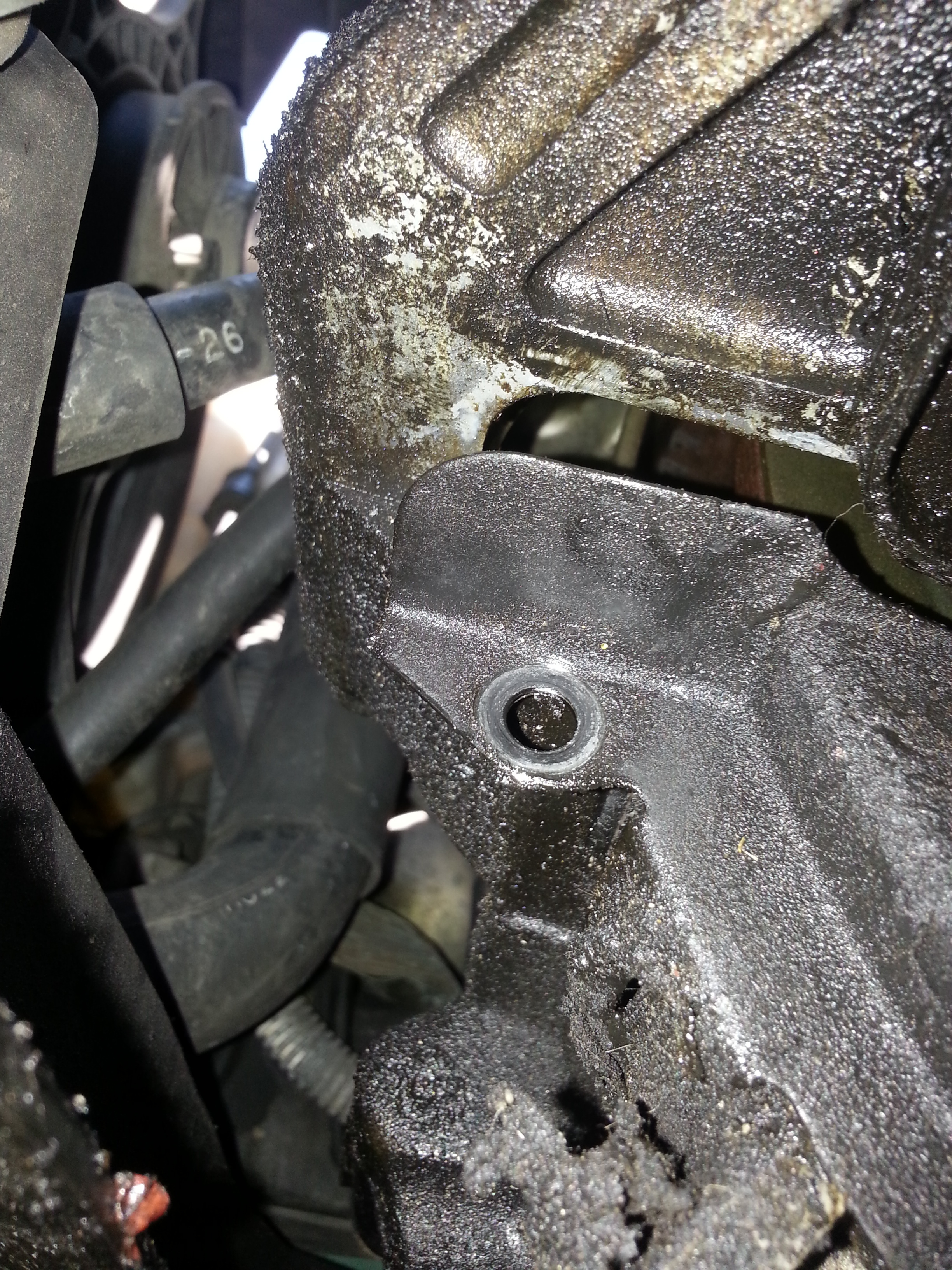

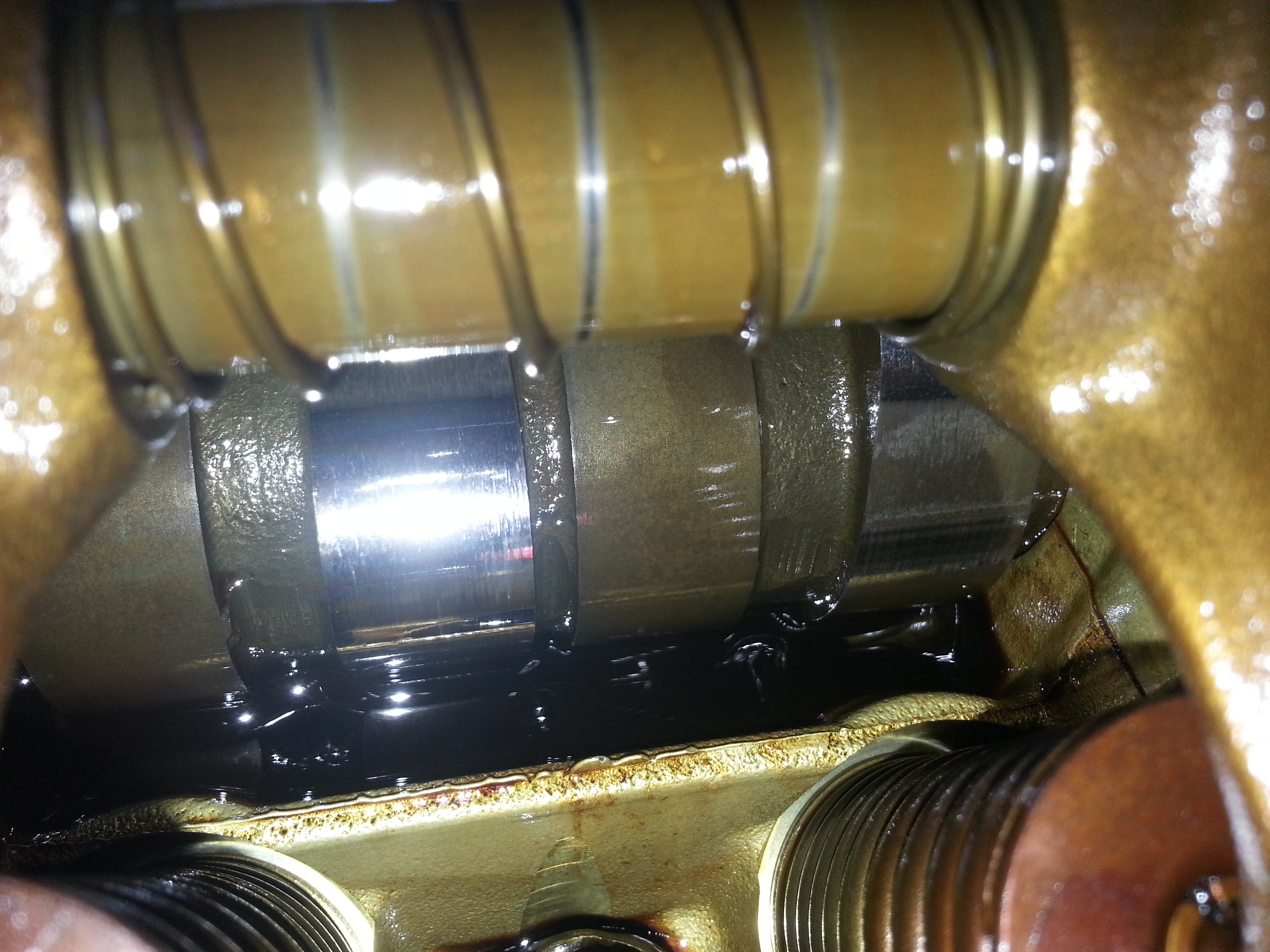

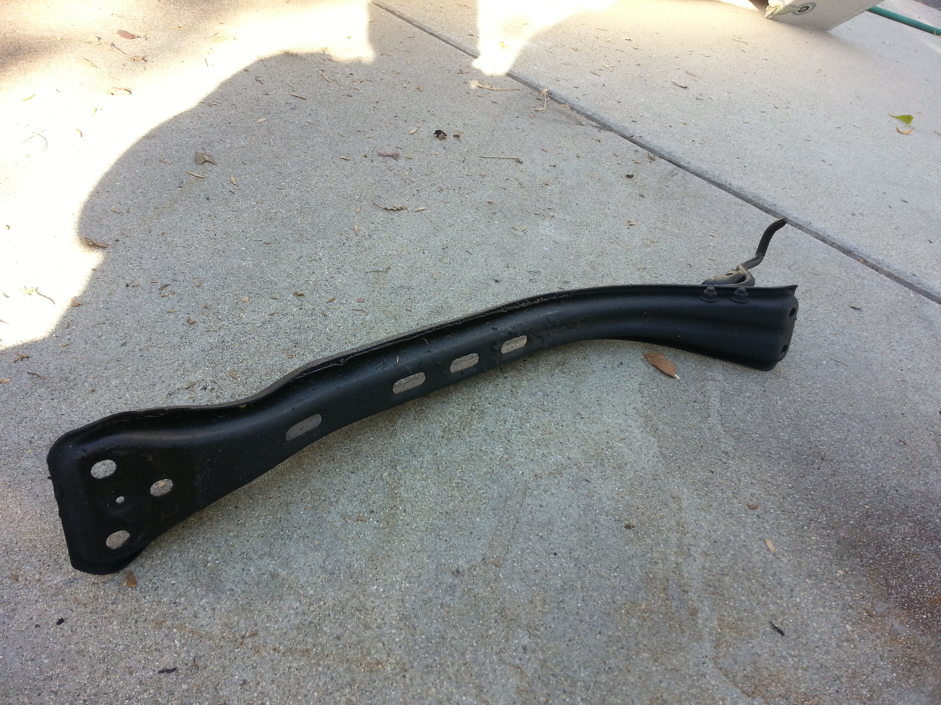

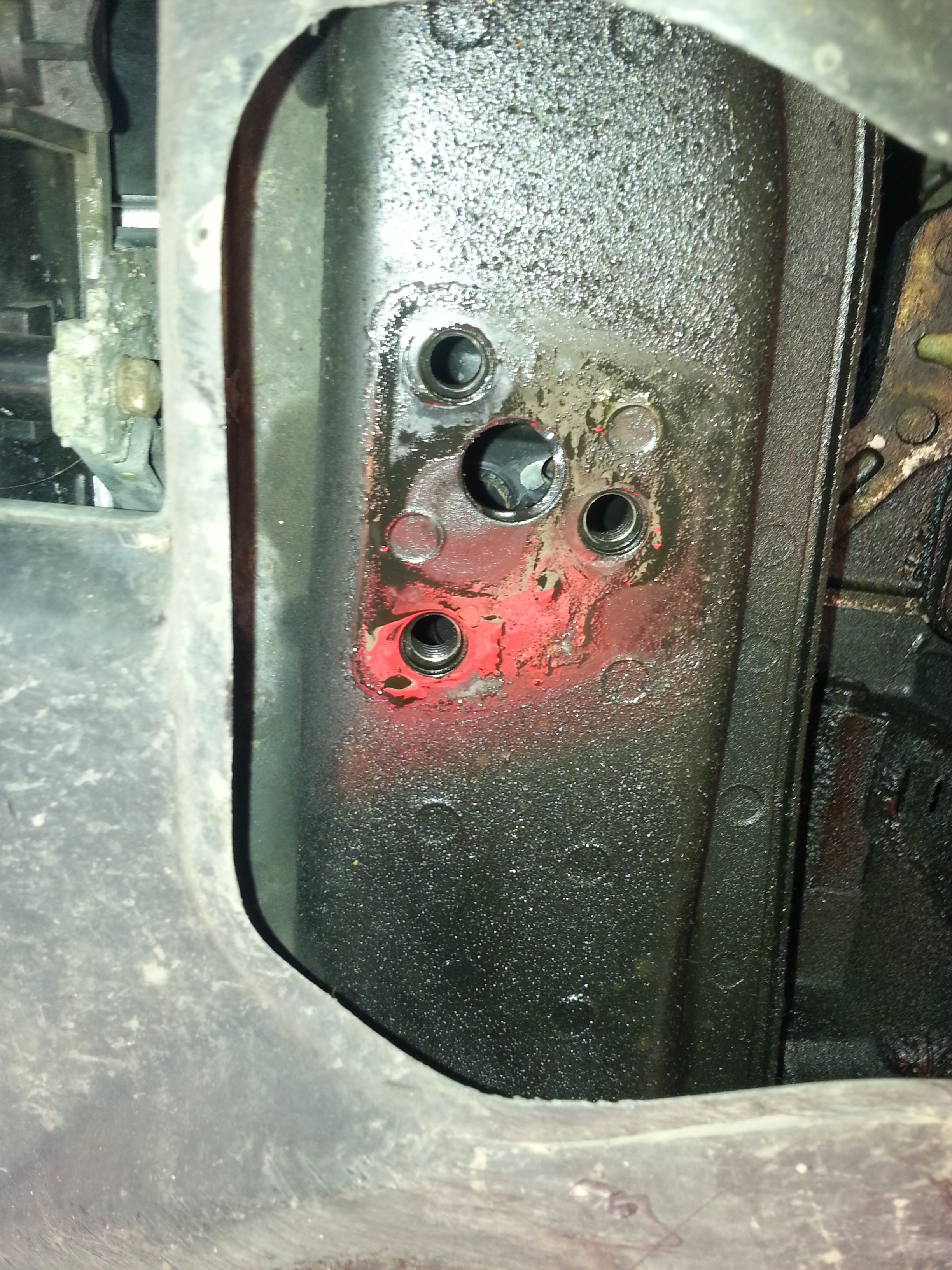

Finished up the valve cover gasket set, checked out the cam'age,... looks pretty good...
All sealed up the right way......
On to the Oil pan and front main seal....

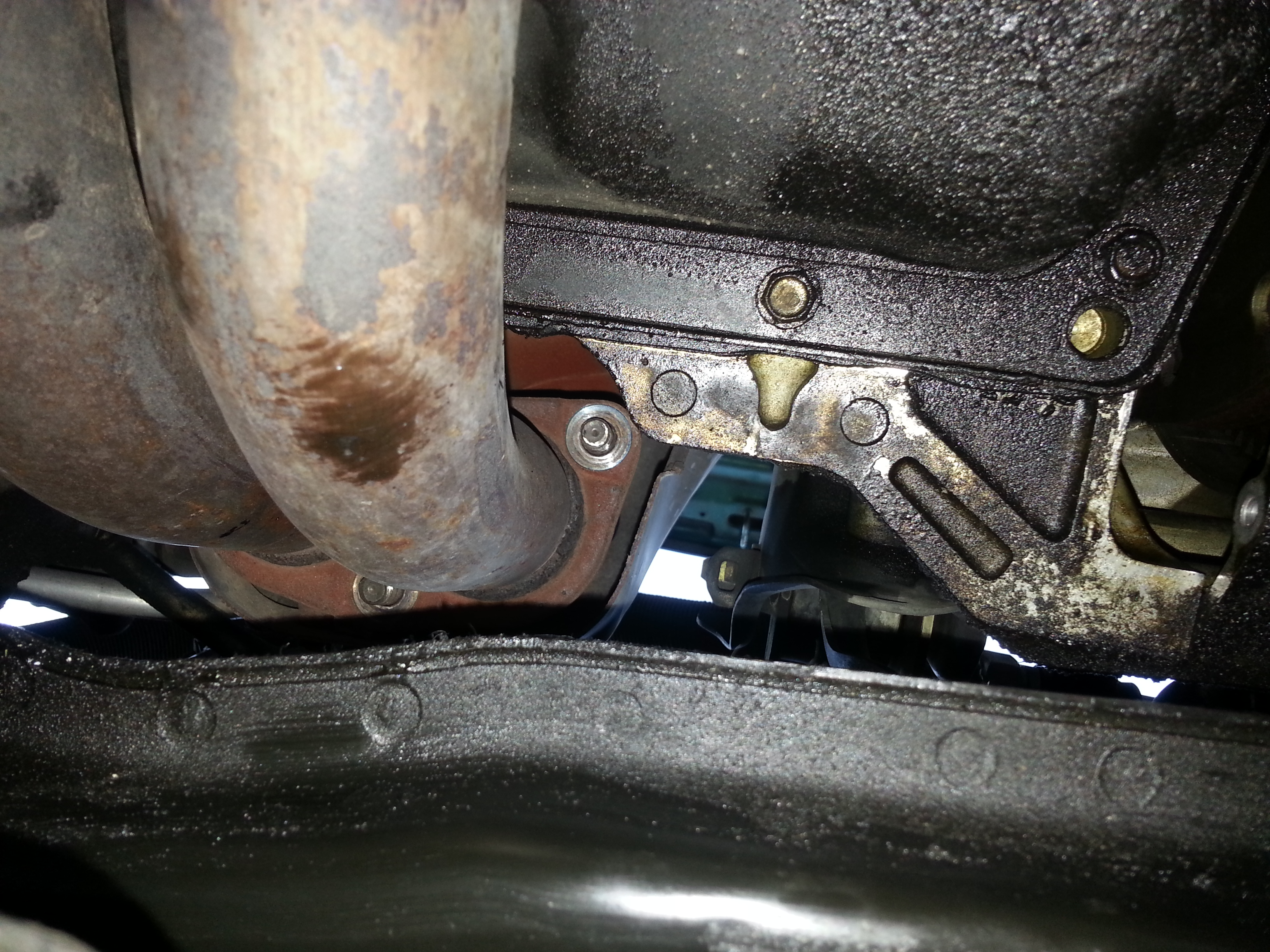

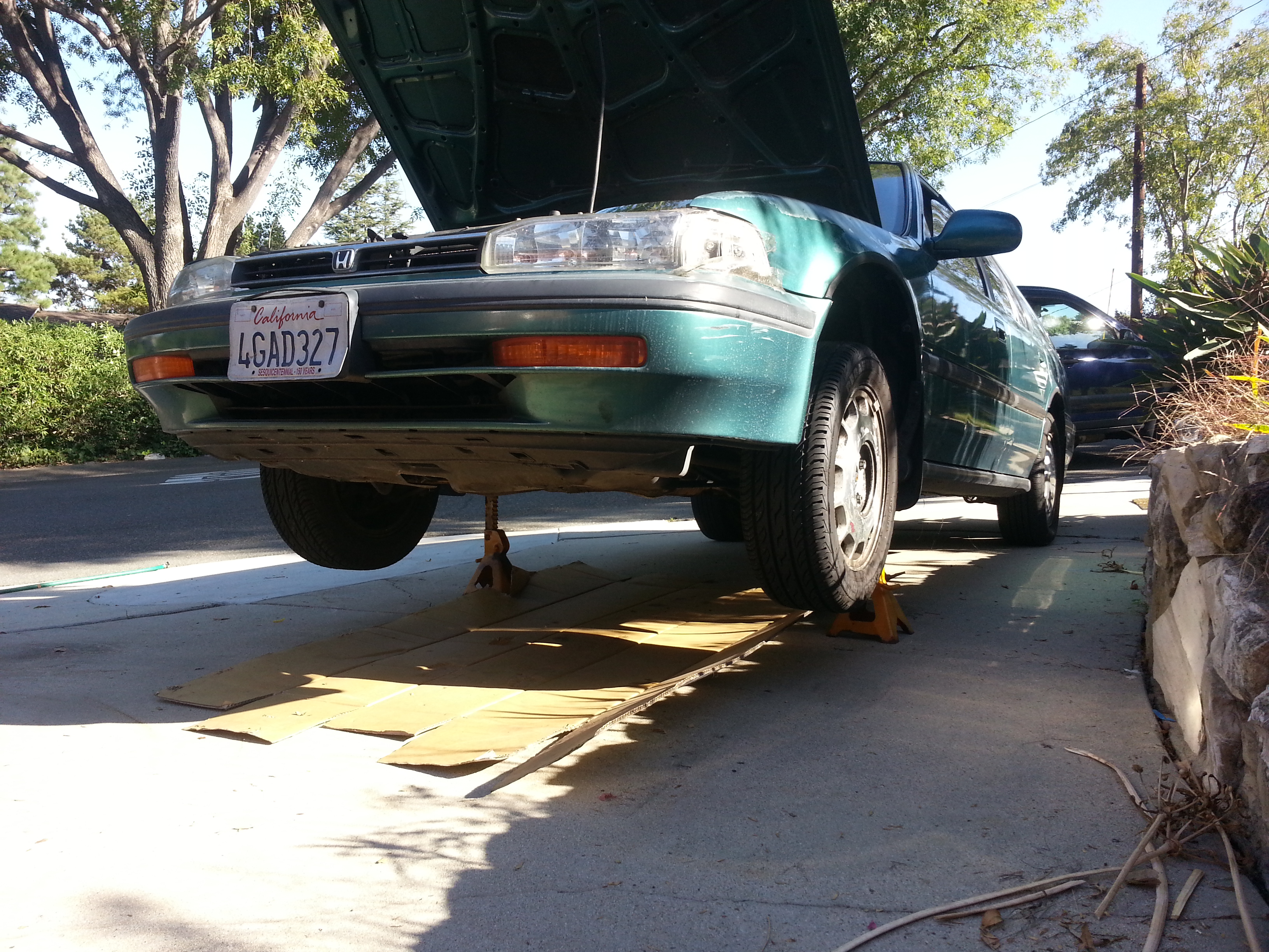

Get em up on jackstands,....
Here,...
Anddddd here,....

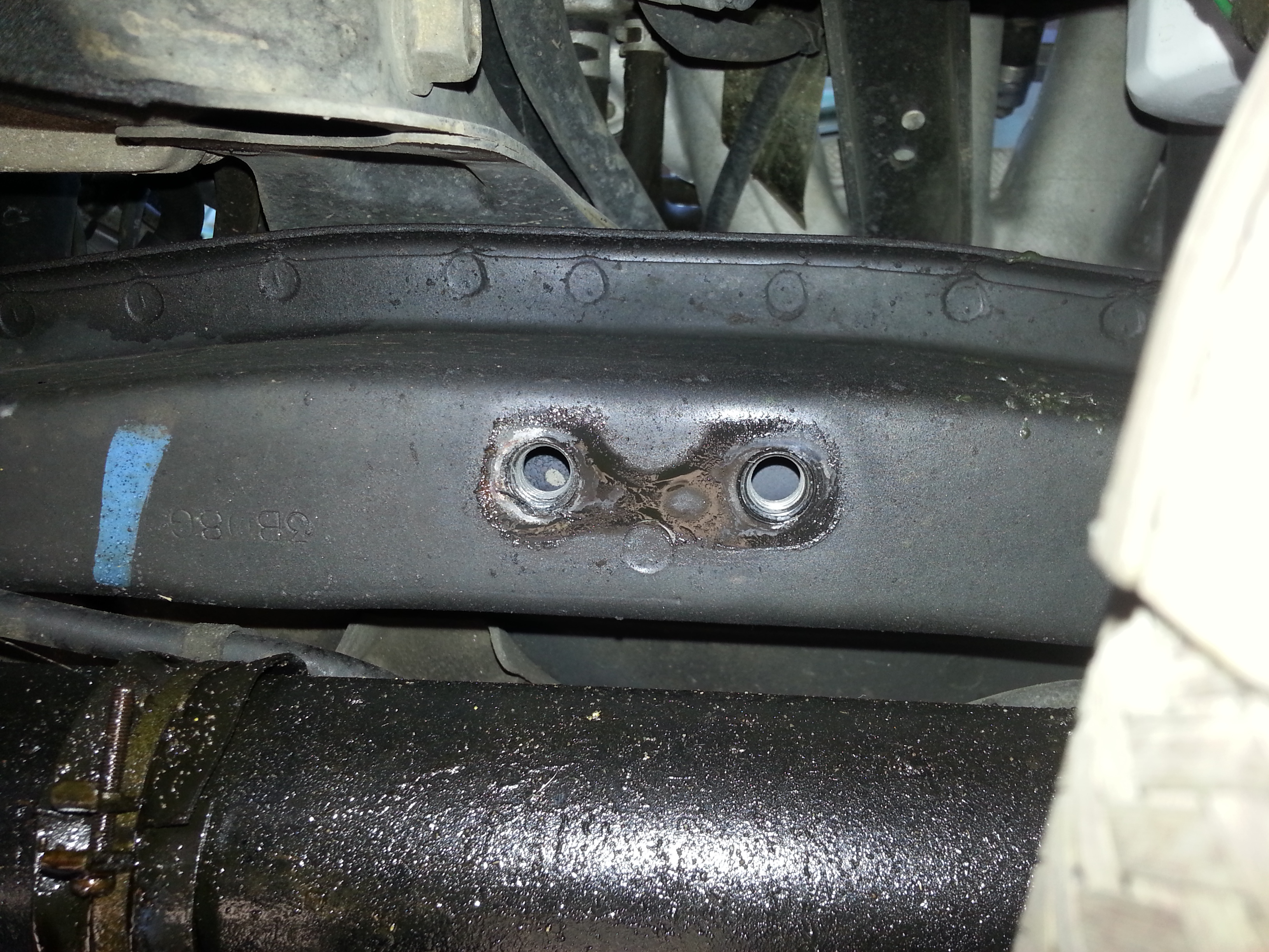

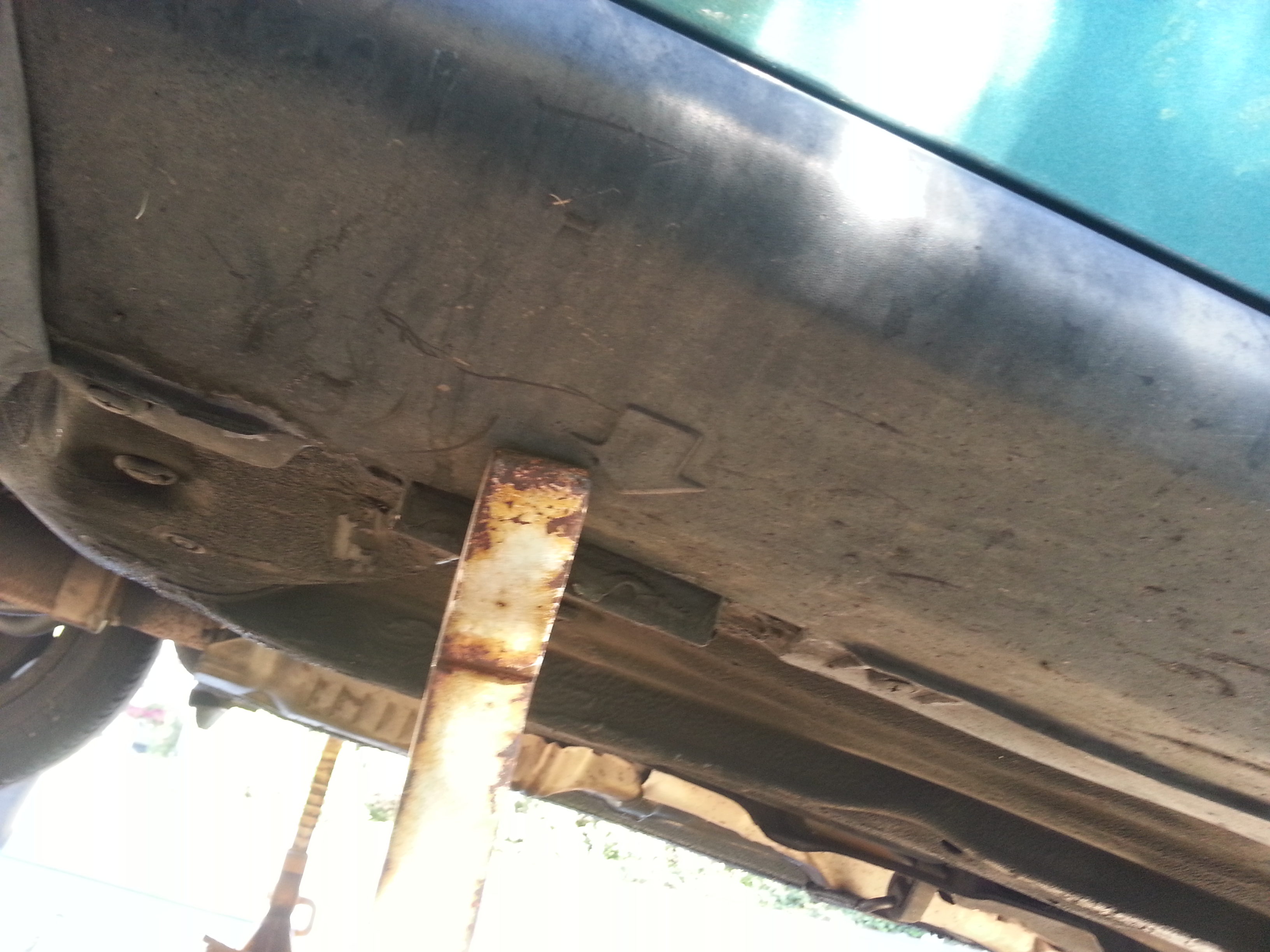

Pulled the crossmember......

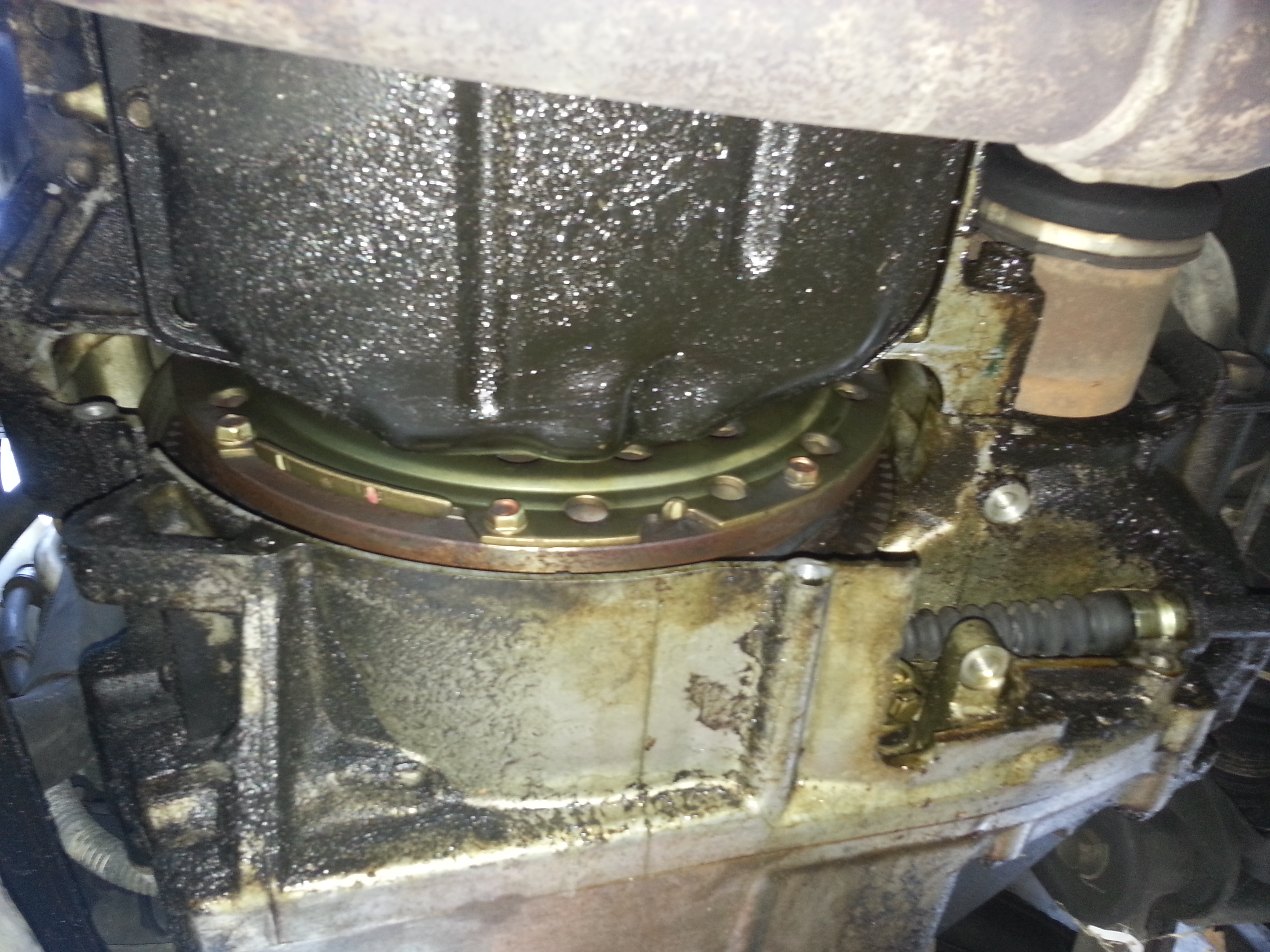

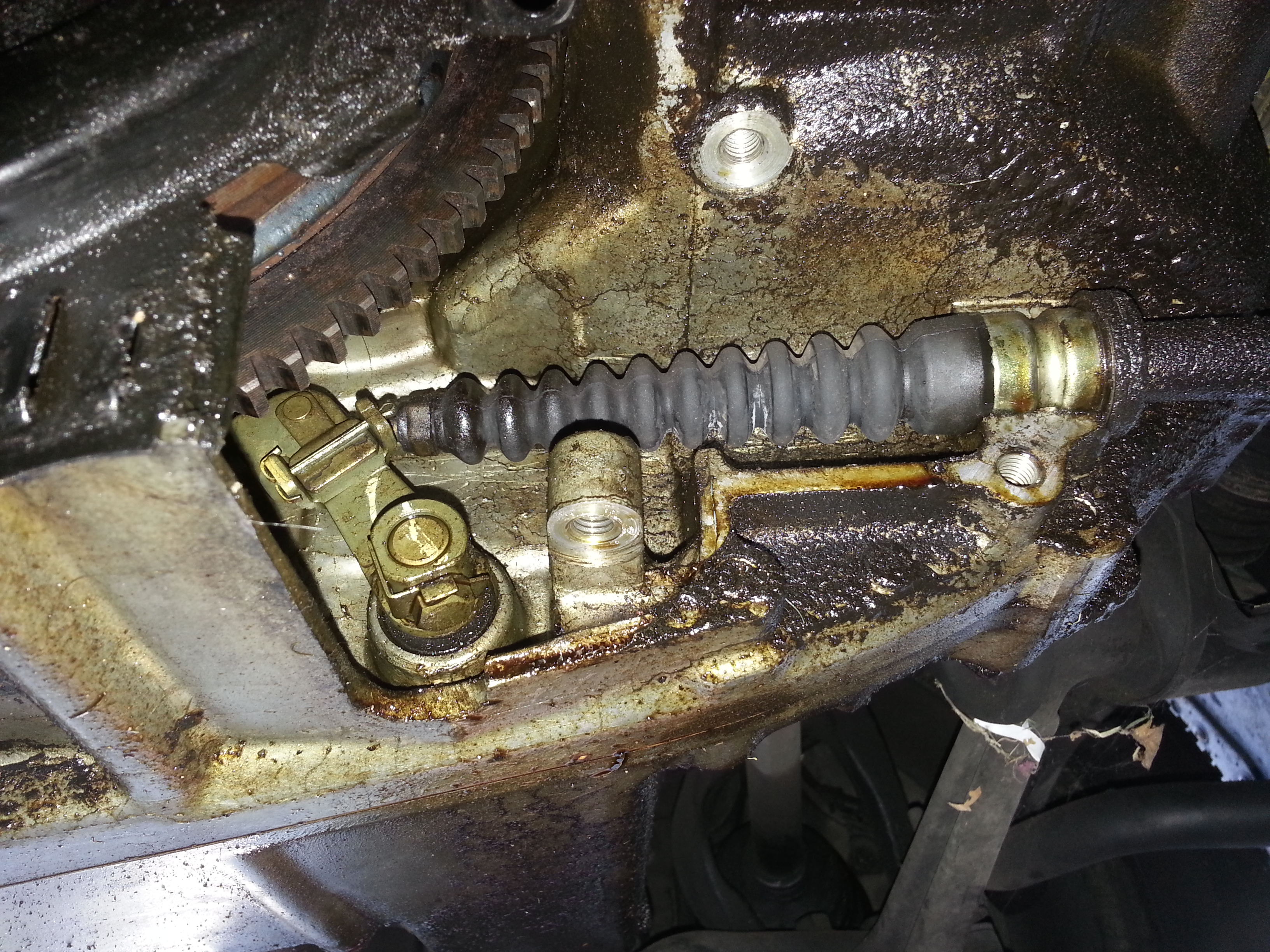

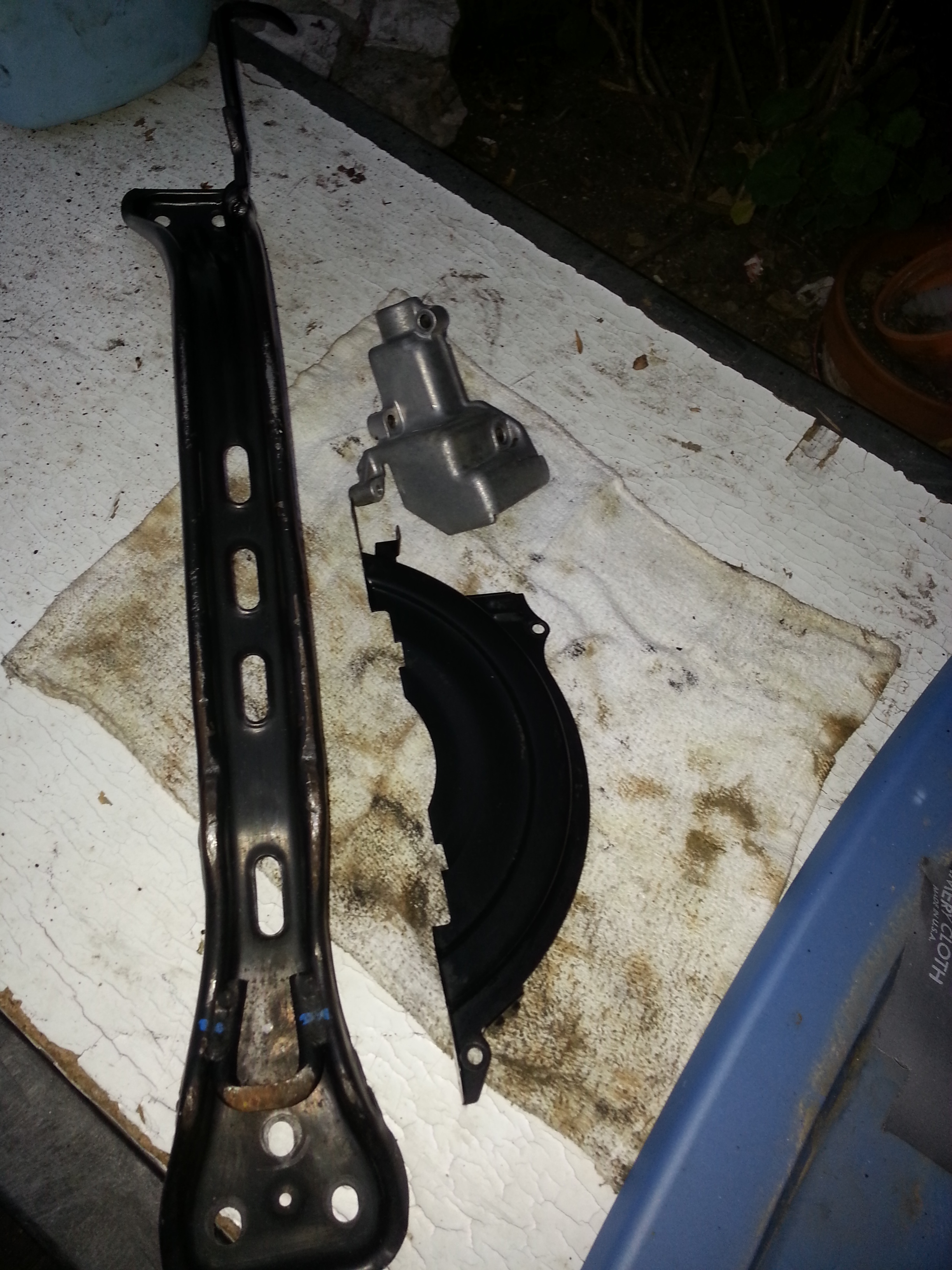

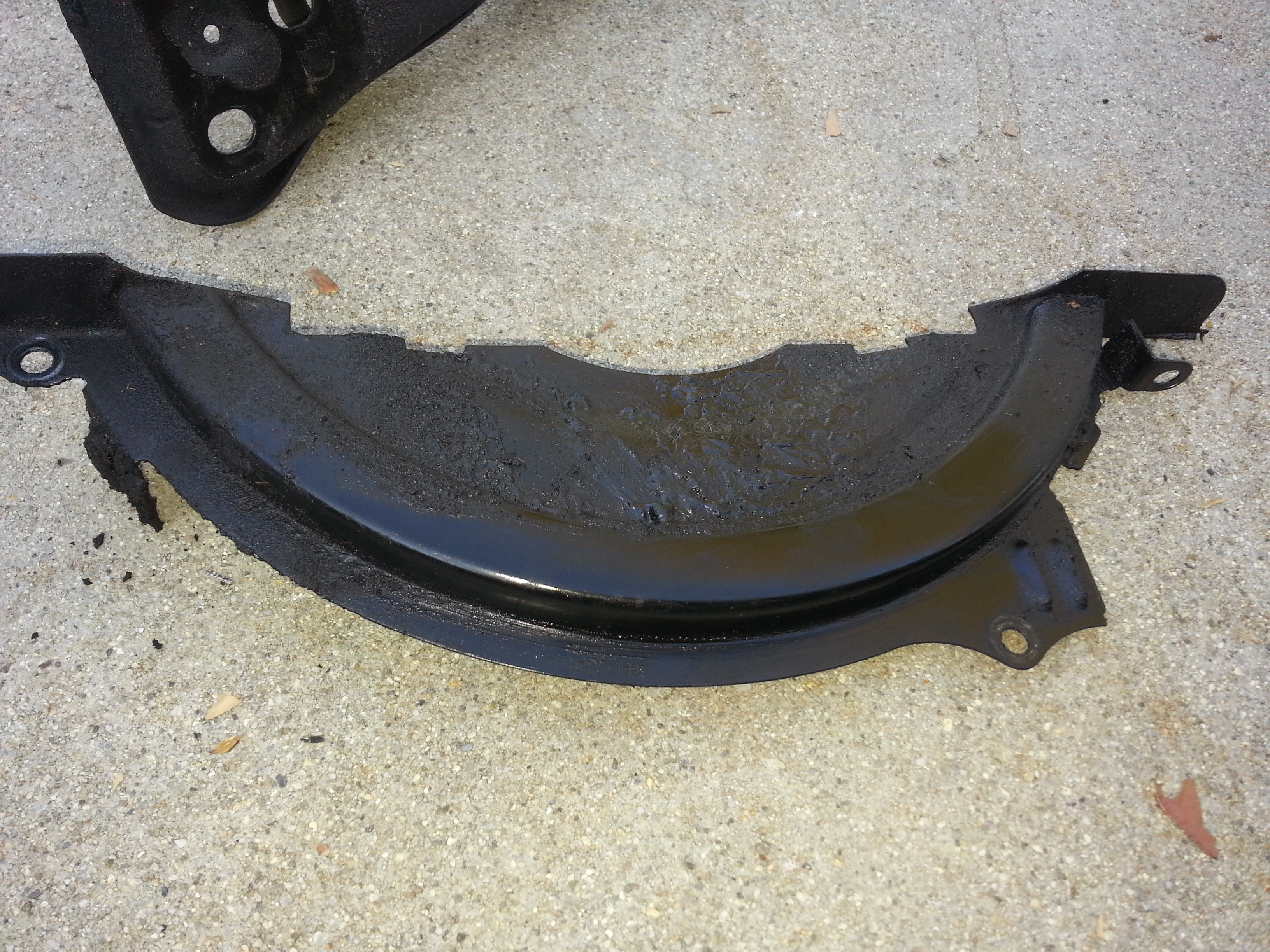

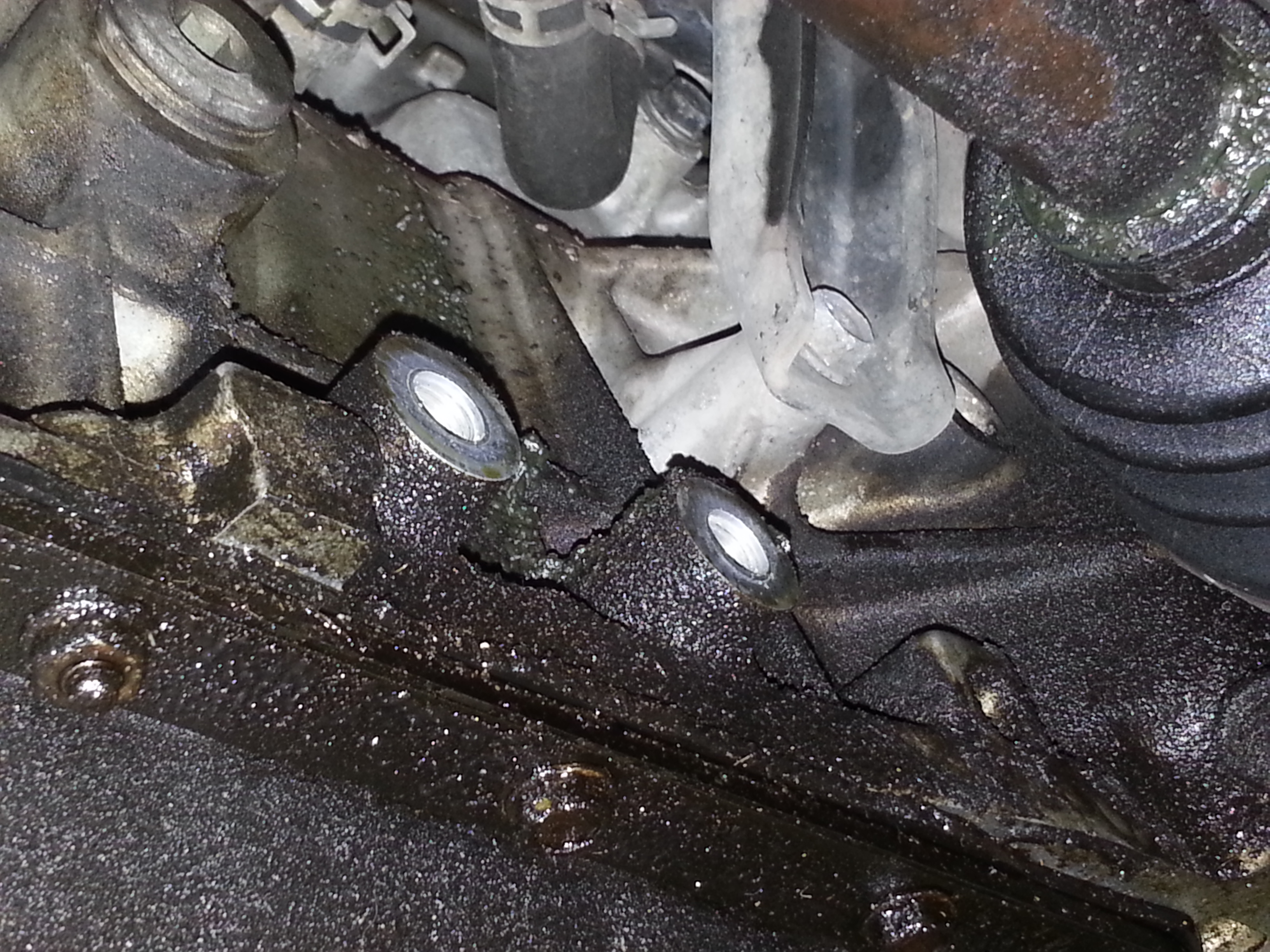

Pulled the flywheel inspection piece and dust shield (have to pull the inspection piece to get the dust shield out)...
HOLY CRAPULA! THESE WERE FILTHY! ..... As is much of the bottom end of the engine...
All cleaned up spotlessly! ....

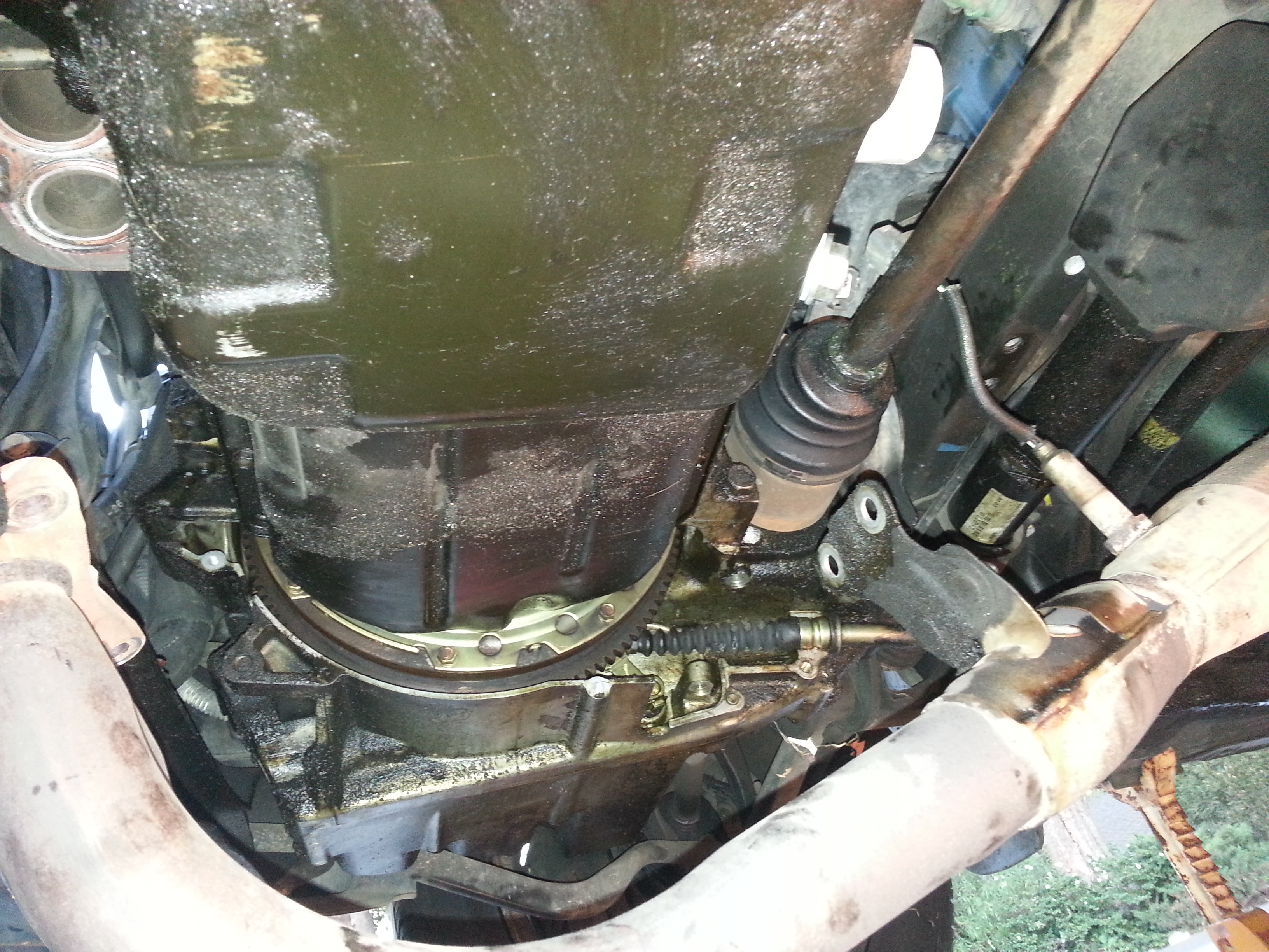

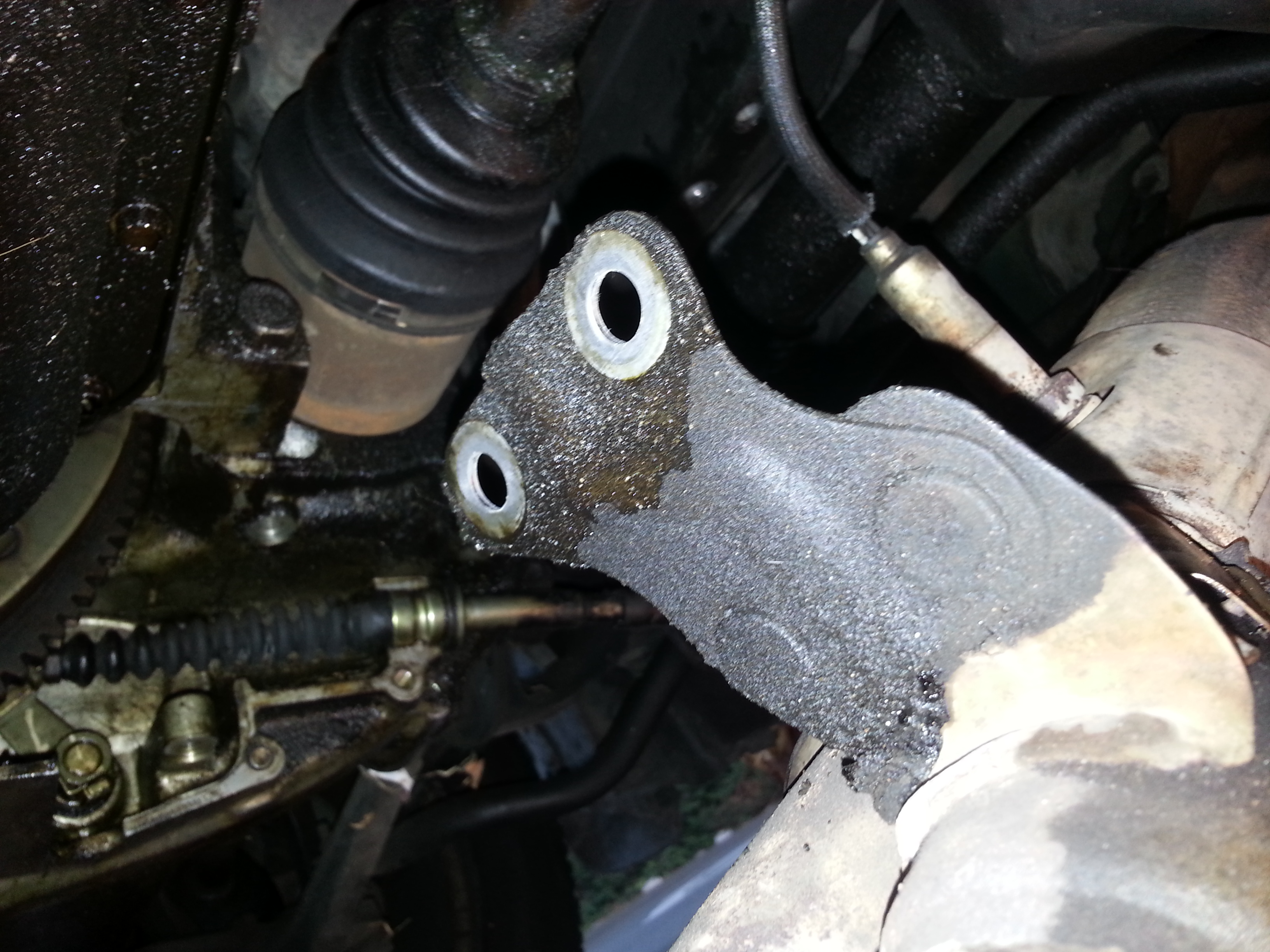

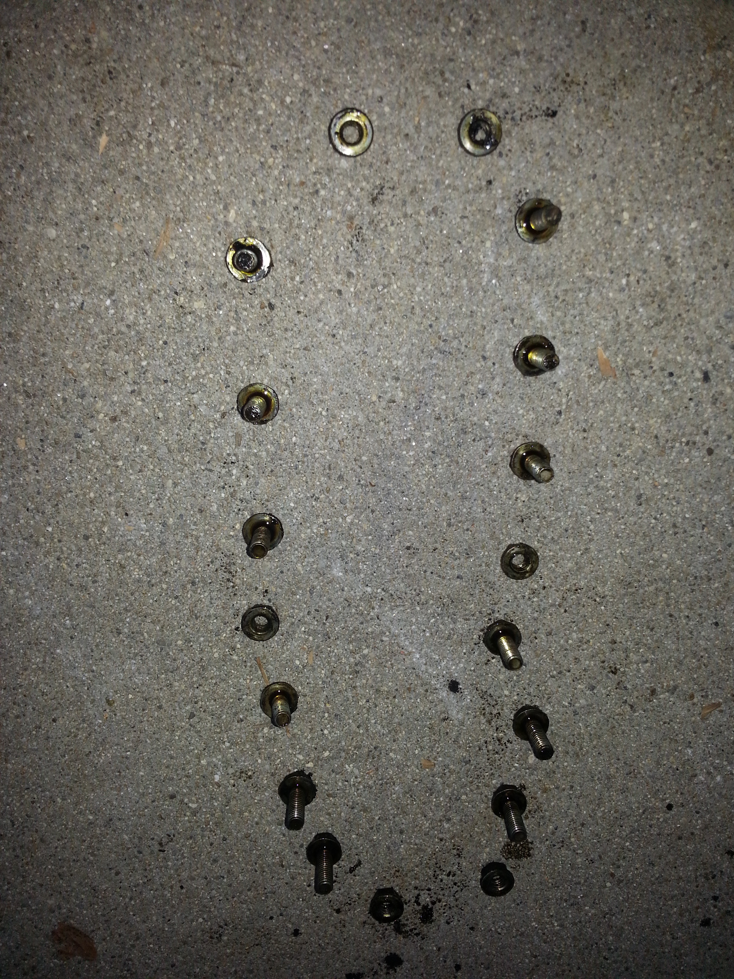

Next, you have to pull the 3 exhaust collector nuts, for which I use an 8 inch extension and 14 inch long impact socket with my half inch drive air wrench..."pop, pop, pop, done"...
Next, pull the two 14 millimeter mounting bolts that suspend the exhaust against the back of the motor...
Then drop all the goodies out of the way,....

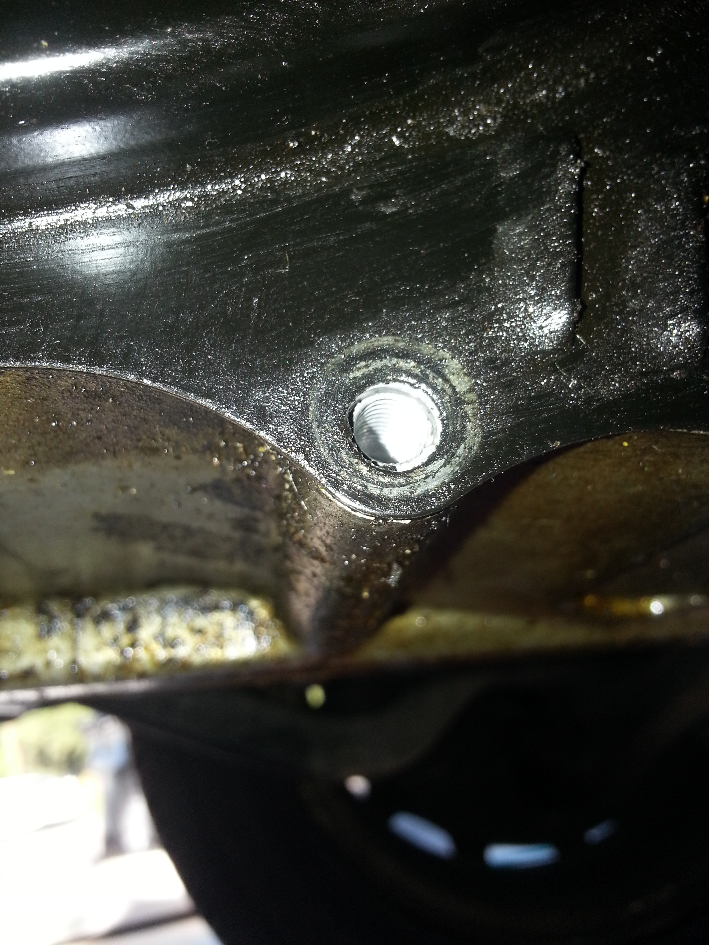

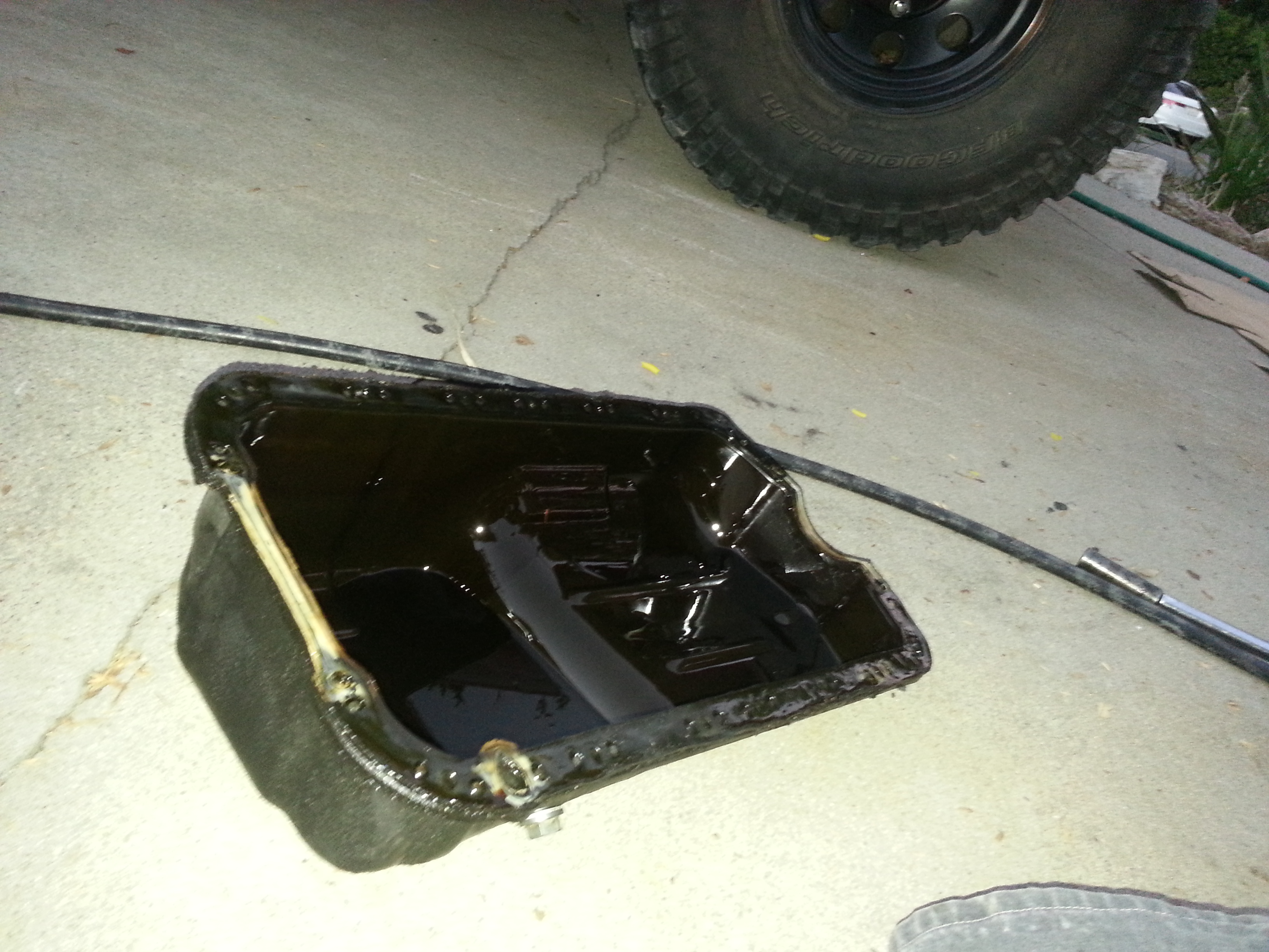

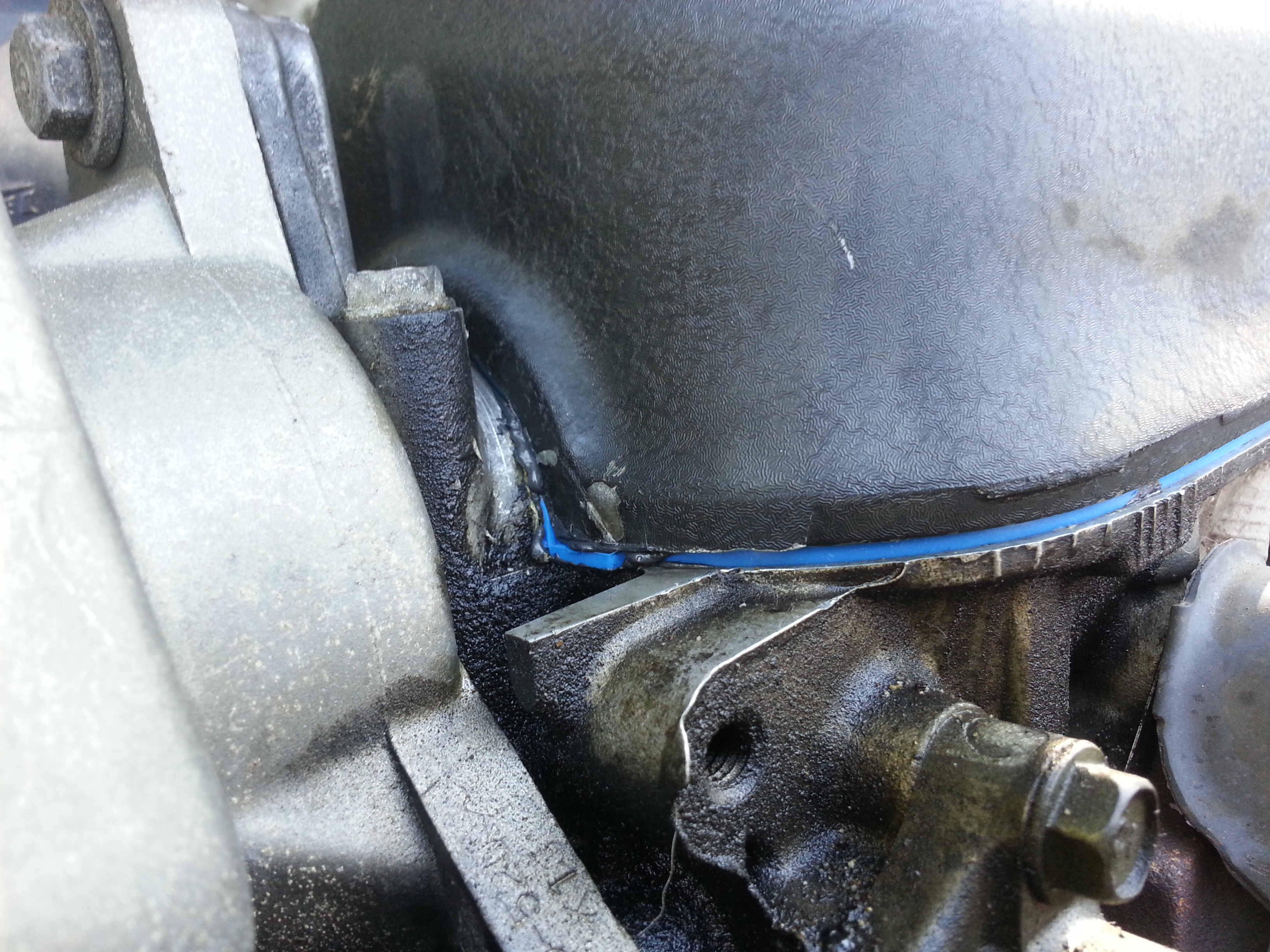

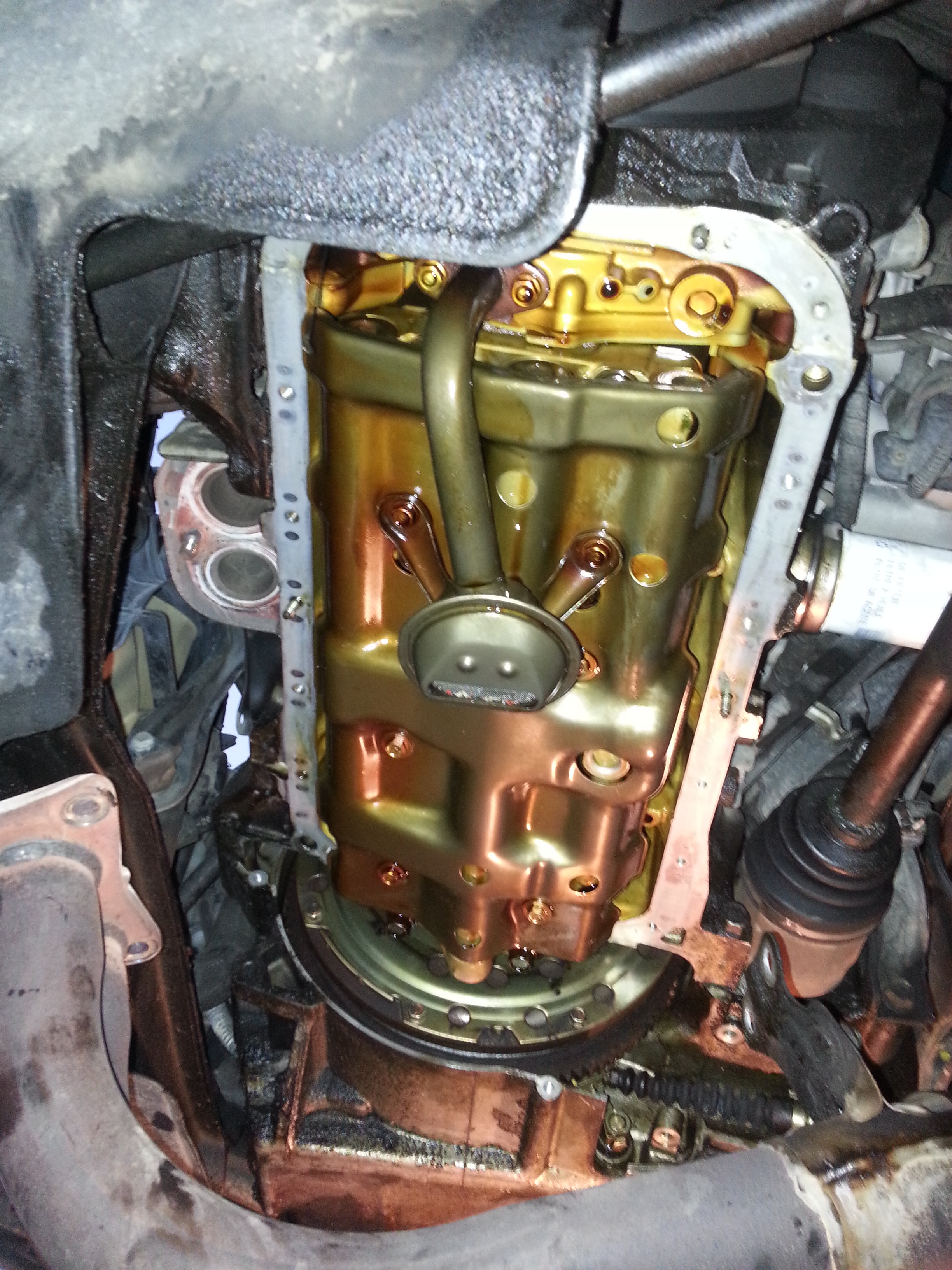

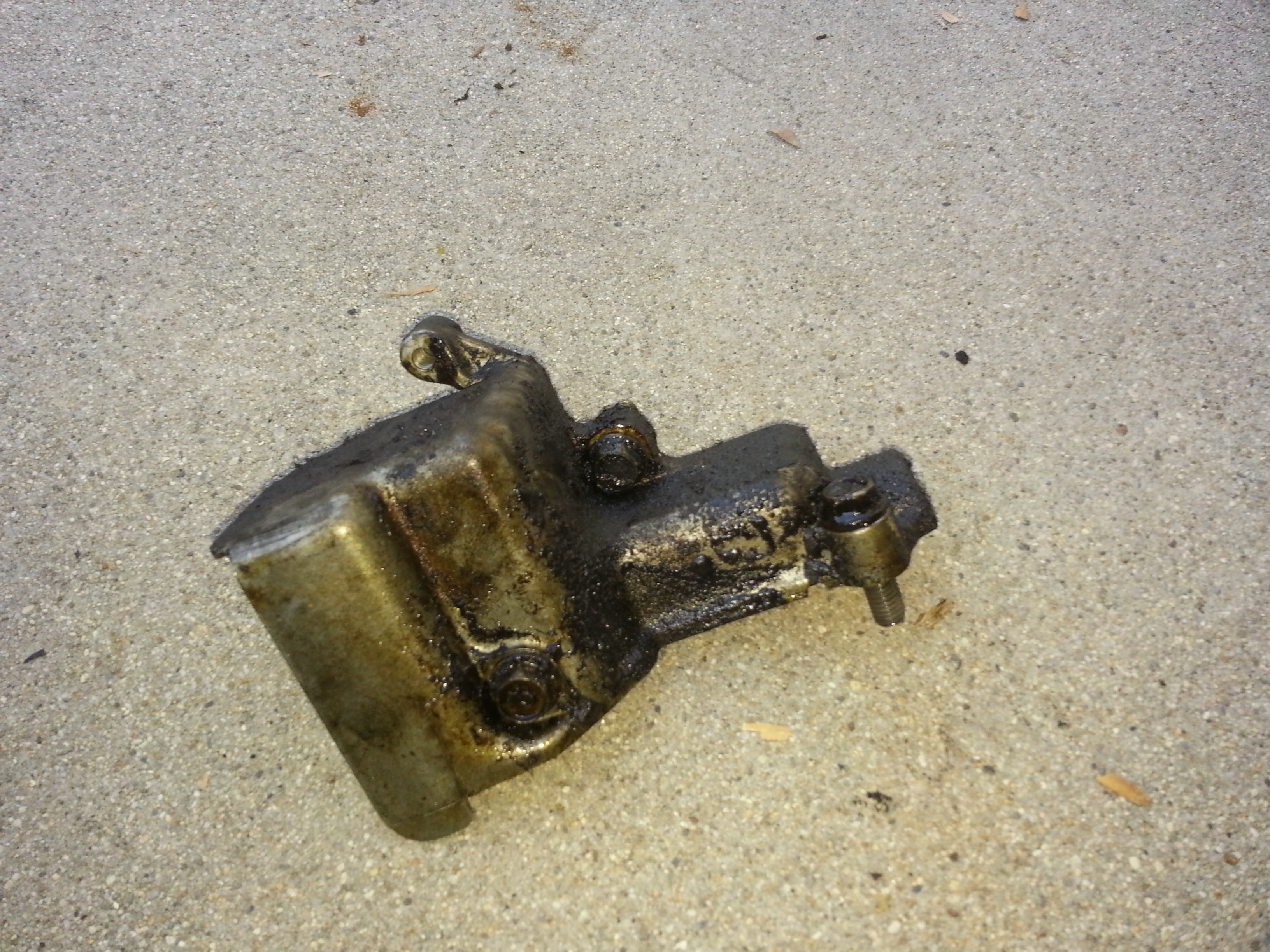

Then start working on you're oil pan bolts,....
Couple good wacks with the rubber mallet, and poof, with a little, very little manipulation, it came right out,......
Cleaned quite a bit of it up, getting ready to pop the pan back on once I get the front main seal in hand tomorrow... It will drip dry all evening, and tomorrow as soon as I can get out there, I will hit it with facetone a little fine grit, then slap the new gasket in with most likely Toyota FIPK, as my FIPG. I'm sure they're all the same, but I have to say, it seems to me that it has sealed flawlessly this last time on my trucks oil pan and timing cover and everything else pretty much..... As I said, cleaned up in part.....
Here,...
Anddddd here,....
