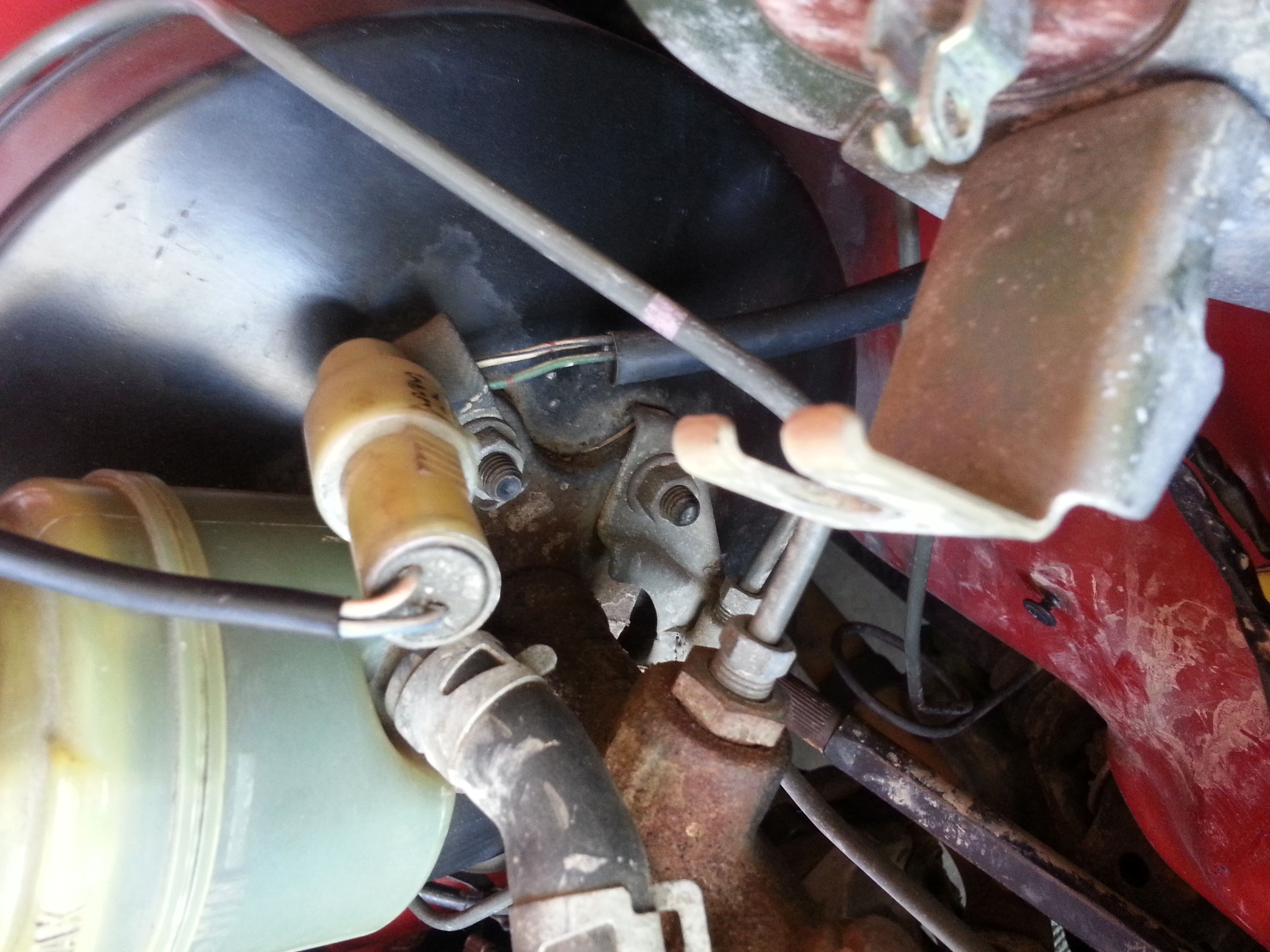

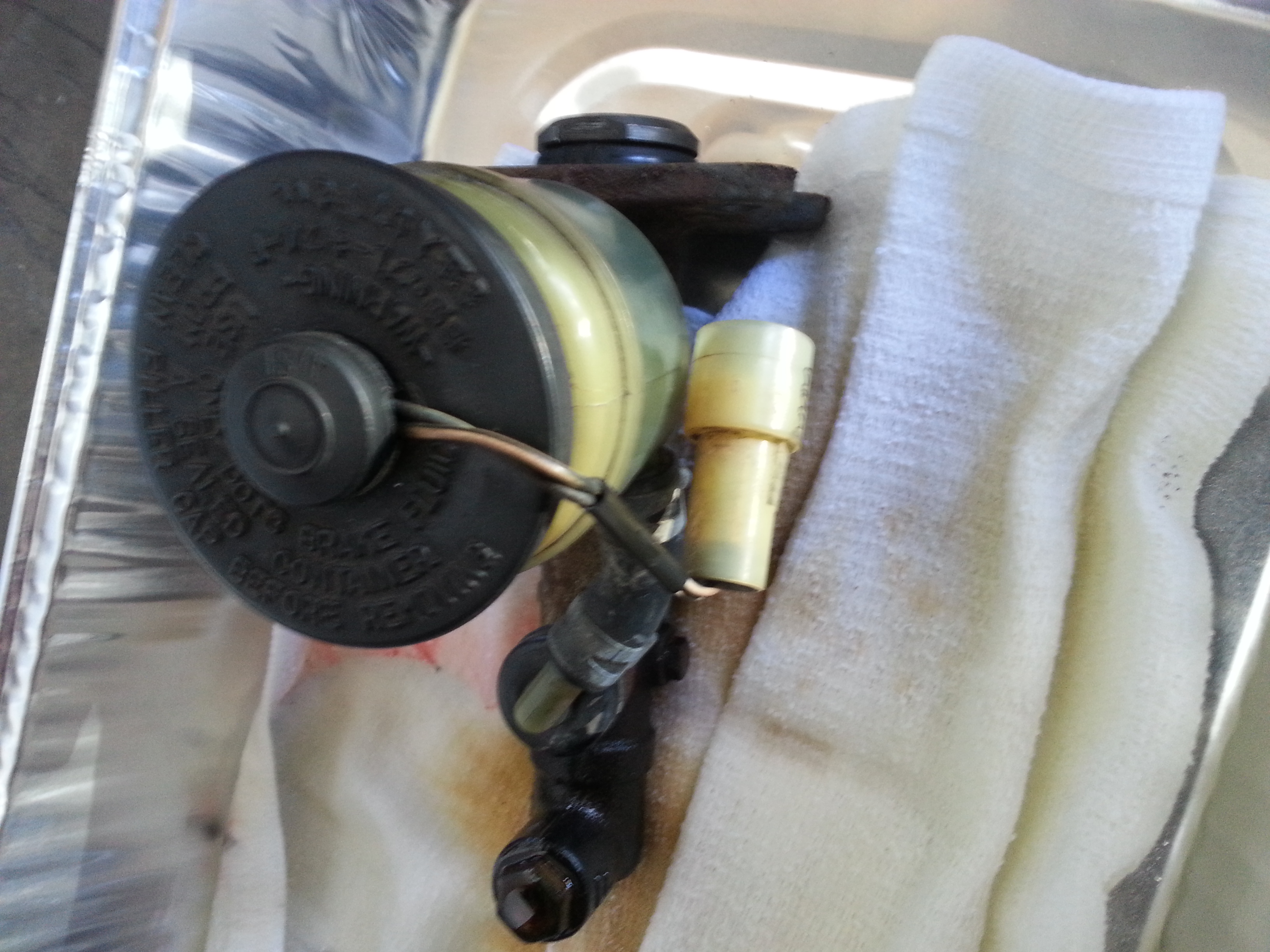

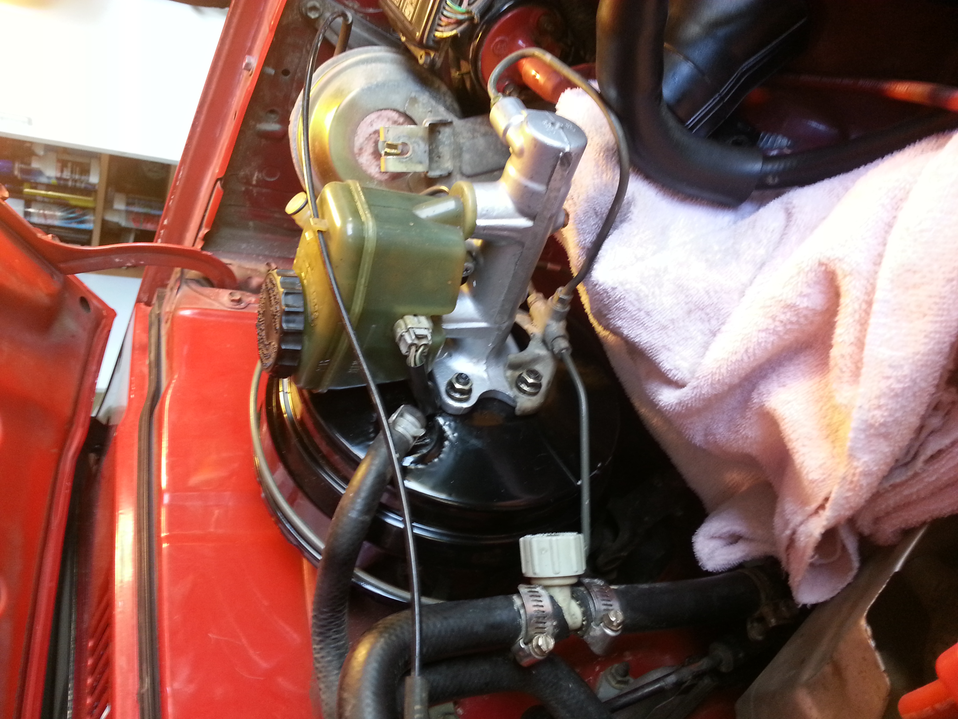

V6 Brake Master and Dual DiaphragmBooster Upgrade?........... CHECK!
Remove booster vacuum, cruise control hose and cable, crack master cyl fluid feed lines, master cyl wiring connector, loosen most of way the master cyl mounting bolts, then free the brake lines from master and pull away multi-line bracket and work the master out. (I have lil plugs that stop the lines from draining)......

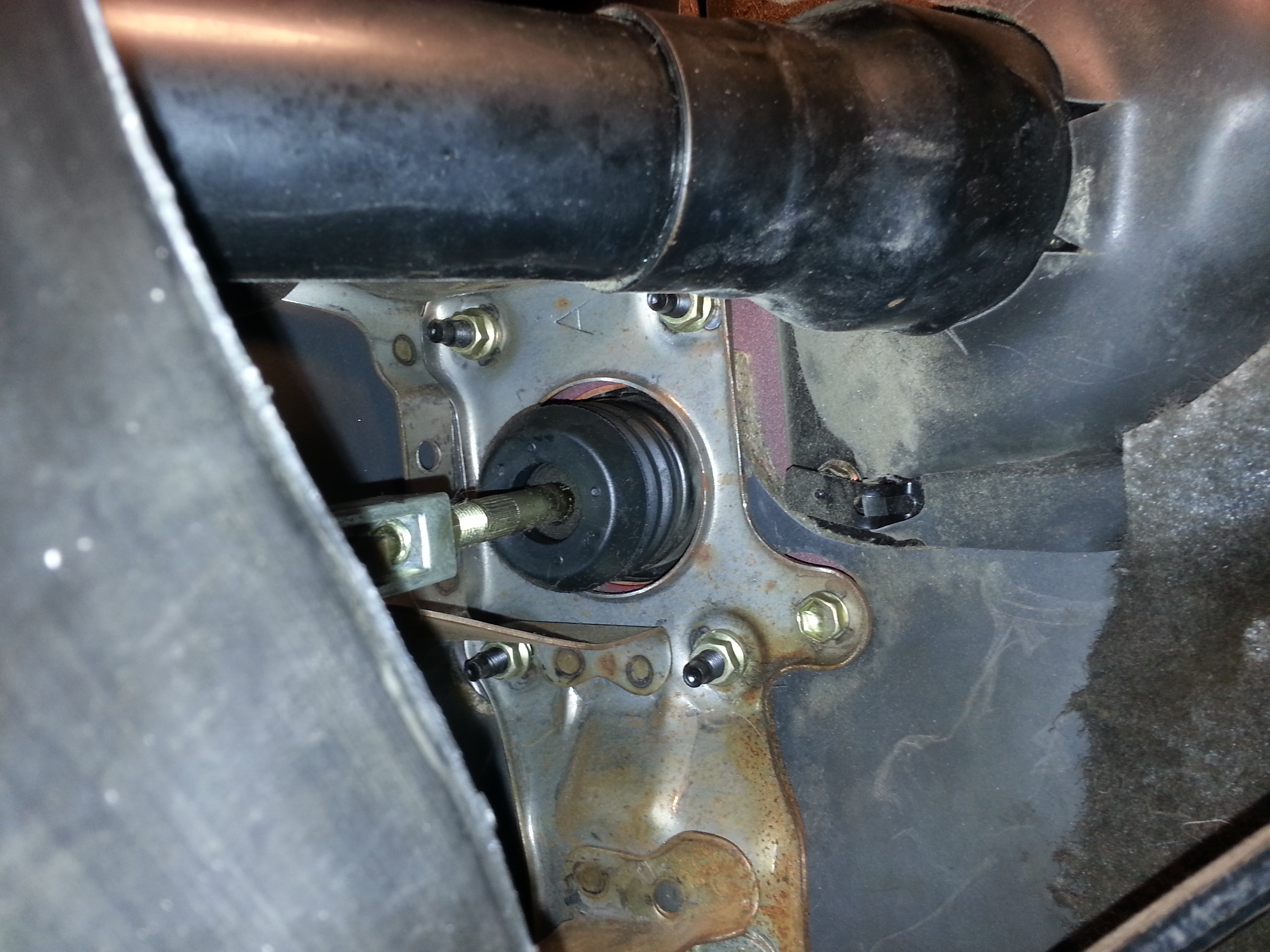

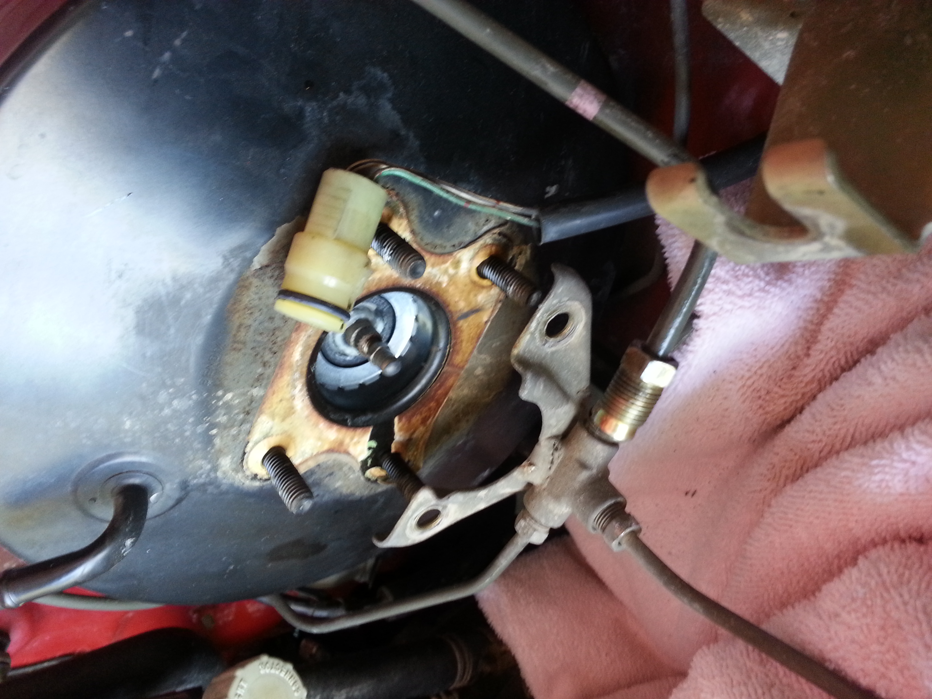

Then go into the cab and remove the retaining spring and coder pin from push rod rivet pin, remove 4 nuts using a 12mm deep socjet on a 3/8" drive socket wrench, then back to the engine bay to remove single diaphragm booster.

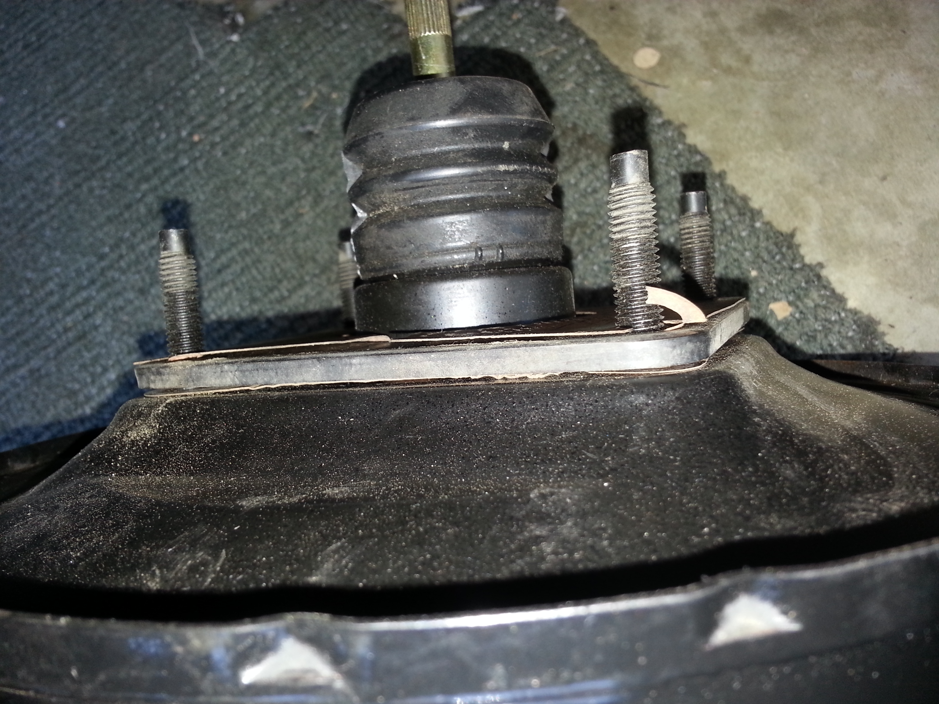

I believe I had read that I should use the shim, even using the dual diaphragm booster, and the both of them sidw by side on the ground appeared to be identical in length, 'back of booster to end of push rod', so I swapped it over. >>>

Sliding the dual diaphragm booster in between those brake lines proved to be a SCARY - bear of a finagling maneuver o.O , hahaha... but I got it! Also, I recommend you measure out all the distances for the existing lines to the new 1" bore master, etc, whether u use the dual diaphragm booster or not (but especially if u do! Because it requires some very clever finagling and bending of the brake lines to get them to line up)... The front line, which used to go like this(top front with and agressive bend, the hose that fed it).......

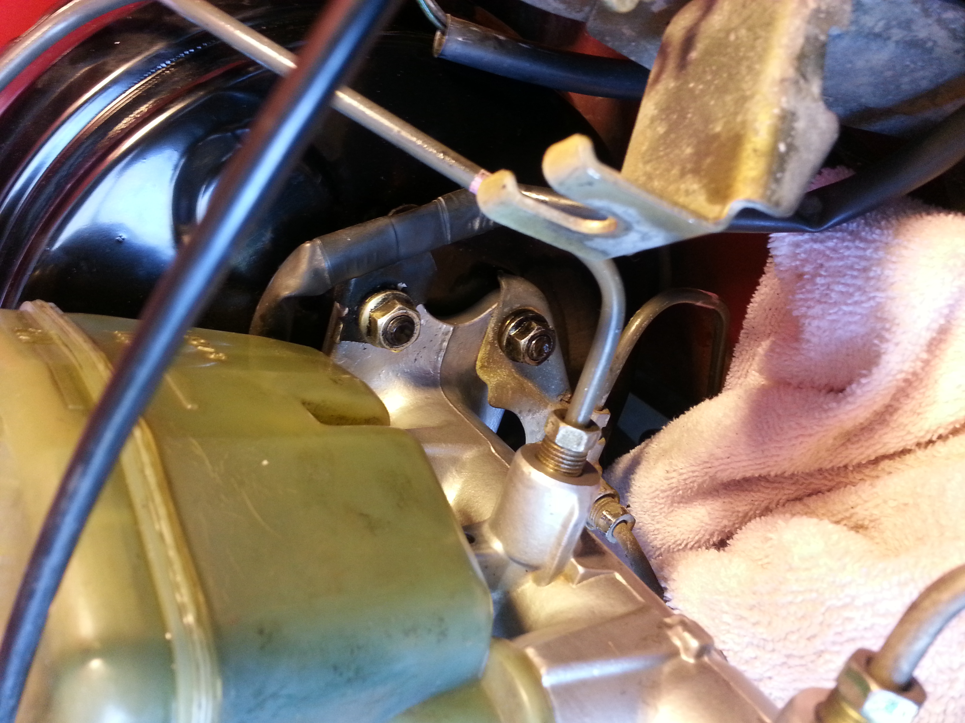

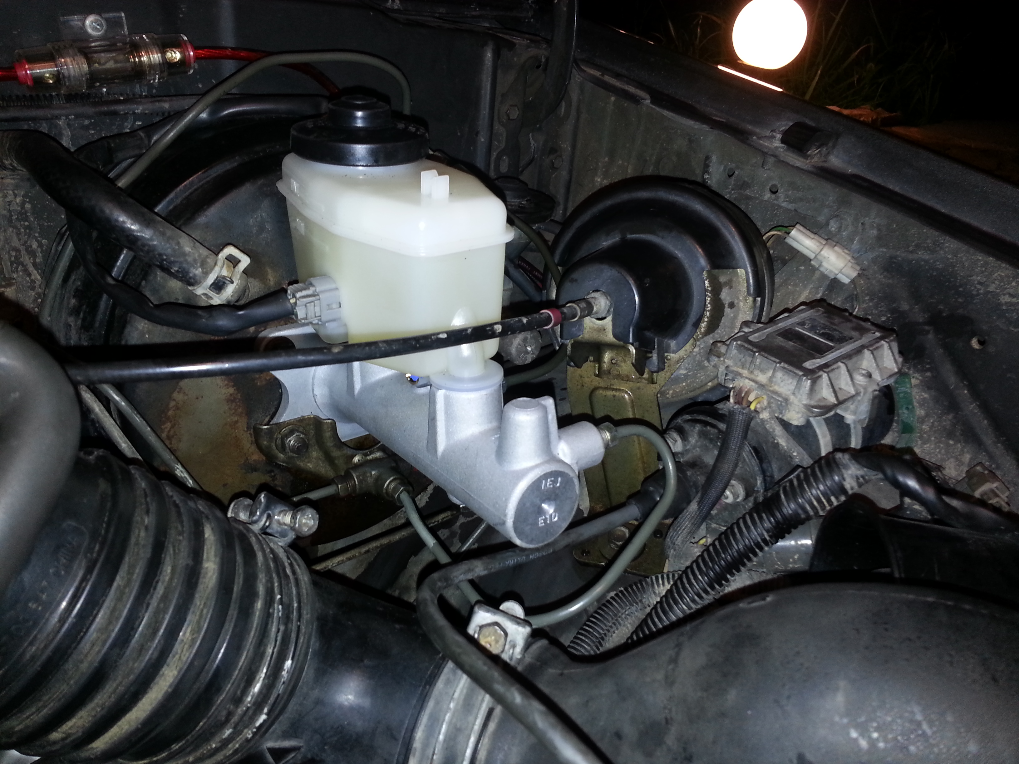

Wound up rebent and stretched to this front position(the 1" bore 2nd gen 4Runner master cylinder both mount horizontally, in tandem [SCARY! HAHA] )....
The back line for the 4cyls is already horizontal, so much easier than upgrading/bending for a 1st gen 3.0 .... 4cyl back line....
New 1" bore master rear line location.....

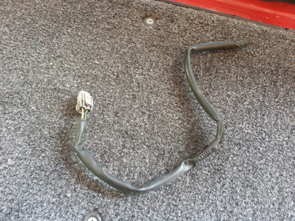

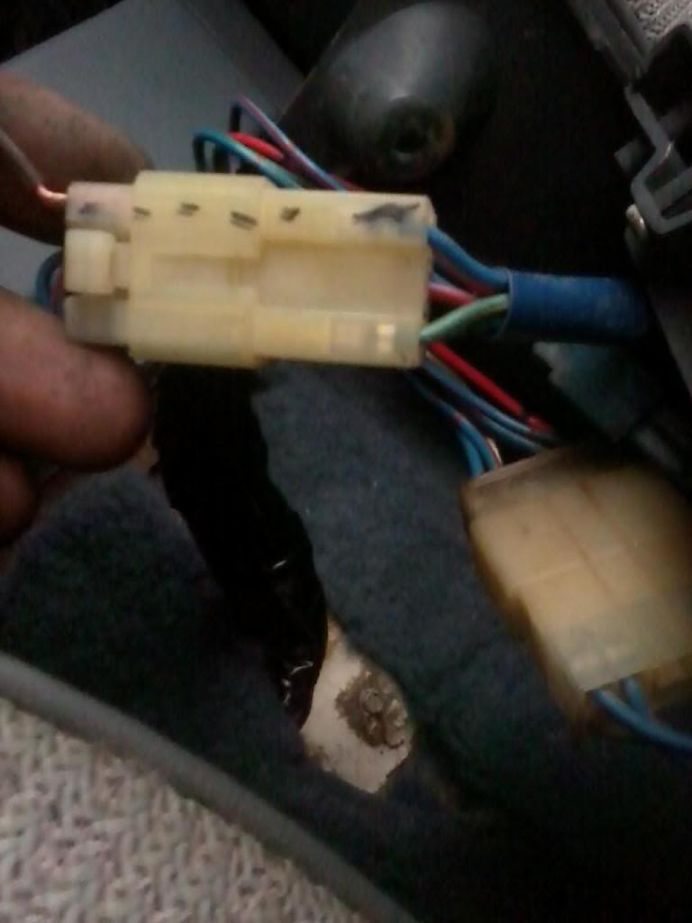

Last was to solder in the 2nd gen 4Runner brake level connector
Size:  482.3 KB .....
(cake same colored wiring even).... and then finish bleeding it....... and that was that.
GUYS! NO CRAP! >>>> JUST THE MASTER AND BOOSTER are night and day in sensitivity and response.... Richard/Redeth felt how it brakes now... he'll tell ya.... its like sports car brakes... IMMEDIATE response to light touch...far less effort. I imagine some of the touchiness will soften just slightly with the bigger, more demanding calipers... and thats ok.
NIGHT AND DAY!

Here is how you can bypass the safetys on your tailgate that you were asking about. Orientate your plug like it is shown in the picture and run a wire from the plug to a good ground. For what you are wanting to do it will work for a temporary fix. I did mine permanent. I knew the motors in the back of some cars would interchange just wasnt sure which one it was. Mine actually work great. While you are back there, put some silicon spray on your window tracks and that will make it alot easier on your motor as well.

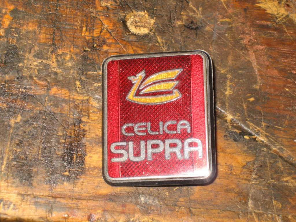

By the way, do you have any idea what the characters on top of this 82' supra hood badge mean? Apparently it's worth some $$, one sold for $65 on ebay recently. It would be a cool return for something I threw in my tool bag from the yard!
