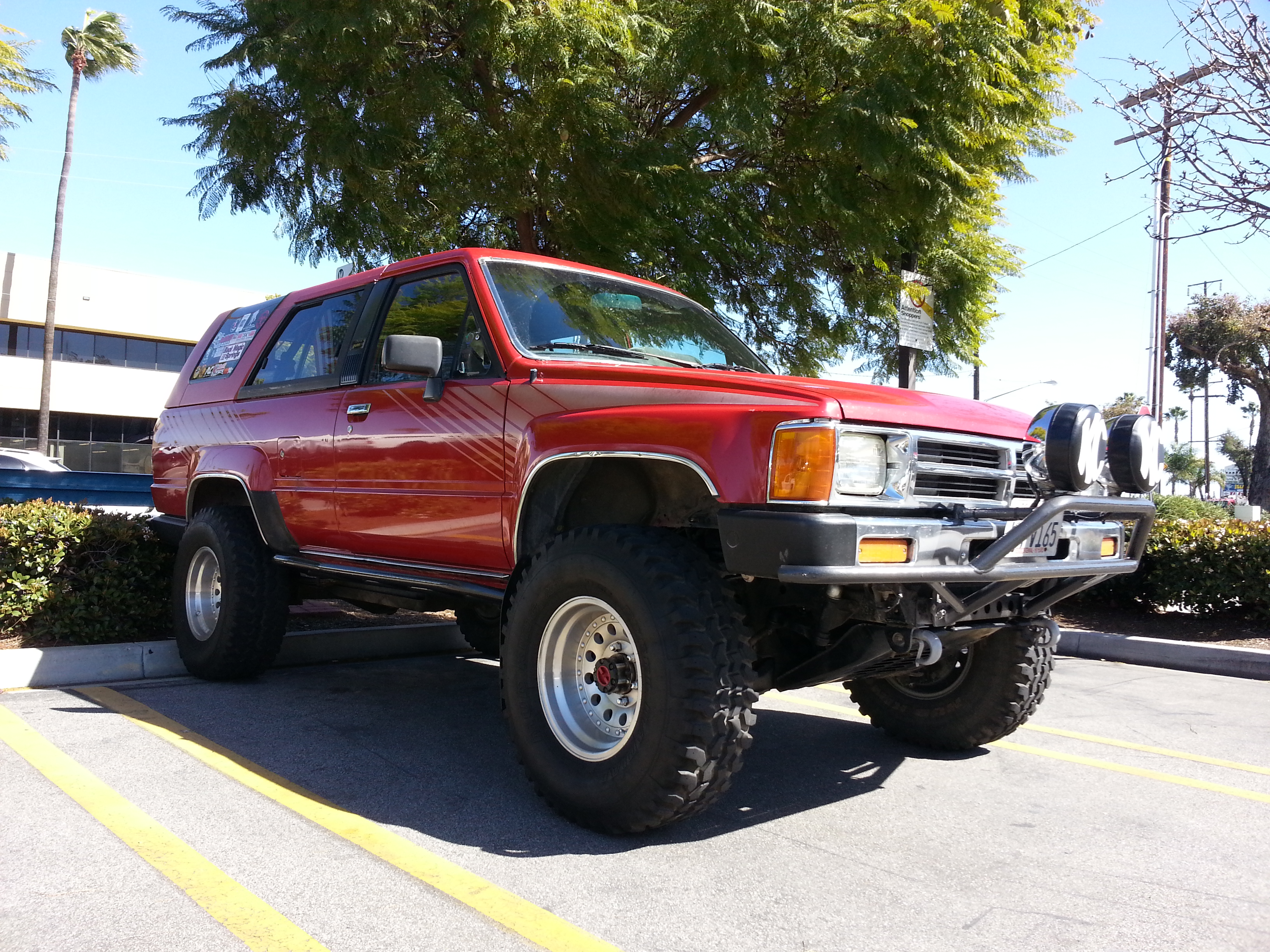

Well, she's back on the road. .....
Still need a lil help bleeding manually/old school (new calipers, I knew they would need a lil exta help... ) .... and the thing is popping a lil bit when I slam on the brakes quickly.... Wad doing it more when first driving it, seems to be mellowing out. Short time will tell if something is wrong. ...
Peddle is nowhere near as hard now.... but it will firm up again some with afull system bleed. Busy tonight with a party, so will have to get the wheel cyl's done 2mrw.

thats about the best picture you've taken of the rig of wonders
bleeding them a few times to get all the air bubbles out of the system will likely do the trick and seating the new shoes in the back (remember nicely lubed rear adjusters will tighten them up as you back up an stop ive heard the 'pop' occasionally

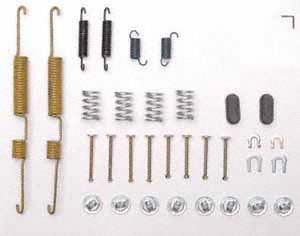

That's partly what I'm saying... BUT, also, the front pin springs..., more like cotter pins or detection pins that push apart against the pads and LITTERALLY cotter pins on the 4Cyl Pin ends.....
6Cyl....
4Cyl...
4Cyl Drum kits aren't a bad idea, either.... I've had springs snap on me on trips and it was NOT nice riding back with that drum carnage going on! lol... (the spring that snapped was one that holds the shoes firmly against the wheel cyl push rods..... GRRR! lol)...
People will do the job how they see fit... BUT, we all know that a bunch of wrecks happen due to TERRIBLE if not NIL brake maintenance/replacement of hardware, etc. And it's SO CHEAP compared to the scheme of the whole job, right? Even in my case, where I got GREAT deals on much of it... It's still what, 10%? If that? It's up to you on the rears... I always install whatever they give me(usually the 4 springs and hats, 2 main springs, etc.)... ALWAYS grease back there, well, too! lol... Mine always make noise, if any, in the rear.... The fronts I do no better... But for some reason, OEM shoes or not... they squeak from time to time. When I do my wheel cyls, I'll just grease everything well and adjust properly, etc. The hardware kit in there is all newer stuff. Backing down stuff, etc... I LOVE knowing my rear brakes are good, as they'll be doing LOTS more work than they normally do, lol. WOULD LOVE to do a kit like Irab88 or RBX are doing... BUT, ... in time, I'll figure something out. For now, I feel comfy with the brakes as they are.
