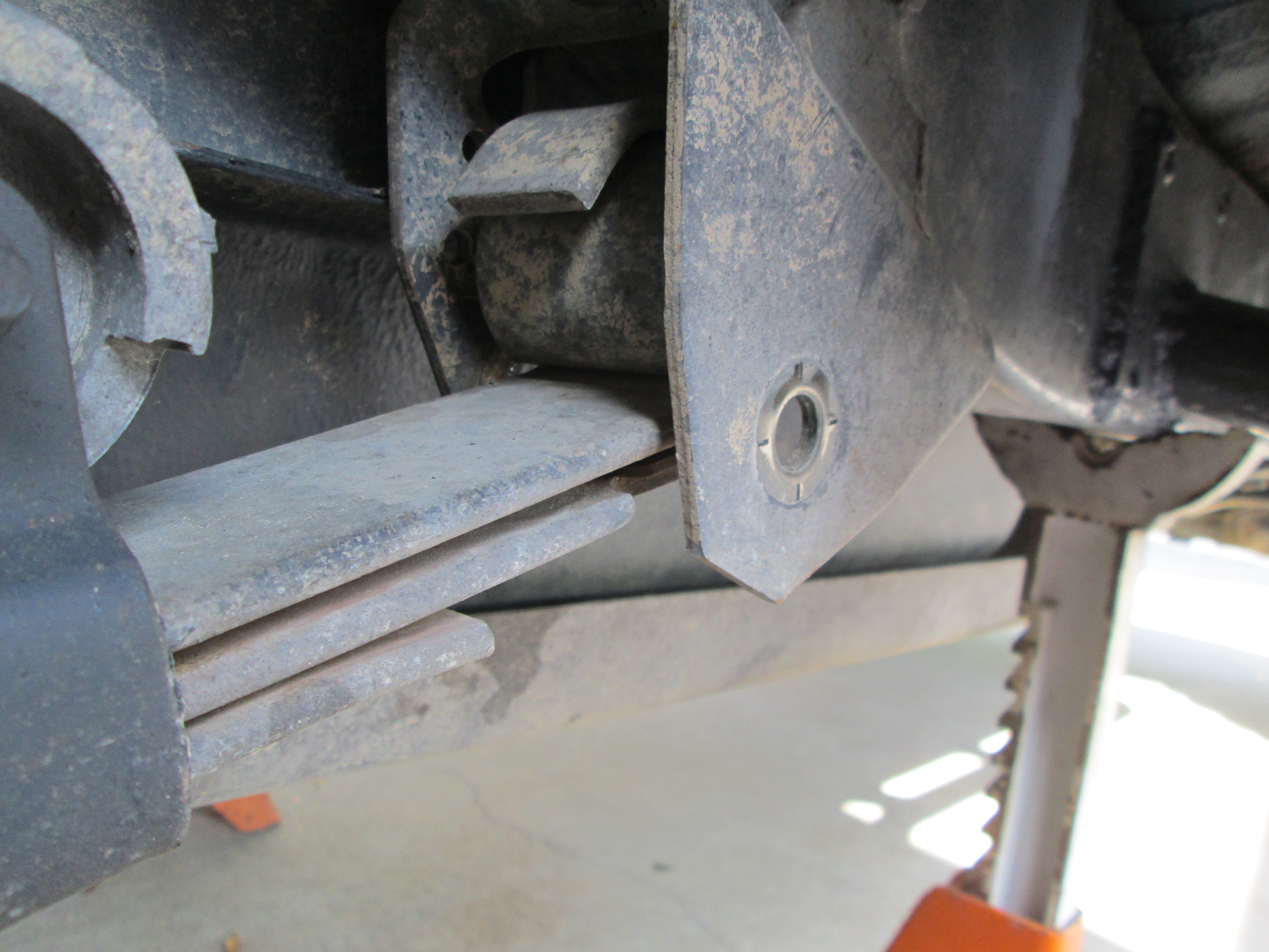

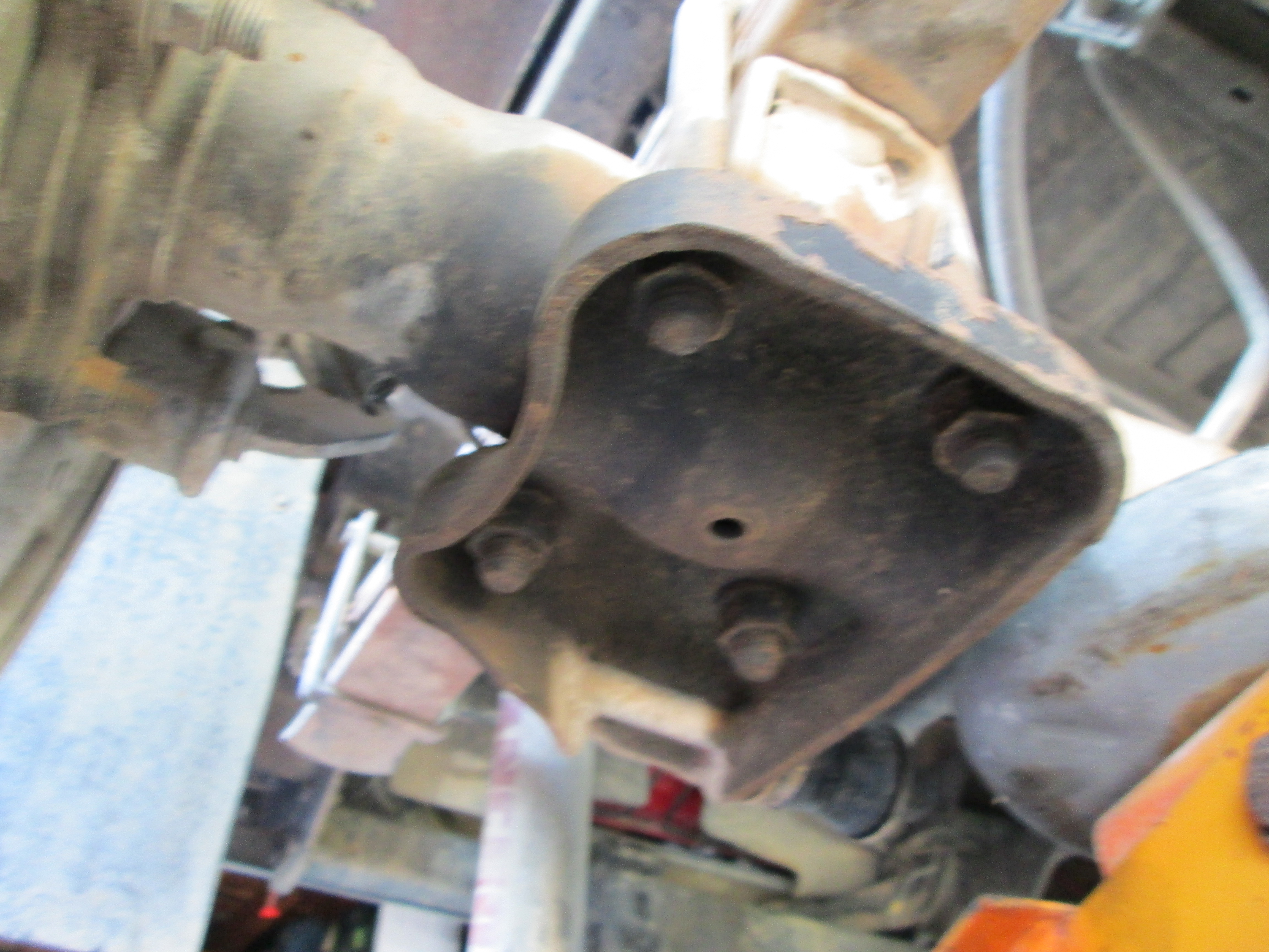

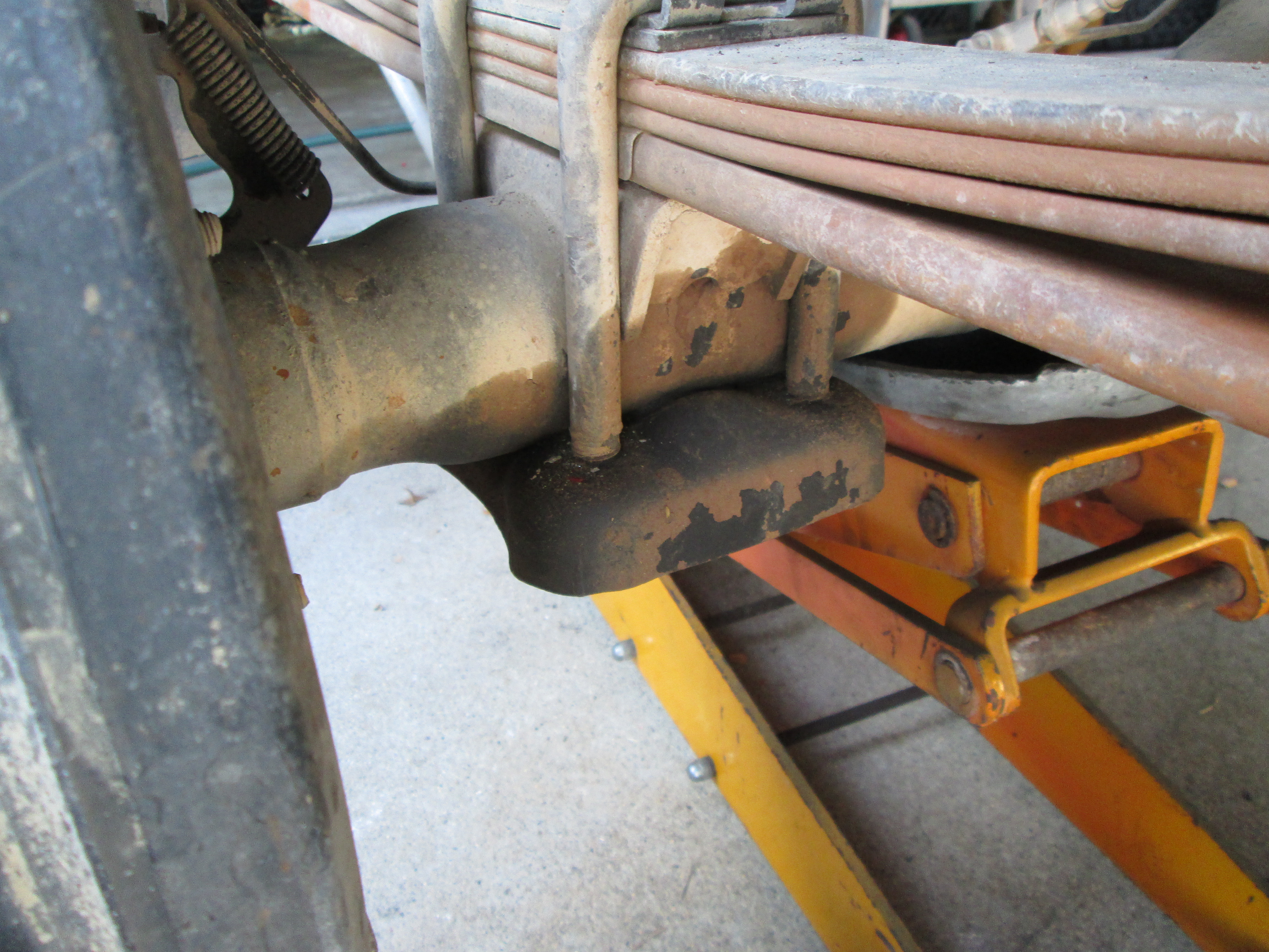

Hey mark didn't you get the heavy springs? These guys are talking about the medium ones. Might not ever be an issue for you?
Looking at this pic, it doesn't seem just flipping the bolt around will do. You'd have to shift or modify the tank.

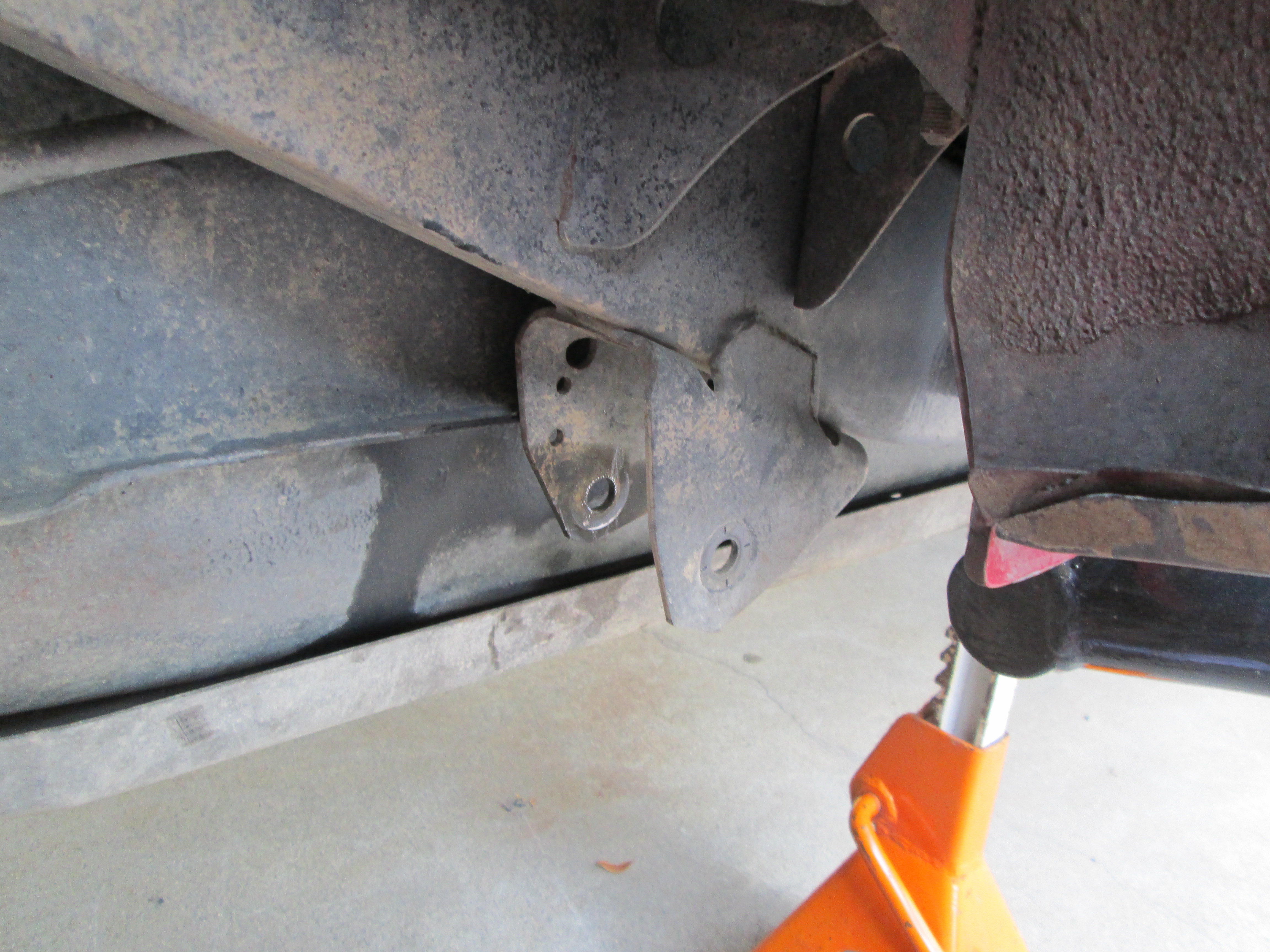

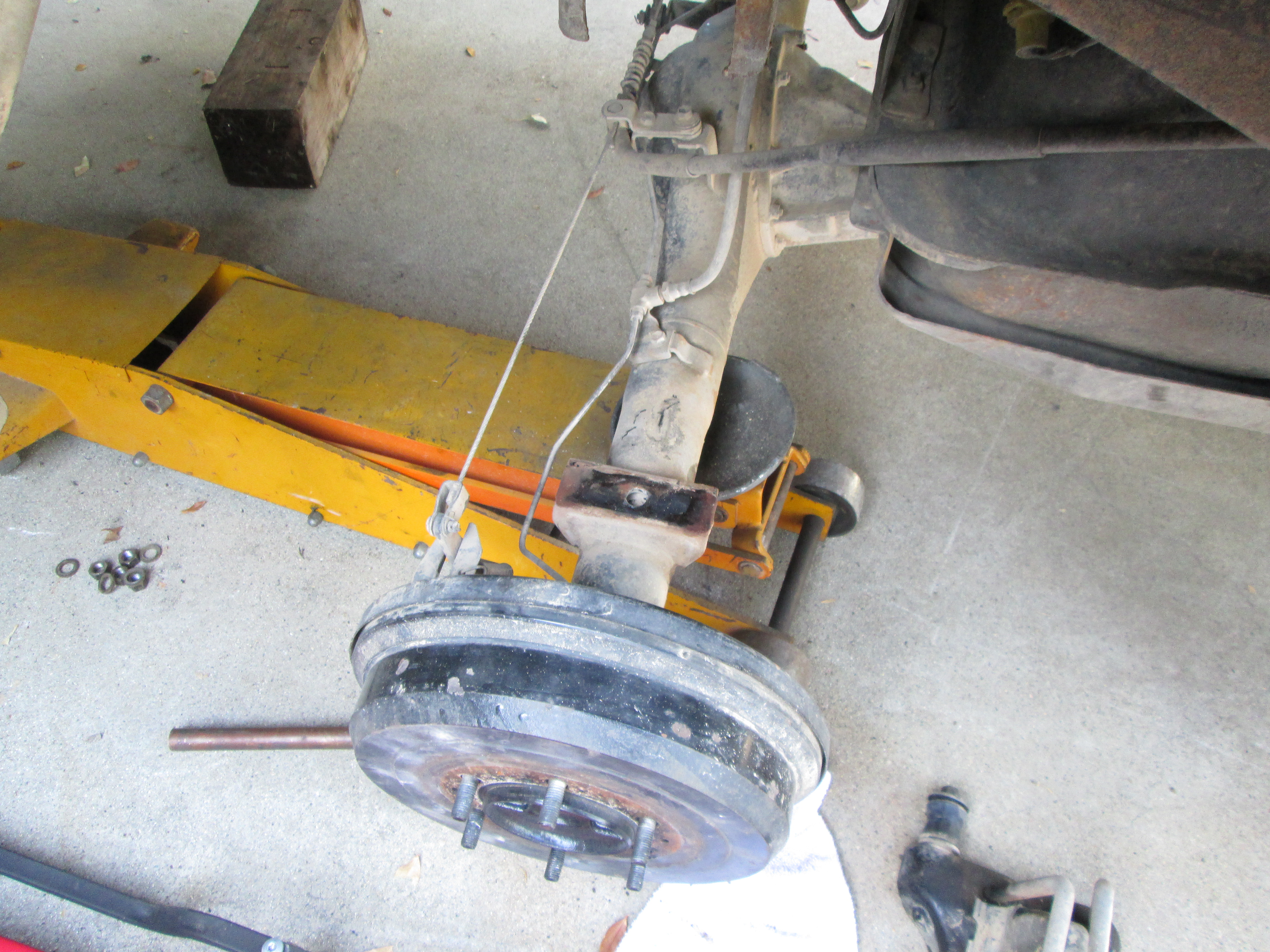

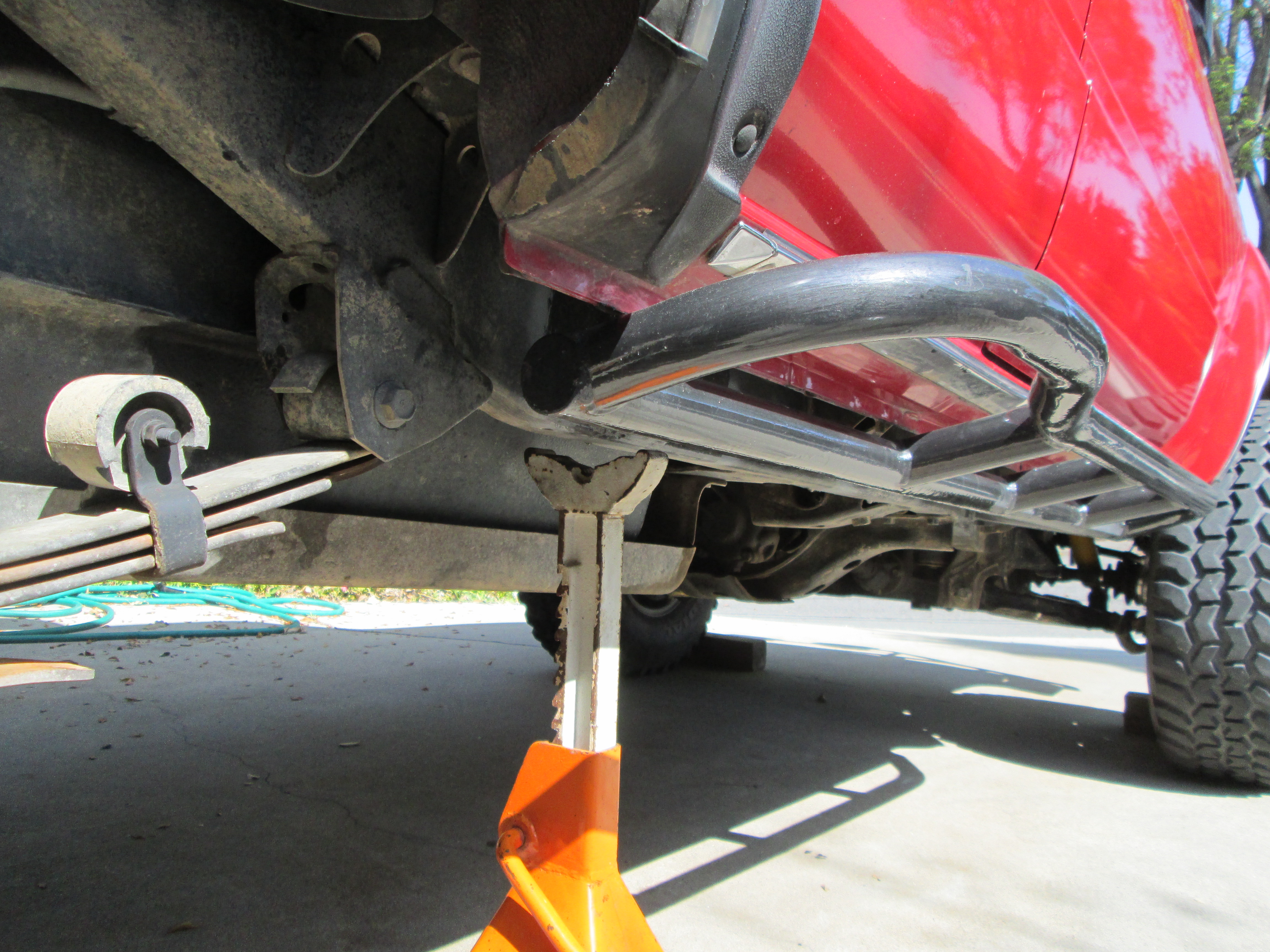

1.) Jack up the Truck by the Frame, letting the rear axle sag as much as possible, until the springs/shocks hit their limit(I chose to use a Big Block and jack up at the Hitch)>>>>
(I then also supported the frame on both sides with Stands)>>>>
2. Using a Bottle Jack, I raised the axle tube on the passenger side, first(doesn't matter which side you start on), taking pressure off the rear hanger/shackle. Remove the "19MM" Nut ON THE UPPER BOLT/HANGER, FIRST!(LEAVE THE LOWER ONE ALONE FOR NOW).....
THIS NUT>>>
3. Knock the fixed bolt/round headed stud out using a rubber mallet and large screwdriver you could care less about.(This did NOT work for me, as the stud was completely frozen in the hanger/splines would NOT budge loose, even though I'd soaked it for 3 tries and have a fairly rust free rig... SOOOO, I did what anyone with a loaned out pitman arm puller would do... GRABBED MY VICE! haha.... a full turn or so, using the method in the picture, below, ...and POPPPPPPPP! MAN was that stuck! lol)>>>

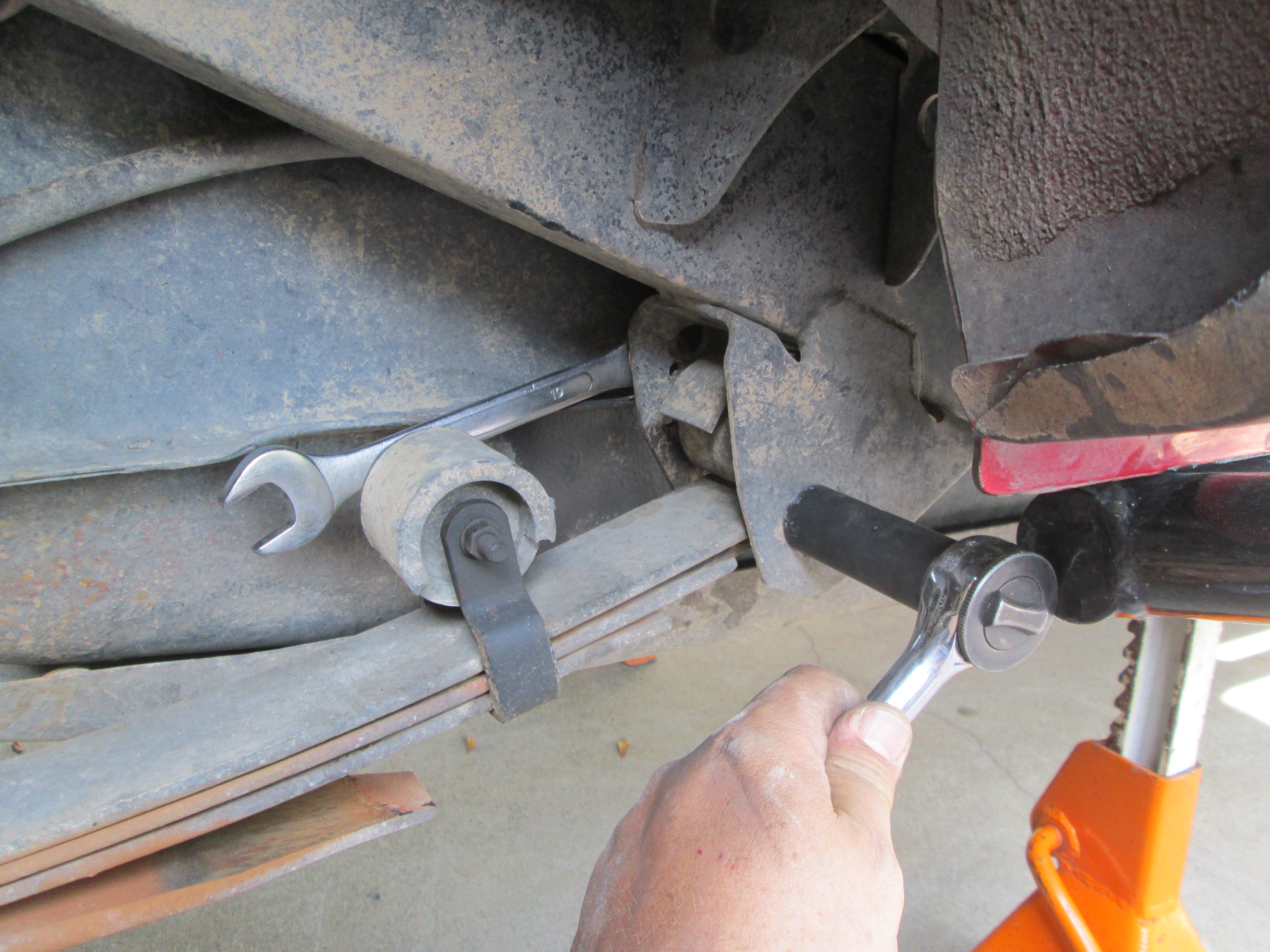

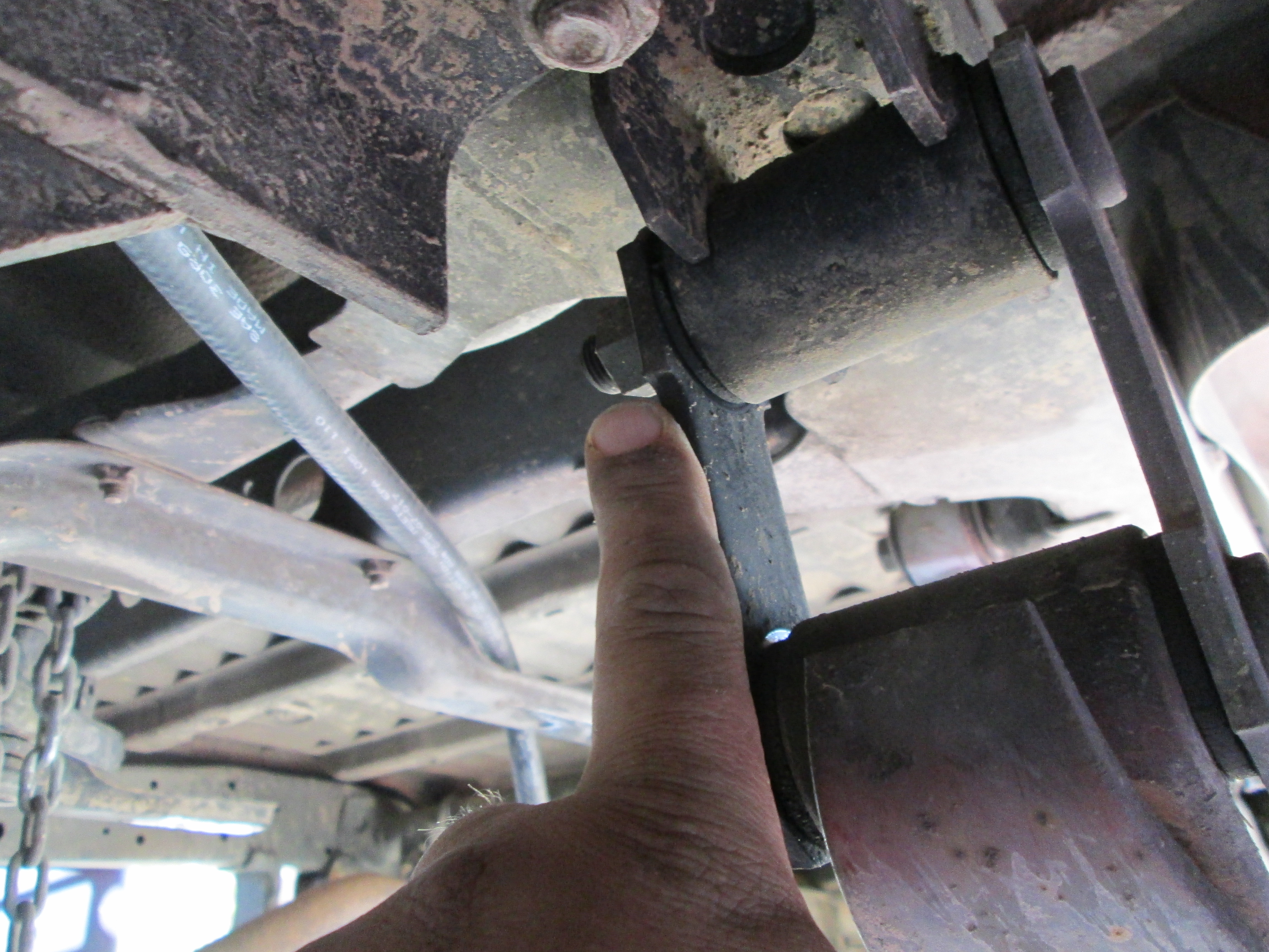

4. Now that you have the Upper Shackle Bolt free from the hanger....NEXT; Using a "17MM" Socket, remove the Lower Shock Bolt from the U-bolt and Shock Bracket... This will allow you to lower the axle further, while the leaf spring pivots on the front hanger, releasing all of the pressure you can from the Zuk Spring(My spring, being a 12"x125# Coil, it came free, but it was still frozen up in the bump stop tower. It easily popped free and rested again on the bump stop held in by the U-Bolts....) Since My Bump Tower has only the very end/plate cut off, .... I still had a lil budging to do to get it out... I chose these tools, pictured below(Nope, don't have a spring compressor
haha)....and without much effort, I pried it out from the tower, then moved to the next step... (TOOLS)>>>
(As Ruined Adventures Noted; "Sceptics of the Zuk mod, worried that it might 'pop out', ..."... I too would note that, while my zuk mod is INSIDE the bump tower... it still gave me a lil bit of work, even at full articulation, WITHOUT the shock limiting at all.... Those things may some day BREAK? Who knows... But pop out? Doubtful... I know it's happened, but I would guess installer error or CRAZY airborne feats to be the culprit on that ONE instance I've seen that...out of HUNDREDS I've read!//// Also noting that this is why I chose what I felt was just a LIL more secure method to 'FIX' the Spring in place. HOWEVER; I DID notice that the spring has dug into the bump stops slightly... NOTHING major... but nothing I'd like to continue. SO, I DO recommend finding one of Zuks write ups on doing a coil mounting ring?)
5. Now remove the "19MM" FRONT HANGER Nut and NON-FIXED Bolt, also "19MM"..(do not lose this bolt! there is no replacement in your OLD MAN EMU CS009R Leaf Spring kit).
6. Now that the leaf pack is free from the hangers, jack the axle back up to more easily get to the "19MM" U-Bolt Nuts>>>>
7. Once you've removed the U-Bolts, bracket and Bump Stop, CAREFULLY, lower the axle and remove the leaf pack WITHOUT DAMAGING/CRUSHING/RIPPING IN HALF- THE BRAKE LINES/E-BRAKE CABLE! ....Removed>>>>>

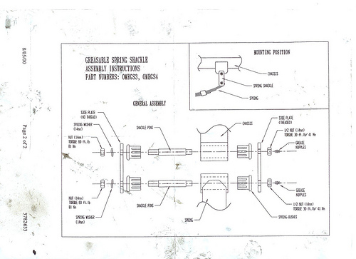

Here is Ruined Adventures posting on the greaseable shackles(I will likely be adding these/or others, with 0" added lift, for now, at a later date).....

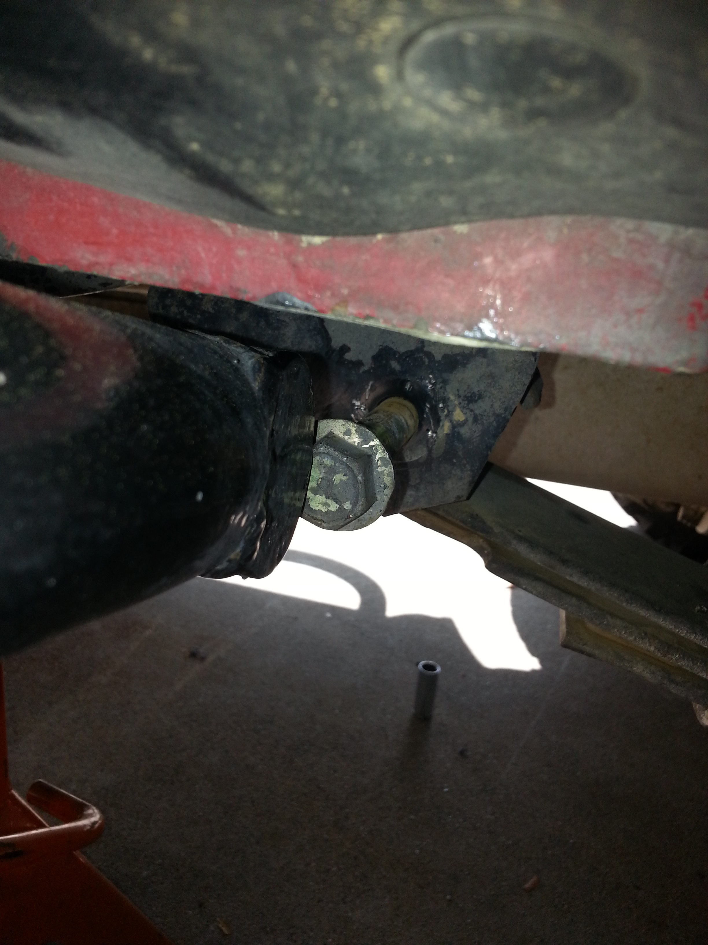

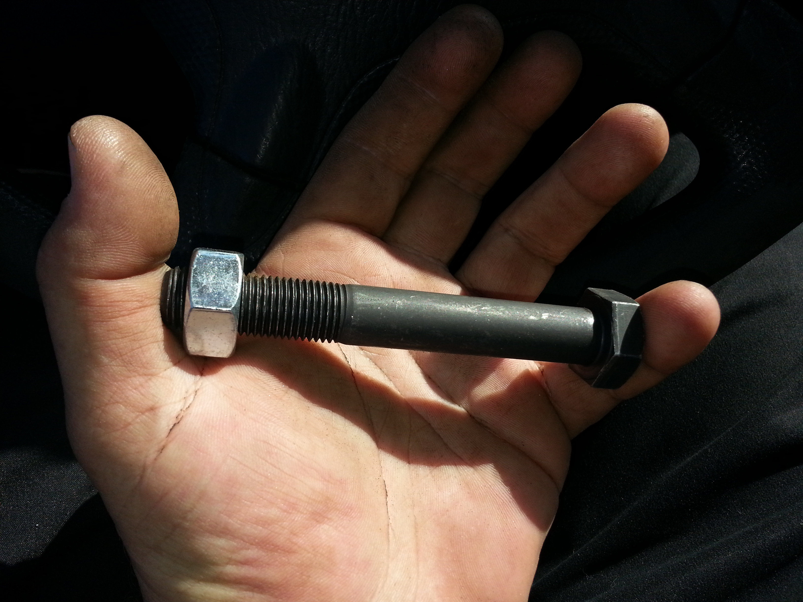

* When I went to remove the driver side front hanger bolt/pin.... I realized as I began to free it, .... it was heading RIGHT FOR THE SLIDER!
hahaha..... So, after trying everything to get it free...
* I had 2 choices.
1. CUT THE EDGE OF THE SLIDER, after Socal85's BEAUTIFUL WORK? HELLLLLLLLLLLLLLZ NO! lol.... OR, ....
2. Cut the bolt and QUICKLY find a replacement!
* WELL, wouldn't you know.... O'reilly? NOPE! Napa? CLOSED on Sunday ... Pep Boys? NADA! Lowes and Home Depot? NOTHING OVER M12.....
This bolt is an M14-1.50-100MM bolt.... With a round flange head beyond the Hex portion... I'm guessing this aids in pressure, like the Crank Pulley Bolt?.....
My LAST STOP, at 4:50PM on Sunday, 10 Minutes before they close......
Used to be a famous 'EVERYTHING you can't find elsewhere' store, called "Lovelady Hardware Co."..... It's new owners, and MAN, I'M NOT KIDDING.... Between Ian Bosco at Lowes(Redeth knows what I'm talkin bout!).... and this place, .... I COULD NOT have been treated better! This guy hear me asking for something unusual for my 4Runner... He looked a lil deeper than the guy helping me, and VOILA, ...an M14-1.50-100MM- GRADE 10.9 bolt!!!!! >>>>
Now, I could head back, CUT the freakin pin-bolt out

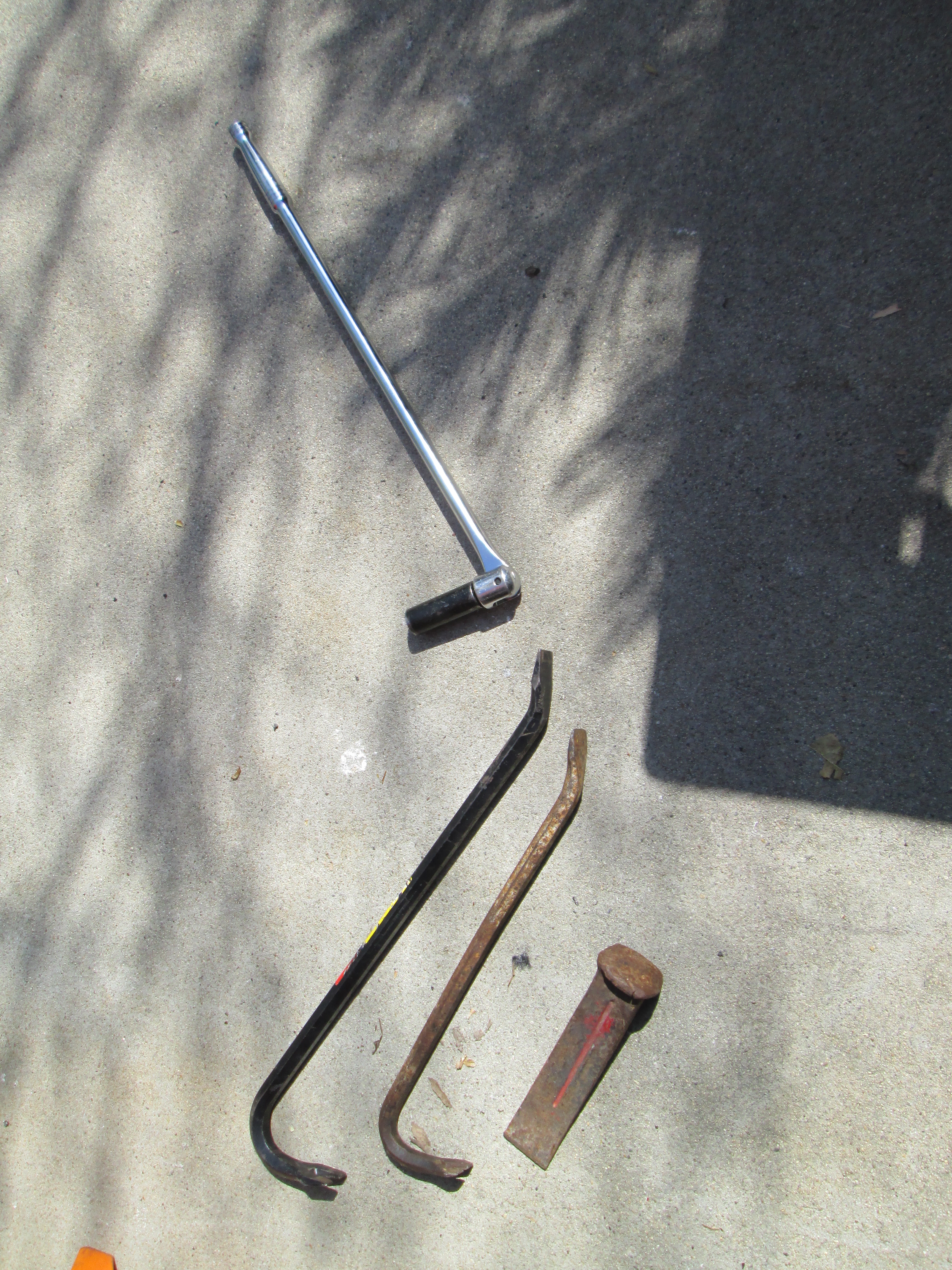

PROBLEM 2? lol.... The muffler is VERY close to limiting me in getting a drift or something in there.... So what did I dig up from that first motor? ONE SOUVENIR I kept.....
^^^ WORKED PERFECTLY, just enough room to rap it out and put in my new Grade-10.9 Bolt and Nut(22MM head).... >>>
SOOOOOOO, now, with my bolt greased up, ready to go into the new OMEmu Bushing Sleeve on the driver side.... I proceeded to 'reassemble'

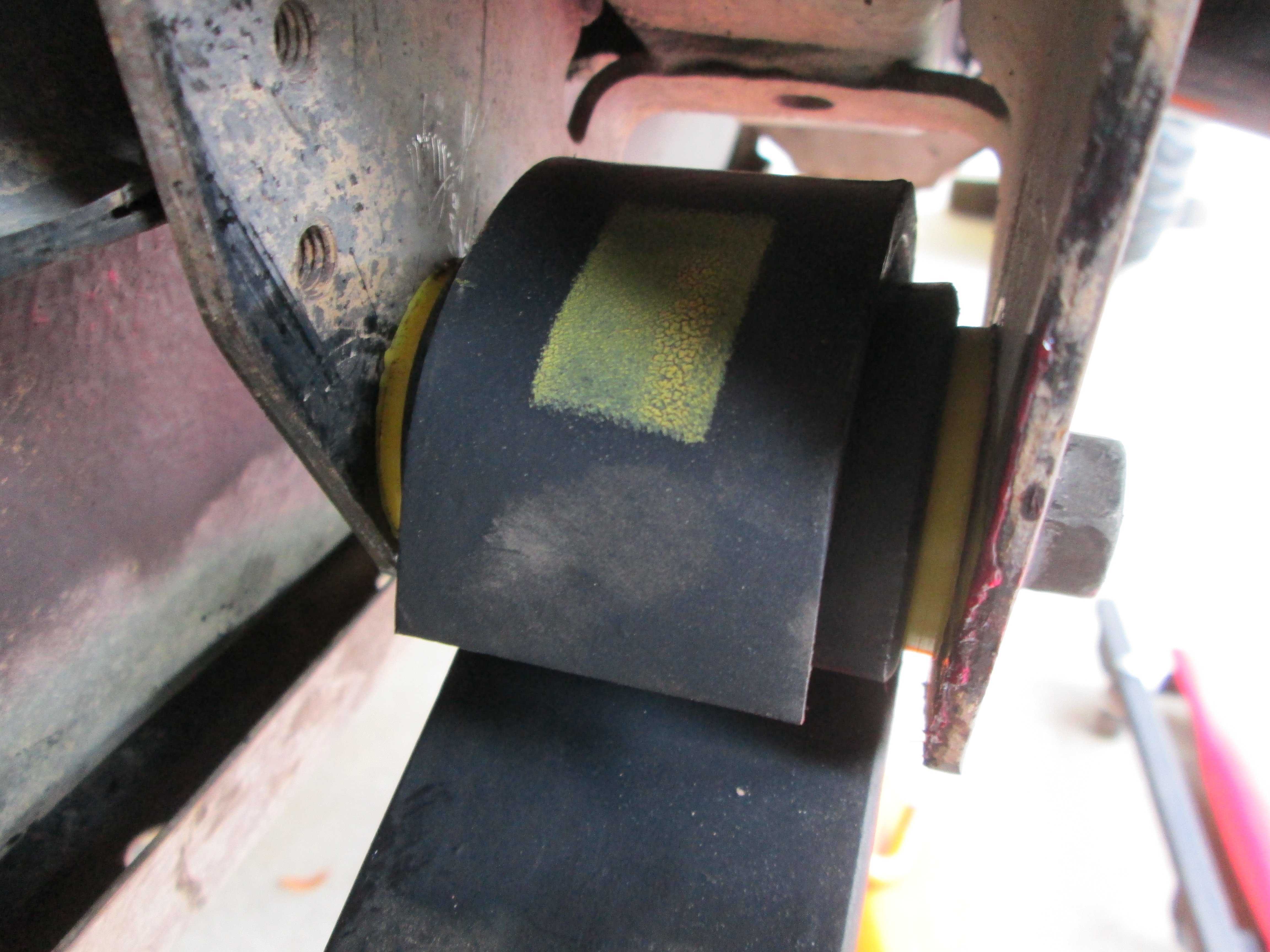

BUT, FIRST, ...since I didn't have the shackles I was going to use... I had another problem. SOOOOOO, lol.... I had to remove them from the Original Leaf Packs, clean up the pins/bolts really well... Grease em up/and the bushings and slap em back in. So, again, I used the "VICE METHOD"!
1. Install the new OME Bushings, WELL GREASED, into your OMEmu Leaf Pack... Also install the 3rd pair in the REAR MOST/UPPER Shackle - hanger mount.
2. Even reusing my original Shackles... I cleaned up the shackle hardware with Fine Metal Emery Cloth, til sparkly, then greased em up and installed them in the rear/lower most bushing in the leaf pack, that secures the shackles to the pack, first. Secure the Pin/nut, but don't torque it down to specs just yet. "SNUG", but not, "HOLY BUGGER", haha...

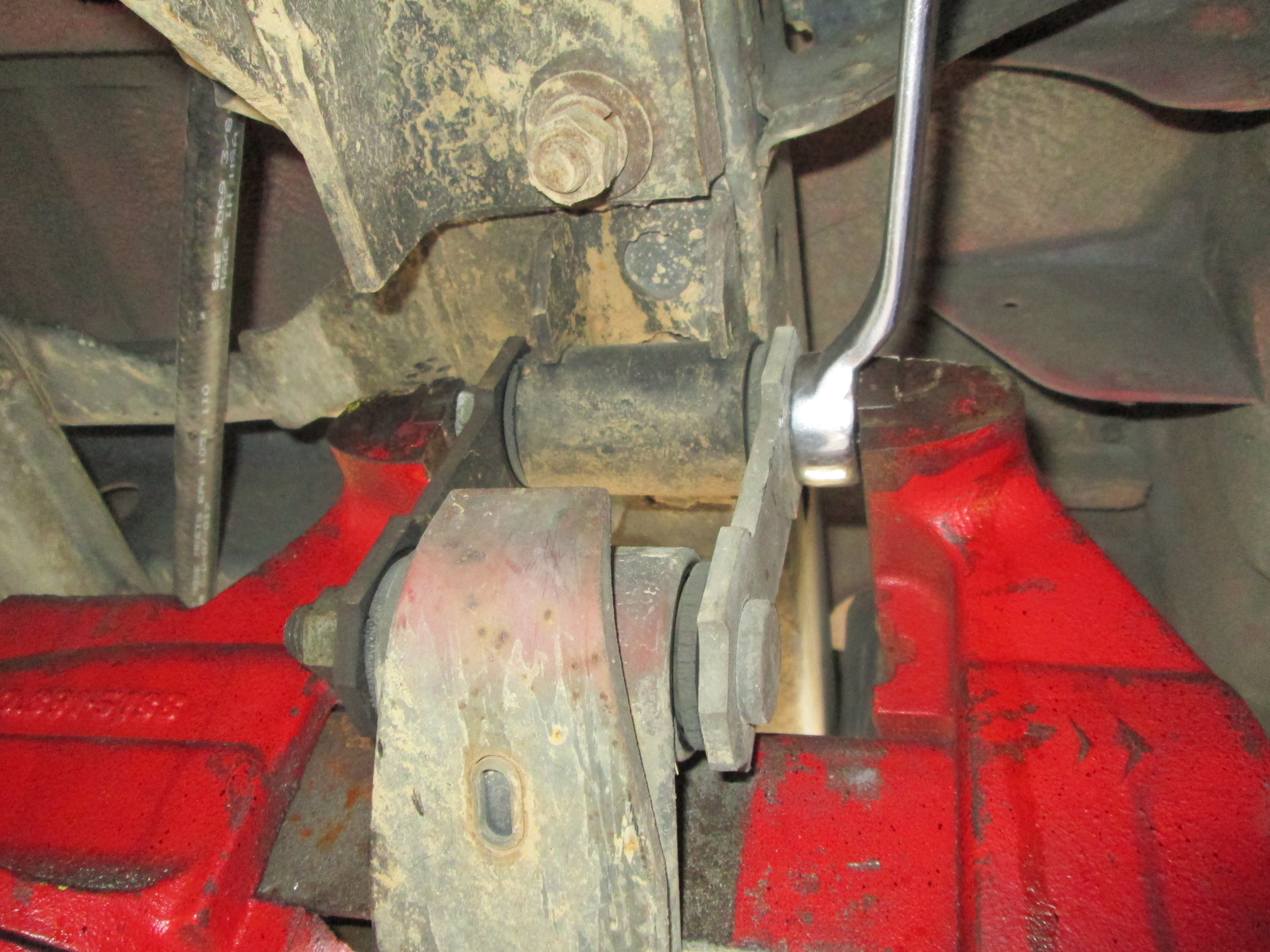

3. Now, you're ready to bring your prepared OMEmu leaf pack over to the rig, CAREFULLY glide it up and in, onto the Axle dowel keyhole(Center Pin)... then jack up the axle again, then secure the axle to the leaf pack using the LONGER U-BOLTS provided by OMEmu. (specs, IIRC, were 78-110#, on the u-bolts... I will get it for ya and edit).
4. After you've secured the leaf pack to the axle; FIRST... HANG THE FRONT of the leaf pack in the hanger, slide the WELL GREASED pin through, MAKING SURE YOU DIDN'T FORGET THE BOLT SLEEVE IN THE FRONT EYE/inside the bushings! >>>
5. With your lower shackle bolt already secured SNUG to the rear eye of the leaf pack.... Jack up the axle until you can line up the upper holes in the shackle to the hanger.... (Use what you want, .... I chose to use 1/4" and 3/8" Socket Extension rods, because I didn't want anything 'gouging' my new OMEmu Bushings)... Secure the upper hanger/shackle pin bolt to 54-72#, IIRC, and then torque your entire set up, every bolt/nut and ESPECIALLY make sure they are all torqued to specs... Sure, brakes are SO important, ...one of the worst things to neglect... BUT, if your U-bolts or hanger pins fall out... YEAH, not good! HAHAHA.

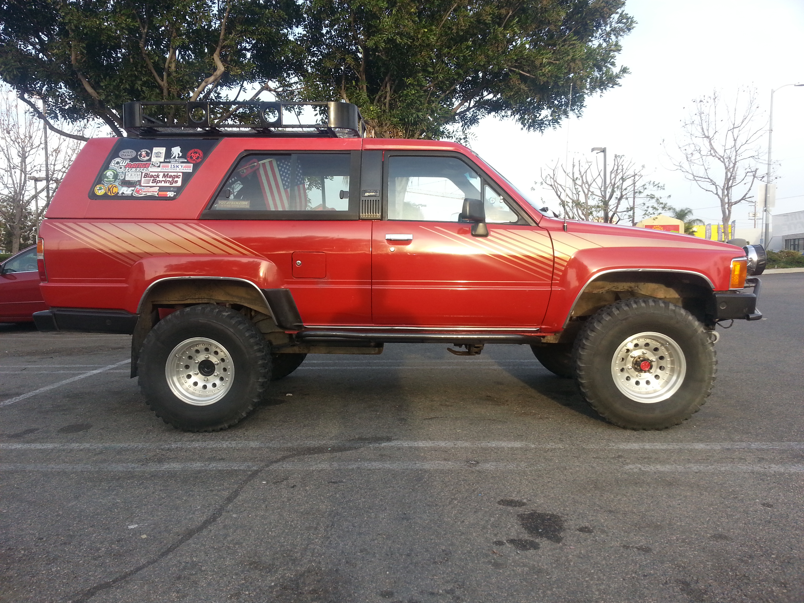

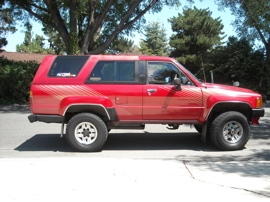

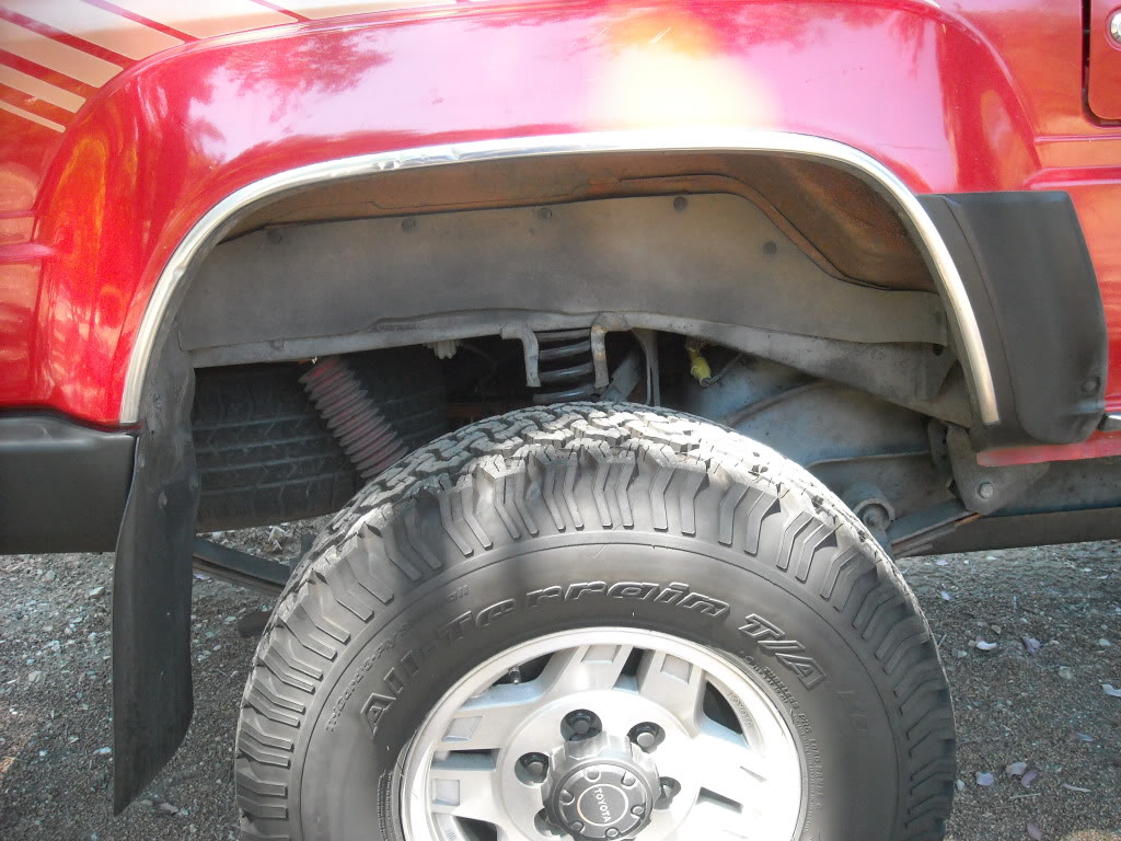

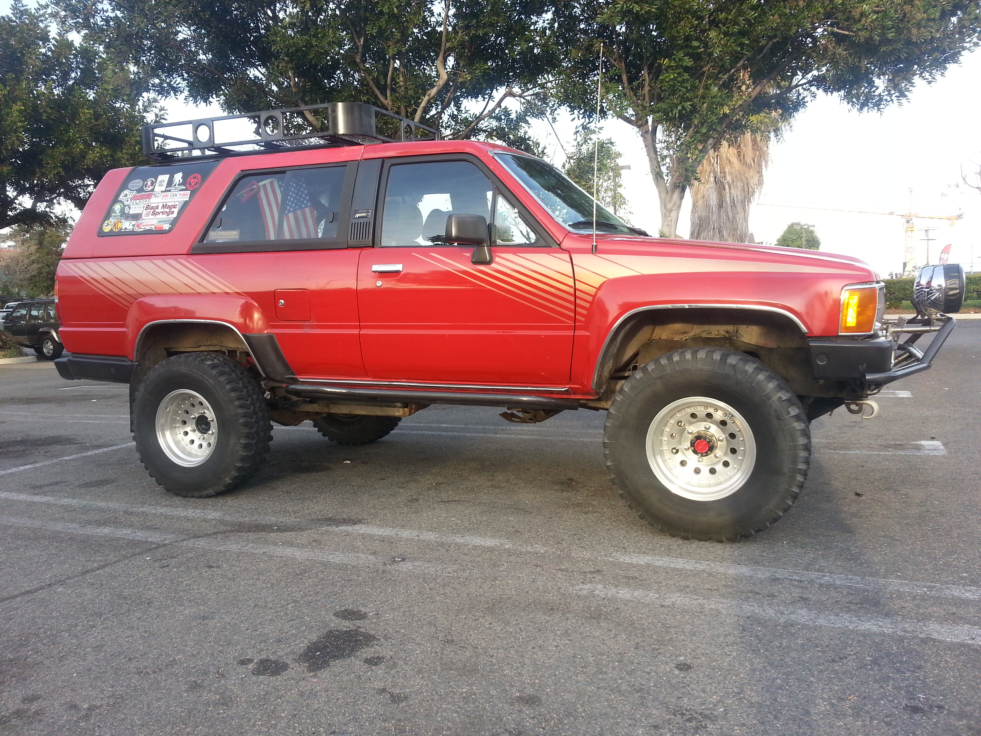

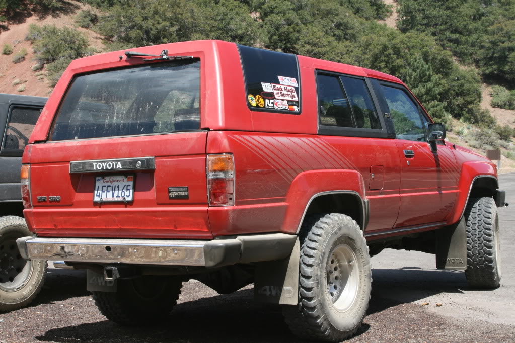

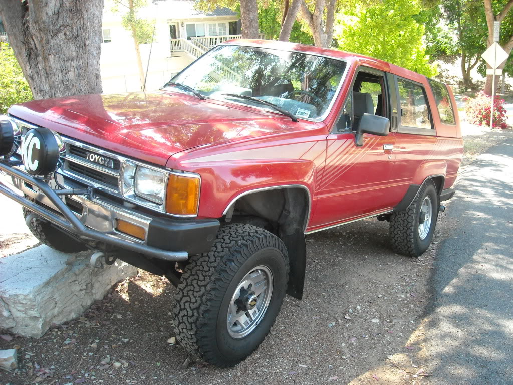

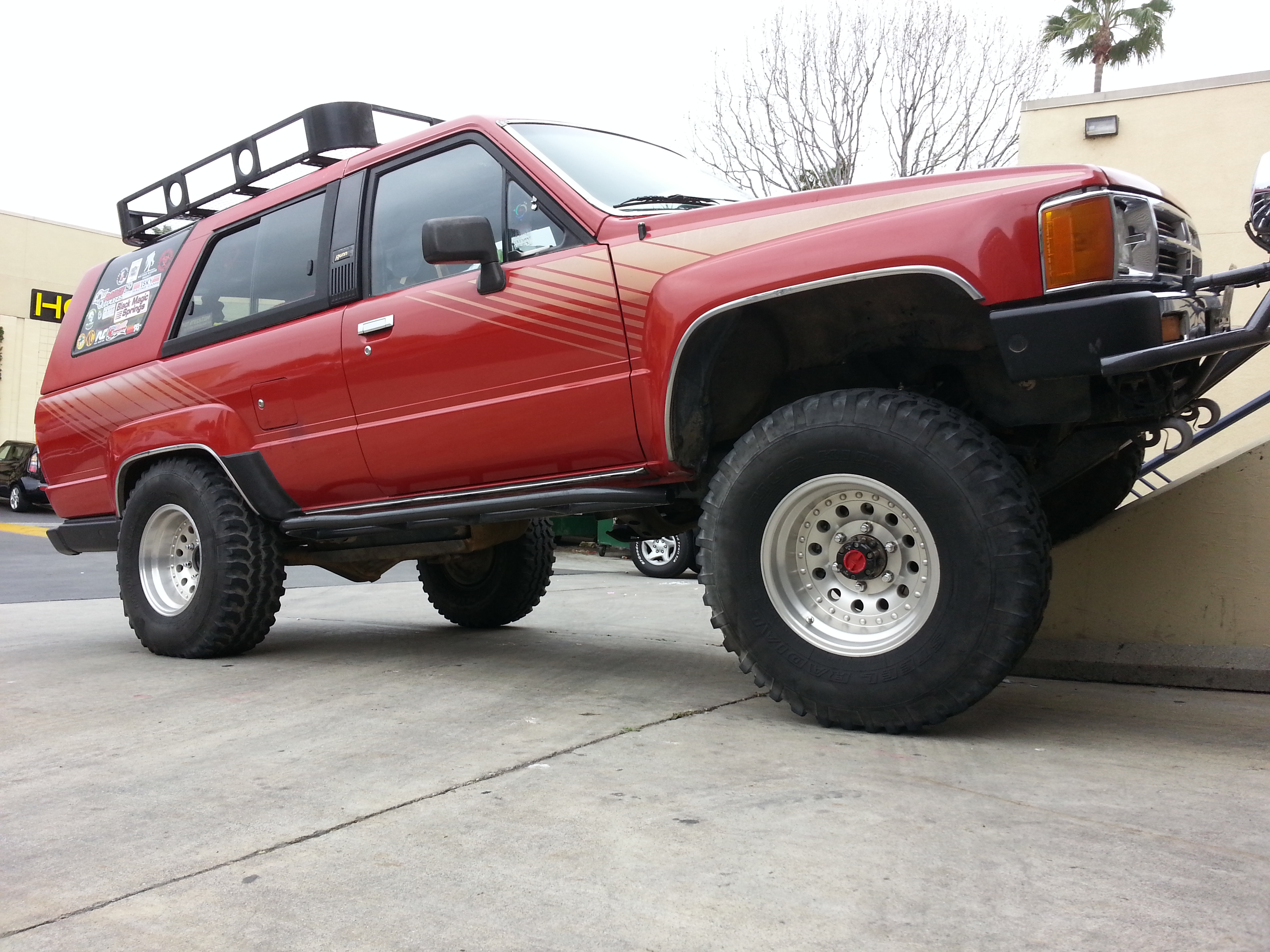

Before Zuk;
After Zuk;
After OMEmu - CS009R Leaf Pack Swap;

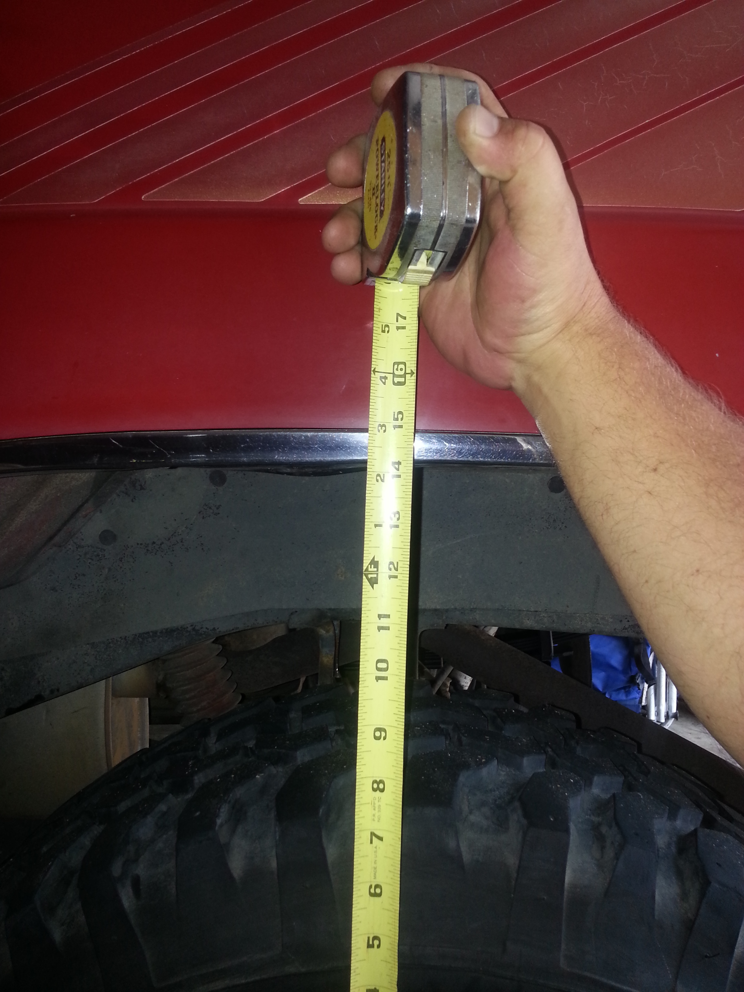

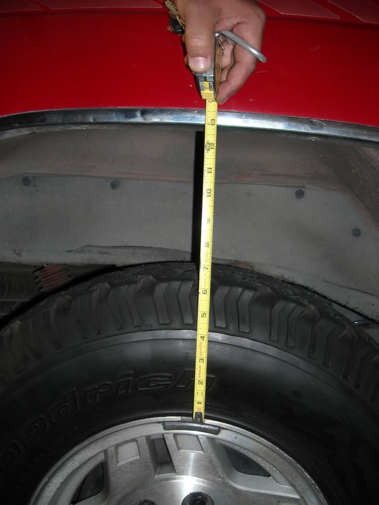

Measurements in rear, top of rim to top of wheel well lip, after Zuk and OMEmu CS009R Leafs:
After Zuk 12"x125#:
Measure/Rear;
After OMEmu:
Measure/Rear;

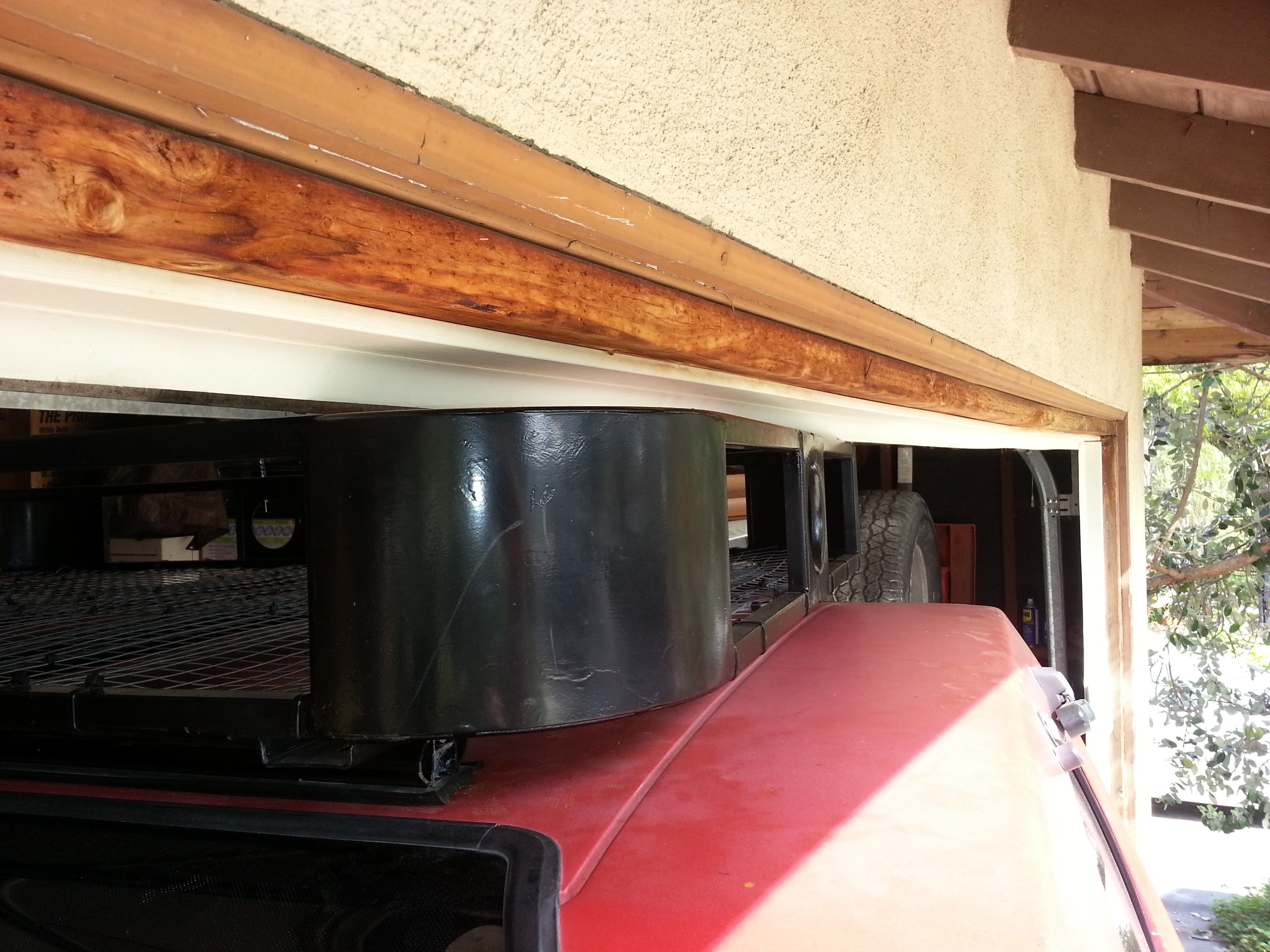

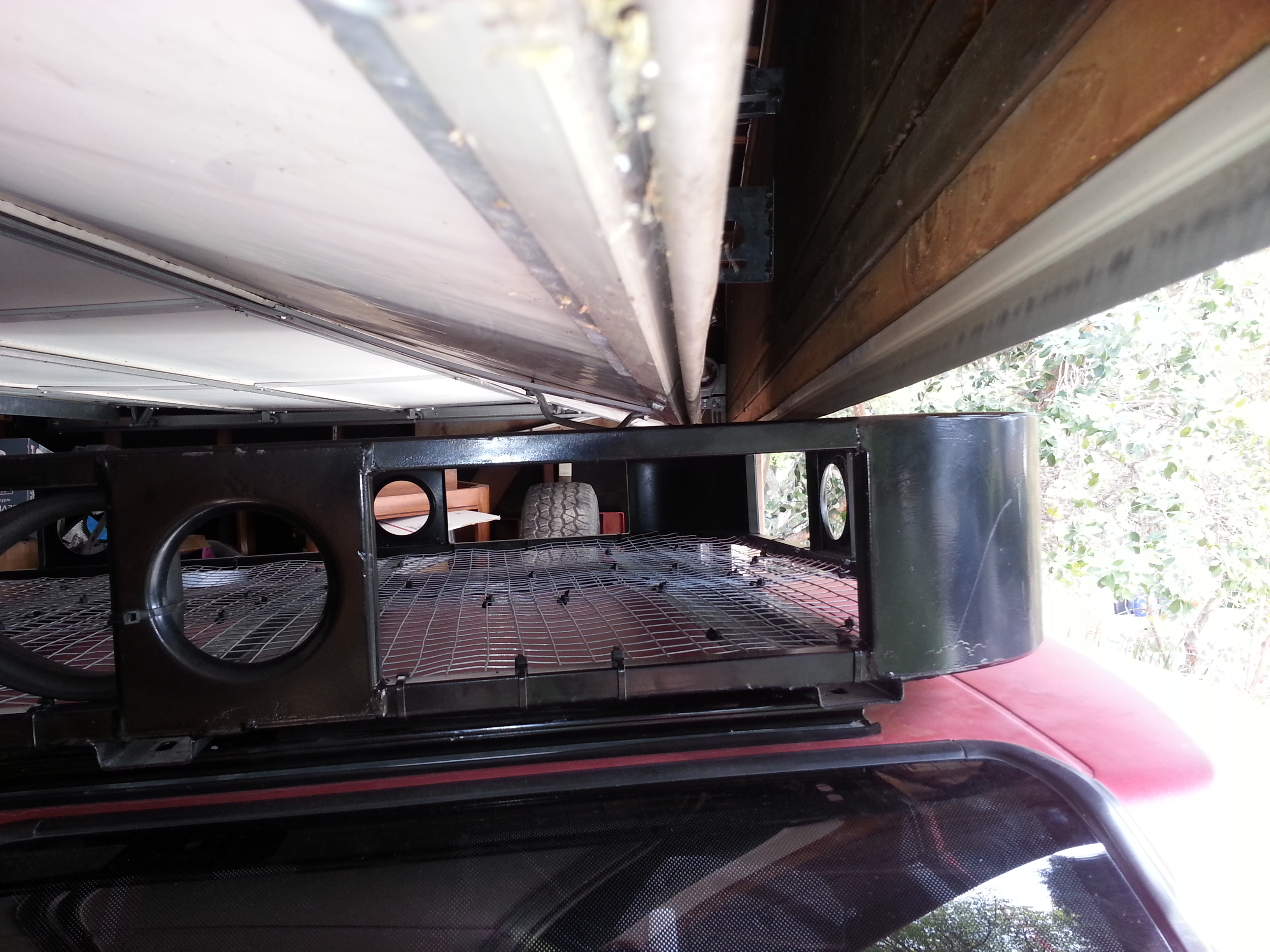

BUT, I mention the height because, well, as I said, I nearly tore my garage door off, just trying to squeeze in, lol... Let the door go up a lil further and it fits... But I will likely try to figure out my final solution for the easy on and off 'con-ferr'.... This will give me around 4 more Inches, if I were ever to go there!
SHHHHHHHHHHH! hahaa.
Garage door clearance after adjusting door all the way up......
THIS NUT>>>
8. Now you want to GREASE EVERYTHING on your Old Man Emu Leaf Pack and EVERY BUSHING, thoroughly. This is the time you would assemble your greaseable shackles.

)Here is Ruined Adventures posting on the greaseable shackles(I will likely be adding these/or others, with 0" added lift, for now, at a later date).....
An Intermission before assembly to share another 'OOPS', regarding a "I did NOT NOTICE THAT, BEFORE" moment! lol....
* I had 2 choices.

Before Zuk;
After Zuk;
After Zuk 12"x125#:
Measure/Rear;
After OMEmu:
Measure/Rear;
SHHHHHHHHHHH! hahaa.Garage door clearance after adjusting door all the way up......
