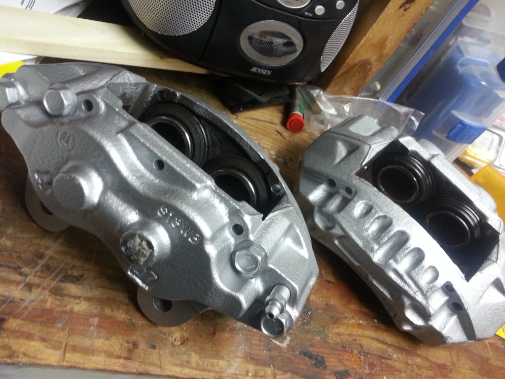

PS>>>>> Picked up a Two Wheel - V6 Caliper Rebuild Kit today...... 20$ for USA Made Kit/Seals and C-clips.... I just COULD NOT tell my brain to shut up and relax, "they're good, it's fine, SHUT UPPPPPPP!".... hahaha... Wouldn't have it, so it made me DRIVE TO THE STORE! haha. Hey, as I've said, which is no great revelation..... BRAKES ARE #1, ......as should be the whole of their parts, right?
.... Aisin Master, Aisin Calipers, Aisin/Bendix Booster?(I'm guessing "Bendix/MASTER-VAC" made ALL THE USA Dual Diaphragm boosters for Toyota and others.... I WOULD BET, ... cuz I've not ONCE seen, in 20 boosters I've peeped out at the yards, ....ONE Booster that was without 'BENDIX', and the part number being an odd one, on the top... NOT 'Toyota/Aisin'.... OK, so I'm not POSITIVE on this.... But that would be a STRANGE coincidence, ..... every one of 20??????? I'll get a pic of what it says.... I almost feel like that's not the case on my 1st Gen... AND, on the booster somewhere, I KNOW I saw it... a Larger Japanese Symbol...
.... ANYONE KNOW? I suppose Google will answer this one as well.... lol. *** The kit is by Wagner, Made in the USA, available at O'Reilly's.... Other names in other states, I'm aware, lol... SHUCKS? hehe. 10$ per wheel... 8 piston related seals per caliper....Plus two tiny inner seals(not sure I'll mess with those, from what I've heard)........
So far, the Calipers with the Aluminum Caliper Paint.... I like em.. At least they'll reveal leaks quickly, lol... GOD WILLING THAT I WILL NOT HAVE! lol...>>>

thaose are lookin really good mark (the calipers)

im always around mark lol as for scraping the paint on the calipers use a rubber mallet if ya need to persuade it

Chef, those cleaned and painted calipers look snazzy. What is your address so I can send mine down for the same treatment?

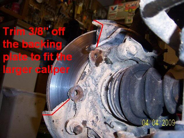

I've been looking into the V6 Brake Upgrade for a while... BUT, as some of you know, it's full of MANYYYYYY options, ... at least in regards to years/application, etc. Well, I first want to thank CORAX ( a seriously generous dude as far as his time/sharing information and such that he's found/learned....) >>> THANK YOU, CORAX, for doing much of the proverbial-"heavy lifting" of research on this! Your write up in expedition portal is VERY well written, complete, .... and YET? ...
YES, you guessed right, ...I TOTALLY read and then viewed right past a picture! THIS ONE! >>>>>

Corax said, "So the only real difference is thickness and overall diameter - if you saw the "height" is also different, that's only because the rotor is thicker and the height needed to change to keep the rotor centered in the caliper.
The calipers are a simple bolt on affair, the only thing necessary is little bit of trimming to the backing plate." >>>>>>>>>
YES, I read that as well^^^ , ........... I just, again, thought it applied to his SUPER-T100 CALIPERS!...... which it turns out, as mentioned, are the same as my Before 10/95 4Runner Calipers....

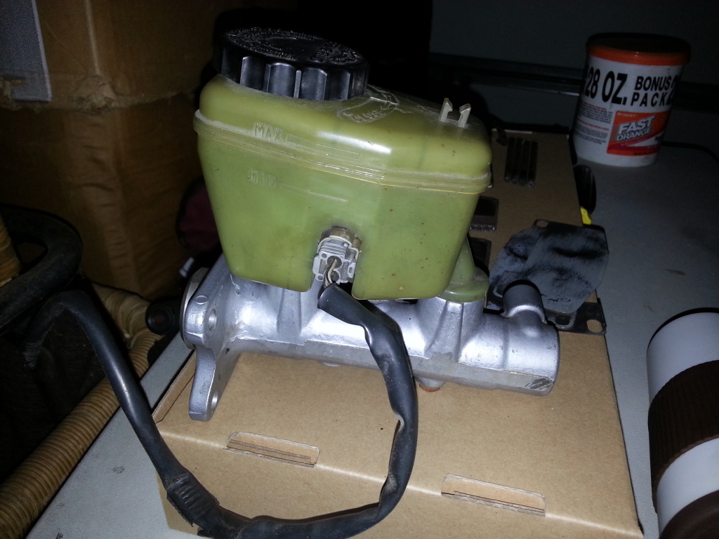

1Ton Master Cyl Info;
Brake Master Cylinder for the following 1 TON Models(1-1/16" Bore Master Cyls):
1994 Toyota T100 Pickup : 4-2694 2.7L DOHC
1994 Toyota T100 Pickup : V6-2958 3.0L SOHC
1995 Toyota T100 Pickup : 4-2694 2.7L DOHC - Notes: w/o ABS
1995 Toyota T100 Pickup : V6-3378 3.4L DOHC - Notes: w/o ABS
1996 Toyota T100 Pickup : 4-2694 2.7L DOHC - Notes: w/o ABS
1996 Toyota T100 Pickup : V6-3378 3.4L DOHC - Notes: w/o ABS
1997 Toyota T100 Pickup : 4-2694 2.7L DOHC - Notes: w/o ABS
1997 Toyota T100 Pickup : V6-3378 3.4L DOHC - Notes: w/o ABS
1998 Toyota T100 Pickup : 4-2694 2.7L DOHC - Notes: w/o ABS
1998 Toyota T100 Pickup : V6-3378 3.4L DOHC - Notes: w/o ABS
*** Corax found this 1-1/16" Bore MC a bit needing of too much PUSH, as the bore is bigger than he needed for his braking system( Corax; "*note* unless you also swap in the dual diaphragm booster, don't bother with the 1 1/16" MC - pedal was too hard, I swapped back to the 1" MC"
HOPEFULLY, I will be ok with the;.......
1. S13BW Calipers from the Low Mile 95 4Runner(Will have all new Seals in them) 20$ for the pair at PYPart 50% off day.......
^^^ ( Some Rebuild Stuff's for the S13BW Calipers ....... http://www.napaonline.com/Catalog/Re...Keyword&Nao=10 ) ^^^
2. Running these PADS; (THANKS for doing that research, GREGO!) ADVICS' Made For Aisin under Aisin's Strict Supervision. NOT positive on Grego's... But Mine are Carbon-Ceramic/Premium Advics HD Pads, Got them from NAPA, walked right in and picked them up for 59$/20% off- Preferred Customer something or another(OEM is listing 2 listings, 74$ for one and 86$ for the other[WITH my 20% off], .....and my buddy at Toyota Parts Counter said, he believes the difference is one is Semi-Metallic and the other is Ceramic>>>) Toyotapartszone.com lists 2 part #'s as well... And I believe THAT is because the 95/11+ Model 4Runners had different goodies, Calipers and all, plus 2 bolt master Cyls, etc. Either that, or again, a difference of Semi-Metallic or Carbon-Ceramic..... AGAIN,... I went with the nicest ADVICS/made for Aisin, I could find, with a 'Walk IN and Buy Factor in mind'...... (Part Number link... http://www.napaonline.com/Catalog/Ca...91V_0265432557 )

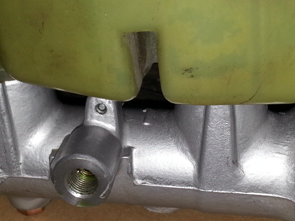

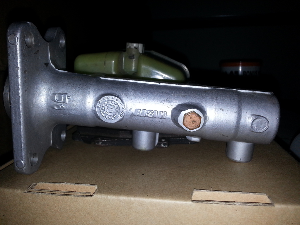

3. OEM-Aisin 1" Bore Master Cyl from 93 V6 Toyota 4Runner (Appeared Brand new, as did the fluid coming out when I removed it for 10$ at PYPart 50% off day) WAS Told to grab the Connector and wiring.... so I did.....
(^^^ The Reservoir IS NOT from that Master... That master-reservoir was nearly brand new... BUT, PYPart staff puncture every one of them they can with a screwdriver and force them off the screw to drain... I FOUND ONE that wasn't, ... Cleaned it the best I could... And while it's a lil stained in there, it's very clean compared to how it was)...

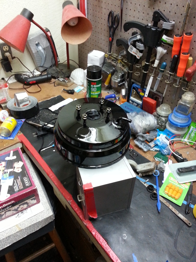

4. OEM 2nd Gen 6/91-8/95 Dual Diaphragm Brake Booster (From what I've read, which is now making more sense, the larger demand from the Larger Calipers and Larger Master Cyl. required a Larger, Dual Diaphragm Brake Booster[Also found on the Turbo 22RE's and many other Toyota Vehicles] 16$ at PYPart 50% off day.........

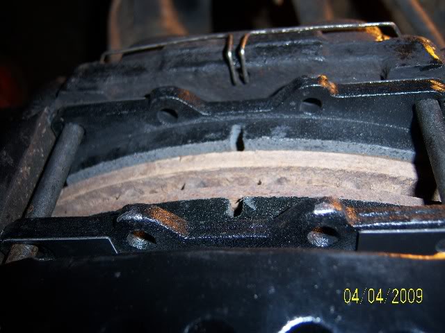

5. HART Black-Zinc Rotors, slotted and drilled, made of g3000 Iron and will be running the ADVICS- Carbon/Ceramic Pads on them.... I KNOW, I know, they're just bling... But I don't care... if they help, great... If I am unhappy with them within a year, ... the warranty will be used. AND, they are machined RIGHT NEAR ME in Garden Grove, CA!
.... Feels good supporting a Local Company
Here's the Link(I AM NOT recommending them or anything... Just sharing where I round them. I discussed this with a buddy on here, and being made of the same Material as Prostop and Brembo, etc., .... I feel comfortable giving them a chance at that price. AND, as I said, feel good supporting a local Company. ) .... >>>>>
http://www.ebay.com/itm/FRONT-KIT-Bl...sories&vxp=mtr
I will be doing a completely separate thread, short and sweet and to the point, once I've added up everything and installed it and added all the resources I got this from(For example, from Grimreaper and Corax and XXXtreme(WHERE THE HECK IS HE? haha), Philbert... and many others. All the links, etc., will be included. I will do that single post here, as well... But, I figured I'd update my buddies, in case anyone is contemplating doing this. UNLIKE 'MANY' what shall remain 'unnamed' here at the moment- mods.... This is one I believe I've yet to hear a "NOPE, stupid move... waste of money!"... People ALWAYS seem to say "WOW, what a DIFFERENCE!"... Often, just from the 1" Bore Master! I'm doing all of it to basically give me the 'just right' pedal and LOCK EM UP power that I feel I'm missing. My brakes ARE good... They're just not great. I'll settle for 'quite a bit better', and hoping for 'WOOOOOOOOT!' lol.

Well, I know others HAVE started with just the master upgrade. I cant remember all the results. And, like Corax said, "depends on which bore u get." I suppose, if u just add the 1" master, ur pedal would get harder right off the bat. It wud push the fluid up to the pressure required by the 4cyl calipers more quickly, ya know? Thus, when Corax had the 1 & 1/16" bore master,....he said "wayyy too stiff for his tastes". The dual dialhragm wud have helped that for him, but he cudnt fit it with his 7MGE he has in there. Thus, he stepped down to the "middle ground" of upgrade ville, haha. (I have to read back to see if he found that result BEFORE or AFTER the V6 Calipers went in..... that would matter cuz the V6 calipers require more pressure to be built up, and therefore, I would think that would soften up the pedal again a bit.) No time to read back right now, I will check back, but I have read several who have said they saw great braking improvement from just the 1" master, alone, into a 22re rig.
Many on this site, few on others.
