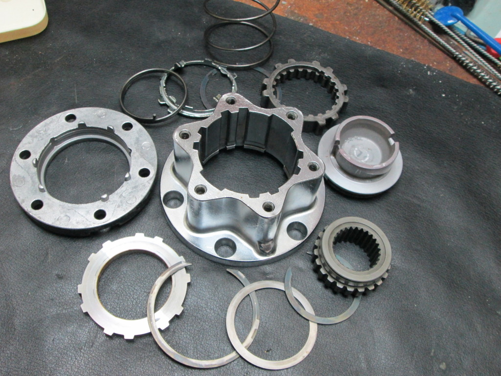

Got an order from some Aisin Hubs; Ordered the full OEM- Gasket and O-Ring kit for the HUB Resto I'm doing for a buddy on here.... It's coming along really nicely in just one day! >>>>>>>
I will post more pics when completed... Please let me know if you're interested in a PAIR... I have 1 IFS Pair and 2 SFA Pairs left..... All fully functional, but WILL be restored, not sold as is(I might as well keep them as spares if that's the case... As the yards charge WAY too much for these now, being LKQ).... S'ALL good, ...I'm just grateful to find them on occasions! lol. SHOCKED how much fatter the SFA 30-Spline'rs are! hahahaa.... ALSO shocked how well of condition this pair is in... Just incredible, considering the age. I'll be restoring them completely and will have them all ready on my Classified Ad... SO, if you're SAS'ing and don't have em or need an IFS pair, Restored WELL, ... Please, lemme know. (I will not discuss price on here... But let's just say, they're NOT free, lol. However, they'll be a VERY fair deal, IMHO. If not, oh well, no one loses... ... But I put great attention to every nook and cranny, and they're ready for bolt on with all OEM Gaskets and O-Rings. ) Just thought I'd let you all know, here, first. hehe.

wow mark those hub internals look so clean ya could eat off um

Where did you get the gaskets and o rings from for the ifs hubs? Toyota or somewhere else?

You lost the spring and detent ball, didn't you? It's the only parts not in the picture, anyhow! Looking good Mark!
Hey Redyota, they are OEM/TOYOTA parts, which I get from the dealer, as I dont always have more to order online, so its not enough difference to pay for shipping and wait and so forth, ya know? But, u can get them from toyotapartszone.com or the like.
Outer/cover to freewheel hub gasket:........
........... 43521-60010
Freewheel hub dial O-ring: .................................. 43532-60010
Freewheel hub body to axle gasket:...................... 43422-60010
Hahahahahaha, nope, I actually place them IMMEDIATELY into empty safety top perscription bottles! YOU KNOW EXACTLY WHY! Hahahahha. These were in such good condition, internally and externally, that both balls still had grease keeping them on the springs, lol. They came off a 94, so they had likely been bought from and installed by the dealer (had exactly the right ammount of grease/Oem Hub grease in them) Nonetheless, they got cleaned to like-new, and will be getting Valvoline/SYN-POWER/ High & Low temp extremes- synthetic wheel bearing grease. LOVE the stuff.

Sweet thanks!! I've been needing to figure out those parts cause I need to rebuild both my hubs!!
Old Feb 1, 2013 | 08:49 AM
  #5739
lil_red_yota's Avatar
Joined: Mar 2012
Posts: 153
From: Louisiana
Quick question. Do you have to replace the 2 nuts in the hub? Cause those nuts are 5 bucks a piece!!

Not unless somebody has used a screwdriver to remove them. Even then, you can still grind the burrs off of them and they're useable. There's also a few places like Marlin and Trail-gear that has the "spindle nut kit" which includes the thrust washer and star washer with the nuts for under $10 a side.
