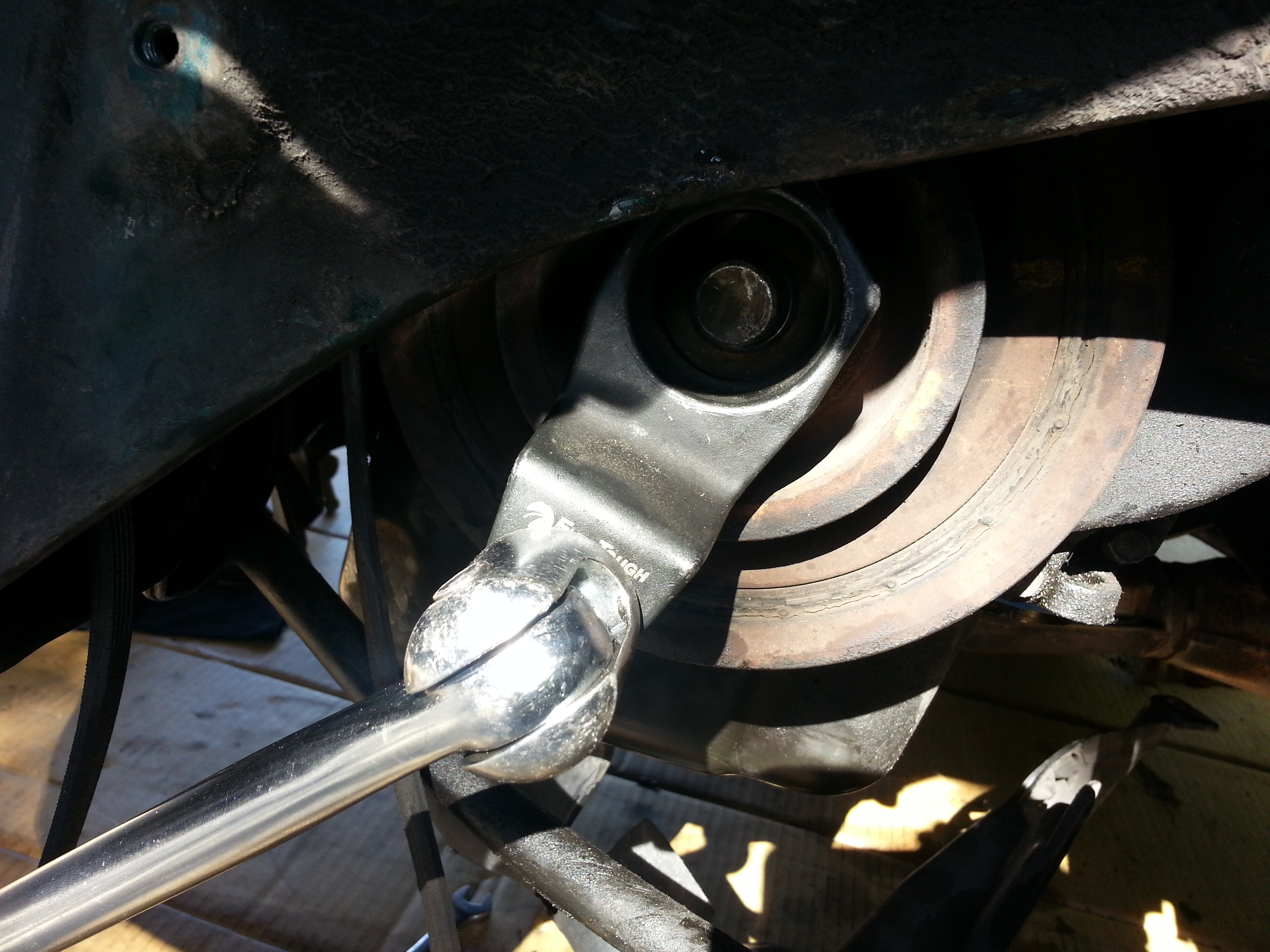

If the crank bolt is like the Acura integra(and I bet is is) you will need a tool to hold the crank pulley while you put a huge breaker bar(add 6ft of pipe to that) on the bolt. I shattered a craftsman 1/2" drive trying to remove one. Me and my brother-in-law stood on the breaker bar and POW! Bolt broke loose and shattered the breaker head. Also, you could try heat(MAPP gas).

crank bolts are fun on honda's...
1st gear, have some one stand on the brakes with blocks on the tires...
I have cut one down with a grinder...
torched....
airtools..... its fun.. good luck
your best bet is something like this
http://www.summitracing.com/parts/tt...FYs9QgoduREAZw

we have a set of vice grips with a chain jaw put a rubber hose in a pully groove an clamp it tight as ya can so it will turn an then brace against the frame or other non moving object
then a breaker bar with a cheater on it least the crank pulley on the honda from what ive seen isnt like the dodge interpid which requires a special puller the jaw tips thin forged steel not cast

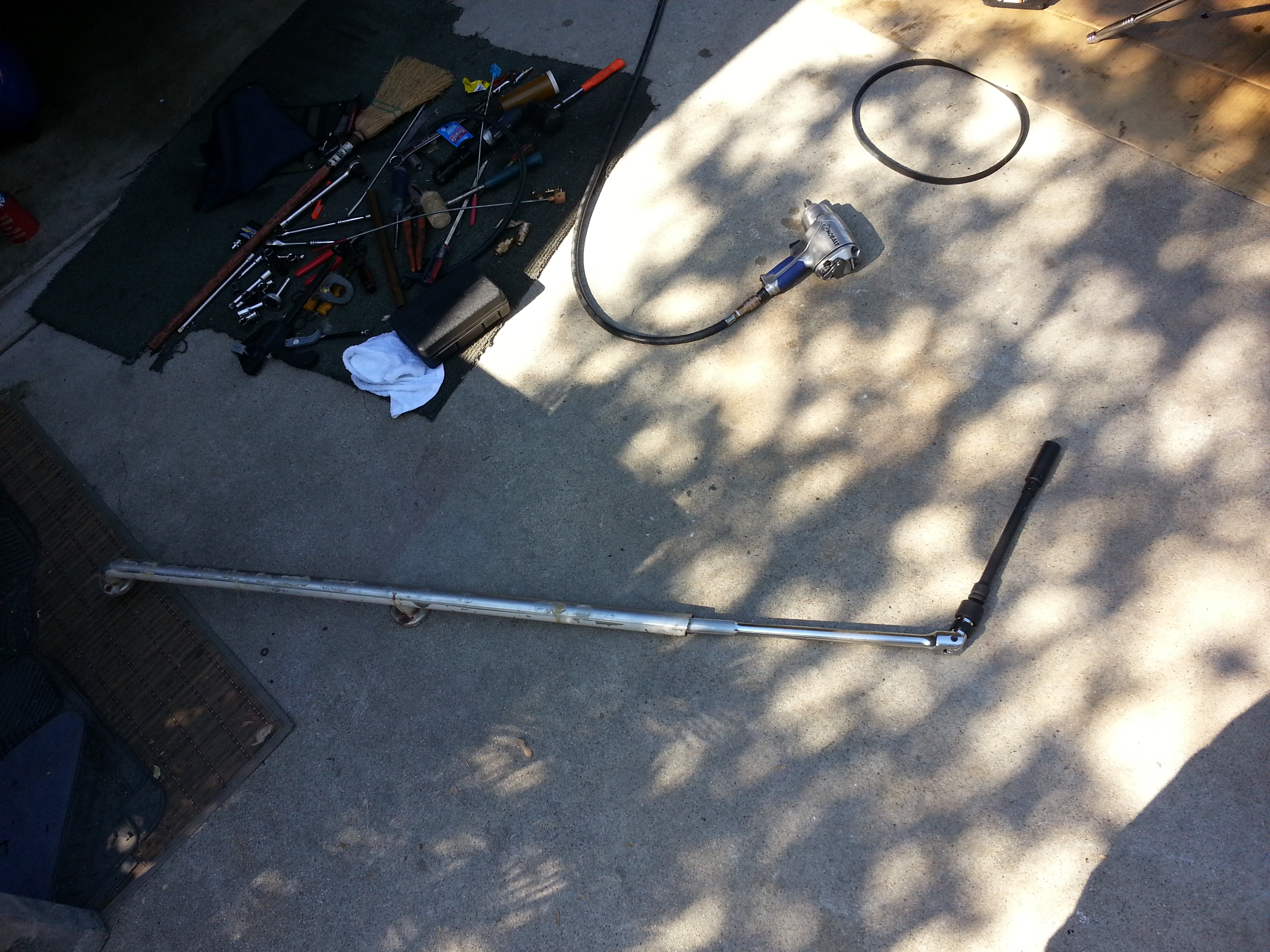

Got it! Guess how? Lol.... Just kidding. RB, I've had that tool from the beginning, the 25 inch breaker bar on the ground stopping it, my neighbors 250 pound 60 gallon compressor home setup that he has, hooked to my 350 pounds air impact wrench... 0! What did work? Three quarter breaker bar with a 12 inch extensions and a 4 foot piece of pipe as a cheater breaker pipe. That along with the Honda crank removal tool I rented the other day, and POPPPPPPP! Either it was rested on or some asshat torqued the thing down w/a 1400 pound air set up and 1 inch impact. I literally stood on this thing, & I am a strong person, and it took all of my weight and leverage around 10 o'clock on the dial to pop this thing loose! ........

Now I'm having a bit of a time getting the cover off, and the main seal is below all the timing components. I cannot get to it without removing all the timing assembly. Piece of crap! I kept going back and forth in the book, it wasn't very clear. But of course, as I read it again, it's clear as day... Hahaha. I guess I'm the ass hat today! Lol. I guess at this point, I'm going to try my best to verify the last time the timing kit was done. Might as well do it.
Also, if anybody with Honda experience can help me on this... Is it common for the dipstick grommet to leak? Because it looks like it's been leaking like a pig... And as I'm pulling the cover off, there is no sign of oil pouring out of there... I may very well have been right in that the steering leak being so severe was running down and into the timing cover. It looks as though, even if they did replace the timing kit, they never replaced the timing cover seal. That is another ass hat move, because when the steering pump for anything of the sort leaks, it will where its way through that seal and then get on to the timing belt which is something that could end up being catastrophic as this is in fact an interference engine.
PS: the next time they go out and by a front-wheel-drive slant engine of any kind, I'm going to give them the number of a good mechanic. This is absolutely a shoe horn fit and I'm going to have to do quite a bit of research if I'm going to do the timing kit. As soon as I can get the top cover of I will know if the cam seals are leaking

I was wondering if you could do the starter trick. My compressor can usually break the 22re crank bolt, but been a few motors that I had to take to a shop and their 3/8th air hose would not break the bolt loose. It took a 1/2 inch air hose to break the bolt loose. Japanese apparently like to torque all of their crank bolts.
Glad to see you got it. I did some work on an escort years ago. The way they had that motor shoe horned in there, you could not get tools in there. I figured out how to use a hole saw in the inner fenders and get to several bolts with a ratchet and extention.

Hey Terry, I hear you man! Its funny, my 429 Cobra Jet had more room! Hahaha... I know, I know, that's a lot bigger engine bay in a Mercury Comet.... But still! Lol.
Anyway guys, it turns out that I had downloaded the wrong manual, which didn't really matter until it came to the timing kit. This is an interference motor, but being a timing belt, the seal is beneath the timing kit ... But, as I got the cover of the bottom of it a bit, I didn't see enough oil or residue or any evidence of slinging and the belt was completely dry... I'm starting to think that is leaking from the dipstick tube and the half moon of the oil pan on the front/driver side. It didn't appear to be leaking anywhere else from the oil pan after I did that job.... But I think my thoughts that it was a cam seal or crank seal were wrong. In a way that's good, but it means I have to pull the pan again.
I installed the new power steering pump and I will bleed it tomorrow... However, I really don't think that the level of leaking that I saw after doing the pan but before doing the steering pump could have been the steering alone. It looks like clean oil...... ...
I'm hoping it is not the main seal, because at that point you might as well do the timing kit, and it seems to be running perfectly with no overheating issues, which I mention because you would obviously do the water pump while doing the rest. The reason I am hoping it's not the crank seal is because not only would I have to do the timing kit, but from everything I've read, when I finally got the proper manual pages: I must first unbolt the motor mount support the engine drop the front crossmember and with the body and allow the motor to drop enough to get even the top portion of the timing cover off.... Not to mention I would also have to remove the alternator and steering again, and I would have to remove valve cover, which I just did! Grrrrrrrr!

Wholly Crap! damn....that's some leverage! My wife's 04' Civic's power steering pump has been acting up also. I'm glad I'm getting rid of that thing come December/January and getting her a new RAV4 awd. It's just got to hold out until then....fingers crossed.

My K20 was a PITA as well. Had to use that crank pulley tool as well, but got mine from my local Matco dealer. My 2ft 1/2" drive broke that sucker loose...lots and lots of struggle.

Yep, if you could see that pipe and that three quarter breaker bar in person... Trust me its huge and a lot of leverage. As I say again below, I'm praying that this is not going to get into the main seal & timing kit, but I'm also not very happy about the pan if that's the case. And, if it is the dipstick tube, I can't imagine that happening without mass blow by ... Which, I think obviously would mean that the baffles in the valve cover or something are all plugged up. I am very sore and tired from working on this damn thing so many hours. Kinda bummed because I wanted to hit the Angeles Crest on the couple days I had off..... But, my kiddos and they're kiddos and all their safety is a lot more important.
My neighbor came home yesterday and said that his Eragon would have worked... I guess that's possible. But I only have so much hair behind mine and it puts out 350 pounds on full blast. And with all the leverage I was putting on there, I just can't imagine an air packed of anything but 1000# or so would cut it. My neighbors buddy owns a shop and he said that he has a 1300 psi gun and system and they still have a buddy with the wanted to breaker bar holding the special Honda service tool and another one heading the gun which literally can rattle your joints lose. I'm speaking of when he works on the Hondas I guess from what he told me. I'm just praying but its not a front main seal

Haha.. I have a 3/4" & a 1" gun at work, but my compressor at home is too small to supply the volume of air needed for these guns.
