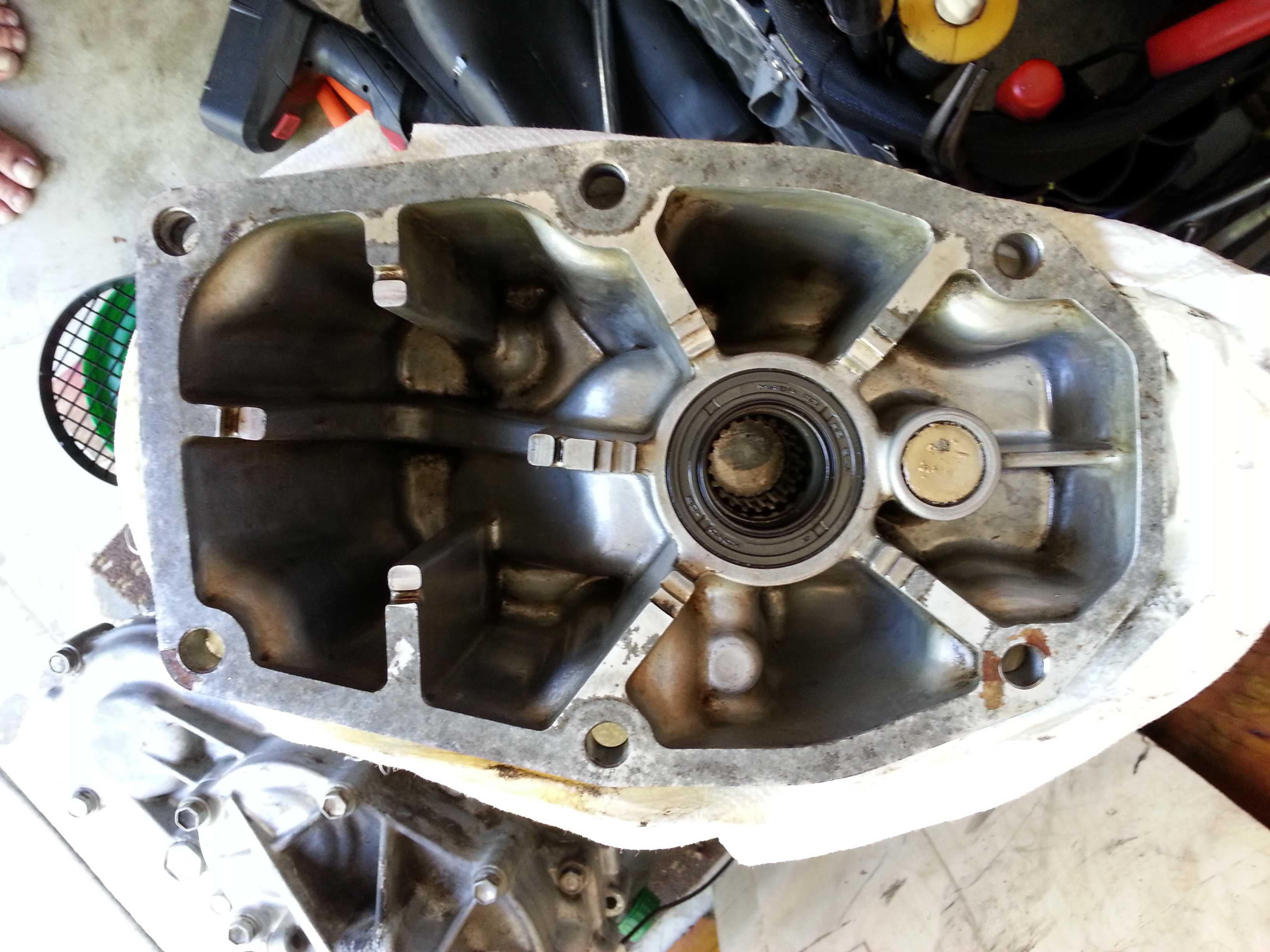

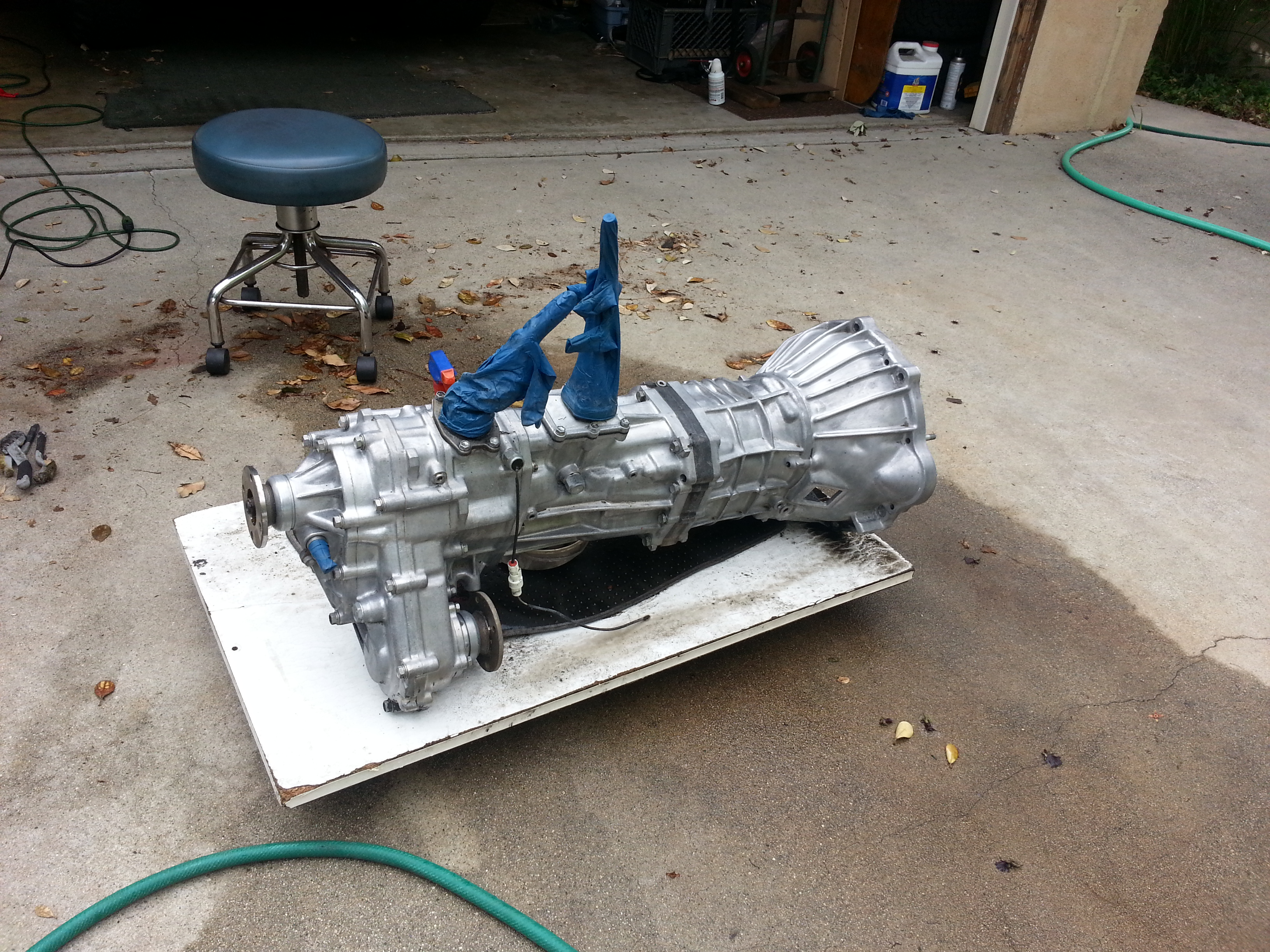

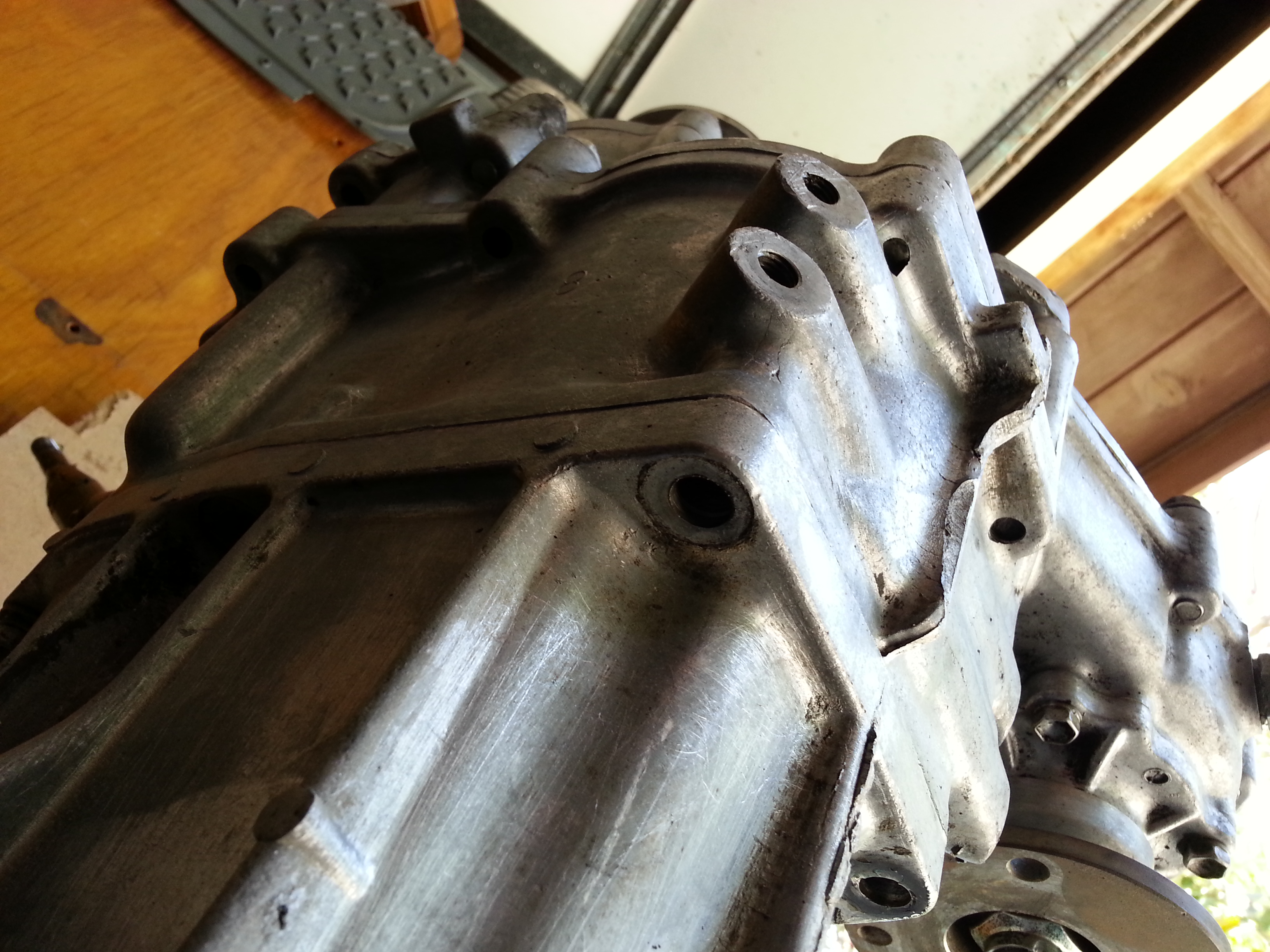

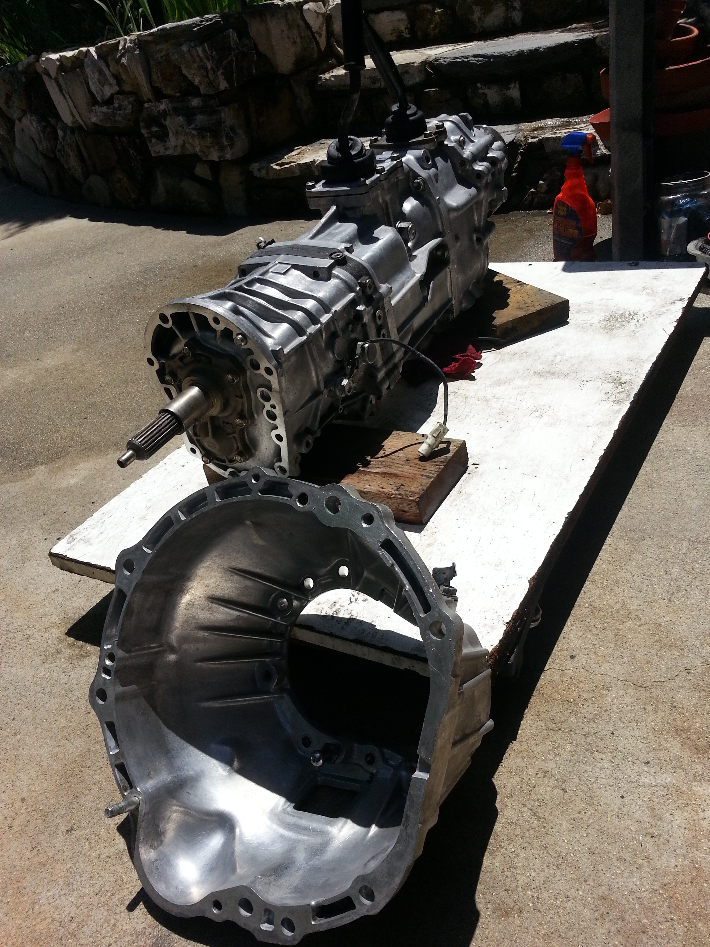

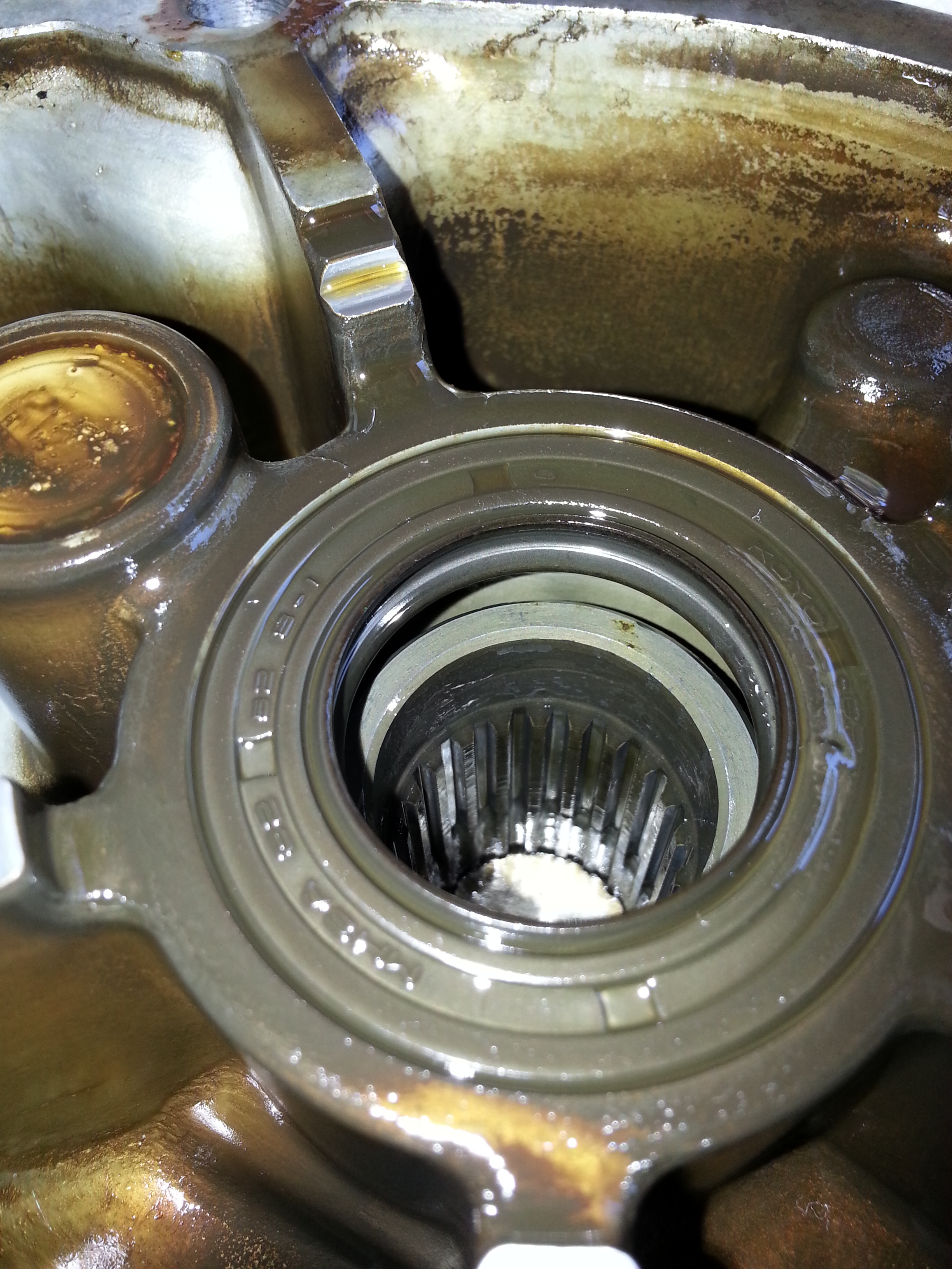

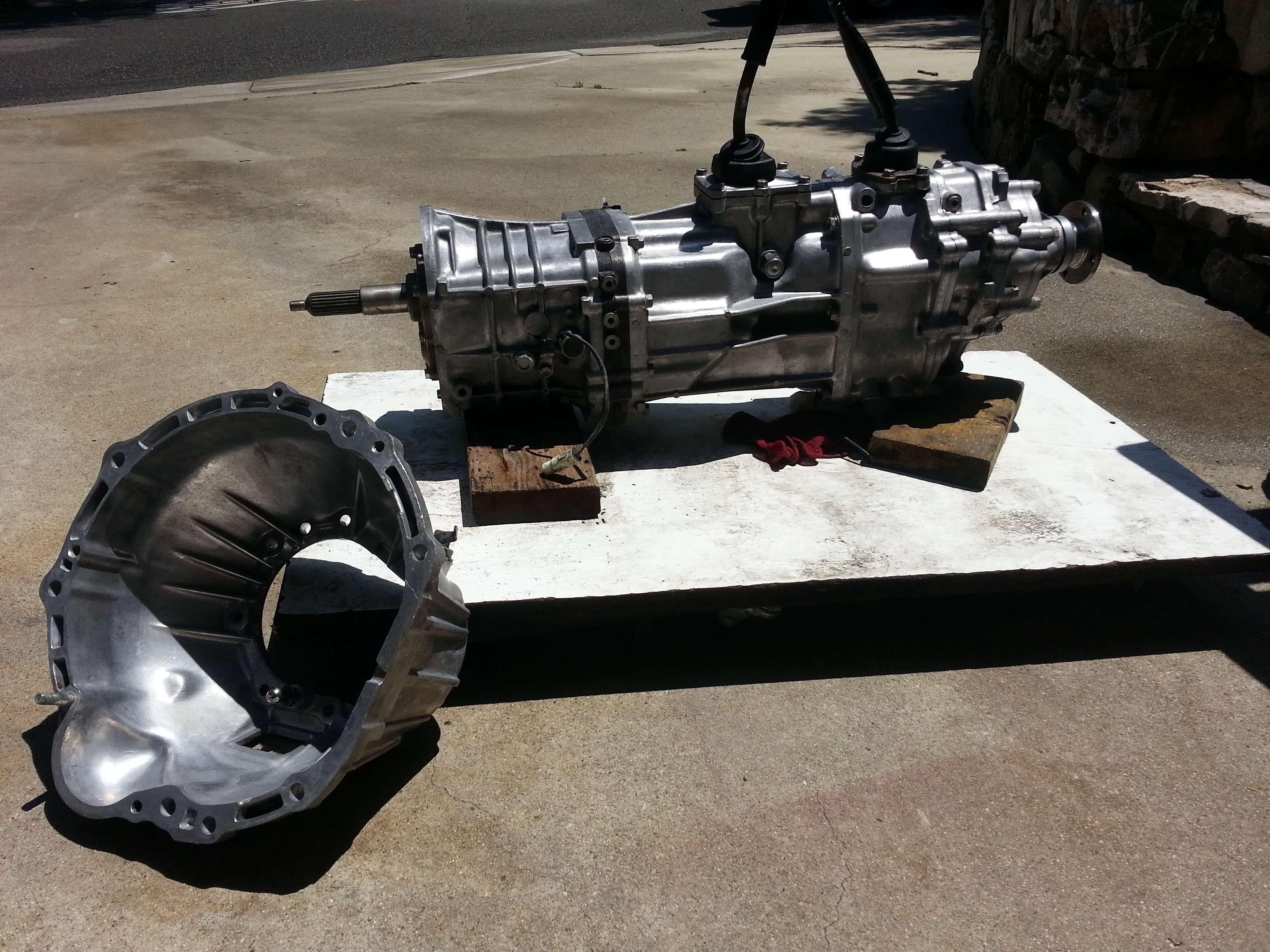

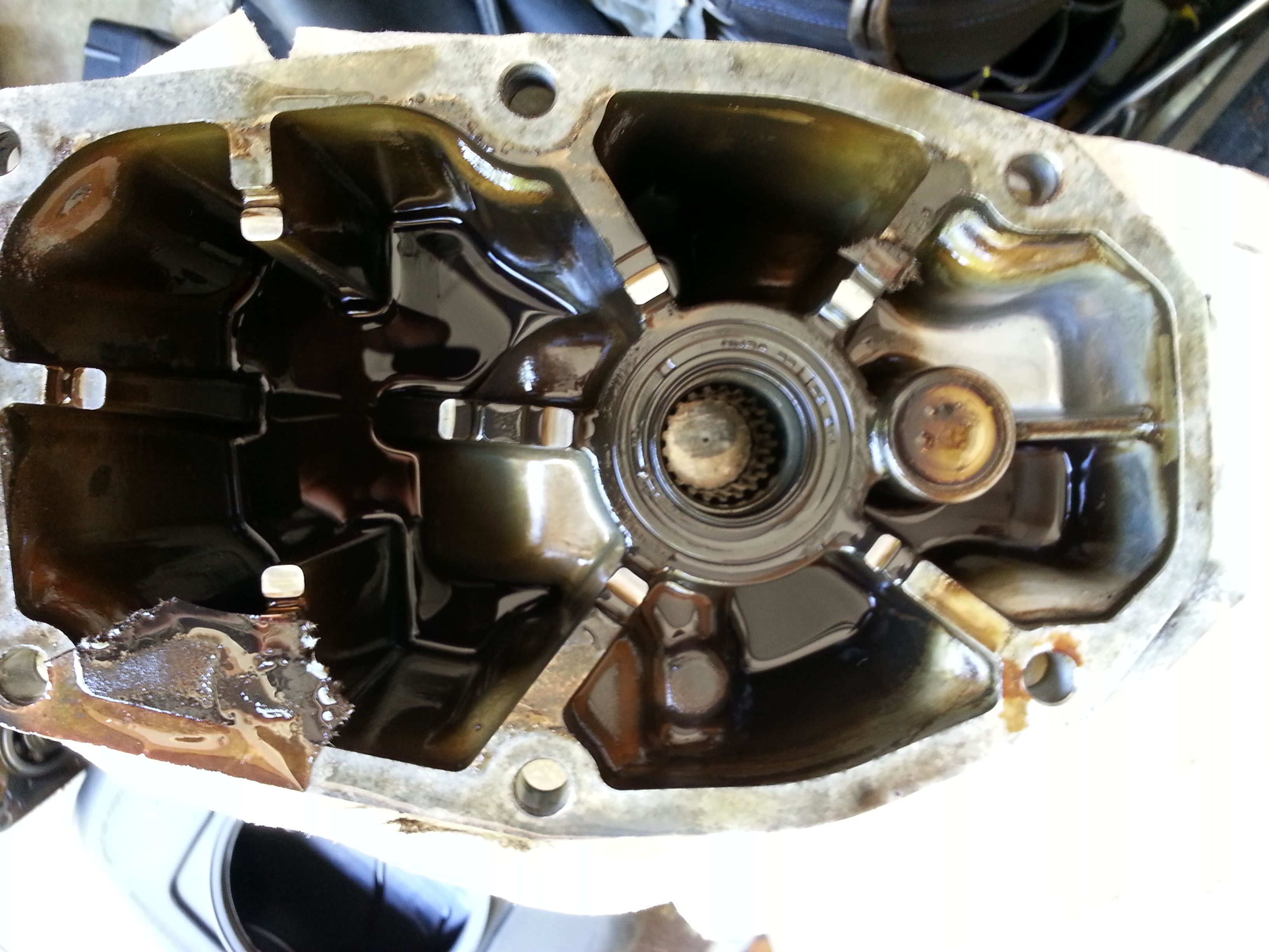

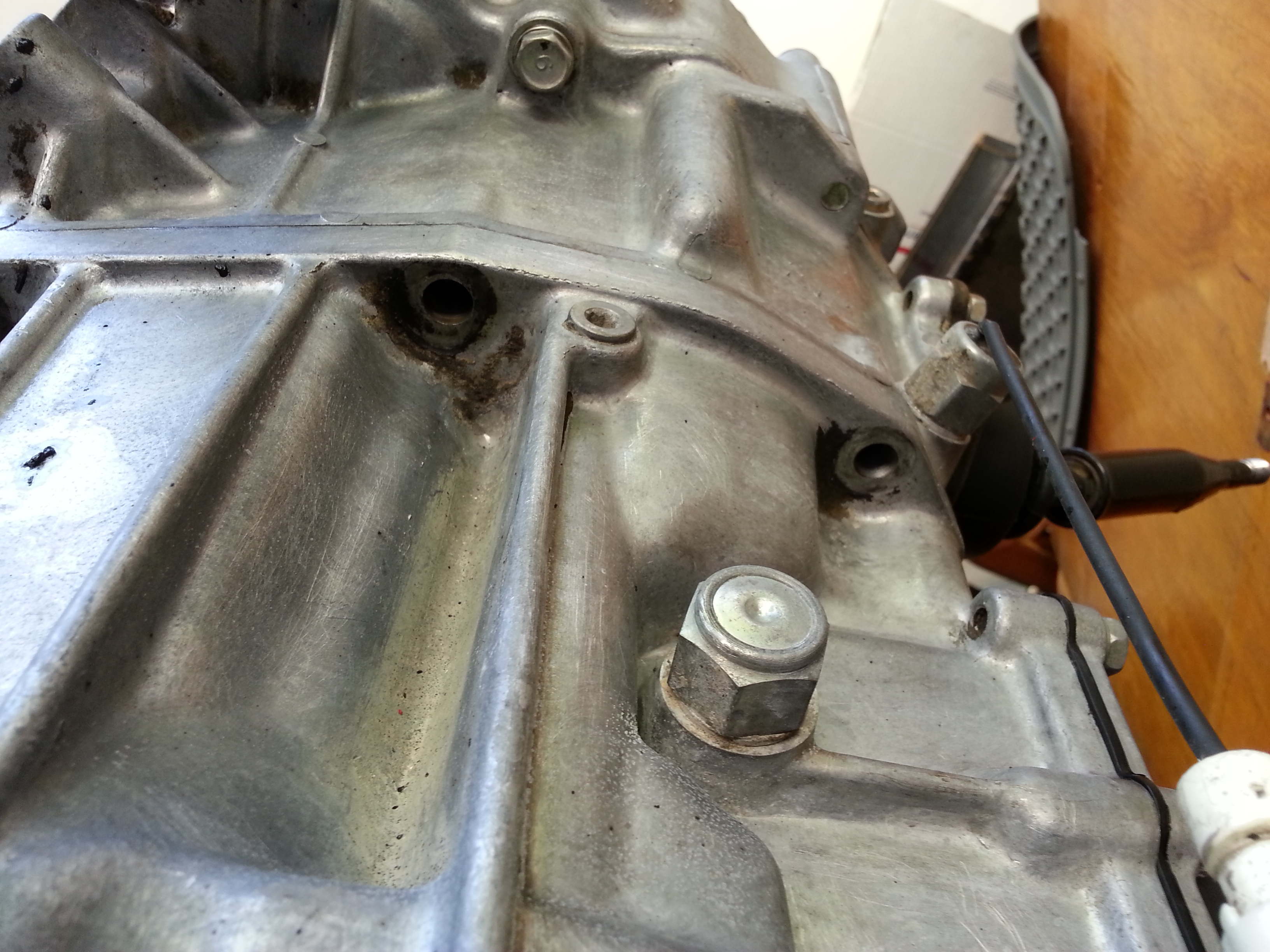

Hey guys, I've just been really slammed with life. Much of it is dealing with things for Mom, trying to put her paperwork and such in order. She seems to be doing a lot better, I can't thank you guys enough for all the thoughts and prayers!
Well, today when I have some time in the later afternoon I finally got back on the Trans and I finished cleaning it up pretty pristine! .......
I have a trans output shaft seal where the transfer case meets the trans, and I have the gasket that mates the two as well, and I also have a front and rear transfer case pinion seal kit with the dust shield for the front one... All Toyota/OEM. I might take a peek and also swap over my bearing retainer seal from my trans which is almost new(I did that when I removed the first motor that Valeo's screwed up so badly. Some of you might remember, I had a week and I was positive the rear main wasn't leaking... Figured out it was the trans input shaft/bearing retainer seal).
From here i have to decide how far I want to go and if I want to take a really good look in there or not. ( I even looked him into the Marlin trans rebuild kit, but it is currently not in stock and doesn't appear to have a date as to when it will be. I figure if I'm going to rebuild it with the help of my machinist it might be a good idea to use the best parts available? I think factory TOYOTA parts, like all new syncros and bearings and seals, ... Well that might get a little costly??? Lol). I think I will call my buddy at the dealer anyway and see if they do have a rebuild kit and how much it would be, minus the parts I already have???
I already removed the bell housing and will remove the retainer tomorrow. Inside of this bell housing was unbelievable! I mean I could literally build a grease snowman out of all the crap I got out of there so far, and its not even done. Hahaha. I'll get it though, I just prefer working on things that are clean, not to mention; I really don't want to open up a trans in an eighth inch of hardened grease and sludge. Lol.
I also noticed that there is is this a number on there. It looks hand written and like perfect writing that was originally on the Trans before all the grease buildup... If I didn't know any better I would swear it says 88, each number being about the size of an orange in total. Just kind of odd, and I wonder if the trans was ever rebuilt or not. It sure does go easily into every gear and the shaft spins smoothly in all gears and in 4hi and 4lo. Anyway, we'll see, right? Thanks for checking in guys, I'm sorry I've been a bit aloof as of late... I honestly can't help it, but I do very much enjoy updating. I'll be back! He he he

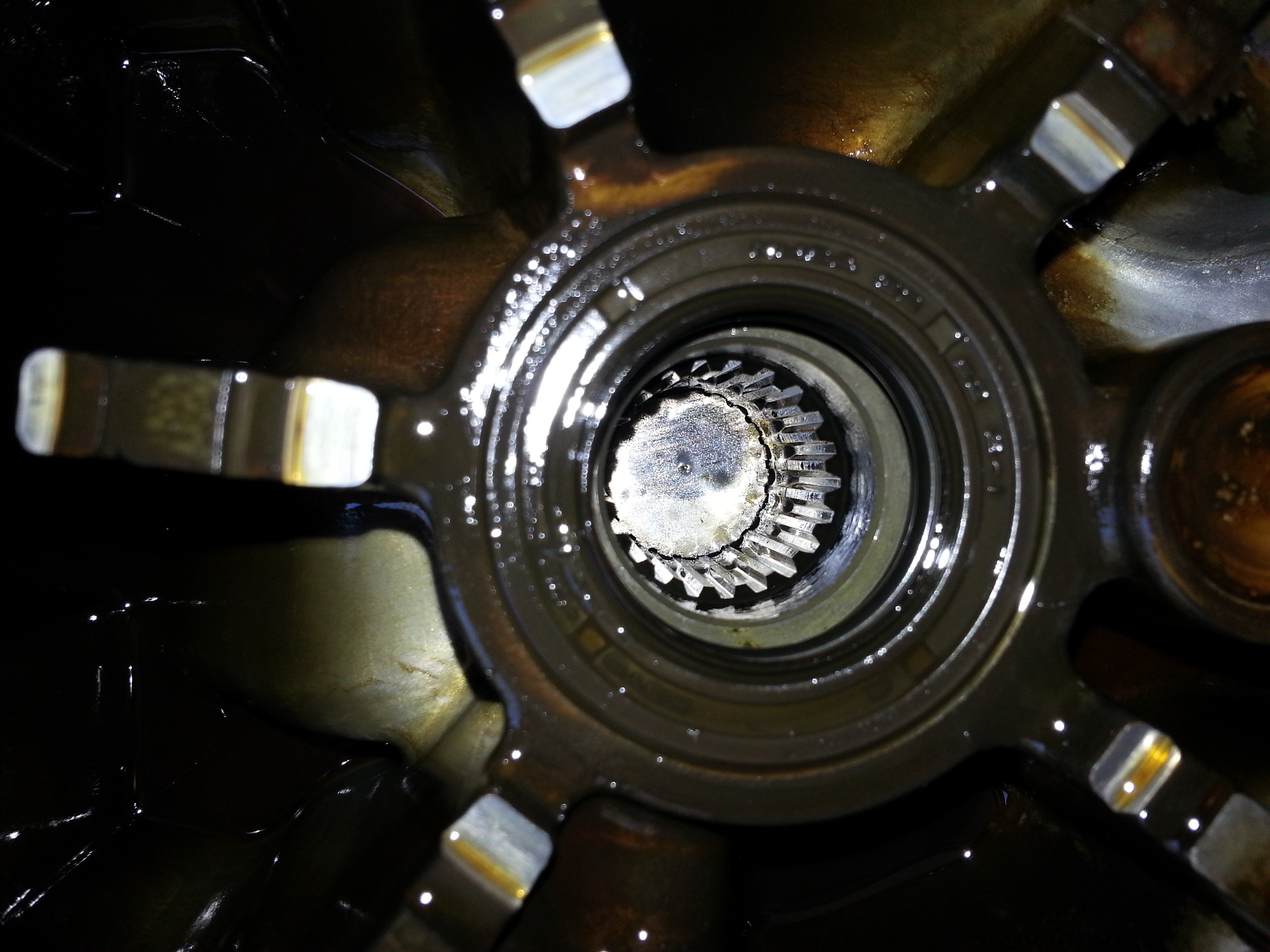

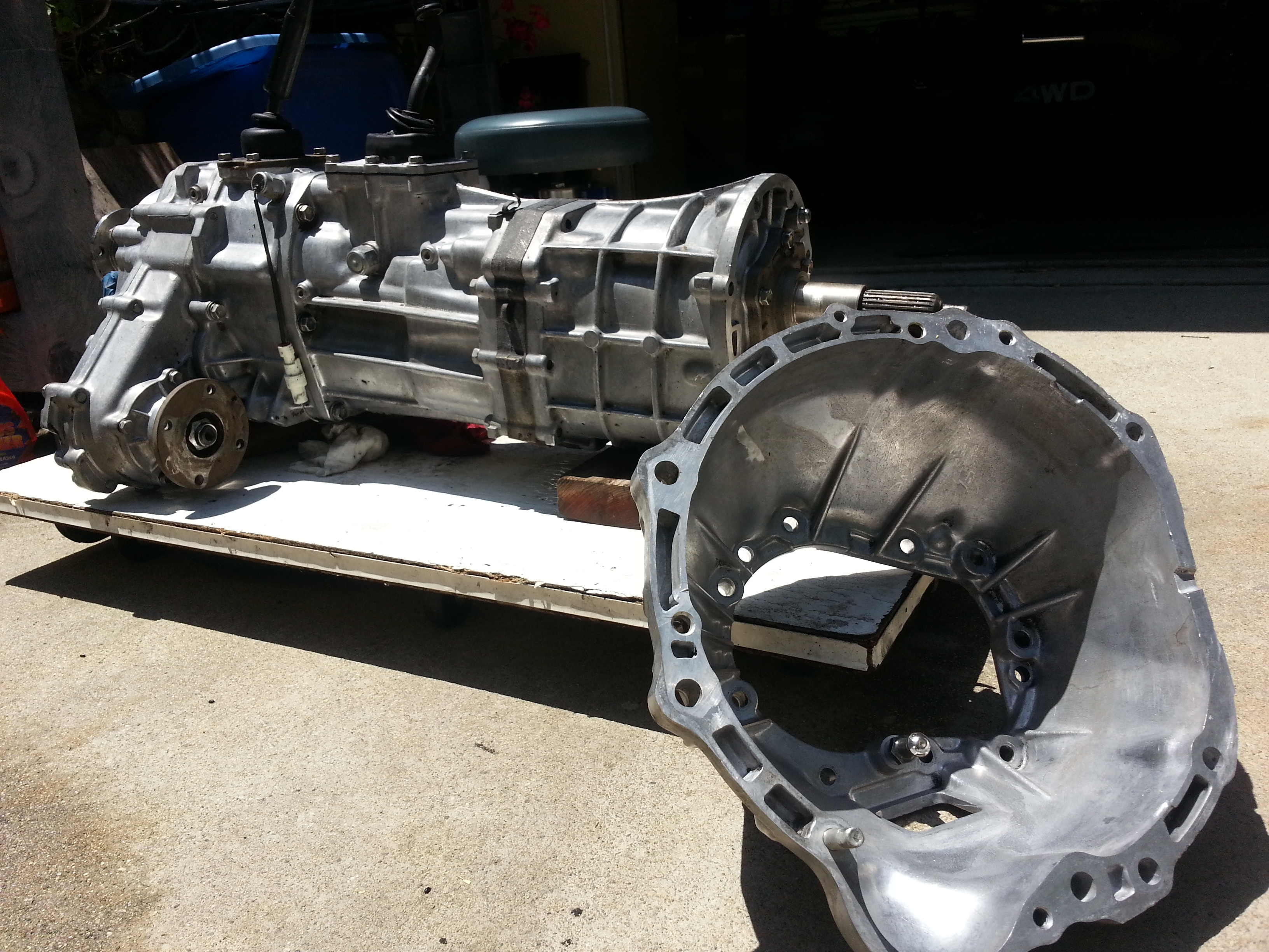

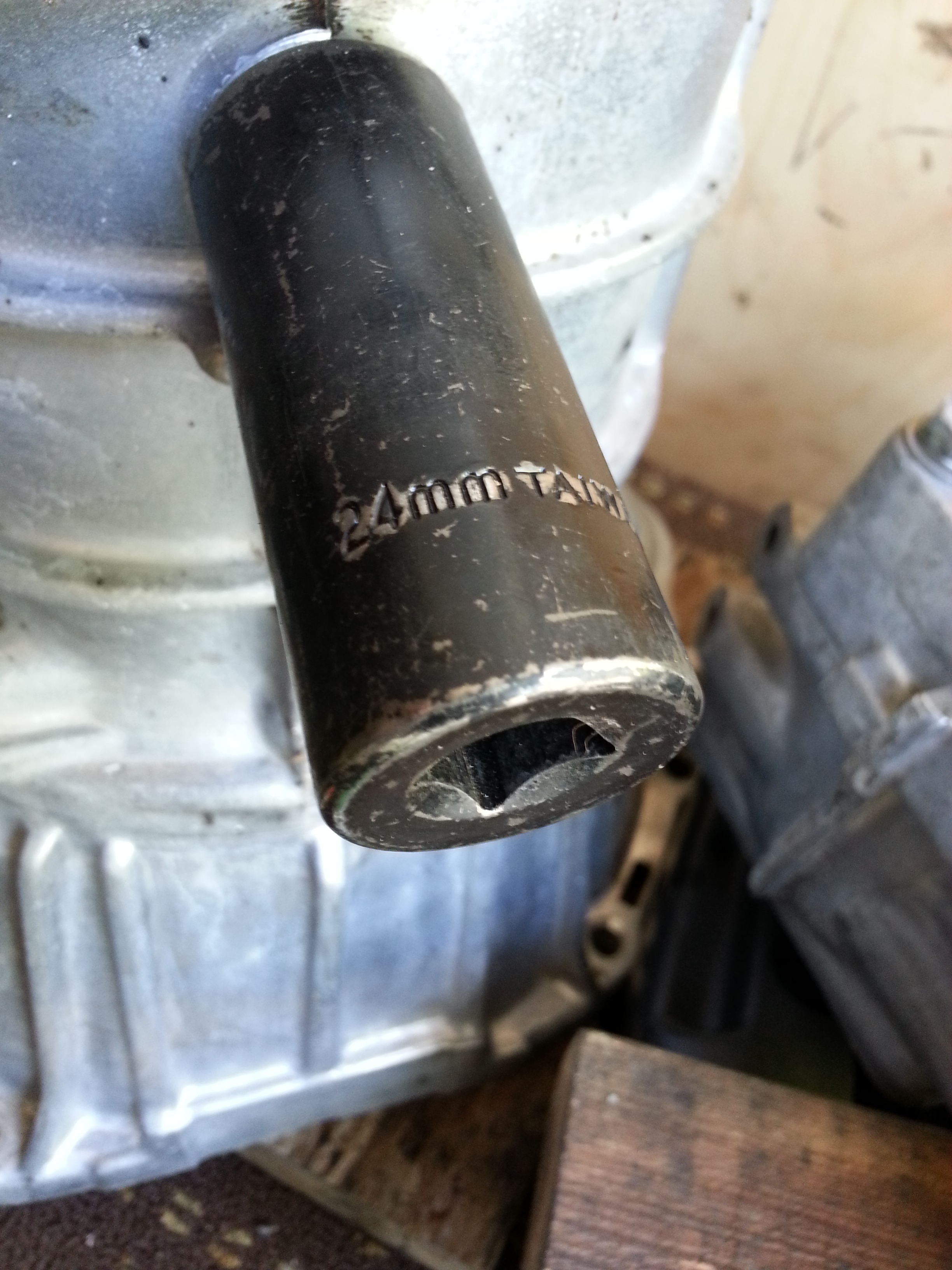

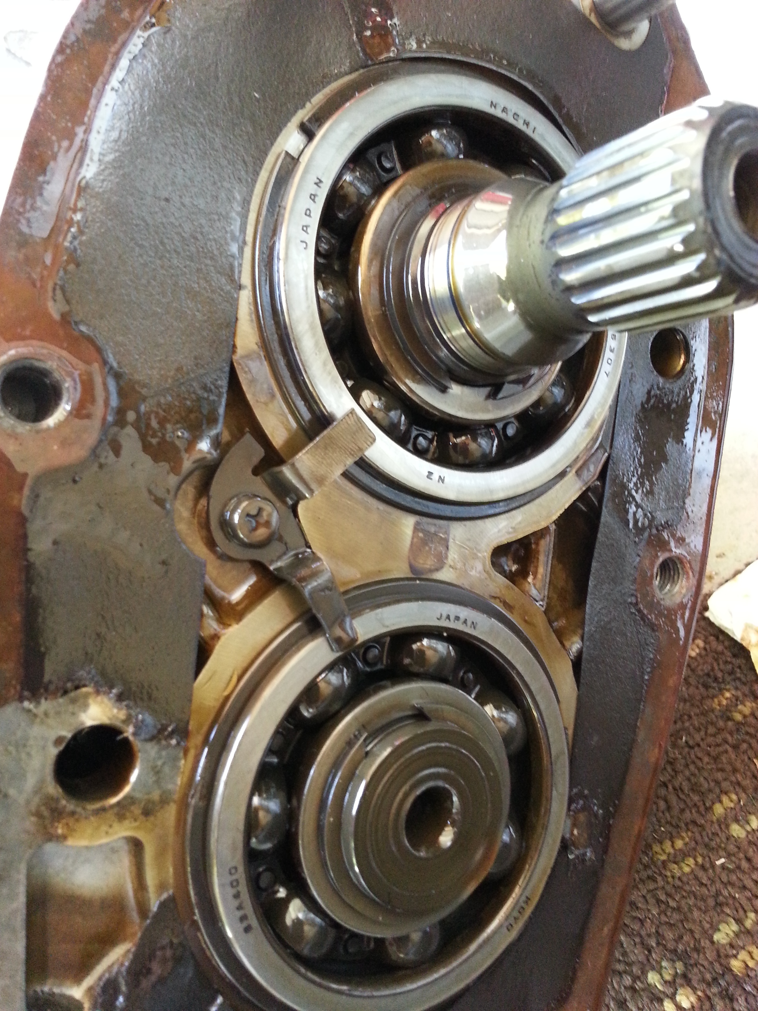

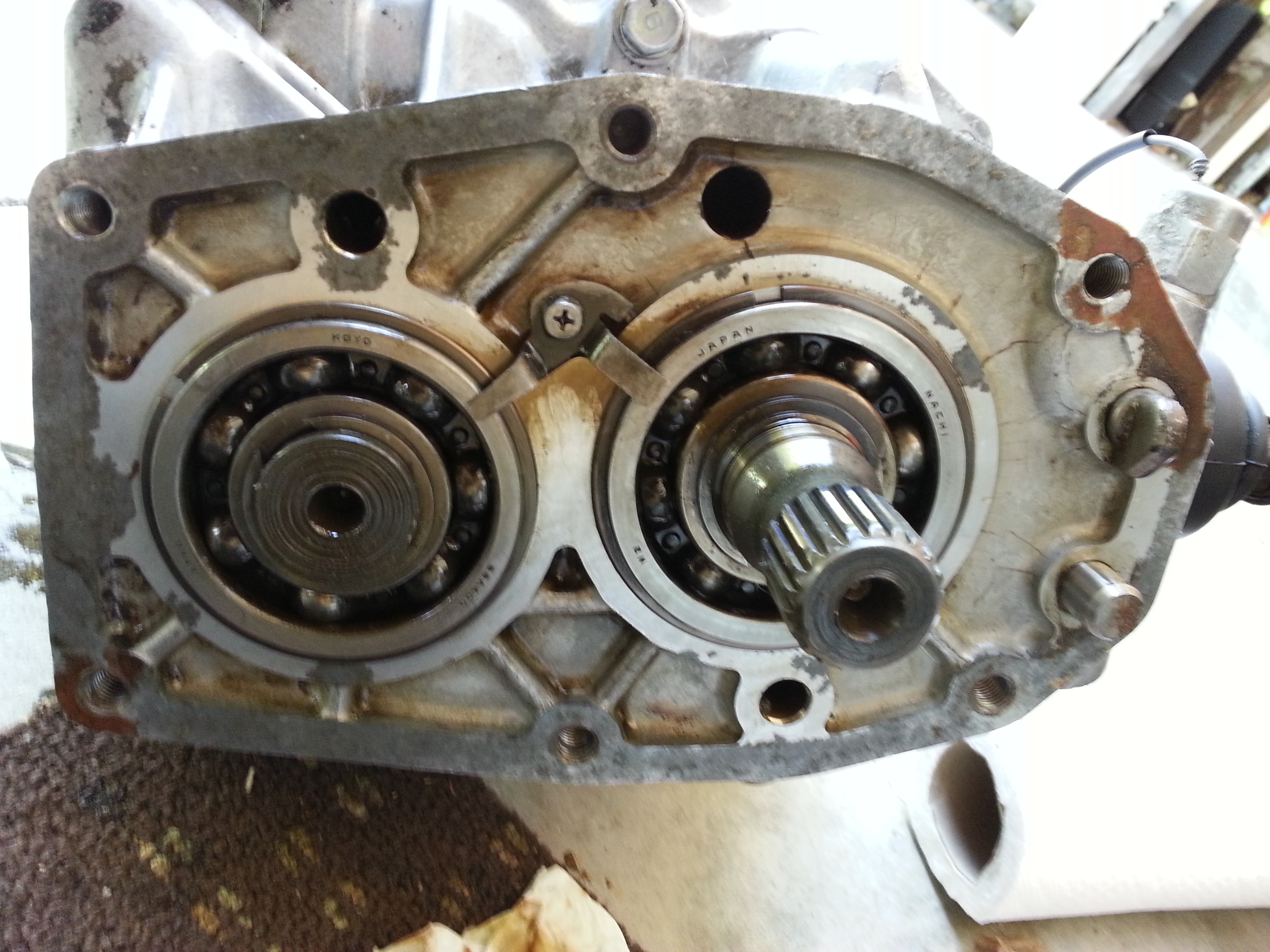

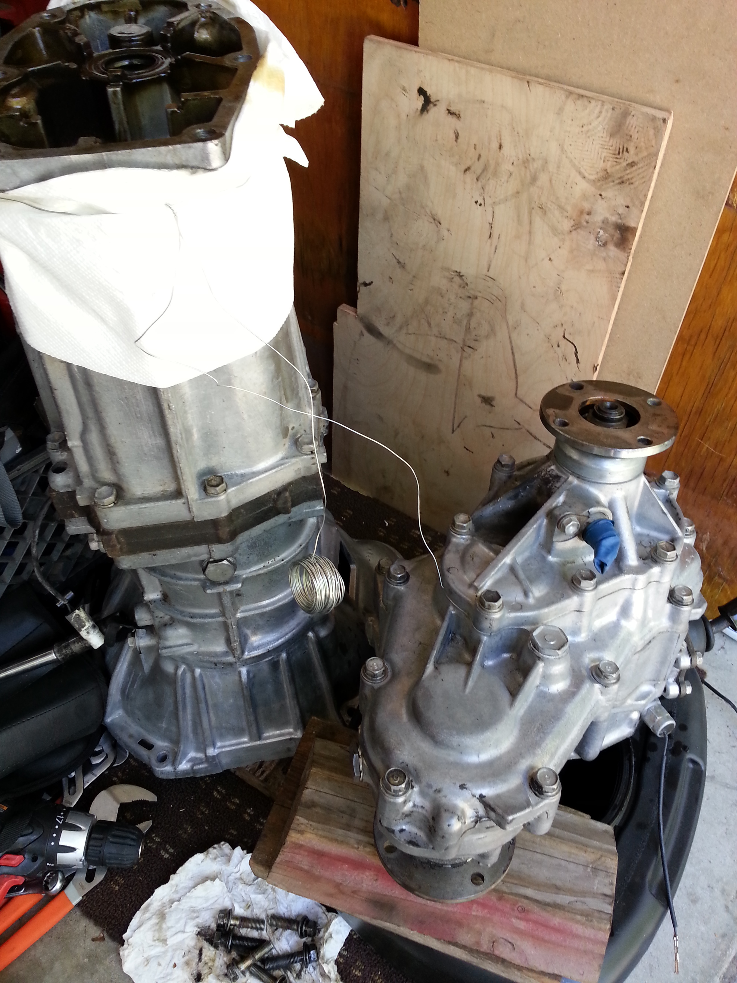

Today I finished cleaning the bell housing and last details of the trans before I pulled the transfer case from the bell housing.....
Next, removing the transfer case from the transmission is in neutral and that the transfer case is also, in other words in H2....
Free movies 6 - 14 millimeter bolts .
Next make sure you have a good grip and that you don't knock the trans while standing up off of your blocks... Then pull up and out!
Eyes and did some cleaning up and removing of the oil the drain from the transfer case into the reservoirs and valleys of the inside of the rear of the transmission...
Came out pretty good so far, and now I'm ready to pull it apart...

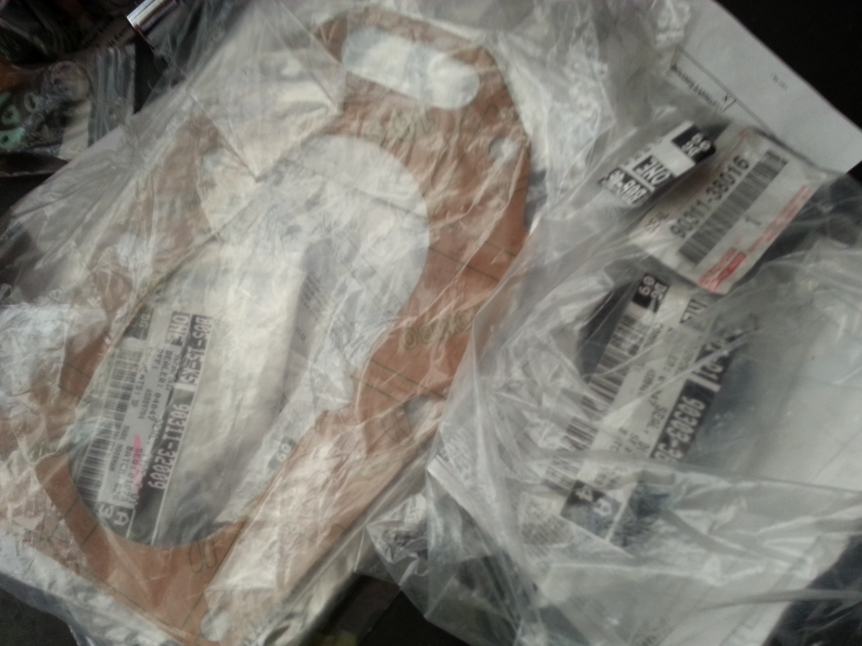

Also wanted to post some pics of the gaskets and seals that I already have, and a reminder to anyone to use a hex socket wrench only to remove the drain bolt from the bottom of the transmission or transfer case...
That's all for now folks, I'll be back with an update as soon as I can, thanks a lot for checking in!
