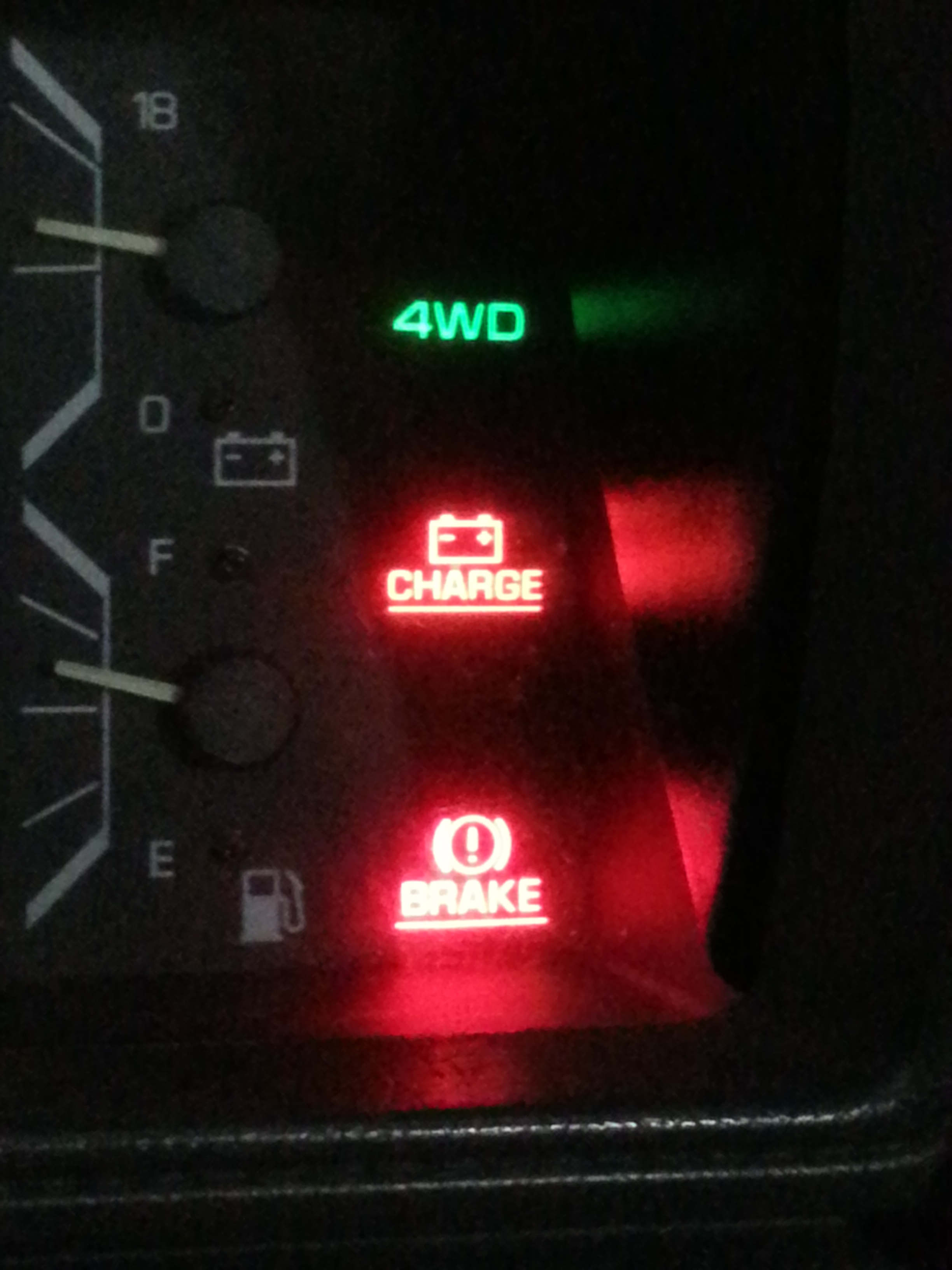

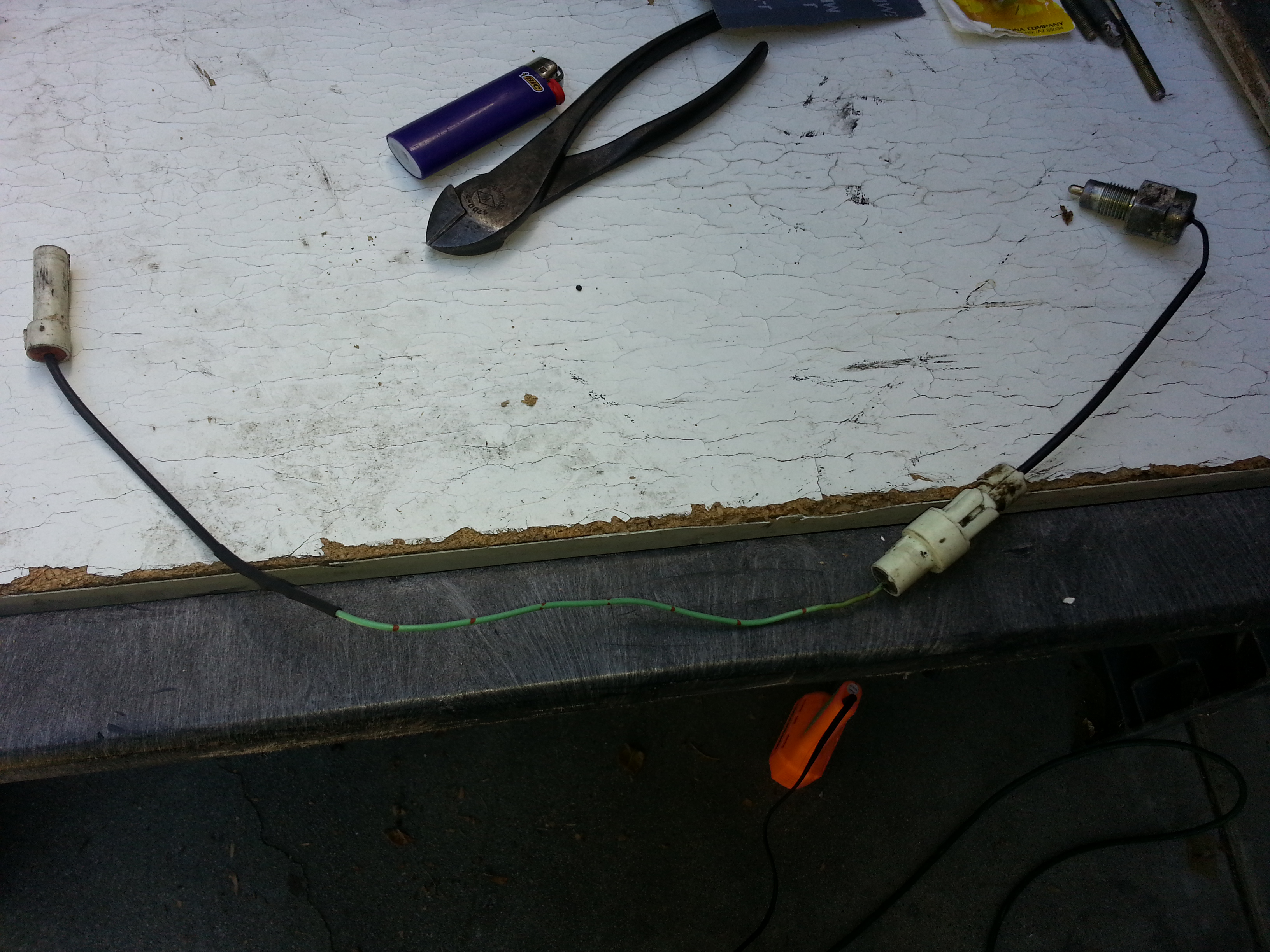

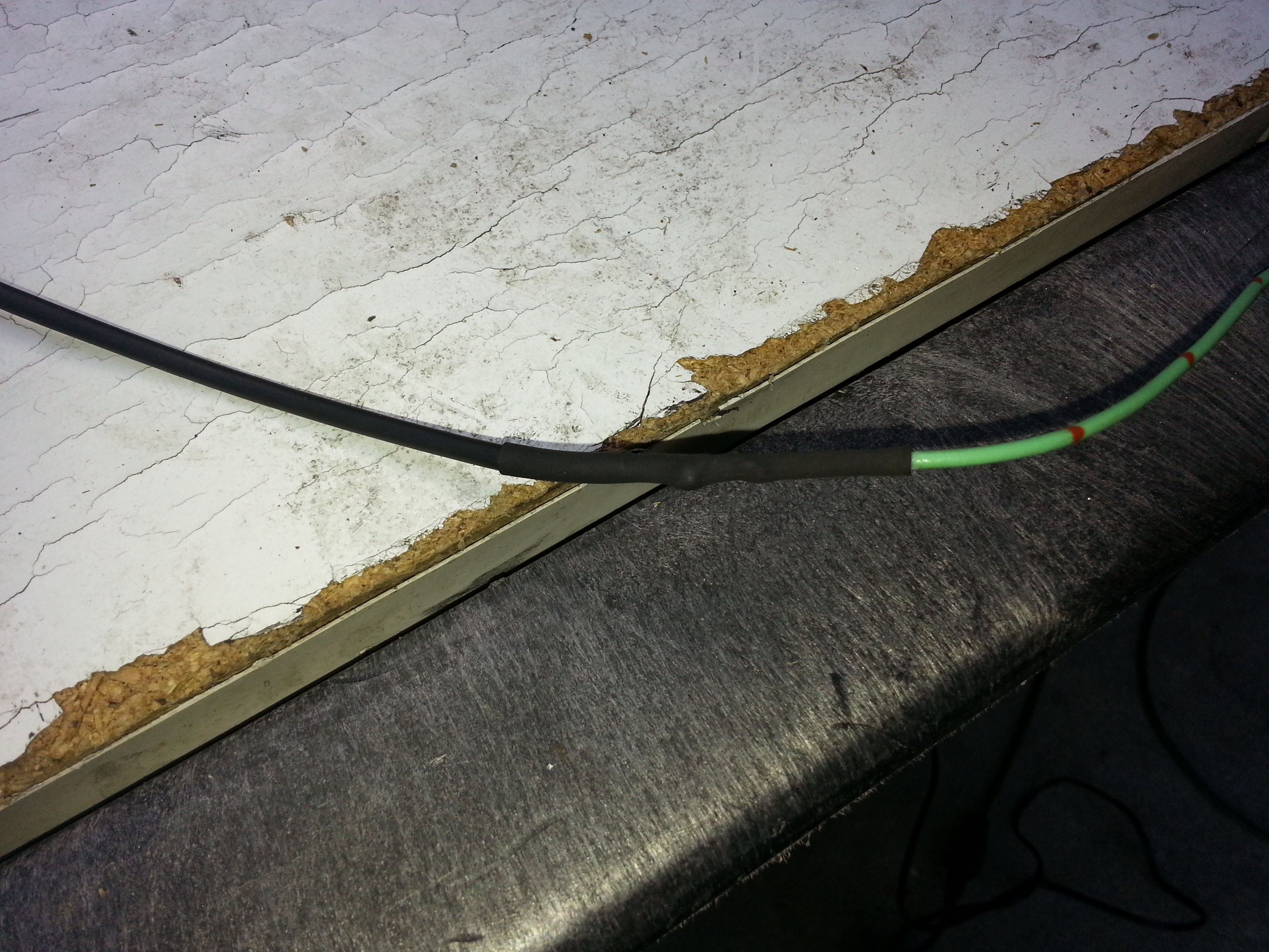

Got my replacement "4WD Indicator Sensorb for the Dummy Light from Eric. Mine broke off at the sensor, which is a tough fix... So I did my mod/extension like this, using 2 connectors....
Soldered and heat shrunk cleanly......
VOILA!......

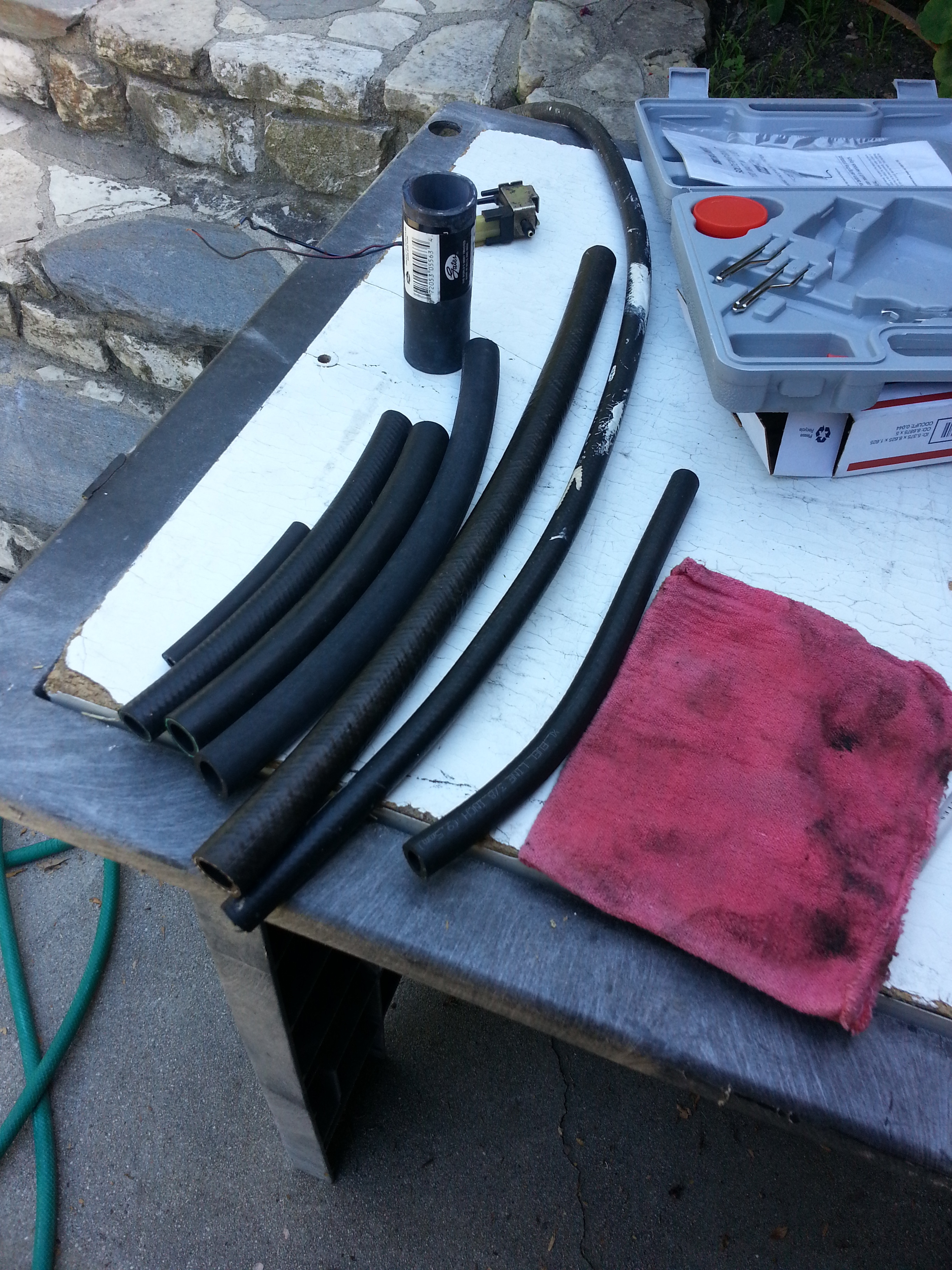

Then I got out all of my heater and fuel hose and cleaned up the garage quite a bit... I will be using some of these hoes is to replace at least the one heater hose in the 2nd picture... It's toast and I'm lucky that it hasn't just blown up to this point!

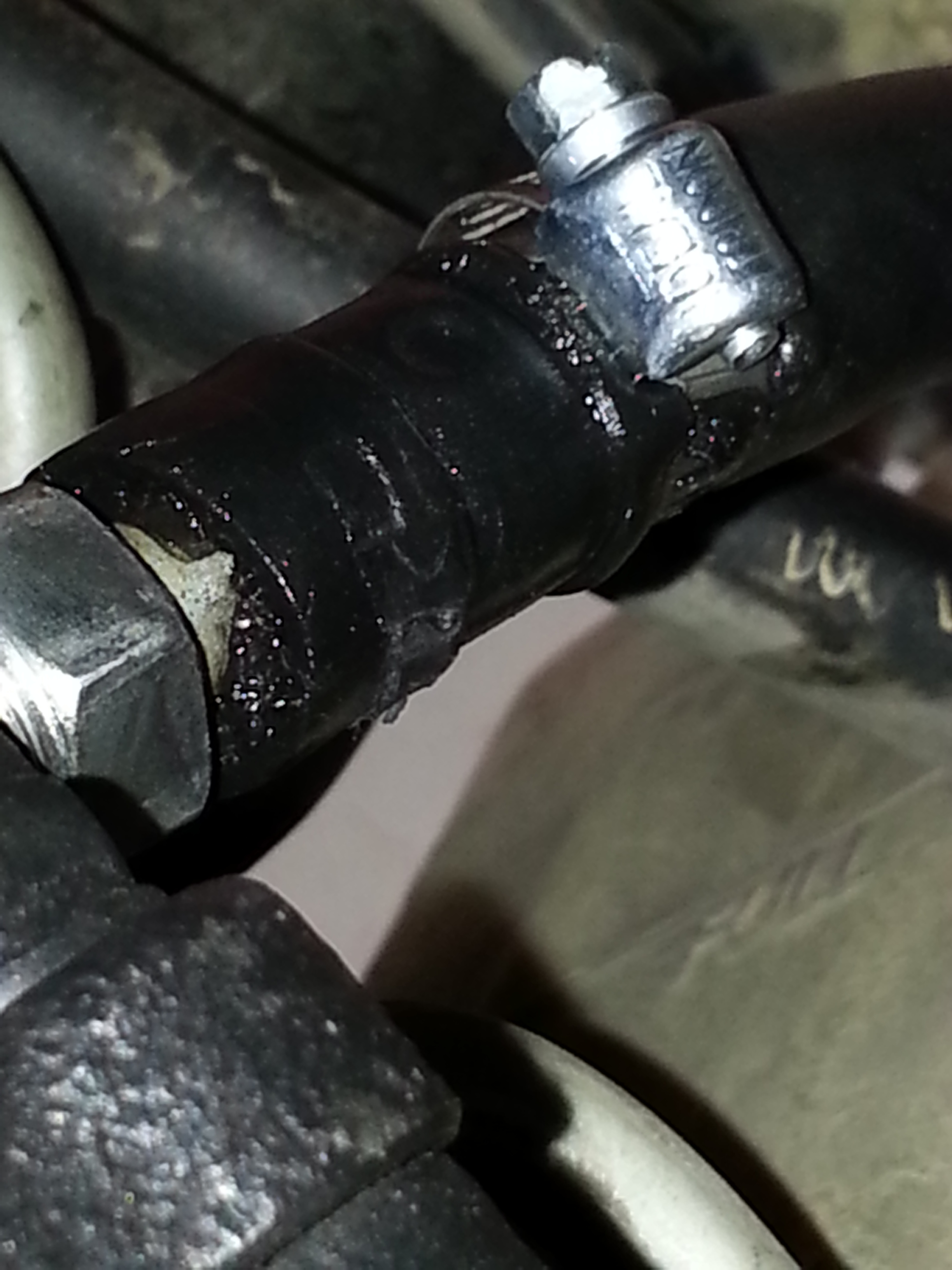

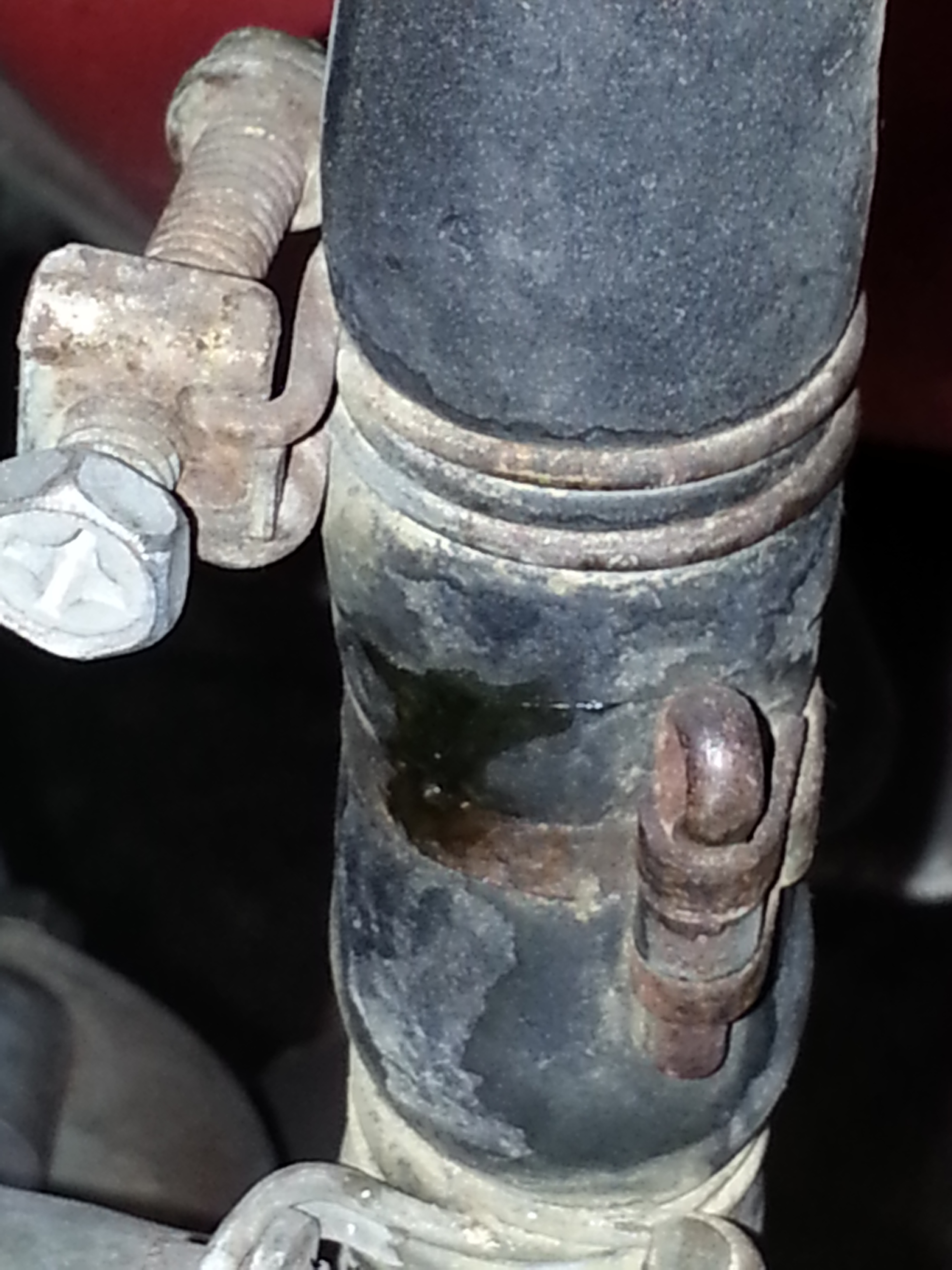

This is the return line from the power steering fluid cooler 2 the top of the gearbox, which I believe is a low pressure line... I'm just curious if I need to absolutely years power steering hose or if I can use some EFI fuel line.. Her I have plenty of that. I also have 200 psi power steering hose but its 5/8, much too big...

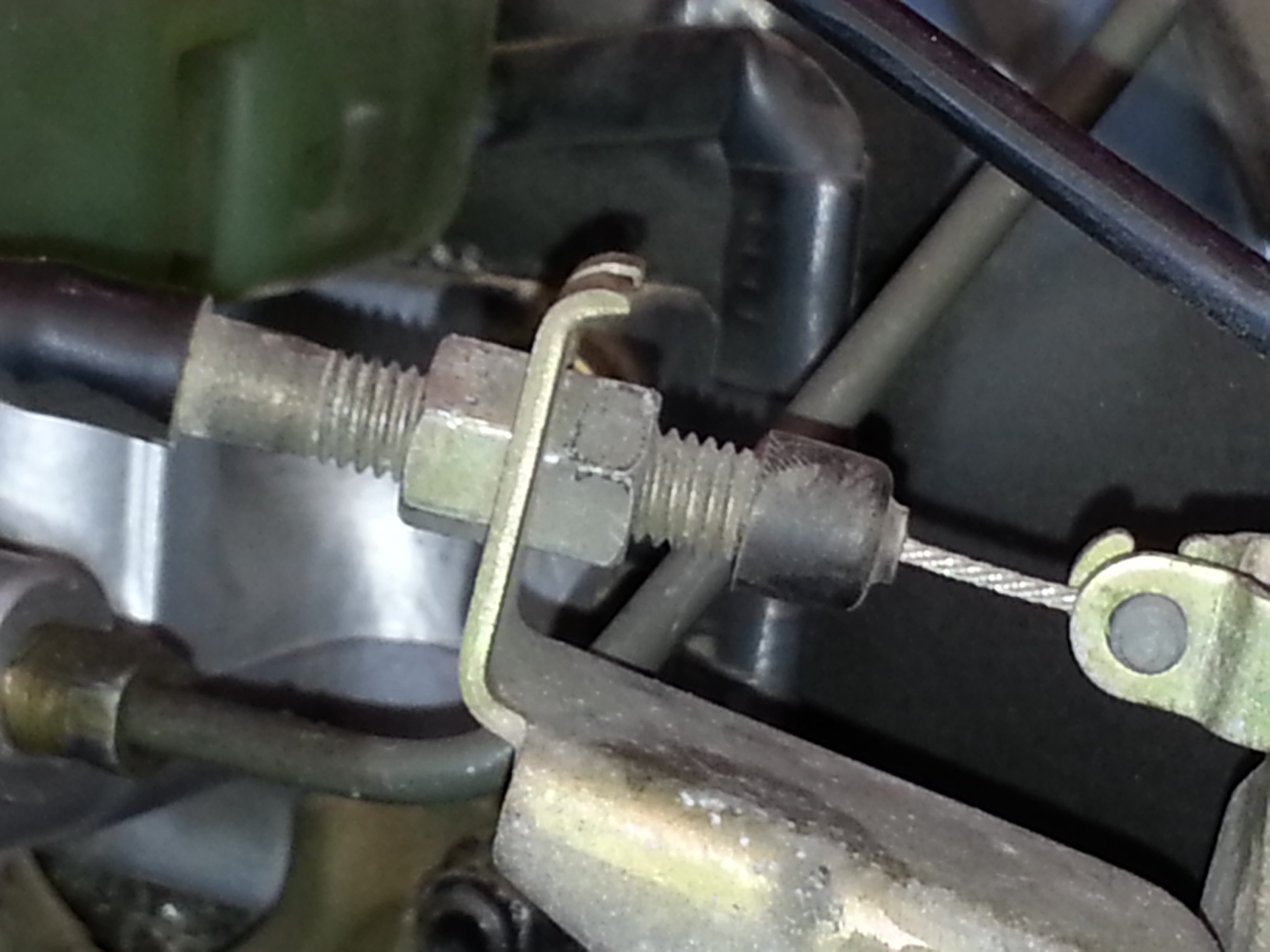

JonnyBoy saw how seemingly frozen these were. The Cruise Control Cable adjustment screw was set for too high and putting way too much of an angle on the cable... I got on it today and it just popped right free... Not sure why I can get it before, but anyway, I think this angle looks much better...

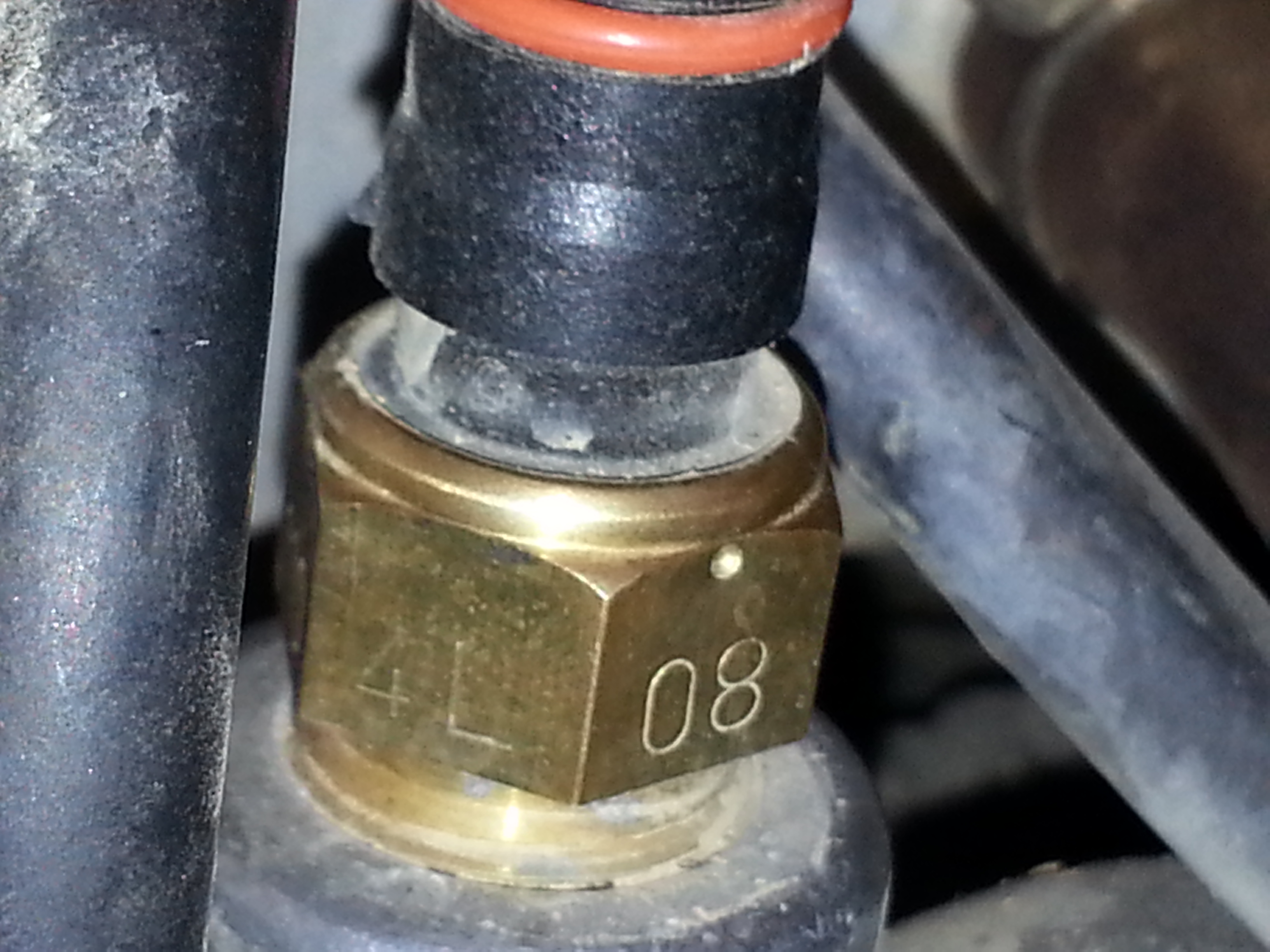

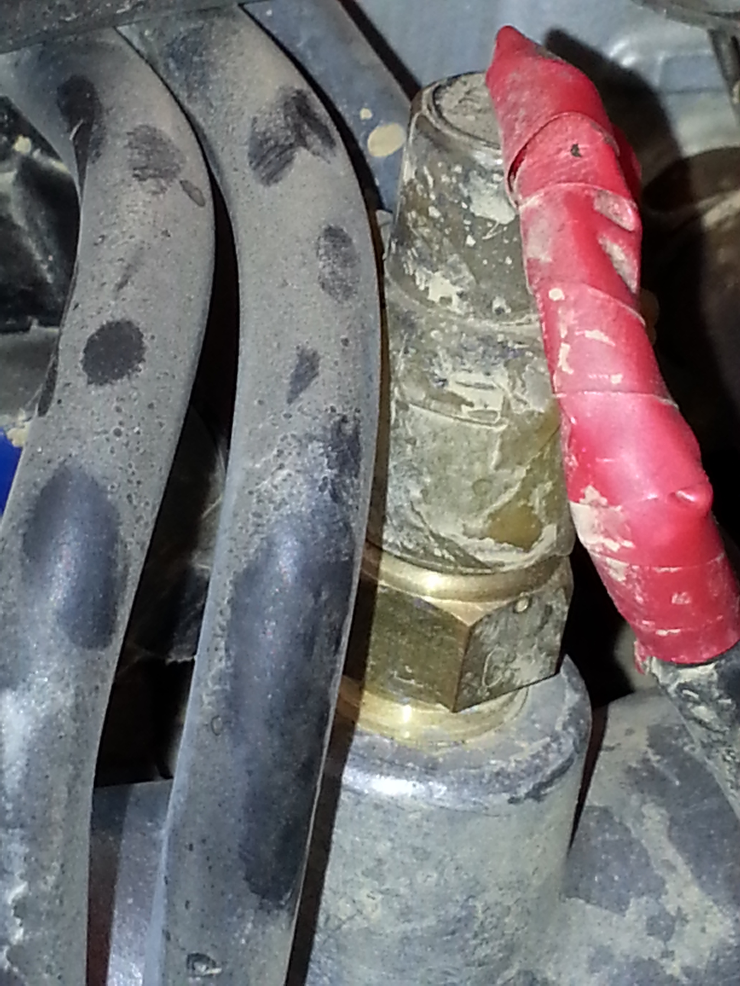

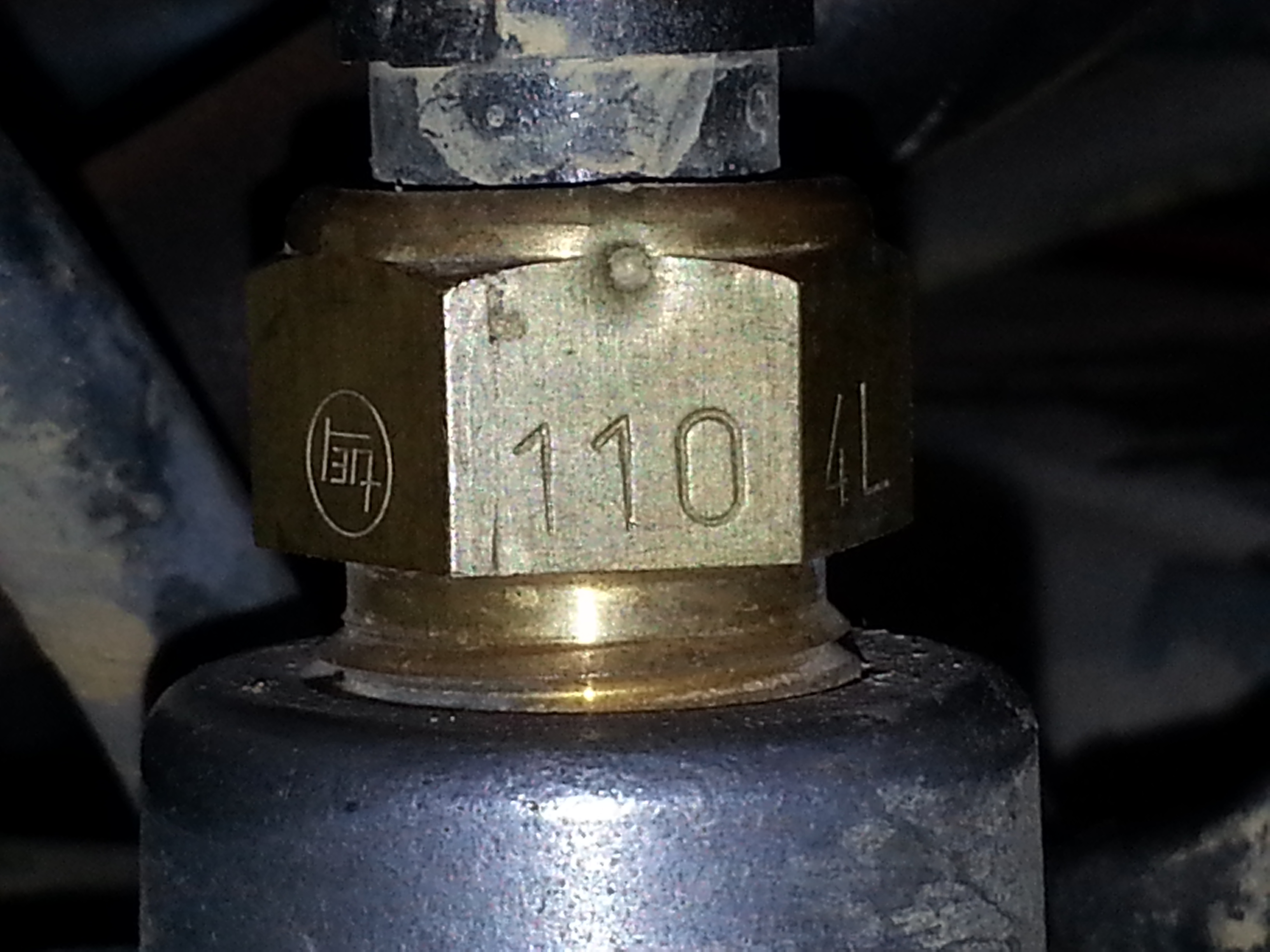

Before I get into the rest I wanted to post a close up picture of the thermal temp time switch. I can't seem to find the whole part number on it......(Maybe it's on the black part that's still dirty???)......

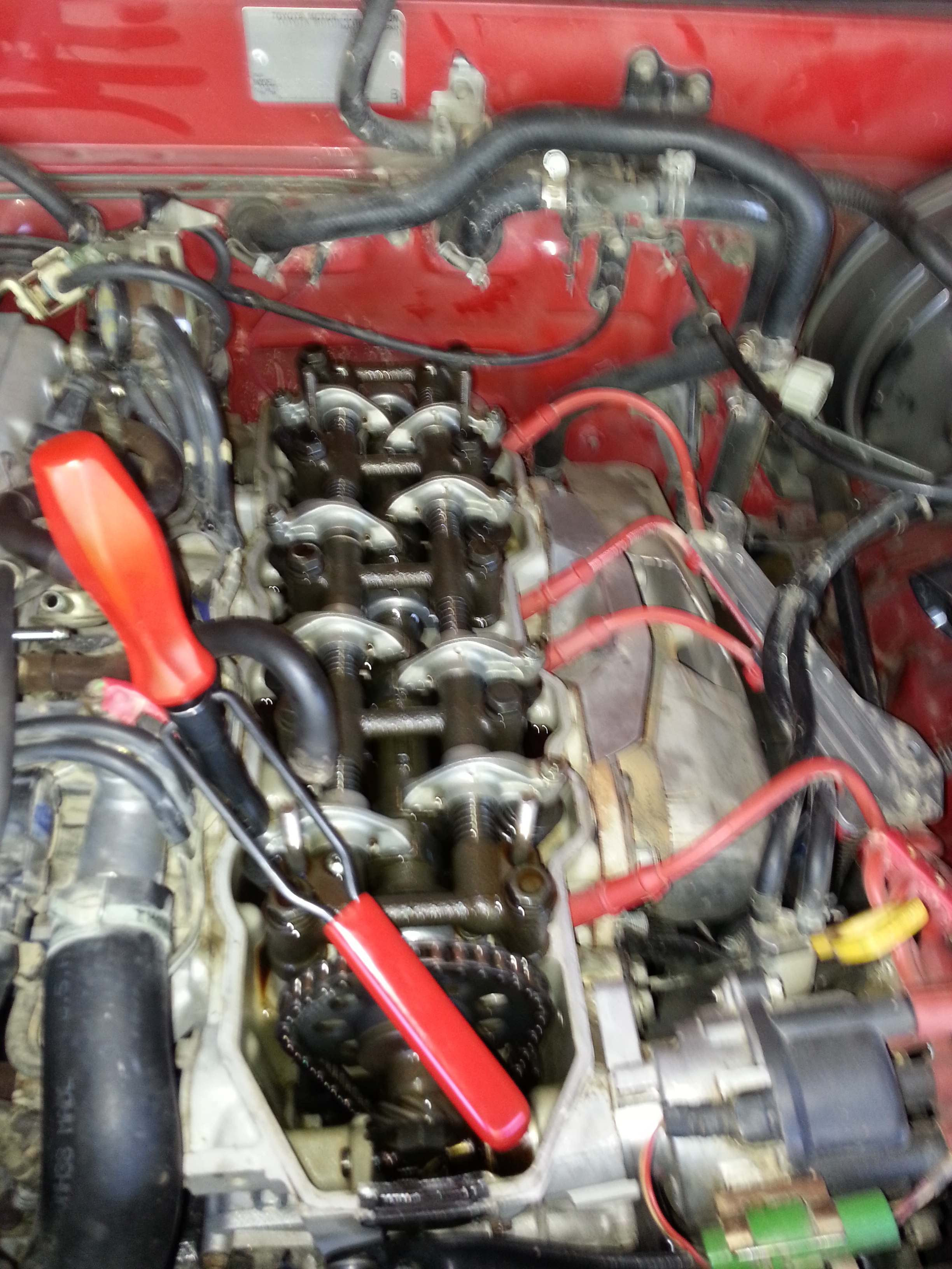

So, pulled the Valve cover, after fully warm, in 5 minutes.... a record for me! Lol... Set the valve lash at .007 & .009 & then waited til FULLY cool and rechecked using my .008 & .010 feelers.... Spot on!
Laid in the FELPRO valve cover gasket and mounted the valve cover after removing the old half moons & fully cleaning up the head with denatured alcohol...
Rolled it back in the garage and will start it up tomorrow... Sure hope it's sealed up for a bit! Lol....

Oh nice fix for your 4WD light. I assume you lost it during the SAS? Mine no longer works when I swapped to the older style axle tube.
You still have a stock power steering pump?
I've had problems with the connections leaking and causing air to get into the system with the same clamp you have on. It cavitated the pump making it scream. I ripped out some of the Toyota clamps from my parts truck. I wish I knew what they where called? The one with the a screw the pushes down on. Sorta like this one but the screw is vertical.
I'm definitely going to replace the low pressure power steering hose that was leaking... It's the only one that hasn't been replaced. the leaking hose that you saw in the above pictures is the heater core hose from the back portion of the straight pipe coming out of the timing cover on the driver side... That is where I have my T as well..... Just below the T is compromised. I would like to replace the upper portion as well but it has like 4 bends in it and I think on that I would just bite the bullet and grab it from Toyota. I believe I did find it at O'Reilly... So I'm sure other places have it as well. I just remember it being a price that wouldn't really save me much compared to Toyota. We will see. I would rather replace the whole thing then just that bottom section.

I'm supposed to have 2 switches. One in the ADD part and one somewhere else. With the ADD axle tube gone it isn't sending the signal to turn the light on. I'll have to be creative.
