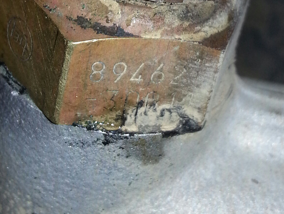

I'm just curious if anyone knows an answer to something..
I know I mentioned it before, but when I am experiencing this gremlin and i unplug the cold start injector and the thermo temp time switch number 2 connectors ,... Nothing changes at all. Does that mean anything? I should know the answer to this but for some reason I get the feeling that it could go either way if something unplugged causes the ECU to decide to just stick with a preset adjustment.

The only receipt I could find that I think might be temp switch #2.....(stat housing sensor)
89428-28030 ....

Ok, found this as well (MR2 forum... But also found others in 83 87 Toyota truck section and so forth)....
"Ok -- so I swapped out the water temperature sensor and the opposite side switchpart numbers 89422-12010 & 89428-28030 . This has taken care of the problem.˟Overall - had to buy/use a deep socket 19mm & 17mm to take them off (darn 3 trips to Ace hardware to get the right ones). I removed the battery & air pipe, socketed the part off - unscrewed by hand and reclaimed the washer - put liquid gasket on the new piece - screwed it back in. I was surprised to only lose like 6 tbsp of coolant as well as maybe 2 tbsp from the other side.Hooked it all back up, turned it over and all good. Did the check engine code with a paper clip and it's flashing once now (ALL GOOD).˟"
http://www.mr2.com/forums/attachment...emp-sensor.jpg

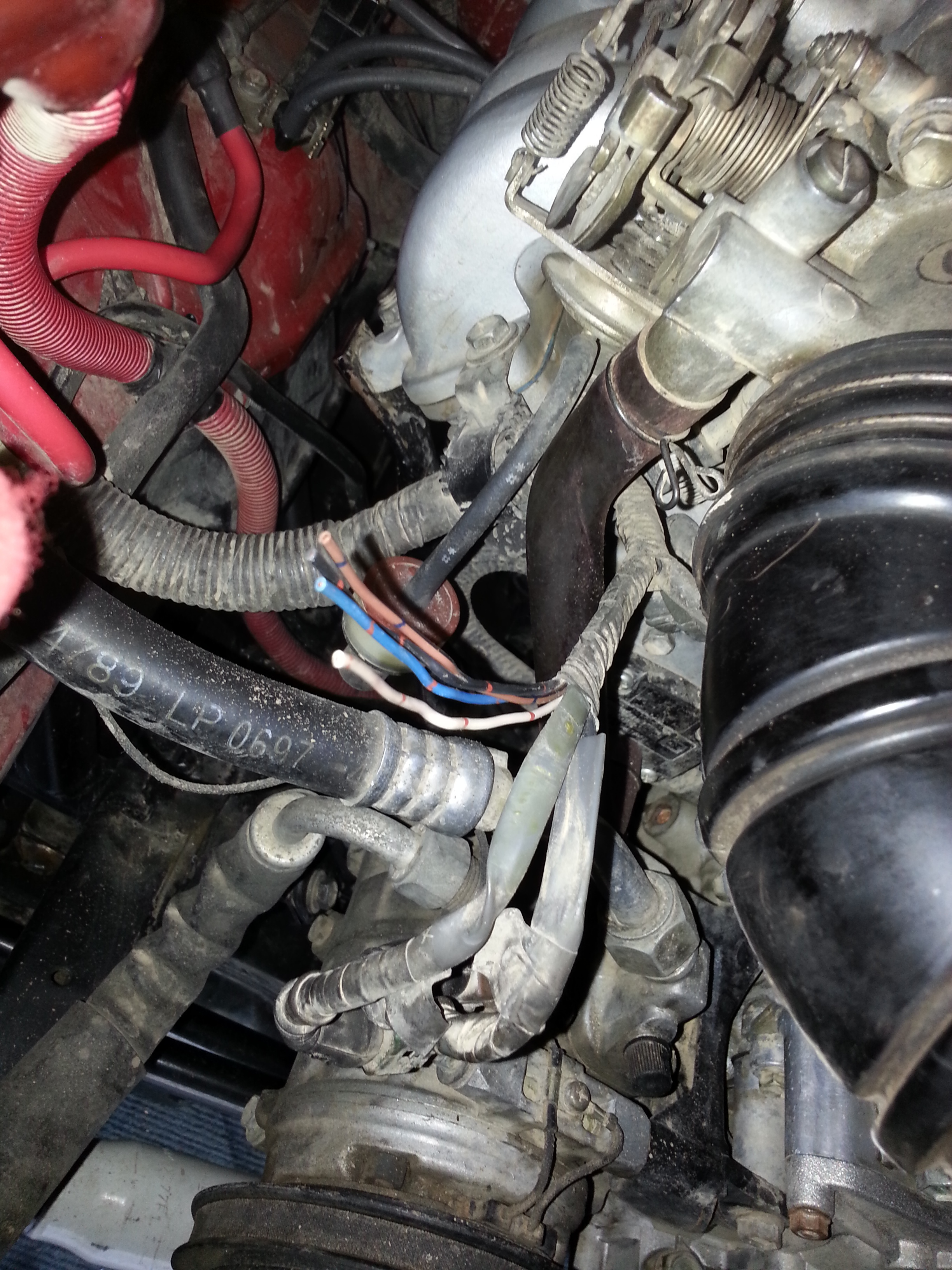

I cannot find a part number on my thermo temp time switch but I'm fairly certain that this one was the replacement that I got that cost around 20 bucks at the dealer with a discount... The one on the thermostat housing. I seem to have the receipt for it, & I don't seem to be able to find another receipt that shows I returned it. For some reason I felt like I have returned it... I can't remember what exactly it wasn't I return so I'm kinda screwed on that because my buddie's retired.
While I am taking a few moments here and there to try and find this burger, I am also getting other stuff done... Quick fix and its in there cleanly and tightly and reconnected... I'm good to go.
I also have another VSV that I would like to try and see if it fixes my AC Idol up problem. The only thing that I can think of is the VSV is just not holding up after the truck warms up. It works when its cold... But will not cut it after its warmed up for about 10-15 minutes.
I also have another throttle body, but this one is extremely clean inside and all the ports seem to be operating properly. Not to mention at one point I did have my air idle screw almost all the way in and it was running perfectly.
As my kids use to say... Whateverrrrrrrrrrrrr! Lol

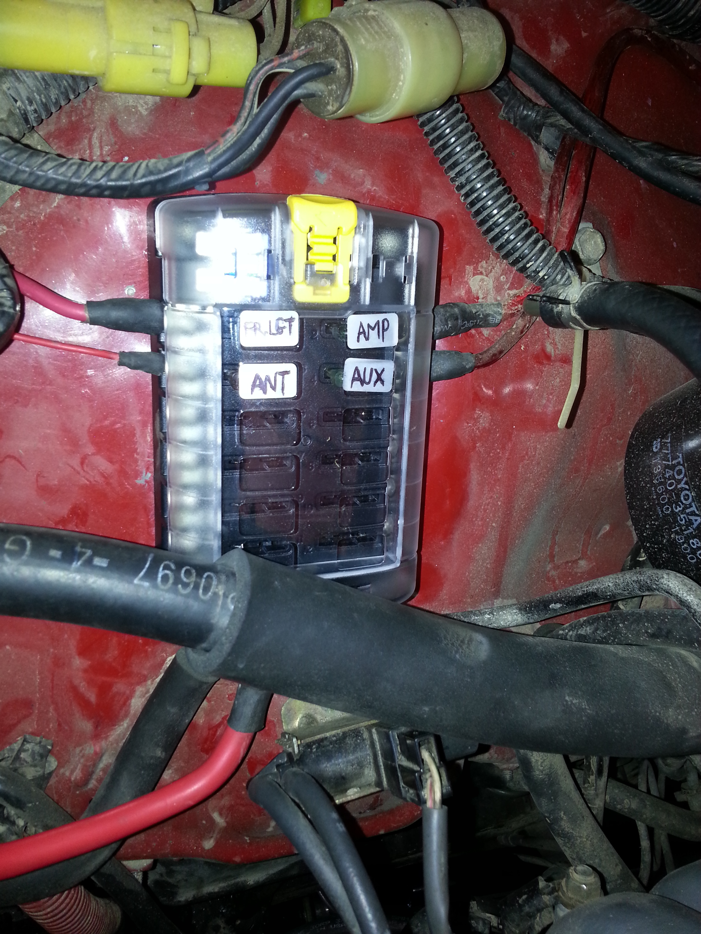

Soooooooo,.... I thought I would torture muself with some electrical escapades today! Haha....
As mentioned, installed the Blue Sea Systems Auxilliary Fuse Block.......

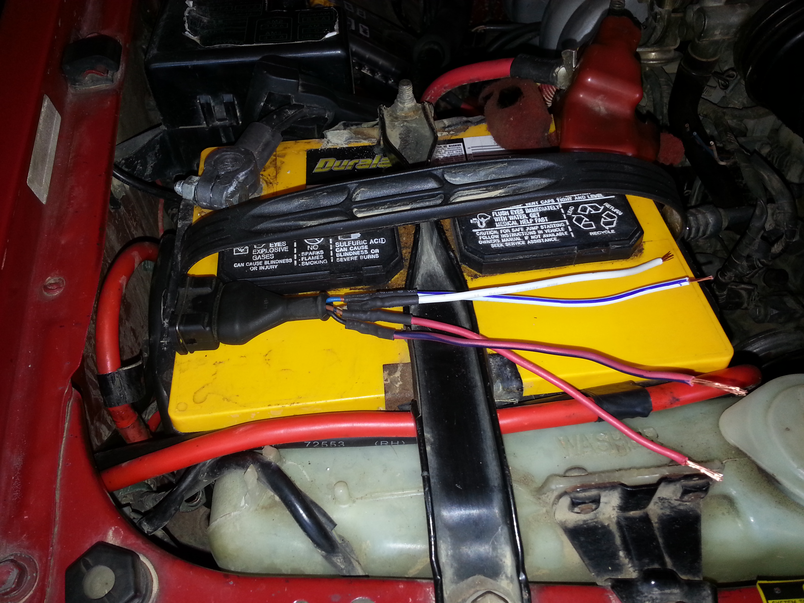

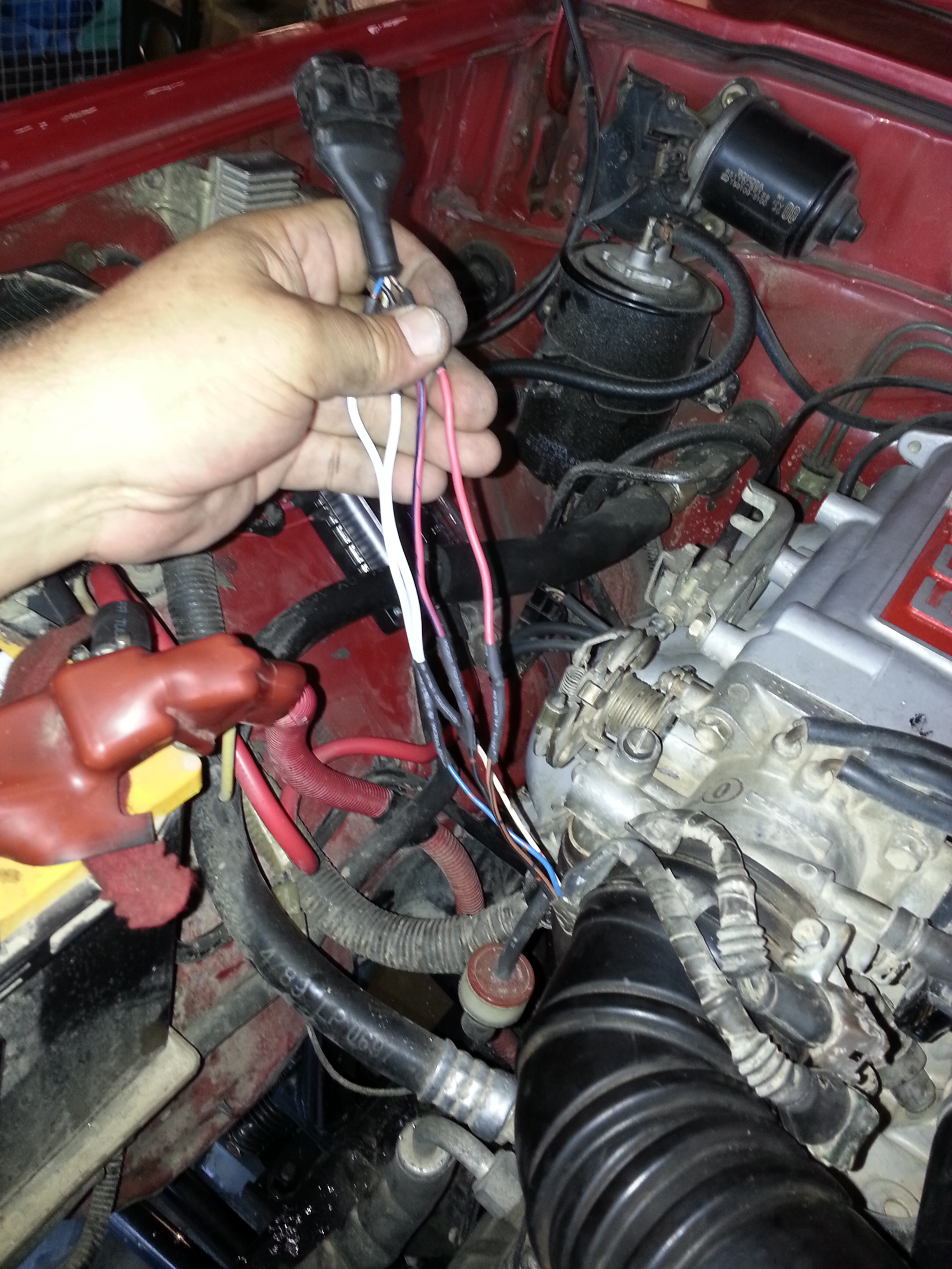

Then I dug up the TPS connector I got from Terry (THANK YOU, BIG TIME, BUDDY!....I MEAN IT, Terry, you always come through when you can....and I'm grateful for ya.....And grateful for a lot more than parts!)
I spent quite a bit carefully heat stripping the wires on the connector as there was at most an inch! :eek: lol.... Freaked me out! Haha......
Soldered 4 extension wires in to the connector-side shorties......
Had to unwrap the harness a bit and again, carefully heat strip the 4 of em.....
Soldered the 2 together and I HAD A NICE, CLEAN set up with a lil more length and a new connector with retainer clip....Wooot! hehe...
I gotta tell ya..... that was a total BIOTCH! Lol....I'm happy it's done!.....and I'm happy it's done! Hahaha.....
