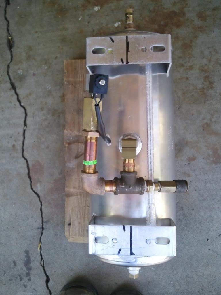

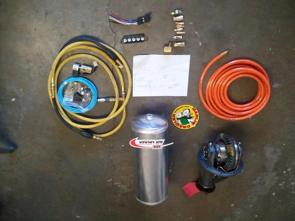

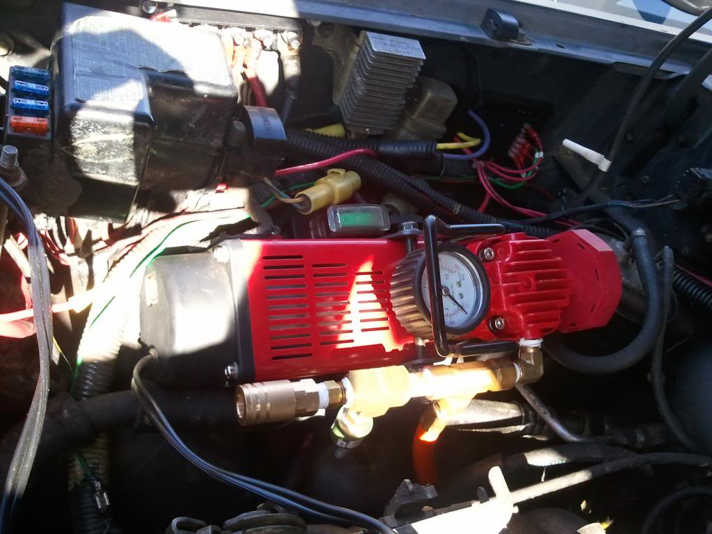

Yeah, I probably should have just started a thread regarding the onboard air... But I guess it's probably best to just leave one thread . I'm sure many people understandably got tired of trying to keep up with this thread and all the crises and so forth.... But I still have a few buddies to hang out here once in awhile and I hoped that someone would just tell me straight out and in quotes, do not, absolutely do not buy that piece of crap... Buy that one and then do this! Lol. There are tons of friends on pirate and other sites, and I'm sure there are a couple hear that I just haven't found... They will give me a really clear picture of the best way to do this. I got under the rig with Jason of Tennessee and really looked it over and I think she is right that above the drive line and closer to the fuel tank, a 2.5 or even larger tank could go right there... I just don't know about the elbows and things like that. I'm not a compressor expert and I noticed that most guys mount the tanks in the back... That will absolutely not work for me as I sleep in the truck 90 percent of the time. Its way warmer and way more comfortable... And now I have the Napier tent truck back tent... I'm trying to figure out a way to make that work,... Yes, another problem, because my new bumper kinda complicates things as far as fitment. But I will try my best to figure it out.... I think as long as I keep a tank down there very clean and have a good filter or dryer... I should be fine. I actually have several tanks but they are mostly propane or freon. ....... Just a little to stubby/tall.
My other things to work out is if I separate the tank that comes with the kit for the 480C. I'm sure I can, but obviously I would have to come up with some type of longer hoses and so forth to run it separately.
.... Thanks. .... And it's hard to tell, but it's really dark gunmetal w/dimples, lol(hammered black)... I thought it would be better to go with the same color that the bumper is... Not that it will make it fill out completely but I think it worked pretty well.

1. Buy parts.
2.Preplumb cheap compressor. Mount it under the hood, They work great but have less than a 100% duty cycle. Air tools are over rated on the trail, and they will get the tires mostly filled.
3.Preplumb the tank. Mount it somewhere like on the roll bar.Save money with a tank from a big rig's air brakes.
4.Connect the compressor to the tank using a quality 50' hose routed along the frame rail.

1. Buy parts.

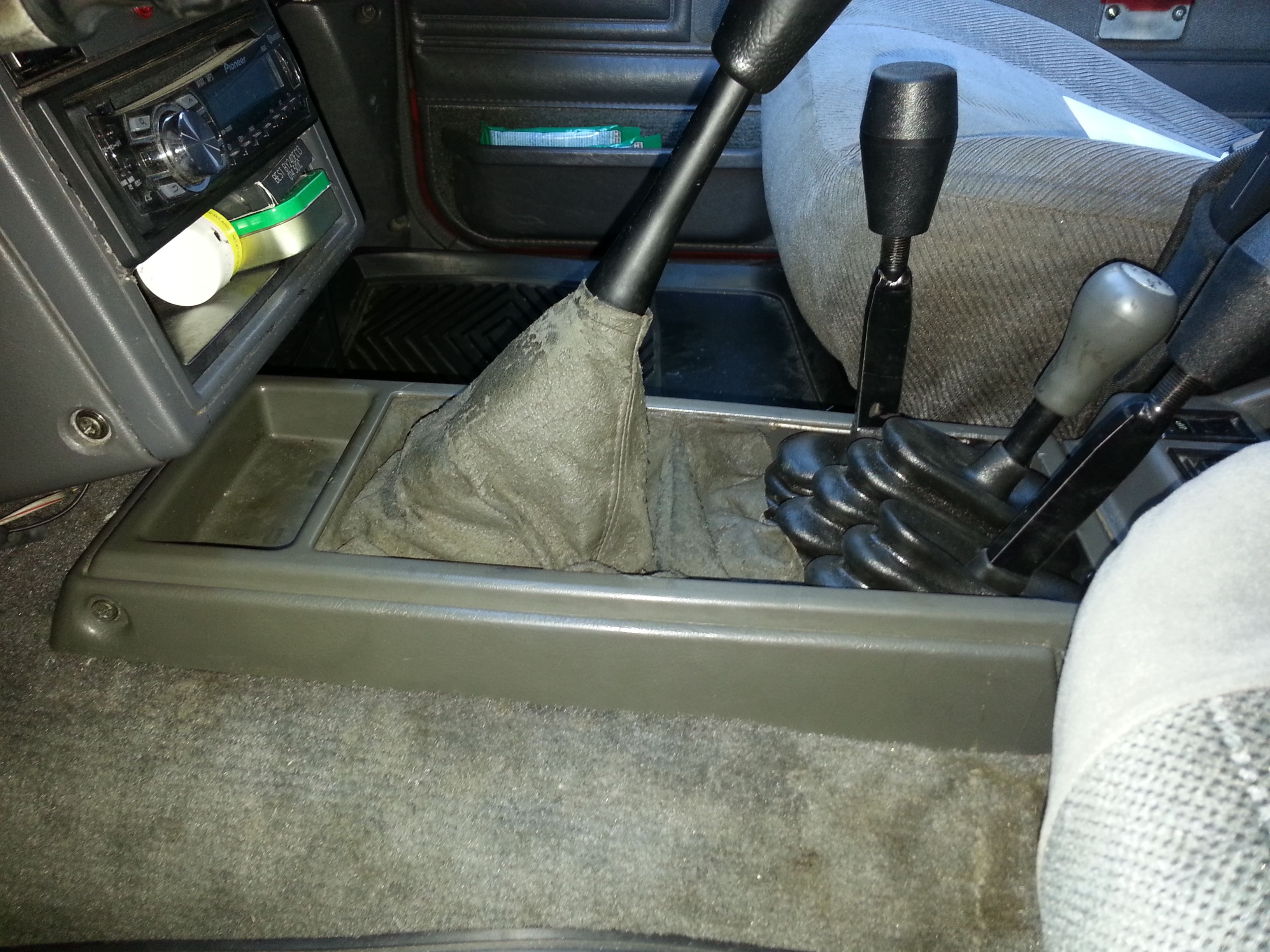

I FINALLY. Set up/finished the shifter bezel install.... I didn't do such a great job, but it came out pretty well....
Before I get to pics of that, I have a video of how I fixed my loose console. The mounting bracket that gets mounted at the rear-mid section, to the floor, had busted both tack weld loose. That's why it was flopping around, because the bolts were tight. ... but they were tightened to a PIECE THAT WASN'T FIXED TO ANYTHING, HAHA. ... The carpet was all that was holding the bracket in place, lol........
It's saying unsupported video format, like the lay few things have. . What I can see the tag it shows and even lets me a copy a URL... I'm going to post up the video link could you please tell me if its working? I'm not sure if its something wrong with my phone or the app or what! It's really starting to tick me off...
Here it is, finished..... WHAT A ROYAL PITA! But I'm actually very pleased how tightly and securely it is in there, especially since redoing the mountain of both mounting brackets for the front and rear on the console. But I actually feels better that it ever has in years....
And then have to run down to the store and while I was a little ticked off that I couldn't take my off road trip for the day, locally, I did manage to pull up across from a construction site I had a pretty decent angle of incline and about a couple feet up ... So I stopped and took a couple pictures and was trying anyway to push the front springs a little bit...
what you think?...
what you think?...
