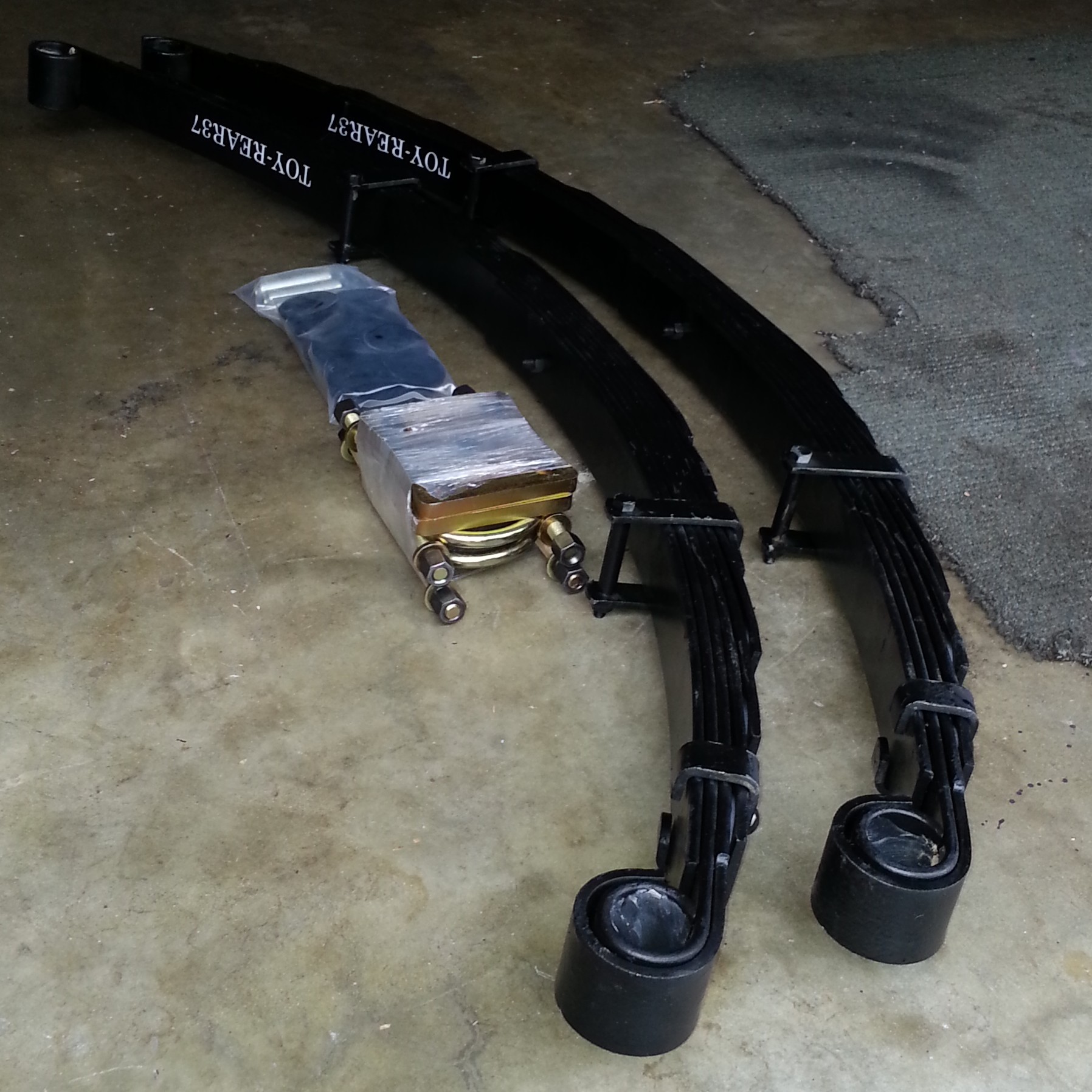

The day before this, I decided to head out to all pro and pick up a set of 6 inch lift Springs for the rear and a new flip kit for the front( I think Johnny boy is going to need the plates for his SAS.... And the bolts we're already resting so bad on the front, I needed to at least replace those...)....

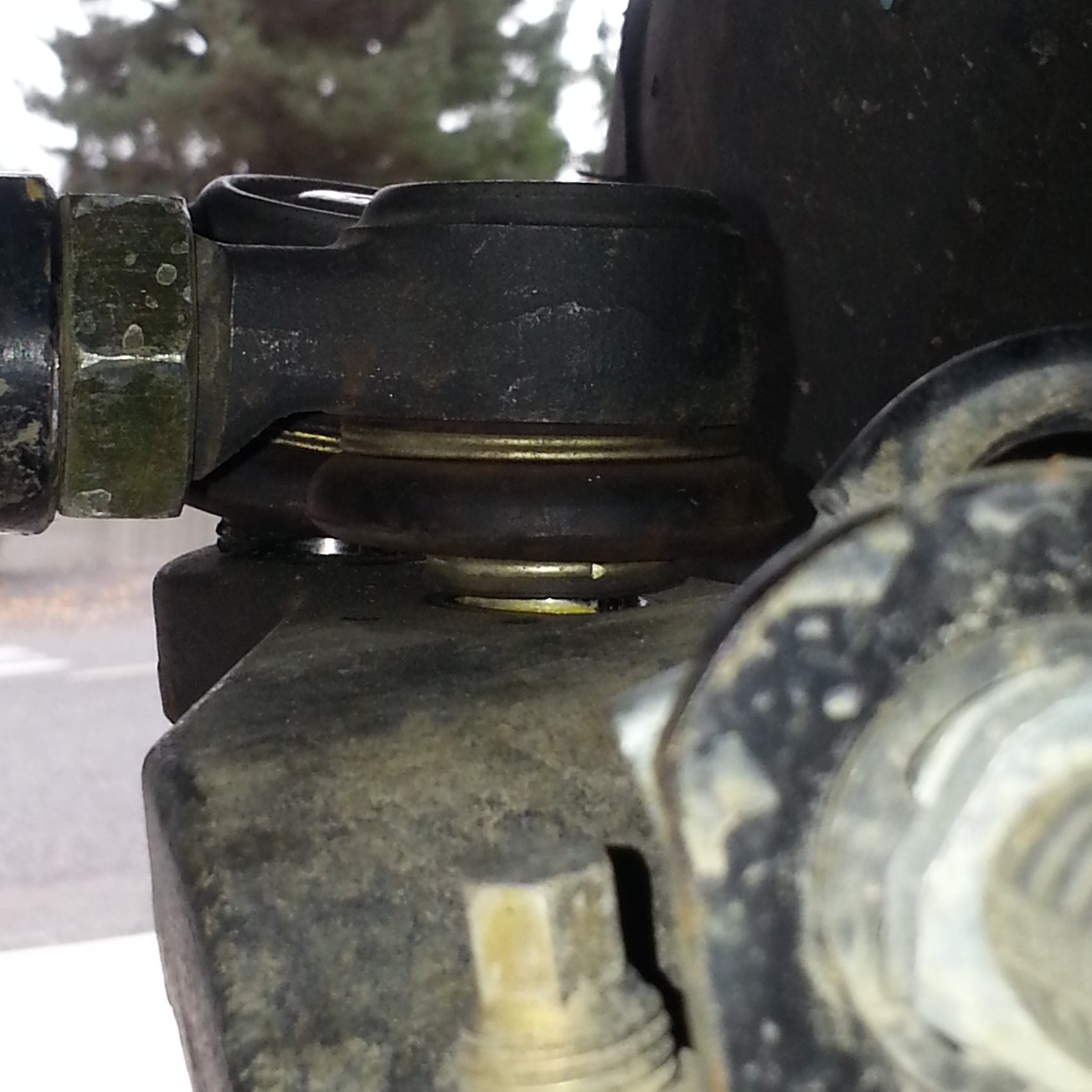

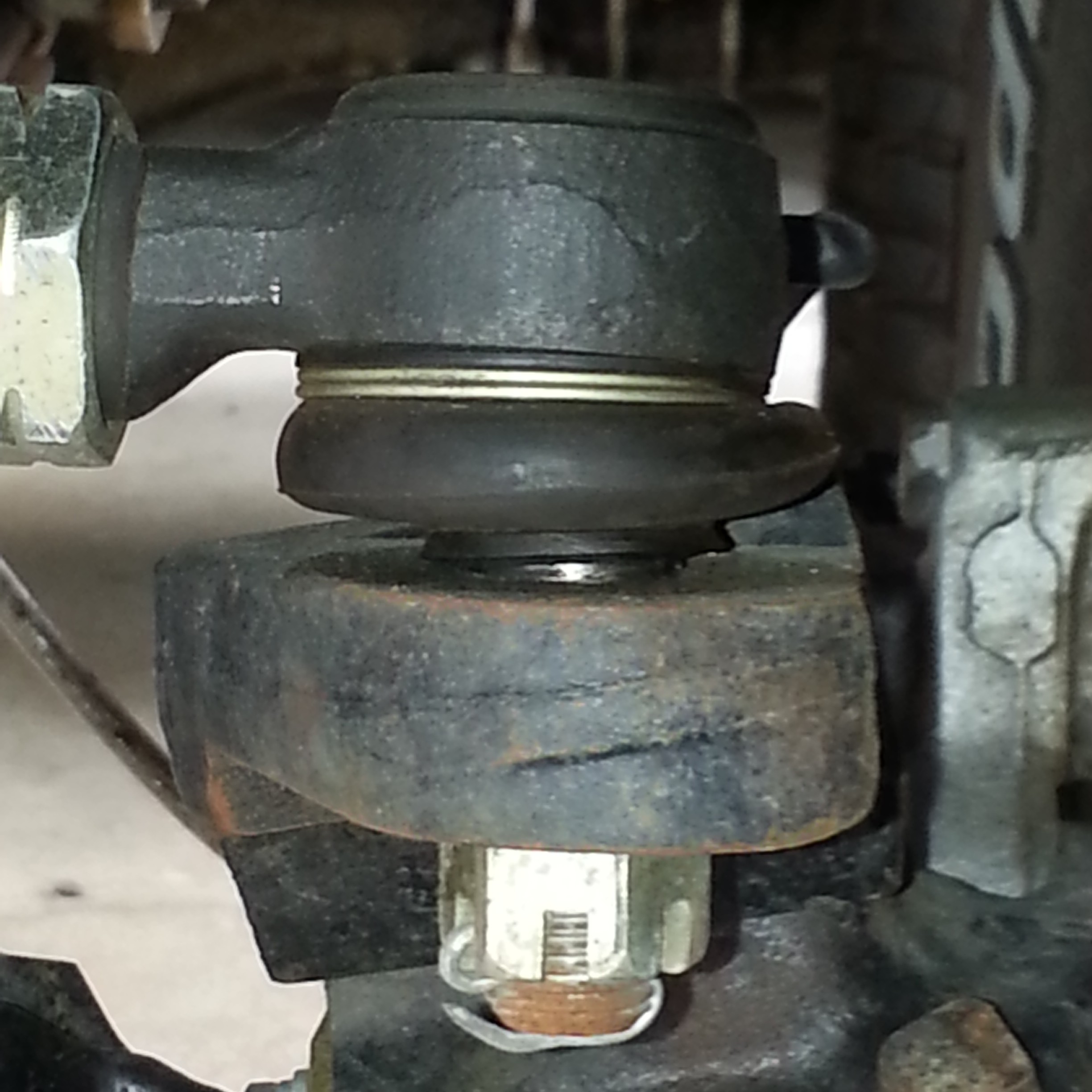

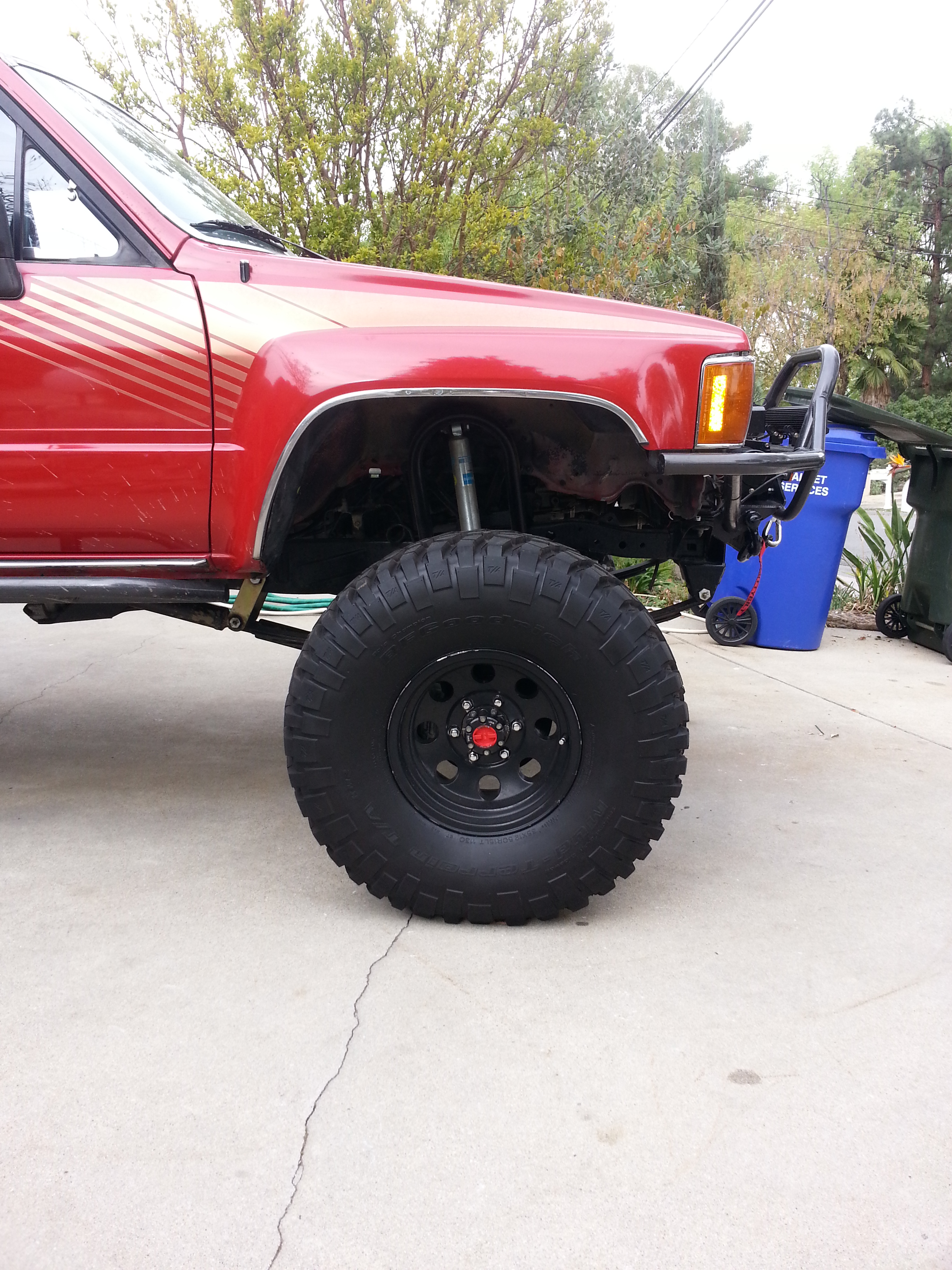

As many of you know, I have been investigating why my hysteer rod is having to be adjusted all the way in to the last threads of the tie rod ends.... I can't be sure, but I'm starting to think that at least the driver side tie rod end is fubar...
I can be sure yet on the passenger side, but I will be pulling them most likely monday or tuesday when my new ones along with a custom length: steer Rod , from All Pro arrive.......
I've also begun to suspect that I might have possibly Sheard the driver side centerpin... I can't be sure, but I swear by my eye that the driver side wheel is further forward...
I need to do some more detailed investigating into that... But I will at least check the center pins so early when I do the flip kit swap. I'm thinking of doing something Johnny boy suggested, using a large Head Island bolt and place of the Polished centerpin cog.... We will see and I will update. I have another pretty cool update coming in the near future.... Not quite ready to bring that one up yet.

Chef,
If the tie rod end is busted it will have play. Jack that wheel off the ground and give the wheel a good shake left and right. You should see play. It is possible the centering pin has move or sheared. But the tie rod is mounted to the axle and doesn't care if the leafs are present or in the correct spot. You are running 35"s on stock trunnions?id check torque on your trunnions which you should be checking after before each wheeling trip. Also check the u lot torque. It's often recommended to restorable after a few hundred miles. Also, don't measure from the body to see if the axle is placed properly, measure from a factory frame hole for accuracy, the body isn't necessarily square on the frame. I'm not sure if I understood correctly, but you should be adjusting the entire tierod not just the end, so that the tierods adjust equally since that is part of your alignment.
Hope that helps.
I'm guessing this all started after your wheeling trips.
Hope that helps.

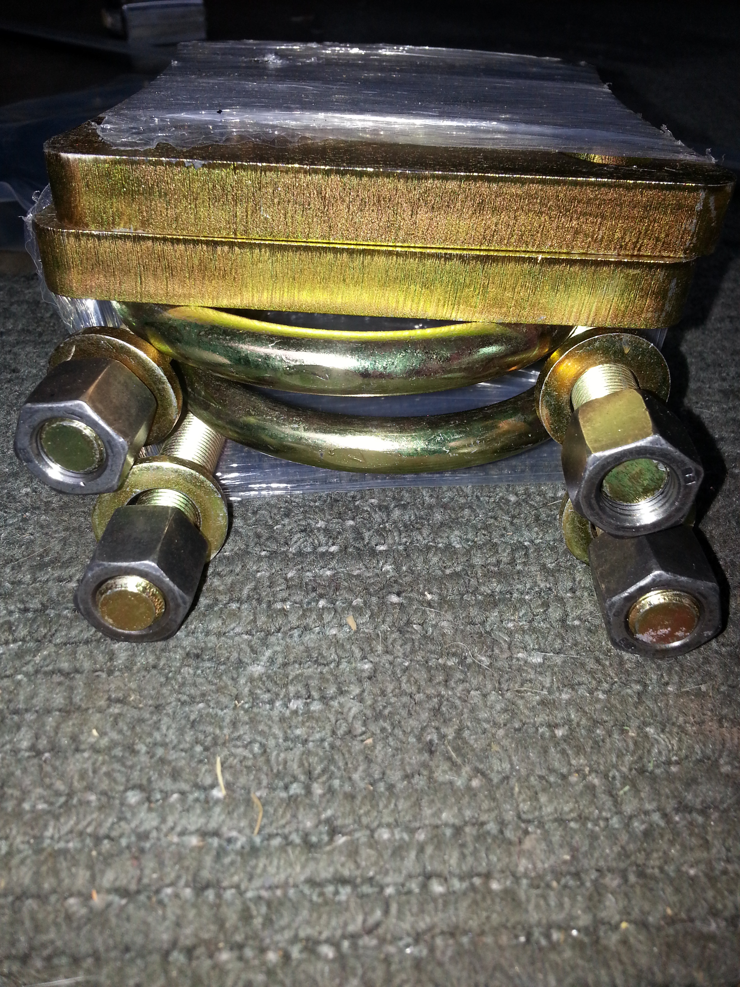

I'm a bit out of it RBX, so forgive me if I've missed this... But did you see my post regarding testing of axles within the tubes, looking for obvious signs of the tube being bent? ...... And, I will be swapping flip kits up front, so that will be a good time to check the leafs' centerpin for compromise.... I will definitely keep you up to date on that and everyone else as well.
I did not check the Trunion bearings.... I will. I was going to do the trunion bearing eliminator, but I was ready to go and read conflicting things...?
PS: I have, more than once, checked the u-bolt torque rating... They haven't budged
