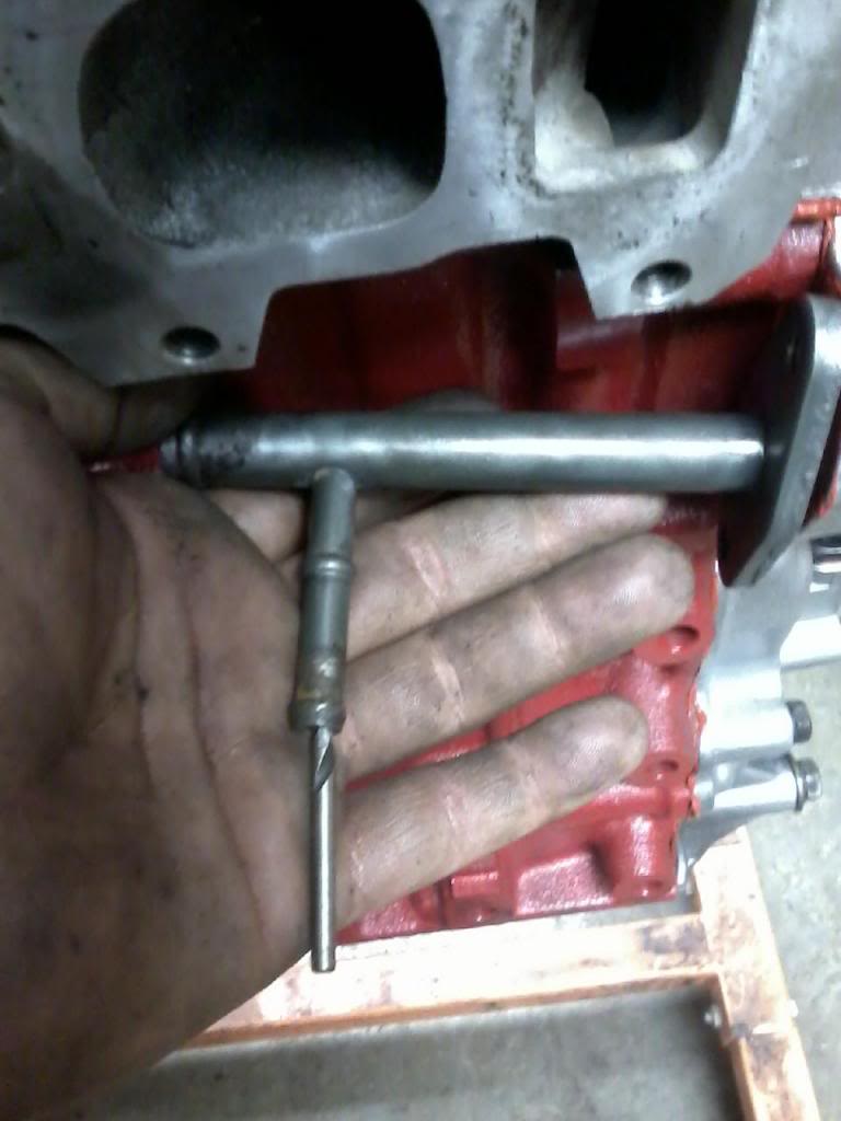

I was reading somewhere about a guy having idle issues and his was in the Throttle Body or water line to the Throttle Body. The motor I am building has a plugged line that I havent run into in the past and could be easily over looked. Maybe this is your idle problem???
Clogged water pipe. I used a drill bit to clean it out.

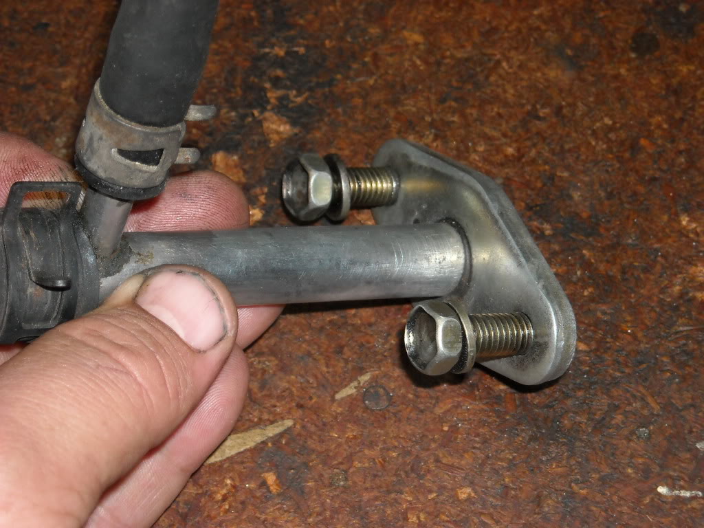

Thanx, Terry. I'm pretty sure mine is flowing well. Remember when upon my first rebuild I had that wrap around pipe that goes up into the center of the intake leaking before I could even start it the first time for breaking in? When I replaced that wrap around type I also replaced the one on the back of the timing cover on the passenger side. I could have sworn that my timing cover pipe like that had 2 smaller parts coming out of the side... But I can't be sure without looking back at my pictures. I'm probably just thinking of something else. Maybe the idle air control valve. I know that that pipe feeds the idle air control valve but I thought there was another one. ......
Here it is, you're right, one offset pipe. This one in the pic was replaced due to rot on the end/big pipe hose clamp area......
I doubt it but will definitely consider that it's possible and add it to the list.... Also adding Dragons reminder of the throttle body micro vacuum ports.... Then also will check the throttle plate and shaft....
