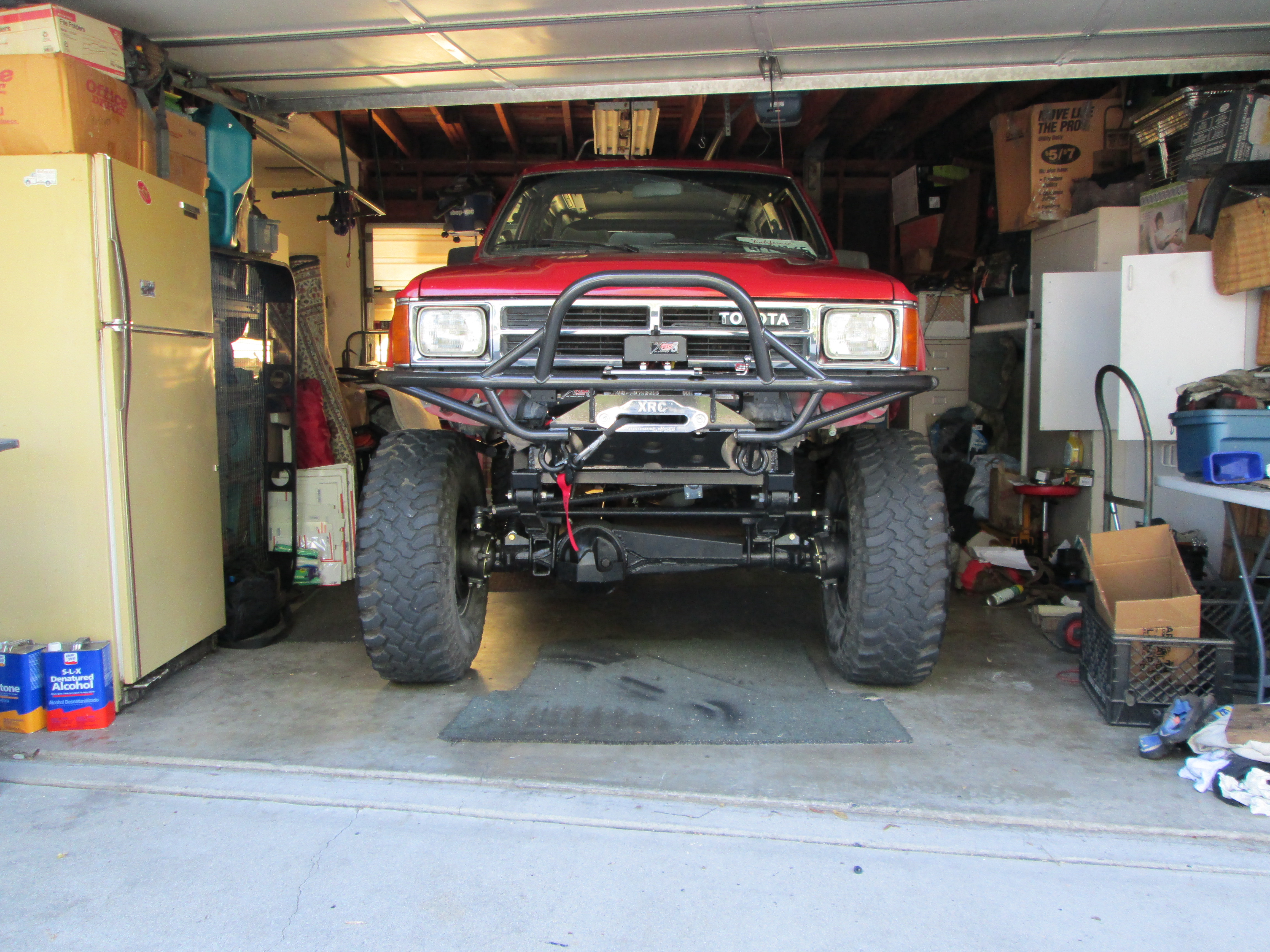

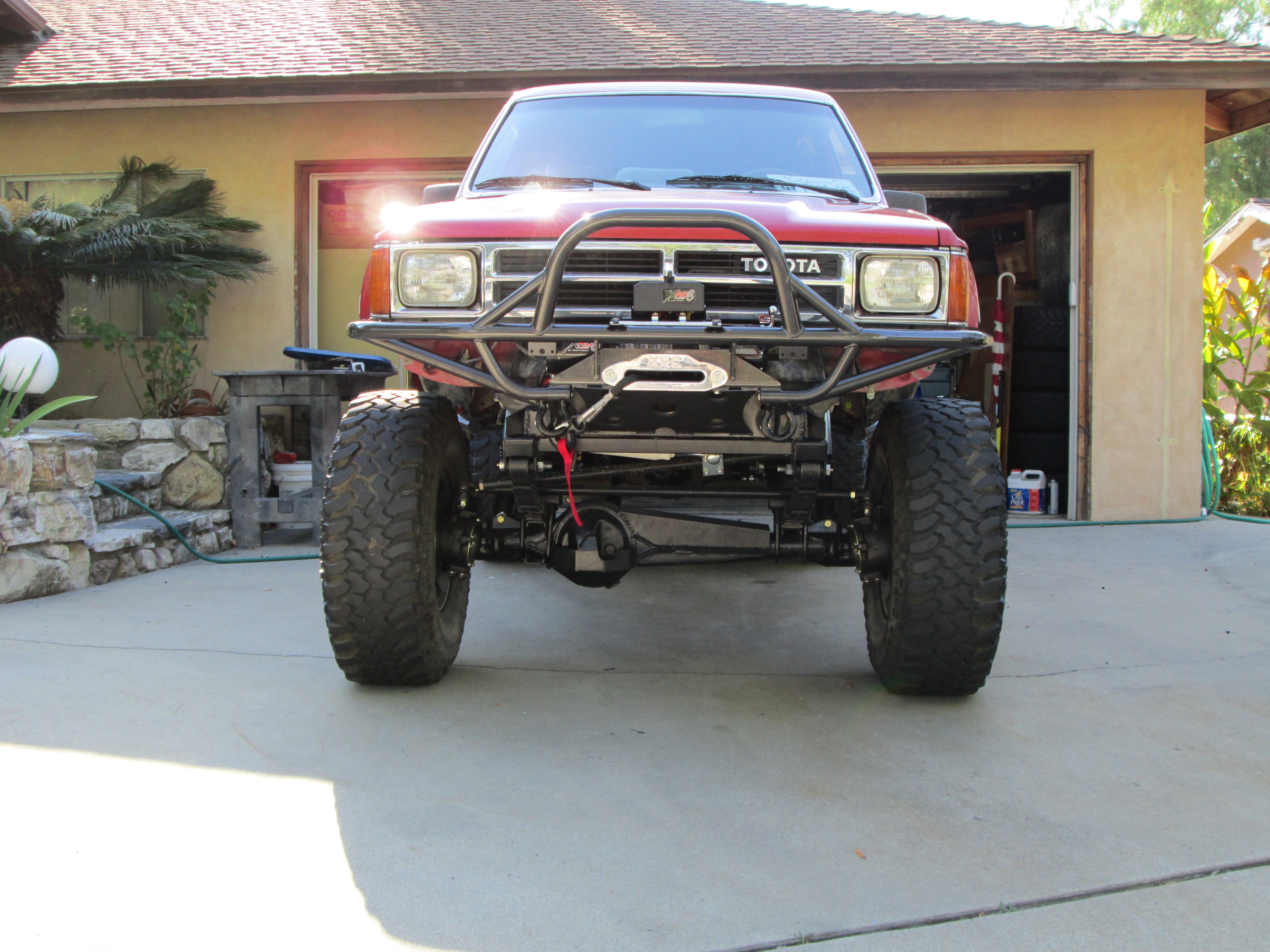

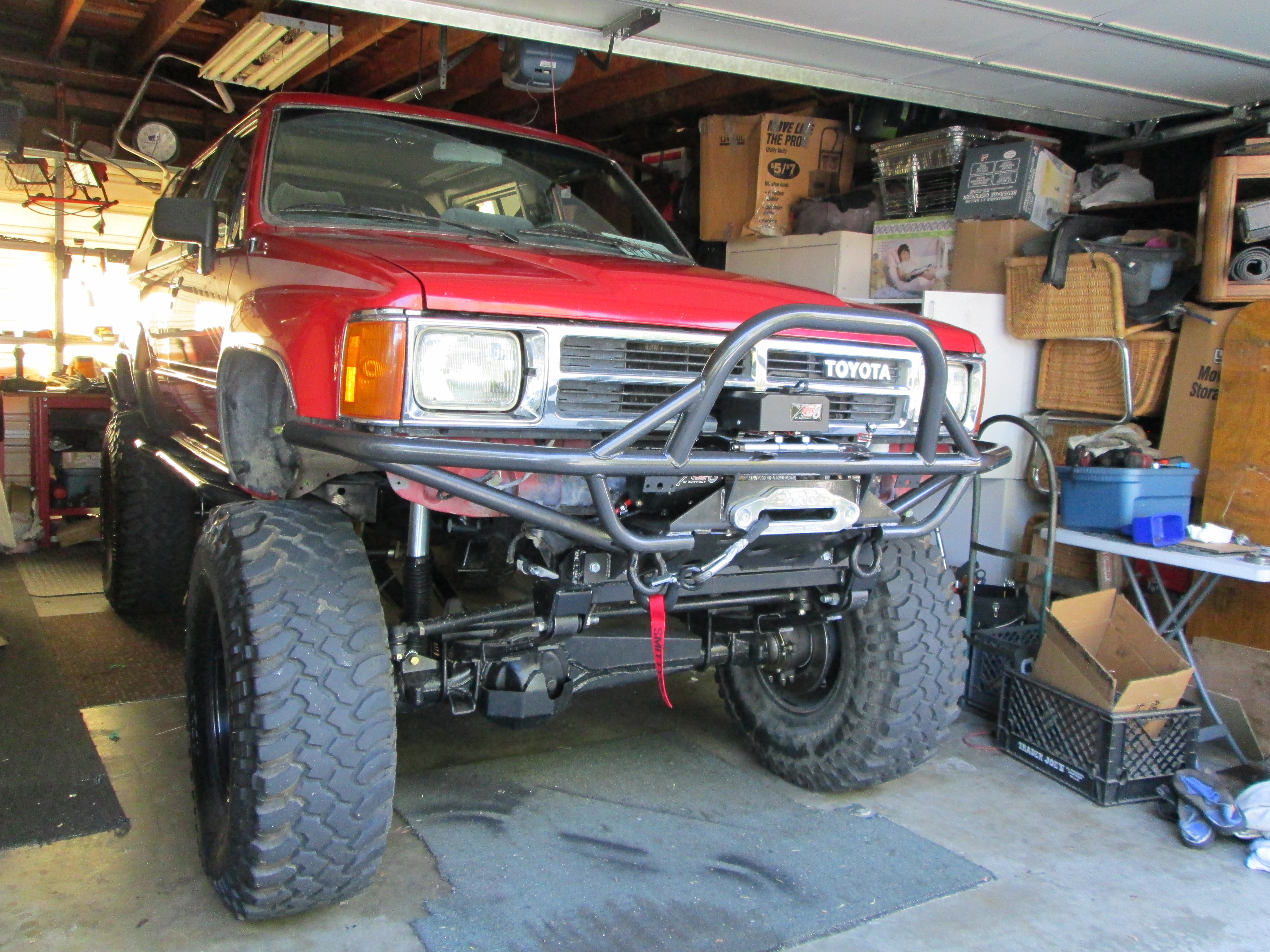

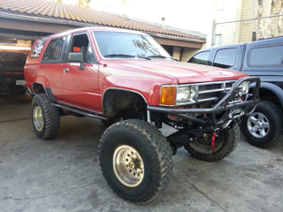

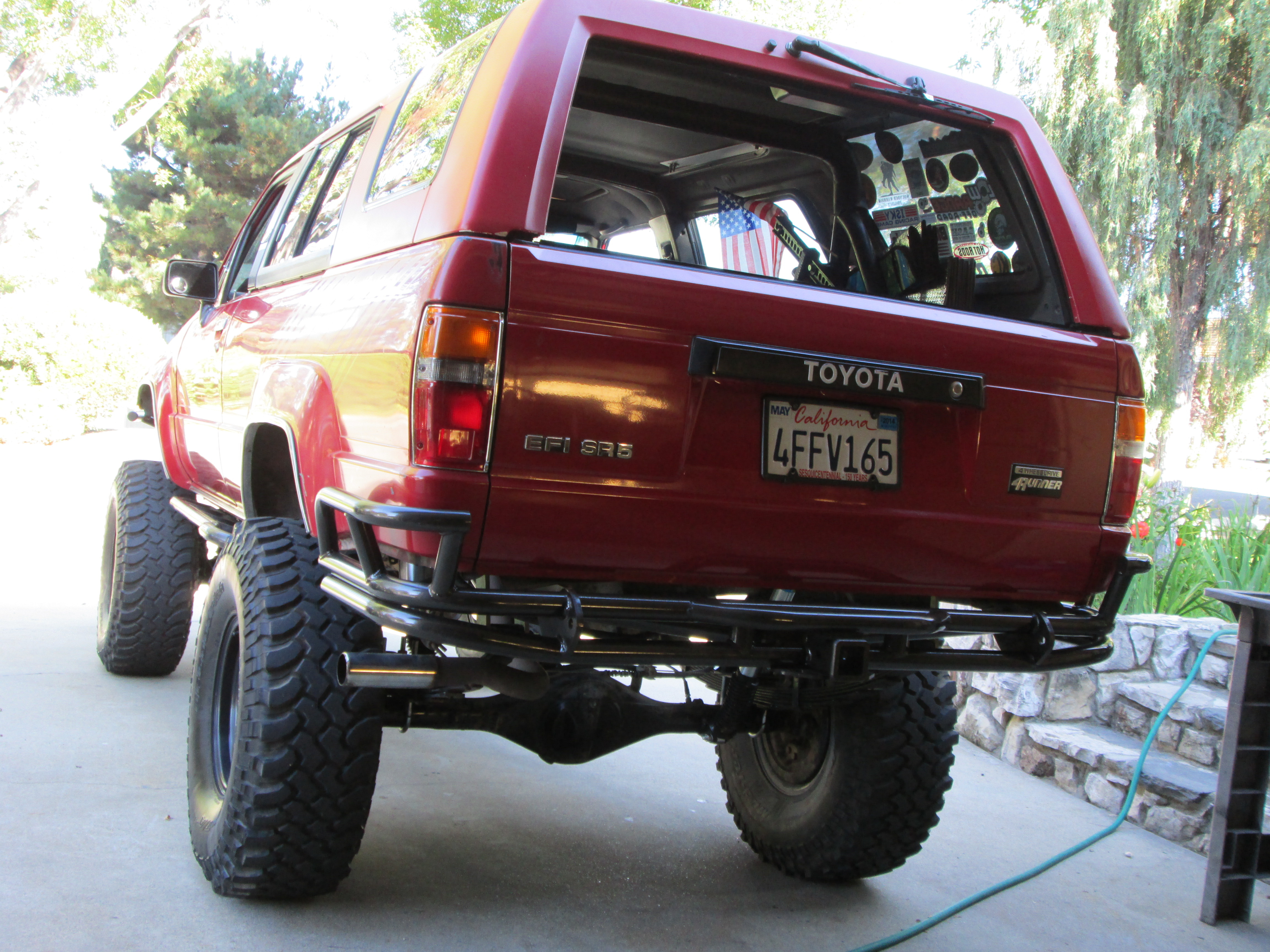

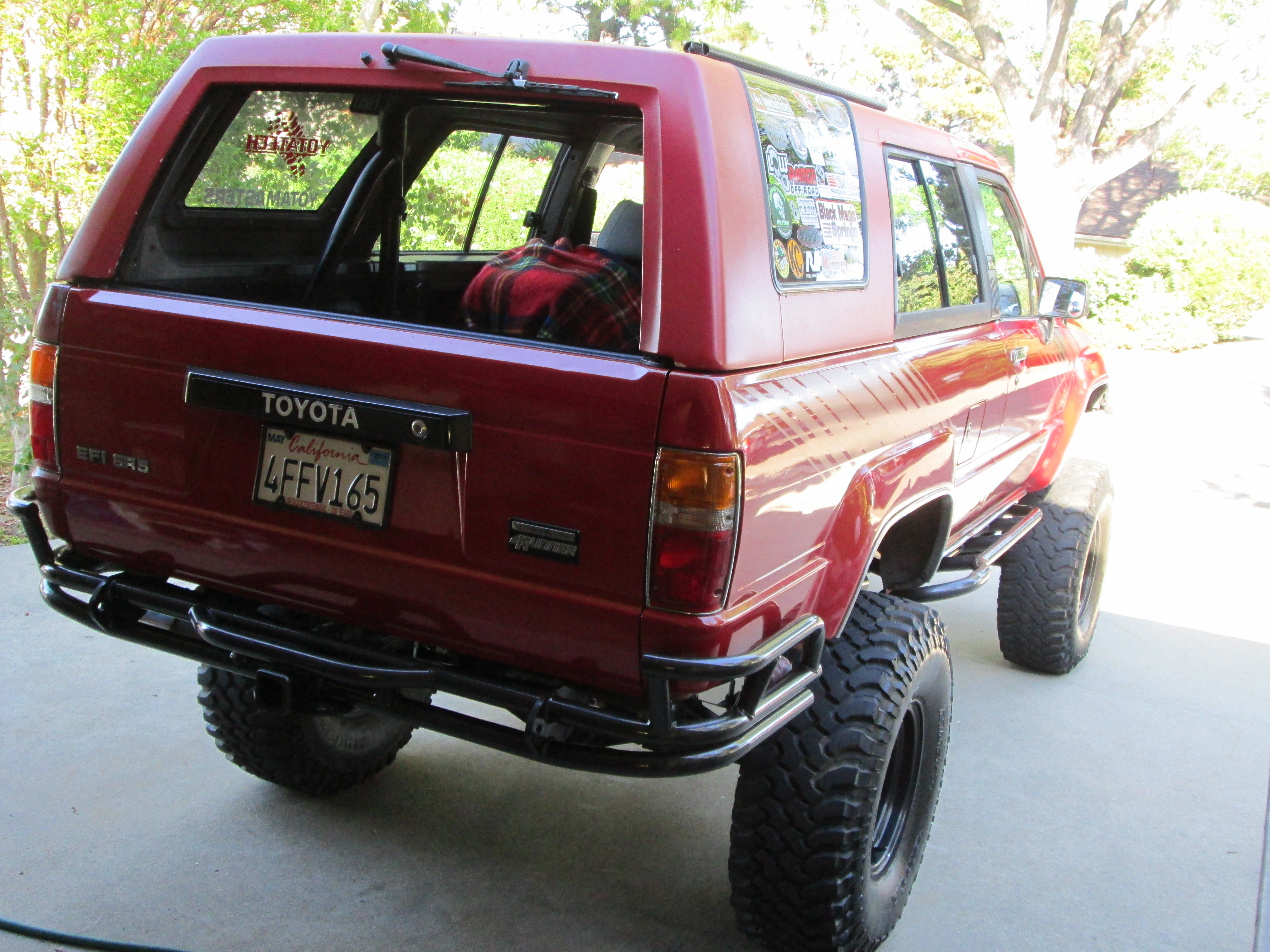

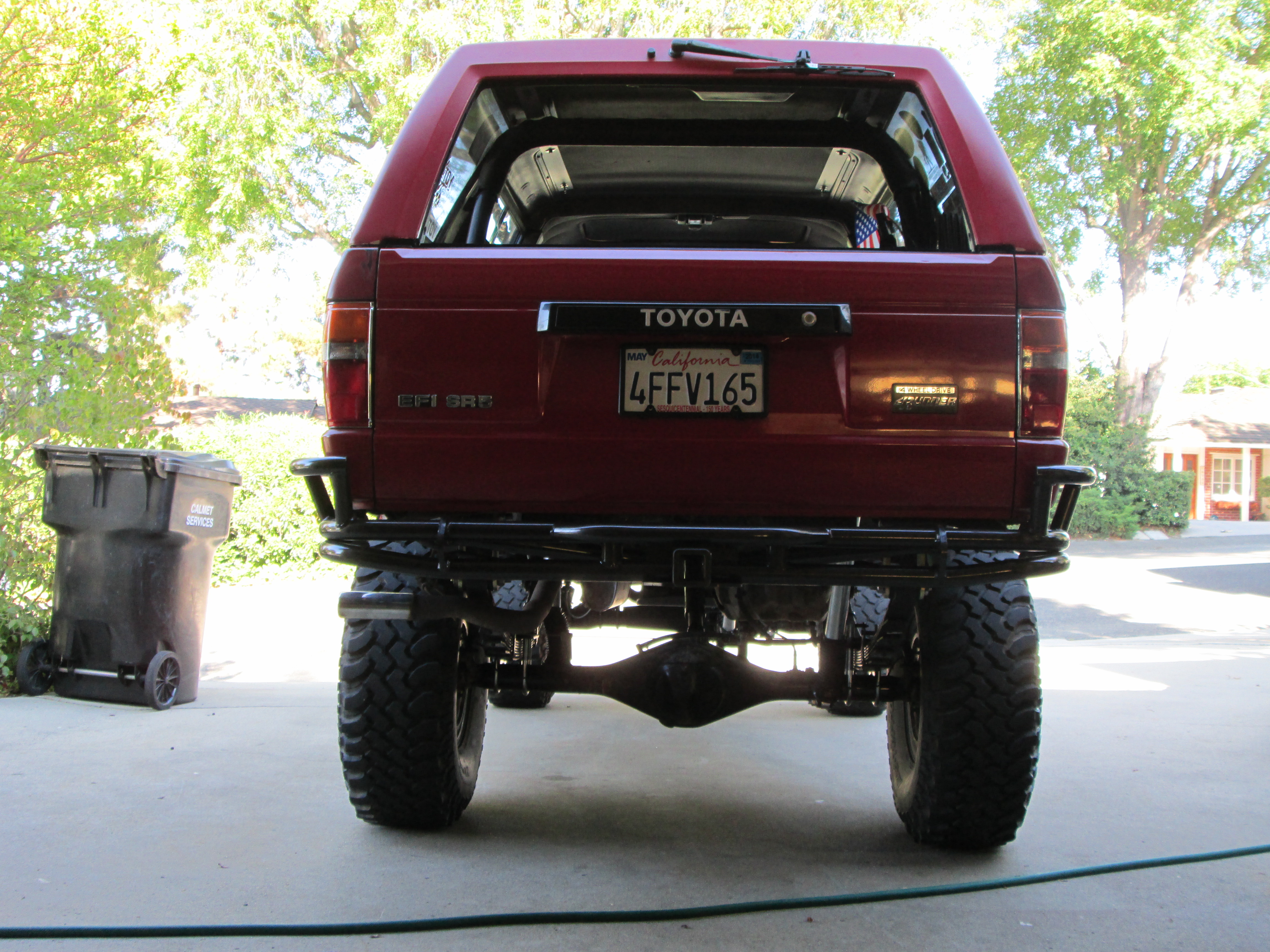

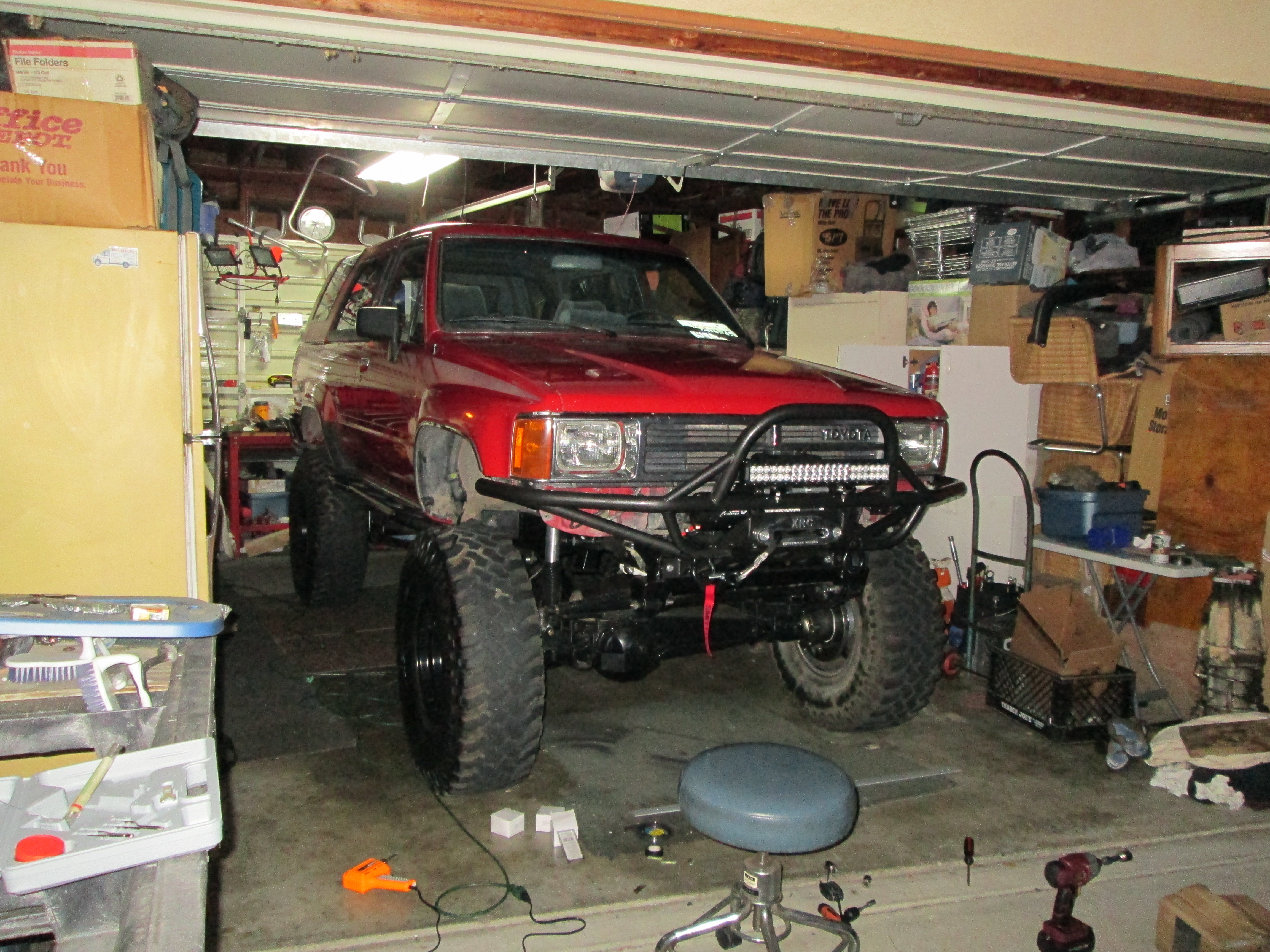

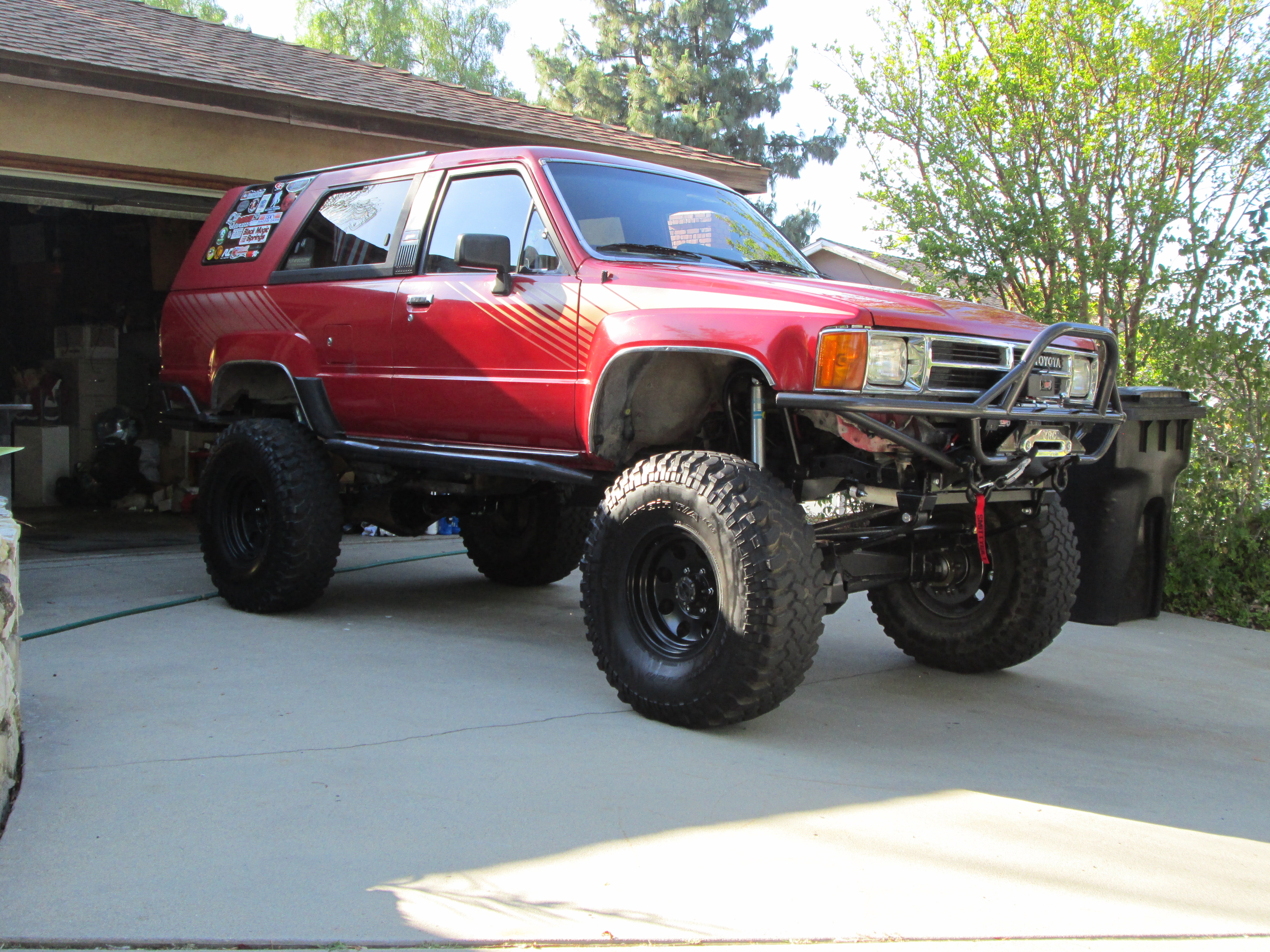

Ok! PICSSSSSS! HAHA.......
Some driveway shots from different angles....(after her first full bath in a month! Haha)

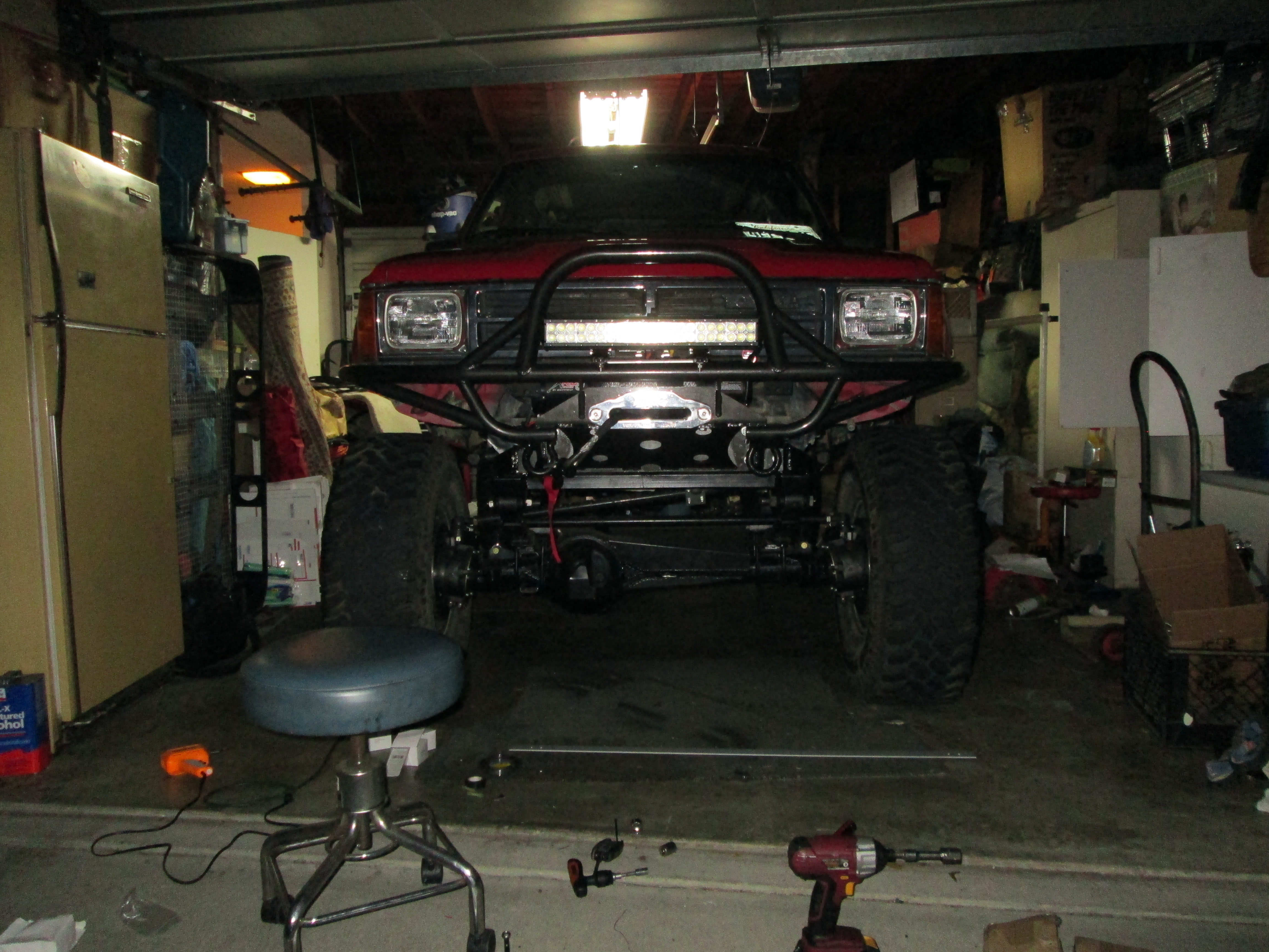

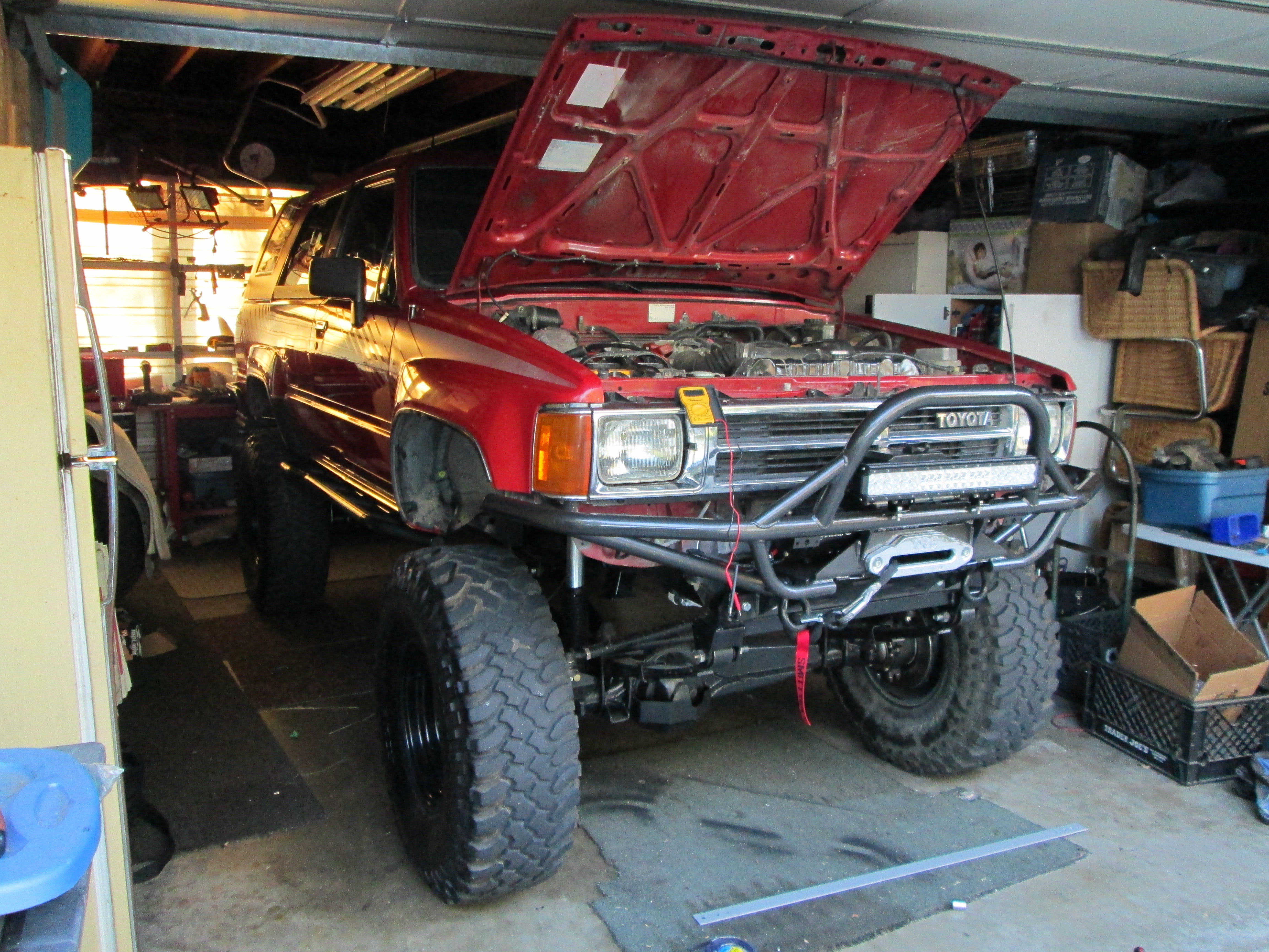

Back in her hole for the first add on since her surgery!........>>>>>>

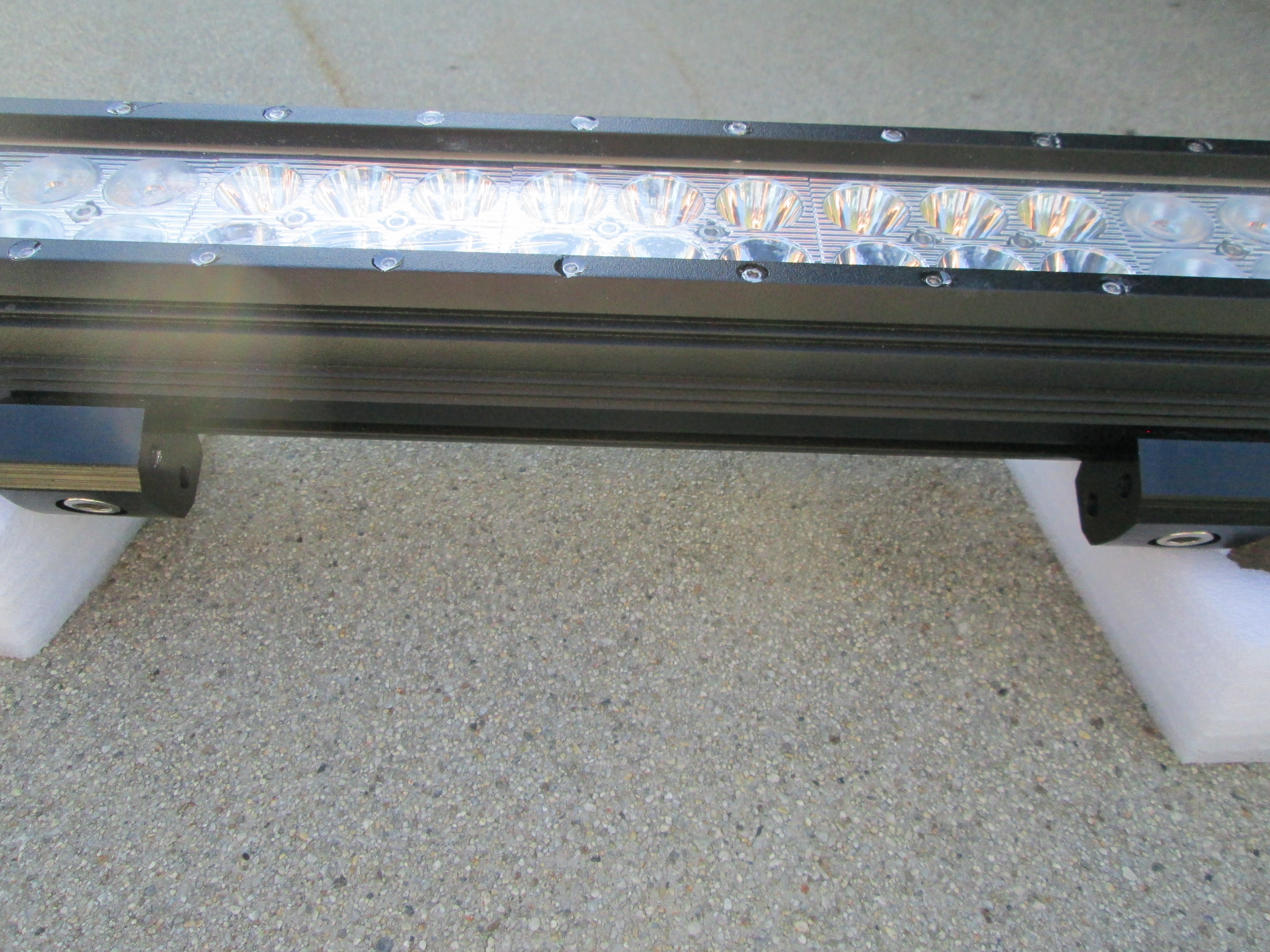

I decided to pull around/route the wiring for the 20" LED Cree Spot/Flood combo light bar...... I was all wired for it because of the Dick Cepek 8"ers .... So now I have an extra wire going to what will probably be for the two 7" spots that will be on the roof rack, facing forward.... combined, they are 72W... The front 20" is 126W... I think if I was ok with 300W of Halogens on the one switch and 30A fuse..... I should be fine with the 198W's of LEDS on the same......
Here, I'm getting it set up. ... And, I realized it was REALLY going to be close on the fit! hehe....

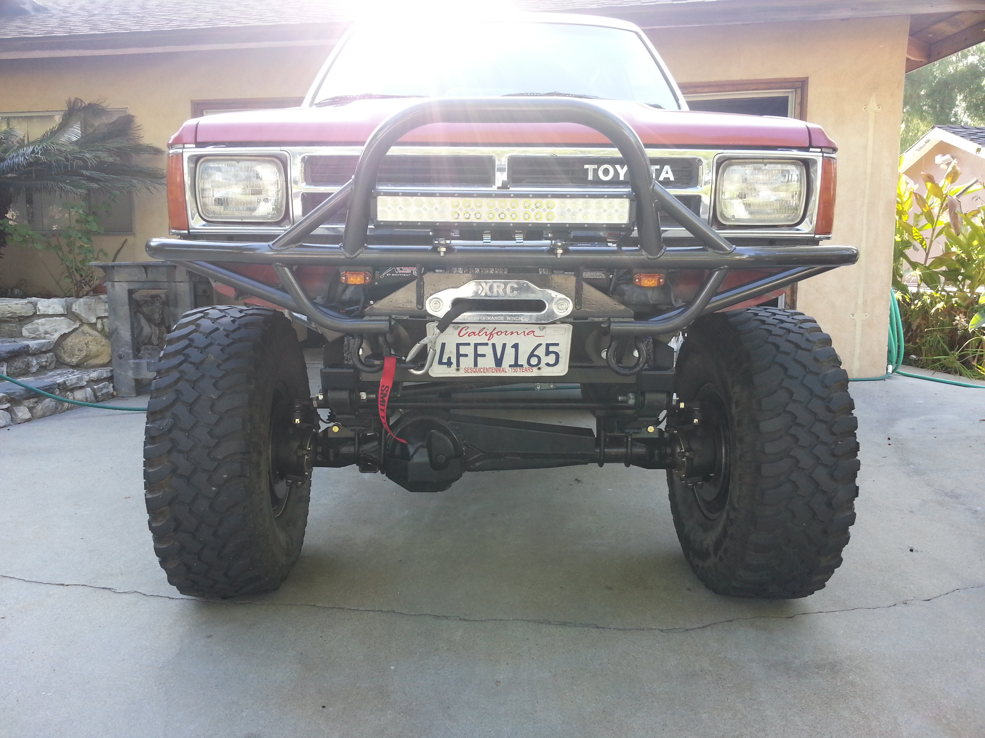

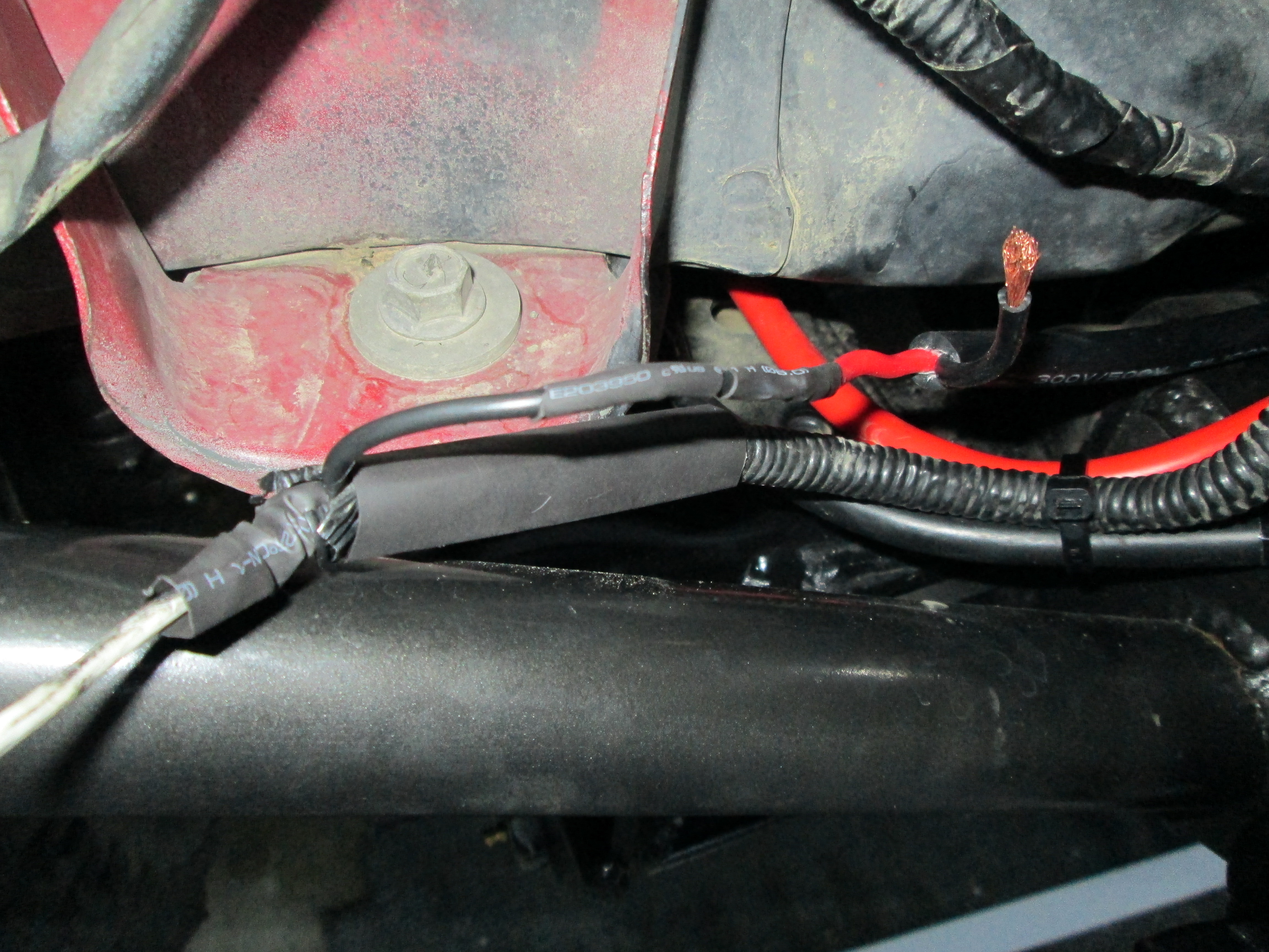

Soldering in everything clean....
DONE!.....

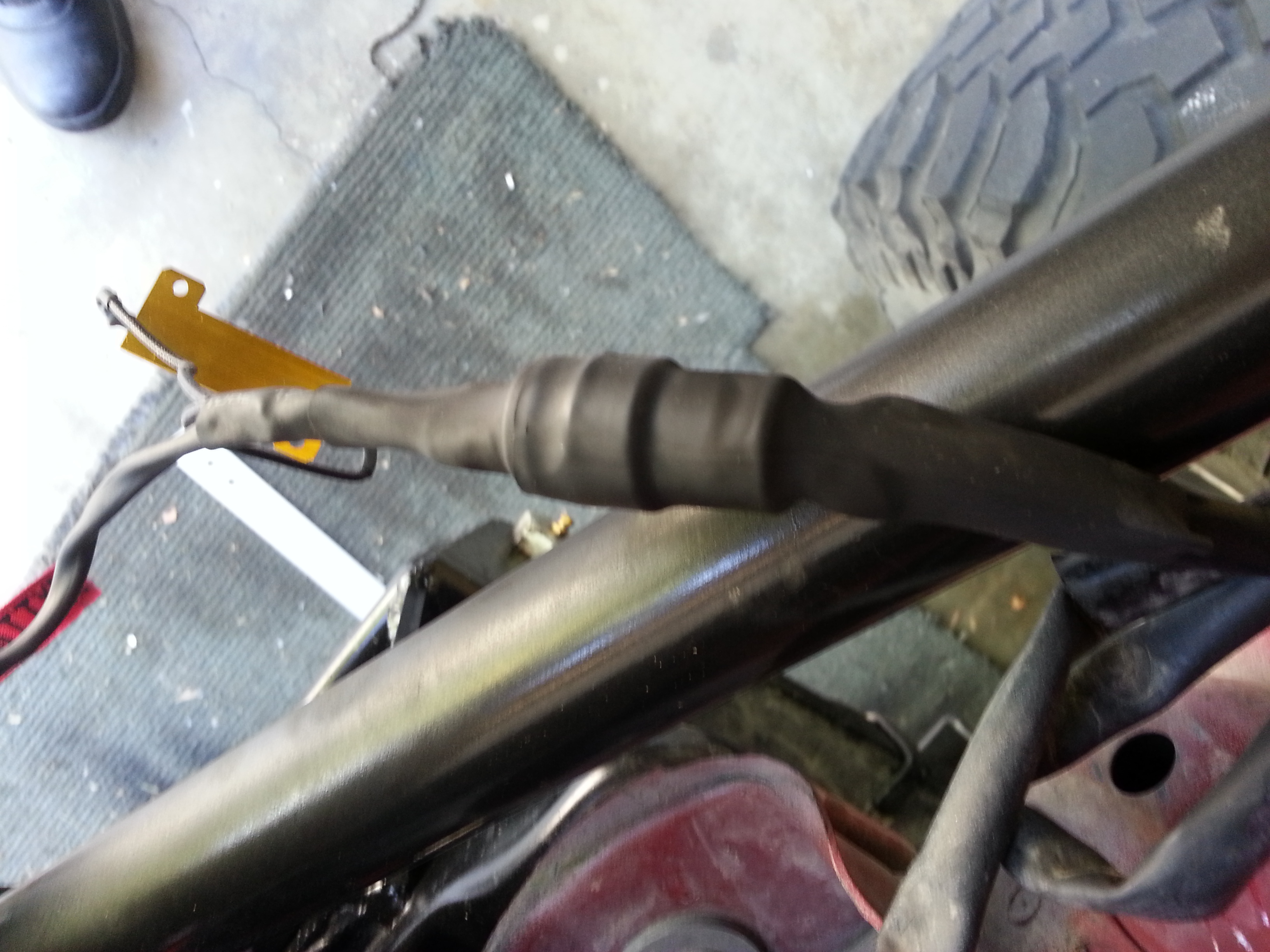

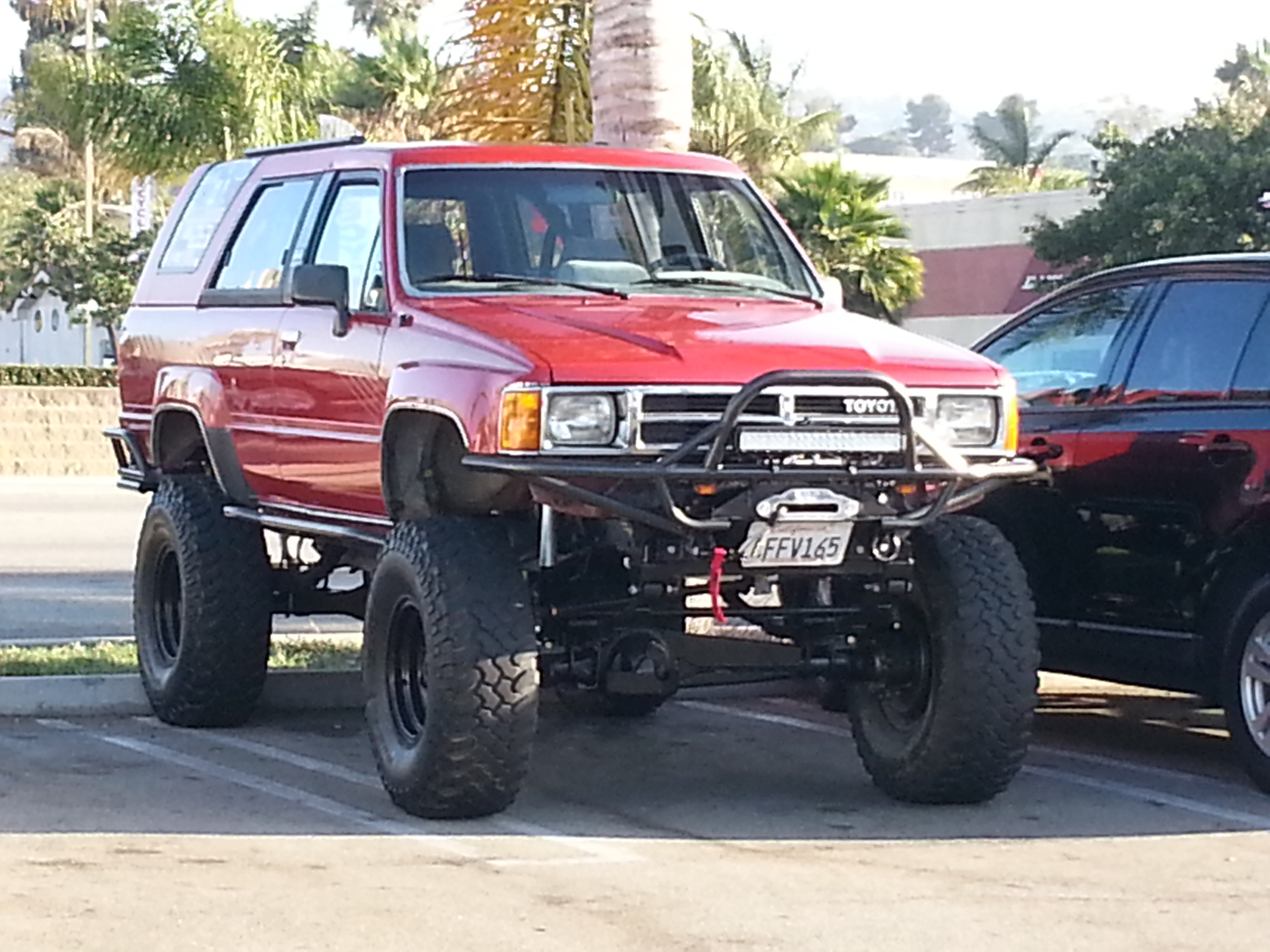

Well,.... got lots more done today. .... important stuff for "road legal purposes"! Lol ....

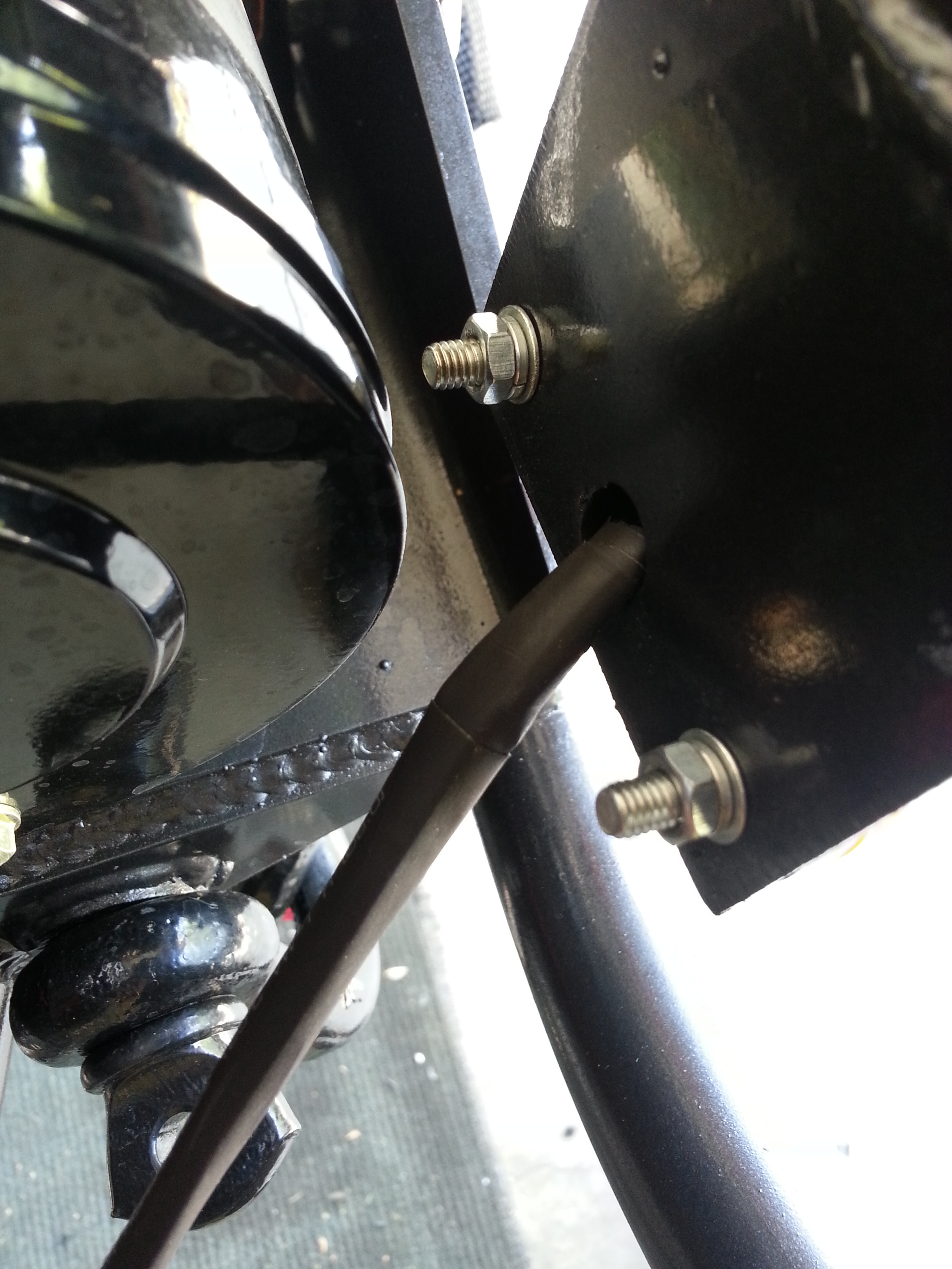

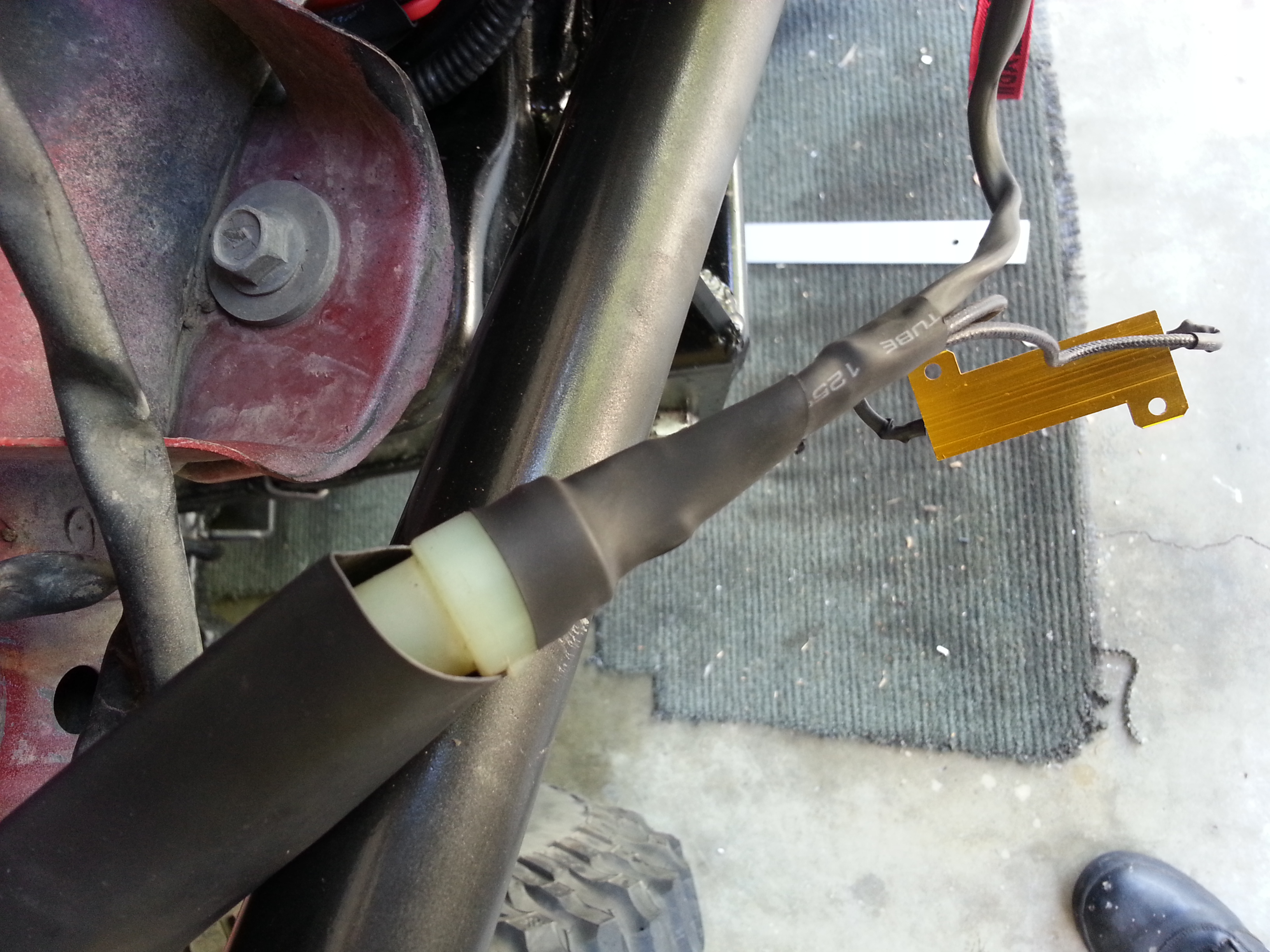

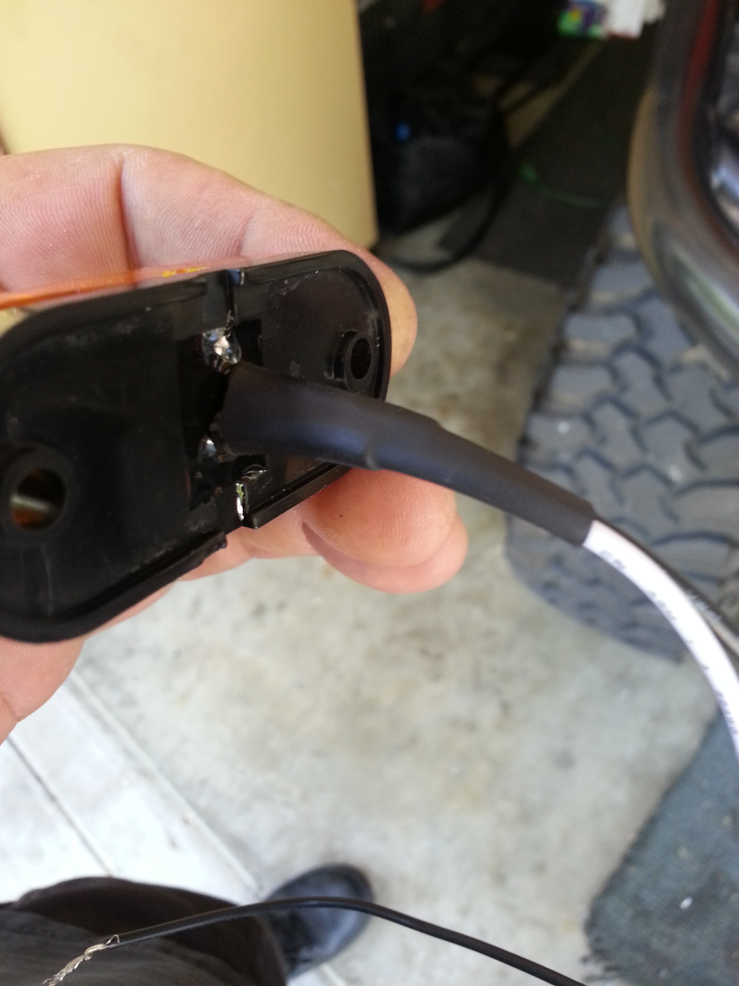

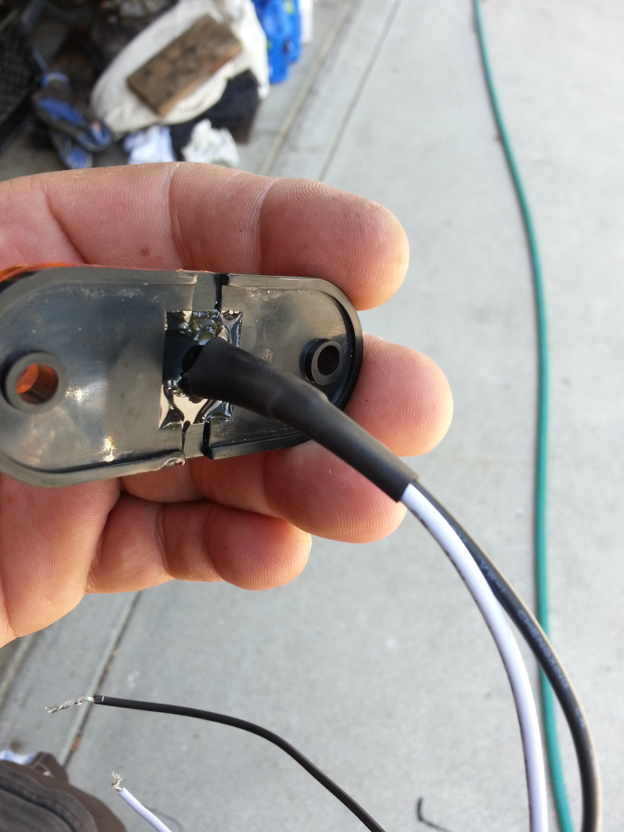

Installed the Trail Gear LED turn signals with resistor, front license plate and got a little bit laid out in my mind for the roof rack.... I'll share that latter part later....
I heat shrunk each wire right up to the light because they seemed to be a little bit raw in that area... I'm fairly sure its just solder splatter or something like that... but they felt a little rough right at the end... so after heat shrinking each one individually I then did it around both tight to the end so that water can still run down the Bible that Trail Gear notched into the back so that water won't collect...
By then heat shrunk together the entire length of wire that they provided.....
I've been used tight fitting spades that we're joined into the factory connector but separated right up to the connector with heat shrink..... Then put three-quarter heat shrink that I had slid previously over the wires toward the signal back over the connector and heat shrunk that tightly...
As you can see in the previous picture I already had one inch heat shrink pulled back over the other side of the connector and the original Toyota wiring from the harness... then pulled that over all of it and heat shrunk both sides til it was completely waterproof and well insulated.... I chose this route because I want to keep the original connector intact. I know that seems redundant at this point but there's always a method to my madness!..... Okay often or at least occasionally, right, hahahaha!....... Each wire gets one of the wires from each side of the resistor from super bright LEDs.com ... I ran each pair of wires through its own heat shrink and then heat shrunk all of them until I had nice clean set up... no cutting or suffering was required because both pairs of wires, 1 signal light wire and one resistor wire went into each spade connector... they are quality spades from Signal Electronics..... This way I can eventually remove spades all together, cut back and small amount of heat shrink tubing and solder in some donor connectors from the yard so that I don't have to cut my original signals up... .....

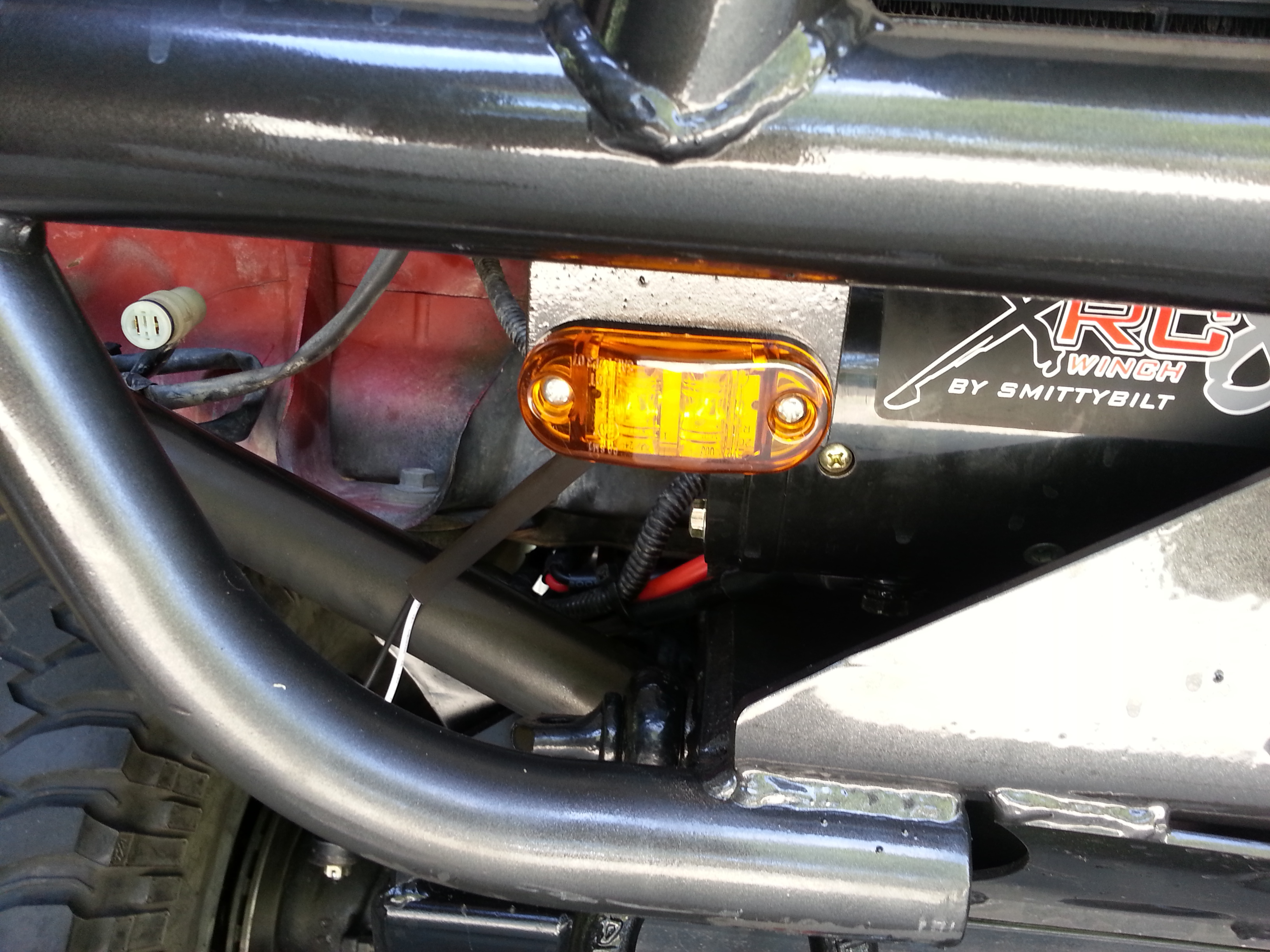

Obviously, before I connected any wiring I had to run the wiring through the tab slot in the tab welded to the addicted off road front bumper(I'm pretty sure you need to ask him for these if you're going to order a bumper and want an easy way to mount the LED turn signals)...... I used fine threaded stainless machine thread screws, staying with flat washers and lock washers and nuts... all of which you can see in these two pictures...
Here they are mounted and working in the videos...

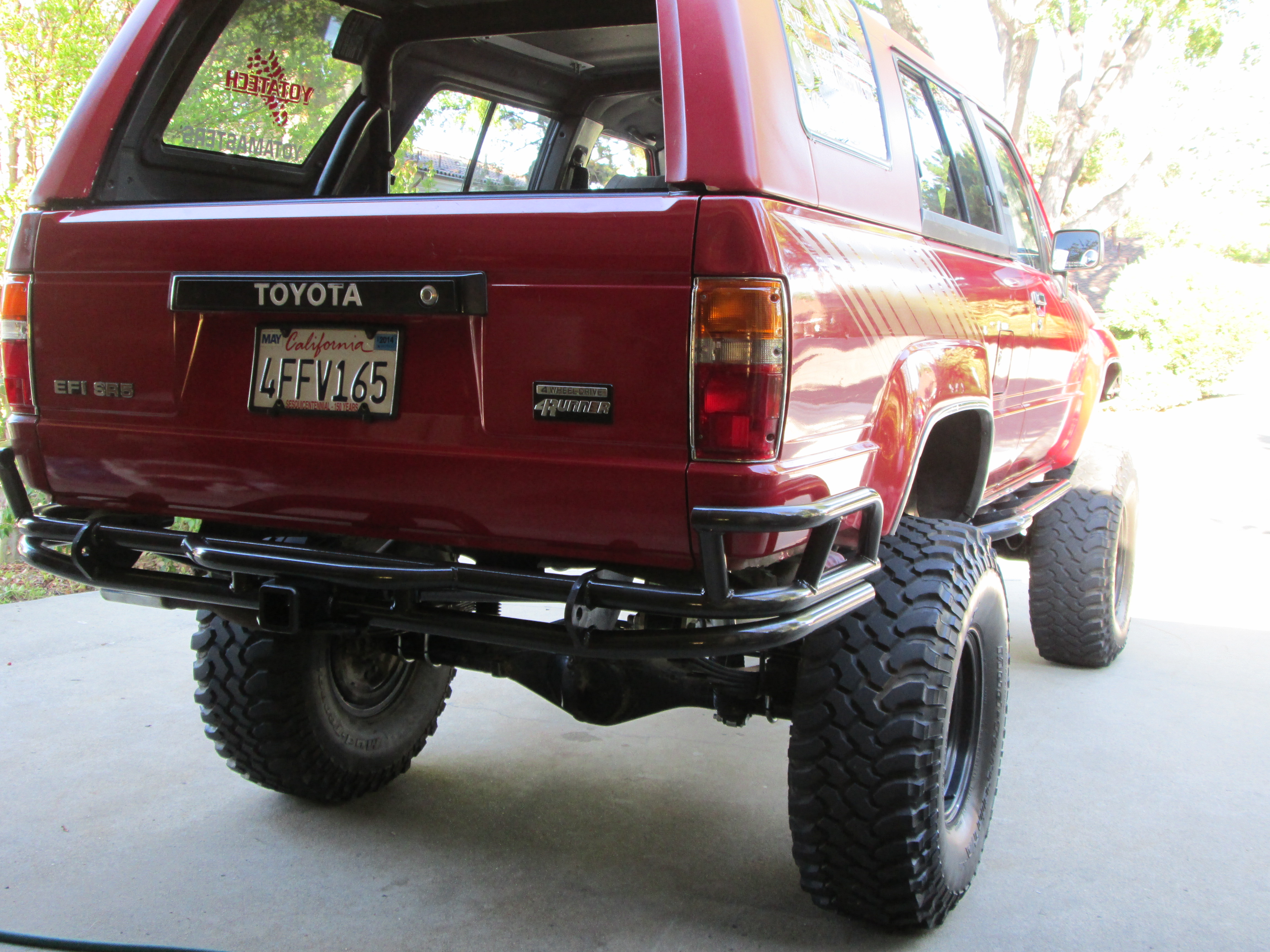

I also explain in the videos how I'd totally missed the fact that studies bumper has holes already for mounting a license plate... I just about spat my coffee all over the place when I realized this.... I have terrible odds with the laws of Murphy when it comes to getting pulled over for the stupidest crap... So within the videos I explained how I meant it but I didn't mention how I got the thread screws from the backside into and through the license plate on front... I ended up taking needle nose pliers and reaching in, which isn't that easy for me as my hands are not tiny, and dropping them through the holes... I tried using a strong magnetic screwdriver that I have first but it just kept getting stuck to everything and was not practical... I didn't take my hand would fit in there while holding the pair of needle nose... but it did...
There is a picture of everything mounted... for those who don't really get to watch videos too often... the videos will follow...

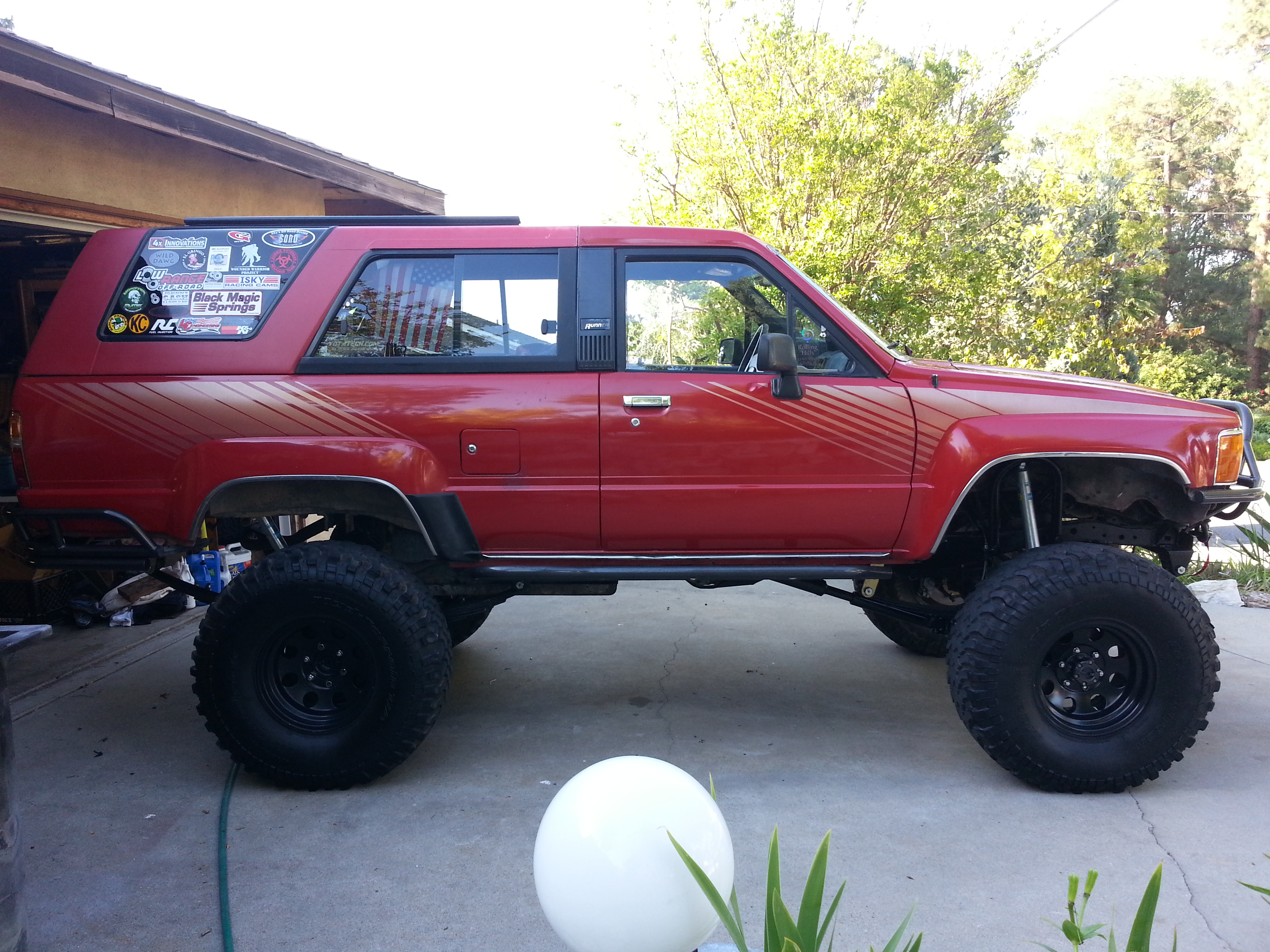

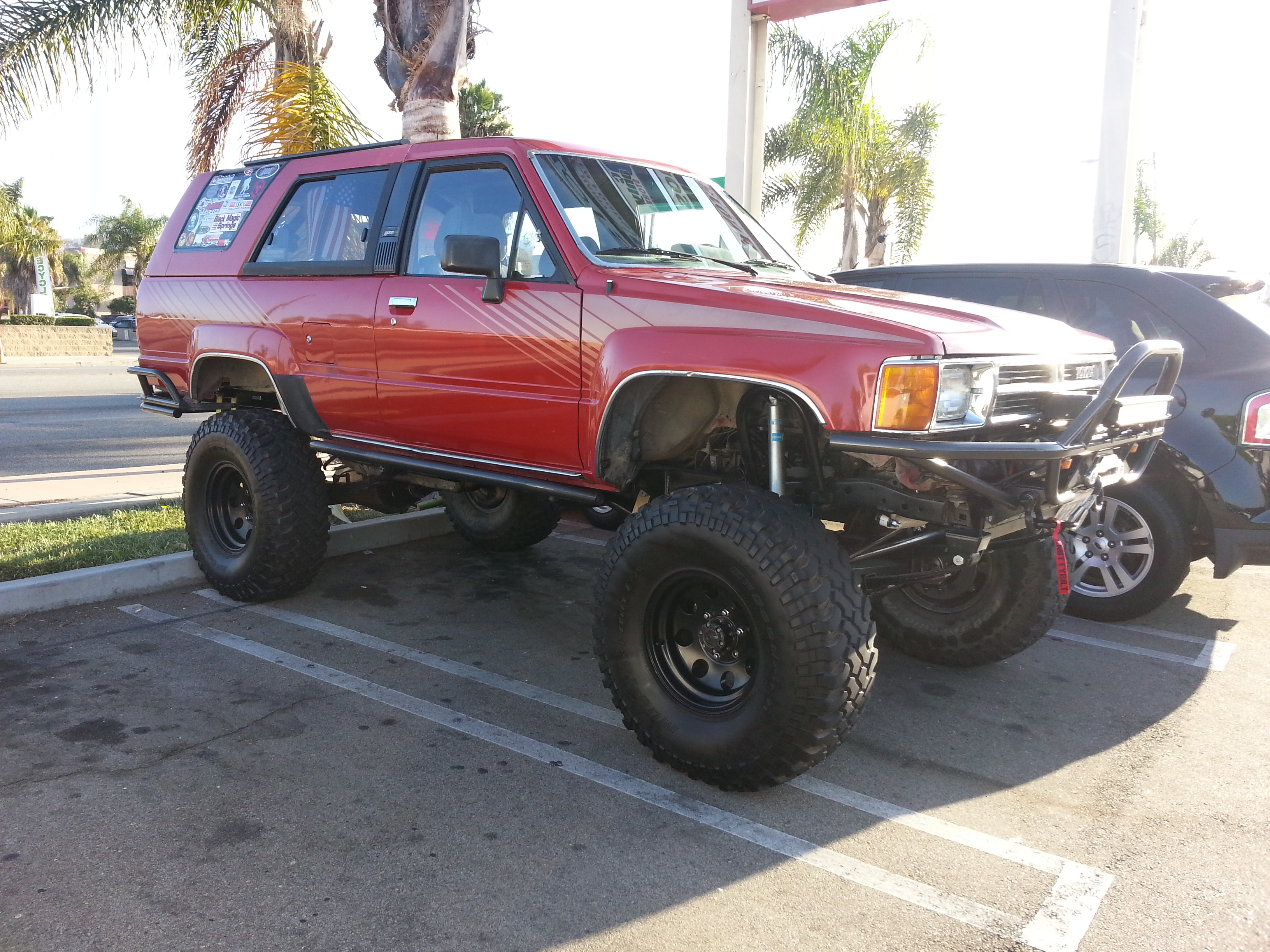

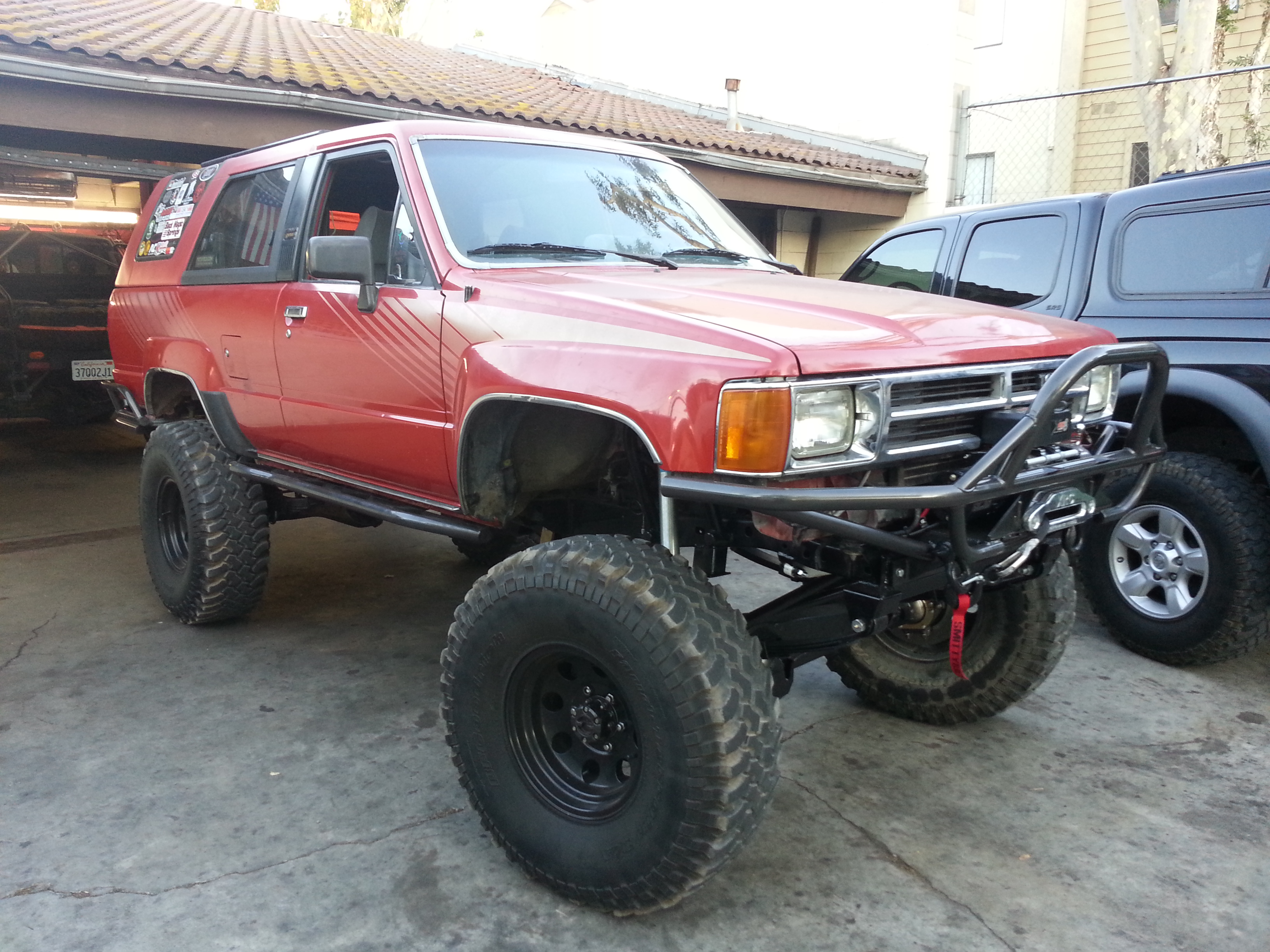

I also took a few shots while I was out and then one from directly from the side... but I was up on my steps and I can't seem to find a parking spot in the city ever where I can sit level and have no one park next to me within 10 seconds of turning off the key...... So I just took a few while I was out and when I got home....
