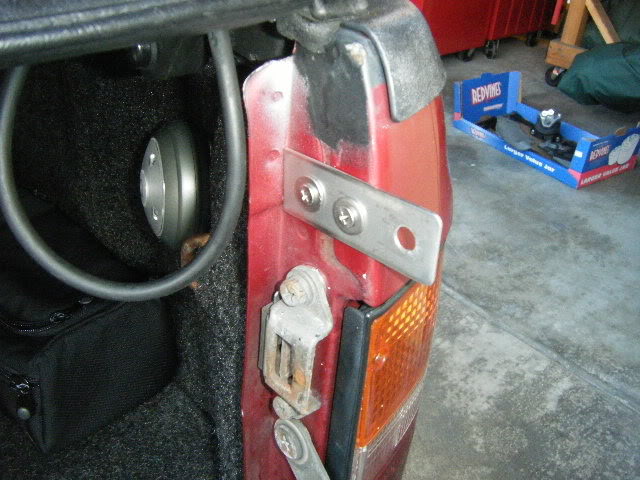

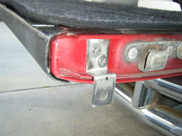

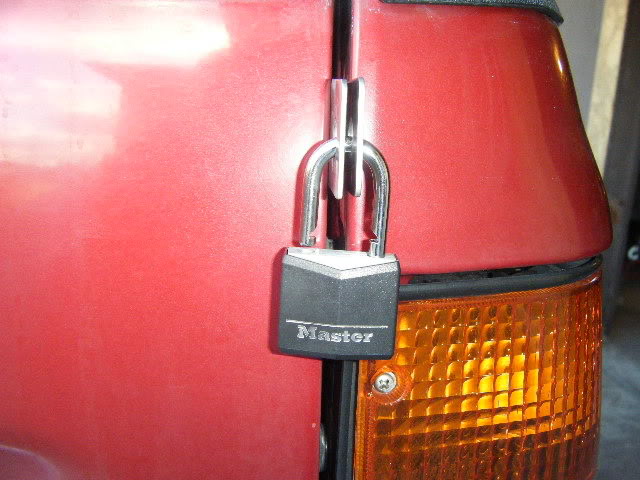

I like that mount ...looks like my tailgate lock setup I made (one of the drawbacks of 3rd gen trucks, no factory or aftermarket lock available). If I put an antenna on mine I'll do the same thing and then just modify the bracket so it becomes both my tailgate lock and antenna mount
AWESOME IDEA! I probably dont need that with a 4Runner, but that is a great idea to keep ppl from being able to open and drag things out!

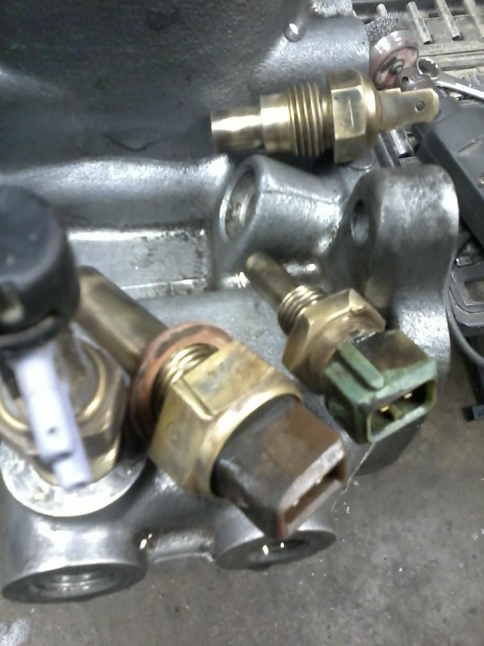

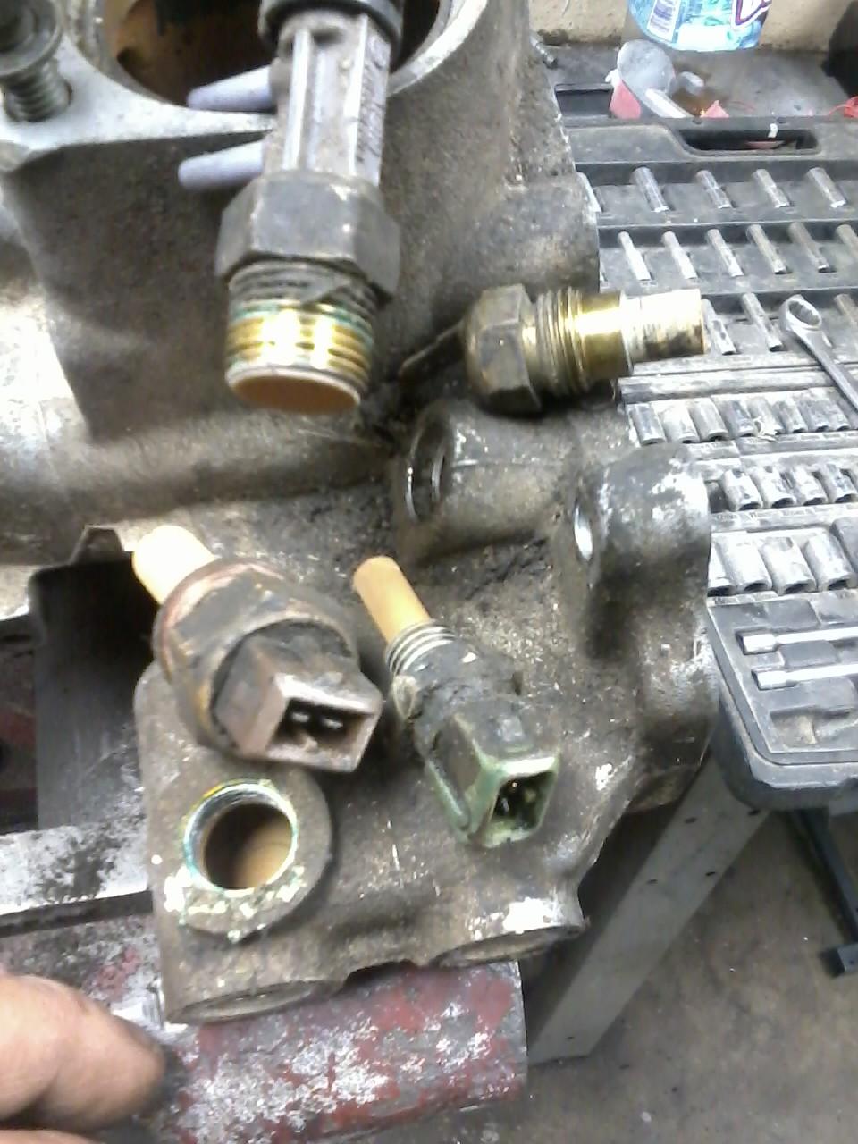

I would also look at your Water Thermo Switch but cleaning the others wont hurt either. Meant to say on my earlier post that I like the clean, everything hidden look in your truck. Been seeing a few threads about Runners on the west coast getting new owners without payment. From Washington down to your area. One less thing to draw there attention.
Copied...
I had to take two intakes and make one. Here are the dirty sensors. Cleaning temp guage one in between #2 and #3 cylinders has helped my temp guage to be more stable then jumping around.(Top Right).
Here they are cleaned. I just use a brass tooth brush and water to get them cleaned. The manual says to wrap the Cold Start Injector Time Switch (Sensor with Brown top)with plumbers tape. I do them all. I haven done it yet but will when I put the motor together.
My coolant temp sensor is new from Toyota. The cold start injector time switch is not.... But I cleaned it very well. However, there is some notations that Toyo made, regarding certain upgrades to sensors were falling short I'm causing problems in 87 in particular. 87 is that in between model the from everything I've read has a lot of problems. I have to replace my heater core hose to the wrap-around part to the driver side of the back of the timing cover.... So I will burp it, well, then.

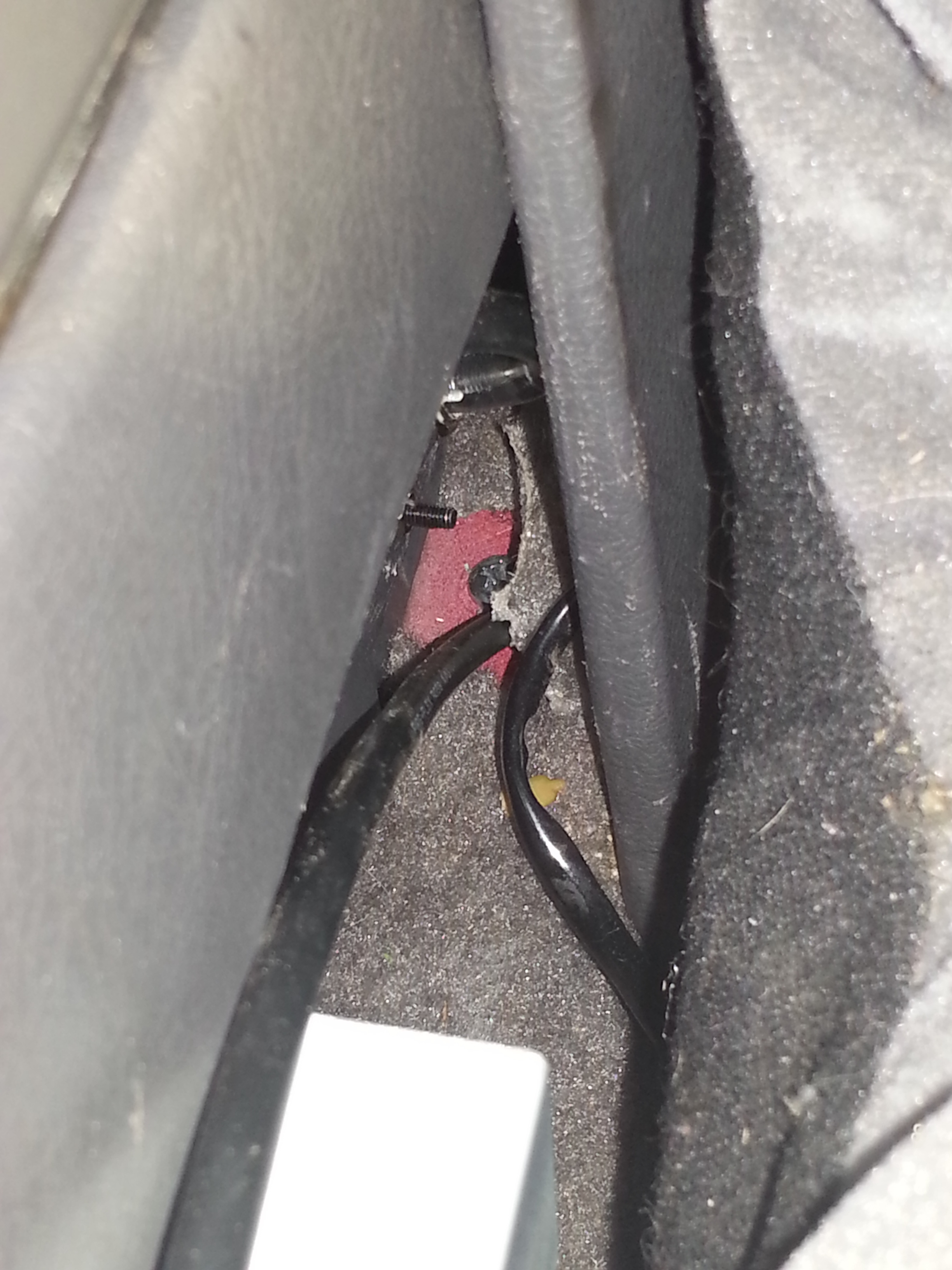

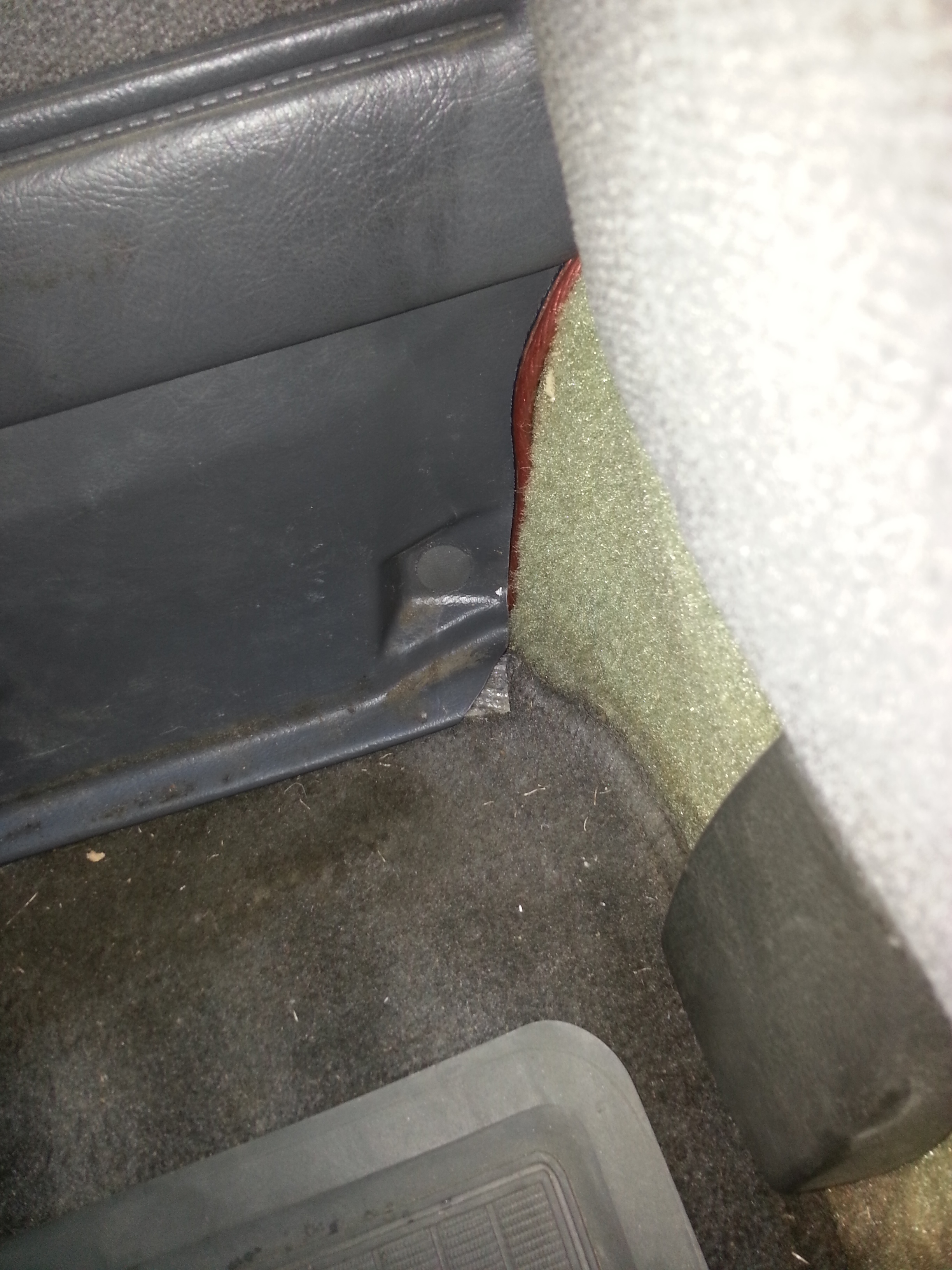

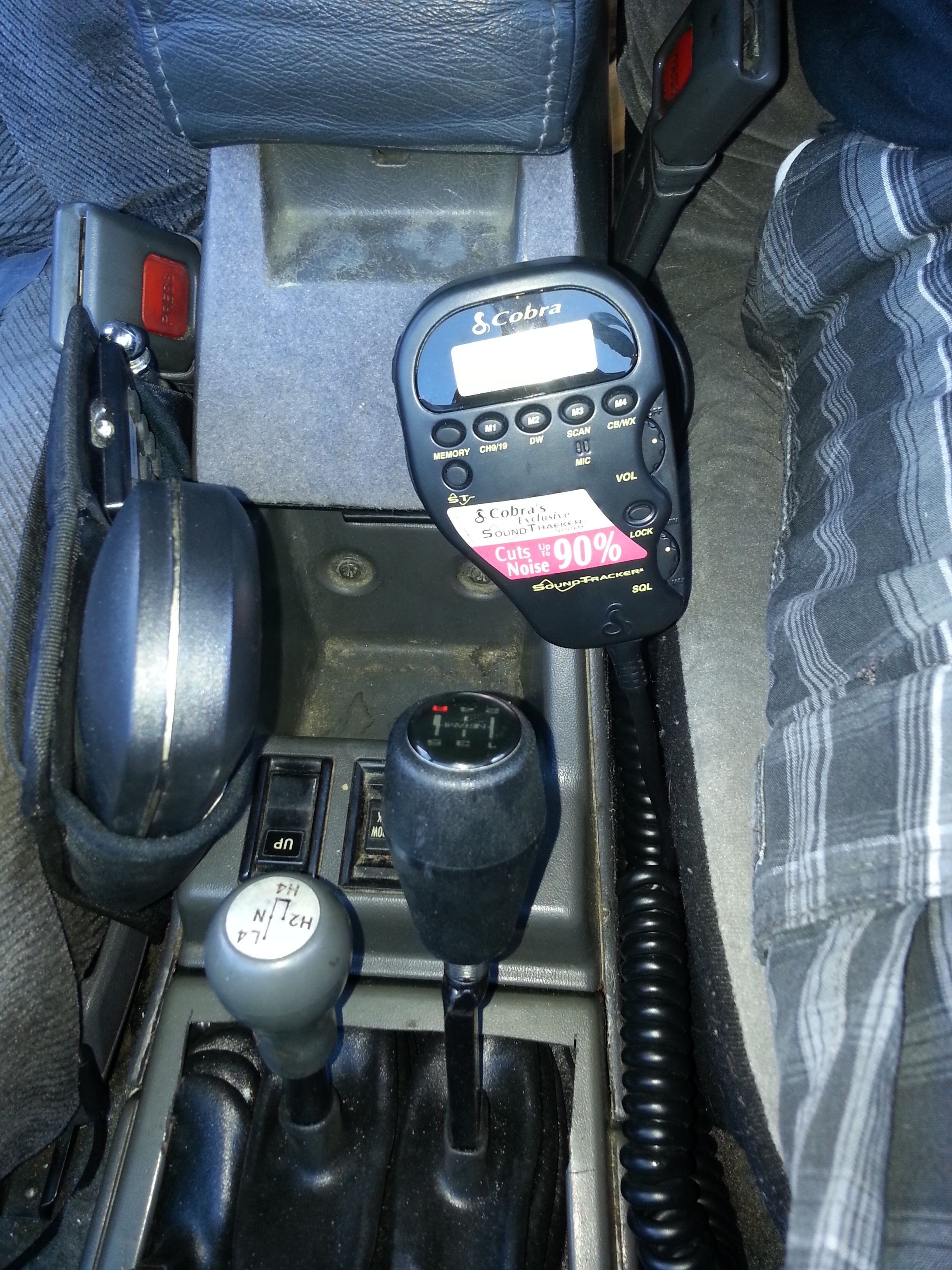

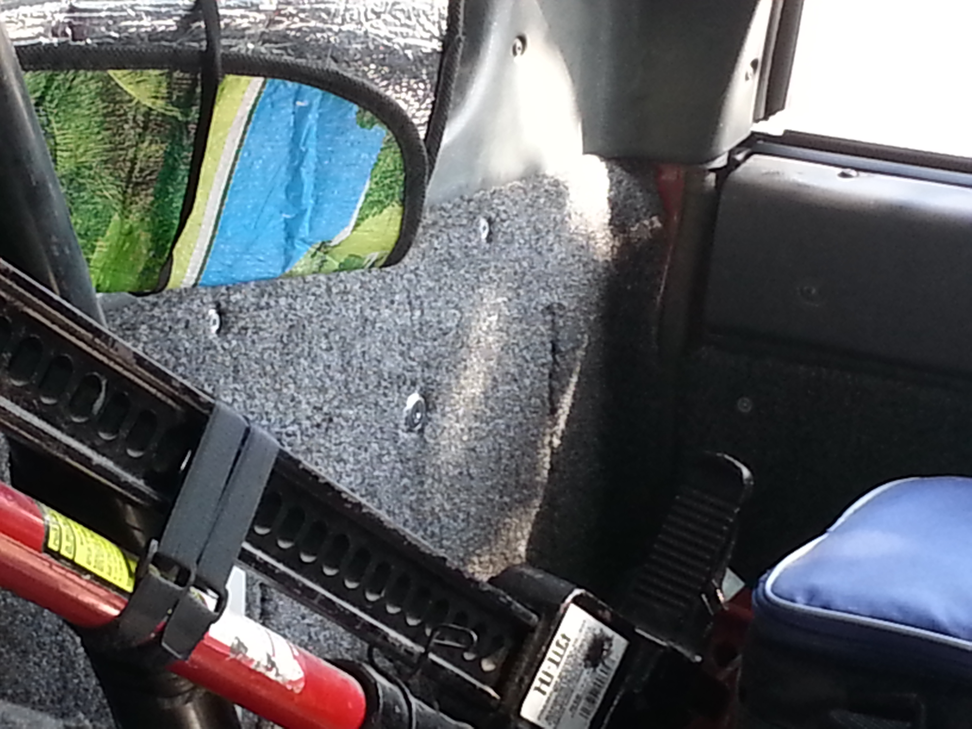

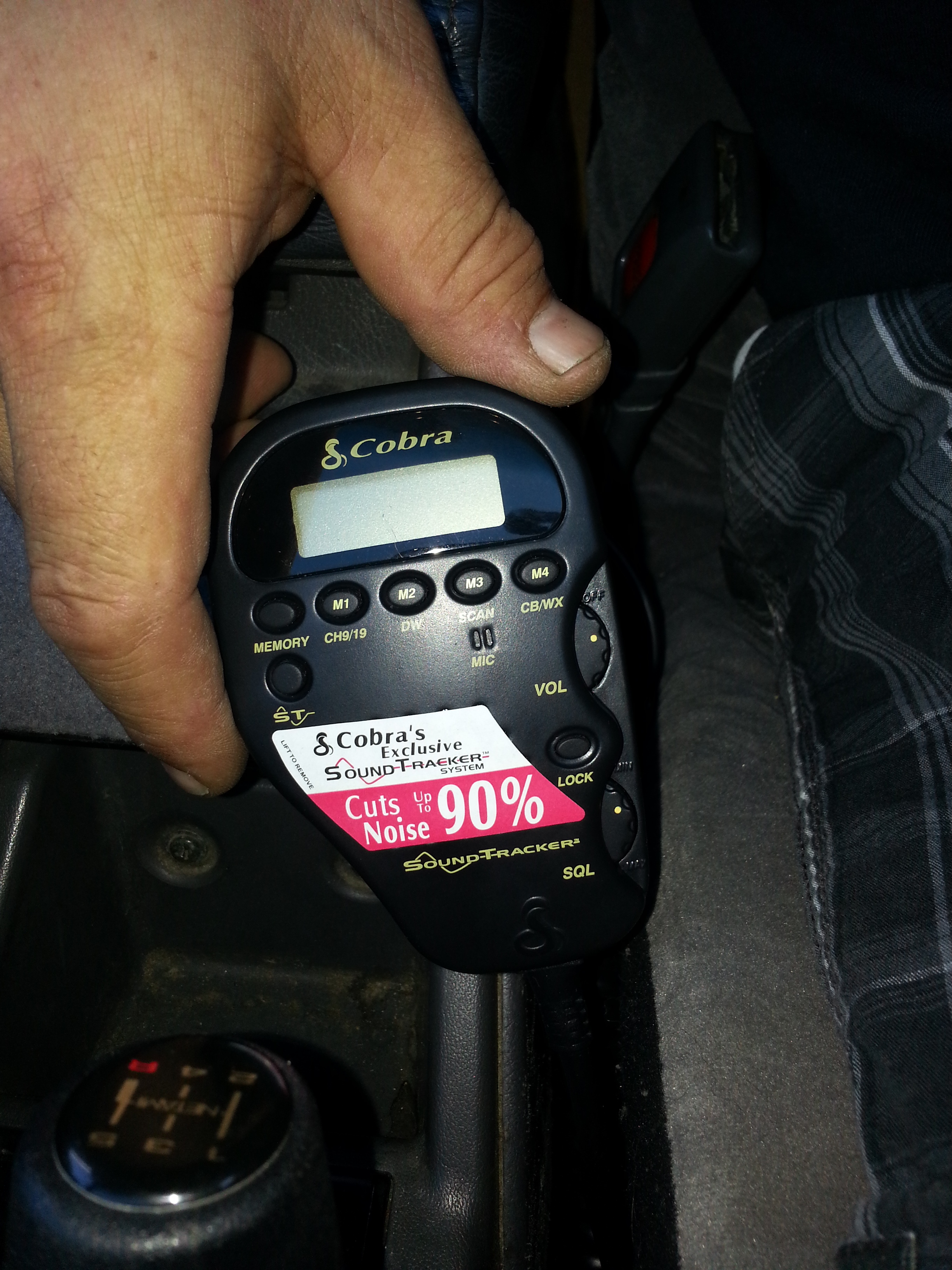

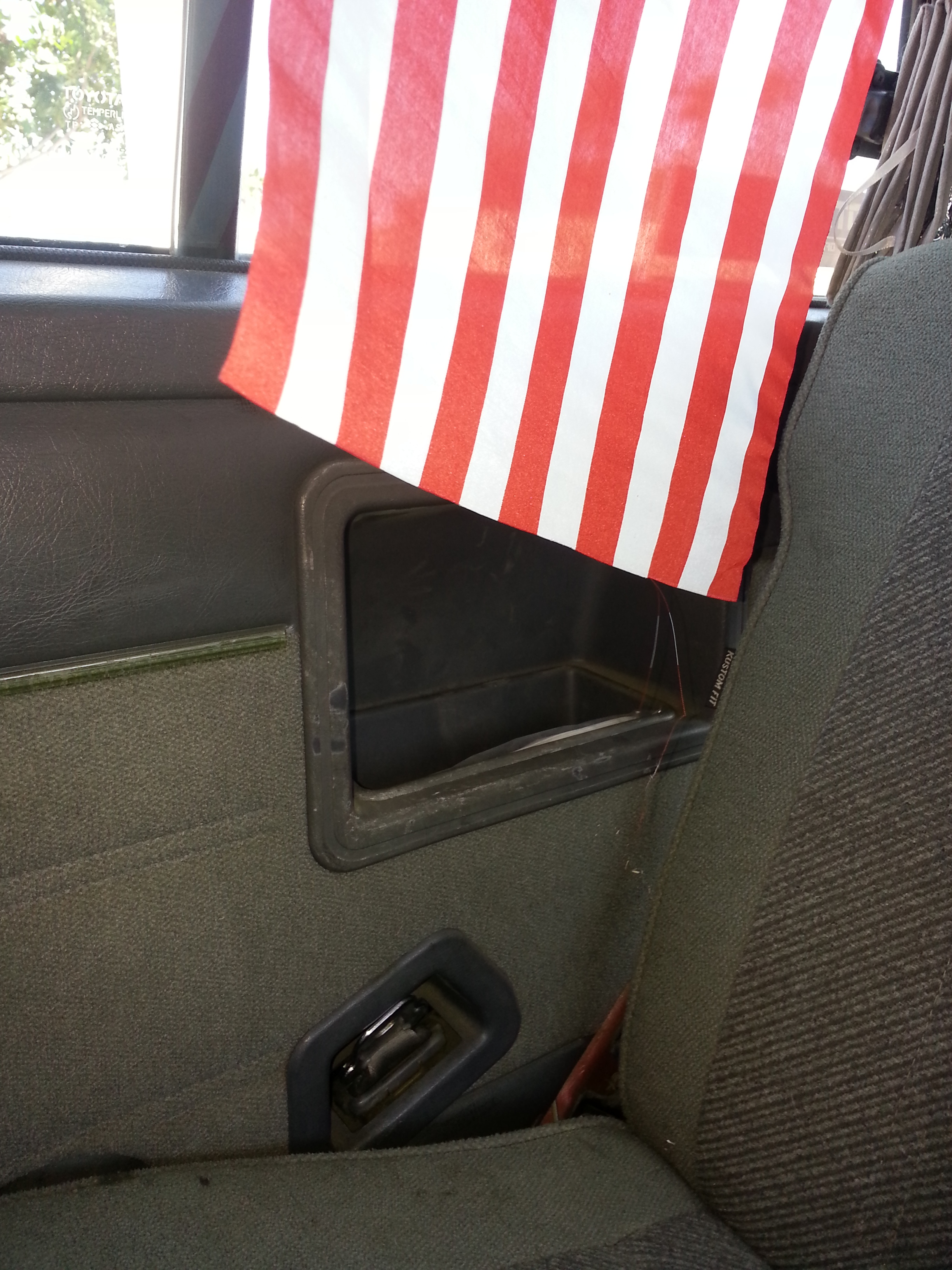

COBRA 75WX ST & MK-204R DOORJAMB/TRUNK MOUNTING BRACKET & 18' FIRERING ANTENNA KIT INSTALL...PART 2 .....
Hey Homies, what y'all think?...
So I unlocked this, grabbed the coax that I'd routed through the taillight grommet from the outside, and routed the antenna wiring to the back panel side pockets area in the panels.....
Reached in the pocket recess.....
Then ran it up as far as I could to this lil exit location I decided, below the B pillar, right at the carpet......
Ran the wire under the carpet, over to the driver side corner, then back over to the center (avoiding foot resting areas). This allowed me to route the 18 foot coax from the tail light all the way the console mounted Cobra remote box without ever coiling or laying over the wire even once... Wound up being the perfect layout! I run the wire up by the seat belt hole.......
I mounted the hanger here (you'll see it better in the video).......
EXCELLENT ergonomic factor.... and should be easier to hear than when on the dash ( Plus, mounting location for the hangar allows me to just pull it out of the console and rested in the hanger then place it back in there at the end of the day.)...
And,..... I just hope that maybe this could be helpful to someone else with a 1st generation 4Runner..... I really appreciate everyones input, and I mean it when I say that it always helps me to figure out what I'm going to do. I often do things like this my own way, but I hope they make sense to more than just me? Hahaha. Actually, as long as it works I guess that's all that matters... Well, as long as it works properly and as well as it can possibly work! Lol...
Video...

dont forget to remove the sticker off the speaker on the hand held... :-)
roof is a better spot for the ext speaker your ear will hear it far better even with the sterio going
mine has grab handles in the back seat 87 vs 88
just ask the cb shop to put one on (90 right angle coax connector) they usually have them available decently priced
I wish I had those handles.... but mine had no fixed nut in the hole. Was it an option, either way? I almost never have passengers,.... but I'd like that to someday change...... Gosh, that's depressing; ...OH WELL, gotta work on changing that at some point.
Far as the 90* angle coax... I will call ahead... See if he had one in shop. Thanks, good idea, it would make it even cleaner.

Heading of to AB Mobile, to have Alberto Benucci, whom I'm told is one heck of a ham radio guru and otherwise... as soon as I can get out of here I'm heading over there to have this wrapped up... I will try to get some pictures if Mr Benucci doesn't mind. Lol.
As soon as I finish that I am moving on to the blue sea fuse block, relays, switches, and air compressor set up wish I should be ordering sometime today or tomorrow.
As far as the air, I think having a tank mounted in the spare tire location is really probably the best way to go. Its in the center and while it's in the rear, with the 50 foot hose I don't really see any problem using it in any direction up to 20 feet from the truck. Does anybody have any ideas as far as if my heavy duty 50 foot rubber air hose is good to go for this application? I already use it to run my tools off a 200 pound Campbell Hausfeld compressor at my home. Its a harbor Freight hose but it seems to be good quality and a matter of fact I believe it's actually one of the better ones they offer . I know people like to use the coil up ones, and I'm not totally against that... But, from everything I've read, the heavy duty rubber ones are way better way to go as far as never ever having to worry about that hose again. Plus, it doesn't have to stay with my truck 100 percent of the time... What I needed I can just pull it out of the rear panels and use it at my house ... So, I don't see why not on using a more heavy duty 50 foot hose. I don't care about having to roll it up and all that that's fine.... I might have found something that I can use as a crossbar, using the spare tire supports let go from front to rear... I will post more on that later.
