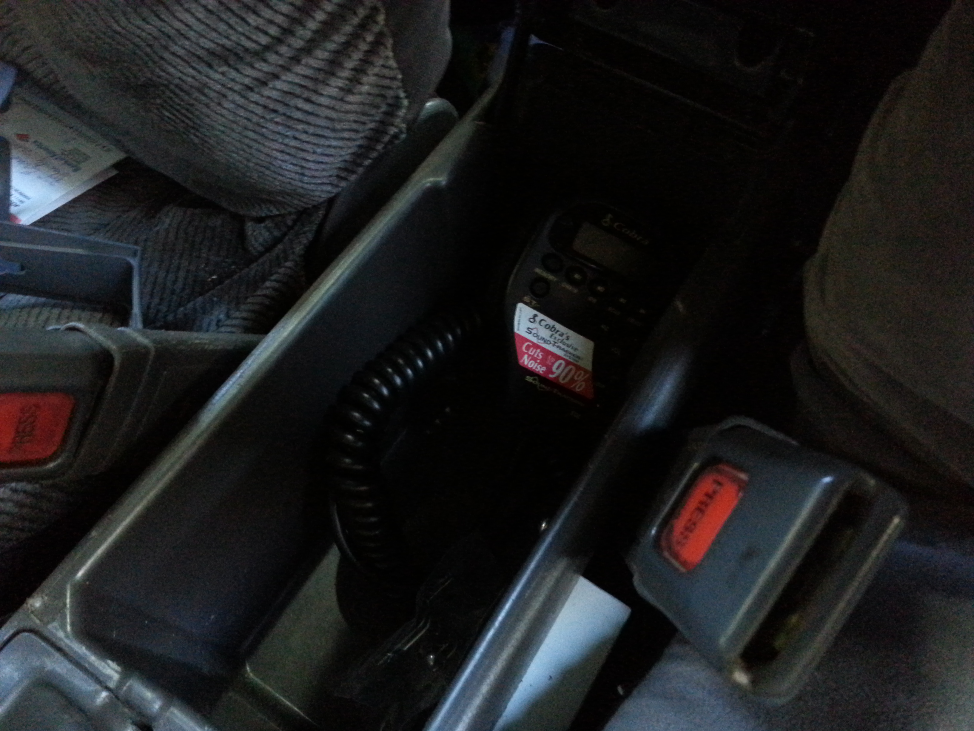

Chef - oh man, I like where you installed the CB...all your looong thought processes paid off. I really think I'm going to move mine at some point. I also want that antenna bracket that you bought, so I might order one of those and then move my CB to the console. Anyway, good job, I can't wait to see the bracket video and the fire ring cable install.

a cb will work fine with the engine off but it will use power more than a radio will
where ya got it a right angle mic connector would be VERY handy

looks good still if ya keep the connector in there id get a right angle 090 degree mic connector its not expensive but will make it a longer lived cable

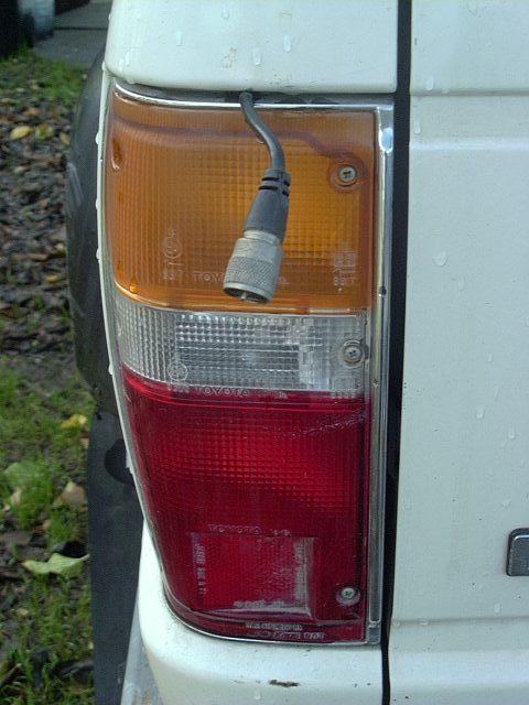

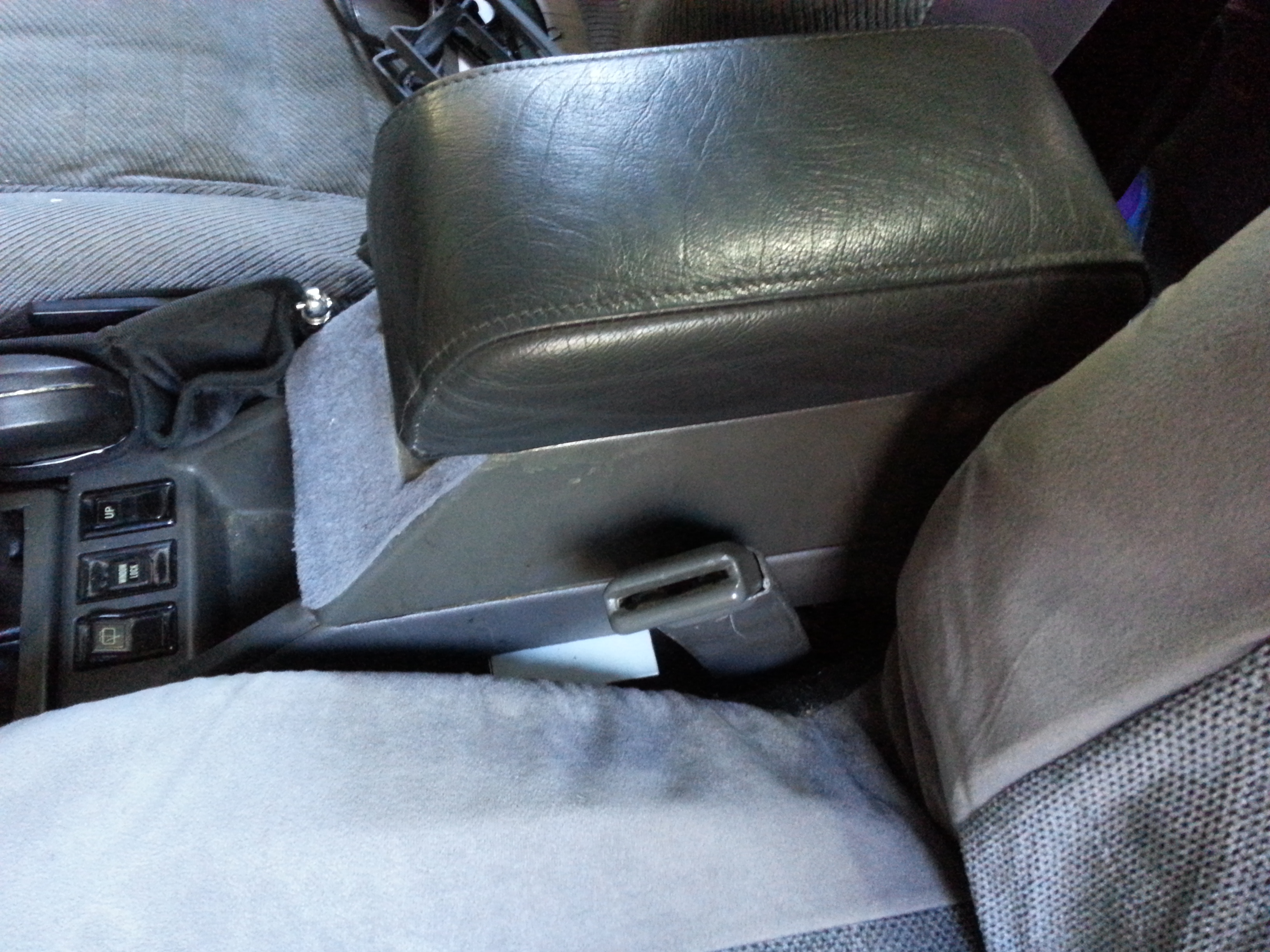

Terry.... Let's play "WHERE'S THAT CB REMOTE BOX?" Haha. ... jk..... but it's out of site! ( I will get better pictures today if I can... Just for now....)......

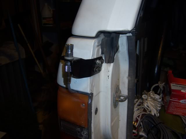

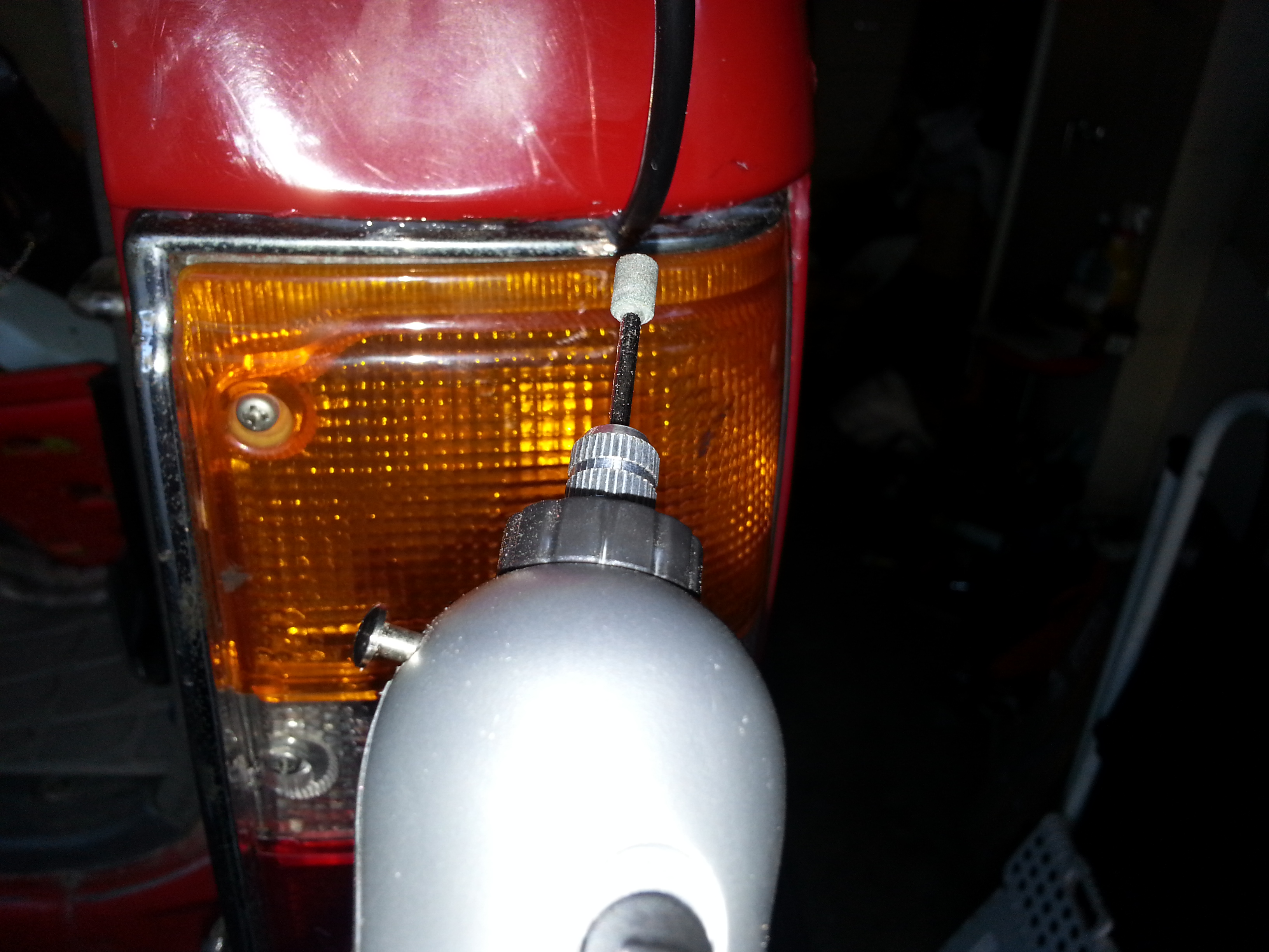

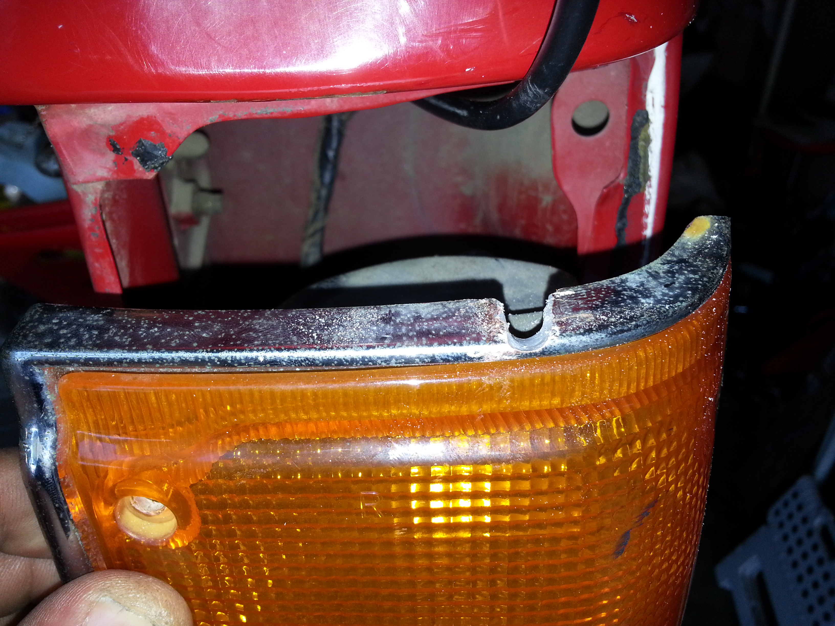

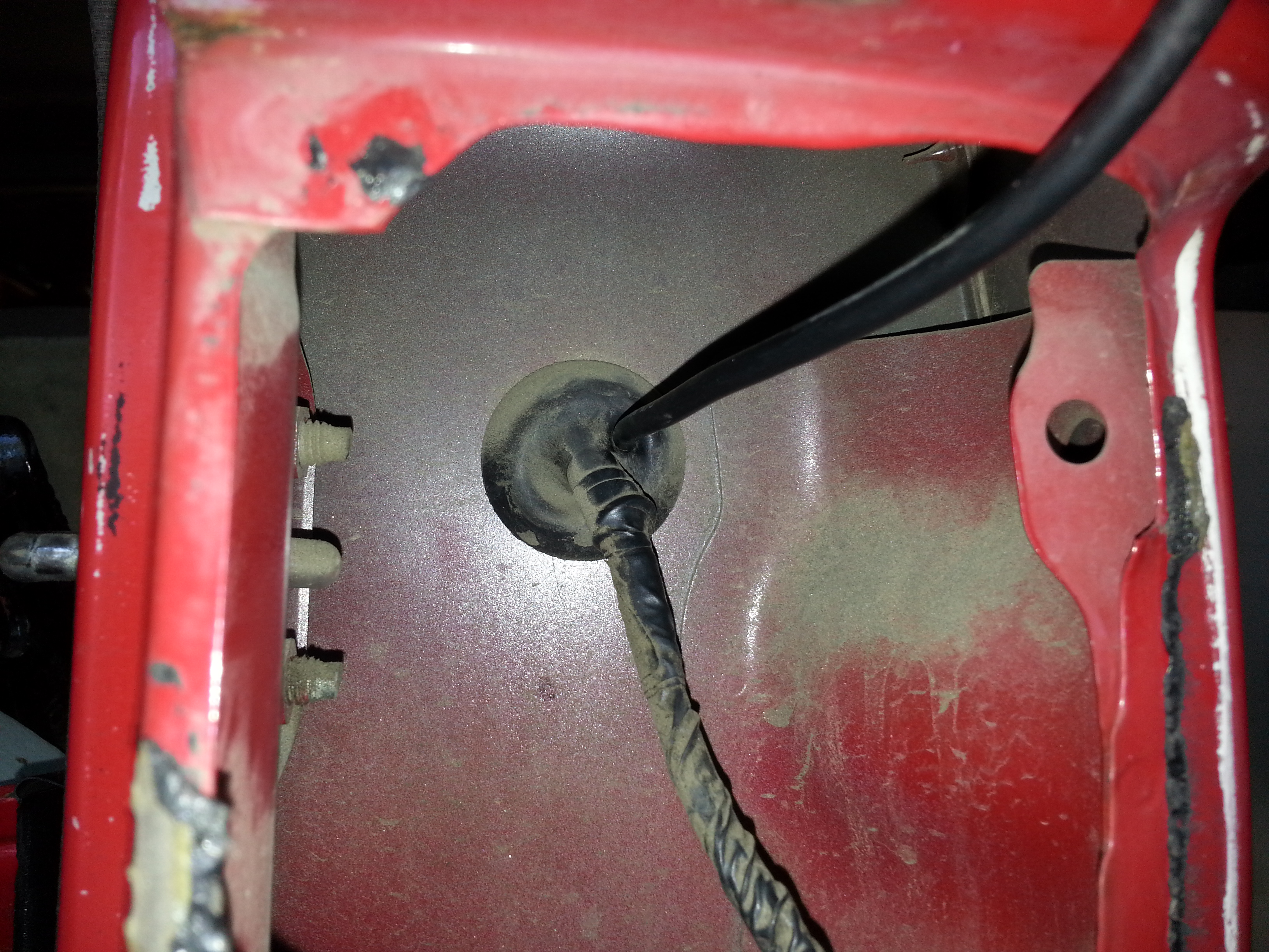

Okay guys, here is what I was talking about. Roger aka 4 crawler did in fact notch his tail light housing on the top, he wanted to prevent drilling holes anywhere in the body.....
This is the type of mount I will be using but on the opposite side, as the passenger side is clean metal under the paint and the driver side is showing body filler or bondo of some type...... The bondo maybe shallow, but then again it may not be, and if I screw through it and even manage to get to the metal, it could still start to crush and then create a space as it flakes away.....
Similar to the Door jamb mount I'll be using.....
I just ordered this item that dragon and Jason had mentioned...
Just want to give proper kudos to Advanced Specialties Inc. , Amazon seller,.... Whom returned my message within 5 minutes as I was requesting quick as possible shipping, so I could use it on my next trip... They answered me with a personal response, stating that they could totally understand and that they would do everything I could to ship it today... 30 minutes later I got a tracking number.
Something I noticed about Amazon however, well let's just say that it has me a little bit bothered. I have so many problems with password issues on Amazon. It's darn near every 3 times that I have to reset to a brand new password. Even though I check to leave it open remember me, everytime I go to use the mobile app, it shows my email never auto fills my password... And furthermore, when I go to fill in my password which I am positive is correct as I write it down every single time I've had to change it..., it almost always tells me that it's wrong! Another thing is that I have read lately how people are getting ticked off that even though they are trying to use the standard Internet sites through their phone, Amazon automatically switches it to the mobile app, even if you don't have the application stored, which puts it in that particular format... As everybody knows mobile apps are often offering less options. For instance, in the photobucket app I can never edit pictures... I have to go back to the standard or beta or whatever its called or literally do it from my computer where I can rotate or crop or do effects. I just noticed that I have a lot of issues with mobile apps, and even though they are updating frequently, they have a lot of holes in their OS.

its not just you mark a lot of video makers have been getting this its youtube

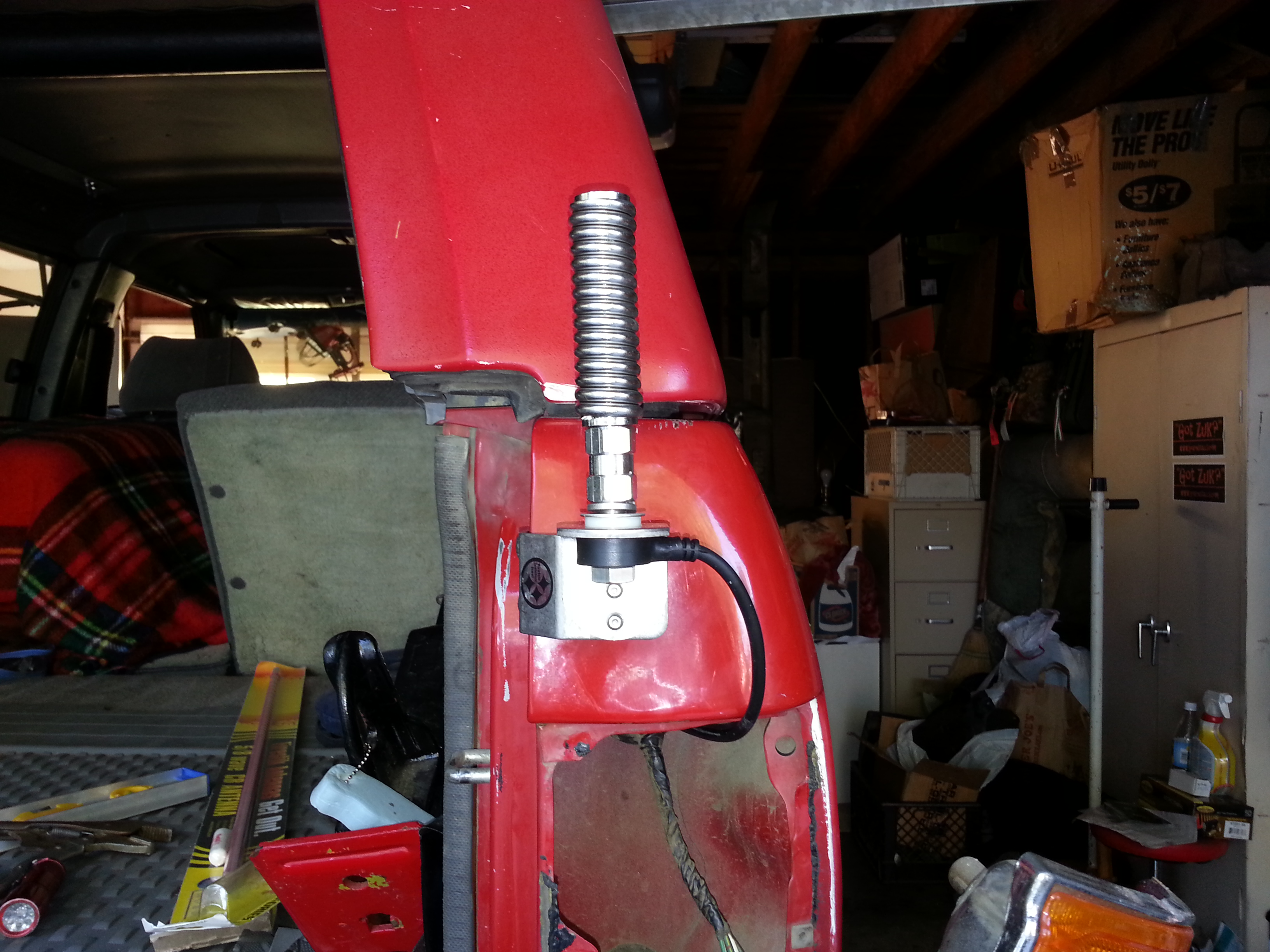

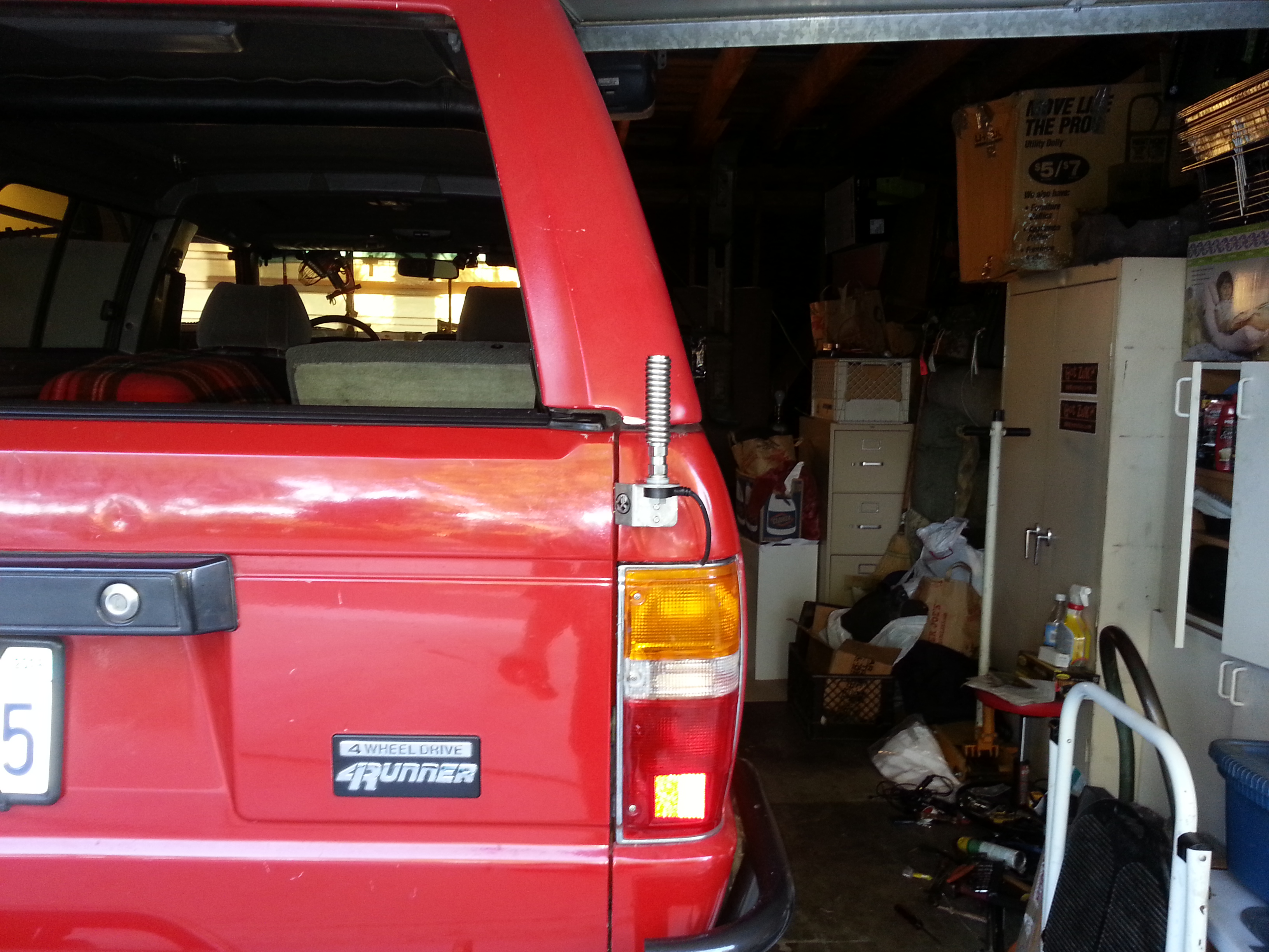

if i can make a suggestion on the inside of the fender where you mount the antenna bracket use the widest flat washers you can or a flat plate drilled to match the mounts holes to firmly crush an hold the body metal securely so you dont get any wobble bending
id mount it a bit lower nearer the top of the tail light as 1. youve got a dent behind the spot (good way to hide it) 2. with the foldover and spring your antenna will be still plenty high over the plane of the vehicle also you want to keep an antenna straight up an down much as possible with the vehicle
if you visualize the radios signal/reception as a giant bowl over the vehicle the antenna can literally angle the bubble one of the reasons why the big rigs lean their antennas forward as it biases the signal an reception to the front

Thanx! So, why would I not want the antenna leaning toward the front/base location? I have no clue, so that is why I ask. Lol.... (is it cuz it will then shell out signal to those behind me more poorly?)
I don't care about the dent.... I really just want the most effective application/INCLUDING HIDING IT BEHING THE SHELLS- 'A'- PILLAR on the pass side.......?????
Thanks so much for your personal experience sharing!
#7409
it will shorten your reception to the rear if you lean it forward now the big guys do it like a massive amount but they want to talk to people out front about road conditions to random DOT inspection stations accidents ect yours wont be too bad but it wont be equal for certain
i was teasein bout the dent but its a good spot

Dragon, you got me thinking with your statement about the big rigs and leaning antennas. Here is some info right from Firestik...bottom line, you should NOT lean your antenna if possible, and if you do, no more than 15 degrees. Apparently the big rigs do it for a couple of reasons which are outlined in the link.
http://www.firestik.com/Tech_Docs/ant-angle.htm
And Chef, if you're worried about the height, to be honest with you, I wouldn't use that bendable thing you bought. The spring is there in case you forget to remove the antenna to go in the garage, the spring will flex and nothing will break, with that bendy thing, it will probably be the weak point and break. Instead of getting out to go around back and bend the antenna, I would just unscrew it and put it in the back of the truck. Just my .02, I know you already bought it and may as well give it a try, but seems no harder to remove the antenna than to fold it over.

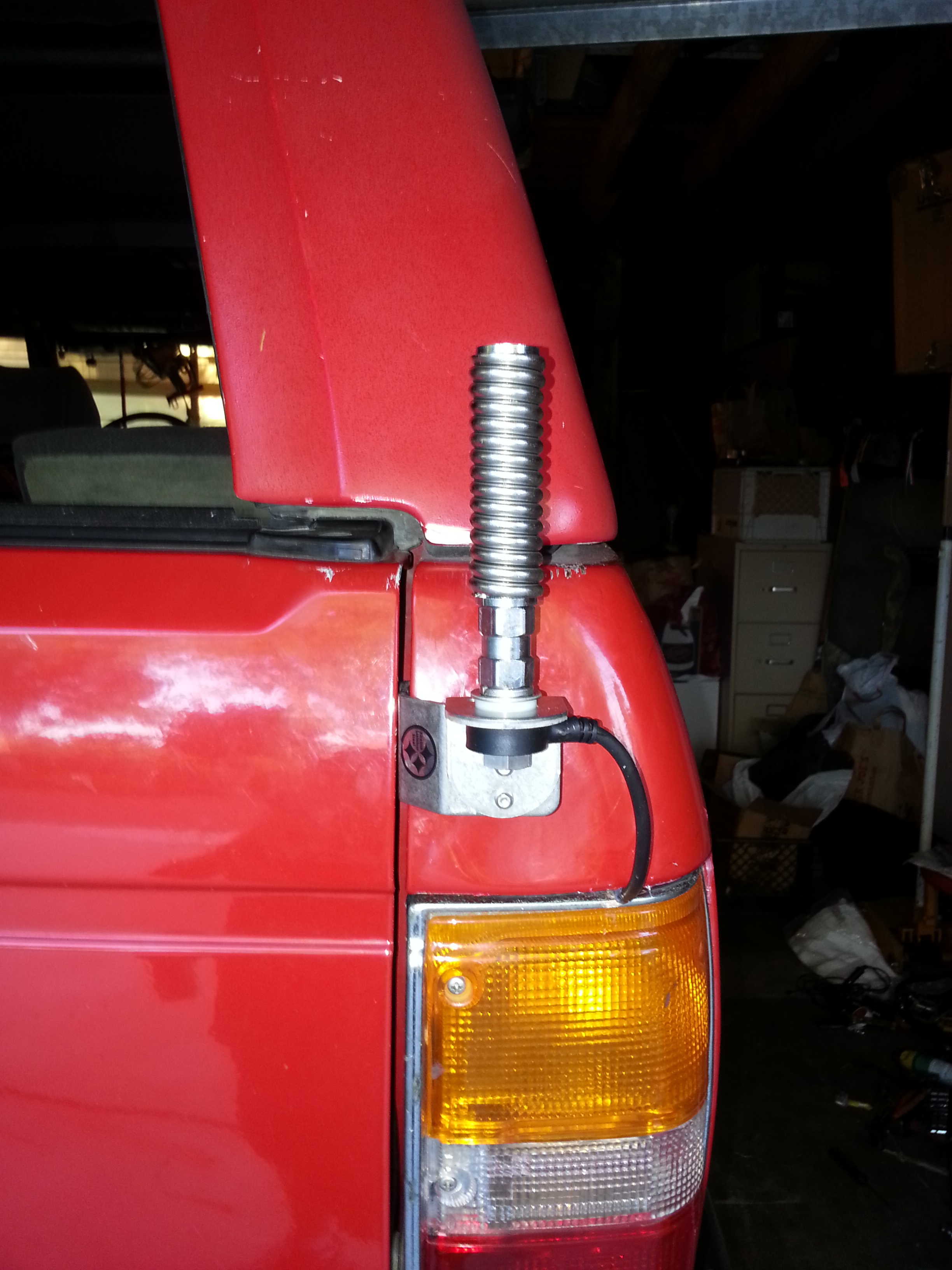

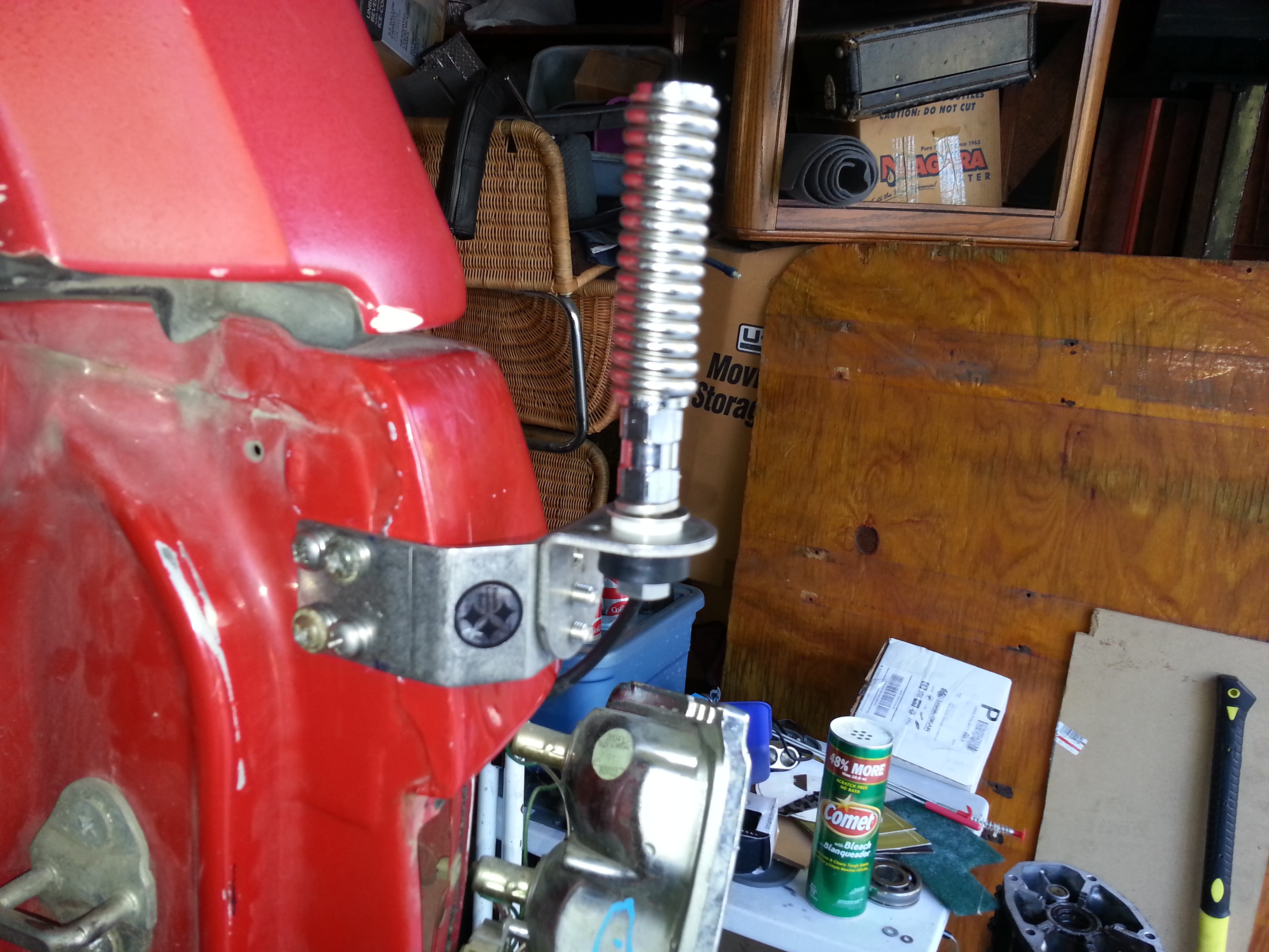

MK-204R FIRERING & DOORJAMB BRACKET KIT INSTALL:
First of all, thank you all for your patience and lending freely your ideas! Two thumbs up, woohoo, alrighty then! Haha... Honestly I'm very appreciative....
So far so good...
I hope you enjoy the videos and pictures... But really its nothing exciting. Hahaha. Although it was kind of exciting for me...
I ran clear rtv in the groove for the coax half portal and around the top... It will not leak! Did you hear me I said it will not leak! Hehehe.
So far so good...

One more thought on your antenna mount, and not that it matters now, but I think if you remove both of those allen screws from the adjustable part, and then put the piece where the antenna bolts behind the other piece, you can then insert the allen bolts from the front so if you ever wanted to adjust the angle of it you won't have to remove the whole bracket. Anyway, don't think it matters now since you have it set where you want it, but from the pics it looks like you could swap it around. Good job on the whole CB install, I really like the whole thing. Once you get the rock lights wired up, we can go ahead and trade trucks since you've just about gotten everything right where I want it.

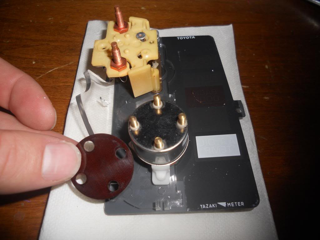

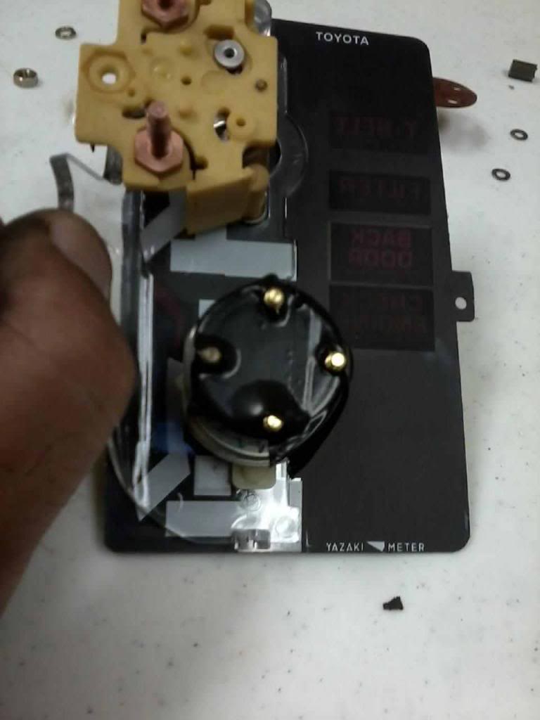

Showing the wire sticking out of the tail light brought back nitemares of teh Uhaul lights that were are in the 3rd post of my 88s build til I seen it was a coax cable for the antenna.
On your Temp guage, it is as bad as my brothers truck was and it works flawlessly now. I can have the whole job done in less then 30 minutes. To make it a little easier and to get some slack in the speedometer cable, undo it from the clip on the firewall under the hood where it attaches to the throttle cable. That will let the guage assembly slide further out to undo the cables and connections.
Inferno shows a disc on his temp guage and the three that I have seen does not have that disc. I dont know if what I did fixed it, by using electrical tape, but what could it hurt? I use an exacto knife to cut the holes for the bolts. I am suspecting your 3 long brass studs/screws are loose. Also give them a good cleaning when you take it apart. I have seen one with green corrosion on it.
Your SR5 Guage is the one that I prefer to work on if I have the choice of buying/selling one. The ones the have the vertical and horizontal lines are harder to get the speedometer needle off to correct the mileage. Just found that out this week while working on a temp guage and some info for you since you sell parts.
If you are suspecting your Tachometer not being correct on its readings, you should get the exact same style as what you have in yours. Just changing faceplates with the other style is really is not an exact swap. There are some fairly major changes in between the 2 styles of tachometers. I am experimenting with one now. They differ considerably in construction.
I would suspect your Dashpot for some of your idling issues. Also recheck that you have no vaccum leaks on the intake. All hoses are not brittle and leaking. Have you burped your system? Raising the front end way up and letting the Thermostat cycle a few times with the cap off? I think you said you have in the past, but I may be confused with someone elses idle issue in the past. Also I have seen the throttle assembly needing a lubed,adjusted on the Peneum and Throttle body.
I think you have mentioned that you coated all of your electrical connections with dielectric grease. Make sure they dont have any green/white powdery corrosion on the contacts as well.
Copied..
I have gotten 2 guages to work. Both of the ones I fixed did not have the insulating piece that Inferno is showing. It may not be on all guages, and I am sure both of mine had never been taken apart.
Top picture is from Infernos thread.
What I did and am not for sure if this fixed the problem, is I used electrical tape to isolate the two pieces, but this thread did get mine fixed. Also I did have the 3 long post loose. I have added electrial tape on both and they are working great. Great thread Inferno!!!
