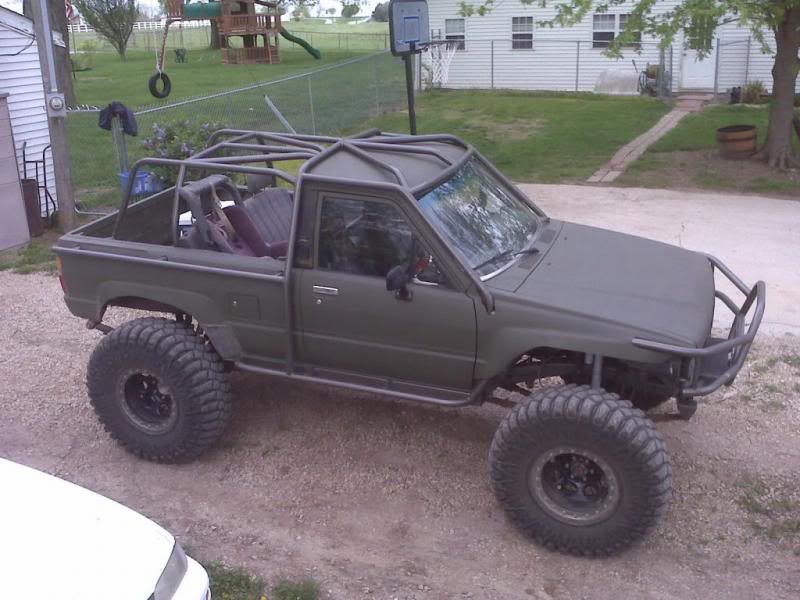

now this is just a pic i found in a 4WD magazine, i have no clue who's truck it is and mean no disrespect whatsover to the owner but for my personal tastes, this exo just has too much tube. I am sure that it would do it's intended purpose though and protect the vehicle and occupants:

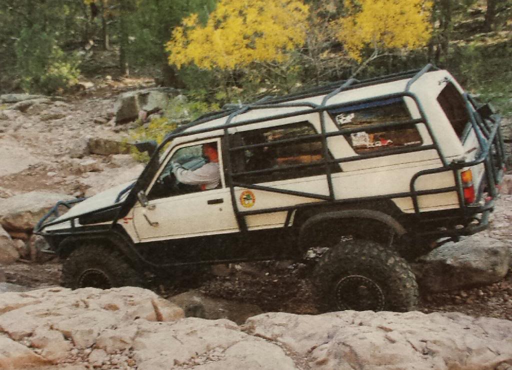

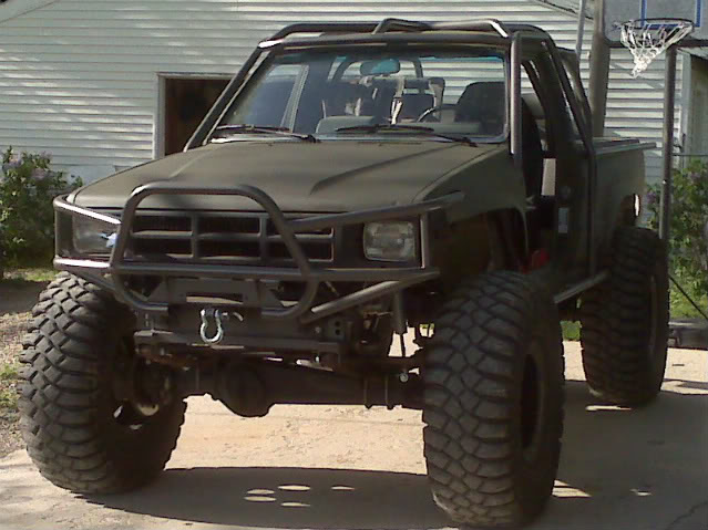

i like the side bars on this one, how the cage was integrated over the rear section wouldn't work for you:
Just throwing these out as ideas..

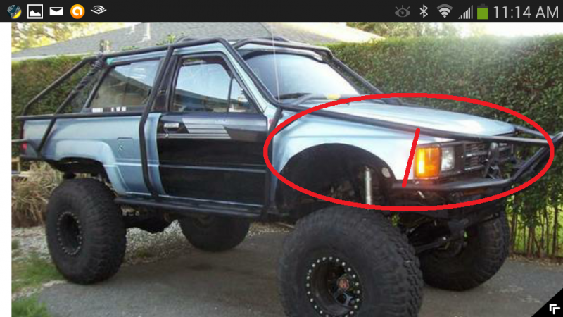

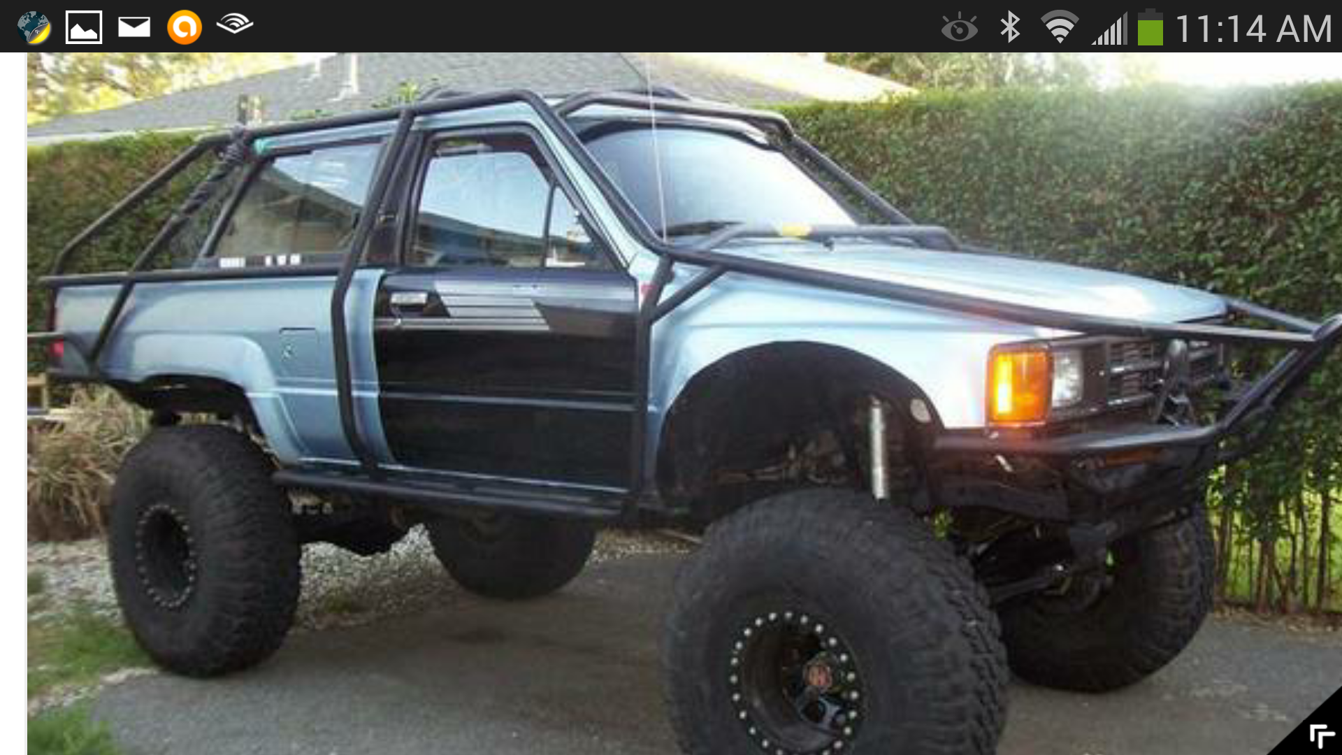

I've read many, and I have a buddy doing a dove thought now that would likely be doing my exo,.... if I do one. I DO intend to continue, and prefer, rock crawling.... I'm sure many are aware of how exhausting it can be over 8+hrs... As can Whoops and 100 miles of higher speeds.... But the latter? It's just too deadly/filled with too much ASSURED totalling of said rigs, by comparison, IMHO... 20 yes ago? DEFINITELY what I was doing, on either my 85 CR500 OR 160 MPH Mustang.... It's STILL fun, but I just don't have the desired to run that realm, full time, any longer, ya know?
Robb, I totally agree! I hate the thought of the jungle gym aspect on my girl... But, ...... It's now a very capable and being very much used crawler.....AND, while I may be a fairly cautious crawler that is not trying to "only flop once, max, a year".... It can very well happen, no matter how careful I am. My buddy in WYOMING, just the other day, cruising carefully up a trail, reached the other side of a 5ft diameter boulder,....And what happened? Well, if you guessed The Rock this large flip back and snapped his rear axle in half before flipping him on his driver side... You would be correct. ANY THING can happen. So, considering I want something safe, yet with a nice body... ; While it might seem the internal cage would be the way to go for me... I just really don't want to give up the room, nor run the risk of even another side flop that would lead to this type of carnage. It may not happen right away, and in which case I will just have to limit the risk that I take... But I think I can come up with something tasteful yet effective. I think I agree with you on that one being just too much.
I have a few I wanna post up from craigslist. 1 of them is really nice.......
Here is one for now...
I was thinking of starting another thread for this resurrection. What do you guys think? Or should I just keep it all here and go for 500 pages? Lol.

i think having a rebuild/resurrection/part II thread is a good idea.
the 4runner you pictured looks incomplete to me. It might be how the front bar extends out so far with out any real support on its route to the stinger..tubing looks to be kinked in a few spots
Agree. Both on Part II & the missing cage member.
I like that one. Does not look like jungle gym (LOL!), yet has the protection for both body and bodIES.
And unlike the one with bar penetrating the fender, it preserves the body. If attachment are all don to frame, I'd hope cage can be removed fairly easily so body remains stock.

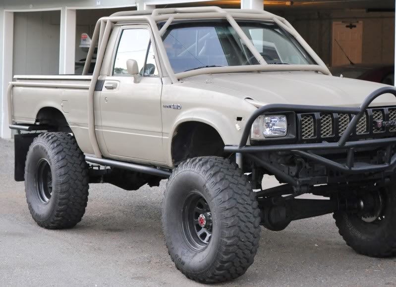

with the exception of the dash/under windshield bar I really like this cage:
I think it may be difficult to swap the windshield with this particular design

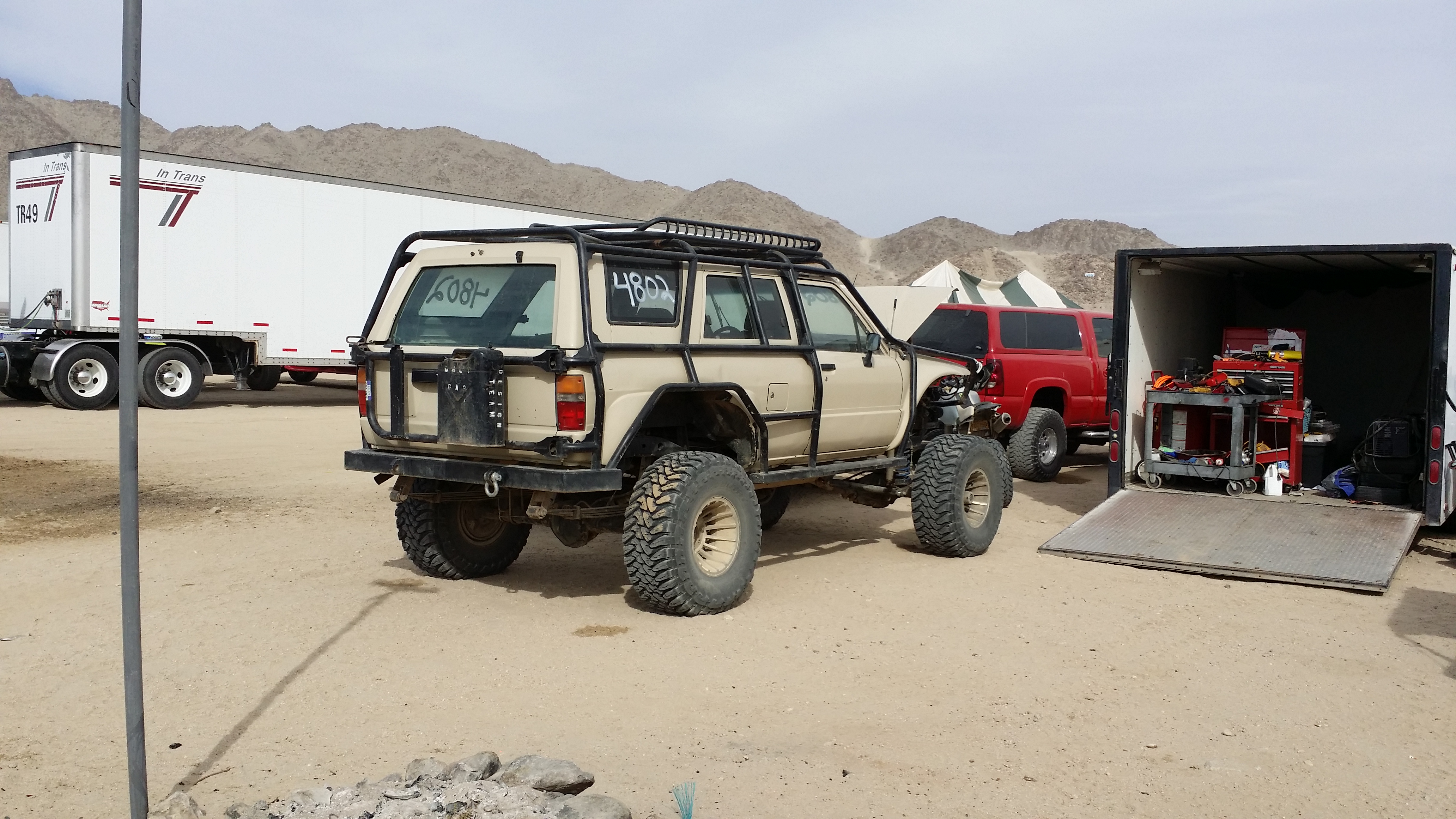

edit: just saw this one Mark from your KOH album..
actually not too bad
