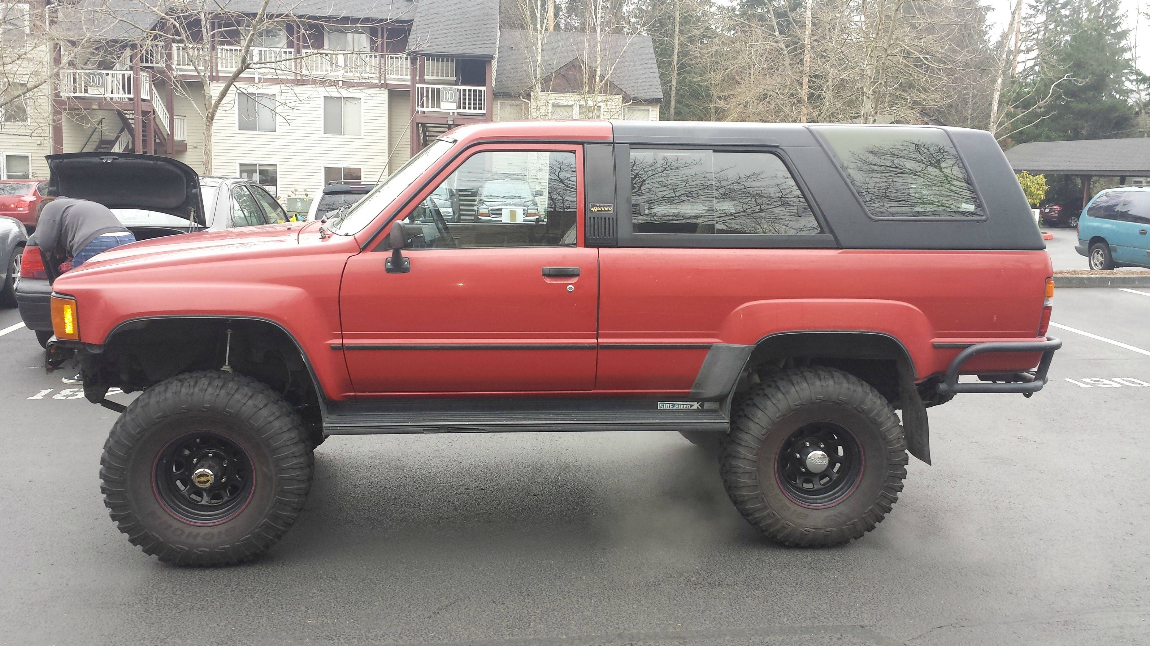

Condition of the truck when I bought it:
  • 281,000 Miles
  • New 22RE long block with 16,000 miles
  • W56 transmission with new clutch
  • Various engine work done at the time of new block
  • 4.88 Gears
  • Eaton TrueTrac rear locker
  • Warn Hubs
  • 4" Pro-Comp suspension lift
  • 33" Maxis Big Horn tires
  • All-Pro 1st generation rear bumper
Guy I bought it from works overseas and even though he'd poured over 8k into building up this truck for the trails he never used it and therefore put it up for sale. He was asking 6k and I got him to take 5 cash. Even with that amount of money thrown into it, the truck does need quite a few things.
