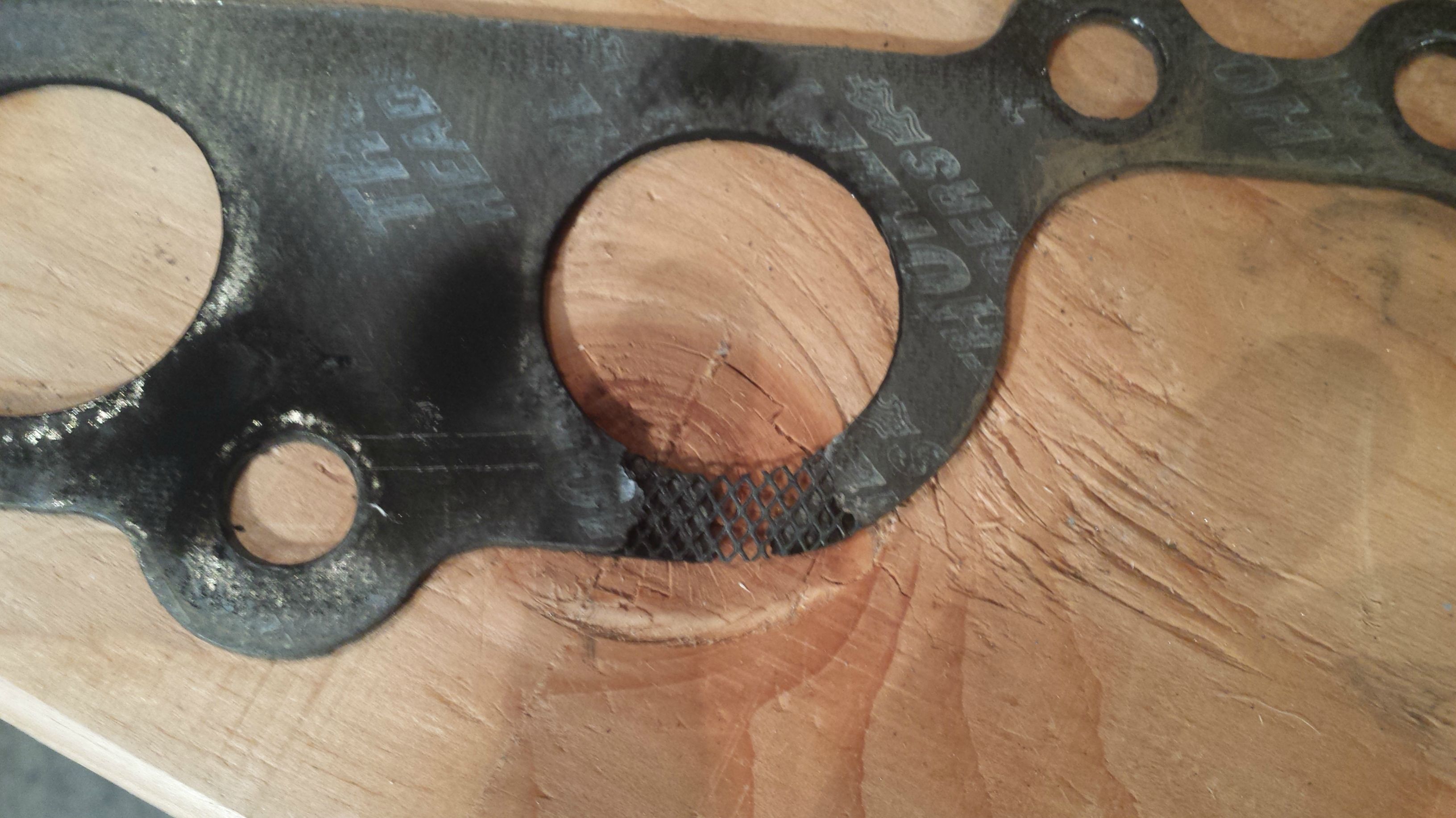

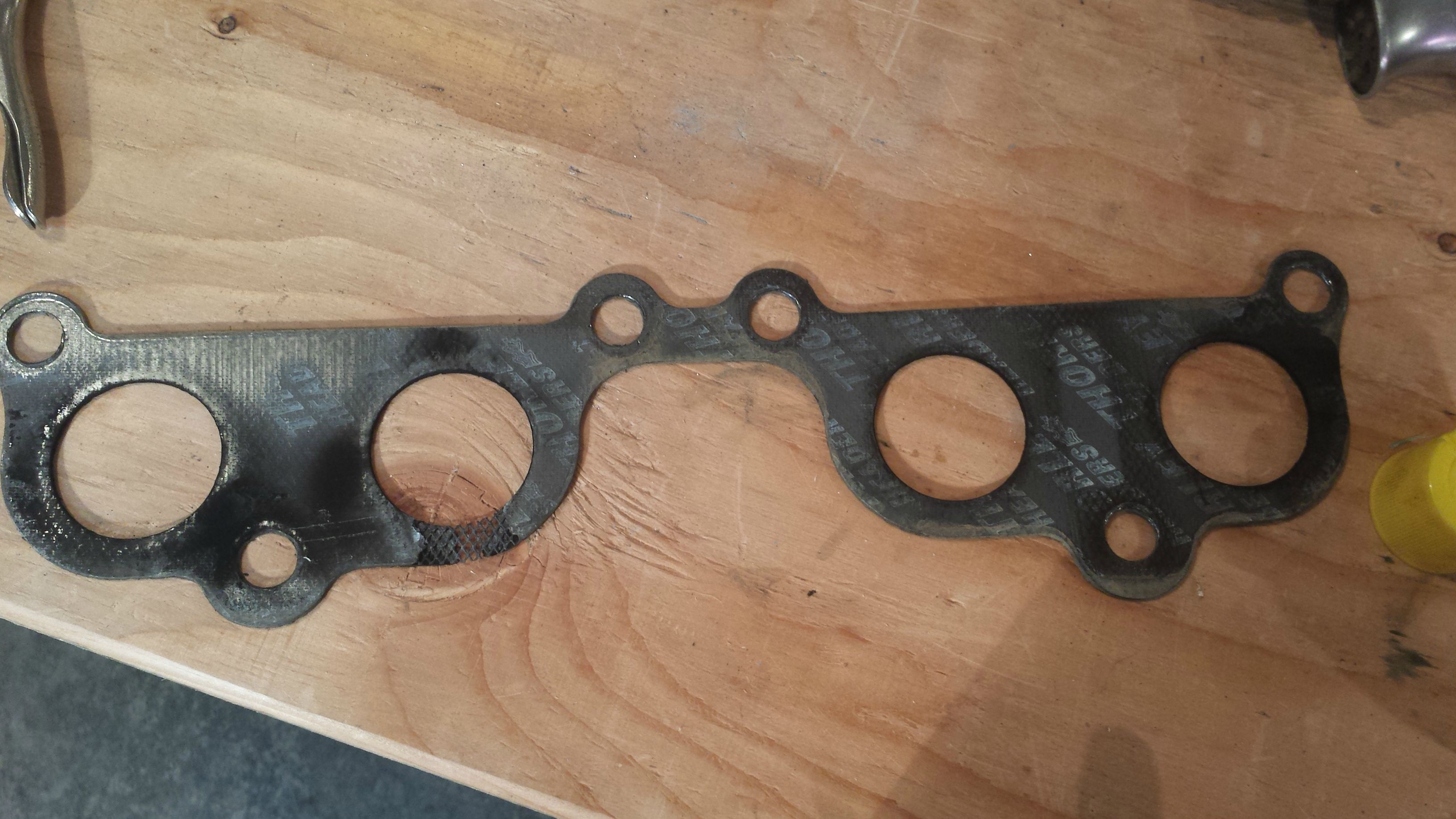

Header gasket has been replaced and my exhaust leak tick has gone away. The one that was in there was in terrible condition with a huge blowout in the lower left.

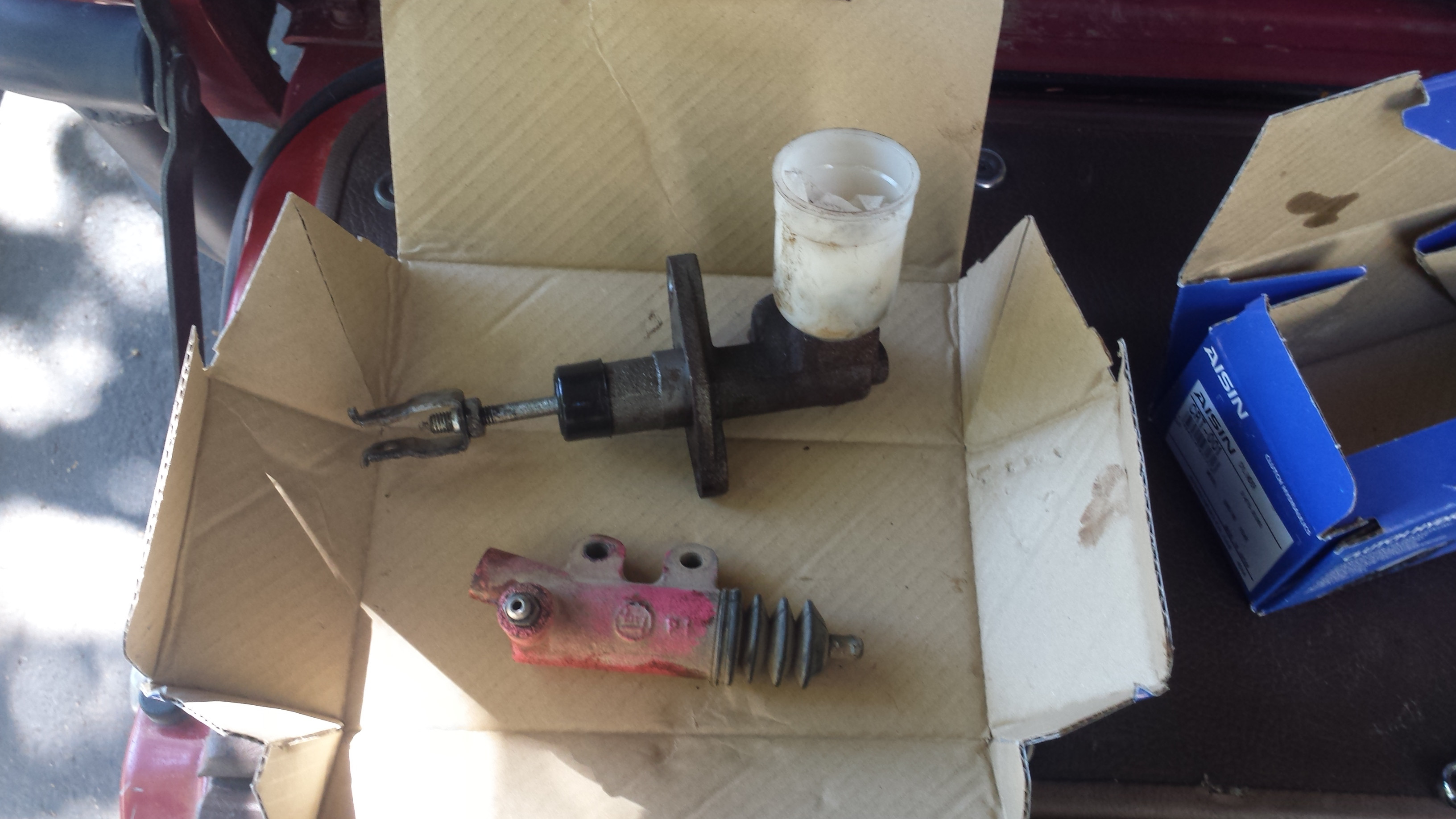

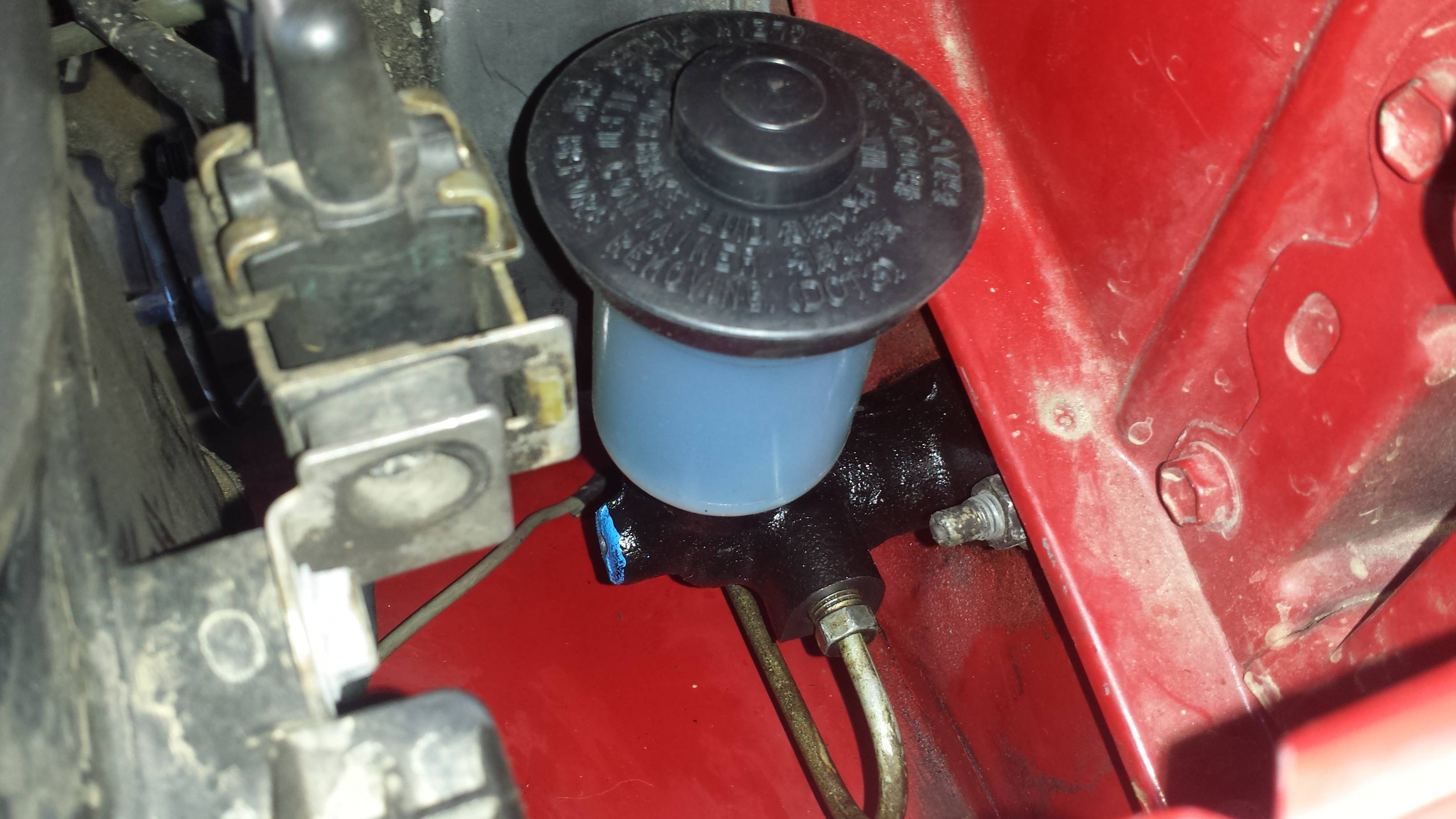

Well I have some maintenance planned for the truck in the coming weeks. As well as some more fun stuff as well. First up was to address a difficulty shifting I've had for some time that I think I solved today by replacing my master and slave cylinders.
17. Hard to shift, especially into 1st and reverse. Likely a bad slave/master cylinder (Remove/Replace)

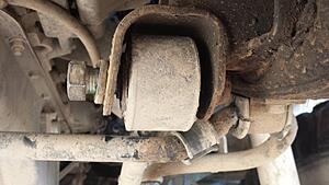

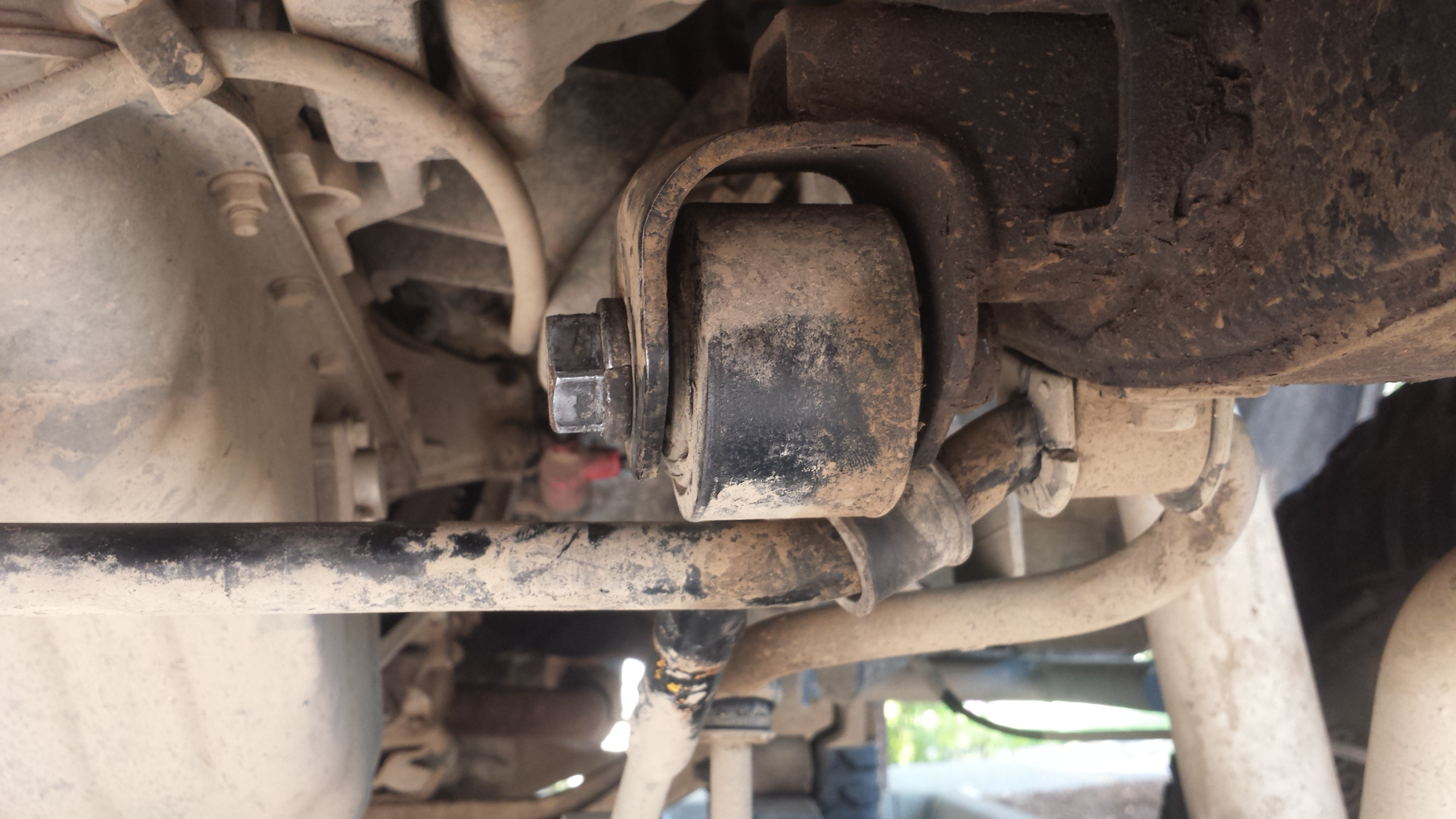

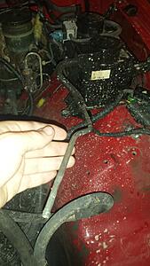

I've also had a popping noise coming from my front end when doing hard turns. I believe I found the culprit today. My torque rod's forward most bolt has come completely undone. I'm going to just pull the torque rod as a lot of guys do it for more flex anyways. I won't be needing it anyways pretty soon. Hint Hint

The one problem I had when I removed the torque rod after the lift was MAJOR brake steer. I suggest re-torqing it down until you go histeer.
Old Sep 15, 2014 | 10:35 AM
  #196
SqWADoosh's Avatar
Joined: May 2013
Posts: 767
From: PNW
Yeah problem is that the bracket is bent as you can see in the picture there. It is making it so that the bolt will not thread. Maybe I'll see about bending it back and putting the rod back together.

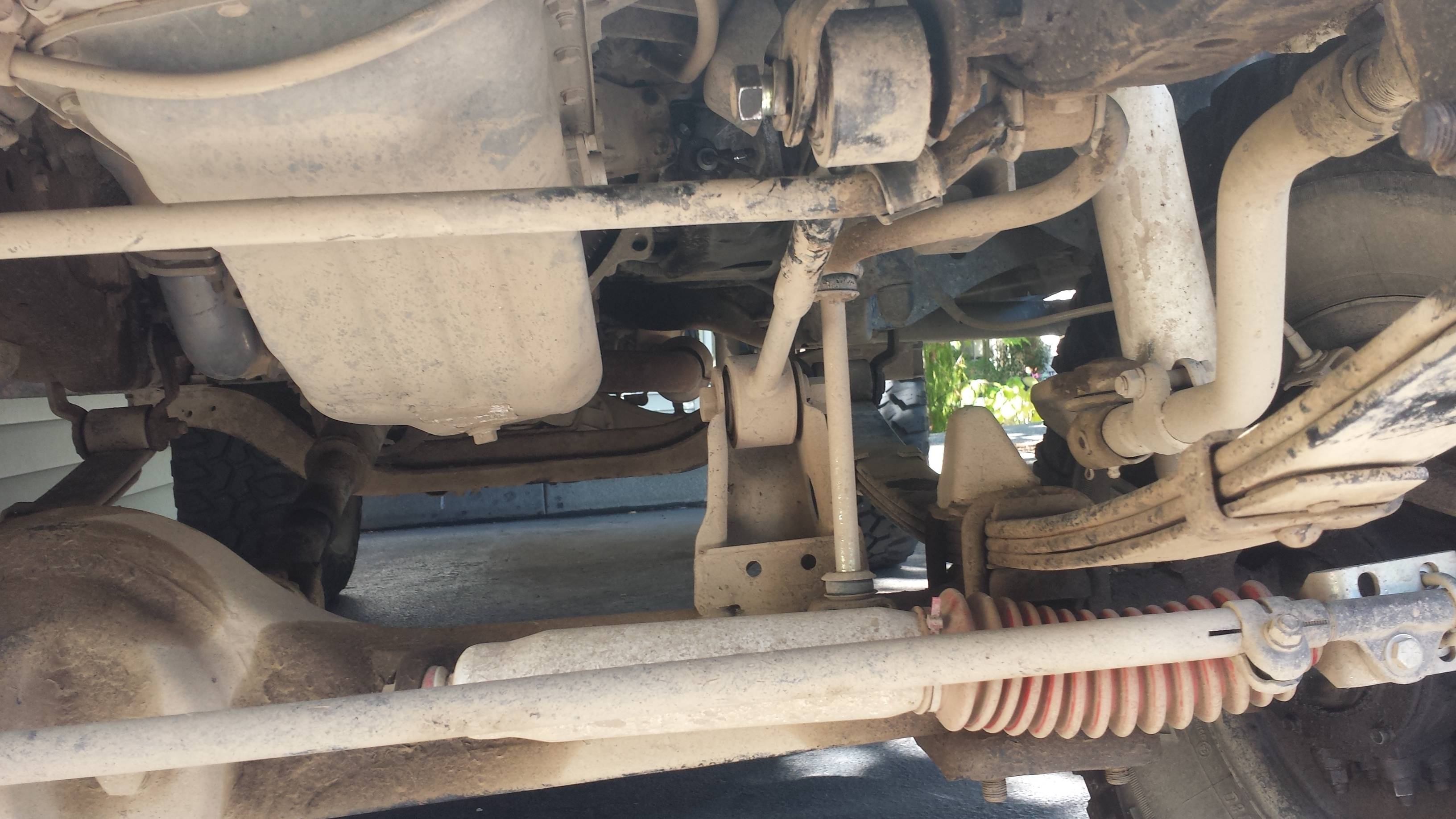

Took taking the weight off the springs to get the bolt to thread. Thanks for the input and keeping me safe from myself fellas
