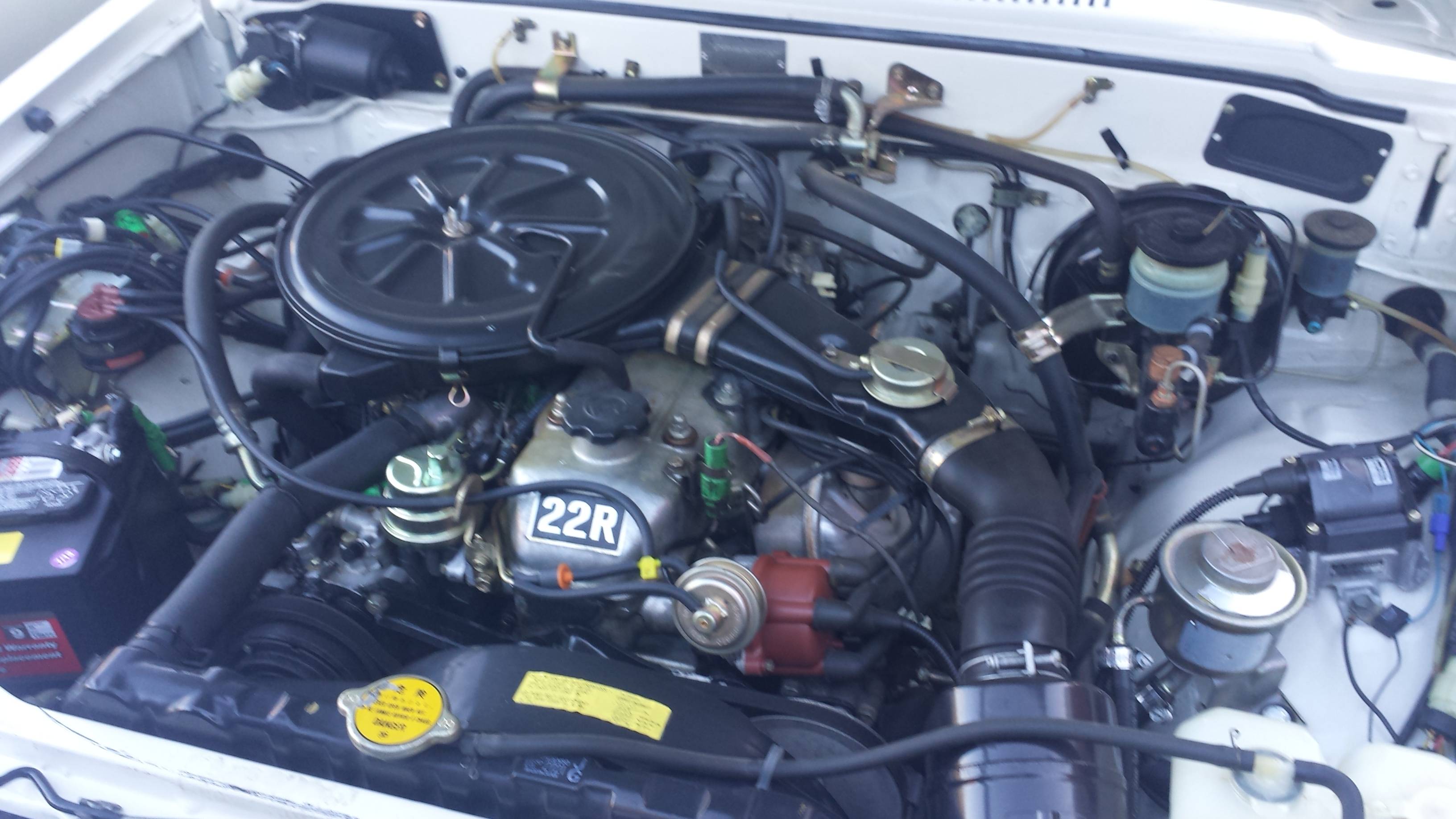

While I was at the alarm/stereo place they showed me another customer's amazing 1st gen pickup. Check this beauty out!
Only 64k on the clock! The pictures do it no justice. The truck was beautiful!

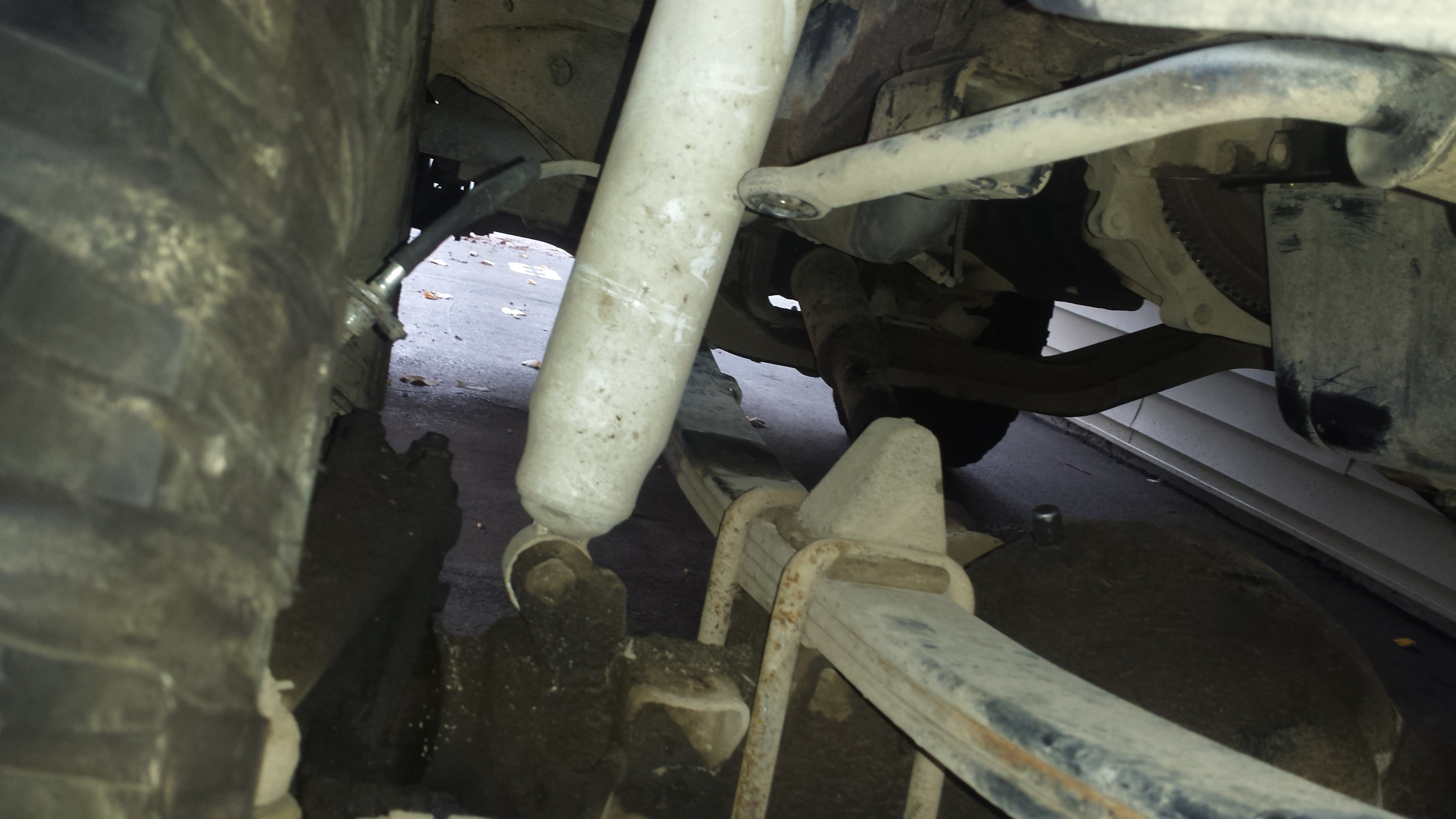

Well I removed one of the bolts from my sway bar in prepration for a wheeling trip tomorrow. Can any of you guys tell me if this is enough to get the extra articulation or do I need to remove the bolts from both sides? I imagine since 4crawler sells the disconnects this is enough?

i think that should get you what your lookin for, but i'd disconnect the anti-wrap bar to if you really want it to flex.

I'm not familiar with the anti-wrap bar. Do you mean the torque rod?
yep. makes a lot of difference for flex. you can see my quick-disconnect HERE: https://www.yotatech.com/forums/f198...l#post51874396

Looks great. Care to share how you made it? Looks like you have a different rod than stock too? Do you have a quick disconnect on both ends or just let it hang there while you wheel?

its just a 5/8" hitch pin, you can get them at most hardware stores, home depot, or even harbor freight. shoot you could even use a standard style pin for a tow hitch, which can be bought at walmart. my torque rod is just a "dropped" one that came as part of my dropped draglink kit, but it would work the same with the stock one. i left the mount on the frame side untouched, i just tie the bar up out of the way when i wheel. i planned on building tab to mount it when disconnected but i never got it done.
the stock steering system has actually been pretty hardy for me, i've been wheeling it hard for about 4 years now and i've never had any issues, other than its flex limitations. I would recommend reinforcing the j arm though. i just welded on some 1/8" thick angle to it, its crude but its never broke haha. you can kinda see what i did here: https://www.yotatech.com/forums/f198...l#post51962477
