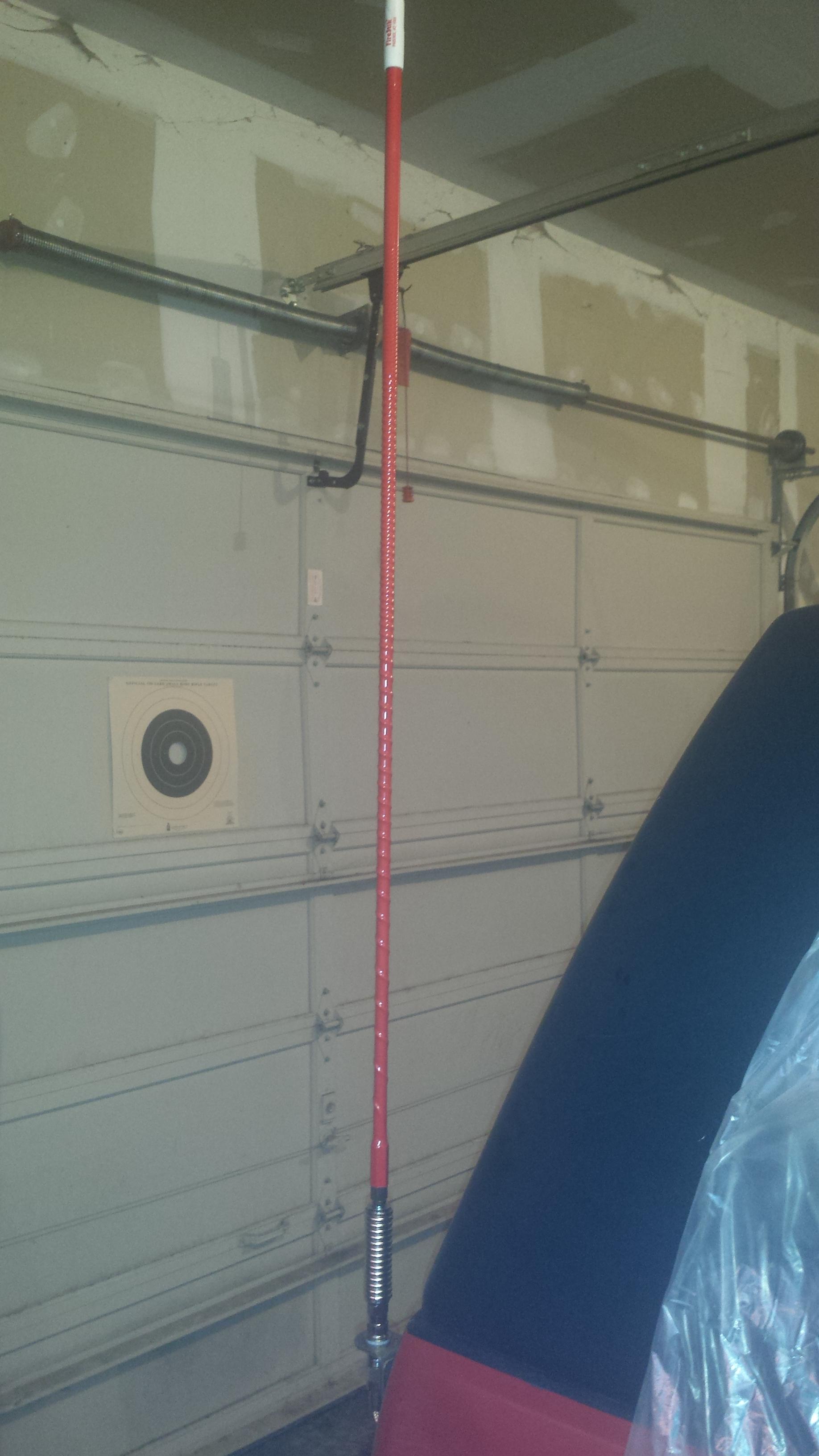

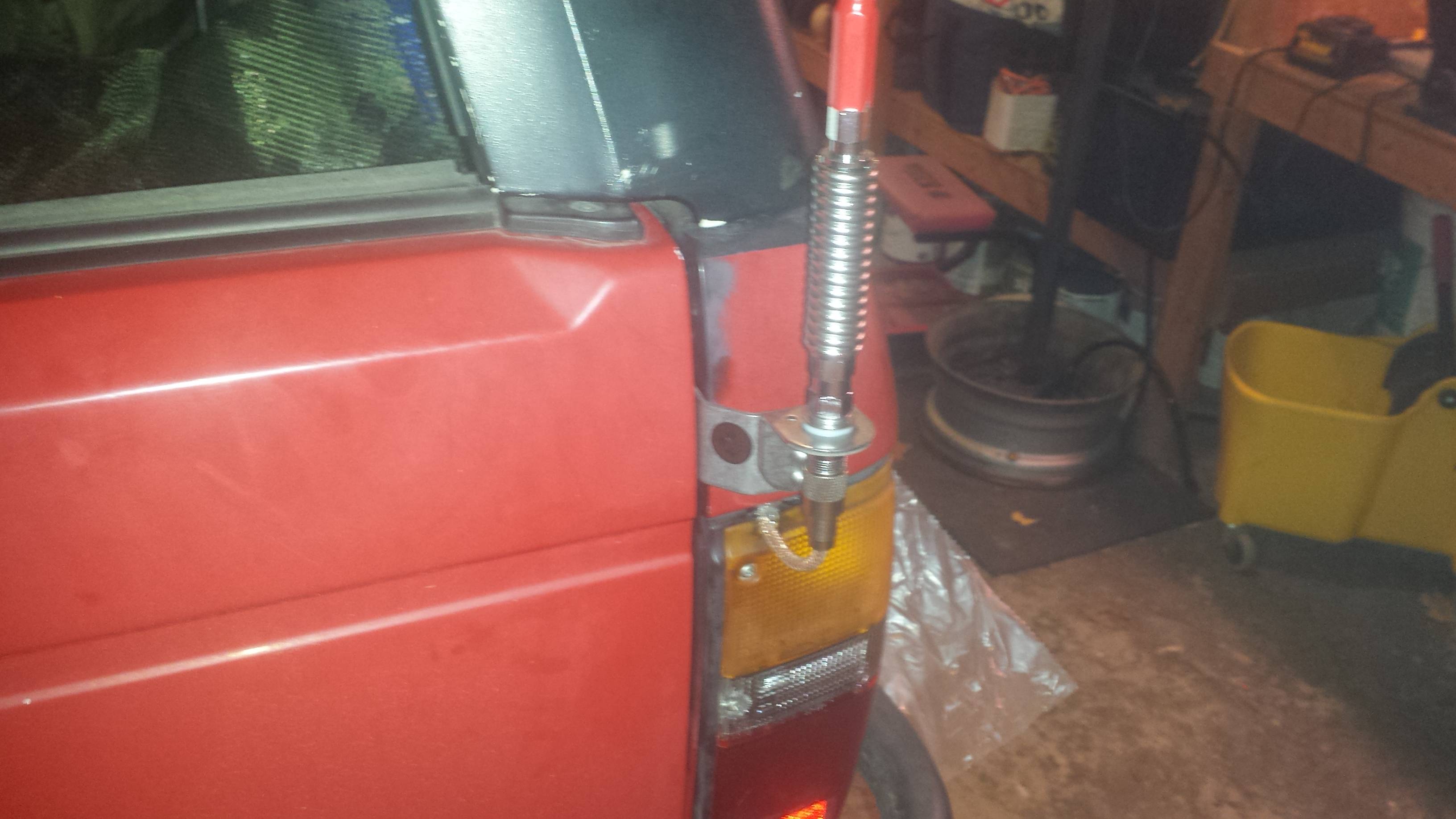

14. Add CB radio and antenna (
Cobra 18WXSTII Cobra 18WXSTII
FireStik II 3 FT antenna FireStik II 3 FT antenna

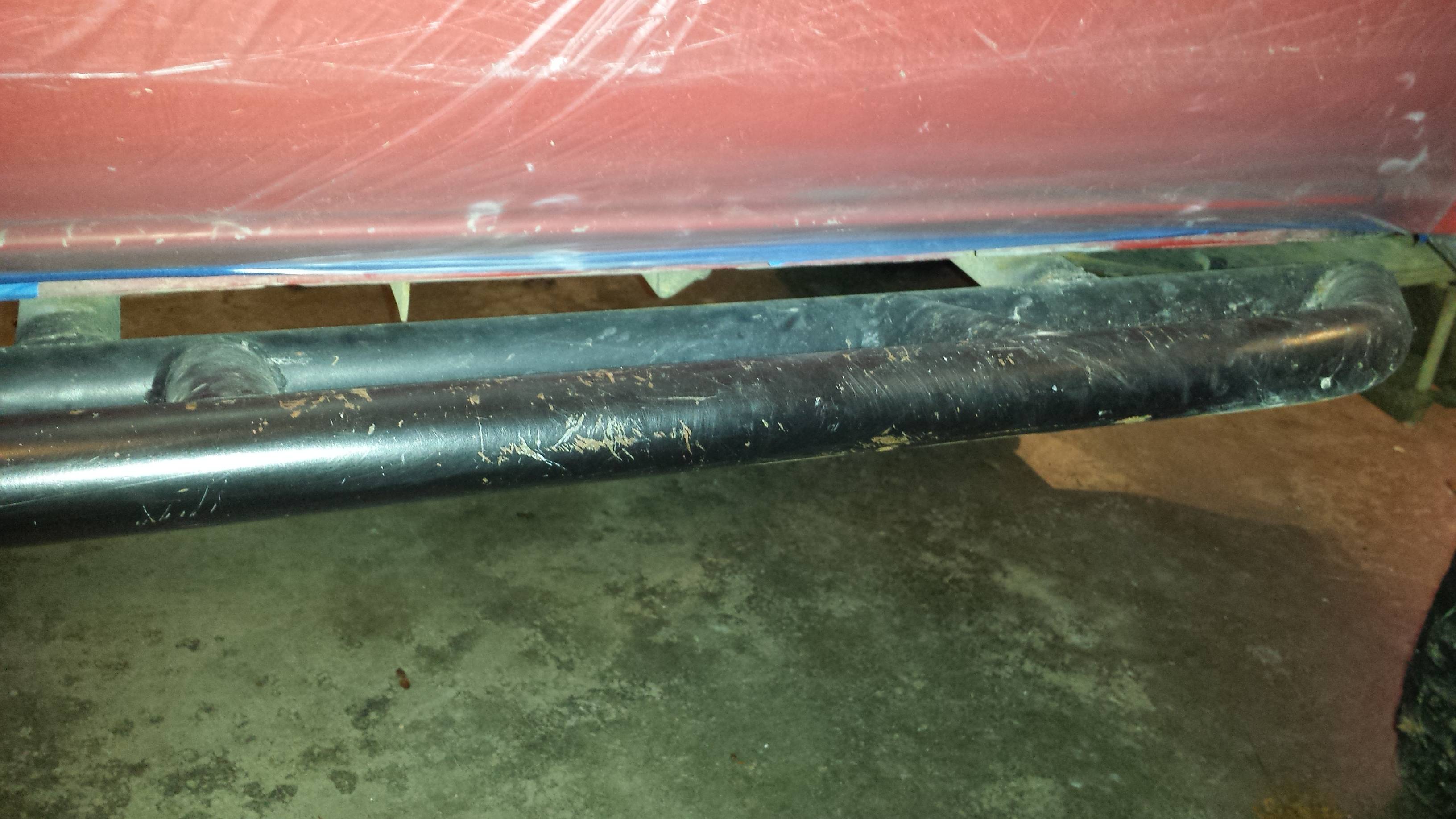

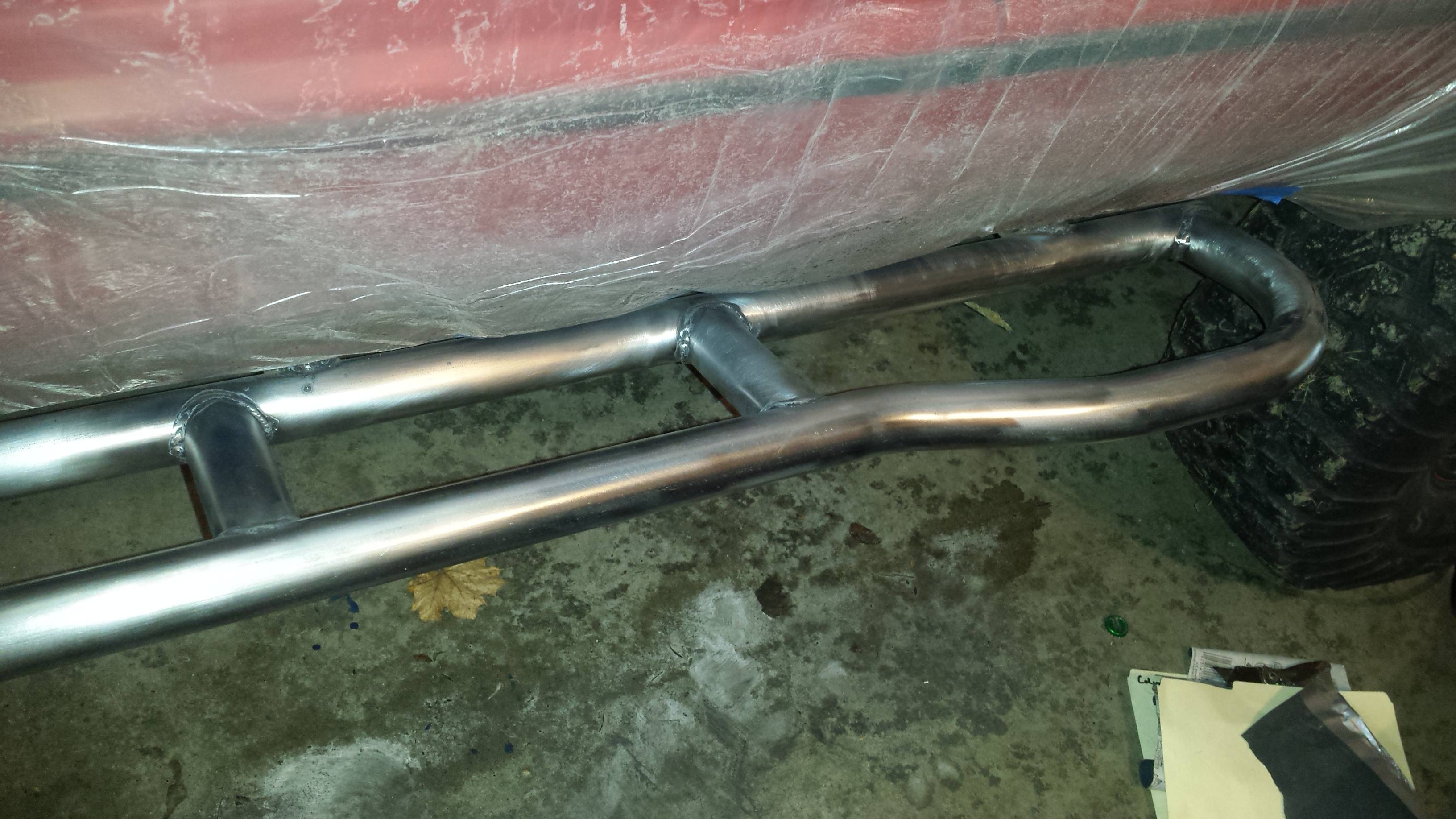

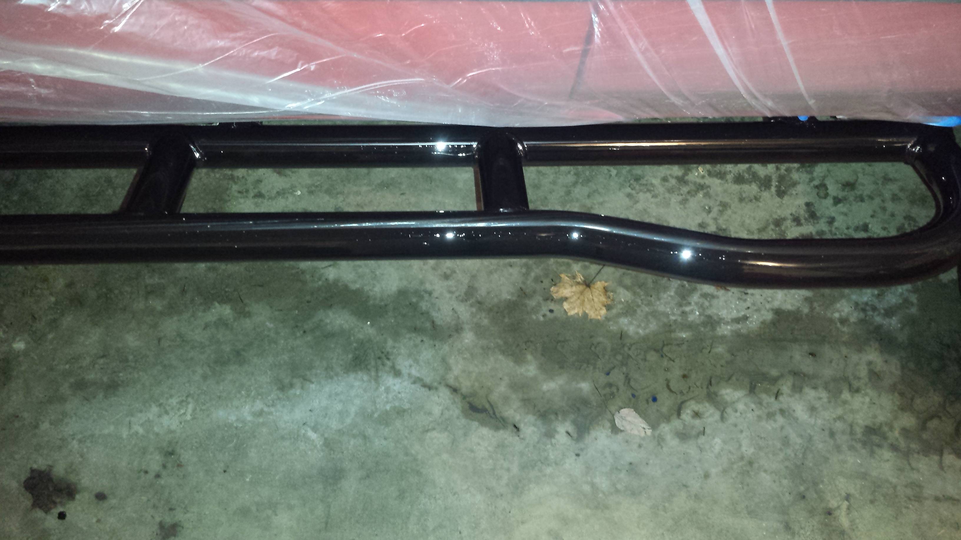

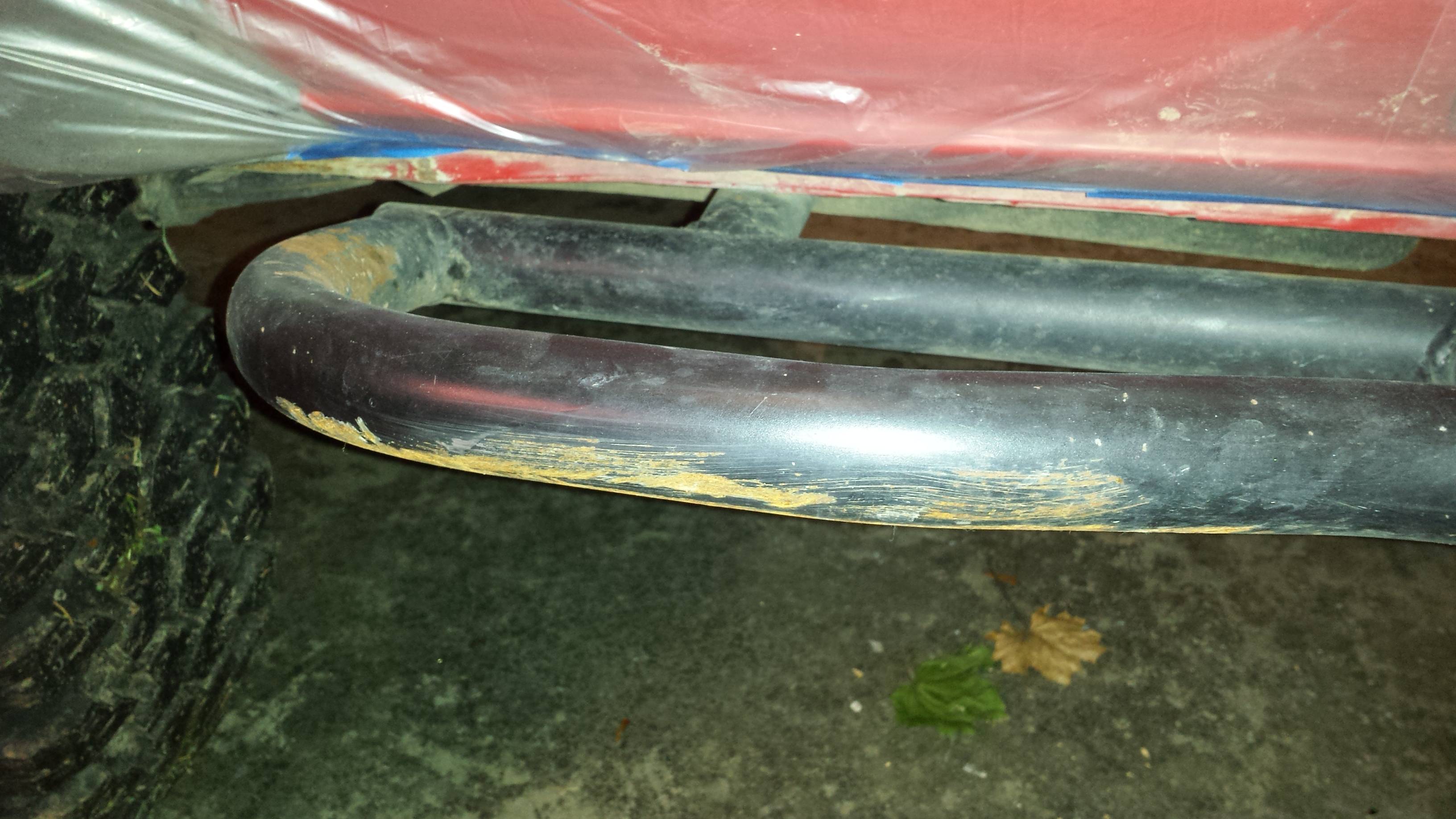

20. Strip sliders current paint and replace with POR-15 and POR-15 top coat(
POR-15 POR-15
POR-15 Top Coat POR-15 Top Coat
The sliders took forever to strip by hand. I will be employing a family friend's sand blaster when I do my front and rear bumper.

lookin' good. sliders turned out great, i need to start using that paint cuz my bumper is a mess. any pics of the cb installed?

That is actually not a true representation of the final product. That is just the POR-15 only. I also put on a top coat that is a flatter black. I will take some pictures of the CB installed today.

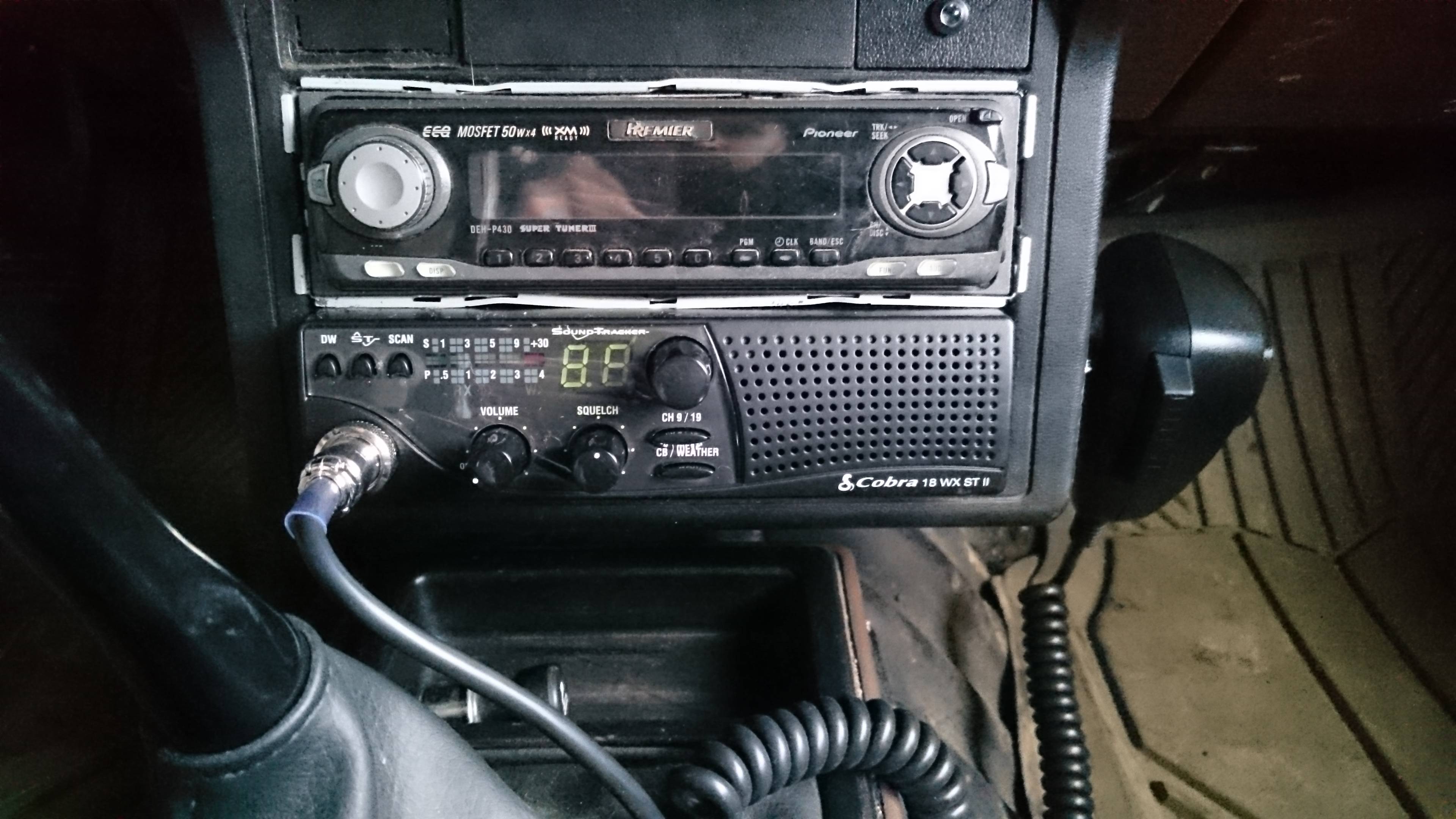

Added a picture of the radio installed to the above post. It did require some filing however not very much. I just filed until it fit tight. Its not being held by anything other than the tight fit into the slot.

Nice work on the CB install, it looks clean sitting under the stereo, like it was meant to go there from the factory!
Old Jan 6, 2015 | 08:29 AM
  #315
SqWADoosh's Avatar
Joined: May 2013
Posts: 767
From: PNW
Thanks man. I need to find a clearing to put a better tune on the antenna. I tuned it in the driveway of my father in law's place and it was surrounded by trees.

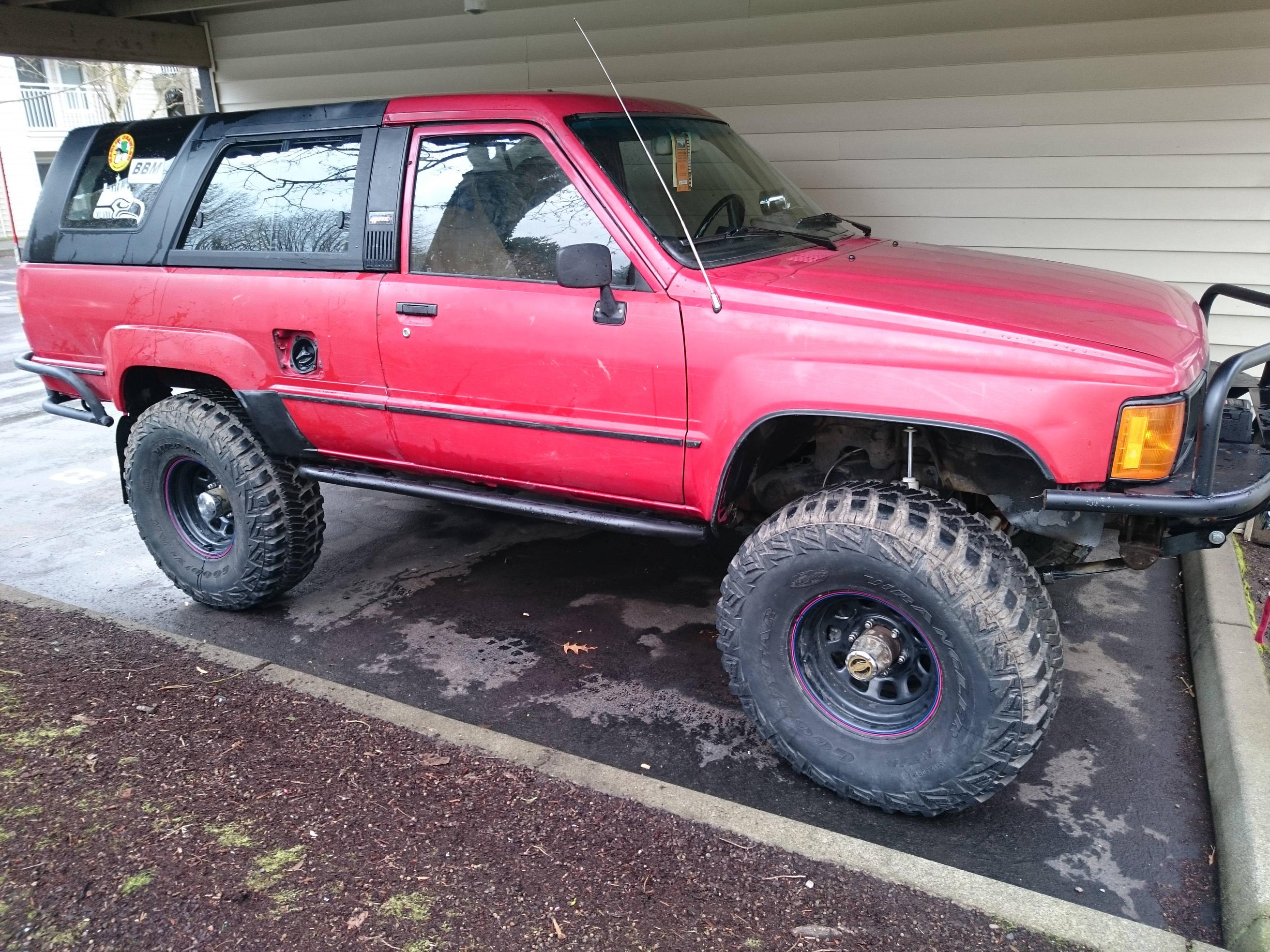

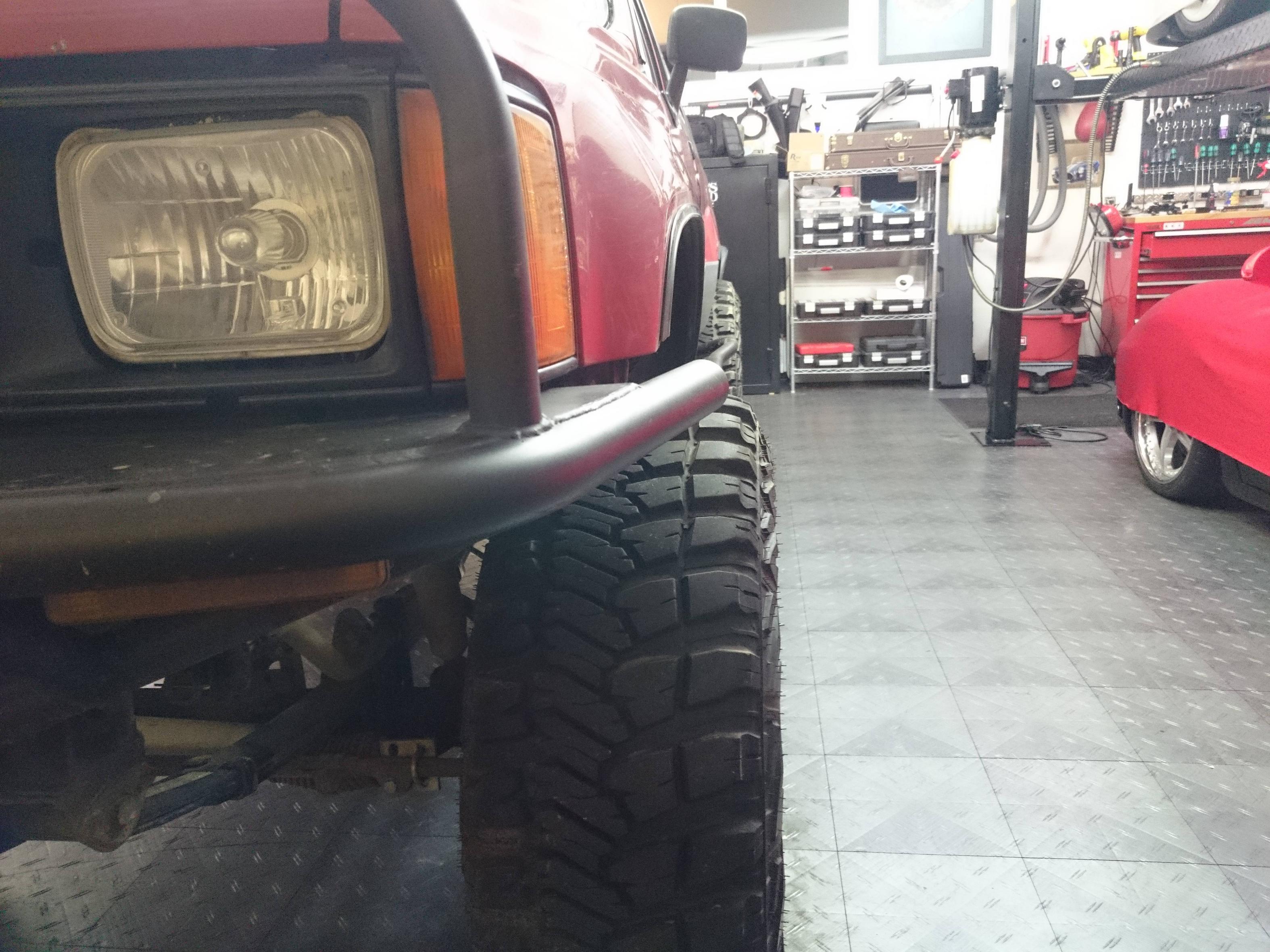

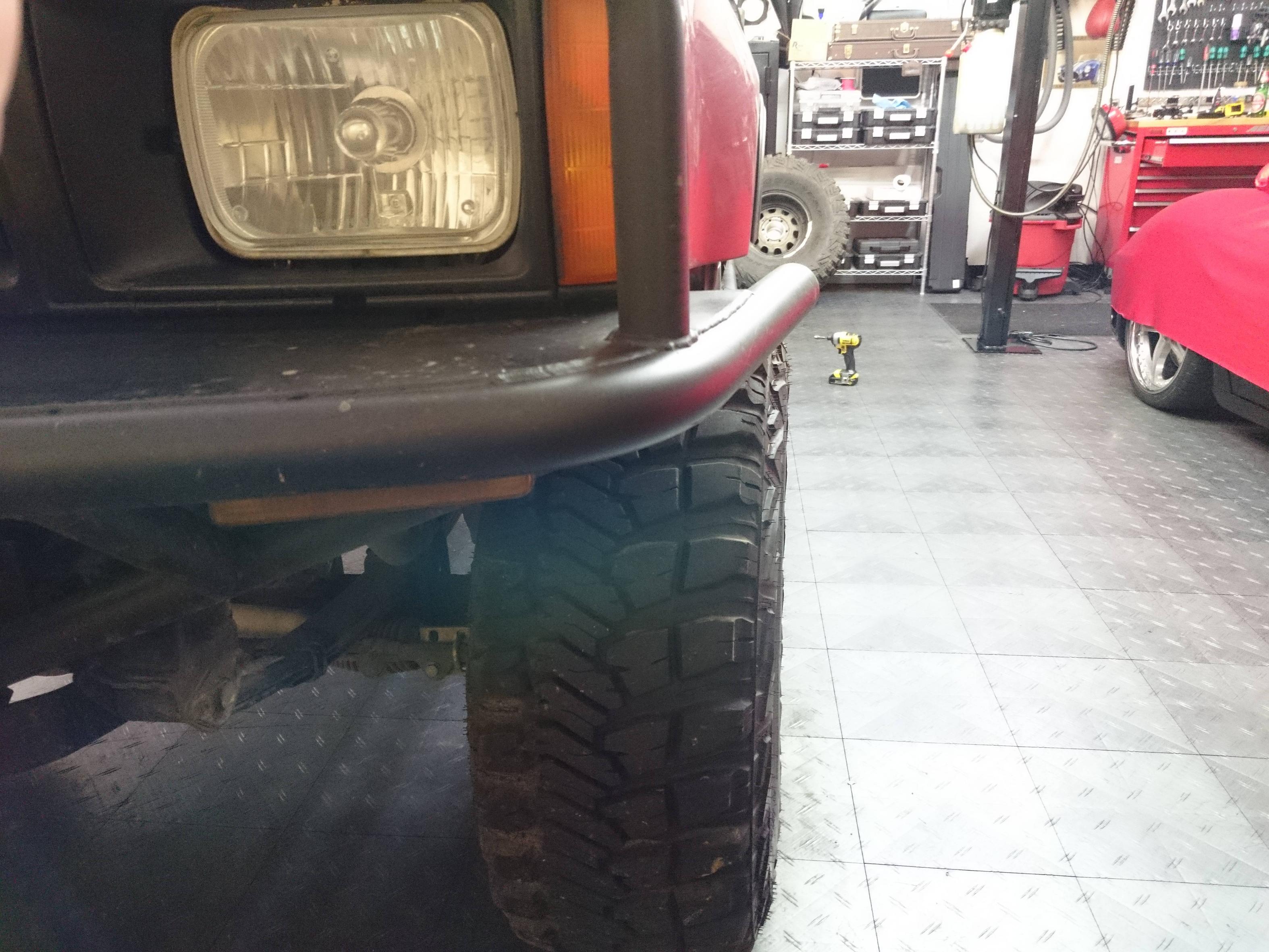

15. Upgrade tires (Goodyear MT/R Kevlar 35x12.5x15)
Got myself an absolute steal on some new rubber this weekend. Truck is sitting on 35s now fellas.

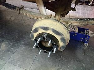

16. Add 1.5" wheel spacers (G2 Wheel Spacers)
Before:
After:
No more rubbing for me!

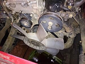

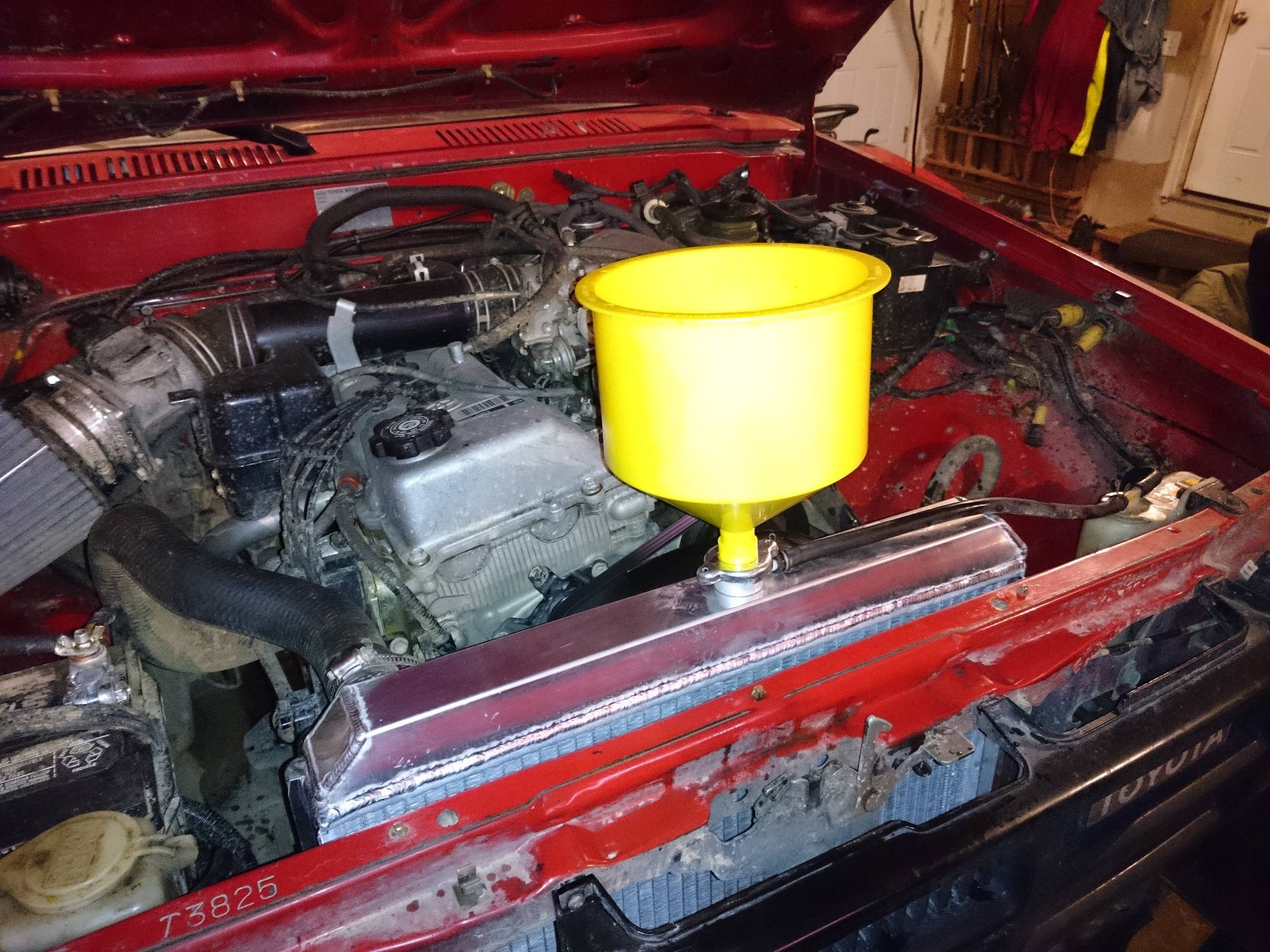

17. Replace tired stock 22re radiator (All Aluminum Nippon)
Got the shroud and old radiator out.
I have to say the 3RZ has this amazing drain nipple for the block which made draining a breeze!
The new radiator had a bent mounting bracket that I had to take the vice grips to. Got it bent as straight as I could and the radiator mounted right up.

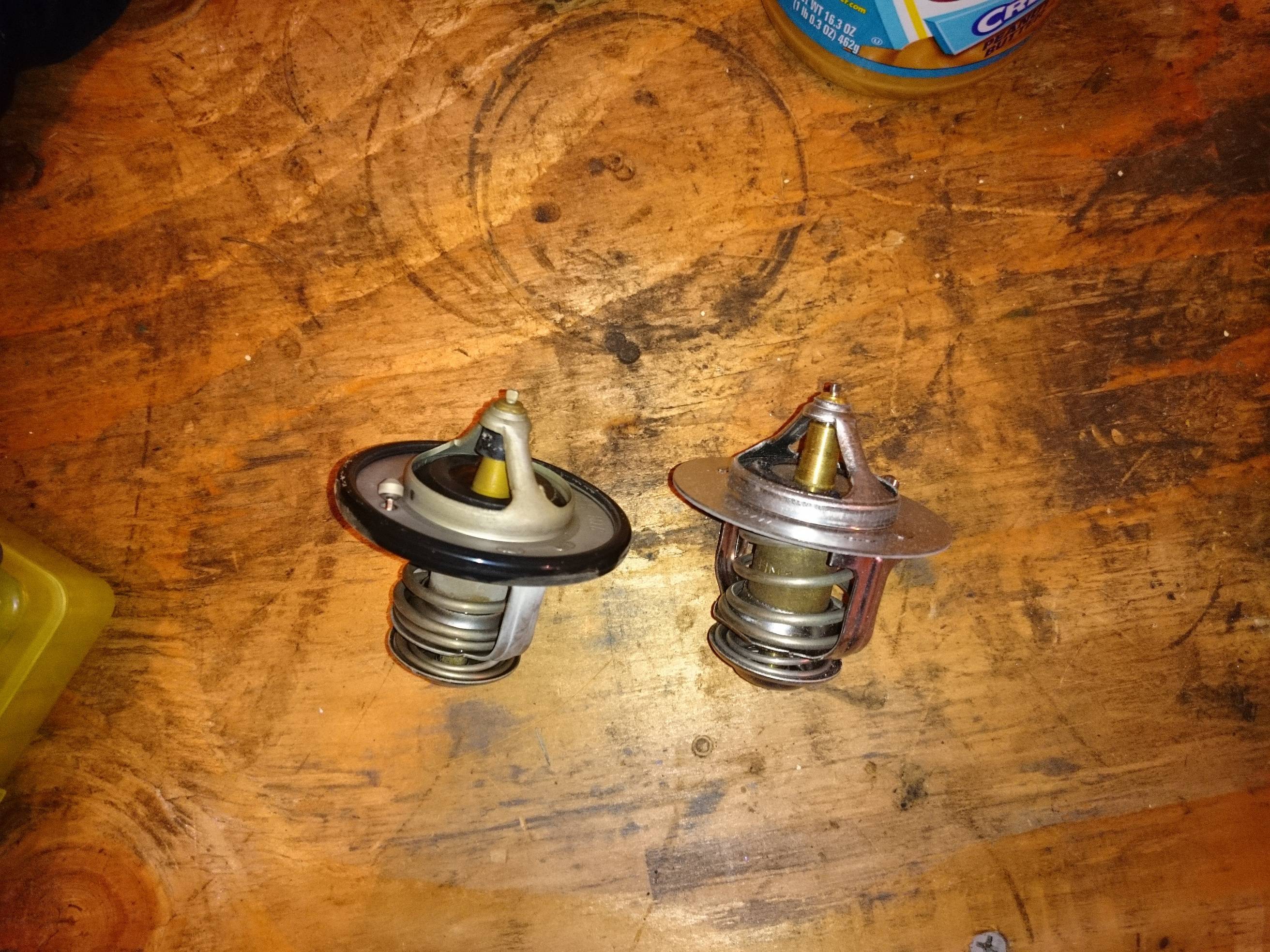

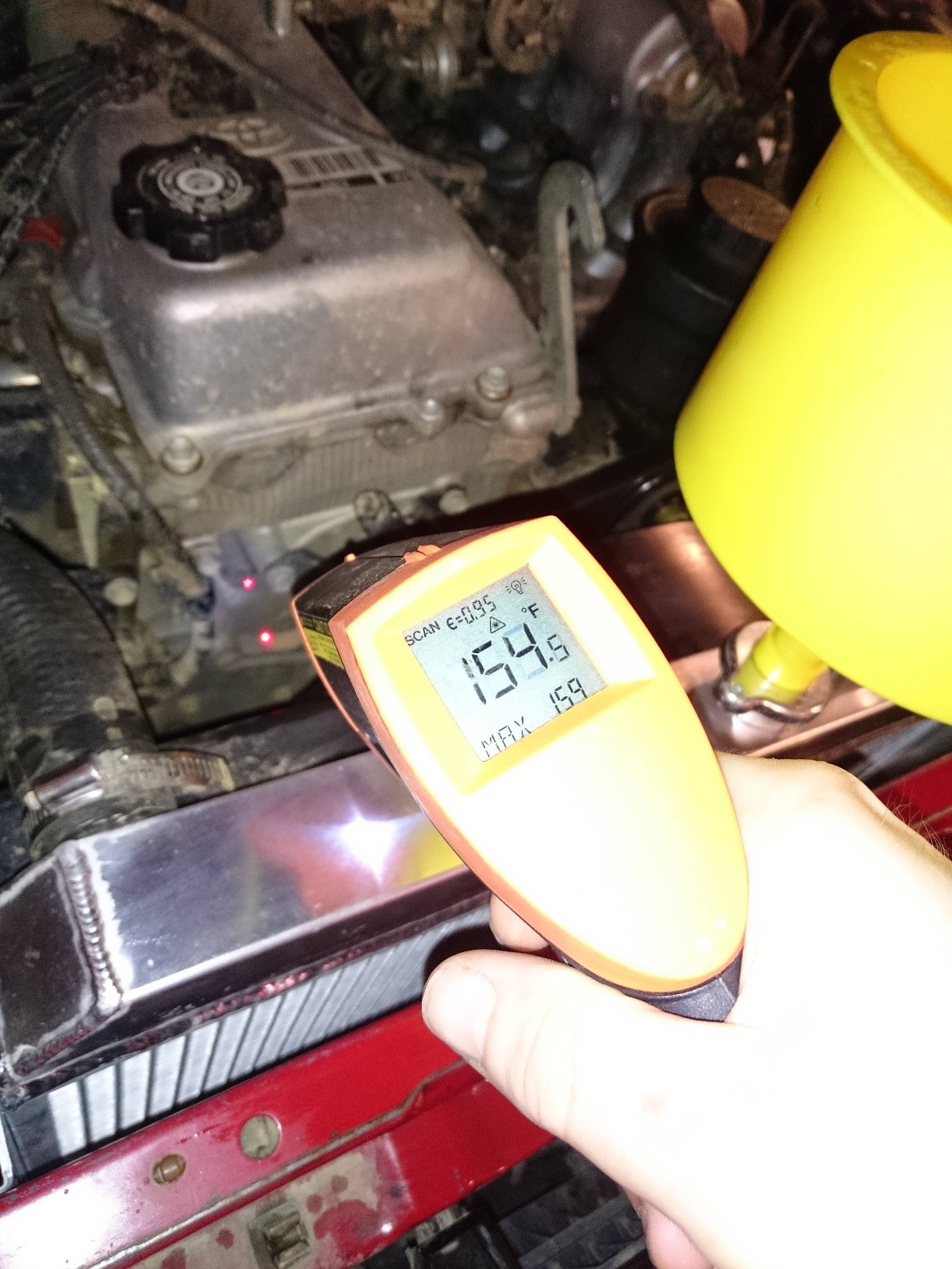

18.Replace stock 3RZ thermostat with 180* (LCE sells it and its accompanying o-ring)
While I was in there I decided to upgrade the thermostat to the 180* one.
Results after the new rad and thermostat. Block was at 198* before.

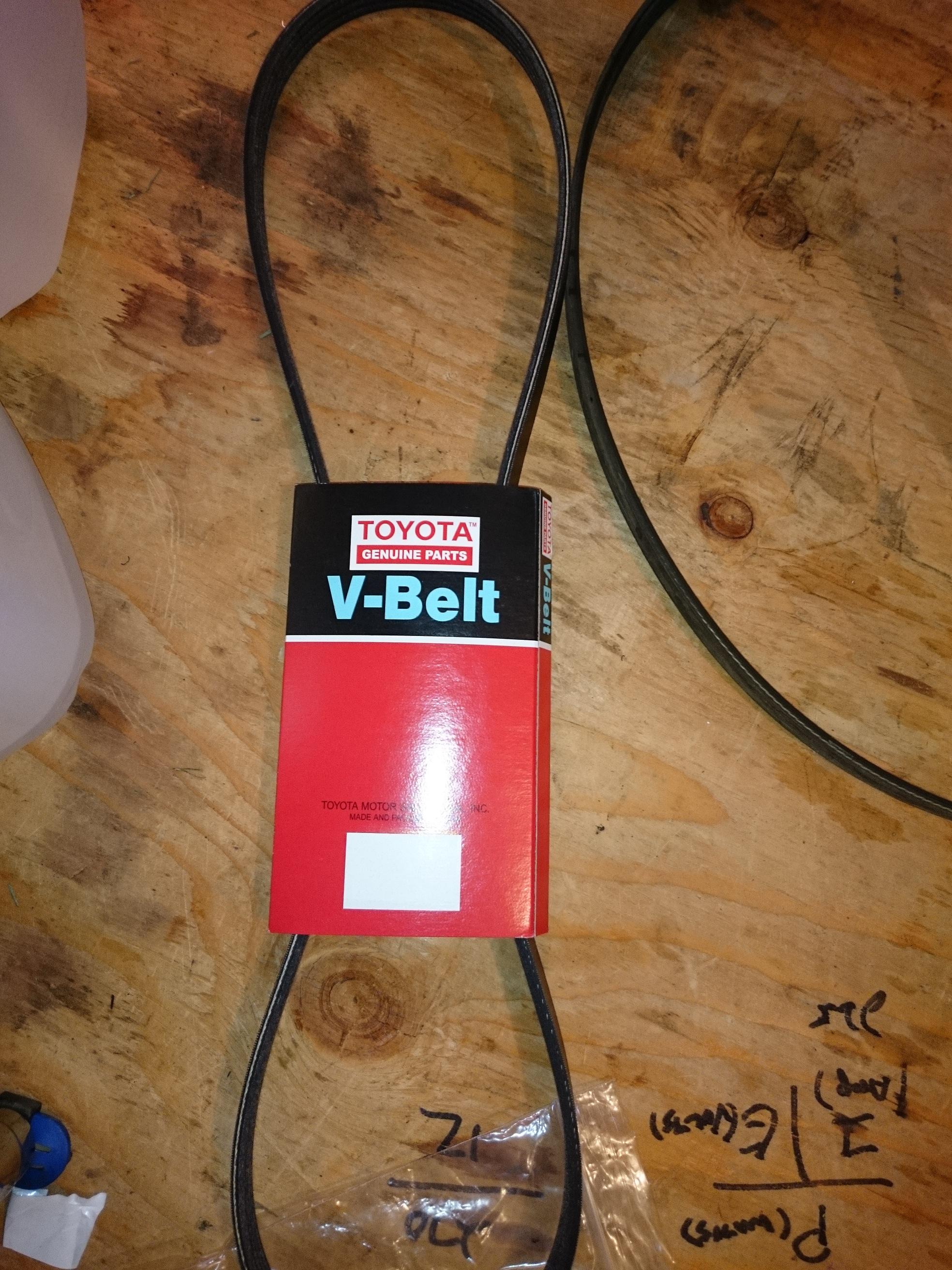

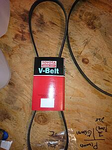

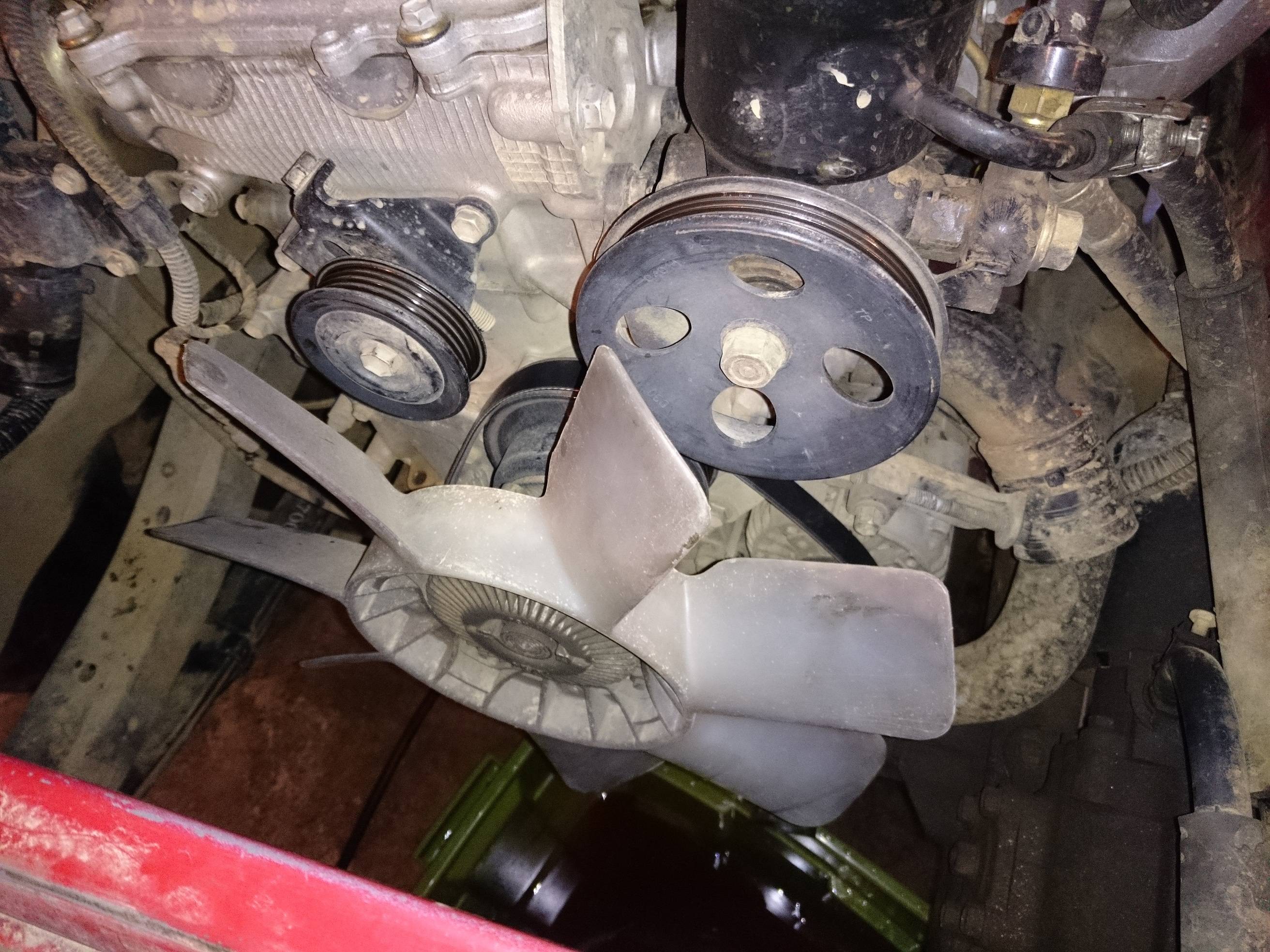

21.Belts are squealing on acceleration (replace with Toyota bando belts sourced from dealer)
Did the belts since I had the rad out and they had been lightly squealing on acceleration.

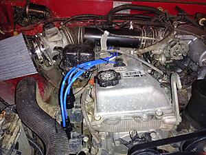

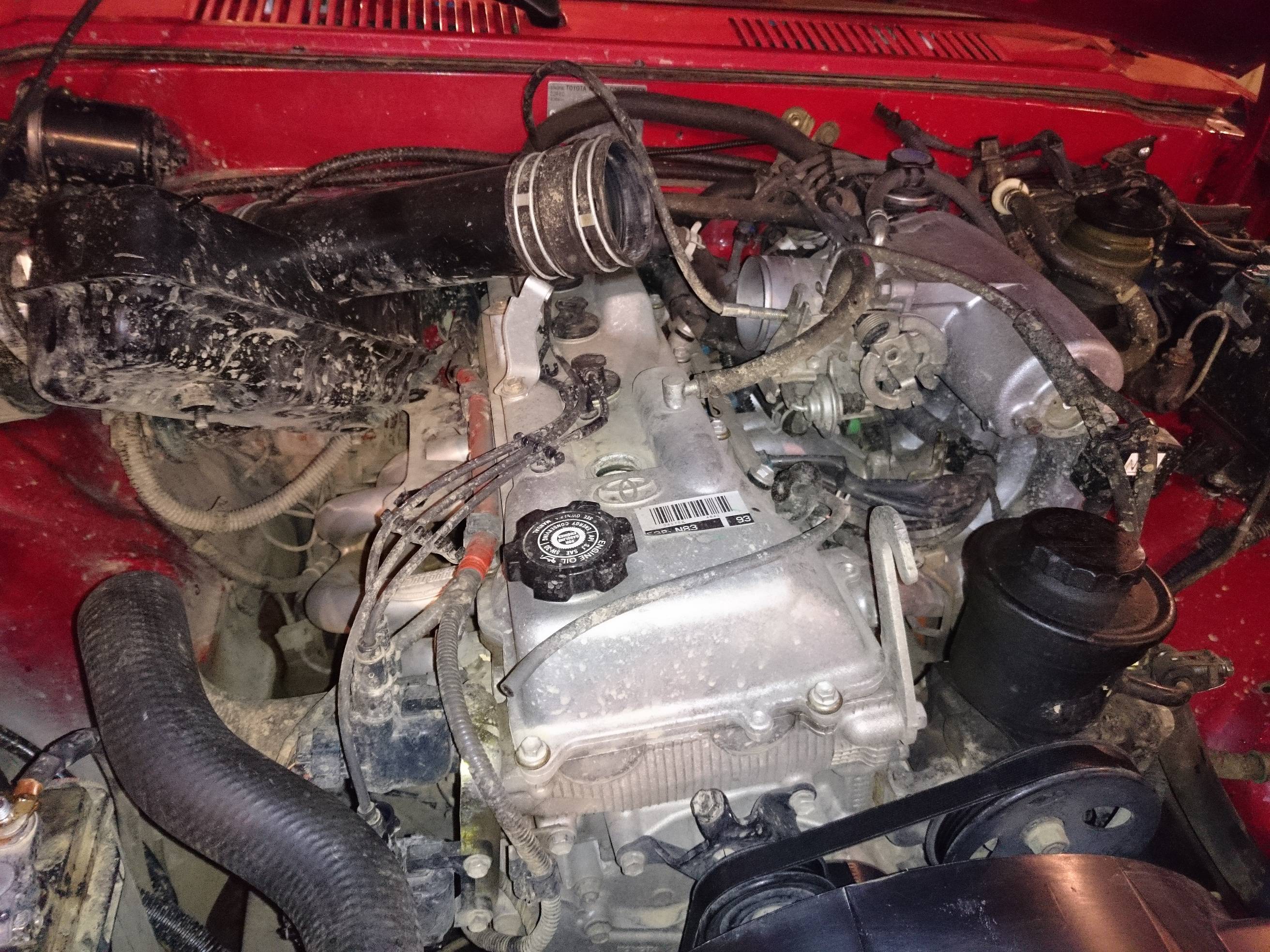

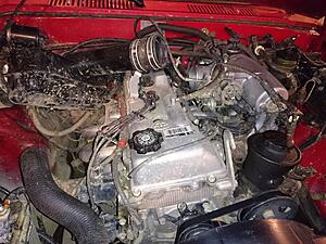

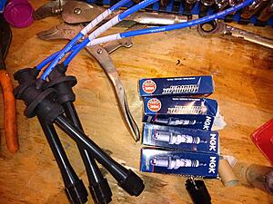

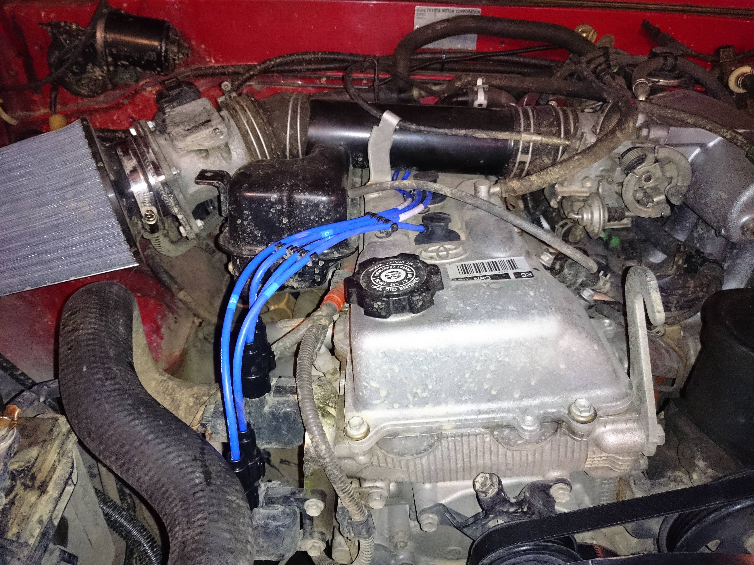

22. Replace spark plugs and wires (
NGK wires NGK wires
Plugs Plugs
Did the plugs and wires I've had lying around since Christmas as well.
Before:
After:
